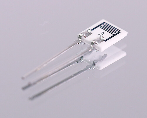

        The supply for the humidity sensor is more complicated. It is a square wave of +5V / -5V at a frequency of about 1KHz. That in turn switches on for a second then off for a second. The fact that such a complicated wave is being produced suggests again that the processor is working. Here are some pictures for completion:

        I can't get any resistance readings using a multimeter, although it seems that that should be possible. I can't find a datasheet for the CJ-HR31. I've found one for the similar HR202L (attached) which suggest that resistance should be somewhere around 5-20k, so maybe this sensor is damaged. The HR202L is rated to be run at 1.5V ac at 500-2000Hz. A website selling the CJ-HR31 states the same 1.5V ac, 500-2000Hz parameters so it could be that this is the source of the problem. The manufacturers are instead switching a 5v supply on and off regularly and hoping that this doesn't damage the sensor. But then according to the manual:there should be an error code in the display but it continues working anyway:
        E2 Error Code - The humidity sensor is broken. The unit still dehumidifiers but in continuous mode only.​
        I'm working through Aliexpress listings trying to find a sensor that is marked with a "3" like mine, but I might just buy a few different ones anyway and see what happens.
        Thanks for the pointer.
        HR31 humidity resistance is the use of a new type of organic polymer materials humidity sensing element, a sense of a wide range of wet, long-term use of stable performance, can be applied to warehousing, carriage, indoor air quality control, building automation, medical, industrial control systemsand a wide range of applications such as scientific research fields.

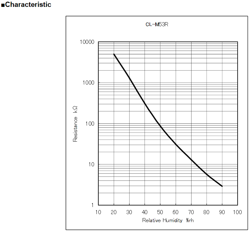

          The khz signal is applied to the sensor and humidity will change its impedance, it is not a dc resistive element
          Yours is a SHINYEI resistive type humidity sensor CL-M53R or C15-M53R (with case)

            Reading 4.5kΩ is way low, like it got wet or is dead.
            I would just swap it out with a resistor like 100kΩ to spoof 50% RH.

              The temperature sensor is driven by a solid 5v dc. It shows a resistance of 4.5k which drops to 4.2K when I touch it. That all seems fine.
              4.5KΩ is what he measured on the thermistor for temperature not the humidity sensor
