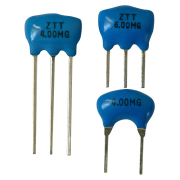

          Just had a peek at what the boys are doing: it's a ceramic device with 3 legs they're using, just so we're on the same page. They're using a test circuit like the one shown here, but my colleague in his wisdom suggested that C1 and C2 are not required as they're built into the crystal element (no doubt fooled by the dotted line surrounding the crystal and caps)...curious to see what happens
          Perhaps they ARE built in and I'm the idiot again

            ceramic resonators with 3 legs do contain the caps,
            metal cans dont.
            also, some microcontrollers have internal caps - but not many.
            as for the scope, the capacitance of the probe is enough pF to fuck the output frequency a bit - but it should still oscillate (i hope)

              Ok, so this one is a blue thing with 3 legs, so there should be caps in there. Initially, one of the kids failed to tie the middle pin to GND, but even after they did, it was still flat-lining...then again, I'm not sure the scope is operating properly OR the IC they used is fine.
              Either way, I highly doubt the oscillator caused the display to fail. Smells like a bad uC to me somewhere...

                            Based on the picture. It's a ceramic resonator and is likely bad.
                            Quartz crystals are more accurate and temperature stable than ceramic resonators. They are not the same but do a similar function and can basically be treated the same

                              This is what the part itself looks like, although it's blue and smaller. Not sure if the circuit I linked to is in operation as part of the stereo's display or it's just for testing purposes. Either way, from what I've learned so far is that these 3-legged devices (ceramic resonators) are NOT the same as THESE metal can things, are they ? The terminology gets a bit confusing there...

                                  Ceramic resonators are lower cost and tougher than quartz crystals, but not as accurate on frequency. The 3-pin parts have built-in loading capacitors.
                                  A scope probe has capacitance and loads down a crystal or resonator oscillator. The MCU osc. has an input and output, and the input is more sensitive to loading. You can see a 100mVpp sine wave at a few MHz and know it works OK, on the the freq. function on a DMM to look for life.
                                  Once the DMM or scope probe is connected, it adds say 20pF which can either make an oscillator stop, go lower in freq., or a dead osc. can start working because it's needing more load capacitance than the circuit has alone.

                                        UPDATE: apparently it's a 4Mhz ceramic oscillator.
