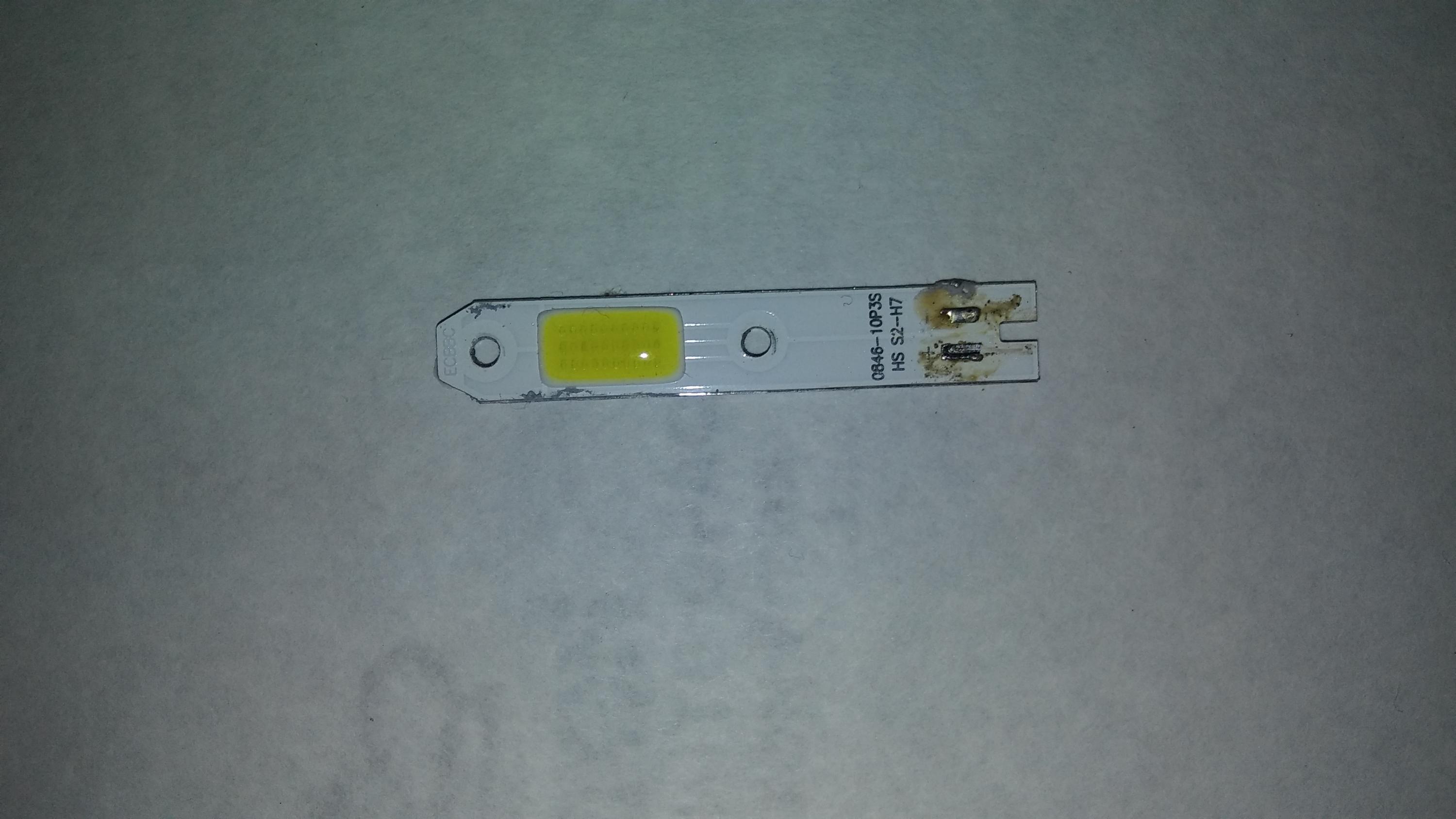

      A picture of the pcb inside the LED lamp would help.
      BigClive did a teardown of one with a fan on the end and datasheets of QX9920 IC and sch.

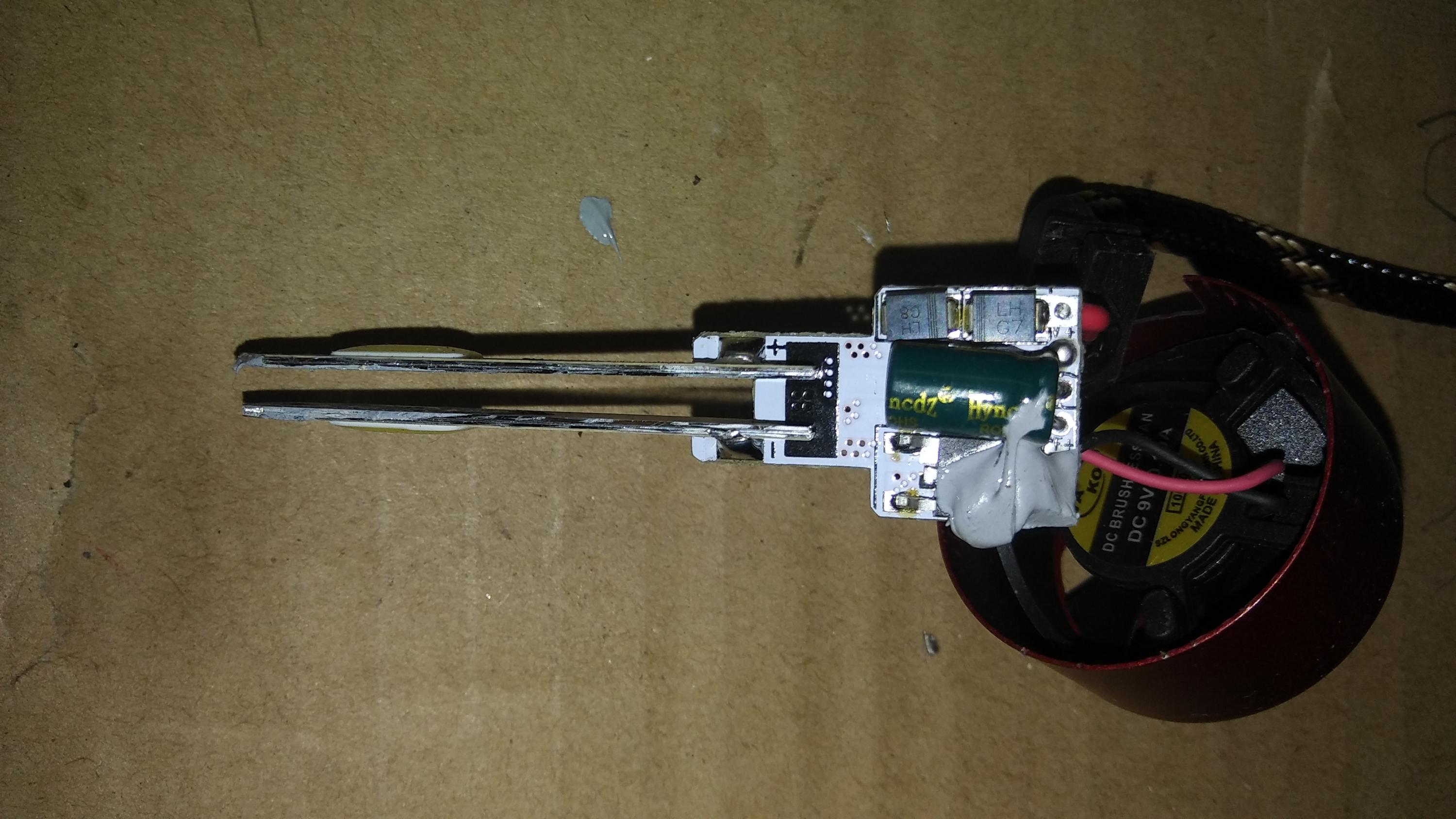

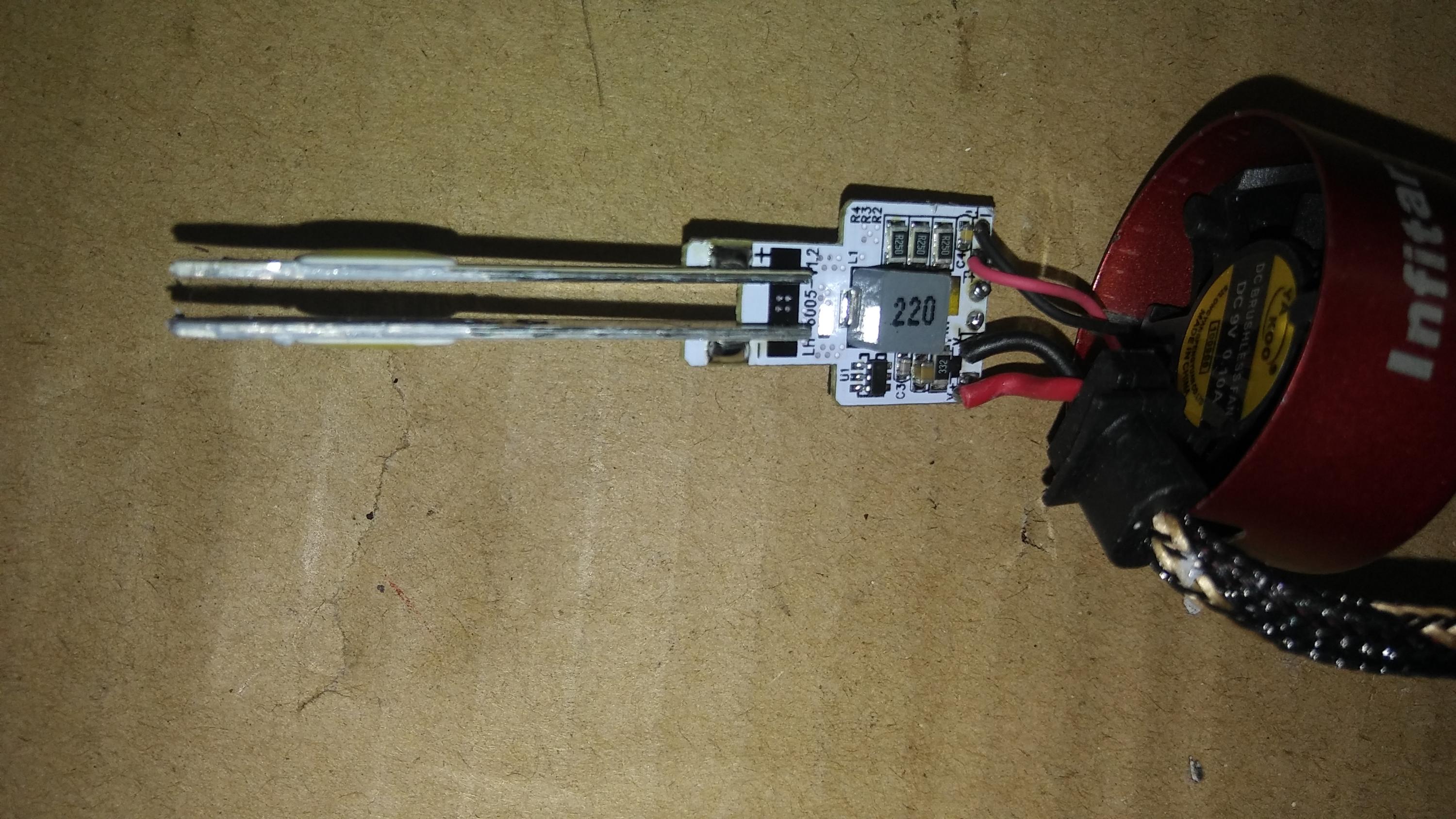

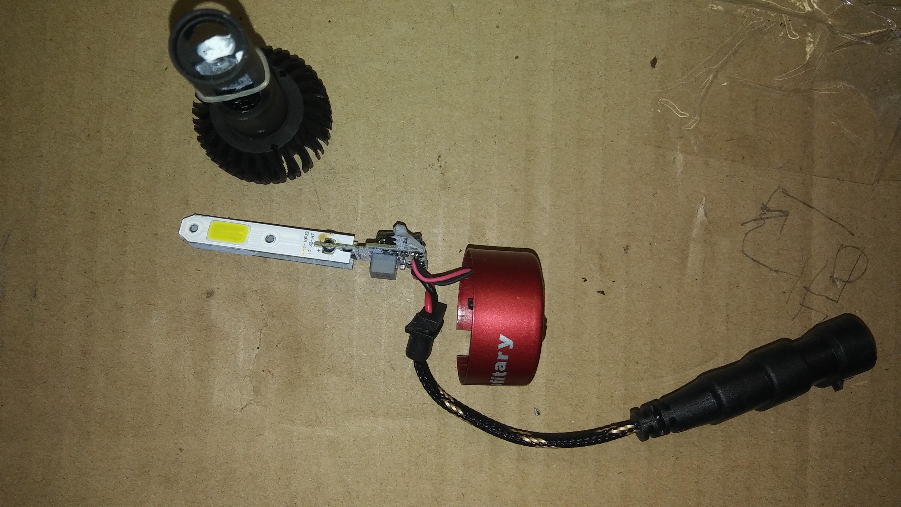

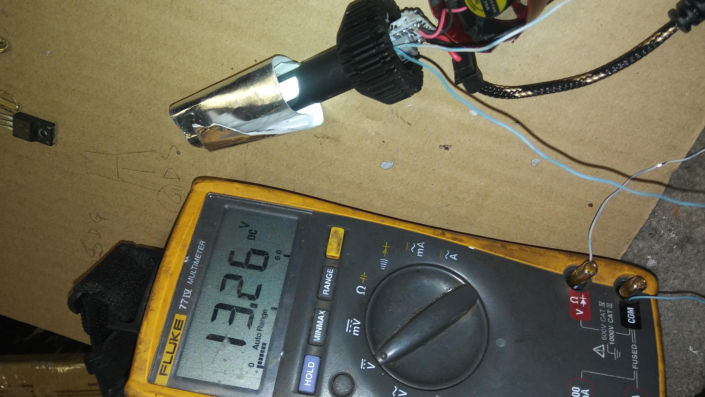

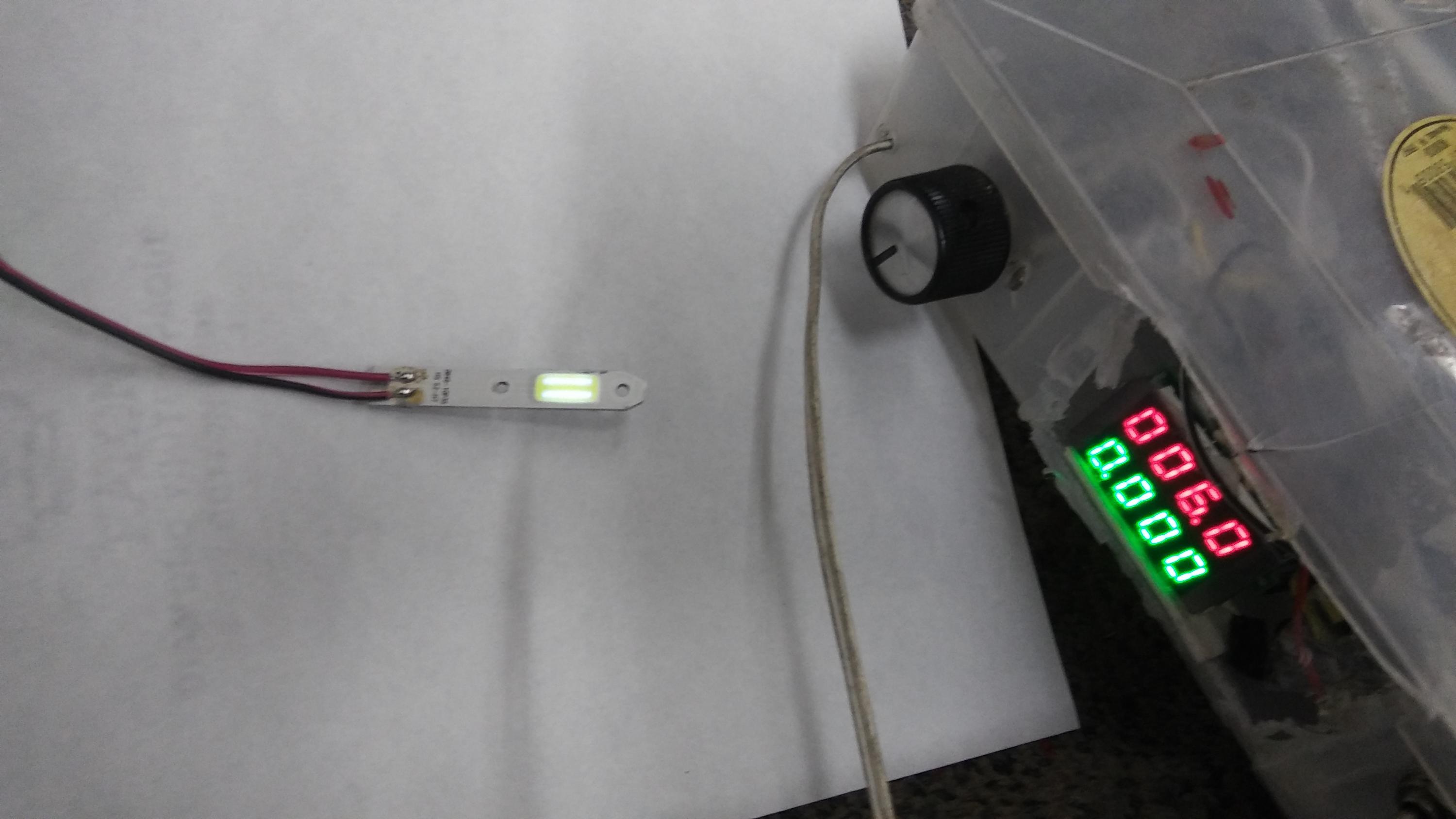

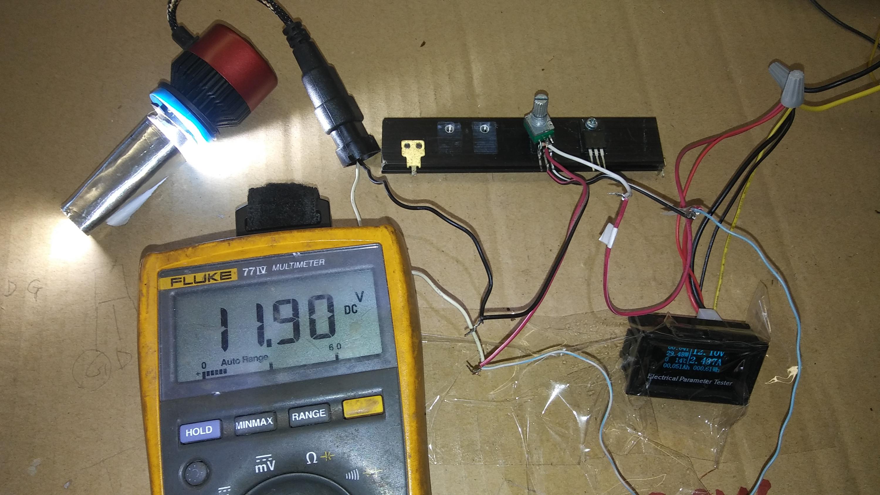

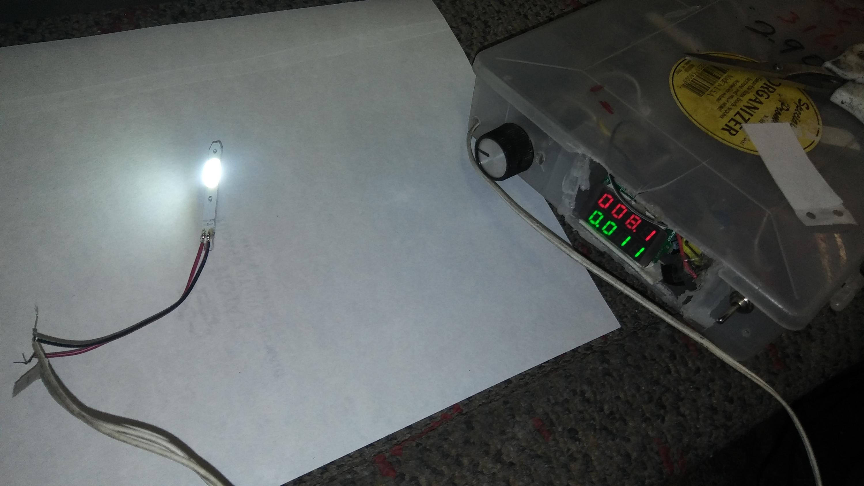

        The led light dimmer worked very good wild range adjustment, the very good linear adjustment from very dark to maximum brightness.
        When I pulled the led light out, no heat dissipation, led overheat right away, not enough time for meter to read. Pic1, 2, 3
          Re: Car LED Headlights dimmer?
          You can lower the buck-converter output current by removing one or two of the three sense resistors R2, R3, R4 that are 0.25R each.
          If the 6-pin IC is QX9920, roughly... all three = 3A, two = 2A, one =1A current to the LED's. The fan is 9V so it might be a 9V LED array.
            Your inference is very correct.
            BigClive, He explained very well. I can add a little bit more here.
            COB LEDs are 3 in each row and 10 in each line. Total 30 in my case. If leds are 3.3v then driver voltage will be 9.9v.
            This is like putting all the LEDs of a 50-inch TV on two sides of one stick. That's why the stick is so hot. I have been using it for half a year, so far so good maybe is because of the fan.

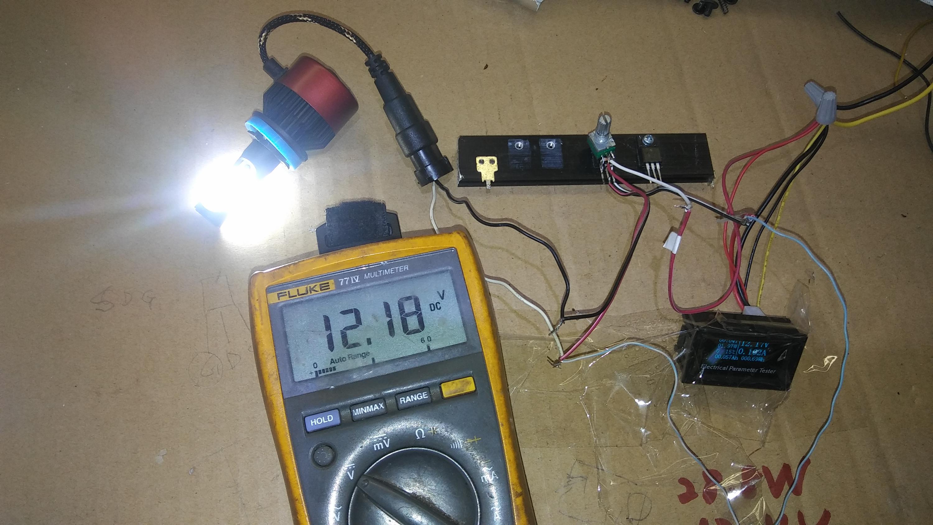

                The Voltage reading of 12.17V @.177A, is it the Voltage reading on the LED terminal or on the input feeding Voltage to the circuit. What is the Voltage between S and D pin of the MOSFET? Once you know that then you can calculate the Power dissipation of the MOSFET.
                The Voltage reading of 12.17V @.177A is it the input feeding Voltage to the circuit.

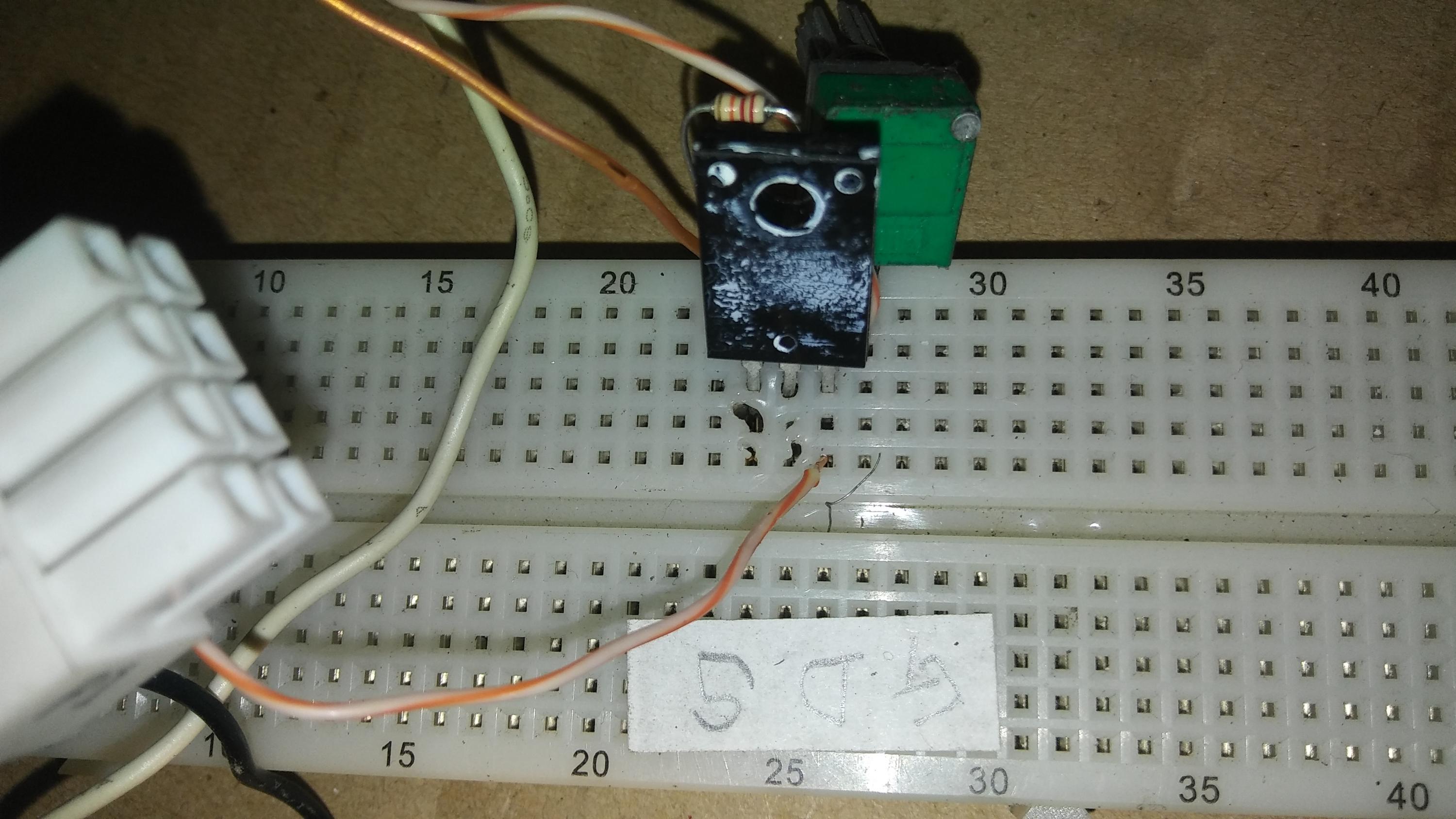

                Sorry took a long time to answer this question because of pic1. As sti predicted, the breadboard is melted.
                So I added a heat sink. Circuits are too simple to be true. Let's test for 3 days.

                  I cannot tell from the pictures as to what Voltage you have between the S & D pin of the MOSFET.

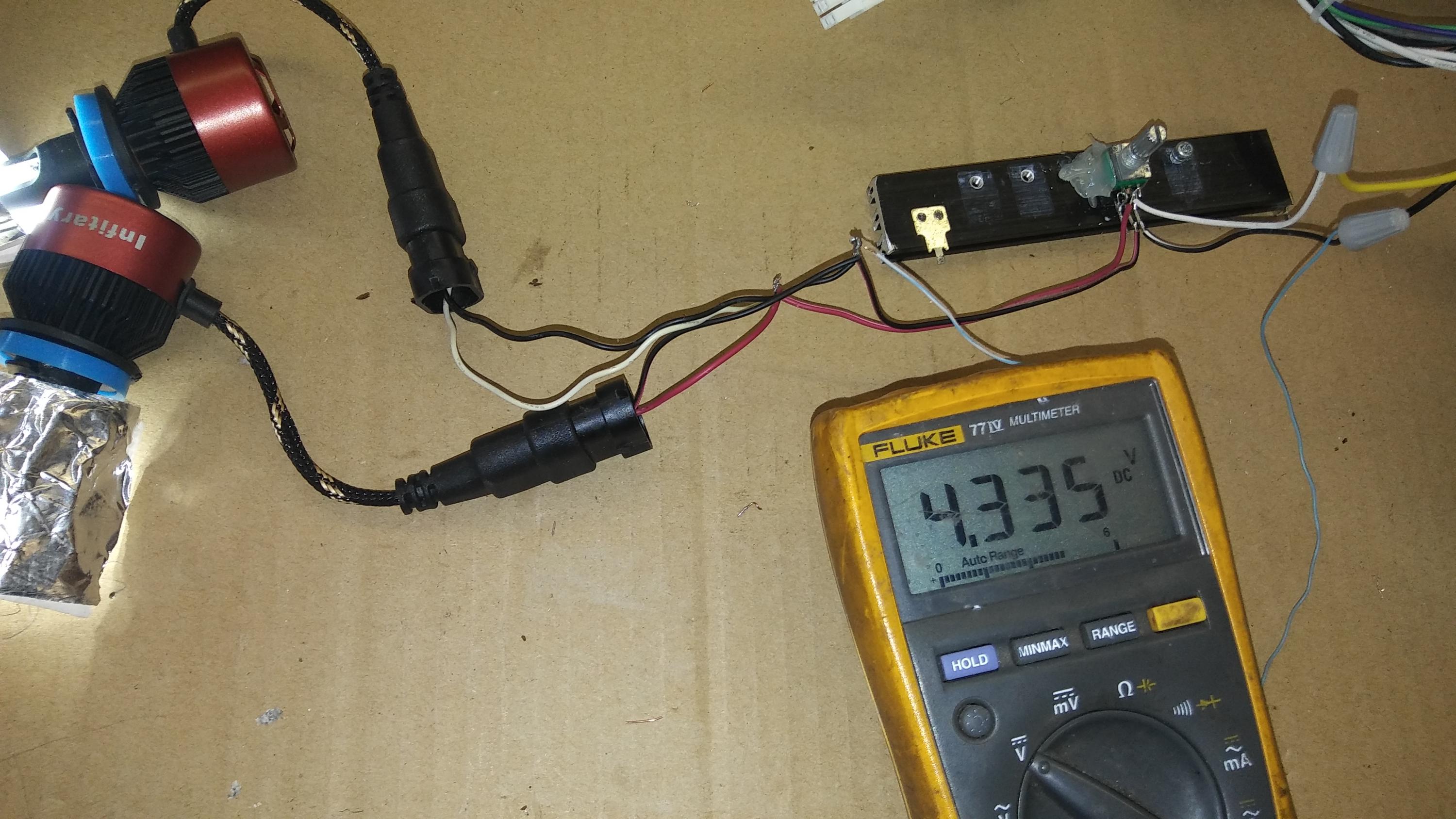

                    I soldered Fluke test leads on S and D pins of mosfet already.
                    Full lightness is 11.9v at 2.478A.
                    12.4v at 0.178A
                    12.18v at 0.102A

                      That cannot be right since the MOSFET is in series with the load, so if you have 11.9 V at full brightness between S and D then the load will barely has any Voltage on it.
                      And at 11.9V @ 2.478A that will be lots of Wattage.

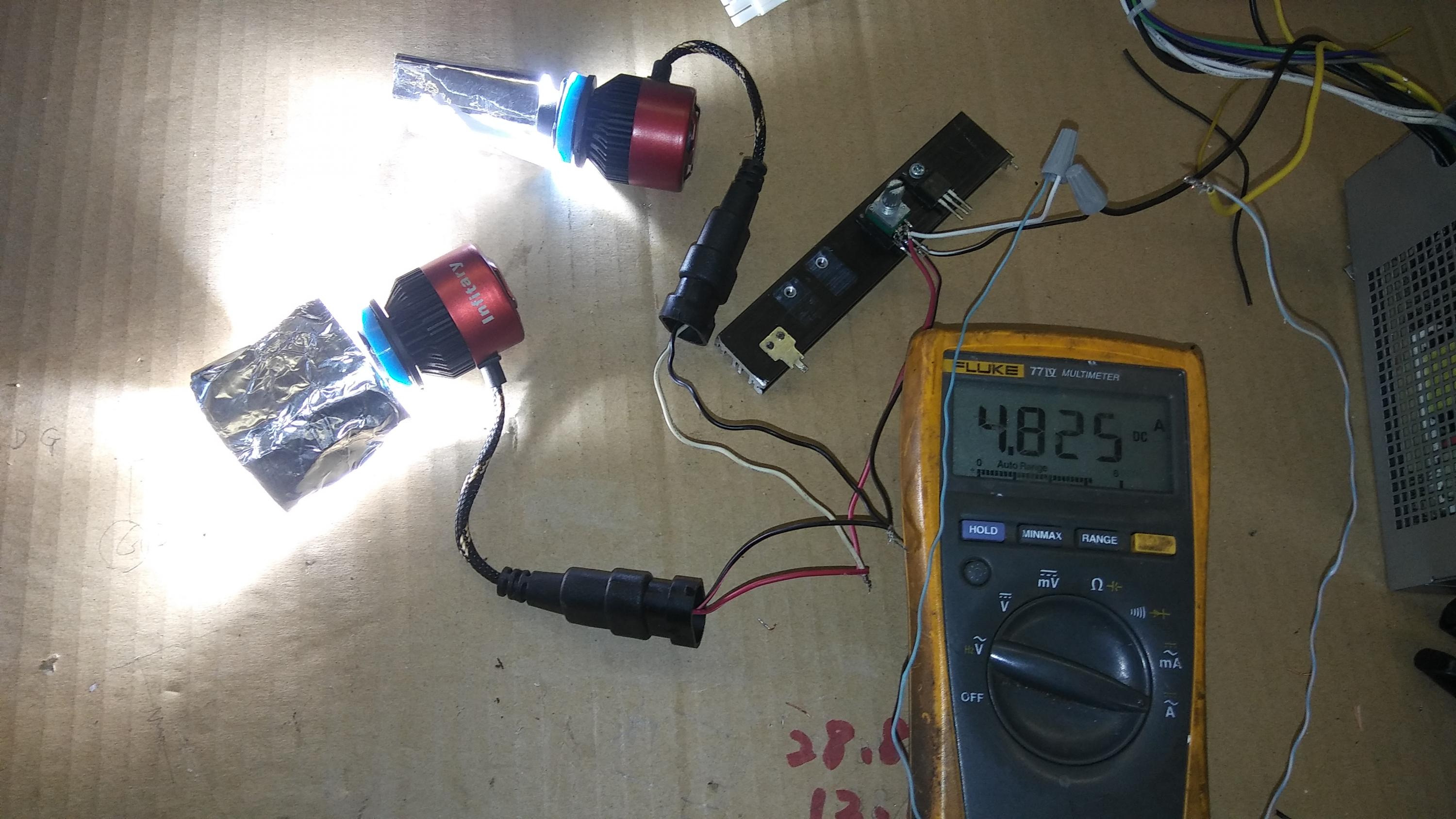

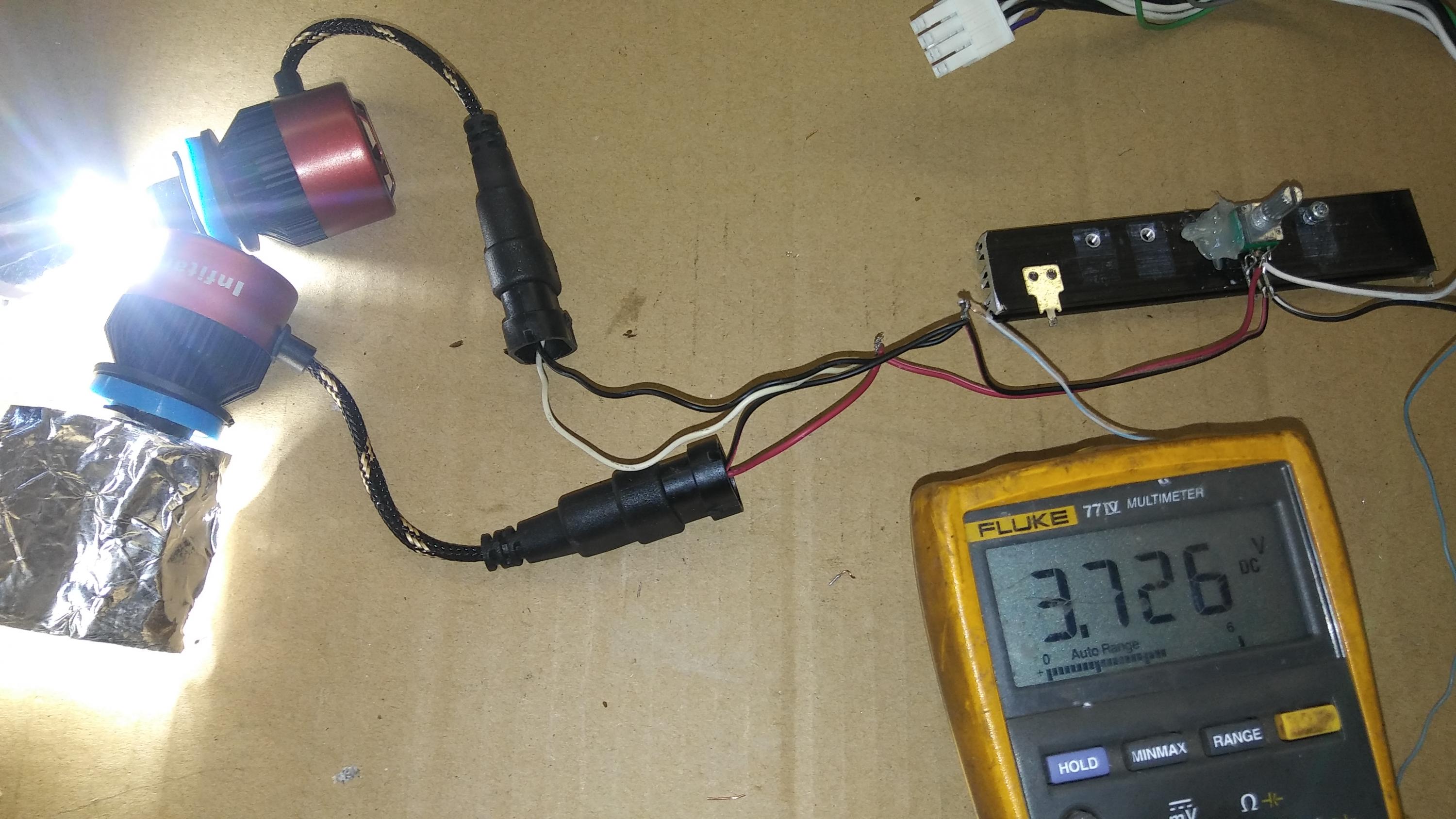

                        I connected two led lights together, reading is from a 12v power input at full brightness. Pic 1
                          #32
                          12.24v @ 4.825A for two lights. Mosfet is 50A that means OK.

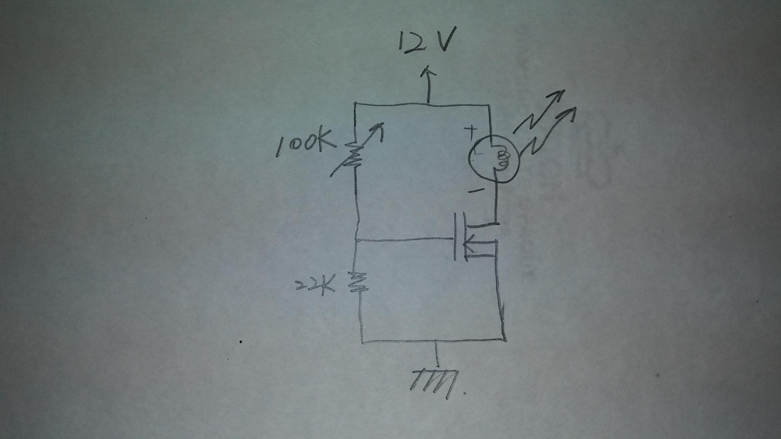

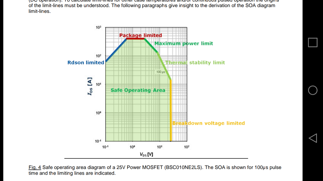

                            But as you know in series circuit, if you have 12V between S and D pin then how can you have any Voltage left for the LED?
                            BTW, it is not just the current rating, you have to consider the power dissipation also to keep the junction temperature at the safe level so proper heatsink is required.
                            Right now you are operating the MOSFET in linear region.
                            https://cdn.badcaps-static.com/pdfs/...f668f60e6d.pdf
                            https://www.powerelectronics.com/dis...mode-operation

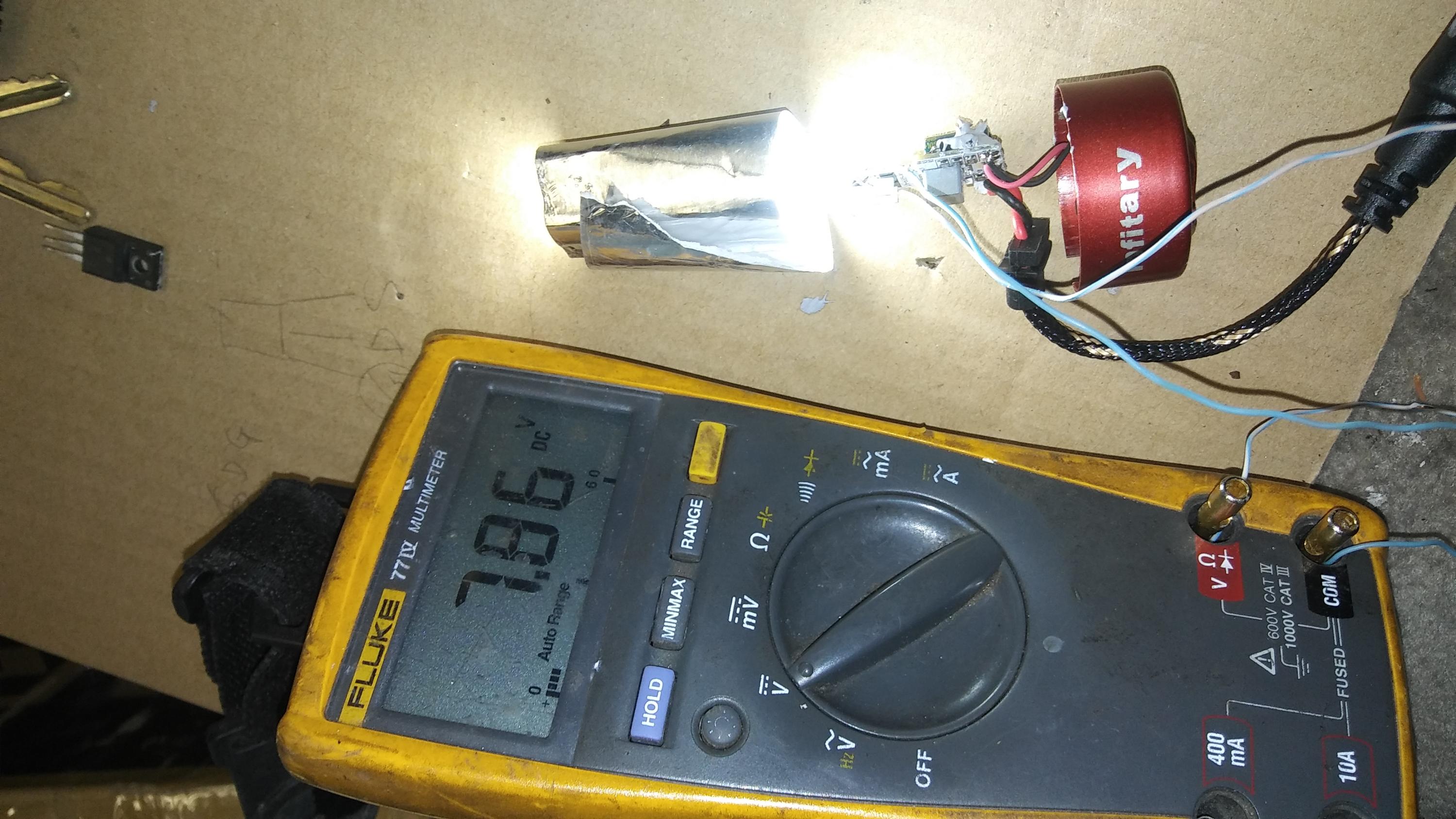

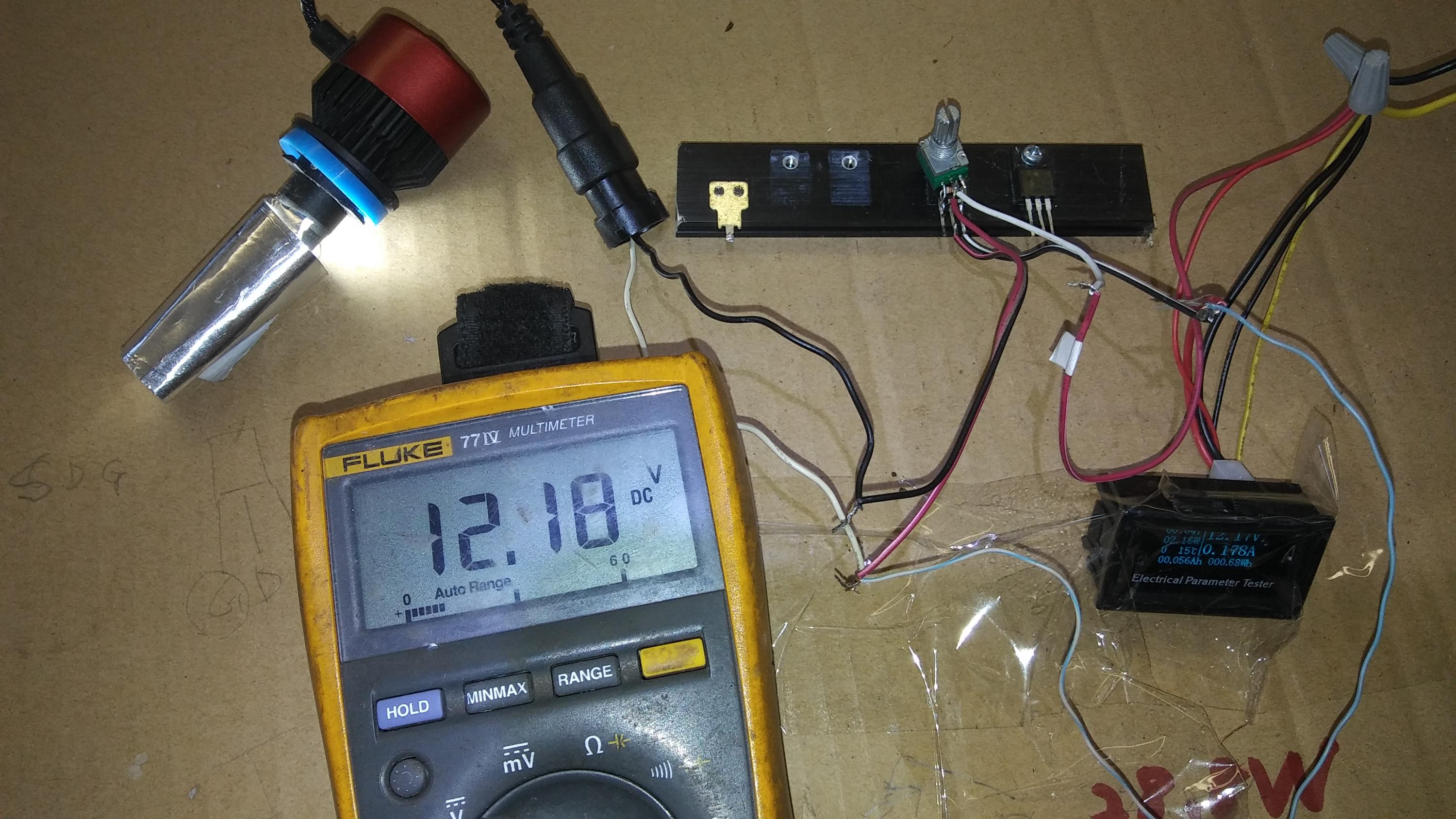

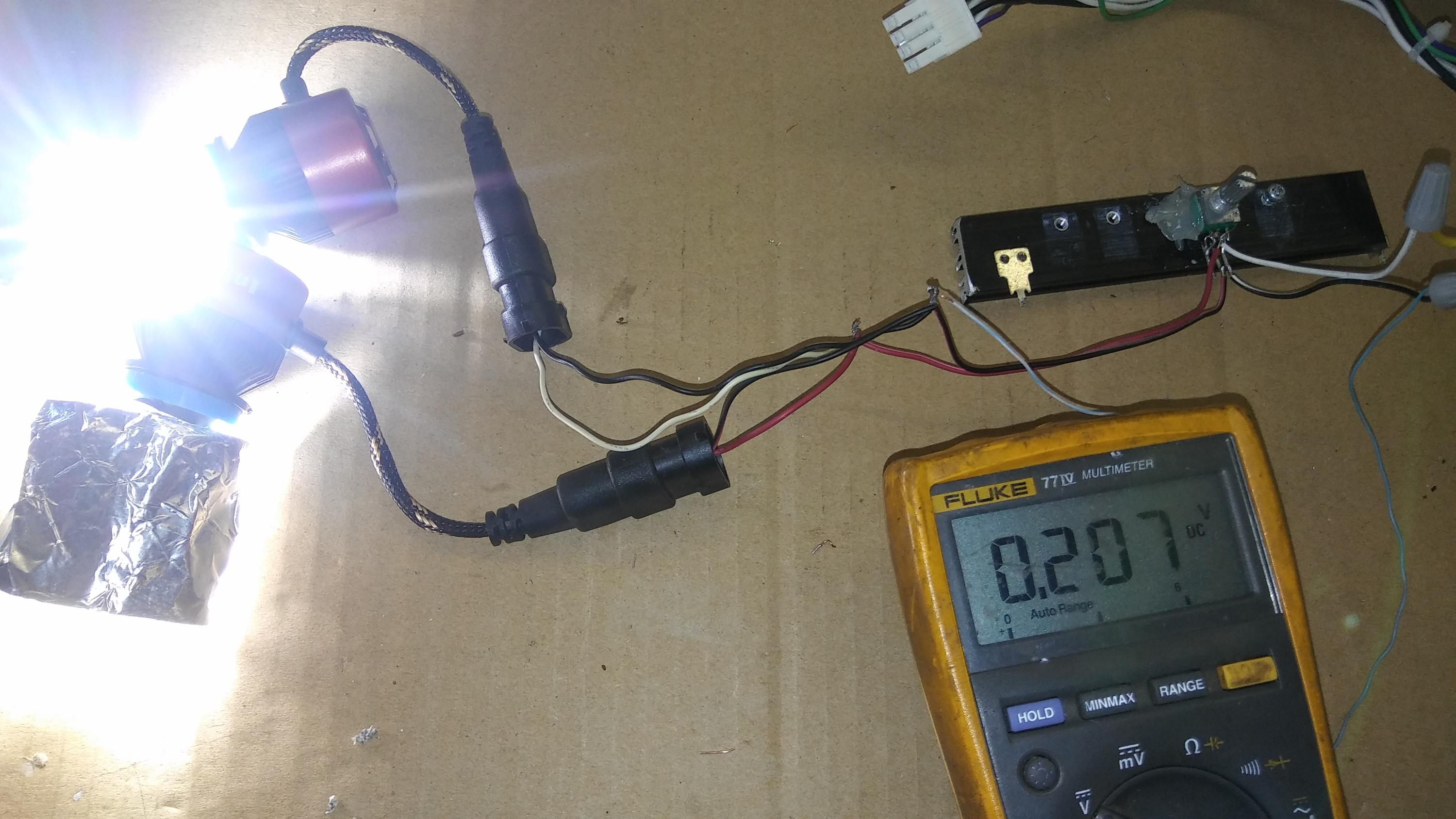

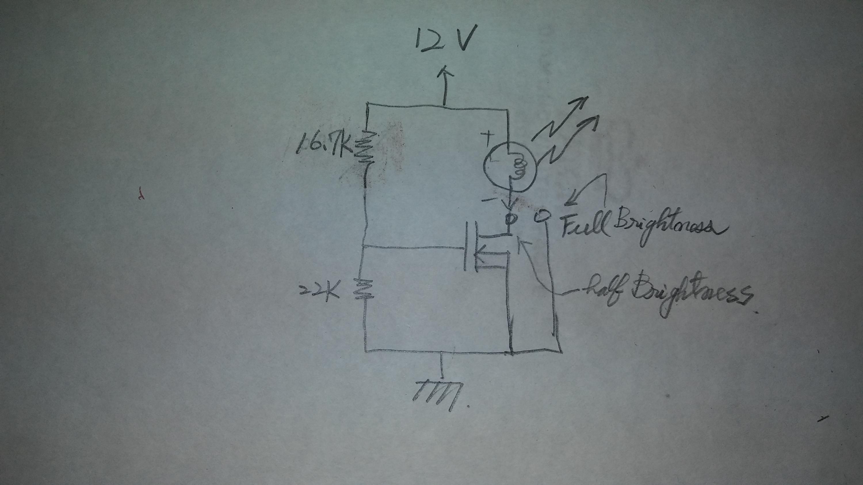

                              My bad, I am so Inteligente, series the meter leads to S and D, it should be parallel.
                              I used a more simple circuit and in the future only use one resistor.
                                #35
                                I used a more simple circuit and in the future only use one resistor. Because potentiometer is not easy to find in Africa.
                                My idea is car has dim lights during the day. At night auto turn on and switch with full or half full light.
                                Pic 4 is at full brightness.

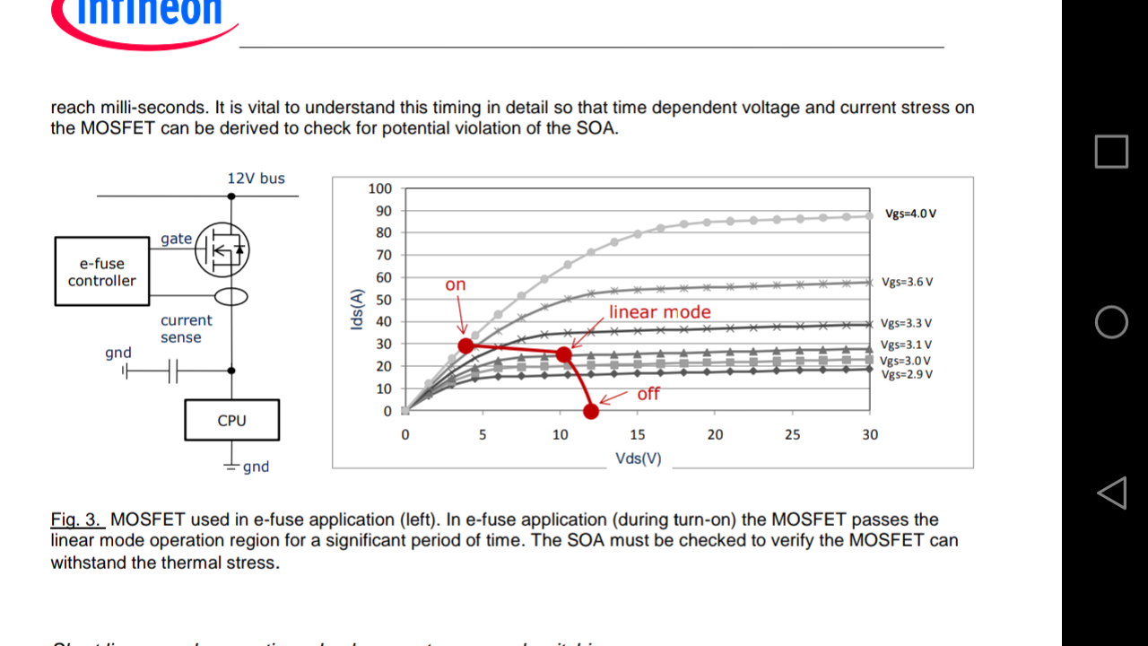

                                    MOSFETs Withstand Stress of Linear-Mode Operation....in this article I can't find fig. 1 ,2, 3, 4, 5 ?
                                    an extended forward-bias safe operating area (FBSOA).
                                    MOSFET is subjected to high thermal stress due to the simultaneous occurrence of high drain voltage and current resulting in high power dissipation. When the thermo-electrical stress exceeds some critical limit, thermal hot spots occur in the silicon causing the device to fail.
                                      yes, so use PWM like it already does.
                                        #39
                                        Or, a big heat sink? PWM IC is not easy to find in Africa.
                                        I used half brightness, mosfet is not hot at all.
                                        When I used full brightness, mosfet is getting hot, still touchable, the way to solve this problem is full brightness just bypass it.
                                        No needs mosfet just use a coil from a hairdryer make 2.5A x 12v=30w current limit resistor.
