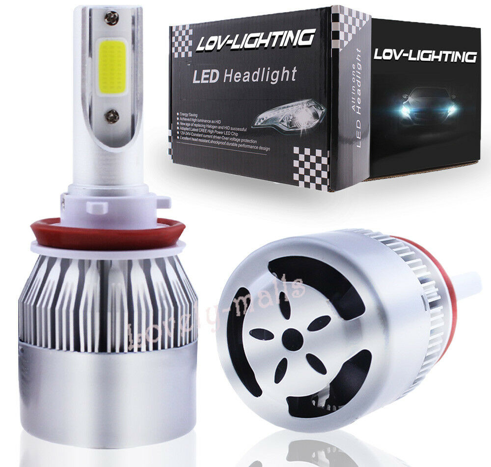

      Re: Car LED Headlights dimmer?
      they are cheap ($12 per pair) aftermarket Car LED Headlights, i try to DIY an add-on dimmer switch, I don't want to hurt someone's eyes.
      After I've installed the headlights, I though were pieces of junks, on the contrary, they are very powerful. All the road signs and road surface markings become more clear but at the same time, it is also very easy to make people dazzle.

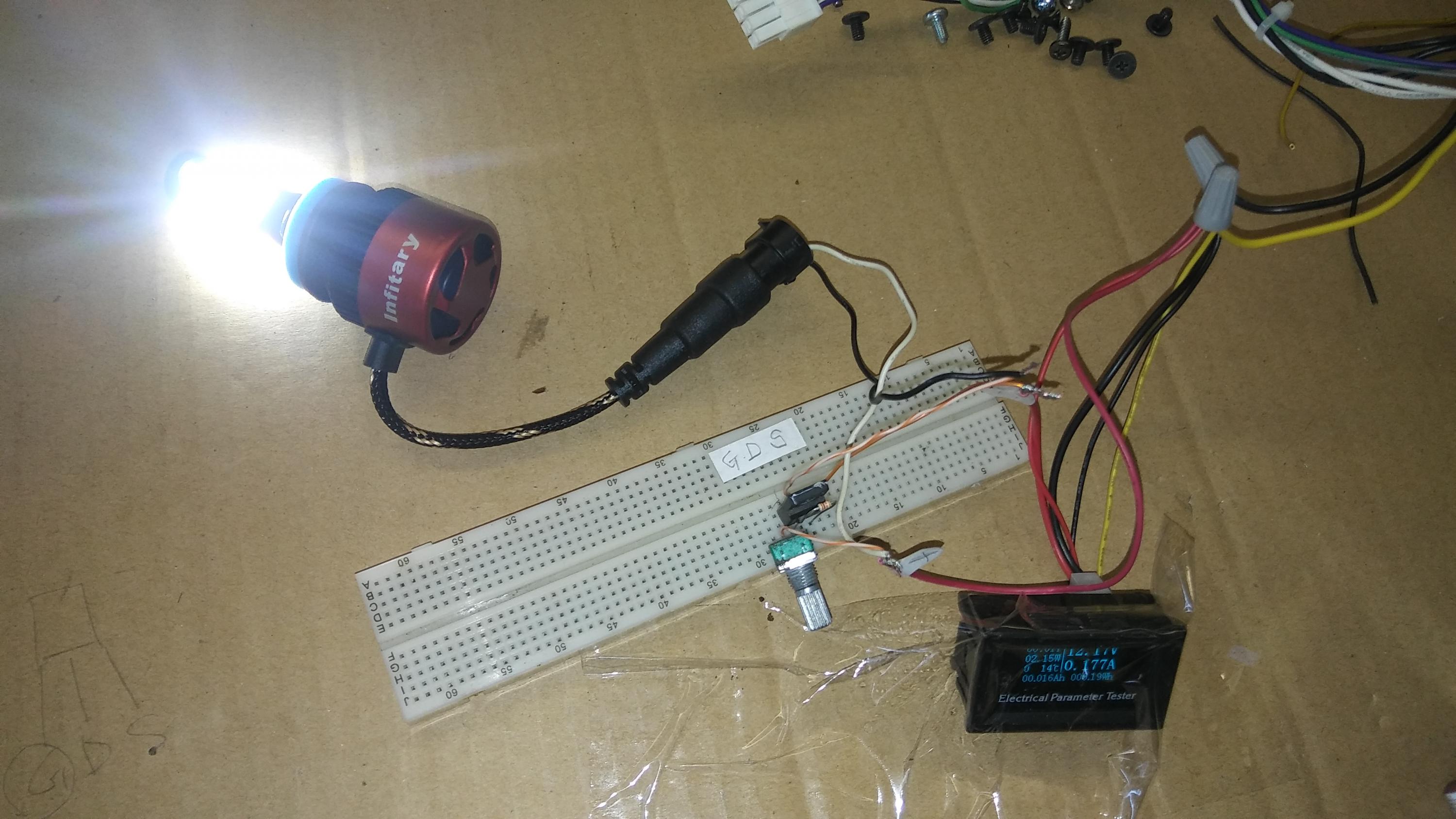

            • capwizard
              • Jun 2016
              • 1991
              My idea is this: isolate original power supply then get my own power supply from battery and add control circus for headlights.
              Led strip dimmer controller | using one mosfet
              https://youtu.be/mnJCRR3yoDU
              In the meantime. I try to put a Cds (photo cell) sensor so I can control headlights automatically.
              Automatic night light circuit diagram using mosfet
              https://youtu.be/UaVFRyObpkU

                    • capwizard
                      • Jun 2016
                      • 1991

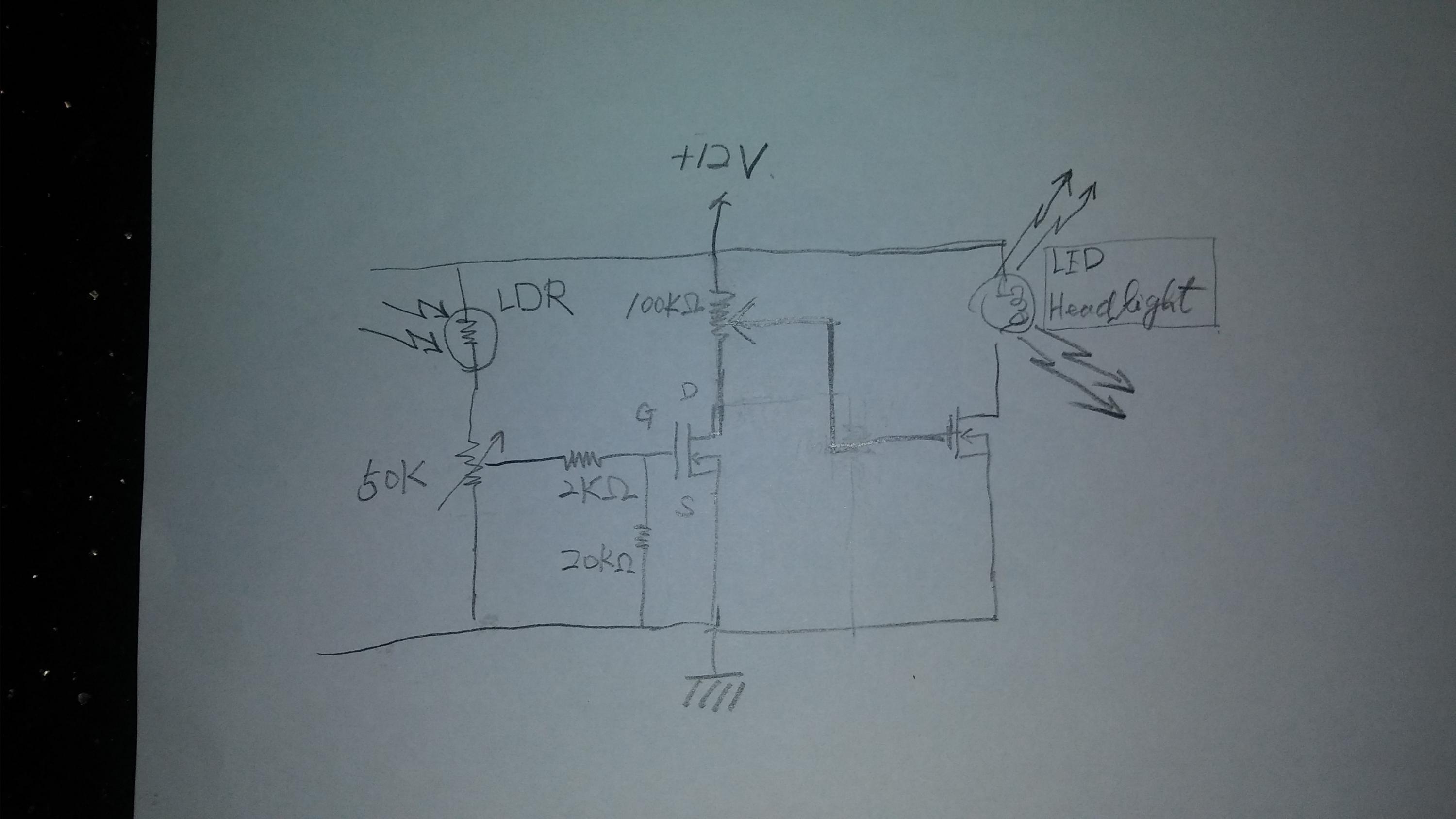

                      Car LED Headlights
                      What I want is to turn on the headlights automatically at night. When the night light is on, I can adjust the intensity of the light.
                      Can this circuit I designed be implemented? pic 1
                        • 31087
                        no, it will get too hot.
                        you need pwm squarewave.
                        drive the fet with a microcontroller or a 555 timer or a 4011 cmos chip
                          You need pwm squarewave.
                          Drive the fet with a microcontroller or a 555 timer or a 4011 cmos chip
                          +1
                          BTW, what is the current draw of that LED assembly?
                          Link to where you buy it from?

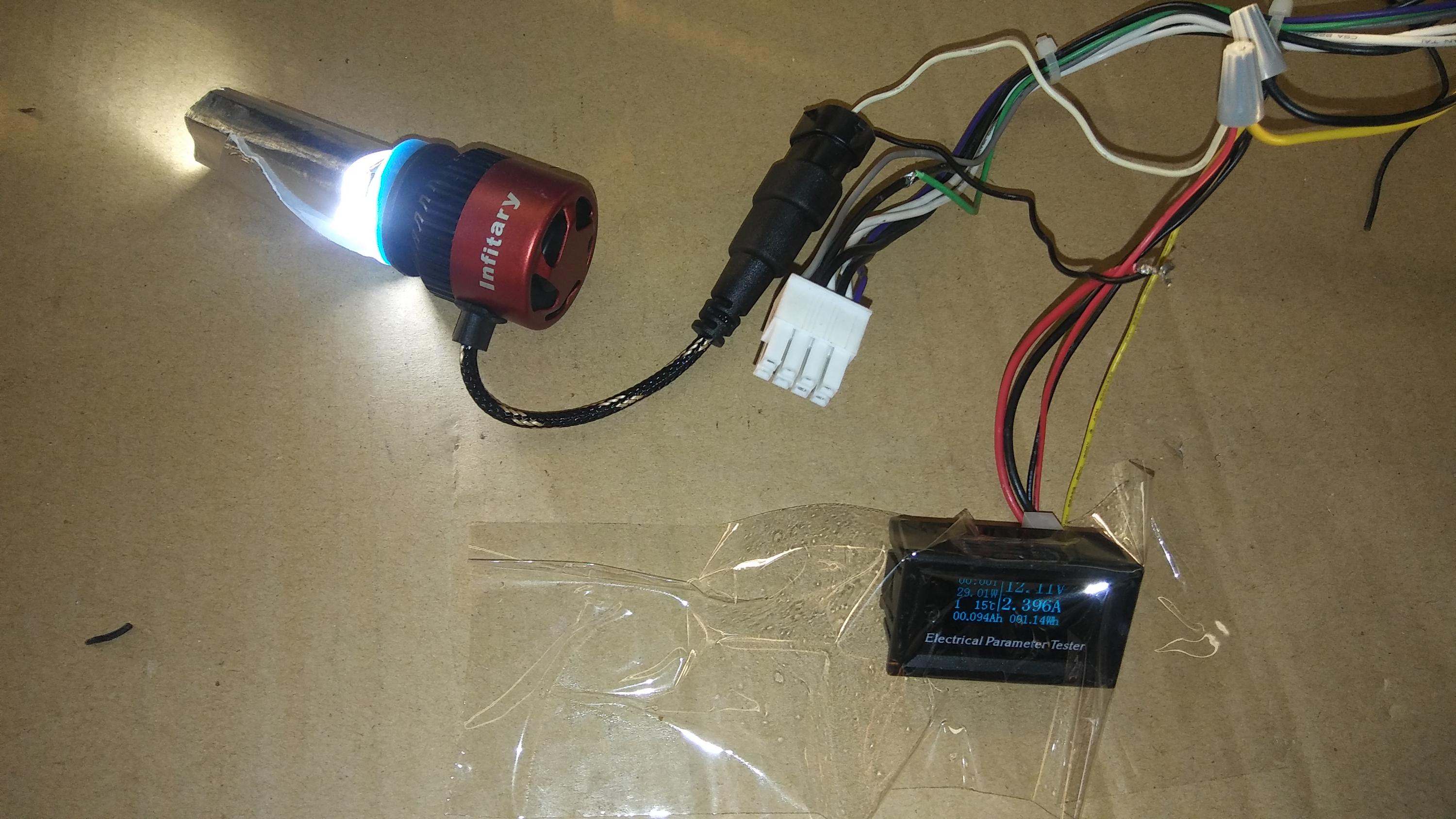

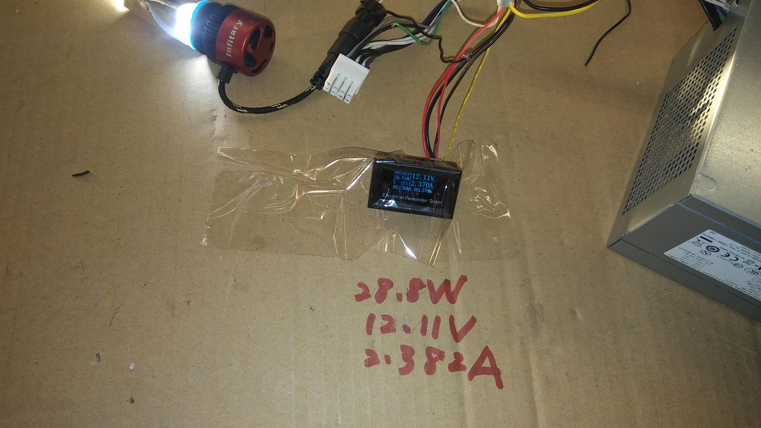

                          • capwizard
                            • Jun 2016
                            • 1991
                            I bought it over Aliexpress, $12.78 for a pair, now they out-of-stock but I think they still have similar products.
                            In fact, this headlight does not use a lot of current, 12.11v @ 2.38A. I have done experiments before, I just used an irfz44 (60v 50A) could control the car headlights and it won't get too hot.
                            My goals are to let it be easy to make and not too complicate. The main purpose is to help peoples in developing countries.
                            In the meantime, I would like to use STM32 then write a program to control the LED heard light sequence.
                              The lamp is rated at 72W so how is it related to 28.8W?
                                • 31087
                                maybe both together, driven at 14v???
                                • capwizard
                                  • Jun 2016
                                  • 1991
                                  Maybe in the car battery is 13.5v not 12.11v.
                                  They mention about 24v. Maybe uses 24v or a pair leds total power.

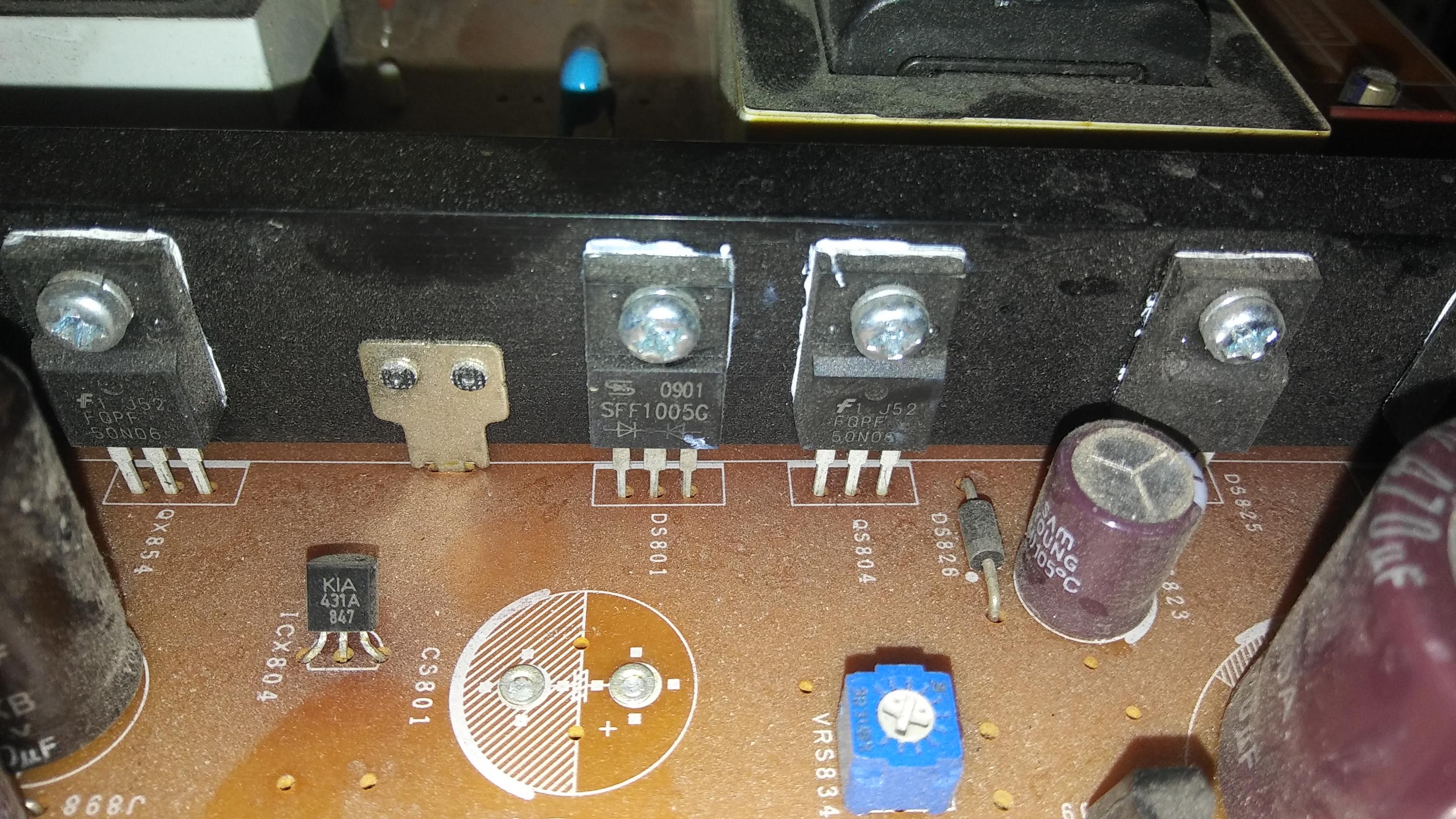

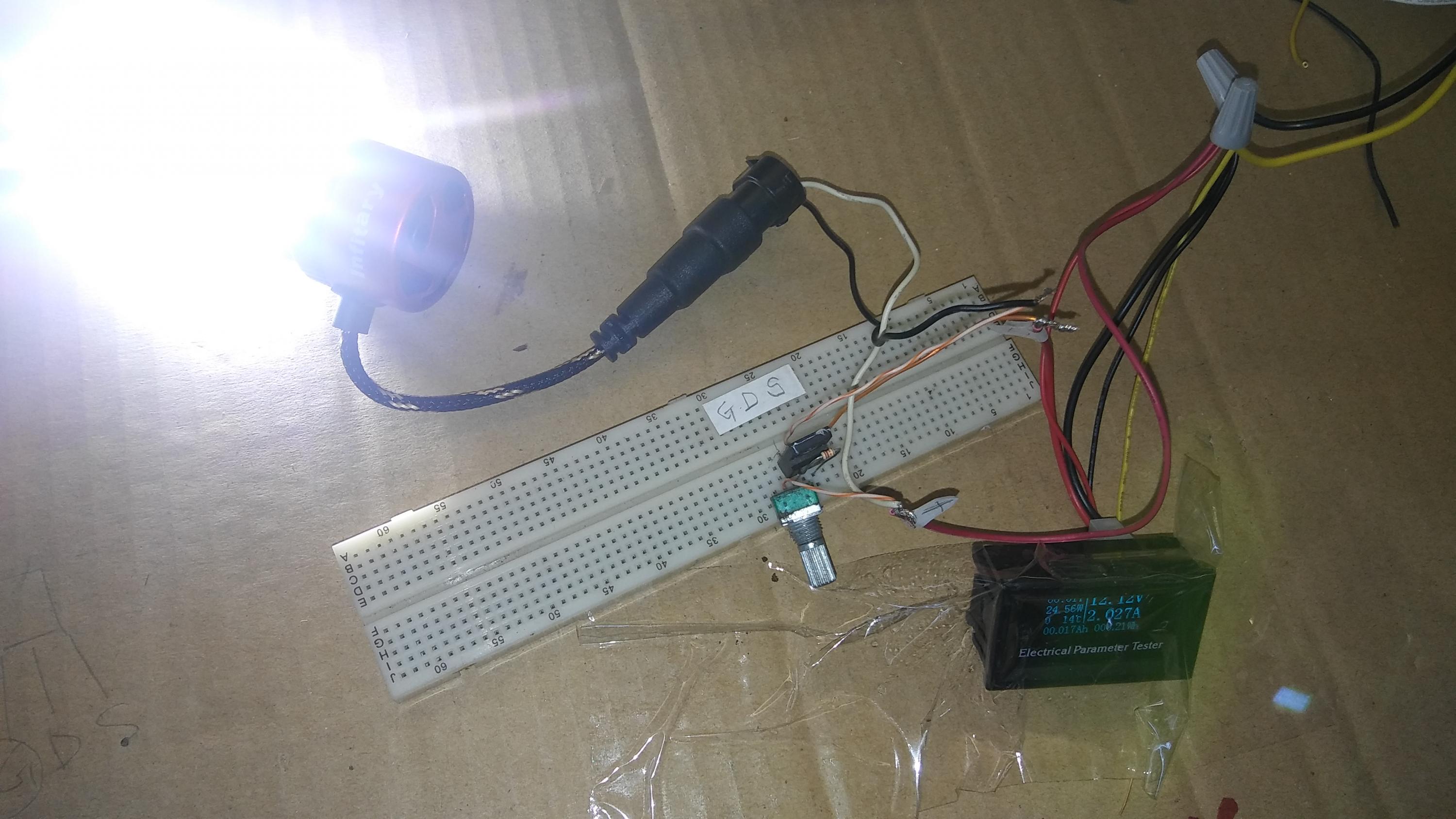

                                  • capwizard
                                    • Jun 2016
                                    • 1991

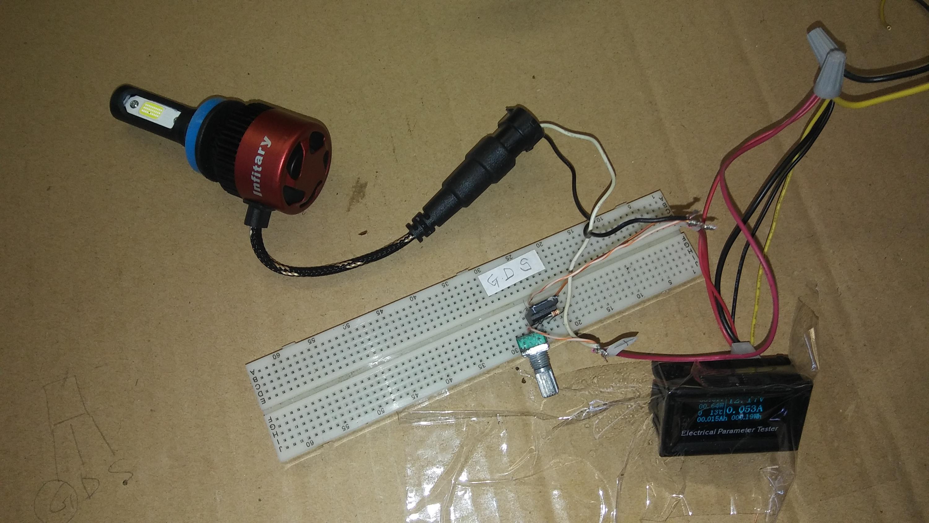

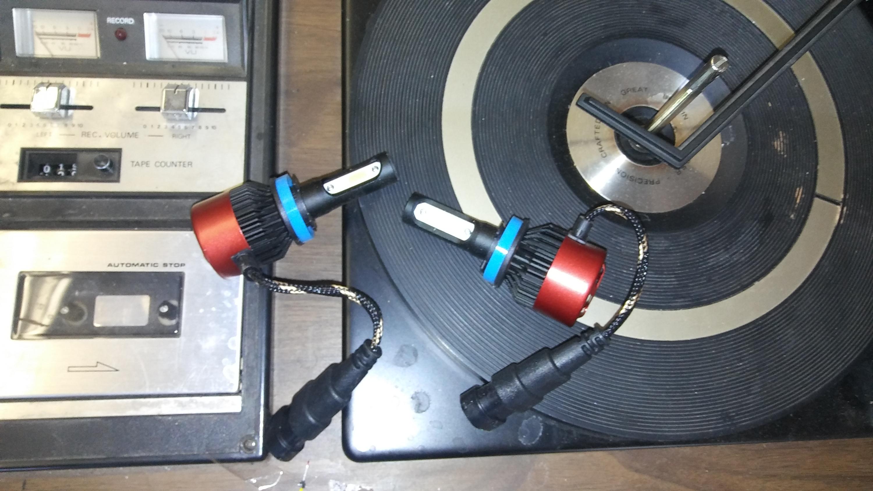

                                    I will let this led light dimmer turn on for at least 3 days see what will happen? Pic1, 2, 3
                                    Pic4 MOSFET is from junk board 50N06 (60v, 50A).
                                    Ps..each LED head light has 60 of small leds, each side has 30 of them. I counted on pic 1. The back dot in pic 1 is the dust.
                                      The Voltage reading of 12.17V @.177A, is it the Voltage reading on the LED terminal or on the input feeding Voltage to the circuit. What is the Voltage between S and D pin of the MOSFET? Once you know that then you can calculate the Power dissipation of the MOSFET.
                                      • redwire
                                        • Dec 2010
                                        • 3910
                                        I think we're assuming the LED headlamp is like a light bulb, a linear load.
                                        But inside is most likely a boost/buck converter.
                                        So supplying the LED lamp with 10V or 15V should give the same (constant) power to the LED's and not really dim it.
