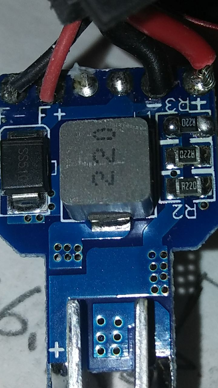

      Re: Car LED Headlights dimmer?
      Can you just switch in and out the Rsensing resistors so you can do HI-LO?
        #43
        That was a brilliant idea...This (Rcs) can omit the cumbersome current limit resistor. all you need are switching with SMD resistors. It costs $0.

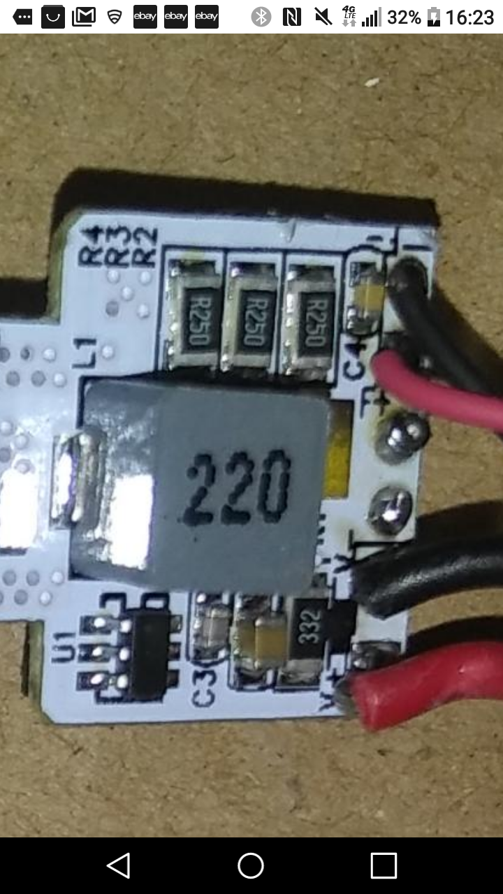

          Higher Rs = Lower LED current.
            #45

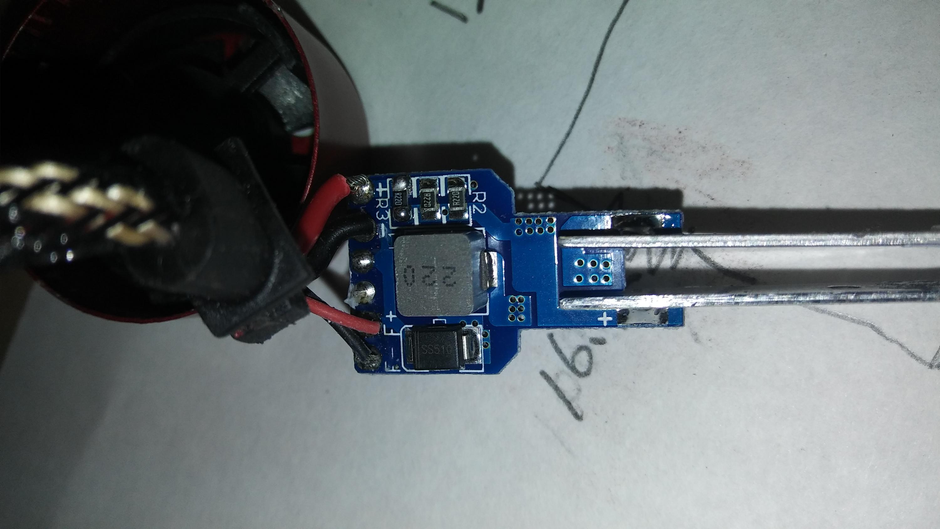

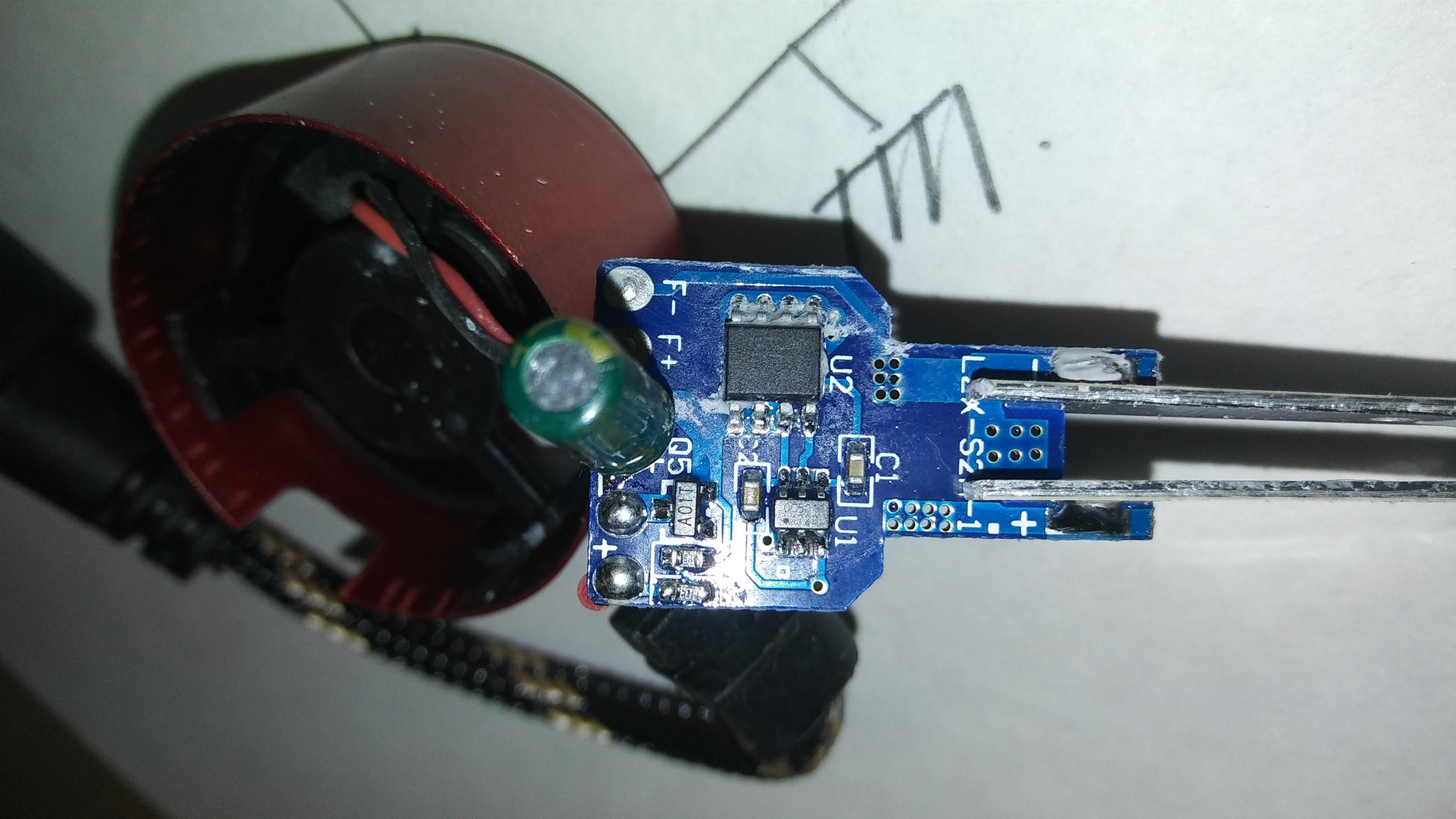

            Red wire said...R2 R3 R4 (25ohm) are current limiters.
              #46
              I cannot tell from the pictures to see how those resistors (they are supposed to be 0.25 Ohm) are connected an what pin of the IC they are connected to, you should verify first.
              The IC is QX9920 for sure? Can you see the power MOSFET? see the spec. sheet of the IC on how they are all connected together.

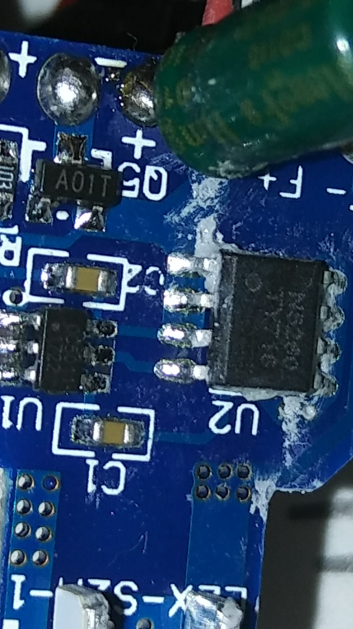

                #47
                This one shows R220 is 0.22ohm. They are parallel for higher wattage.
                The different car has different inside circuits construction. I have two sets.

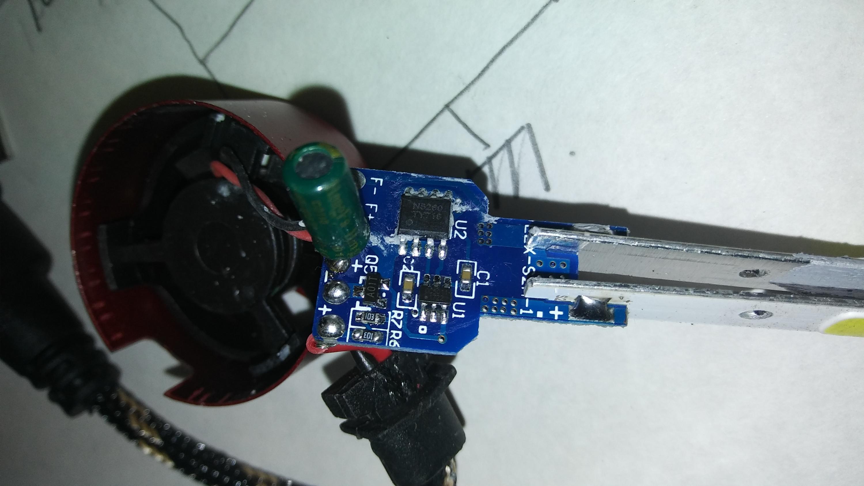

                    U2 I can't see the no. But it is mosfet. (N5280?)
                    U1 is OC5011
                      #50
                      It may be similar to something like this: https://cdn.badcaps-static.com/pdfs/...0f19c2bfce.pdf
                      IC OC5011:

                        OC5011 already has PWM input brightness control which sti highly recommended, We can use CMOS 555 as a simple PWM Generator to efficiently control brightness of the headlight.

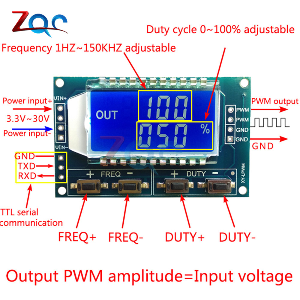

                        if you need PWM here
                        Signal Generator PWM Pulse Frequency Duty Cycle Adjustable Module LCD Display 1Hz-150Khz 3.3V-30V PWM Board Module US $1.63 pic 4

                          According to the spec of QX9920, you can apply PWM to EN pin also.

                              QX9920 EN pin and OC5011 pwm pin. I know they are digital pwm , but can we use analog signal input? For example, some IC have both functions. i gonna try it.

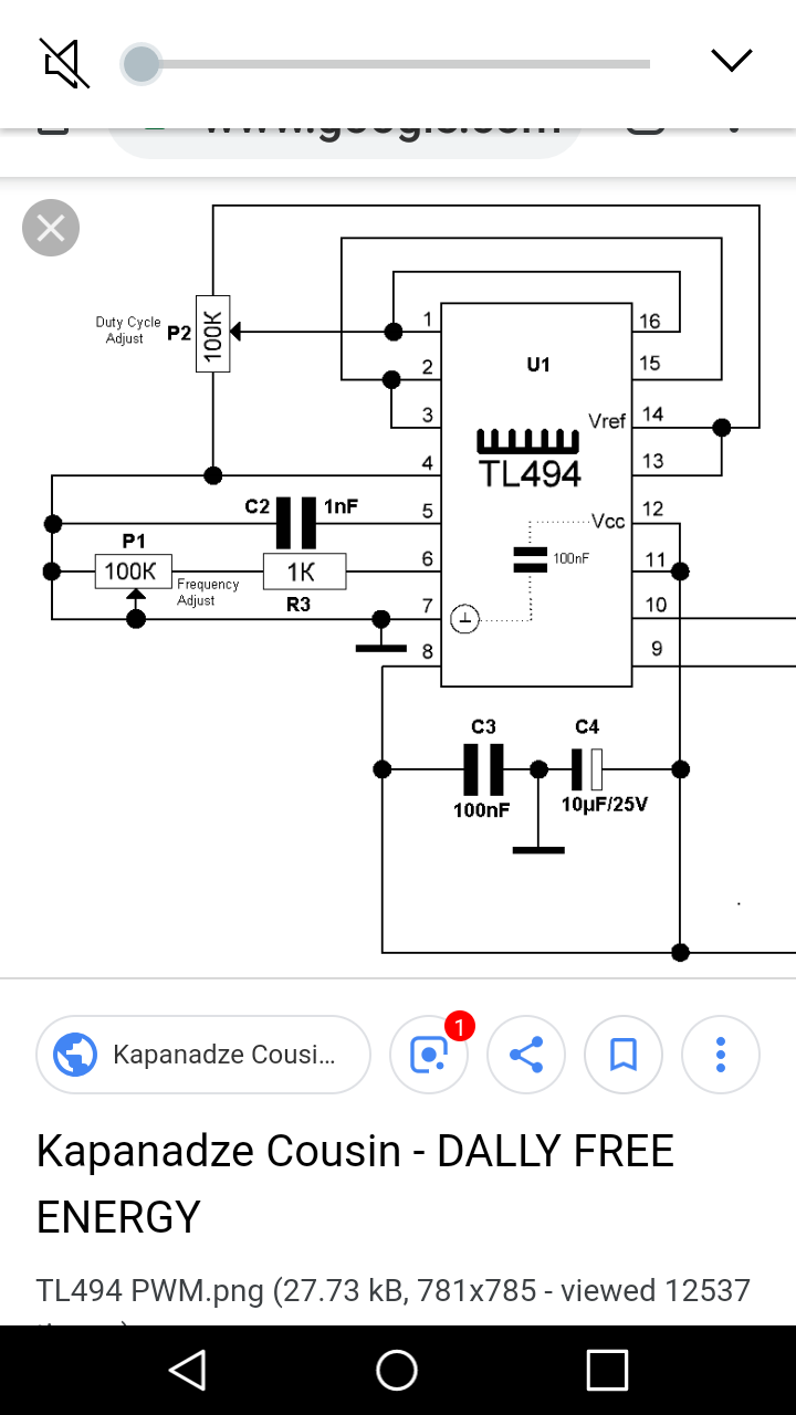

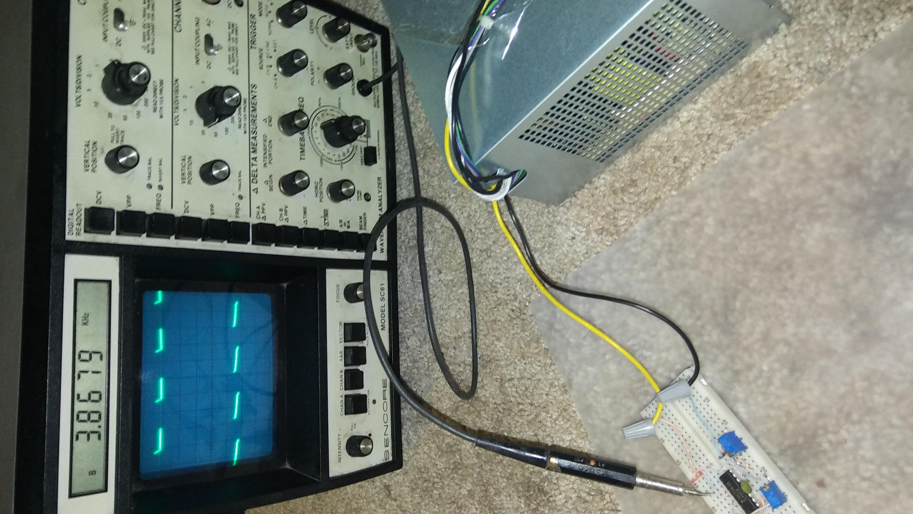

                                  Thank you.

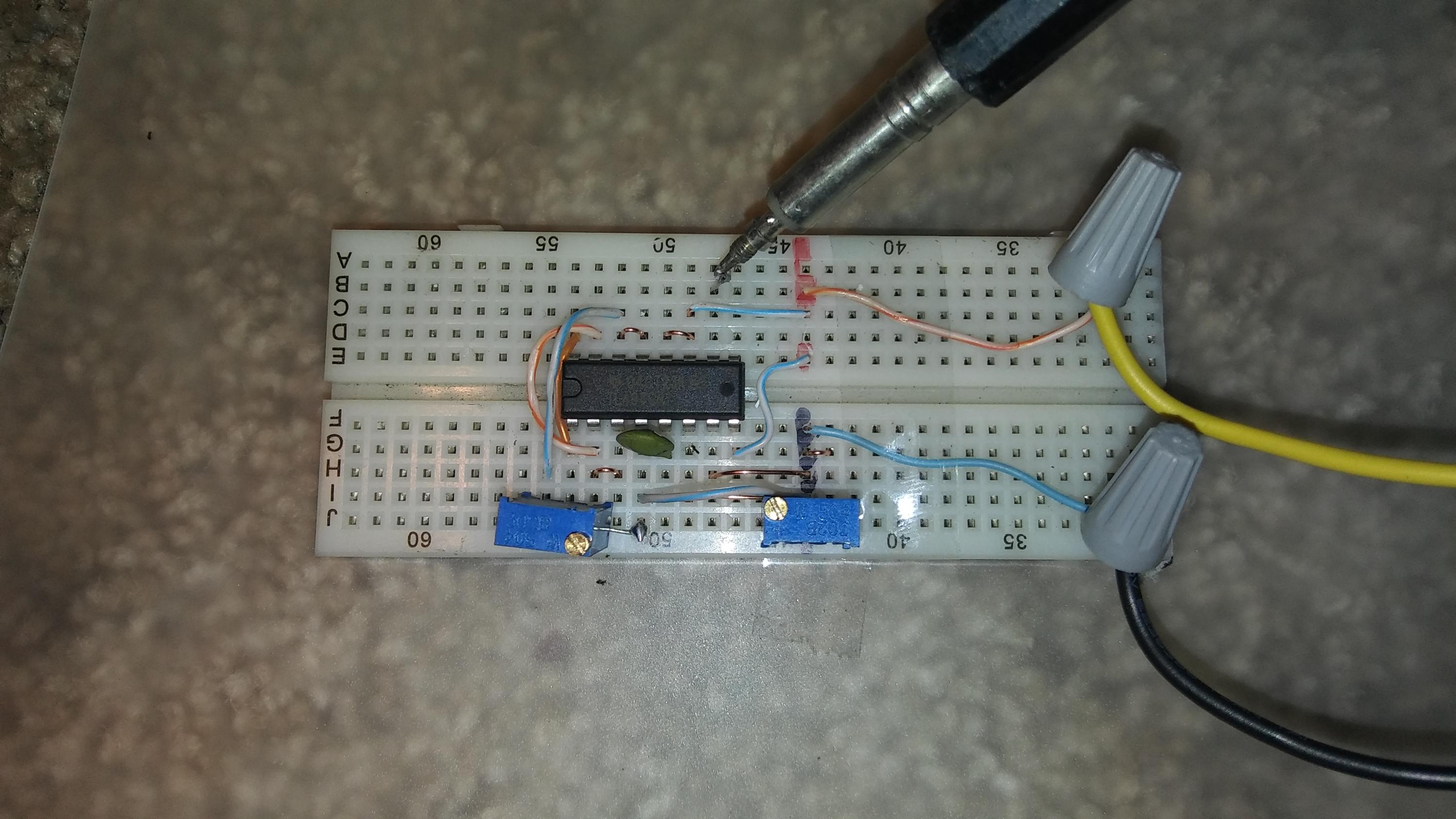

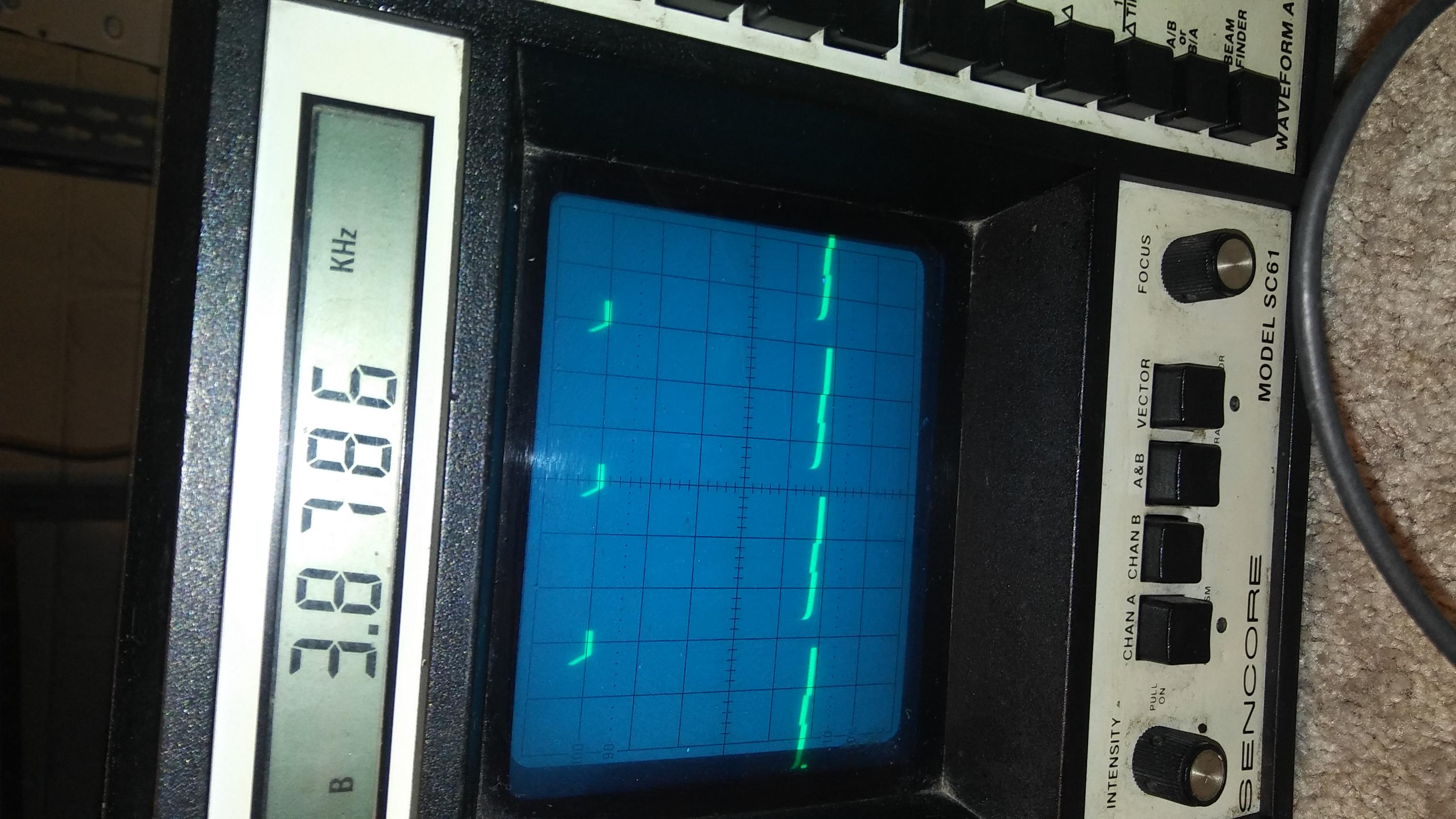

                                  I'm gonna use TL494 to built a PWM and inject a signal into OC5011. see what will happen?
                                  This PWM has two channels, Working frequency and period can be adjusted.
                                  The hard part is LED headlight PCB is too small to work on.
                                  Pic4. I adjusted the P2 duty cycle.

                                        #59
                                        PWM (Pulse Width Modulation) "chops" a DC into many "pulsed packets" or "sections". Comparable with a turn signal circuit on the car, the consumer (eg a light bulb) does not get a "full" current, but just "packages". Now, the PWM is not specifically for flashing, but for "power control". Therefore, the "flashing frequency", so the output frequency of the packet sequence is usually so high that it would not be visible, you would connect a lamp. For example, 300 hertz for solenoid valves or motors or even 20 kilohertz and more for other applications.
                                        Pulse width modulation with TL494
                                        The TL494 is a very convenient pulse width modulation IC and has been on the market for a long time. That's why he is relatively cheap. (Reichelt 43 cents). An IC with many features, and there's no reason for hobbyists to use any of the other, newer types that may be hard to come by or cost 10 to 20 times.
