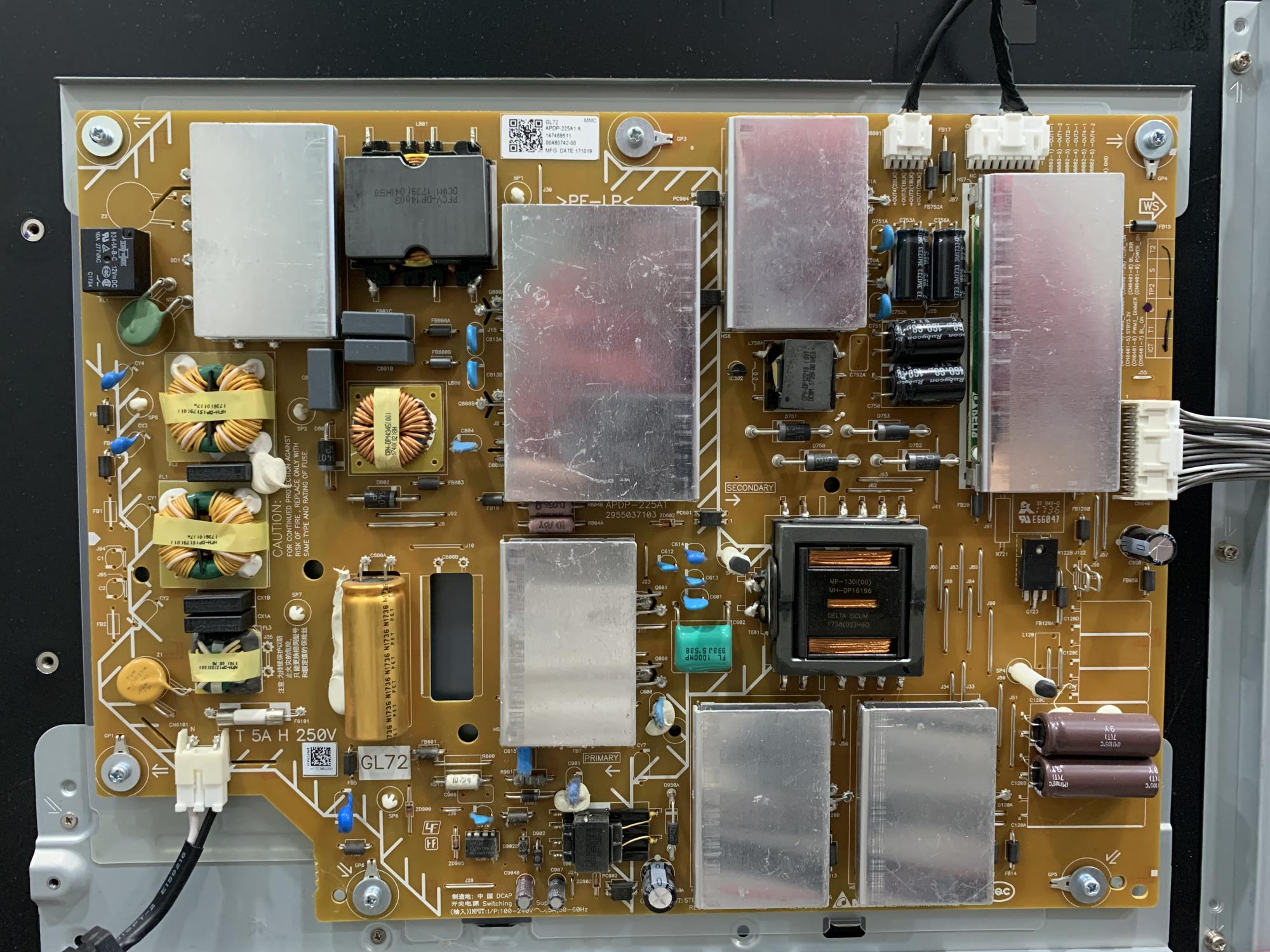

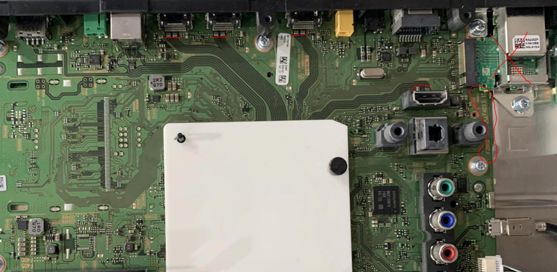

    Tv won't turn on. Not sure if there is a standby light on this TV but I'm not seeing any.
    Checked the usual diodes that go bad and all test good. When plugged in 2 show 100v and the other 2 50v when plugged in.

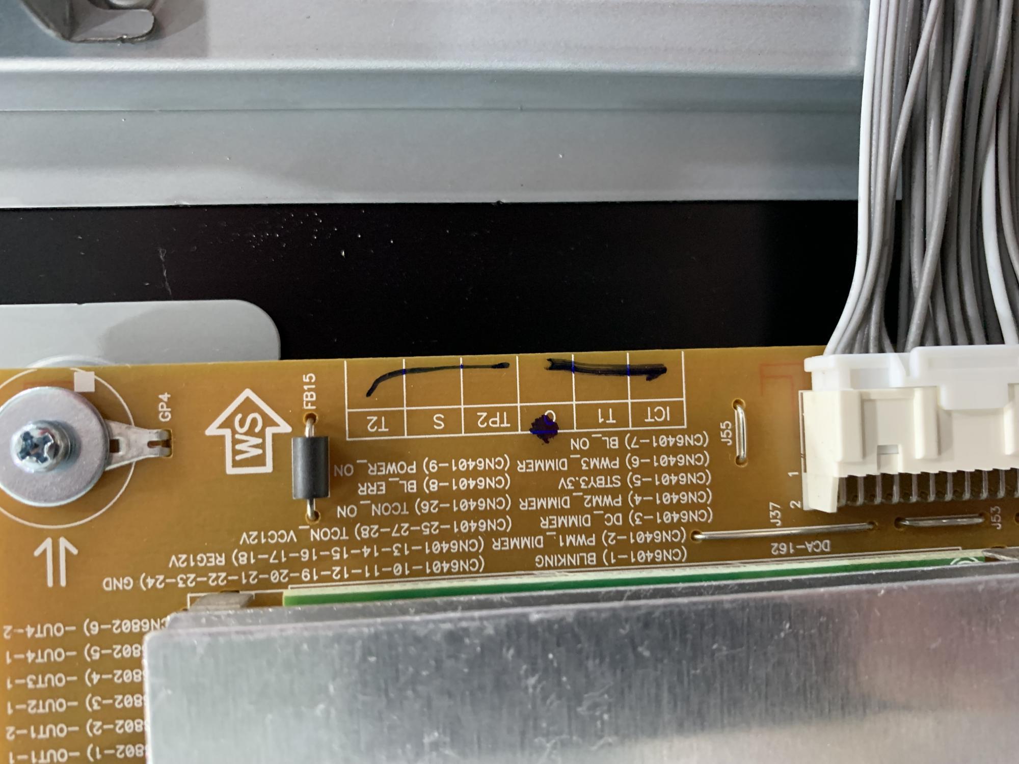

    Below is reading for CN6401
    1) 0v - blinking
    2) 0v - pwm1 dimmer
    3) 0v - DC dimmer
    4) 0v - 0wm2 dimmer
    5) 3.5v - Standby
    6) 0v - pwm3 dimmer
    7) 0v - BL On
    8) 2.6v BL Error
    9) 3.5v PWR On
    10-12,19-24) 0v - ground
    13-18) 12v all pins - 12v reg
    25) 0v - tcon vcc 12v
    27-28) .5v - tcon vcc 12v
    26) 0v - tcon on
    Also I tested backlights with my tester and all pins show 119v. So assuming they're good but not positive since I get 2.6v on bl err pin.
    I know a lot of these Sony have bad emmc also but not sure how to confirm if that's my problem.

    Check all the fuses, there are a lot of them on the board with the designation "Fxxx", there is a duty LED, turn off the Wi-Fi module, measure the resistance on the HDMI signal lines relative to ground...

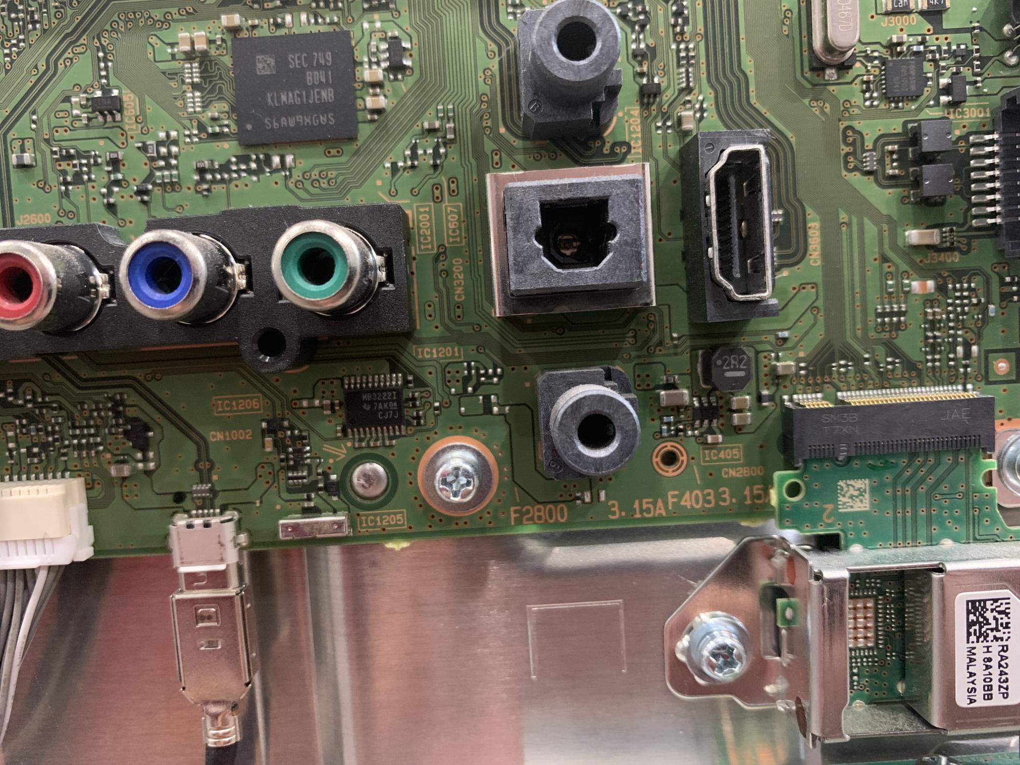

      I measured all fuses and they test good. I couldn't find the fuse labeled F2800 to measure it. They're so small and really hard to see.
      I removed the Wi-Fi card and measured resistance on HDMI and got 5-6 ohm on all 4.
      I posted a close up of the fuse I can't find. Maybe someone else will see it and point it out.

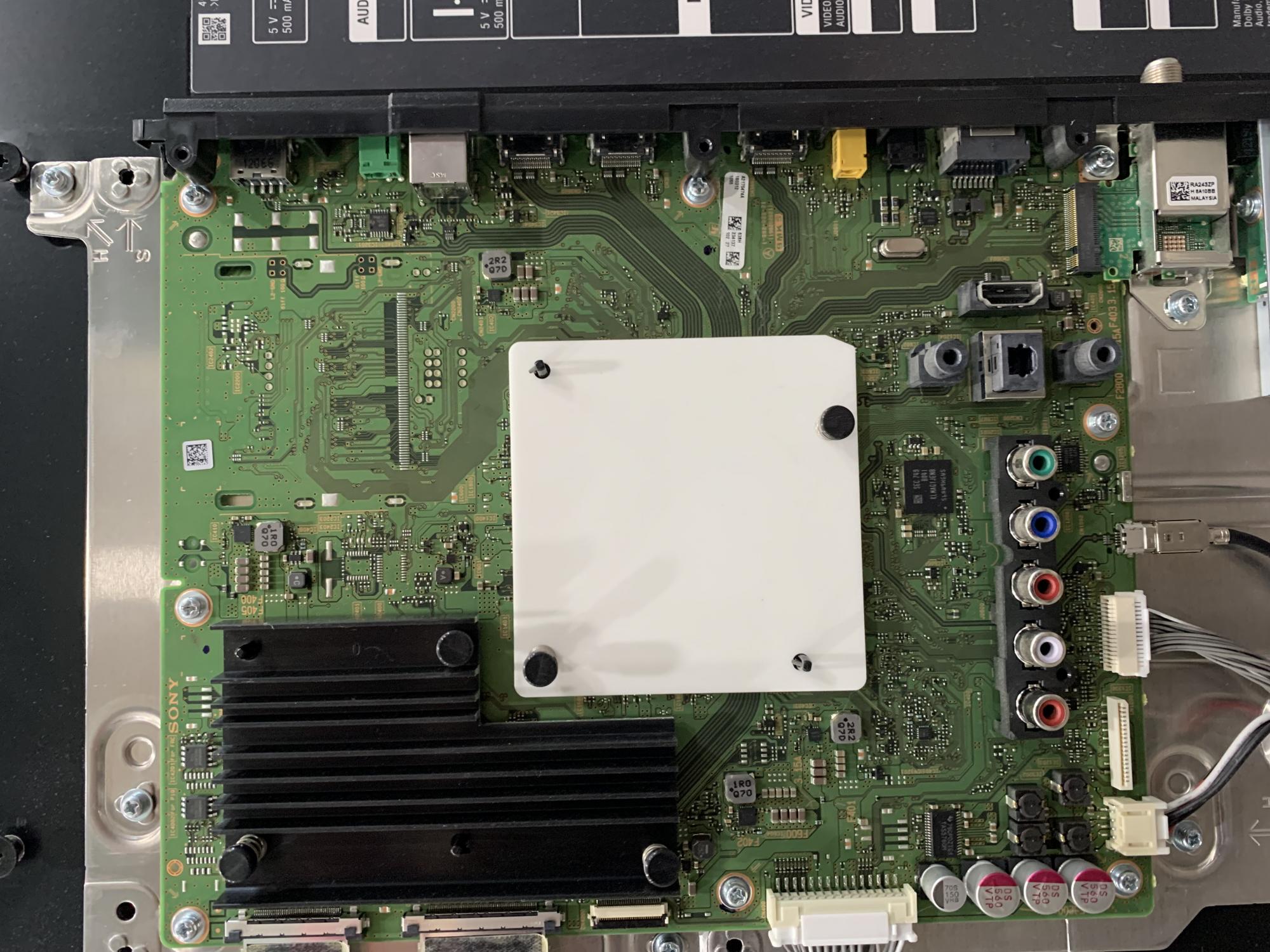

        But 5-6 Om is a short circuit, this should not be, if this is the case, then only a processor replacement or a motherboard replacement.
        • Storyteller12
          • Jun 2020
          • 625
          Re: Sony XBR-65X850E No Power
          Ok, I was leaning towards a bad mainboard but didn’t know how to confirm.
          I appreciate your help. Is there anywhere to buy processor?
          • lotas
            • Jan 2016
            • 4752
            • Russia
            Here it is better to look for the motherboard, since Sony is linking the processor and eMMC firmware by ID ...

                Prolly bad e-nand, notorious problem for sonys.

                  Just got the board back and everything works. It was the emmc that failed as usual.
