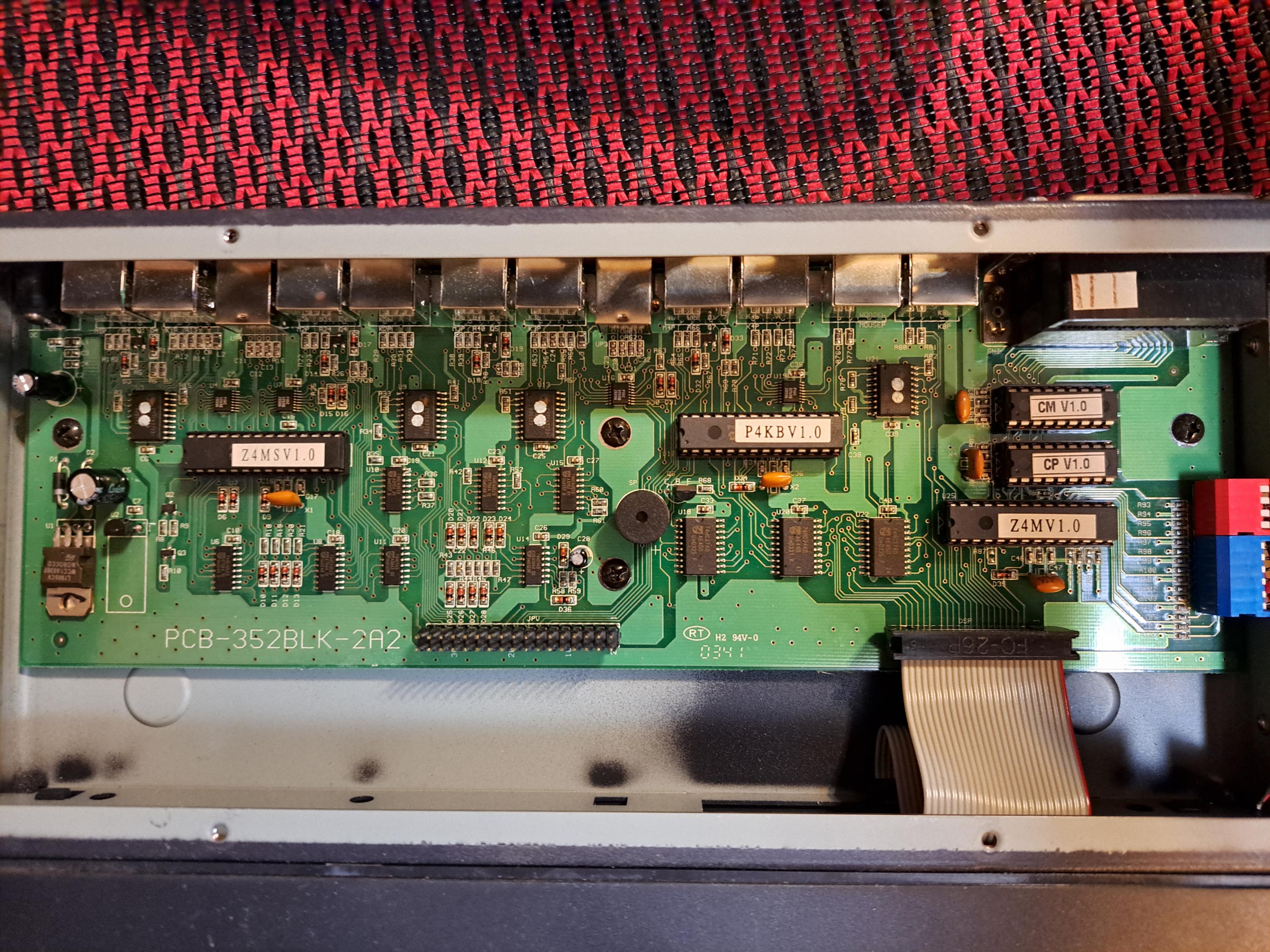

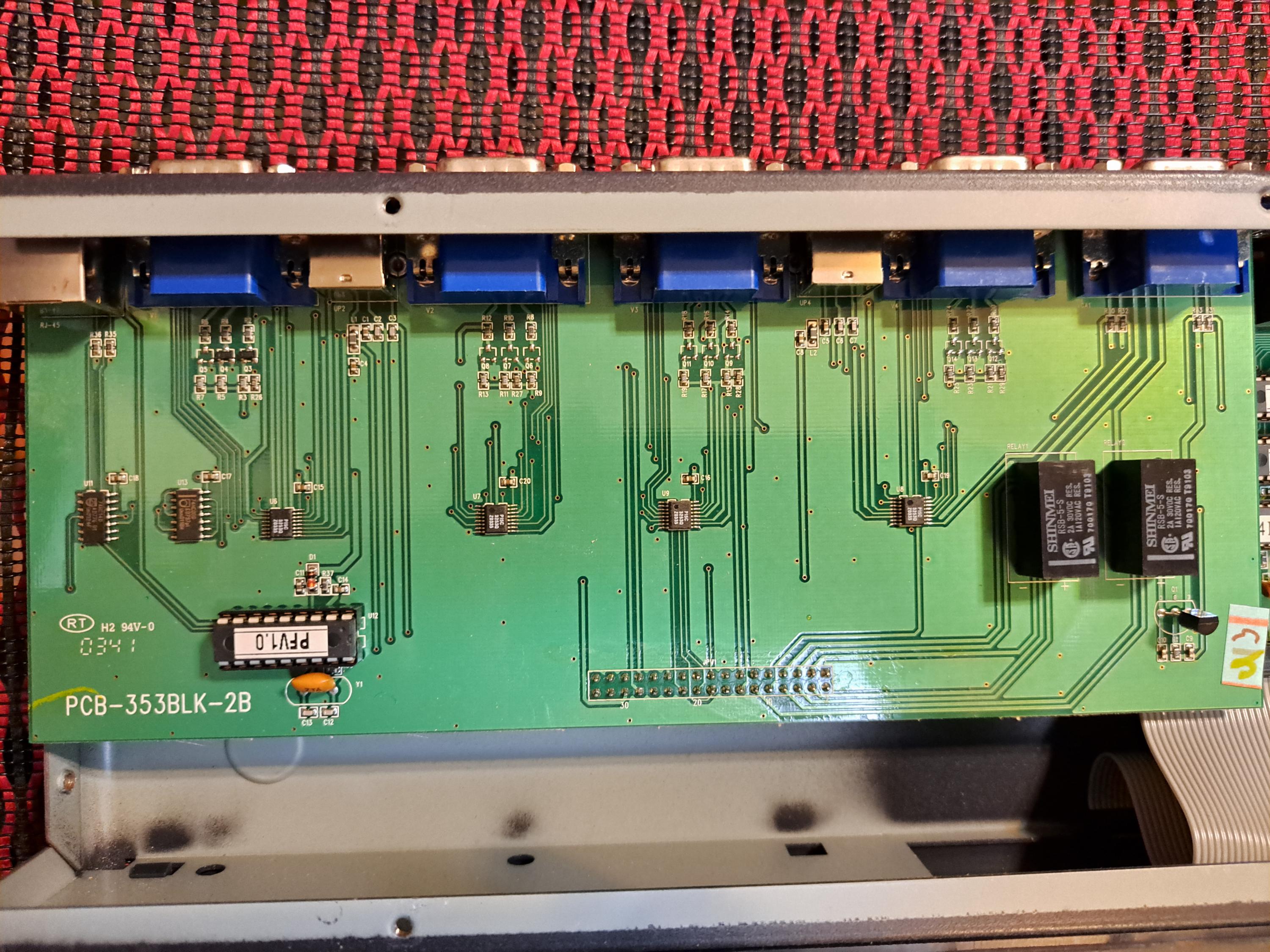

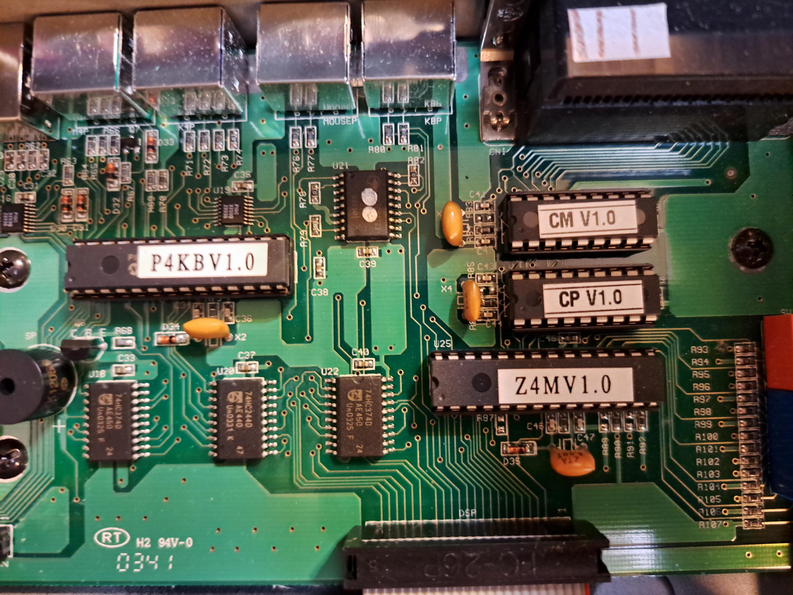

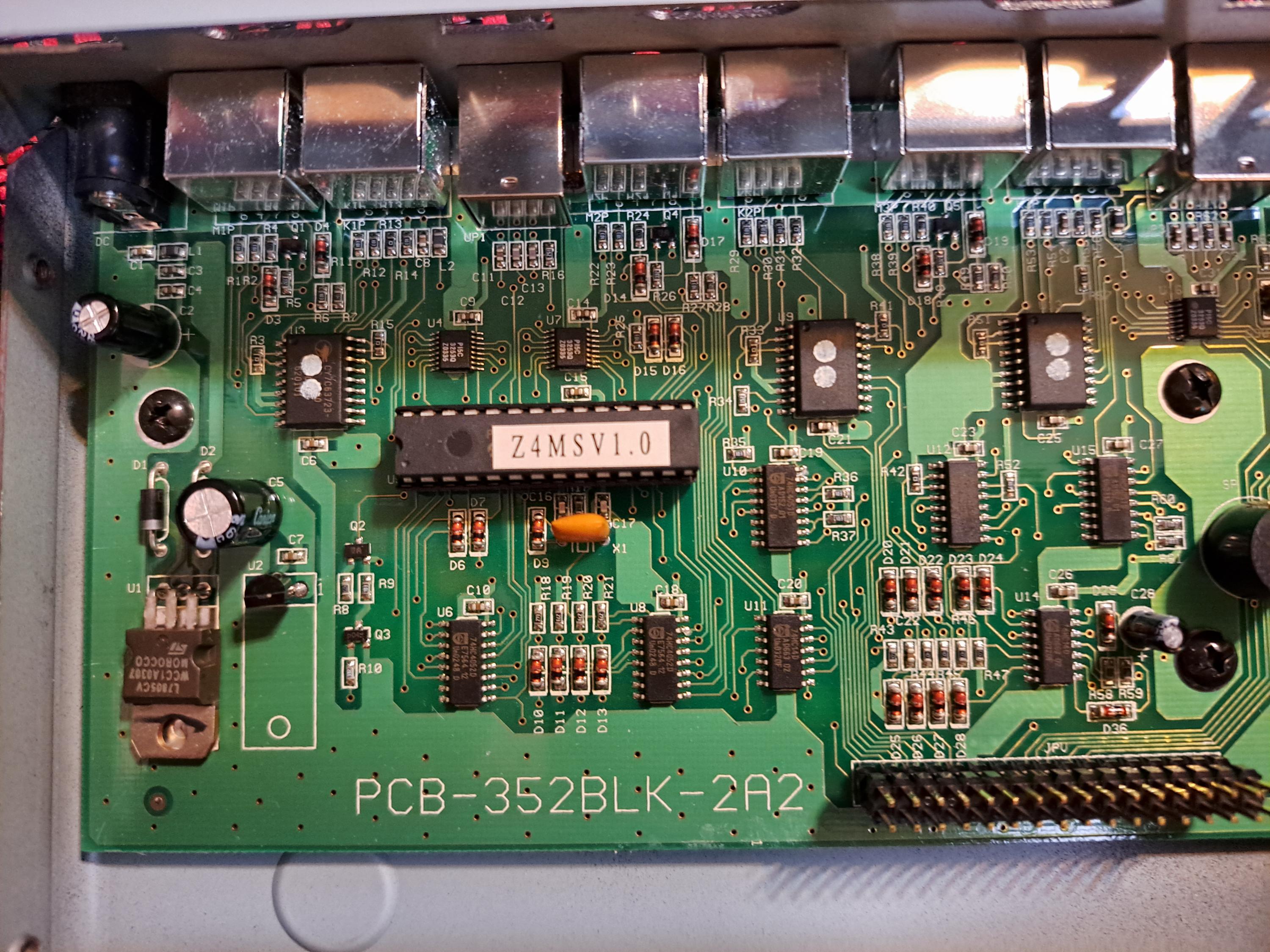

          Here are pics of the boards:

              Re: 2 Belkin KVM switches have dim VGA output
              I took a look yesterday, but couldn't think of anything much.
              For starters, perhaps check or replace the two Canicon caps near the L7805 regulator (U1). While technically linear regulators like 7805 are quite stable and don't need a whole lot of capacitance to regulate properly, Canicon are also some of the worst electrolytic capacitors IME. So try checking / replacing those first. If replacing, you don't need any low ESR caps for these, since 7805 is a linear regulator. Any 85C or 105C electrolytic should do, provided it has OK ESR.
              Apart from that, I'm not sure what else to suggest. I'm no expert either, though, so perhaps someone else may suggest what else to try.
                Corrosion inside the VGA a port? That 7805 regulator… is it getting hot? Check the output voltage on it with with all the jazz hooked up to the KVM.
                If there is no amplifier inside the KVM, just multiple splitters. That analog signal is let’s say getting spit once, the loss is 3db loss per split. Now using an 8 port just with splitters… no wonder the VGA signal is dim. 3db’s cuts your power in half.
                However I am not sure if these KVM’s have a vga signal booster built in. If they do, maybe there is at least one that’s effed up.
