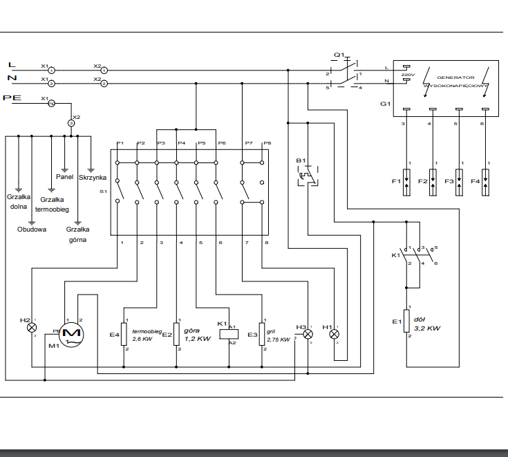

    i have one of these:
    https://allegro.pl/oferta/generator-...ska-7247049917
    does anybody know how you wire a 230v ignitor, or have a cooker schematic??
  • capwizard
    • Jun 2016
    • 1991
    Re: gas cooker ignition
    Originally posted by stj
    i have one of these w10t-4a
    here you're it is for 4 burner gas cooker
    Spark Generator Replacement Kit - RH Peterson
    https://cdn.badcaps-static.com/pdfs/...e274a1f901.pdf
    F1, F2, F3, F4 – Elektrody zapalające (Incinerating electrodes to 4 burner gas ignitors )
    Generator wysokonapięciowy ----- high voltage Generator
    4 palnikowe szt.1 ------------------4 burner pcs.1
      • 31087
      nice.
      what's confusing is the meter readings - it must have capacitors or something inside with the windings.
      also where is the HV return???
      i see the primary,
      and 4 seconary's for the electrodes but no ground??
      • eccerr0r
        Solder Sloth
        • Nov 2012
        • 8701
        Probably returning to GND... so does the igniter light all units at the same time regardless if it's needed or not? I guess it should be fine, cars do it all the time...

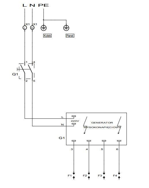

        • capwizard
          • Jun 2016
          • 1991
          ....the igniter light all units at the same time ......
          you're right. as same as gas BBQ grills.
          i think they are build-ed inside ignitor.
          DOKUMENTACJA TECHNICZNO-RUCHOWA LINIA 900 KUCHNIE GAZOWE

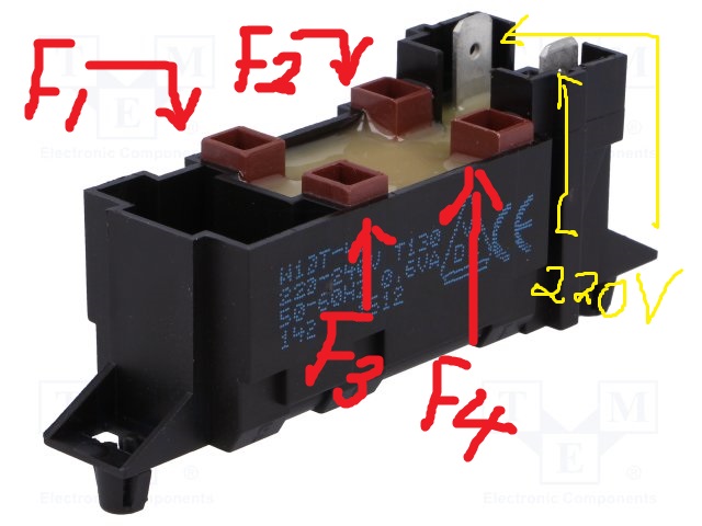

              • 31087
              i tried to get the resistance of the windings, they look open.
              but they arent - it's a new module!!
              reason for the questions is i want to re/mis-use it.

                    • 31087
                    it does not explain where the HV return is.
                    i see in a cooker it sparks to mains earth, but the module has no connection to it.
                    • capwizard
                      • Jun 2016
                      • 1991
                      sti: .... no resistance of the windings.....
                      no resistance of the windings is because transformer uses floating earth ground for safety reasons. when you have 2.4kv...anywhere can be ground....
                      it is an electrical resonant transformer circuit....a miniature Tesla coil or high voltage spark transformer.
                      you can use variac change 1/10 AC input voltage to ac 22v , make output voltage to 300v then add a diode and caps, now you have DC 320v for TV LED tester. or use for High voltage electronic fence. i think it has too much current for electrostimulation...I do not recommend.
                      eccerr0r.....a high voltage diode.....
                      i bet you inside this module just one Tesla coil no diode....and no HV cap.

                          • 31087
                          i had a thought,
                          maybe the secondary output and return are the first 2 connections and they arc to each other via the cooker body.
                          that's gonna complicate shit - i only want one spark - have to build a "safe" spark gap for the other pin.
                          • eccerr0r
                            Solder Sloth
                            • Nov 2012
                            • 8701
                            I also wonder what it will do with open outputs, or do they need to be insulated off...
                            Dang, what are you trying to "misuse" this in?
                              • 31087
                              i have it worked out now.
                              each pair of outputs is a secondary.
                              if you use both then it arc's via the cooker, but if you only use one then you ground the other end.
                              so the 4 output model actually has 2 secondary output coils.
                              to answer the last question, i'm trying to repair a Miele industrial cloths dryer with a 400€ ignitor failed in it!!
                              i'm not paying fucking 400€ when a brand new polish 4way ignitor costs under 3€ !!!!
