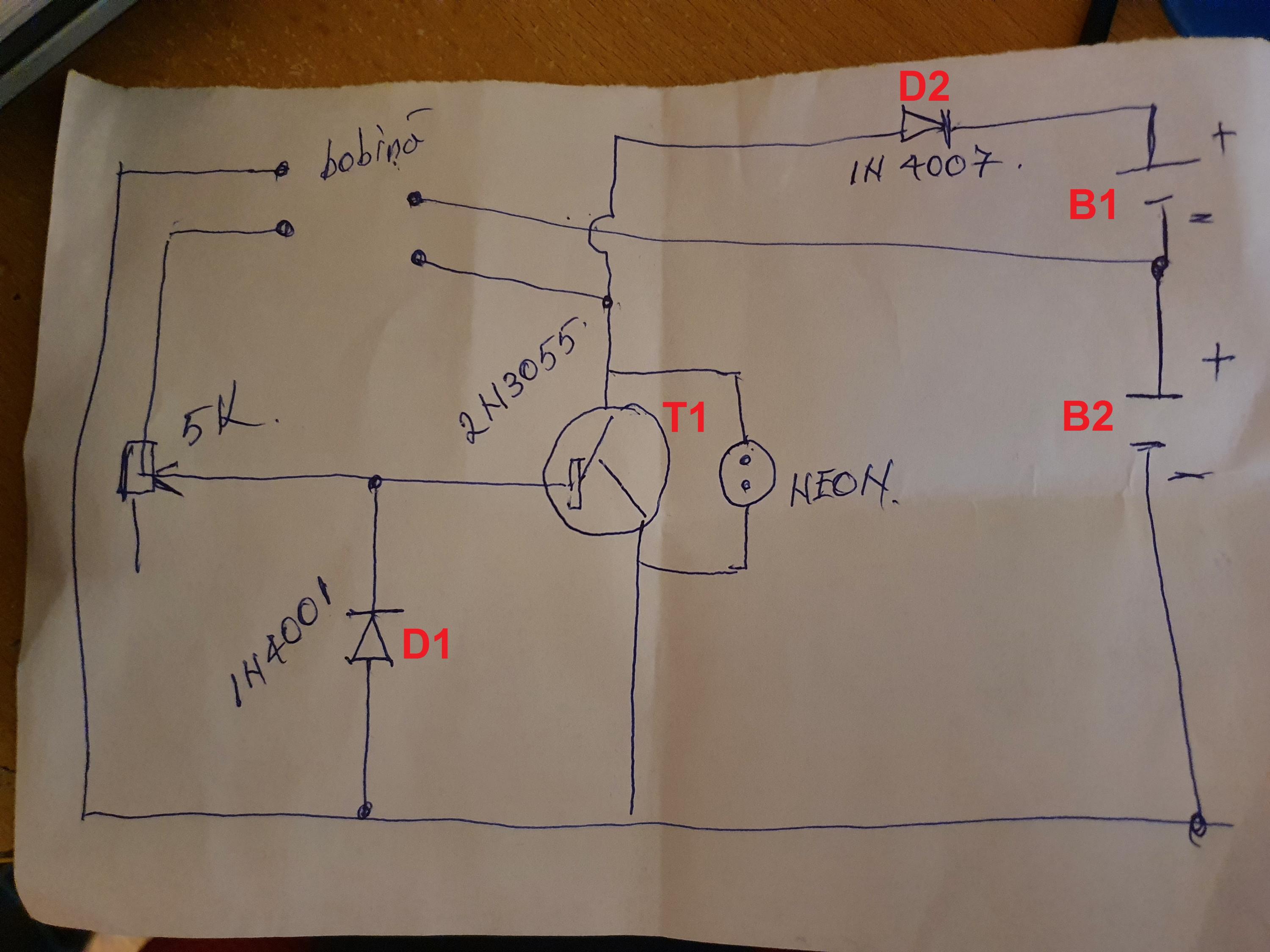

    Good day folks. A former colleague of mine recommended me to a relative of his and I got to speak to this man today in person. He's a bit of a mad scientist/tinkerer sort-of guy - just my kind of weirdo Apparently this chap builds all sorts of generators and wind turbines in his little shop at home and sells them here and there. He even showed me some footage of some of his inventions in action out in the field. However, as he himself very kindly put it, he's not good with electronics - he just designs and builds the generators (from scratch, I might add) and turns to others for the electronic side. He doesn't have a regular guy for this task, which can be a red flag that people don't like working with him, despite him being very kind. There's only one way to find out and that is to give this guy a shot and humor him....for a while at least.
    Have a look at these two schematics he asked me to build for a small-scale turbine. Right away, although I have close to zilch experience with gennies of any kind, these look like nothing I would stick on the output of a generator. Apparently, someone else drew them for him, who in turn got them from....somewhere. Maybe I'm a noob and they're actually some really standard setups that just don't click with me, or maybe they're just complete baloney that would never work for this, or just go pop within seconds....
    There are WAY too many questions that need answering here, starting with the generator itself: he claims he can build any generator, in any shape and size, with any number of coils...which he showed me on his phone - told you the guy's nuts In the larger schematic, the outputs from the coils (2 coils in this case) are those 4 dots in the upper-left (that's the Romanian word for "coils" BTW ). Trouble is I'm not sure how the pairs are supposed to be arranged: is one coil the upper two dots and the other coil the bottom two, or are they the left/right ones instead ??? What sort of output are we expecting from them ??? Number of turns ??? Wire gauge ??? Poles, magnets ??? Not a single capacitor in this schematic. Neon lamp across the E-C junction of the 3055, why ??? It's been a while since I had to reverse-engineer something, so although this seems simple on paper, there are many things I don't get - not to be rude, but it's almost like someone threw random components together. The bar is set too high for this thing I can't see how it's expected to rectify the AC those coils SUPPOSEDLY spit out, regulate it and then stuff it into the batteries. The only thing that I CAN kinda see is D2 blocking B1 from attempting to turn the generator. The whole thing looks like it's trying to be some sort of regulator....which it isn't because there's no reference voltage set anywhere (zener anyone ???) and no series-pass element...unless one coil acts to limit the speed of the rotor and that's your regulation.... That 5K.....pot (?) is another thing that seems unfinished. No, it's not an error - the chap says that's how the other guy drew the schematic. Might as well be a fixed 5k there then.
    How I would do it, even with 0 knowledge, is stick a rectifier on the output (3 phase if necessary) smooth it out and feed it into a DC-DC converter - MUCH more efficient and LIKELY to work, at least at small scale....
    Is there even any point in building this ???

    The circuit is a "2N3055 joule thief" which is very common in the "free energy" crowd. Basically, just a primitive one transistor boost-converter.
    To sell a fake generator, it's common to show more volts out than in = aliens, unicorns, magic - helping generate more.
    When you actually measure power in and power out, usually one battery is being drained while the other appears to be charging. It seems to fool the mind.
    The neon acts like a gas-discharge tube and protects the transistor from over voltage if a battery is disconnected when it's running. These are really low tech, low efficiency and not worth building.
    Instead, why isn't the generator outputting more voltage? Add turns of wire or speed and get the voltage you want in the first place lol.

      Ok, at least now I know what it is I guess it is not commonplace in the field of high-power wind turbines, since I see most projects involving friggin' AA batteries I'm not sure how it would get hooked up to the guy's generator though...
      Let's instead focus on how to ACTUALLY design a wind turbine and what the electronics that come after the genie should look like - I'm talking mostly OTS stuff. I'm fully aware that we're not about to compete with the factory-built stuff that already exists on the market, but at least for home use, mostly for fun and for learning stuff....

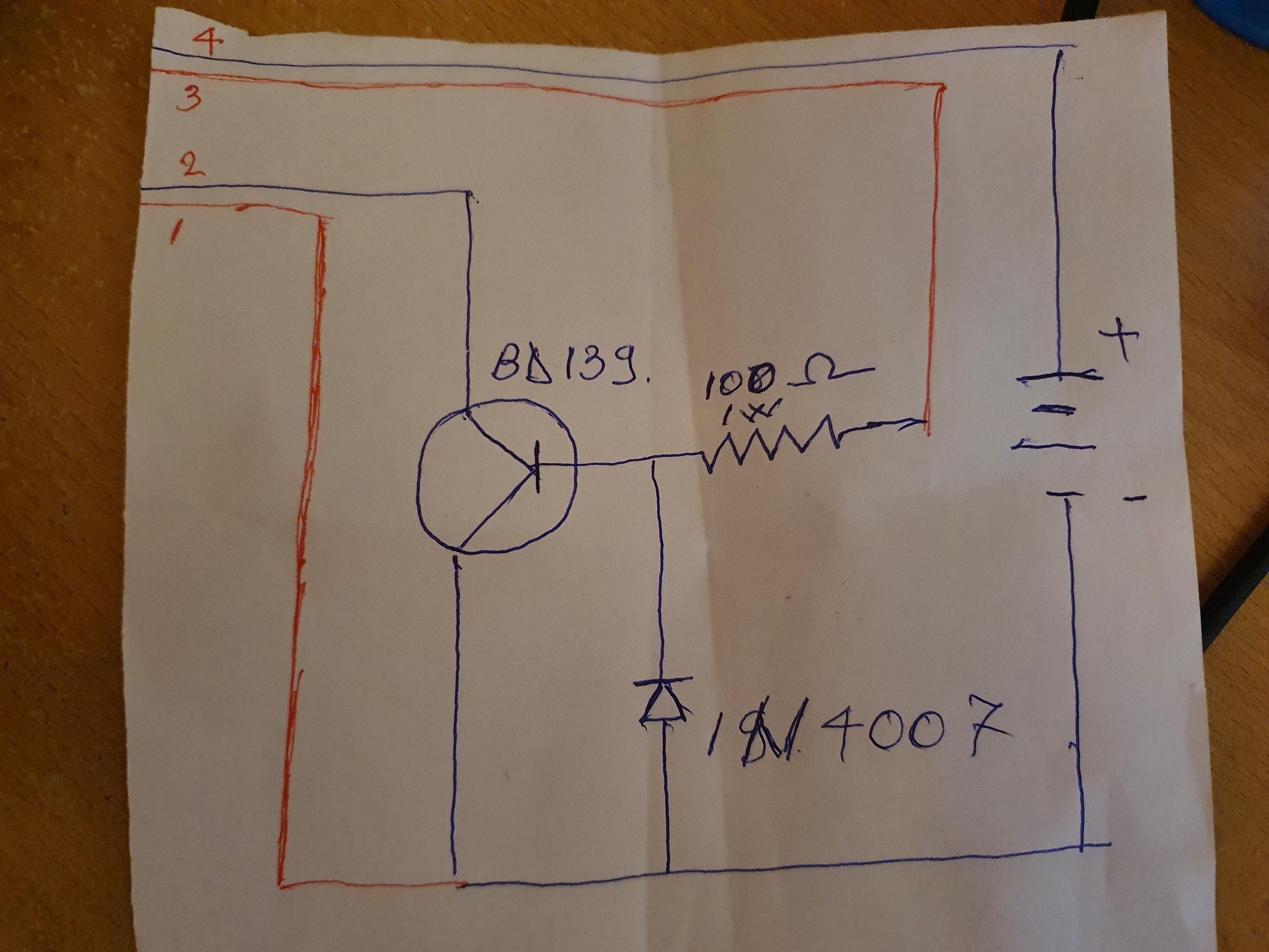

                                      I ended up putting together the smaller circuit with the BD139 after all, just by soldering the components to one another because I couldn't get the guy out of my hair I'm actually kinda curious to see what happens once he hooks this up to whatever coils he put together at complete random, with no specs and no measurements like inductance and the likes. I'm no expert either when it comes to this advanced a topic, but I know for sure there's more to it than that. If I had to take an educated guess, I'd say the battery will immediately kill the transistor (assuming it's a 12v SLA he attempts to use), because once the C-E junction starts to conduct, that battery is capable of pushing WAY more than the 3A the BD139 is rated for, since it will just pass through coil 1-4 like a dead short, with only minimal resistance from the wire. The wire itself may melt and split at that point anyway...

                                        Need more details of how the electromechanical parts are made, what are the rotor windings, stator windingsl is he using magnets or electromagnets to generate the field, what commutator is being used, etc., etc. - without those details it's hard to tell what needs to be connected to what, and what kind of voltage output is to be expected?
                                        There is no standard, using a DC PM motor in reverse as a generator requires significantly different circuitry than using an alternator from a car to generate electricity...
