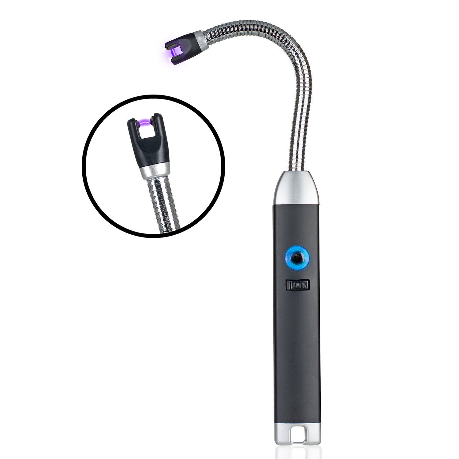

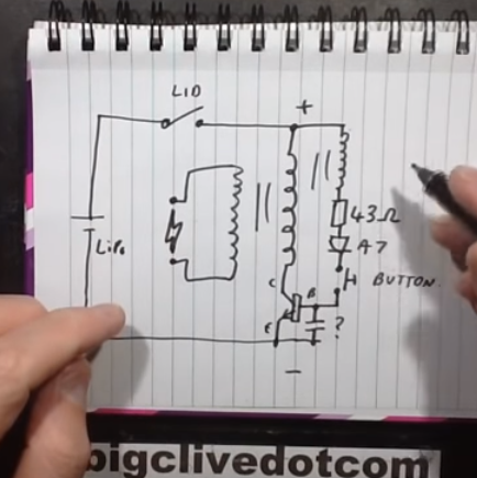

      I hope this will be helpful for you? Long neck 360° Flexible Neck Plasma Beam Lighter. see picture 1
      Disassembly and schematic of an arc lighter.
      https://www.youtube.com/watch?v=4aK1GK1KBGc
      circuits inside the plasma lighter are as same as bug zapper! can be modify to a pocket TV LED tester.
