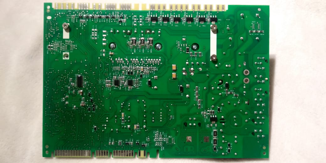

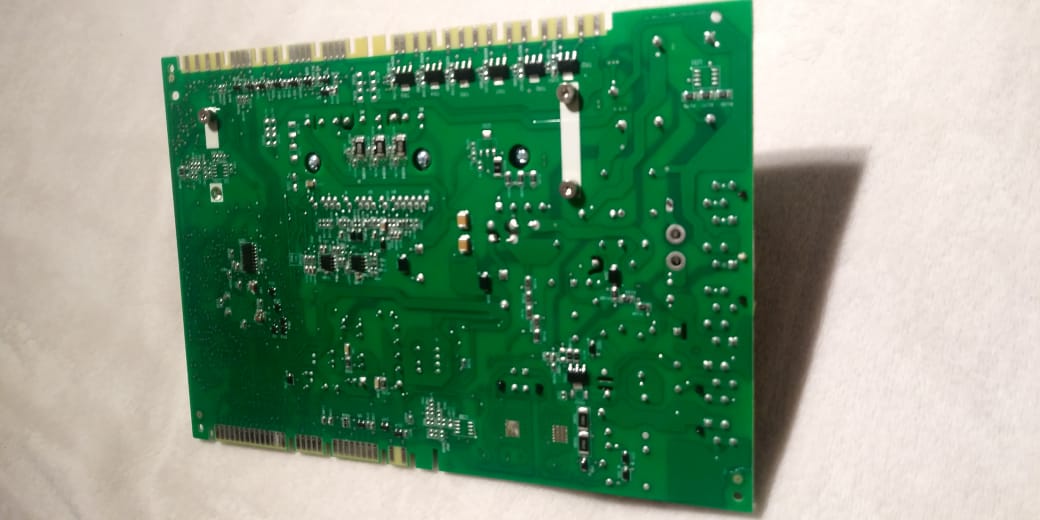

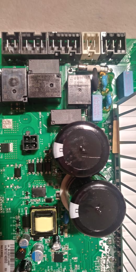

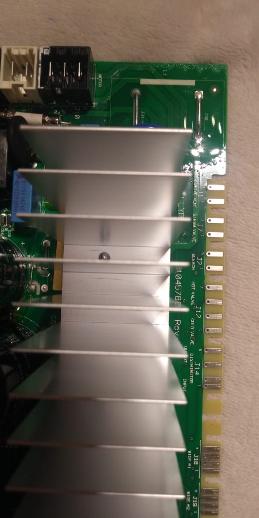

    Hi guys, I need a bit of help to resolve an issue with a washer.
    A friend likes bringing all his equipment from the US (Argentina based). He has a Whirlpool washer (model WFW97HEXL0) that has about 7-8 years of daily use so it is about to die in the near future.
    So he brought a new one (model WFW92HEFU0). He plugged it in to his big 220-110V transformer (same used for the other washer), and it was dead. No buttons on the from panel responded at all.
    He reported it DOA, then arranged to have a new one shipped out, this time he received model WFW92HEFC0, to find out it was also dead!!
    All it does is turn the drum lights on when opening the door. But the buttons do not respond at all, just like the other washer. Nothing lights on the control panel. We double checked that there are no loose connections to the front panel or anywhere, so this must be something else...
    Washer's label states 12A, 120V, 60Hz.
    We have 50Hz here, could it be some sort of protection on the new models that prevent them to turn on when on 50Hz? The old model always worked on 50Hz... and still does, but it makes a lot of noise...
    Any help will be more than appreciated!!
    Attached pictures of the mainboard.

    That could be the problem, It could be that the board looks at the a/c line frequency to calculate wash times etc.

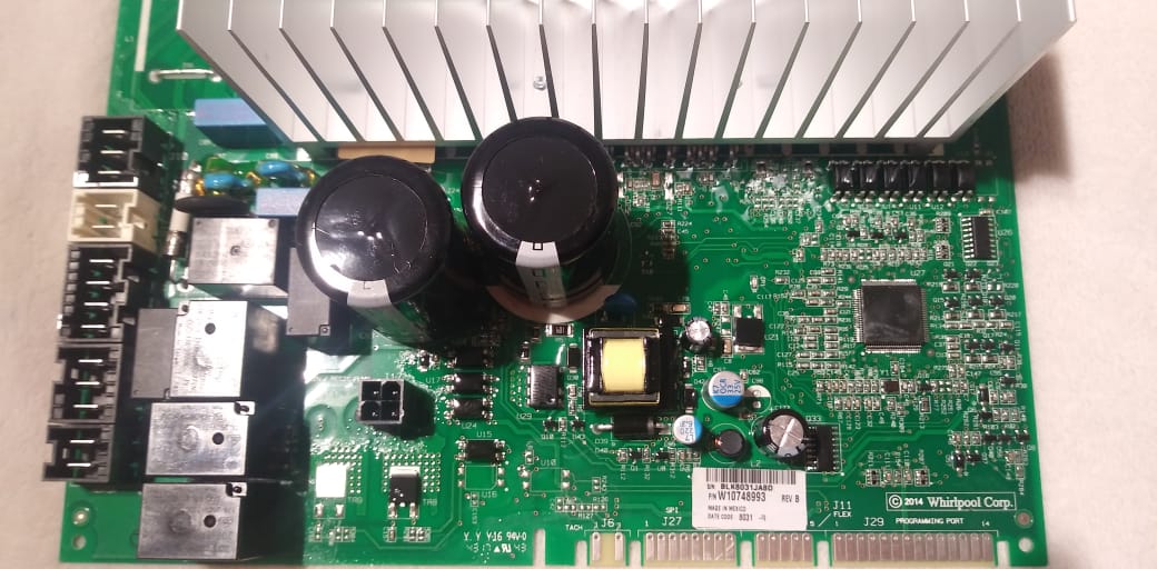

          Awful big heatsink for a "conventional" washer! Wanna bet it's got a VFD?

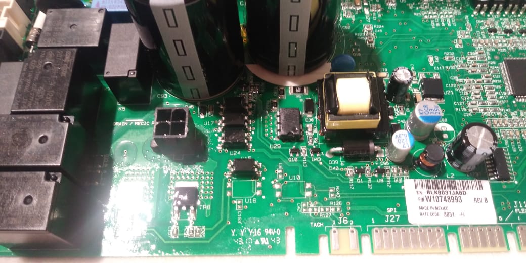

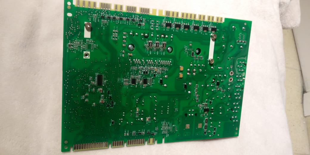

                      what's the crystal frequency on the microcontroller??
                      if they are fucking around, it may be configured by a jumper - but your pics are too low-res to zoom into.

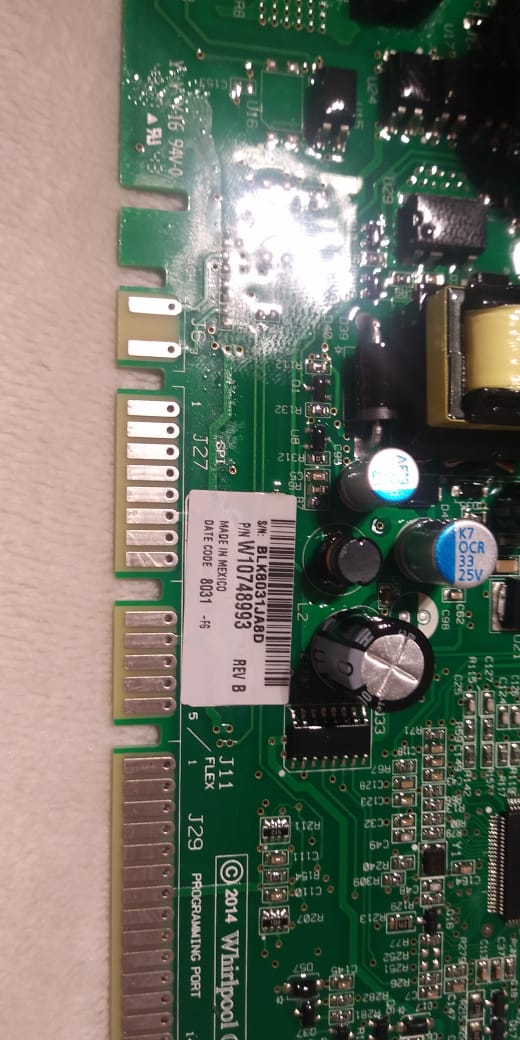

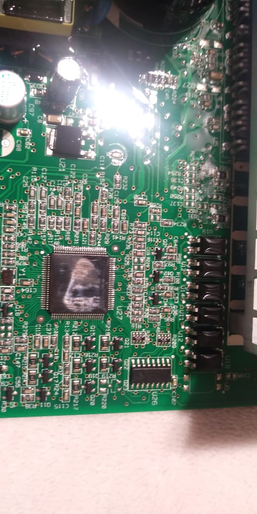

                        ...I don't even know which µC is, the whole board seems to have been bathed in epoxy, and the component codes can not be read
                        I also wonder if Whirlpool enables code protection or not on their micros...

                          You don't need a 5KVA genset -- as long as you don't engage the drum motor/water pump! Instead, you need just enough power to convince the electronic that it is attached to 60Hz mains; THEN see if there are any different reactions from the display/controls.

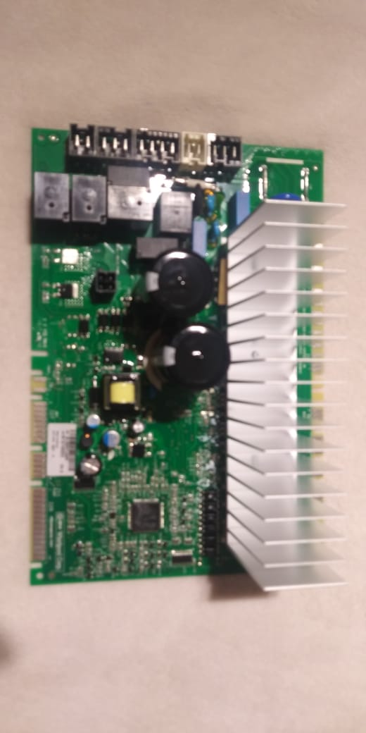

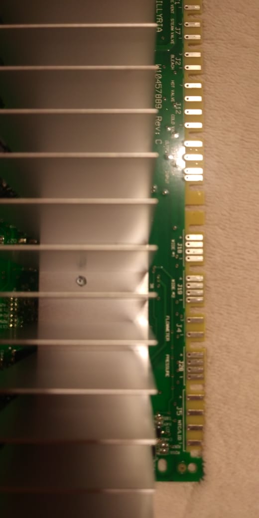

                            I'm uploading some more pics, all I have for now, sorry for the shitty res, will try to make better.

                                    pictures are terrible - what the hell did you use??

                                      Use "his big 220-110V transformer". With no motor load, there's no practical difference between running 50Hz through that vs. 60Hz.
                                      I suspect there's a VFD in there and they exploited knowledge of the line frequency in its design to cut down on filter caps. The software that does the riming (of the VFD switches) might not know how to handle a shorter mains "period".
                                      [You don't know what assumptions were made in the design so you can only start by trying to mimic the INTENDED application environment, then incrementally see what works/doesn't work.]
