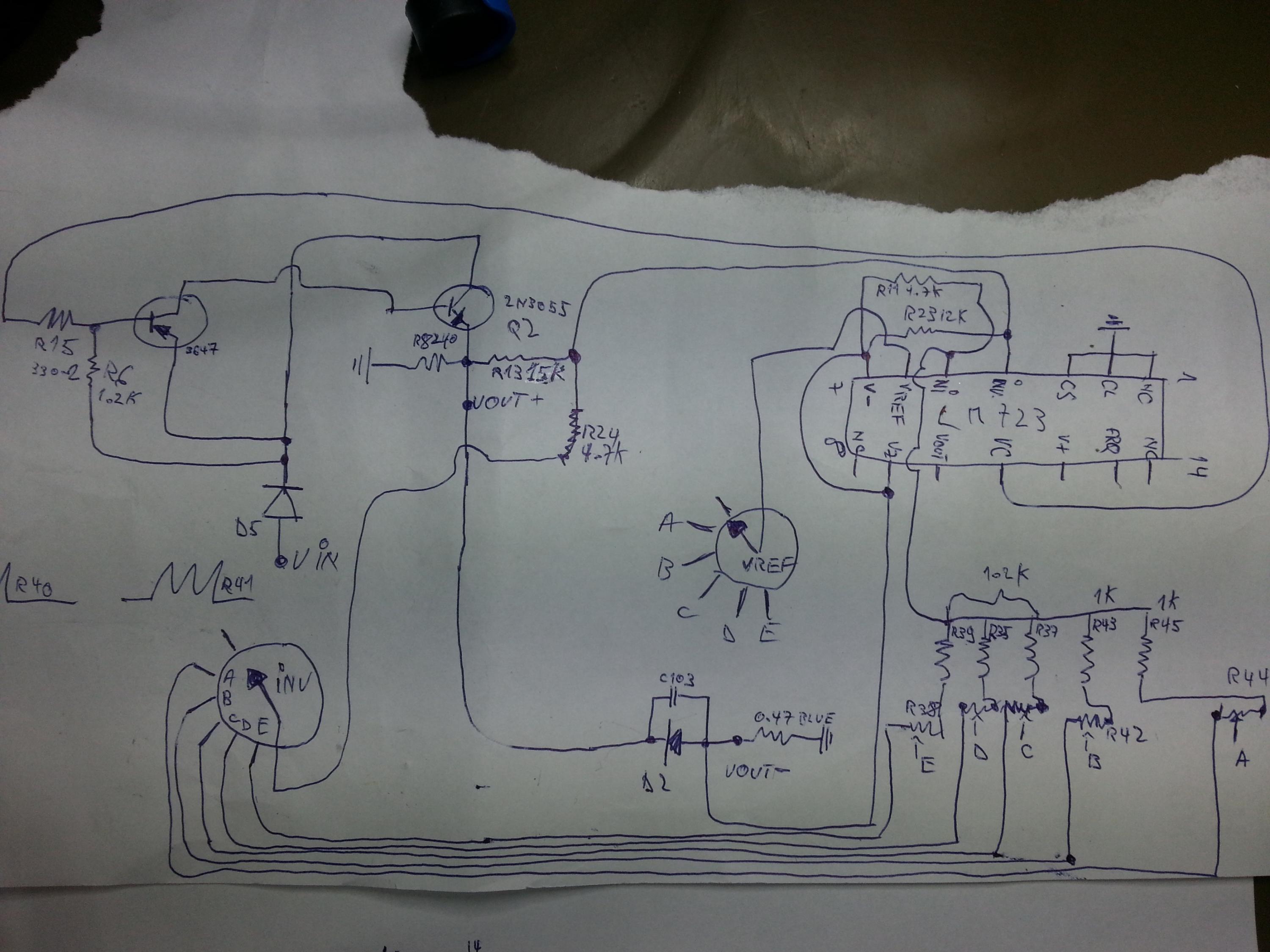

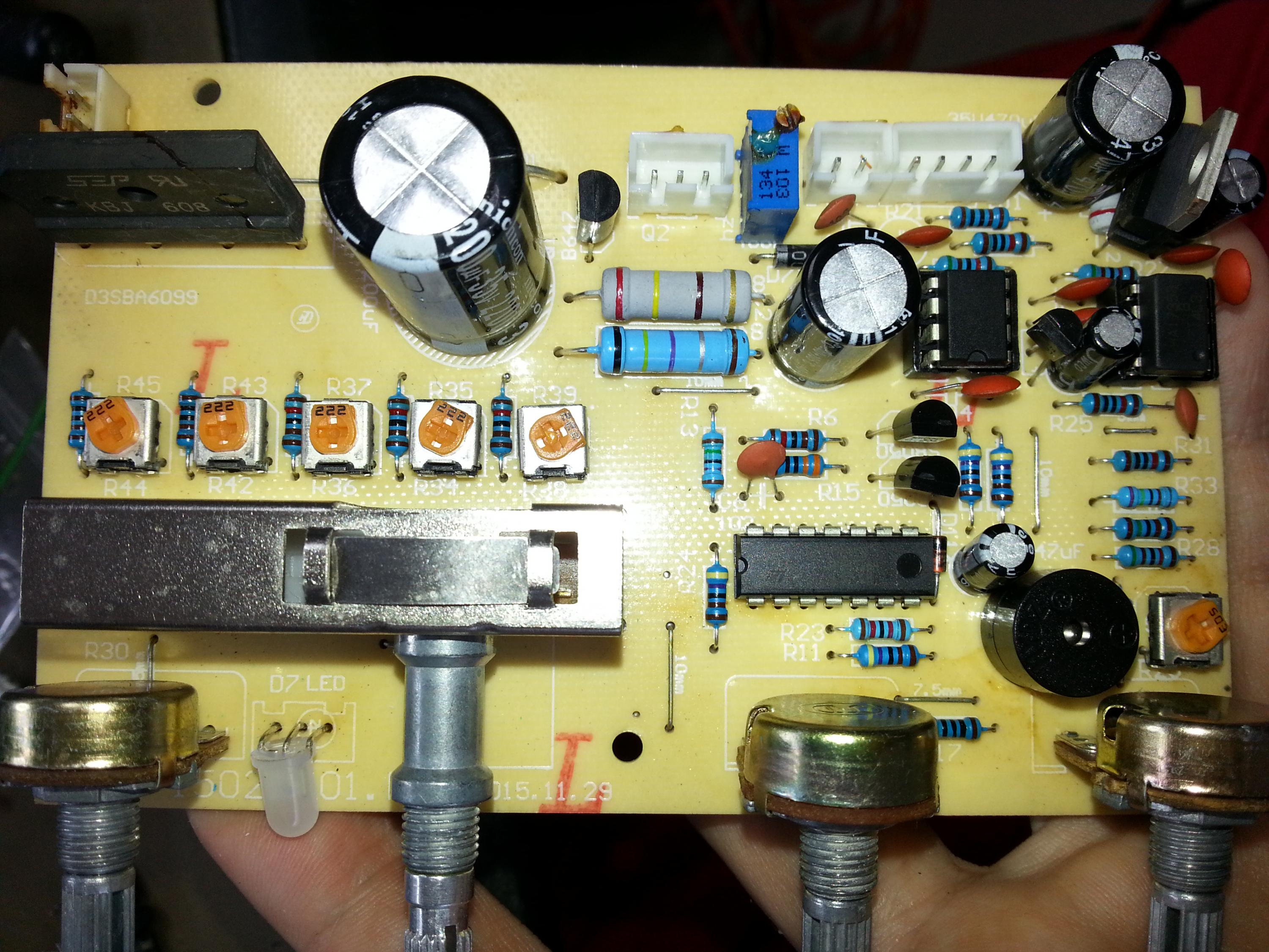

    Good day folks. I've had this cheap and nasty adjustable power supply in the shop for about a year now. It's called "Bakku" (obviously a take on Hakko), though it's not the least bit important, because I've seen this exact same product under many different names and appearances.
    Anyway...less than 2 days ago, this thing dies on me: my colleague tried charging some laptop cells on it but forgot about them and left them connected for more than an hour. The little transformer inside got extremely hot and the primary shorted out, blowing the fuse and rendering the whole thing useless. I took it apart and tried replacing the transformer with a laptop power supply at 24v DC which matched the original voltage of the transformer. It worked to a degree, the voltage adjusted up and down and I was ready to leave it like this, except when I tried charging the laptop cells again, I had to increase the voltage A LOT before the current started going up and when it finally did so, it jumped to around 2a, then something died again and everything dropped to 0. Now I can't figure out what went wrong and why it failed, since it's never failed under heavy loads with its original transformer. The voltage now stays at 0v all the time, so I suspect the output transistor died, despite not showing any shorts. The thing is based on an LM723 although I can't fully understand how it operates in this case. The output transistor is a 2n3055 fed by a B647 PNP. Although I get 22v out of the collector of the B647 and into the base of 2n3055, I get nothing on the ouput (the emitter) of 2n3055....I started drawing the schematic of the thing (though it's far from complete and doesn't include the current sensing side) and I kinda get how it's SUPPOSED to work, although I don't understand why the B647 transistor is not driven by pin 10 Vout, but is instead connected to pin 11 Vc of the LM327...how does such a thing work ? Actually pin 10 is floating :| Let me know if you need any clarifications on the schematic - it's rather messy and not to scale. Don't worry about those breakout connectors - they go to the voltmeter and ammeter on the front panel, which do come on, so I don't think there are any issues there.
    Trying to fix it first and then perhaps increase its current capacity a bit by employing a larger transformer, as that's its main limitation at the moment - the build itself seems stable enough.
    Wattevah...

    your 3055 could be open-circuit.
    i'v never seen a 723 fail - and worked with hundreds of them - i still have several tubes of new ones.

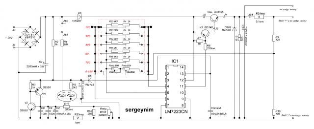

      This looks similar model is PS-1502d under many names

        What's the voltage at the base of the 2n3055 too, check for bad wire?
        Are you measuring with any load on the output? With these emitter follower designs, it gets confusing when the output (emitter) has no load...

            No load attached. The base of the 2n3055 is around 21v, the same as the collector of the PNP one, so I can only assume the 2n3055 is dead like STJ suggested.
            No diodes appear shorted.
            Also, yes, the schematic does look very similar so thanks for that - saves me the headaches

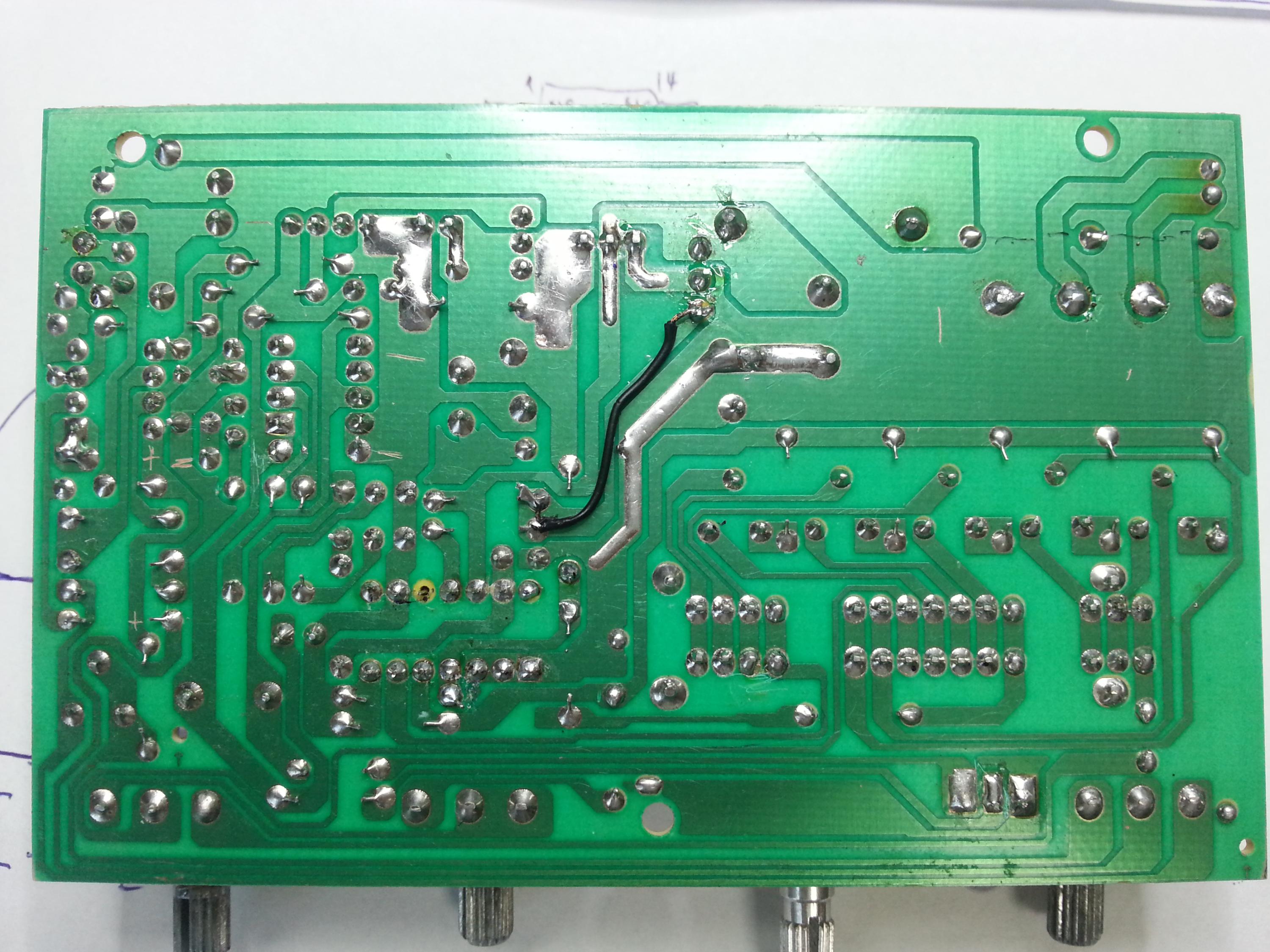

              The 2n3055 is bad: I got a new one and I get a reading with my meter in diode mode across B-E, whereas with the faulty one I get nothing....still, it doesn't answer the question why it died. My only idea is that the laptop power brick I tried using didn't provide enough current to drive the 2n3055 all the way "on", so it got too hot and died.

                  Actually, this 2N3055 is being used in "forward active" mode not "saturated" switch mode, so it's not supposed to be "full on".
                  Unfortunately without more details of what was done with the unit, I can't give any guesses as to why it died with the laptop PSU, assuming it was hooked up correctly... Perhaps the input voltage was too low and the current limiting on the output failed to kick in, and too much base drive was applied? Don't know.

                    Yes, I believe it was hooked up correctly. I left it exactly as it was, except instead of the transformer which was dead, I used the laptop power brick and connected it between the AC legs of the main bridge rectifier. It worked, but when I started loading the output, for some reason the 2n3055 quit. The other PNP driving it is fine though :|

                        I was staring at the schematic here for this particular PSU, when the current limit is reached, does it shut off or does it fold (voltage goes down to ensure it doesn't go over the current limit...)
                        Just trying to understand this schematic...

                          My particular one turns off for like a second, makes a LOUD beeping sound (notice that piezo on the board), then turns back on. If the overcurrent condition is still present, it will do it again and again until it's removed, so it's not a proper constant current supply in that respect. It's a constant VOLTAGE supply....still haven't fixed it BTW I replaced the 2N3055 but haven't tried it out, mostly out of laziness....was gonna put an UPS transformer on it, since it doesn't matter as long as the input is roughly 20v input.

                            Aha... yeah that's what the schematic looks like what it would do. I was looking for ideas in changing my CV/CC homemade PSU from using a LM317+TIP42 pass to one that uses a 2n3055 + LM723 on hopes for more current and also it seems this combo can go down below 1.2V without a negative supply - I'm thinking it can go to zero just fine.
                            Alas I want CV/CC so I'll have to modify this circuit a bit. The transformer I'm using also is using a 24V 2A CT transformer that I want it to automatically switch between 12V and 24V in hopes that it will both go well past the 12V limit that I have now (since I'm using the other winding as a negative supply) without dissipating double the power...
                            I might have to use a RRIO op amp to do current sense for current limiting (CC) but if I could get away without using an external op amp, that would be good...
