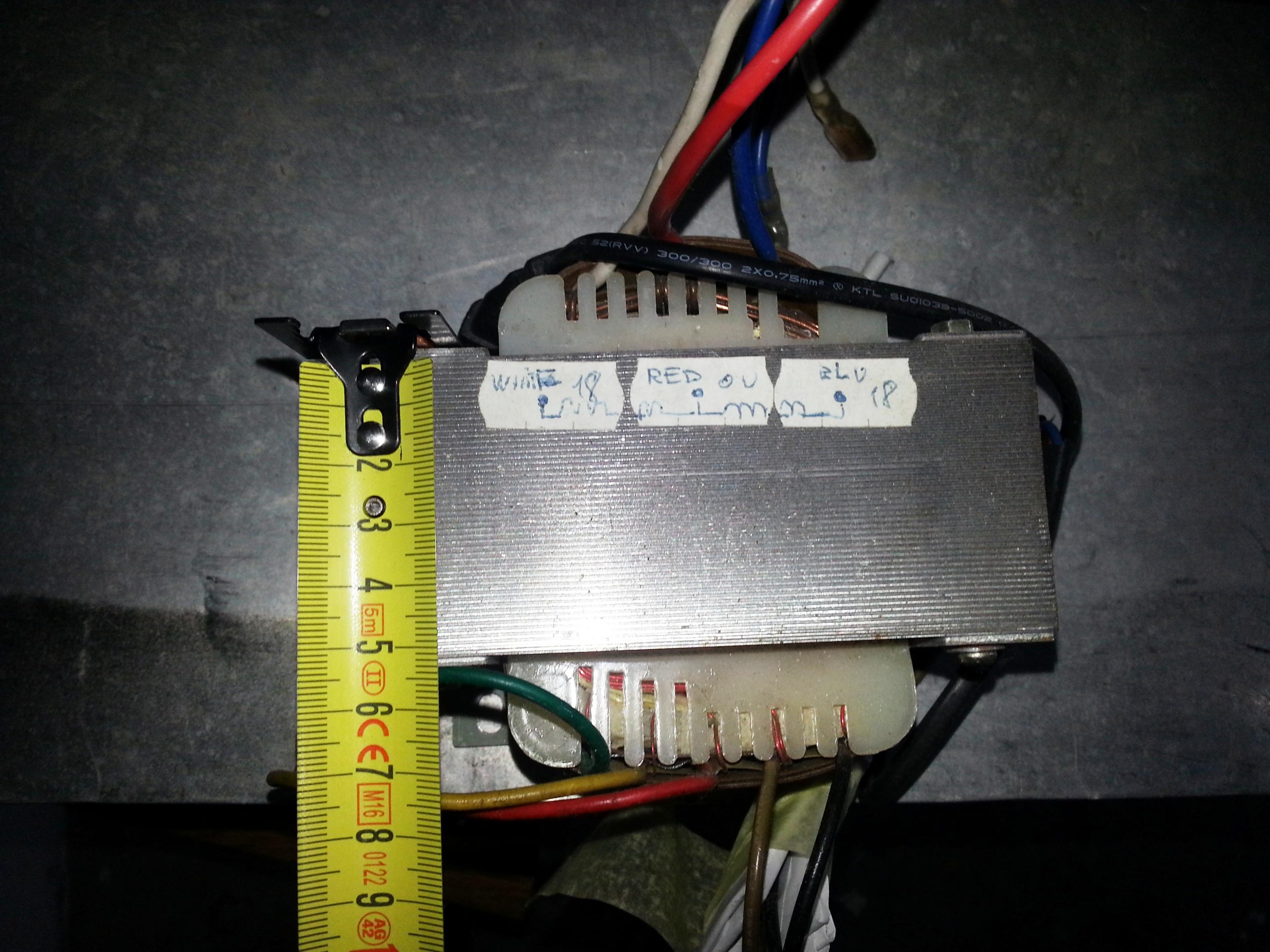

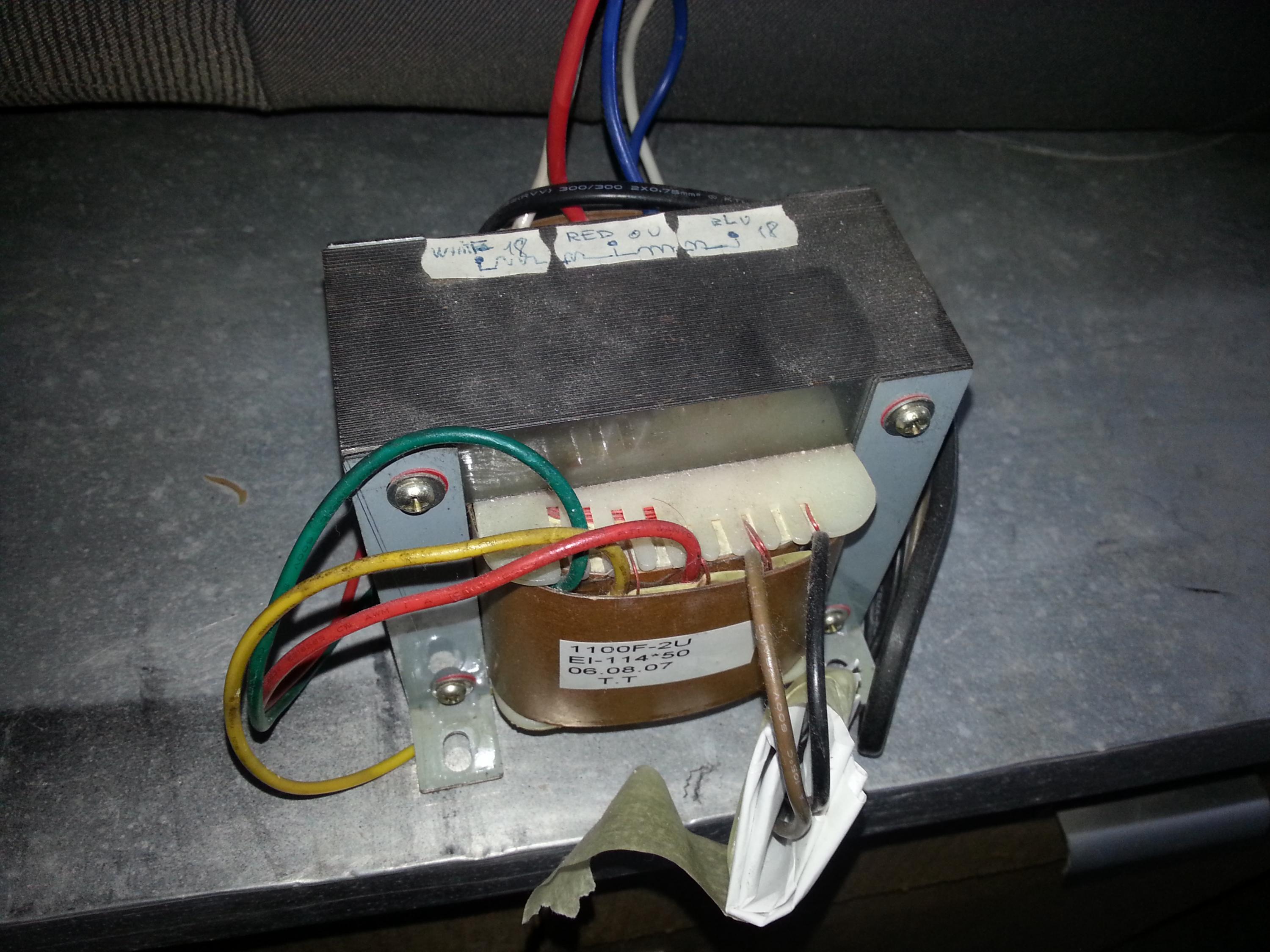

                Really quick, here are some shots of the transformer I'm planning to use...not terribly huge, but still "beefy". Scale is CM (duuh)

                  • 31256
                  Re: LM723 adjustable bench PSU not working
                  just use a module.
                  this is the top one, but there is a table of versions on the page.
                  https://www.banggood.com/DP50V15A-DP...p-1072236.html

                    #29
                    Originally posted by stj
                    just use a module.
                    I feel like something's missing in your post...you mean like a step-down module or buck converter or whatever ? If so, I think there should be a link in there

                      #30
                      no, I think he meant don't bother designing a wasteful linear design and depend on the chinese to get a switching solution without needing to do anything...
                        • 31256
                        #31
                        no, you supply the dc, it does the rest.
                        so your transformer + rectifier & cap.(or a laptop supply??)
                        then a module with the apropriate max current.
                        they do make ones that have boost converters btw.
