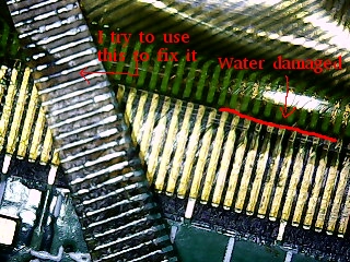

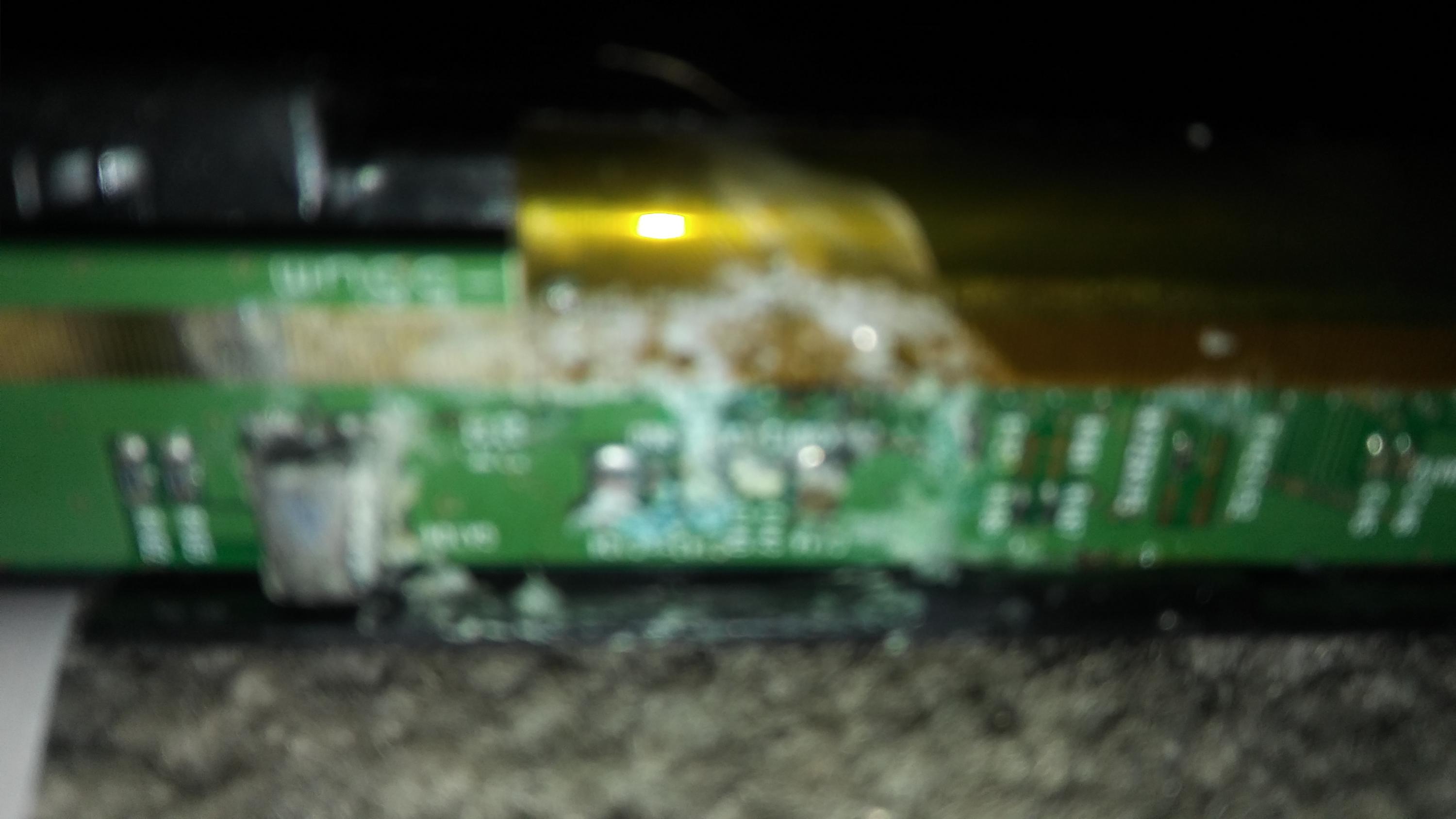

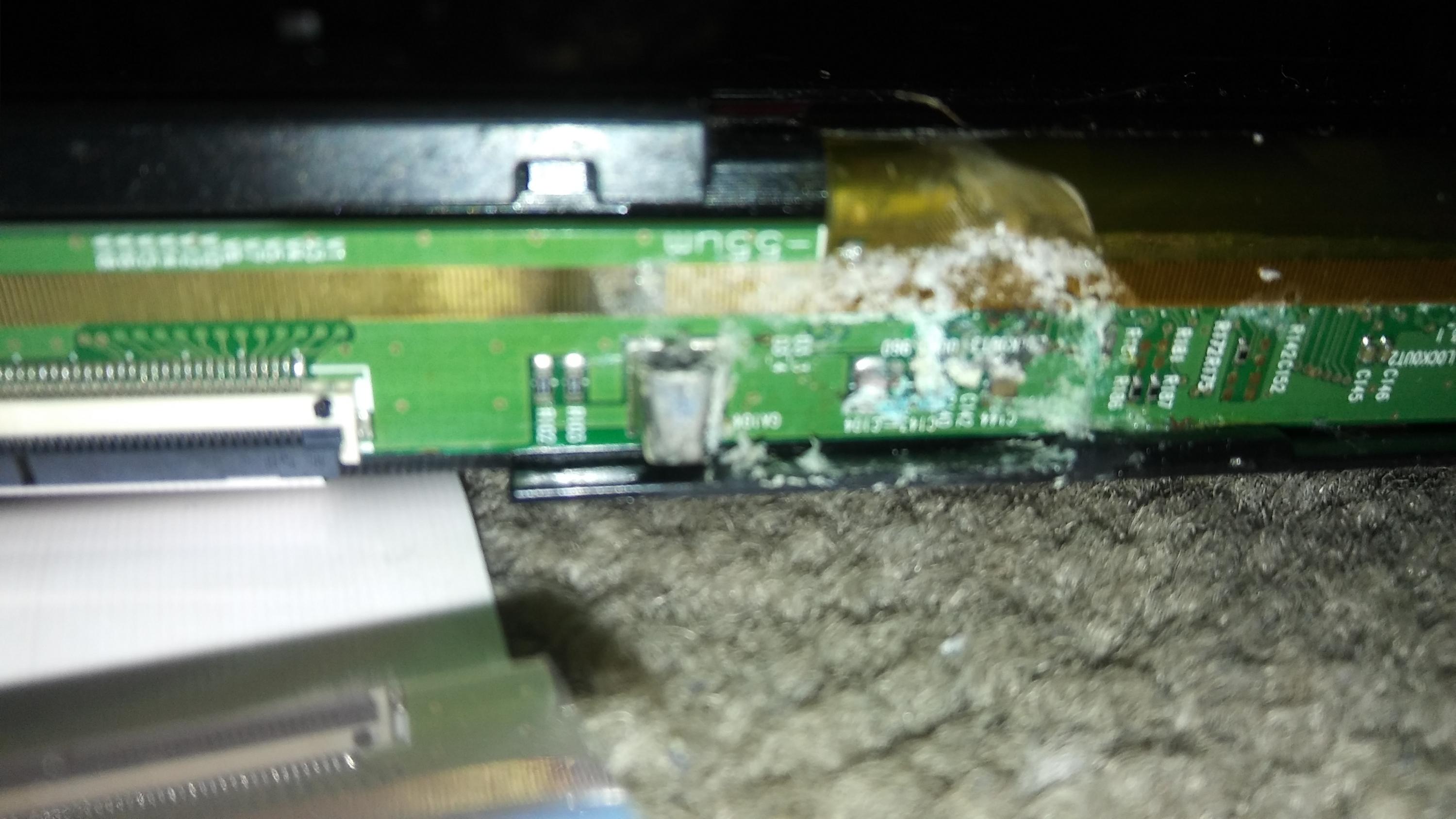

Help! need to solder the wire to the TAB!
  • capwizard
    • Jun 2016
    • 1991

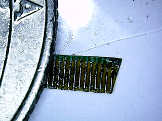

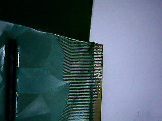

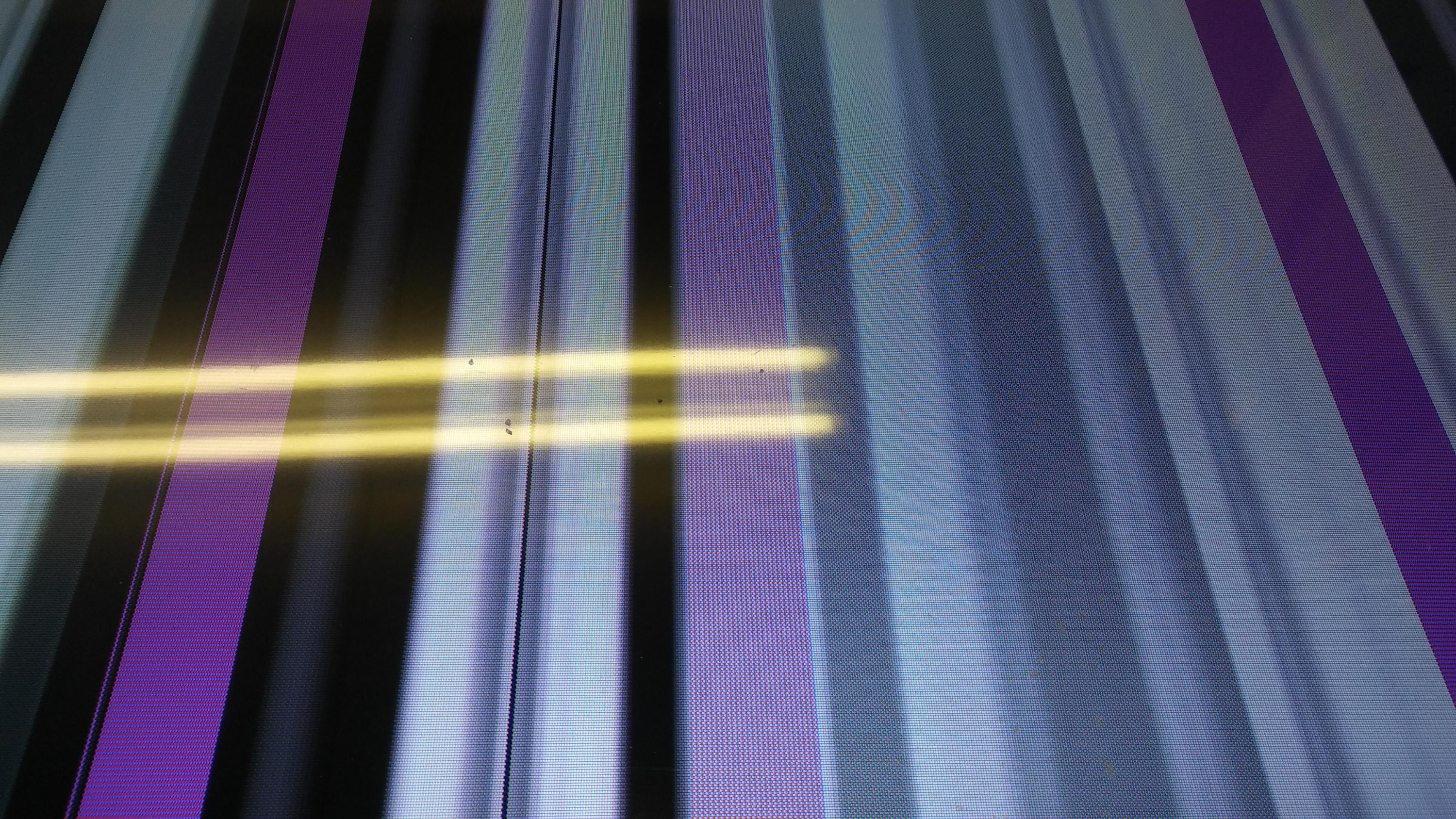

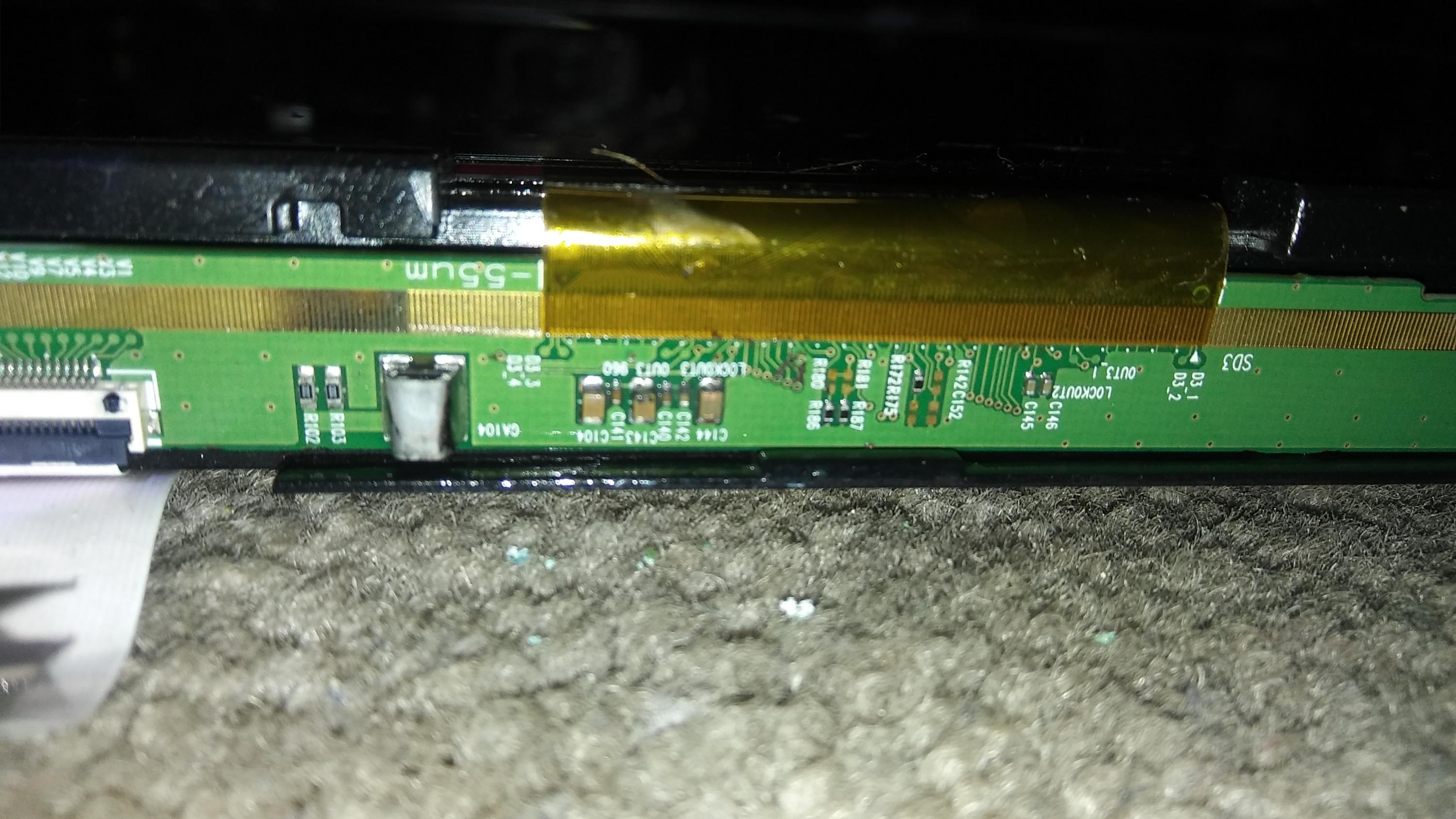

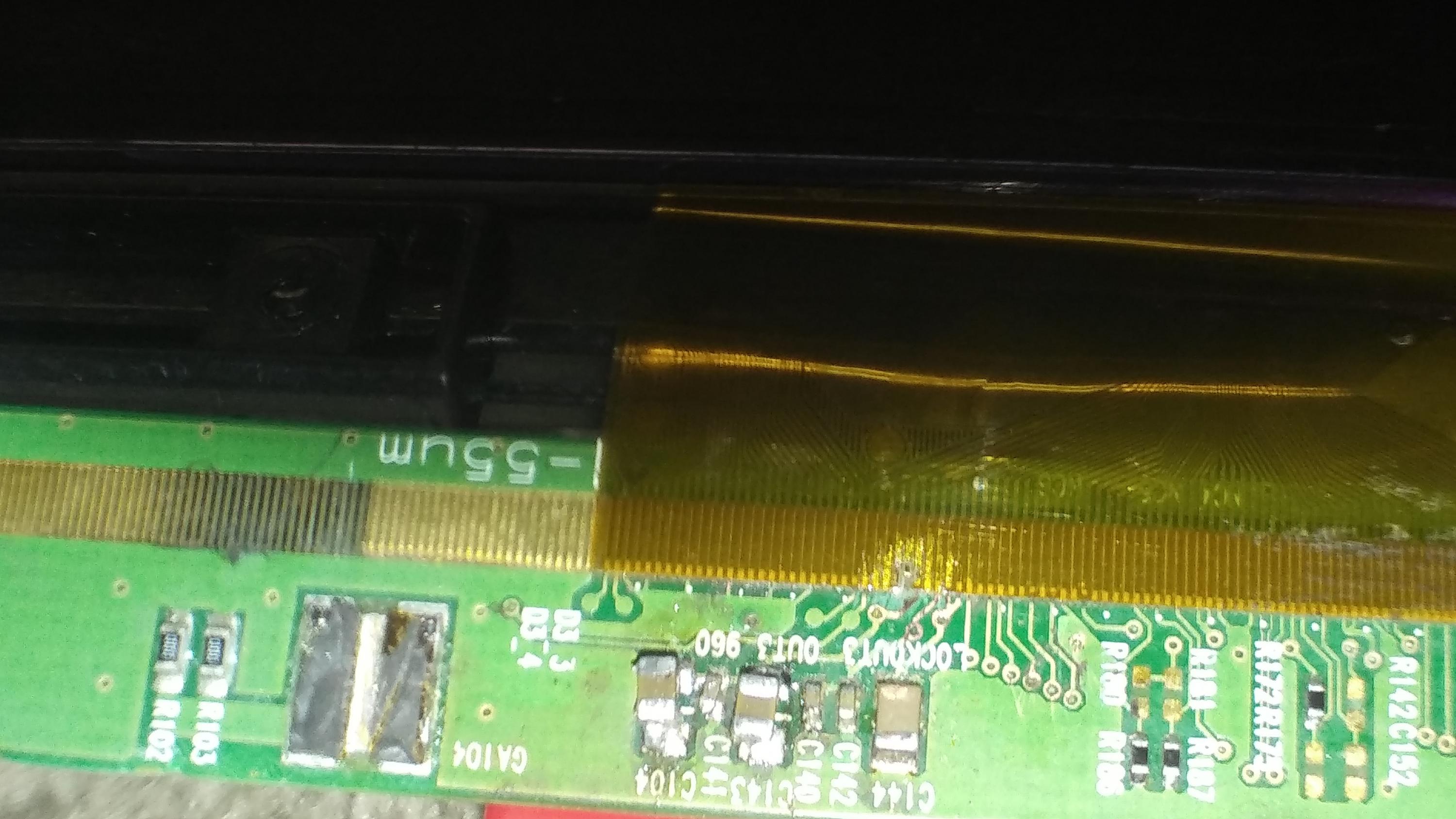

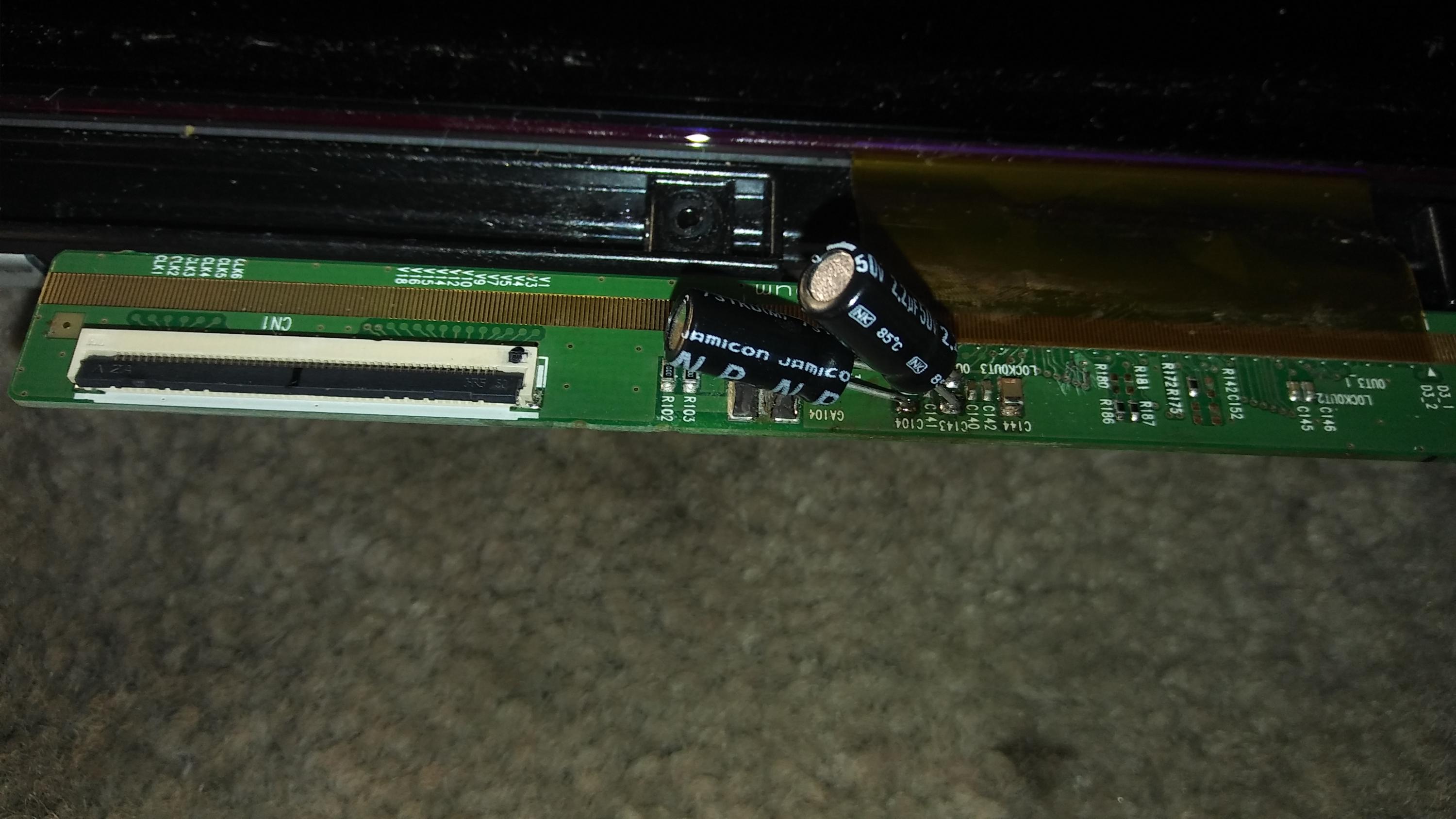

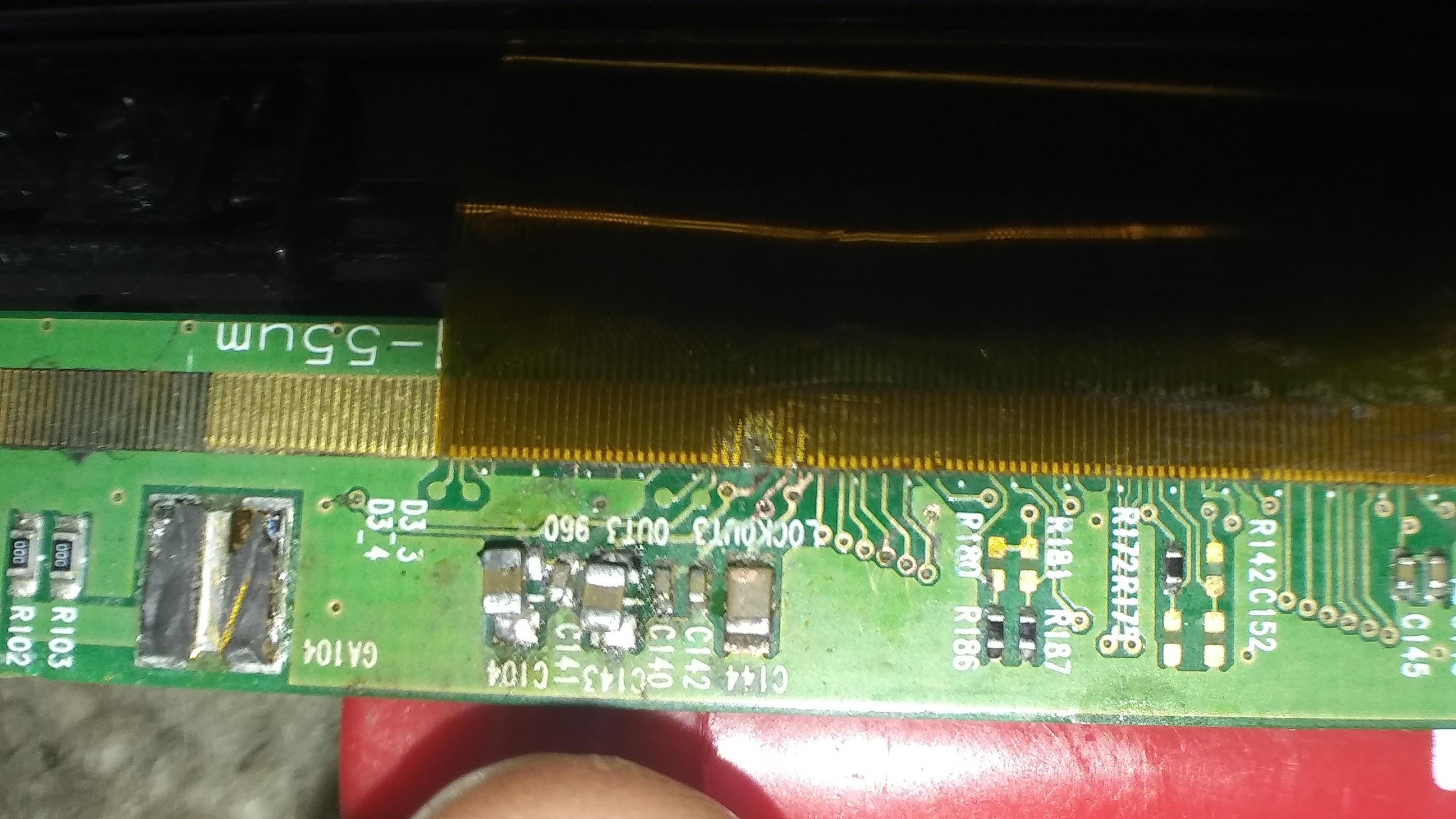

    55" TV has water damaged on the TAB, after I changed two shorted SMD capacitors, now TV has picture but the TAB has 8 etched copper wires. (Before TV was cut off and T-con board was hot.)
    My question is : it is very hard to solder the wires back to the TAB which took me whole day even I was using stereoscope............
    PS: I Apologize for the blurry pictures more better pics on the way.

      Re: Help! need to solder the wire to the TAB!
      can you not jumper wire around the ribbon cable ?
      • capwizard
        • Jun 2016
        • 1991

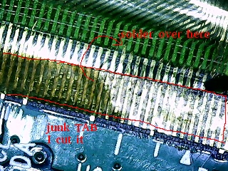

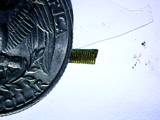

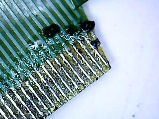

        I try to use a junk piece of the ribbon cable to do the job
        First I put solder on the junk TAB then try to overlap them together and put heat try to bond them together, because their do have the same spaces.
        The problem is the TAB piece is too small to heat it up. I cant use the gas torch, MIG or TIG................
              Thank you, I use 400'c iron still can't transform heat to the top of the coupon tape. I try to bond the junk pre solder TAB to the PCB instead of using wires to repair.
              PS: If this method works, we can fix most water damaged TV.

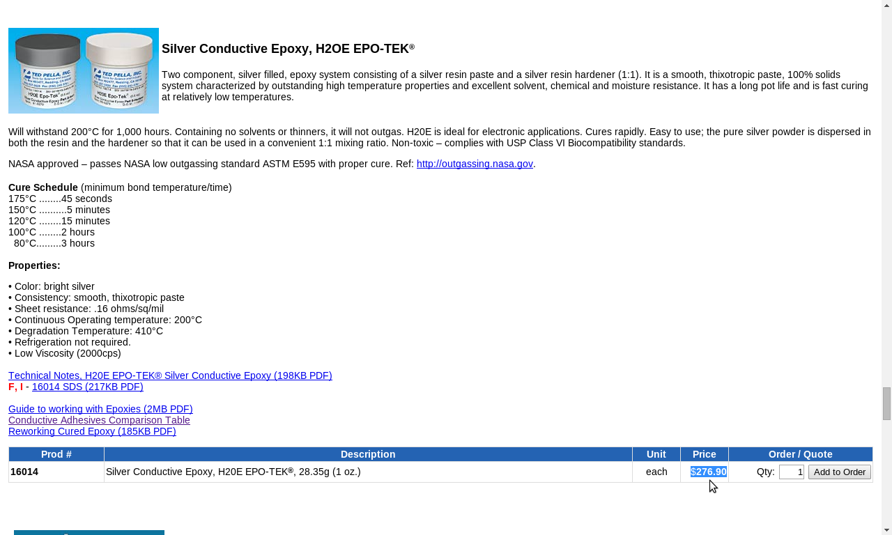

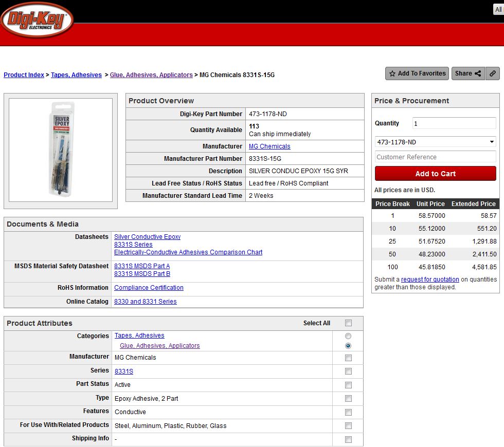

                      I would think about using conductive epoxy not paint. Its not cheap though.

                        Pelco 16045 : PELCO Isopropanol Based Graphite Paint
                        Conductive graphite paint, primarily designed for SEM sample preparation. The graphite flakes, with an average size of 1µm, are bonded by a cellulose resin with isopropanol as diluent. Good bonding properties on most materials. Graphite content is 20%. Ideal to mount samples on sample stubs or to make a conductive path to the sample surface. Let fully dry before using in the SEM. Maximum service temperature: 200° C. Use Graphite Paint Extender to dilute when needed.
                        " would think about using conductive epoxy not paint. Its not cheap though."
                        Pic1 : Yes, Not cheap, 1 oz is $276.9.
                        https://www.tedpella.com/adhesive_ht...Comparison.htm
