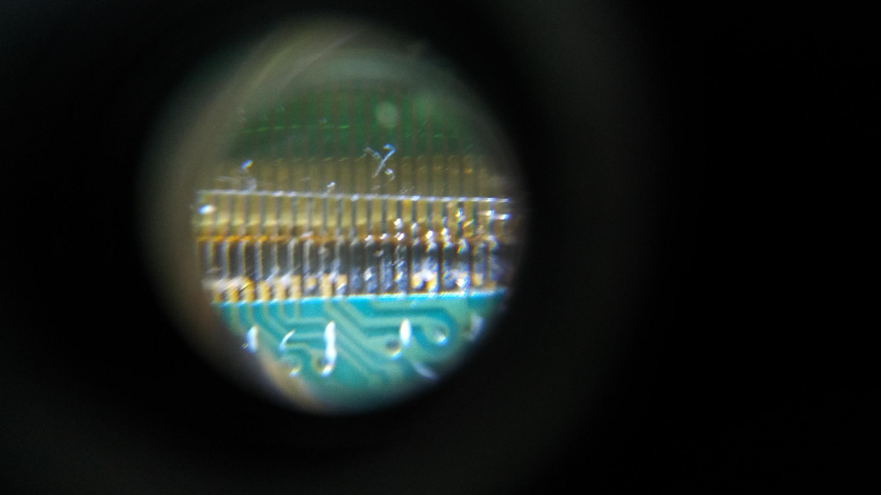

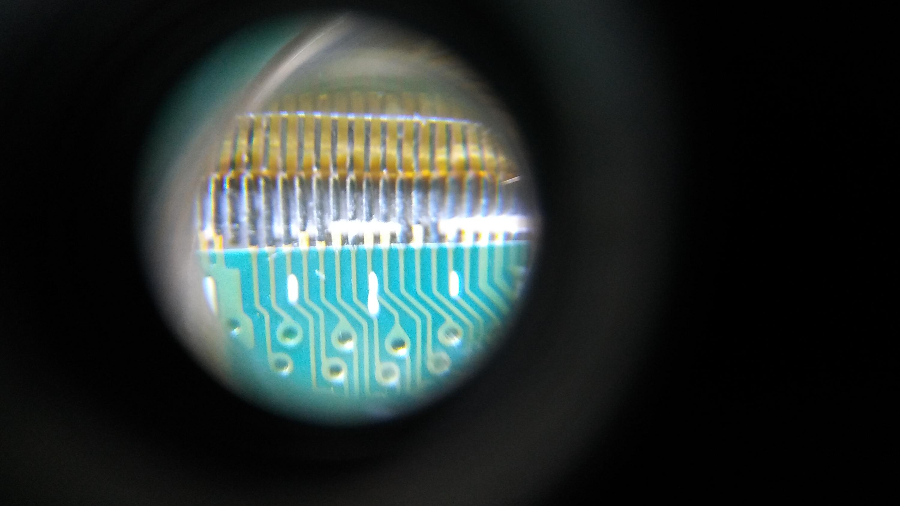

          Been a few days since I have been able to get back to this thread, a lot of repairs came through, anyways I have spent quite some time using a microscope and scrap tab connectors, as suspected the tab substrate is substantially thicker one side with a thinner layer on other side. The way I have seen most tab on connectors configured is thin side down with the exposed copper traces bonded to the pcb or the glass panel.
          While I have carried out flexi pcb repairs with unrelated electronics these had a wider pitch and tracks. With reference to tab connectors though I did find repeatable results could be obtained from the thinner side of the material with some distortion to the flexi pcb substrate however I had little or no success working from the side you would have to access on an assembled panel. If that makes sense.
          I a not sure I would consider this a permanent lasting repair either as the soldering process badly distorts the flexi pcb material which is largely not intended for this kind of process.

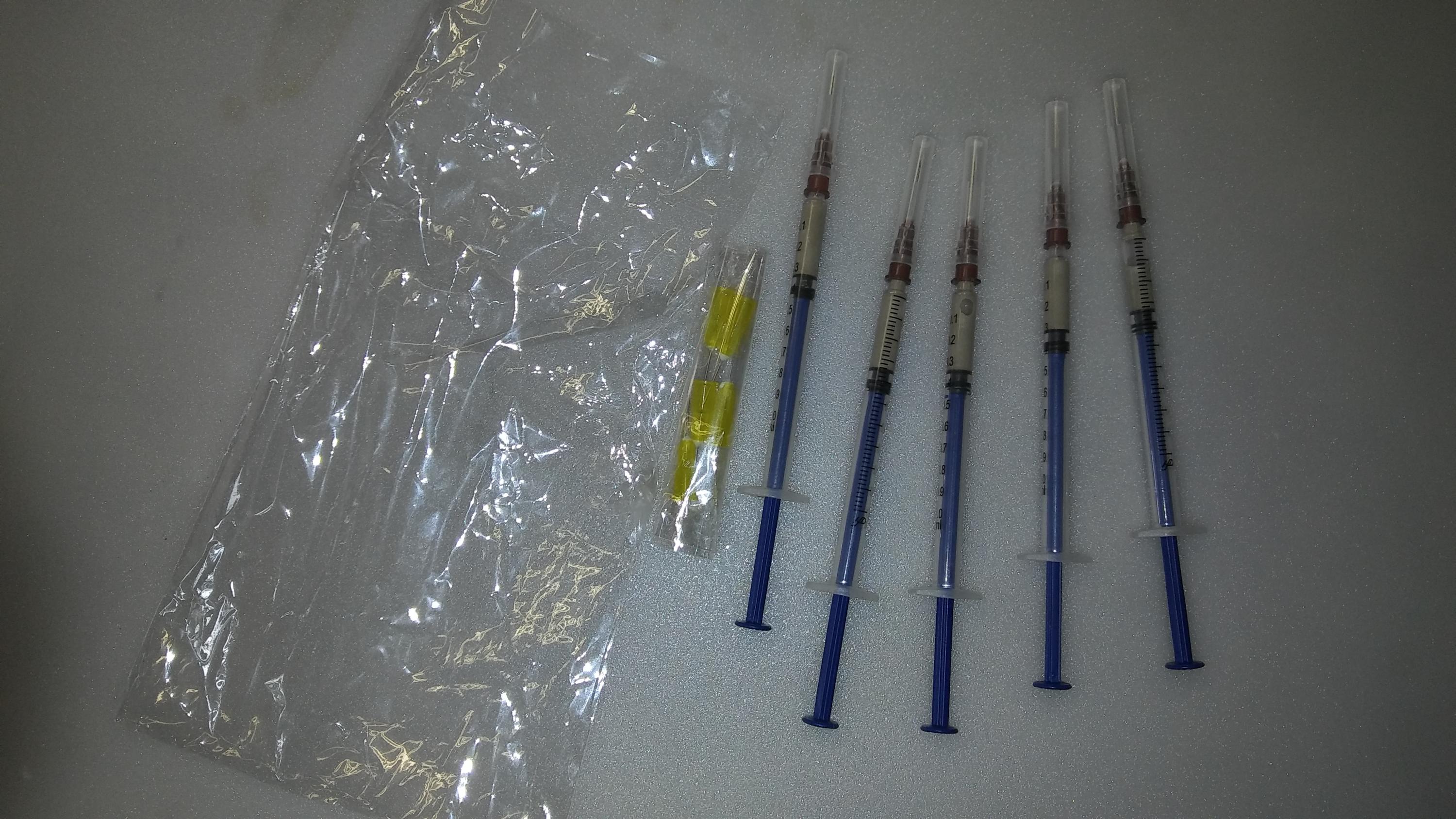

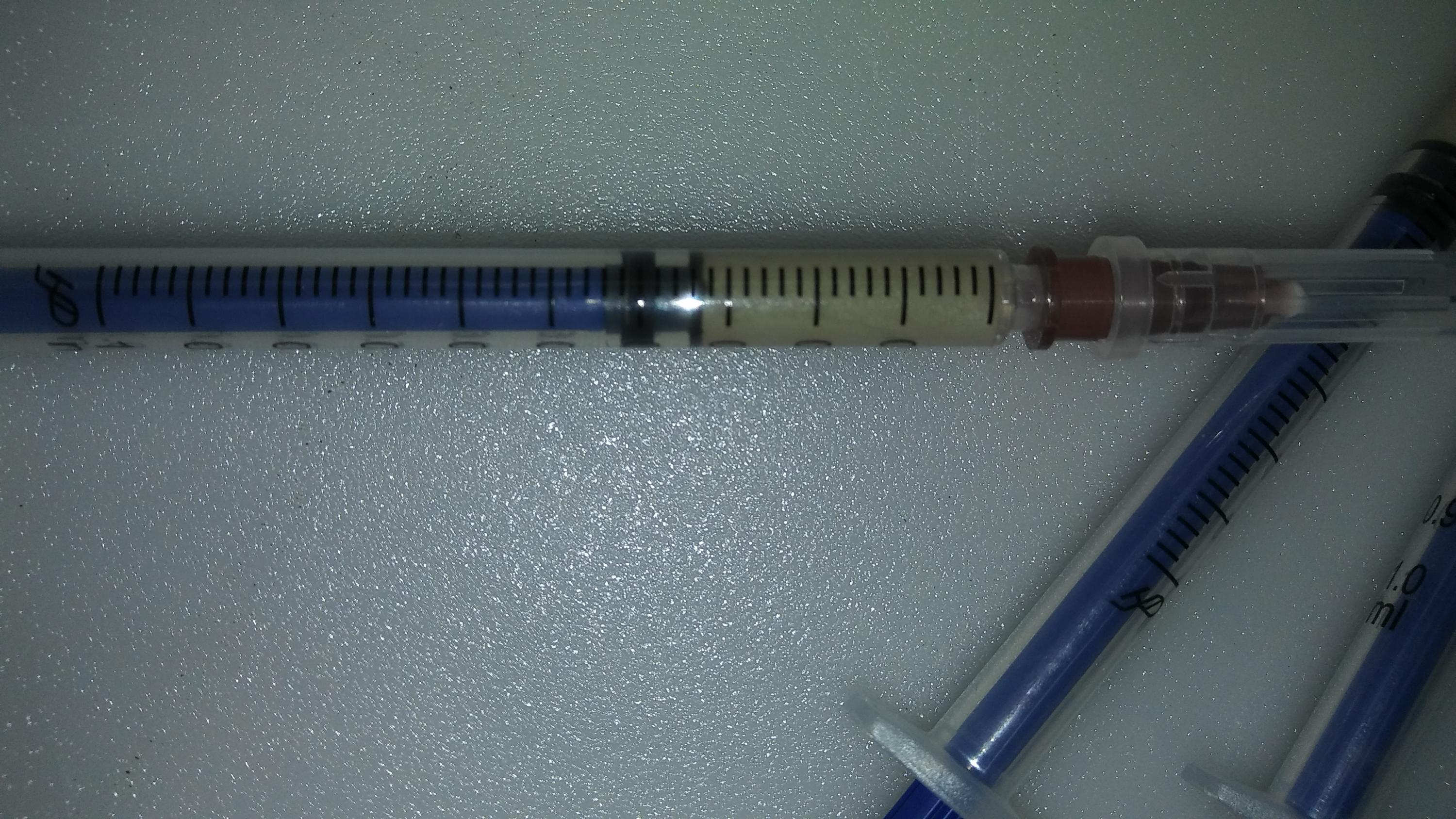

              diif ; You're right, it took 2 weeks came from China. I can't see any silver inside of it and the color look like soil. If no work I will return it. (Amazon)
              So, I reordered this ReFaXi 0.2ML Silver Conductive Glue. pic3

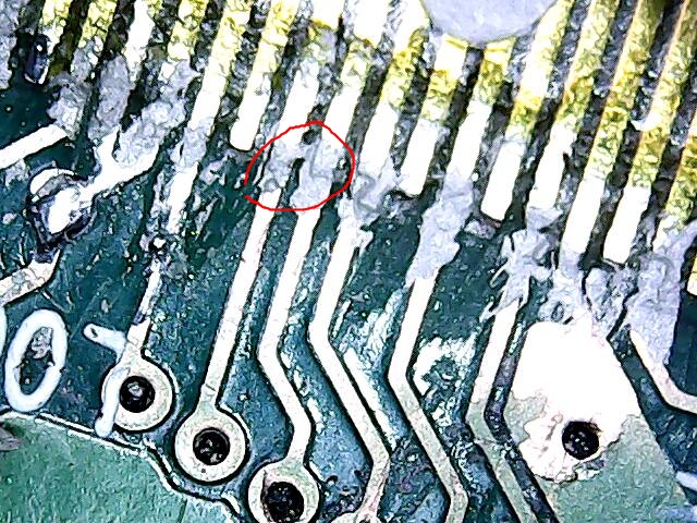

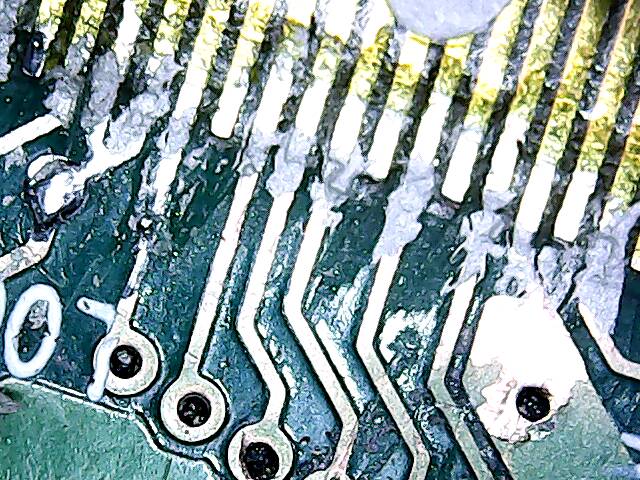

                I think you're wasting your time with cheap silver glue.
                Sand back the flex until it reveals the copper, tin the traces then solder fine wires to it.
                Like I did in this thread. https://www.badcaps.net/forum/showthread.php?t=59062
                  Re: Help! need to solder the wire to the TAB!
                  That was A marvelous job, OK Your next mission is to fix the TAB attach to the LCD glass screen super fine copper traces...................
                  One question Please, Who broke that flex TAB copper traces at first place?
                    I did ,trying to avoid the razor sharp edge of the back panel.
                    I need to find a broken monitor but I accept your mission challenge.
                    Soldering to the board is easy, I removed the gold with a fibre glass pencil, tinned the tracks and soldered the same 0.15mm wire I used on the plasma.

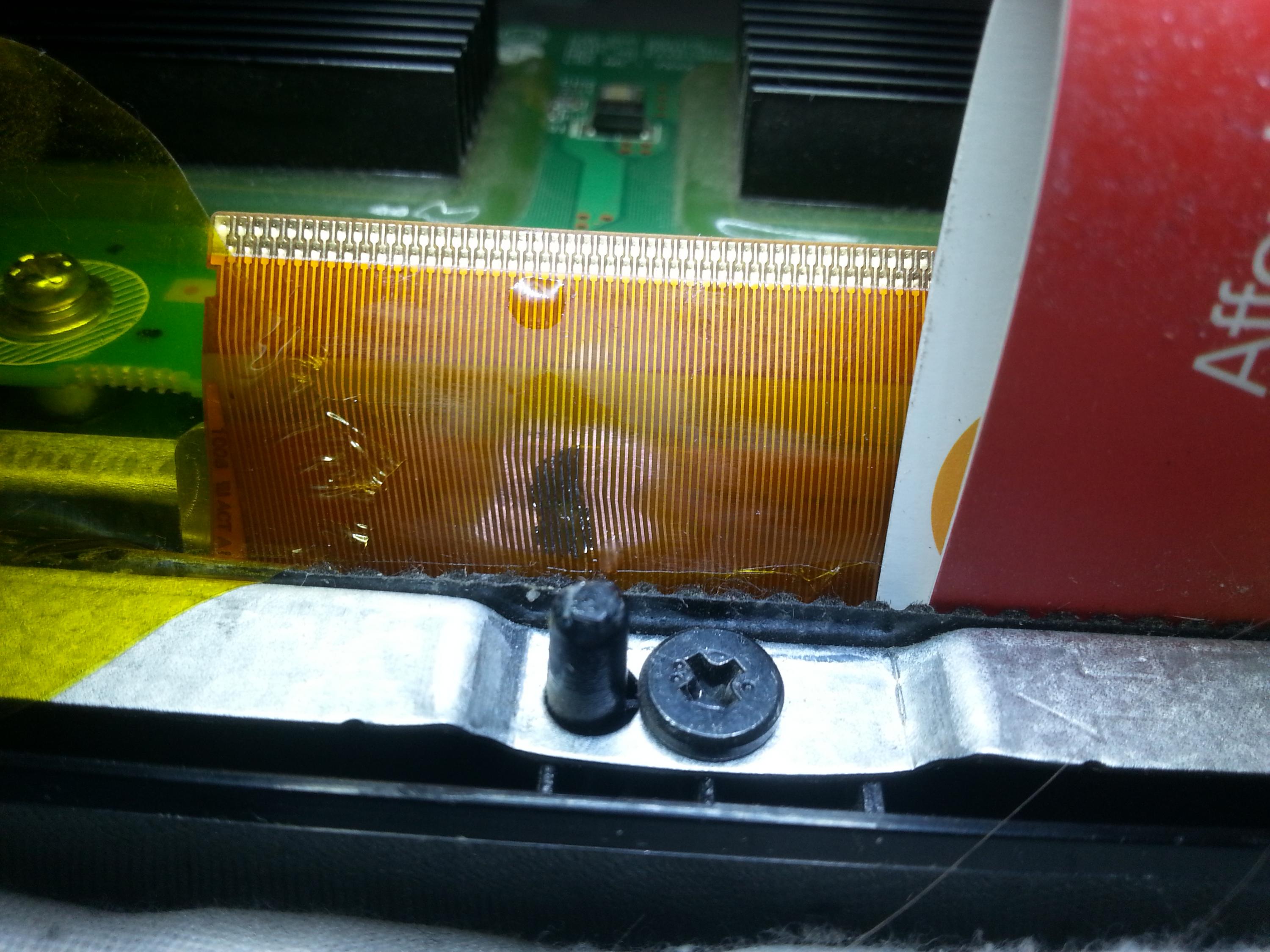

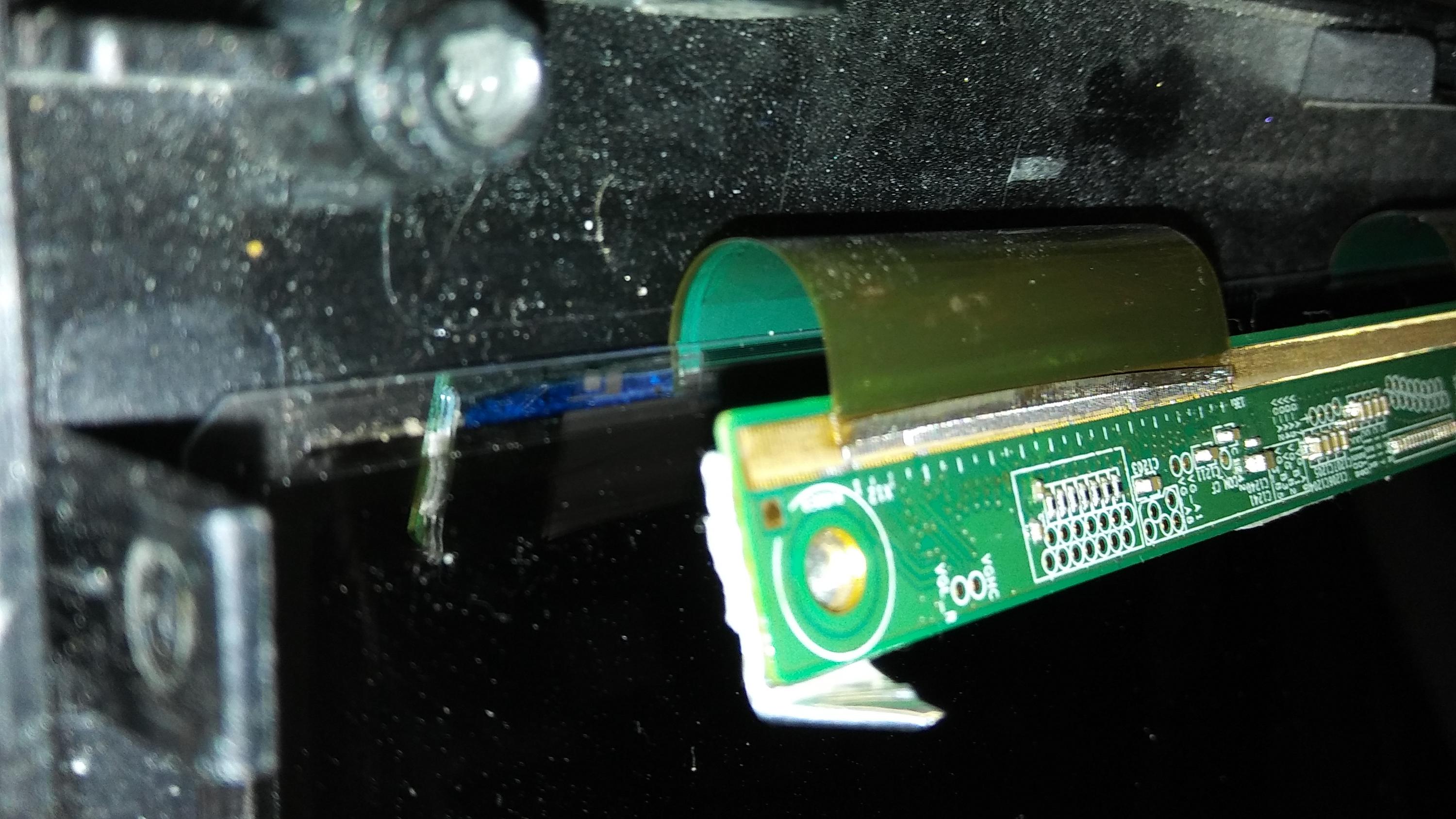

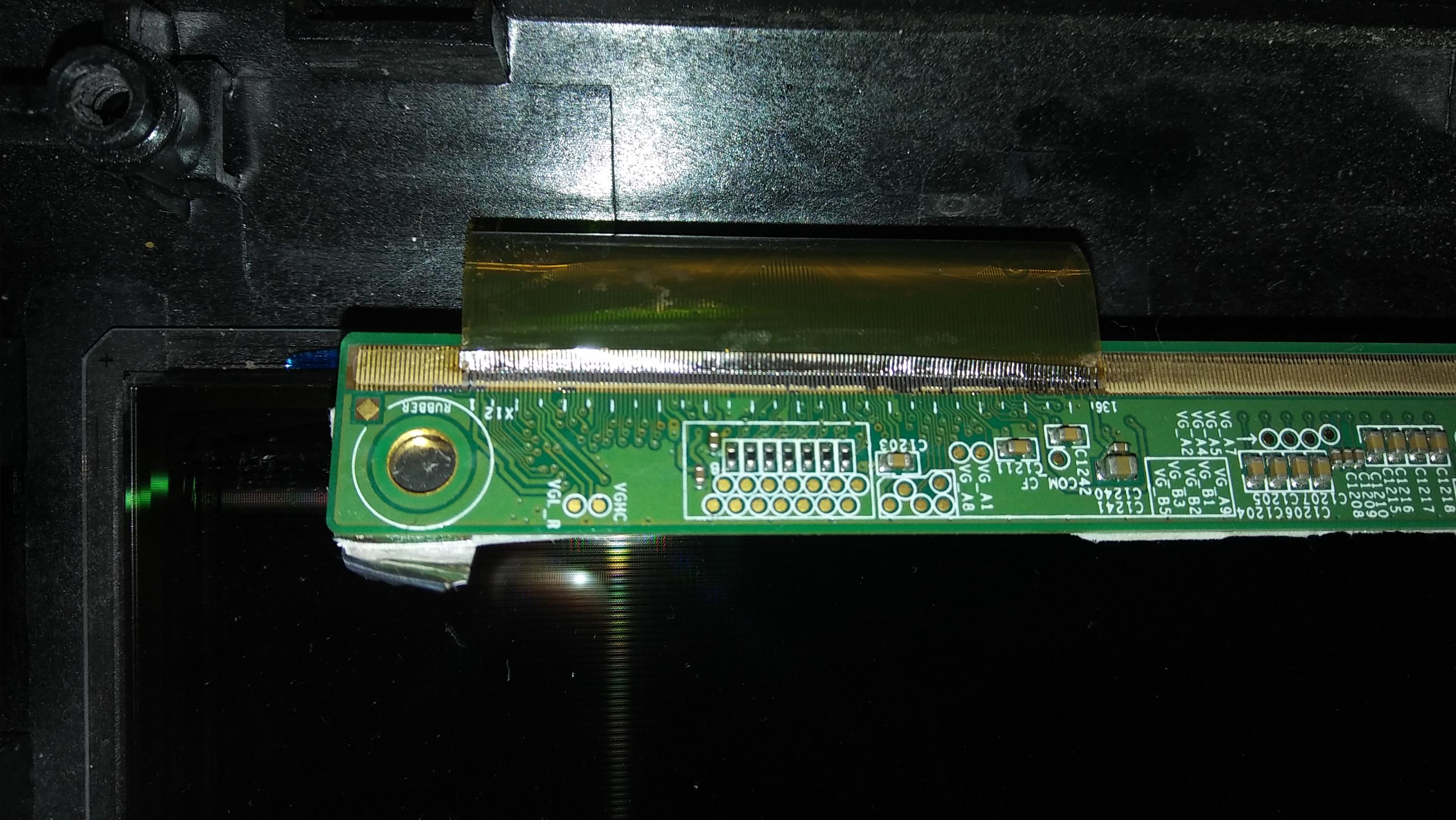

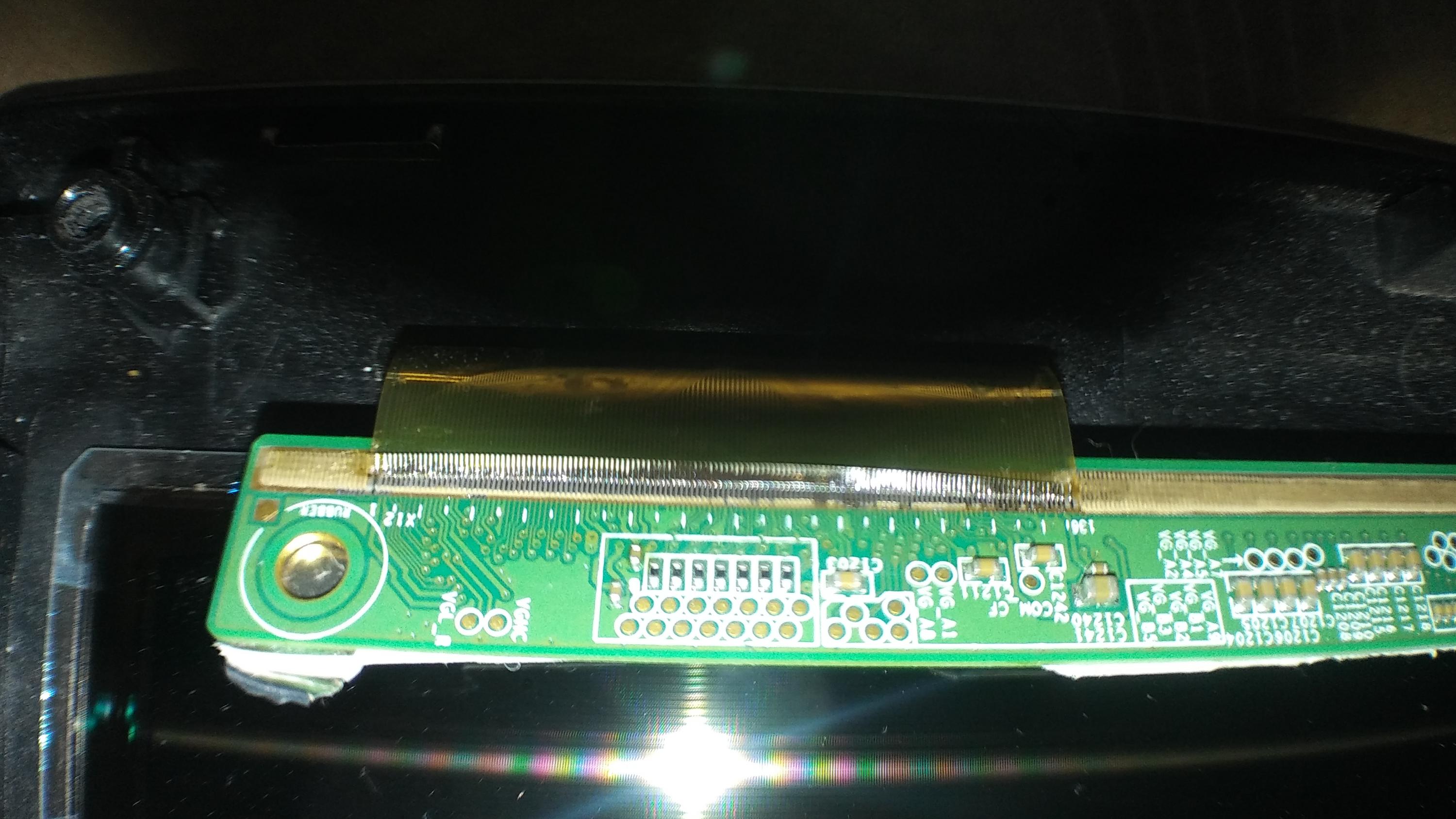

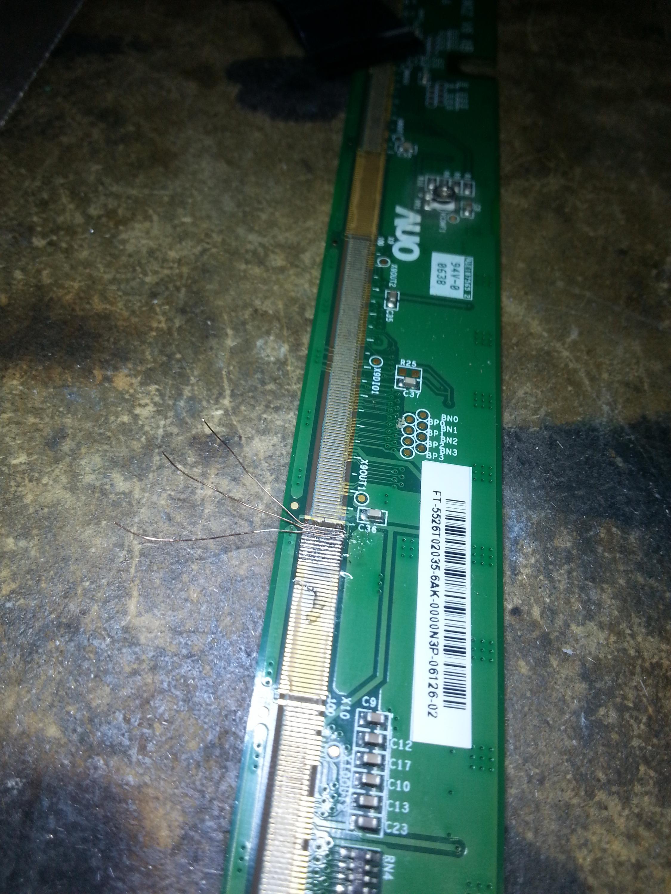

                        Yes, Silver Conductive Glue works.
                        Pic2 ; It has a short, no problem use needle take out.
                        Pic 3,4 : ...Works, but TAB IC already damaged................................ Only needs 1/4 drop glue to finish the job so buy the best quality Silver Conductive Glue.
                        Hope! Someone will find out which Silver Conductive Glue is best for our application. My glue looks never will get harden.
