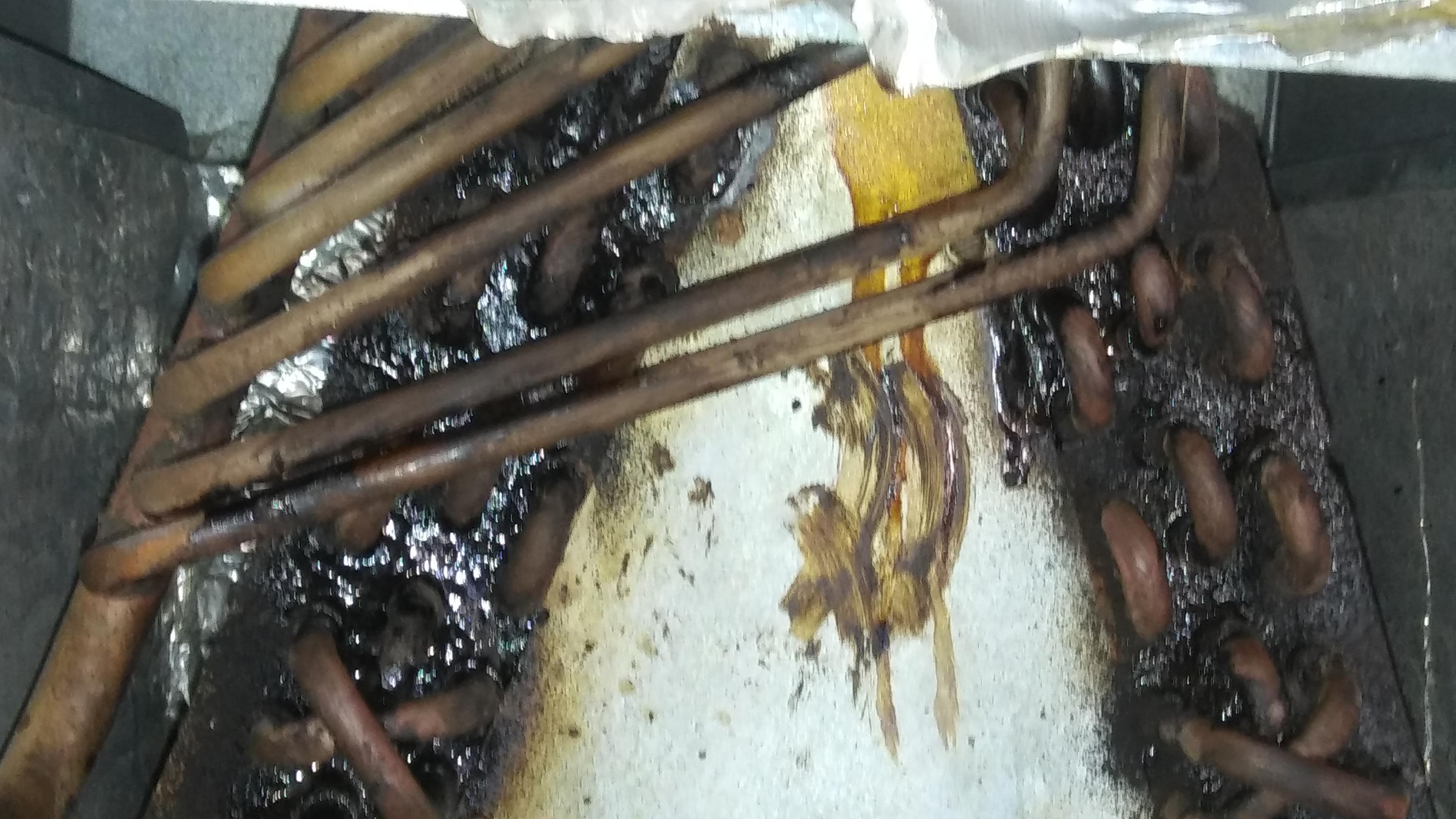

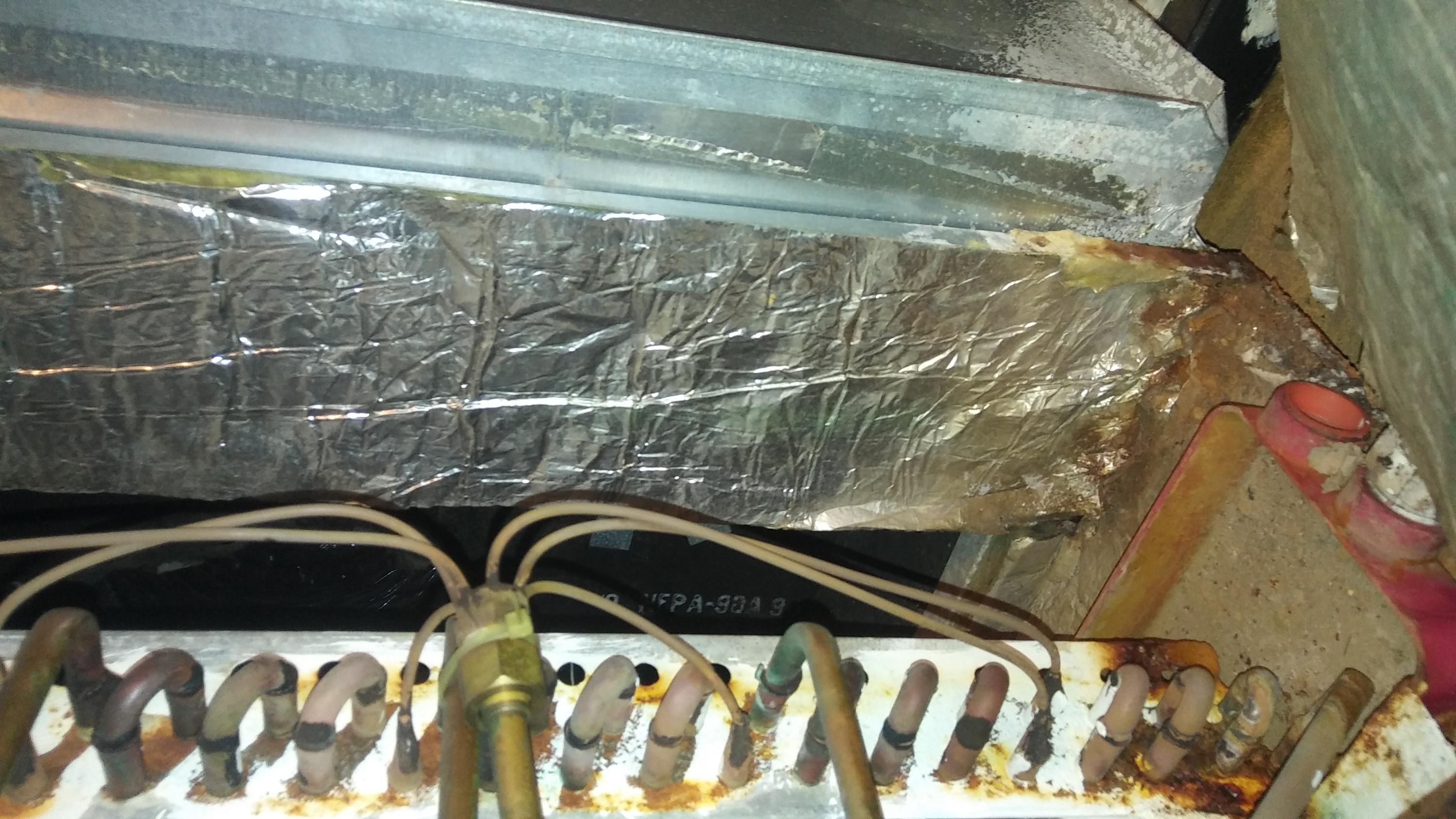

    Routine maintenance on HVAC save you $12,000

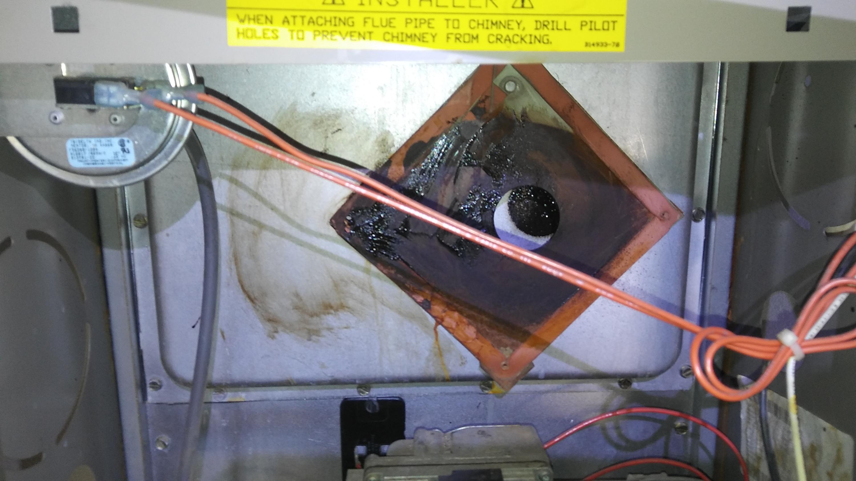

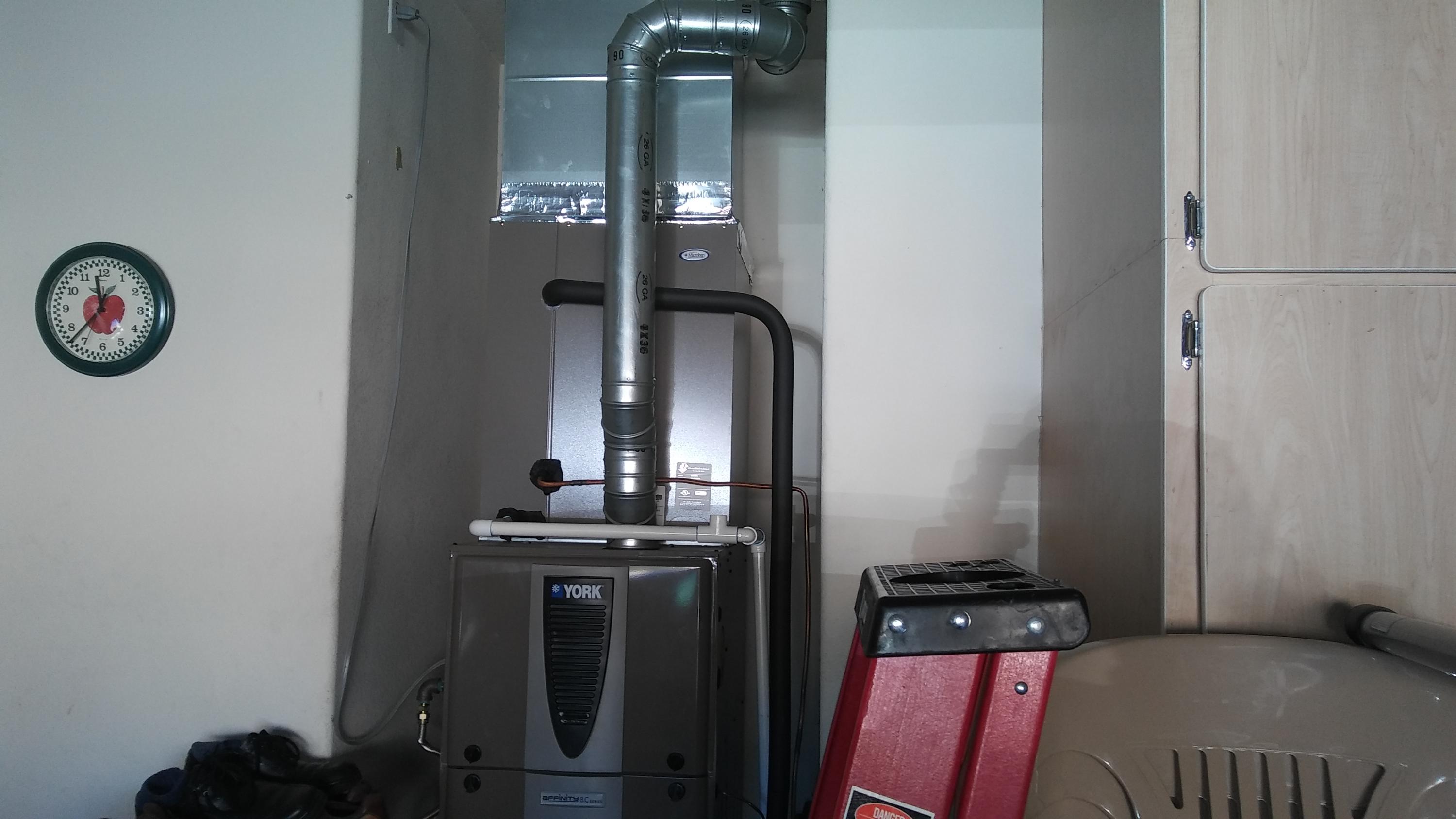

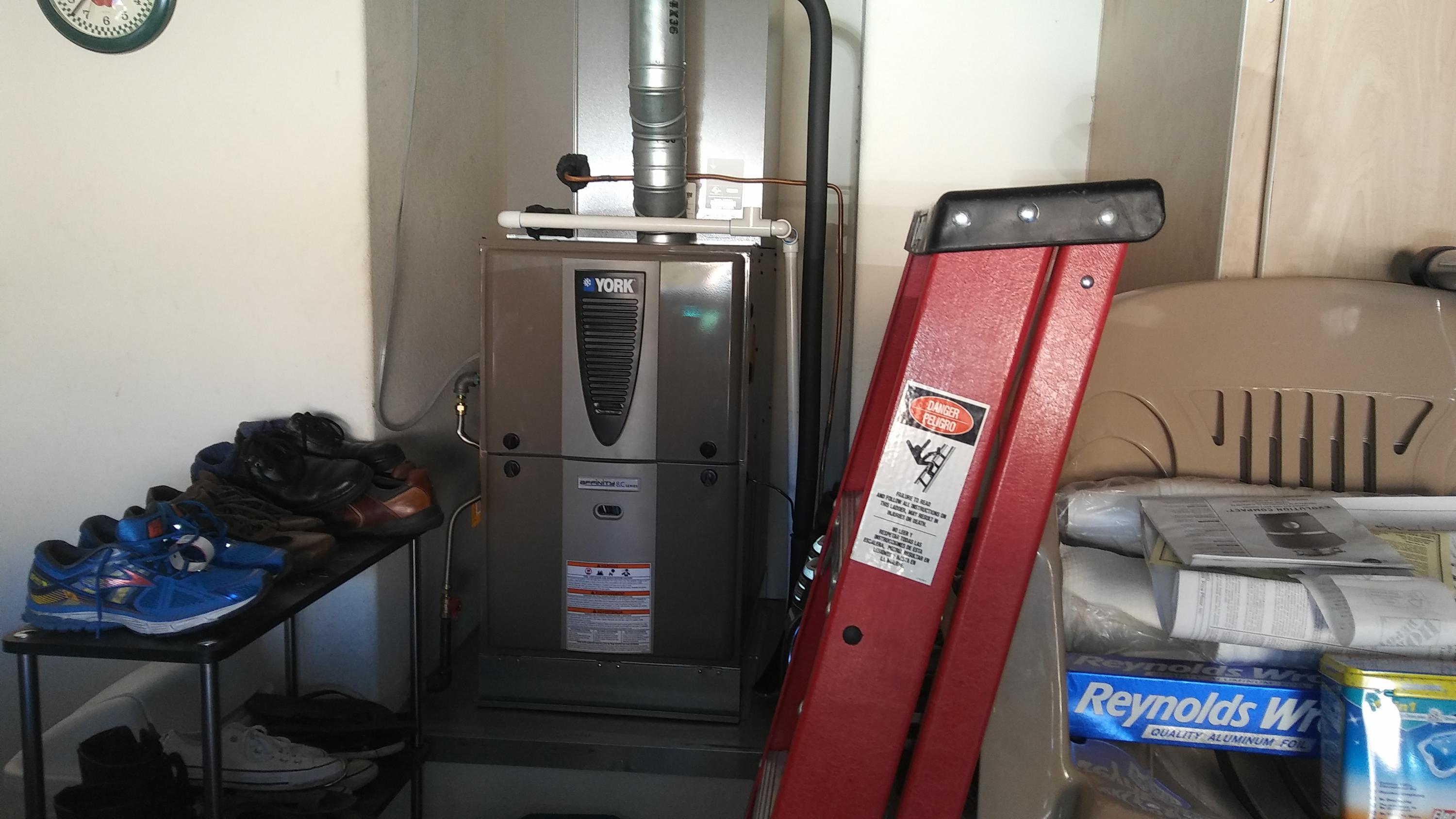

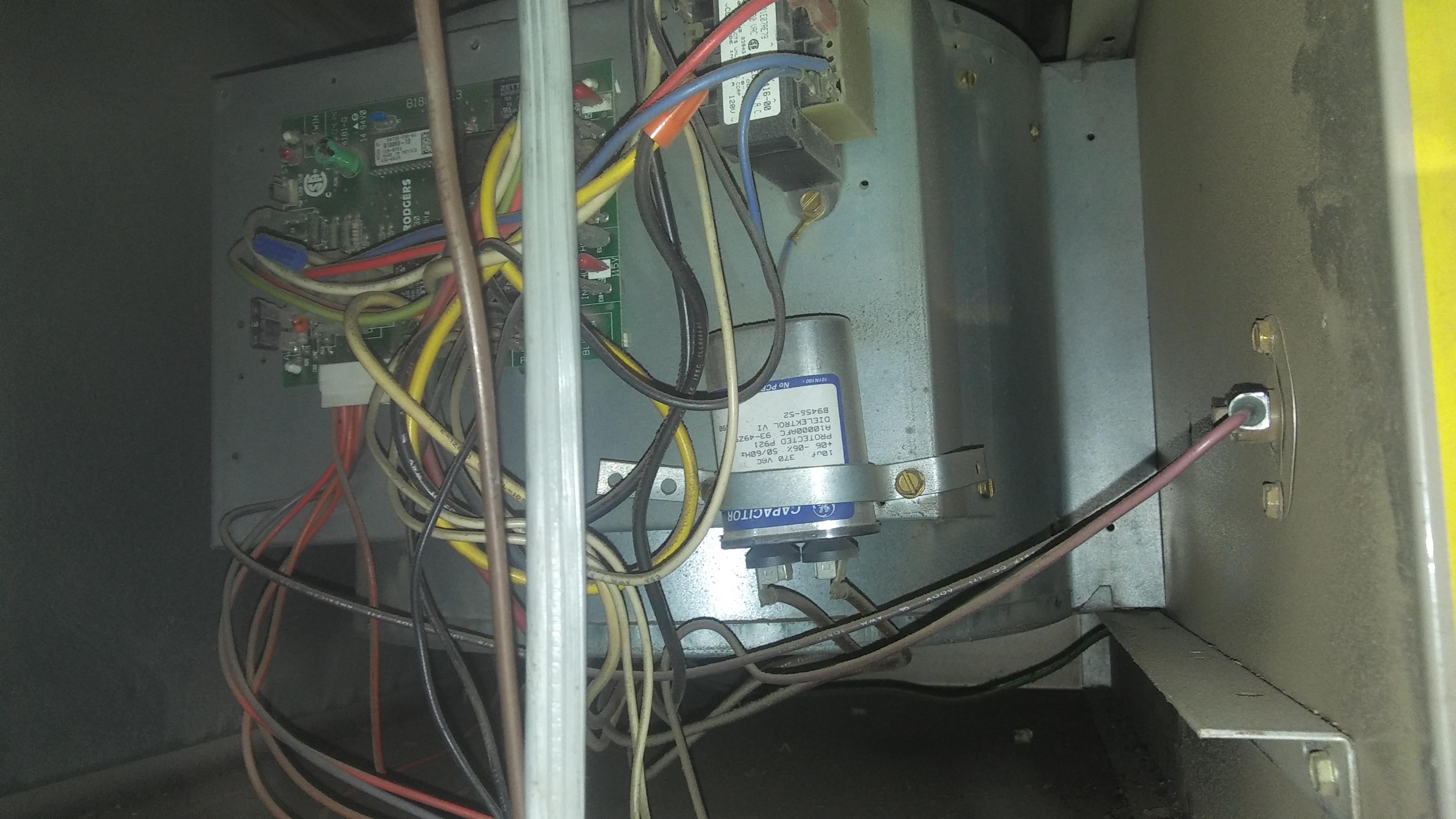

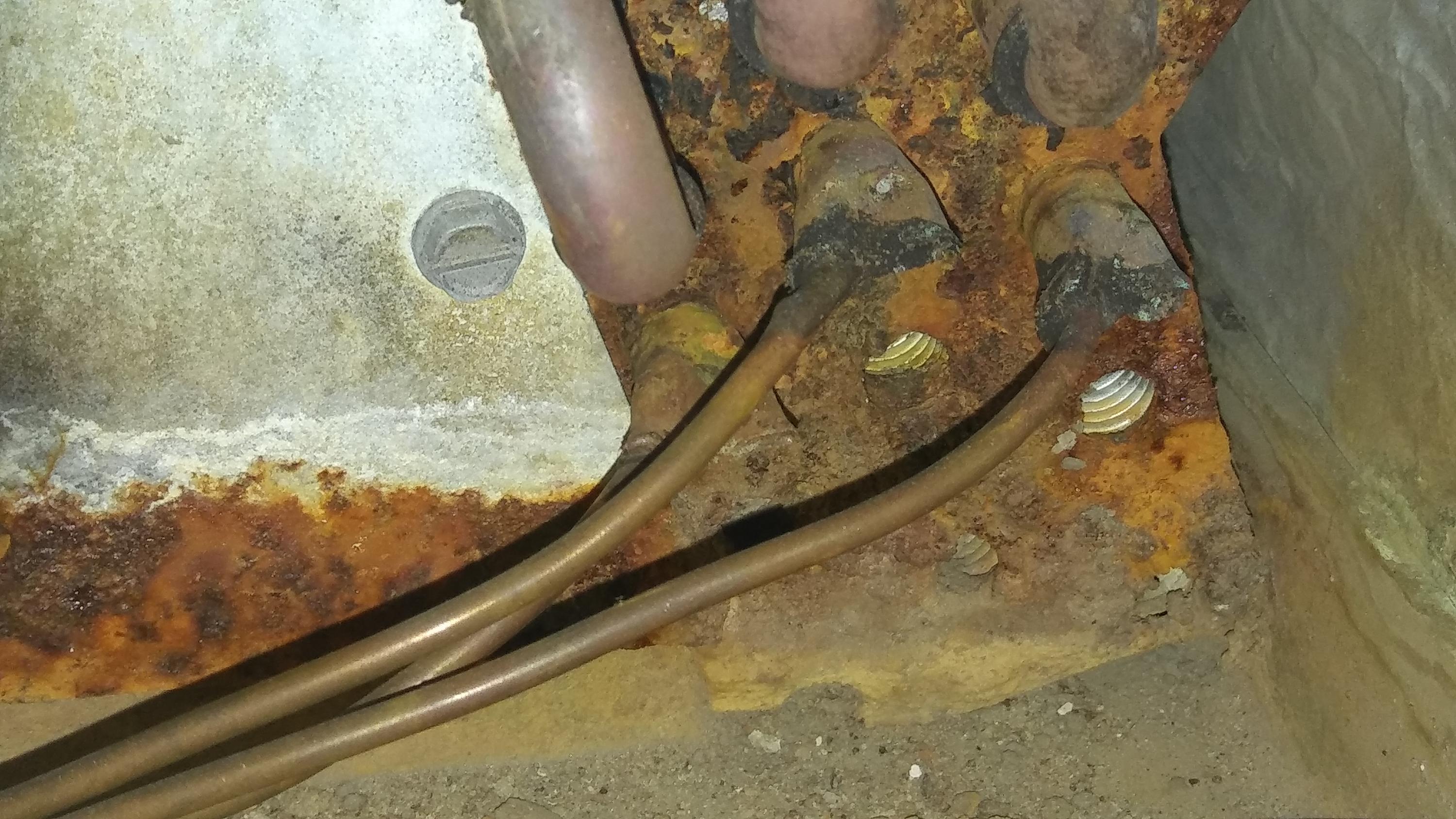

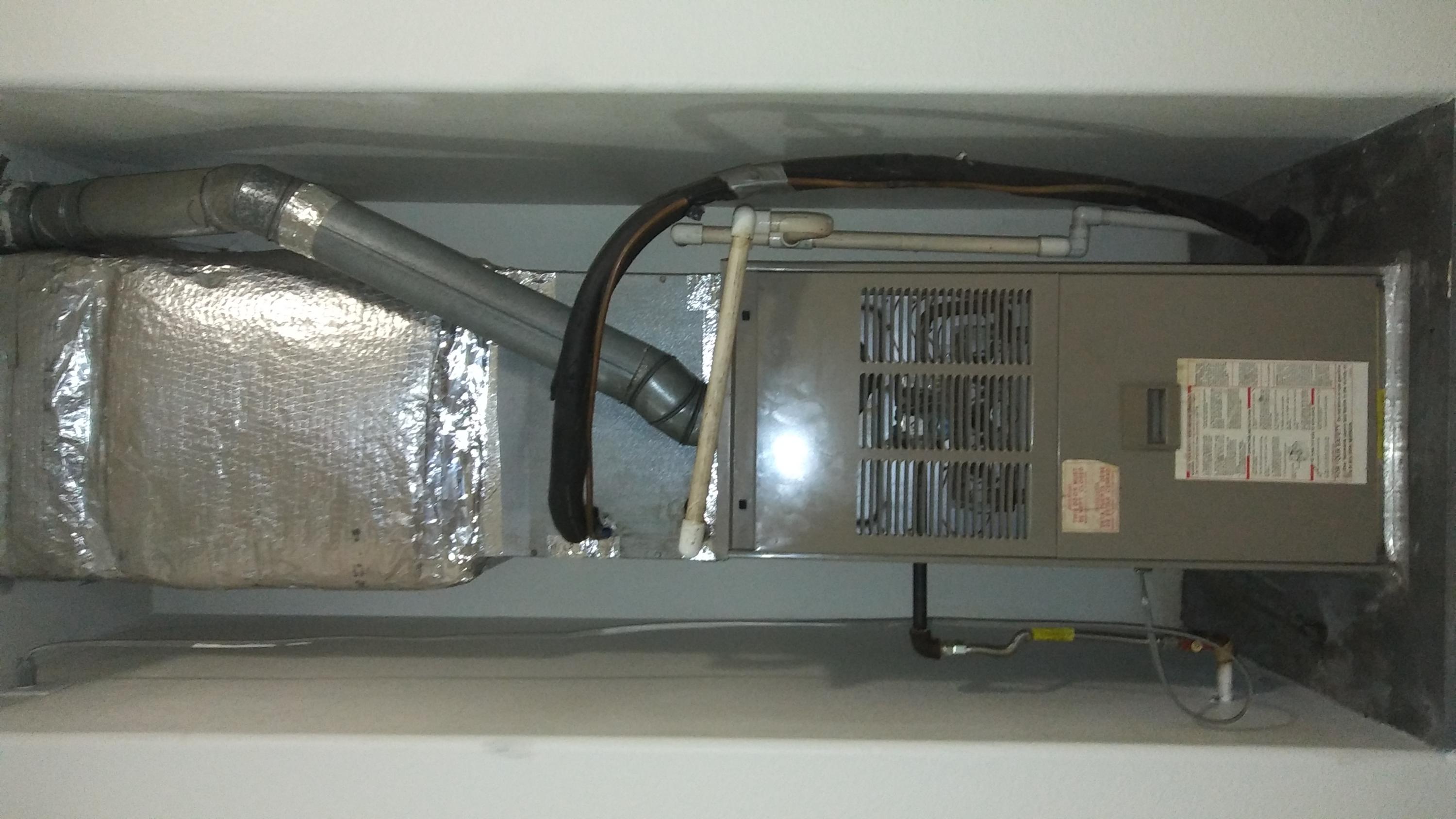

    Green green grass of home. (pic 1,2) Pictures took yesterday, I wear T-shirt and short on this sunshine sunday afternoon, as a weekend handyman.
  • capwizard
    • Jun 2016
    • 1991

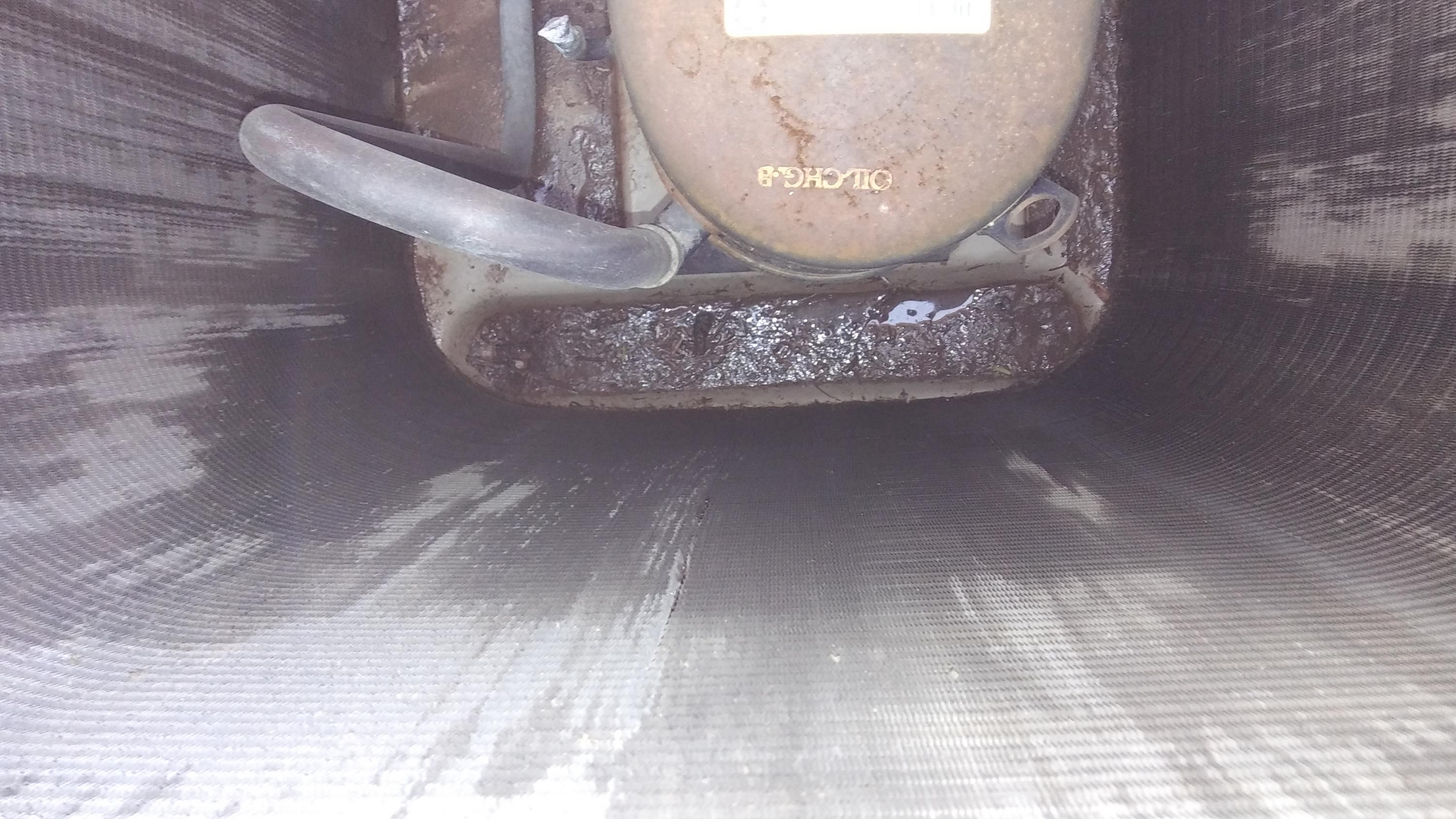

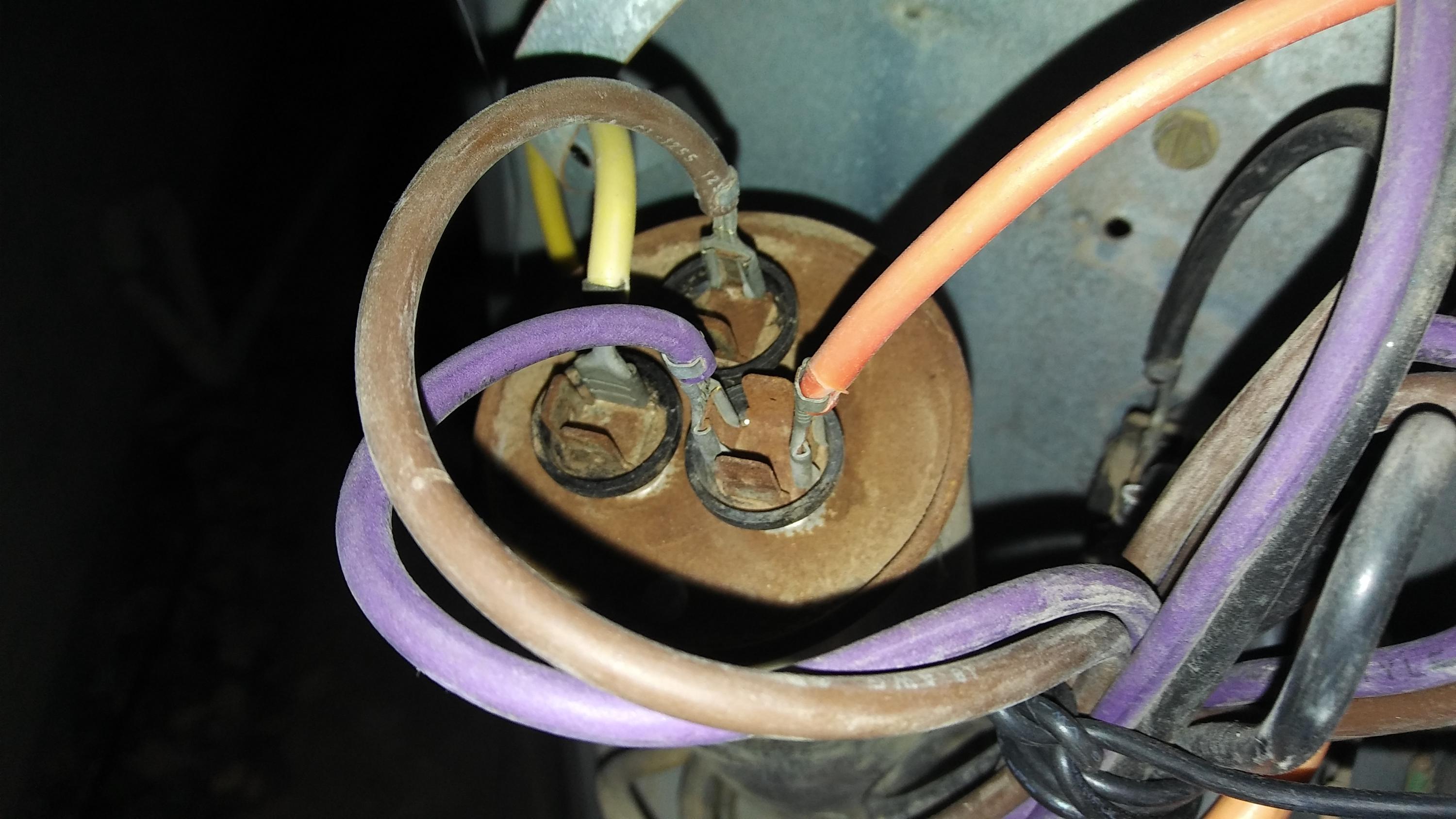

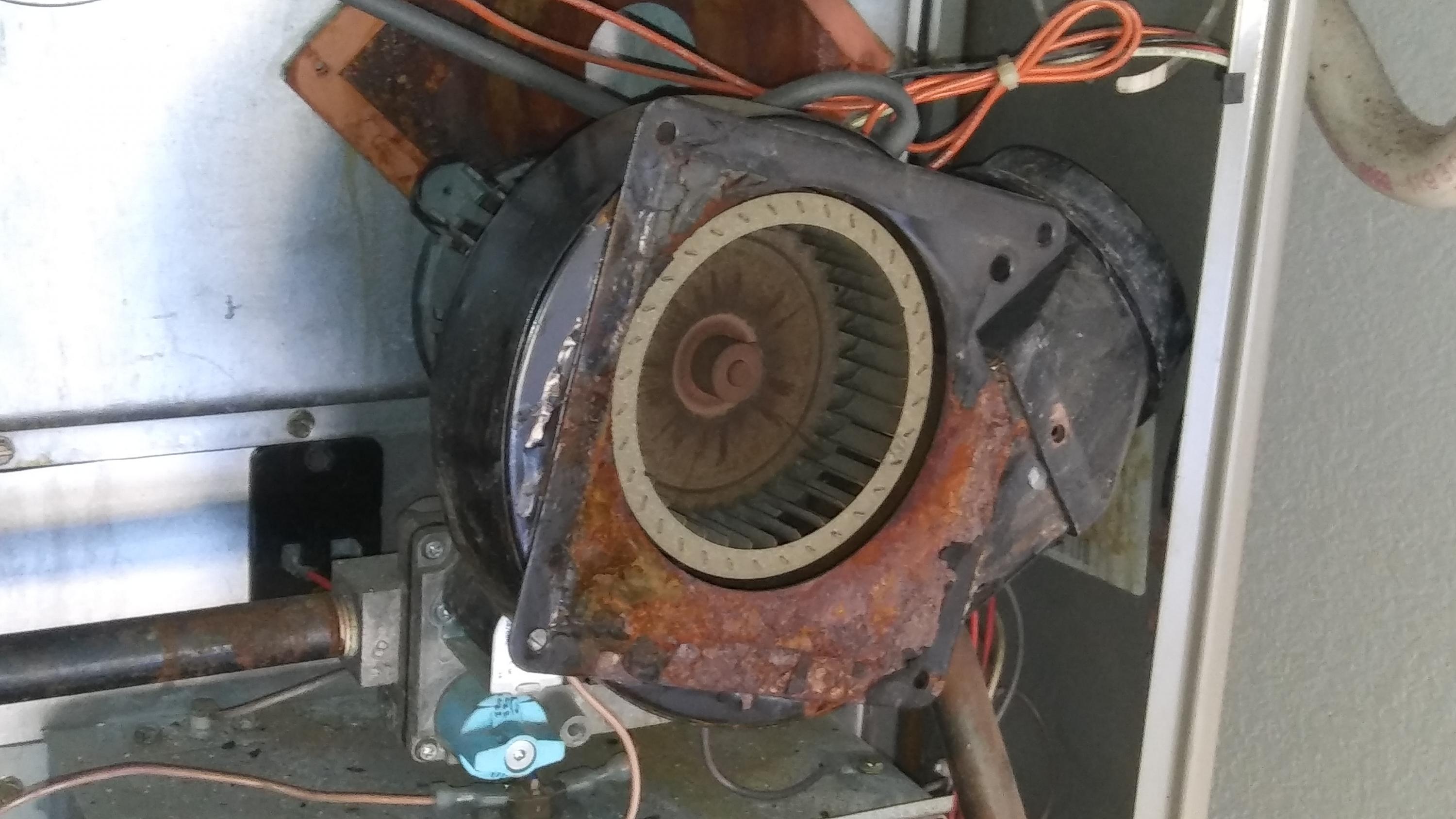

    Re: Routine maintenance on HVAC save you $12,000

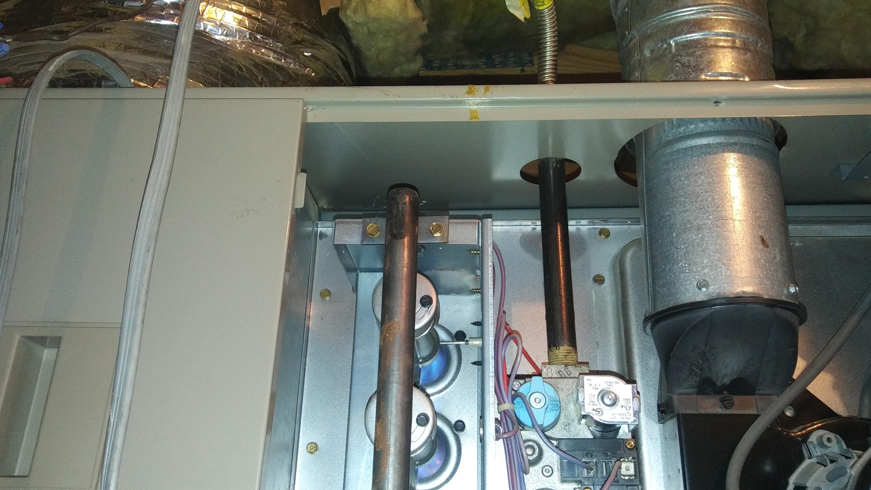

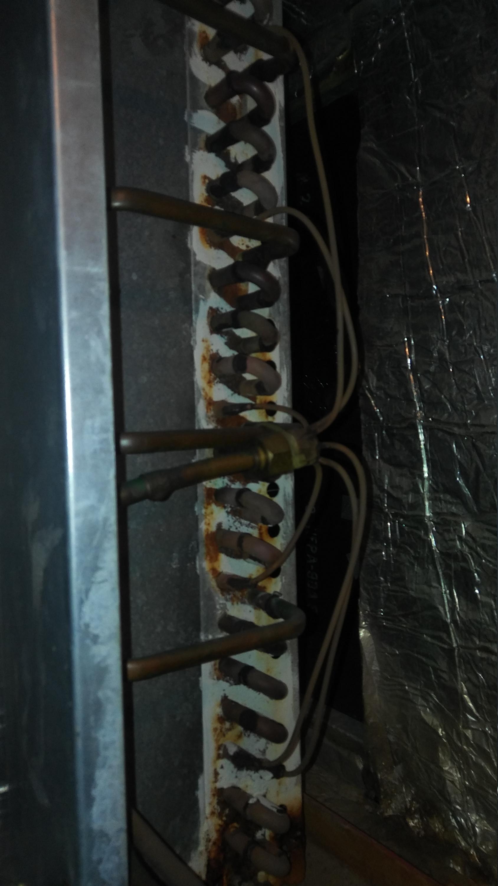

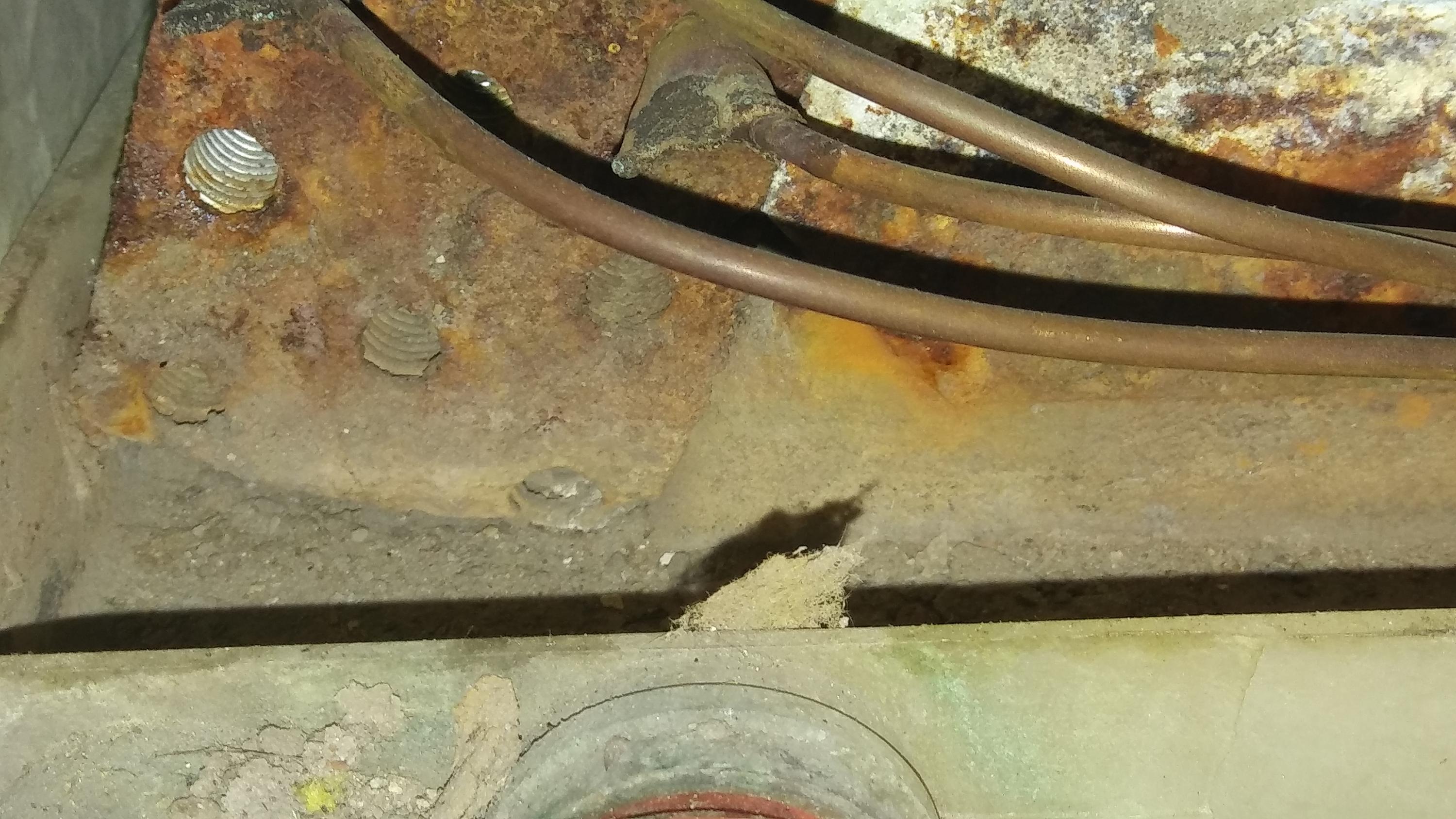

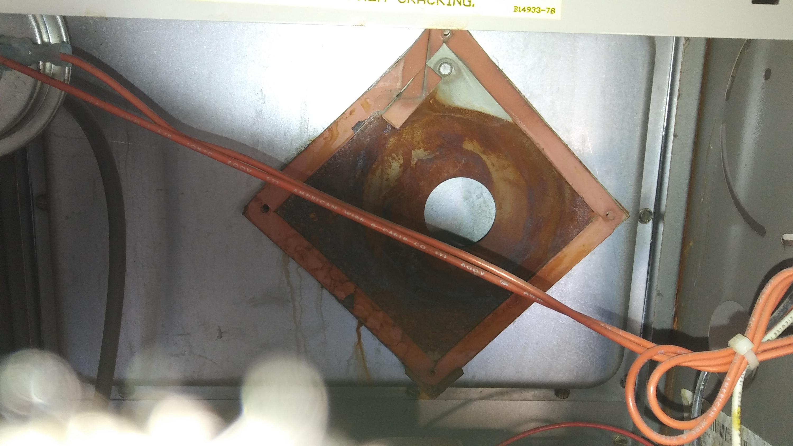

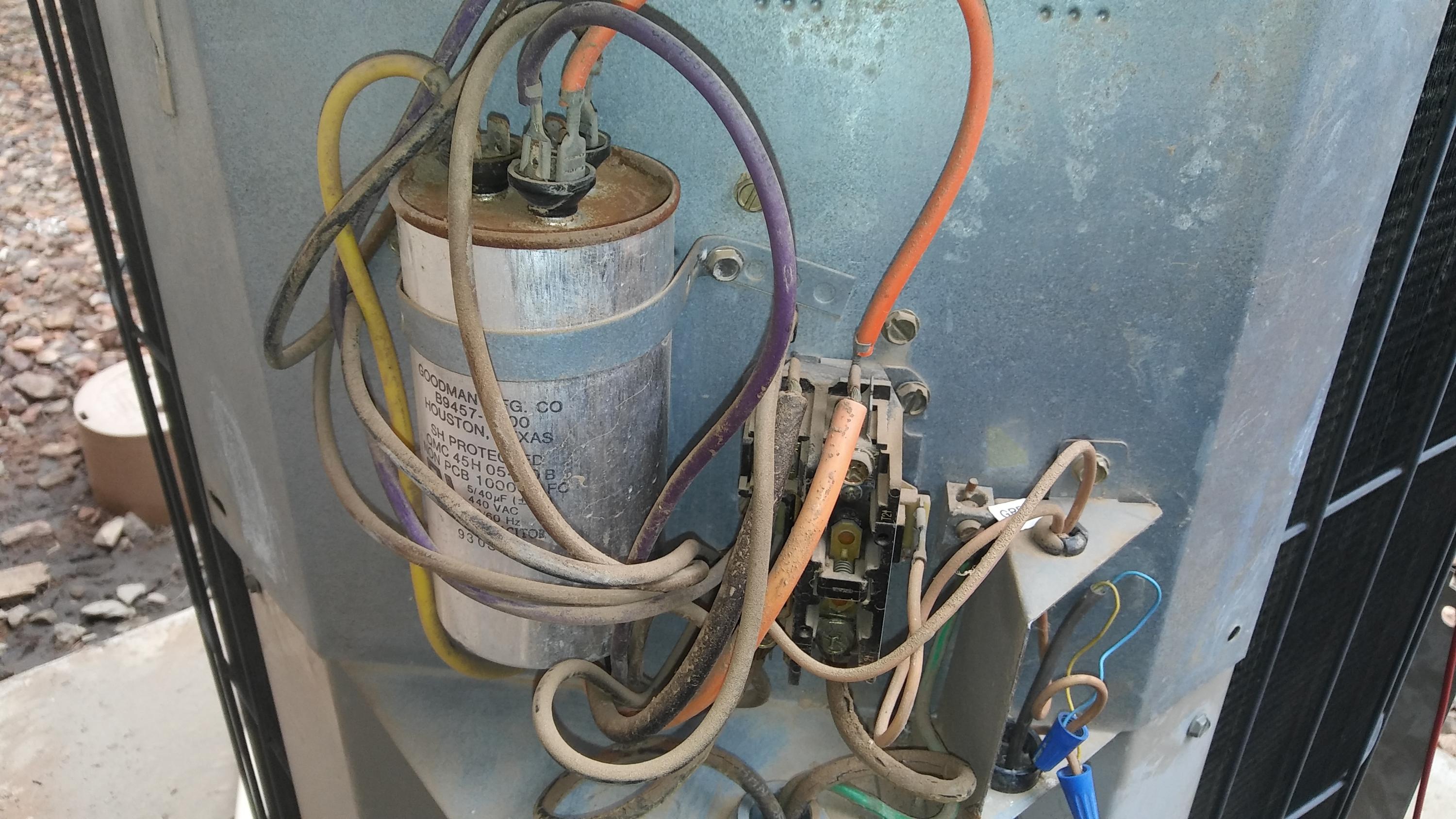

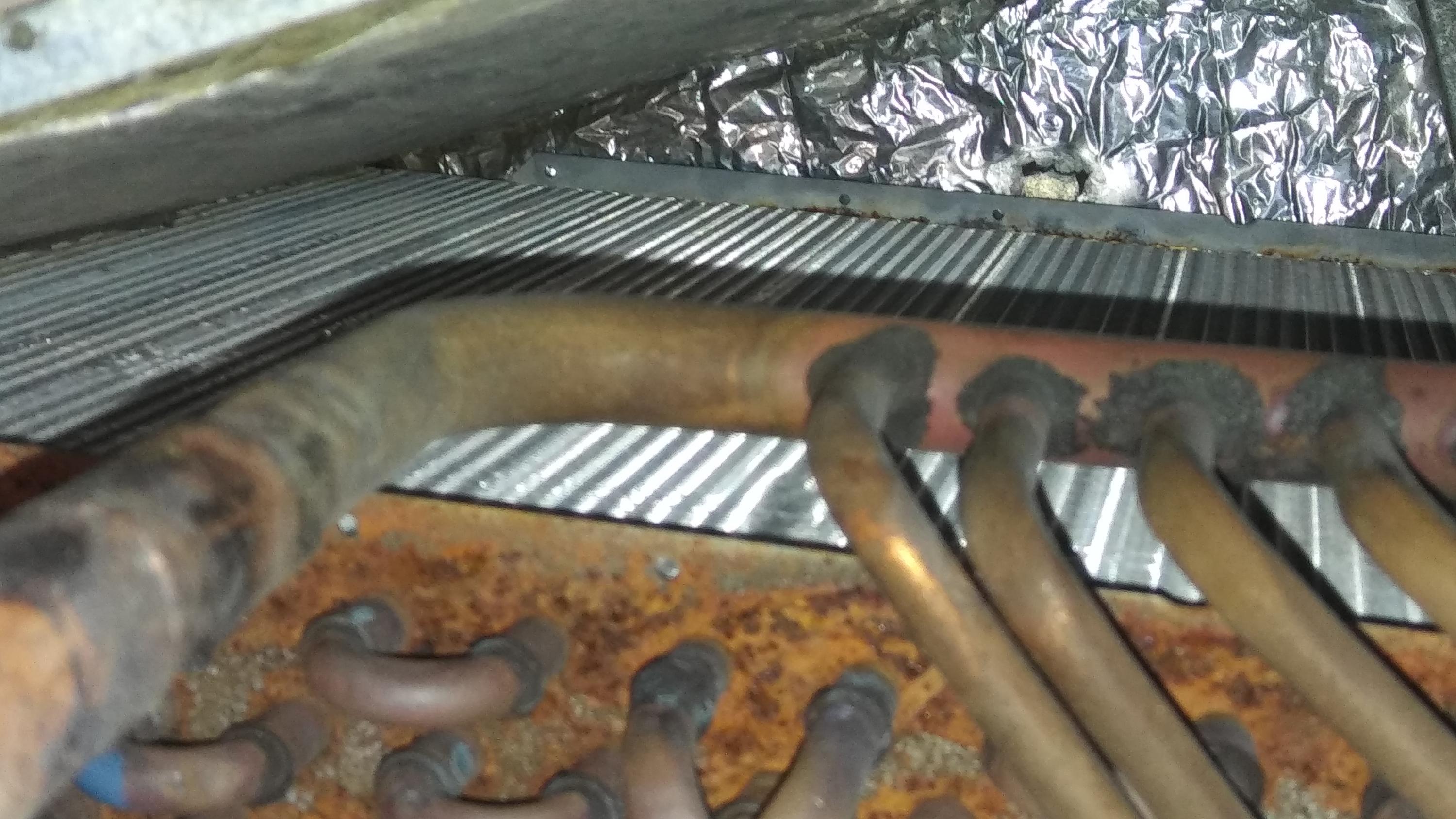

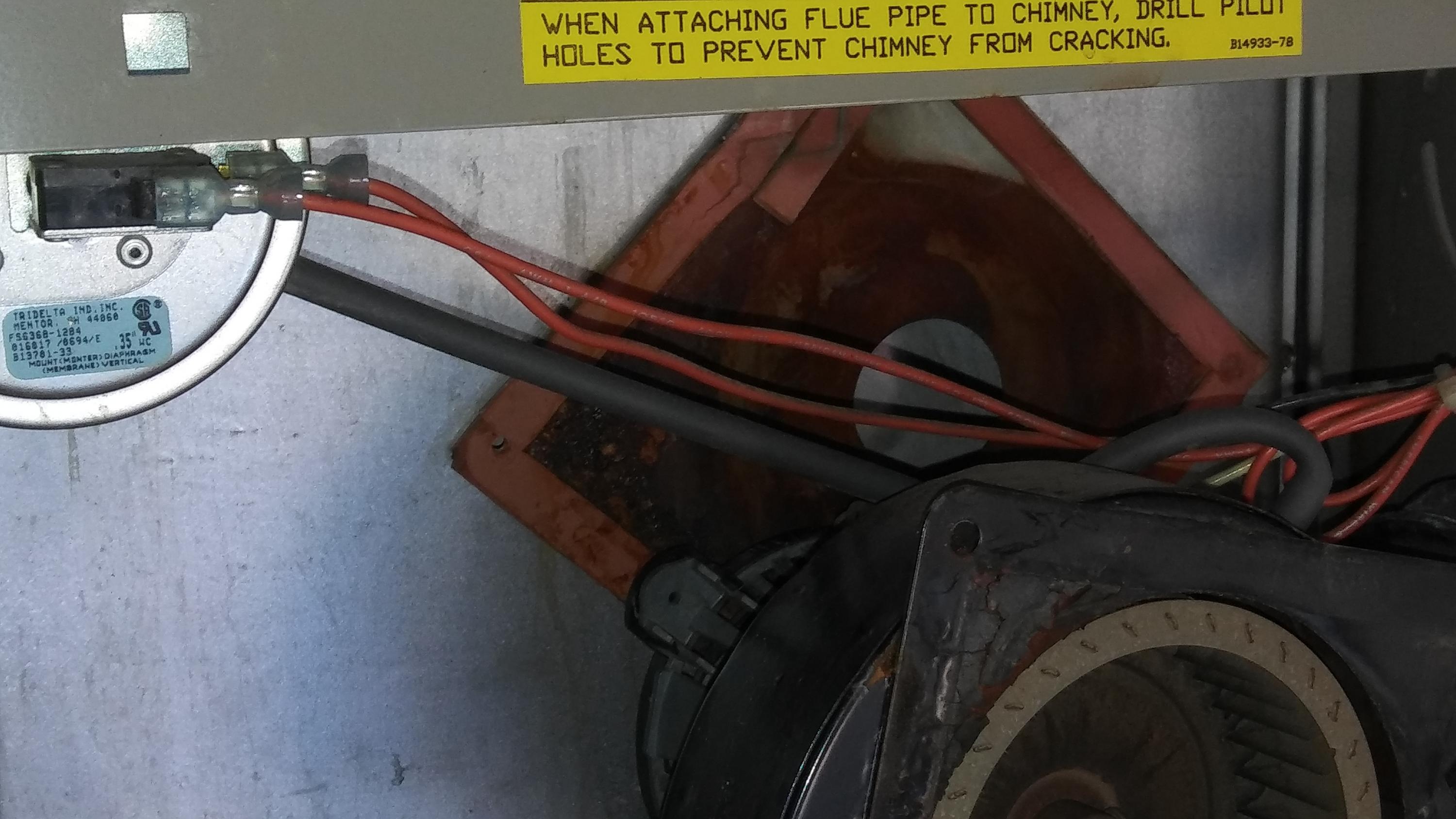

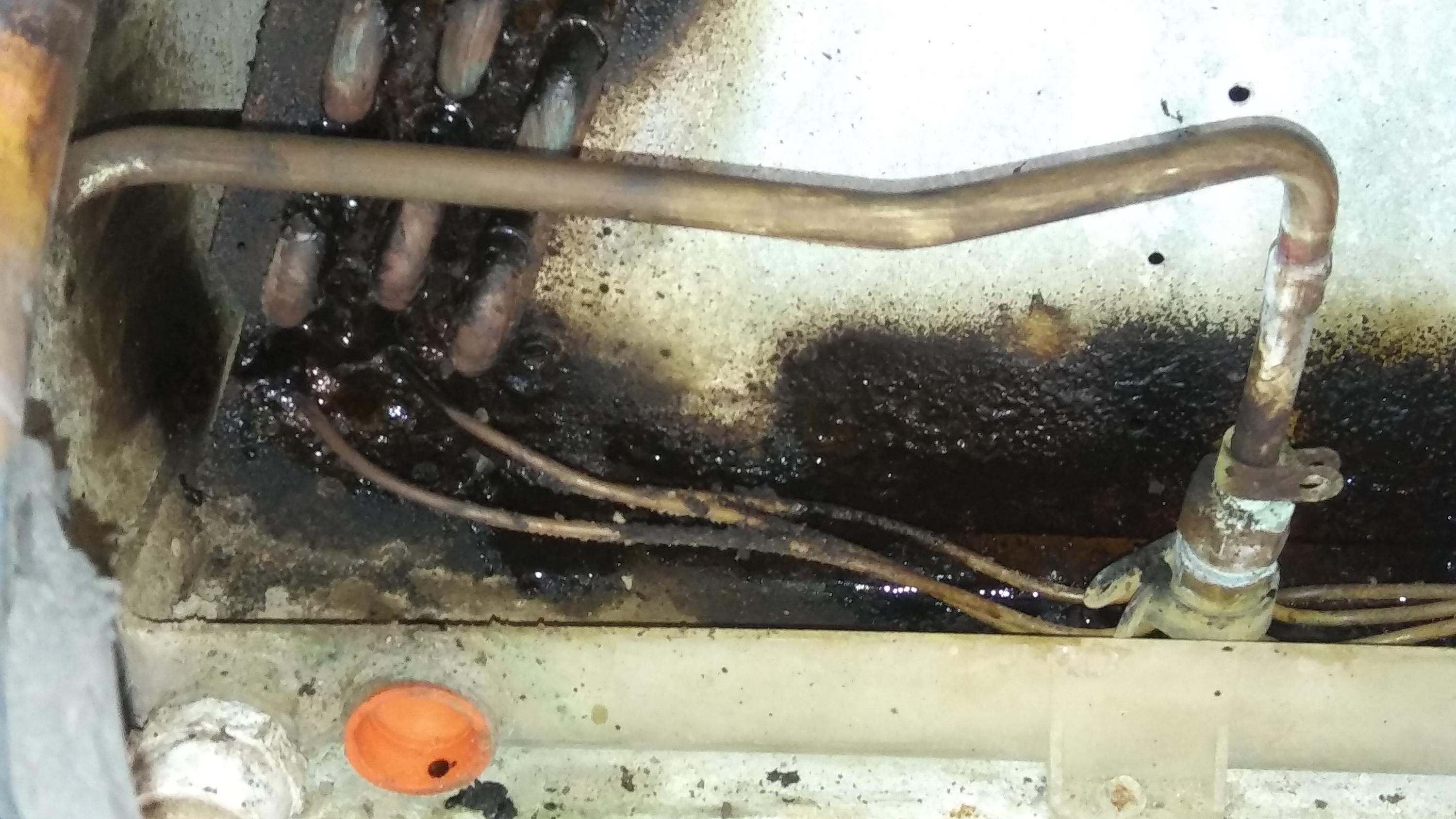

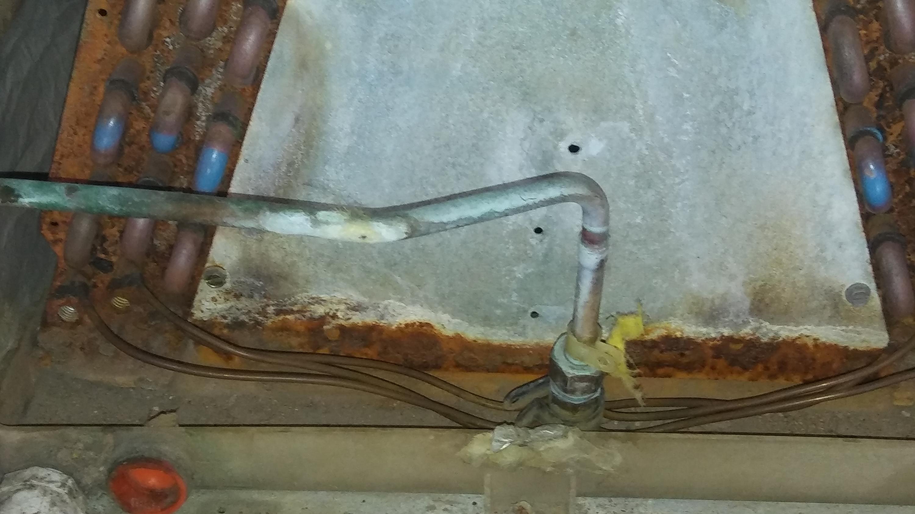

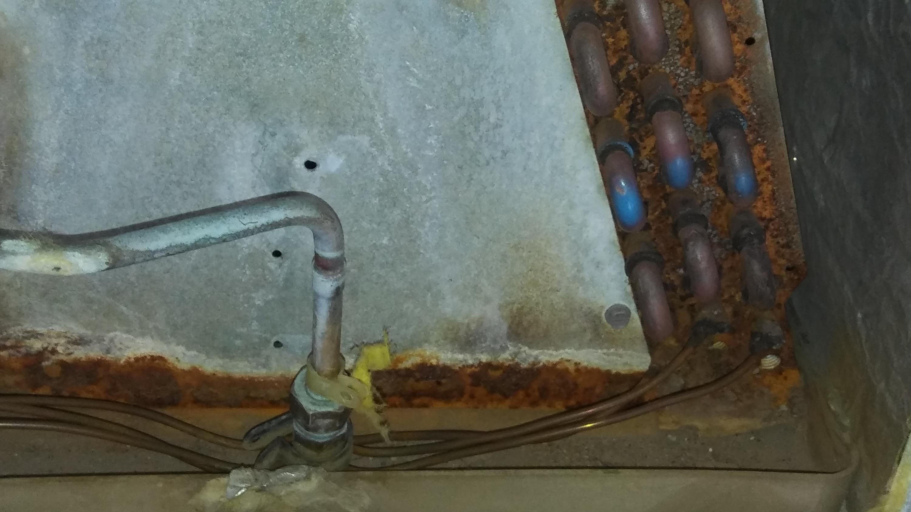

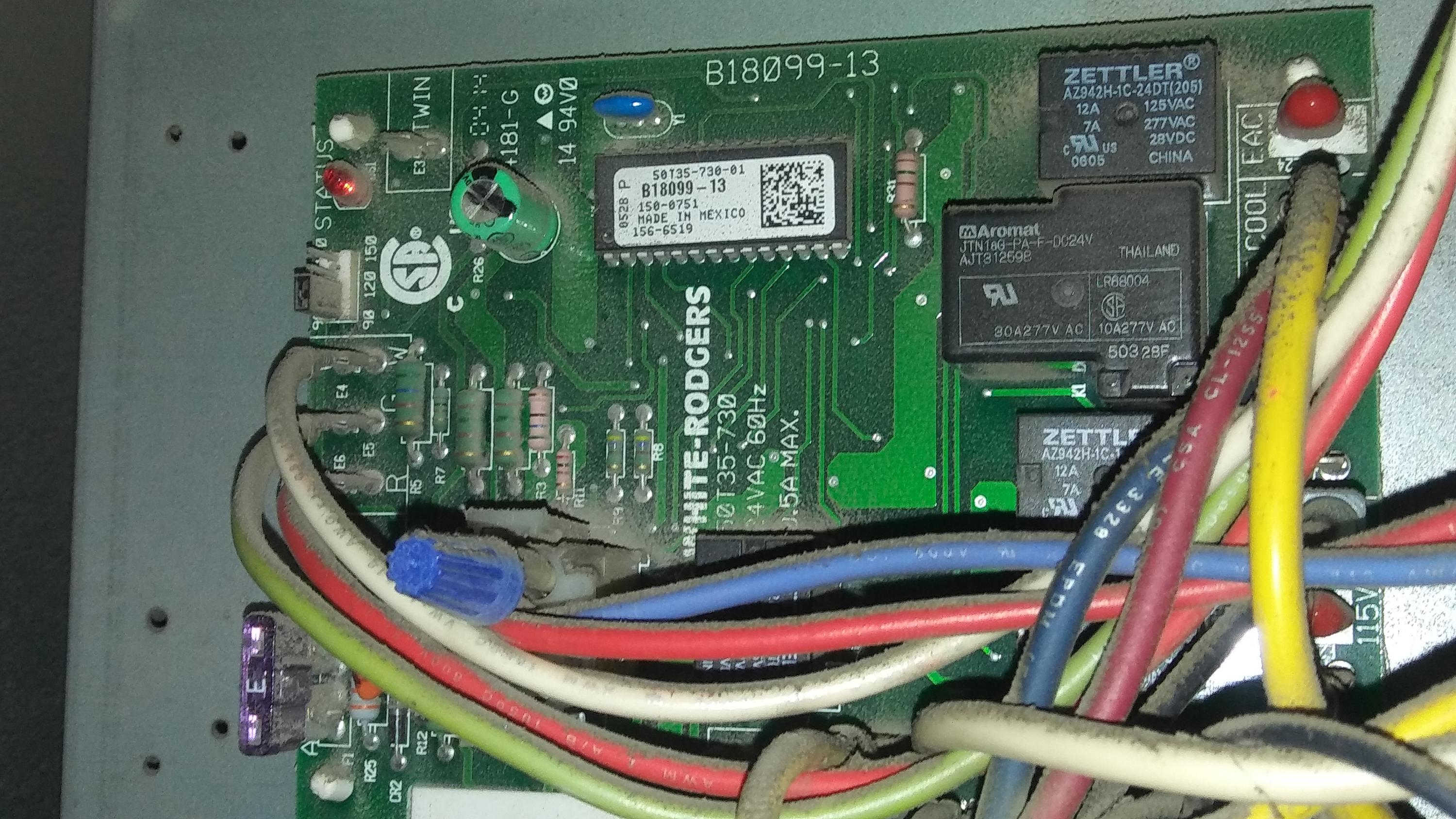

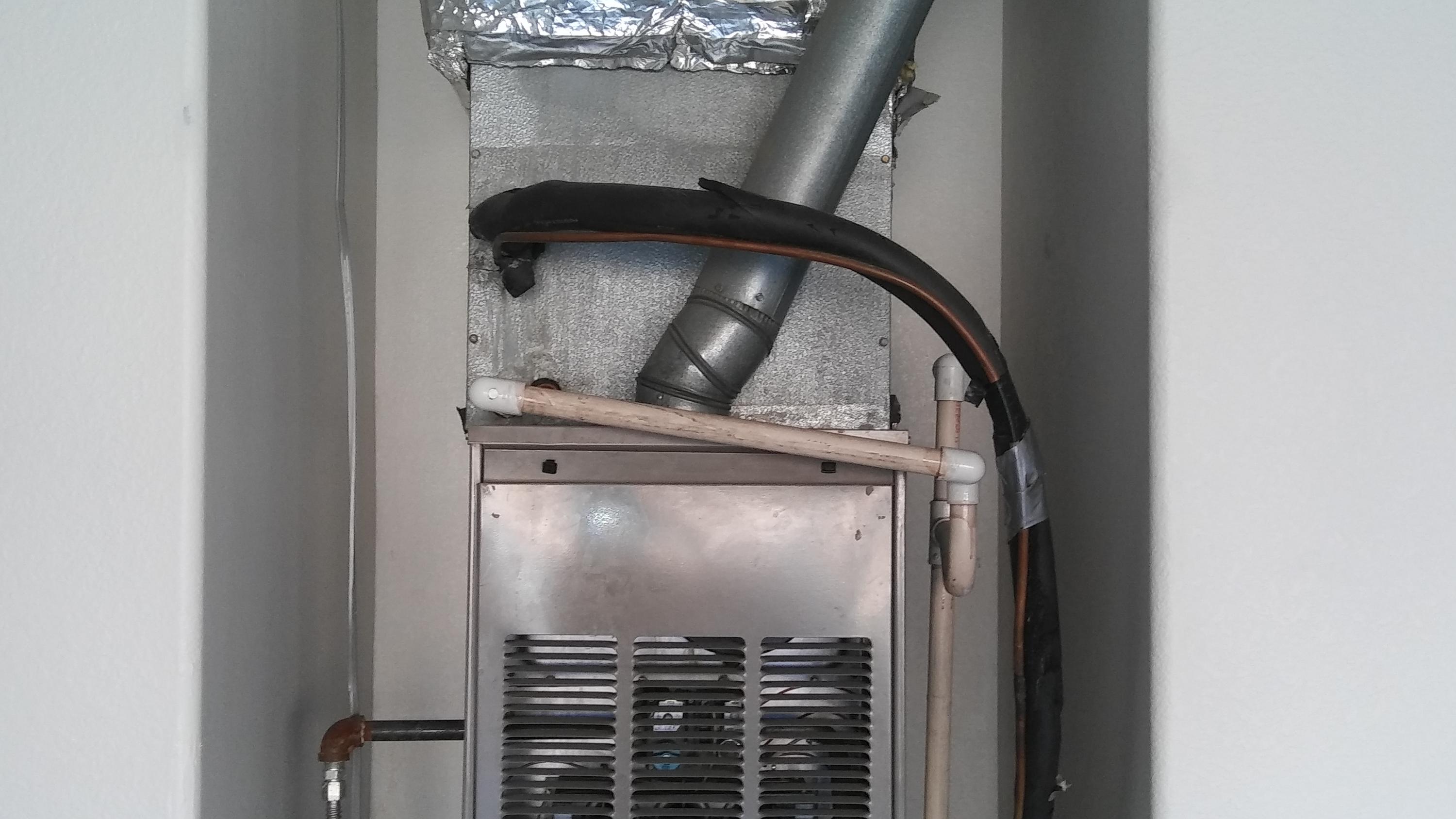

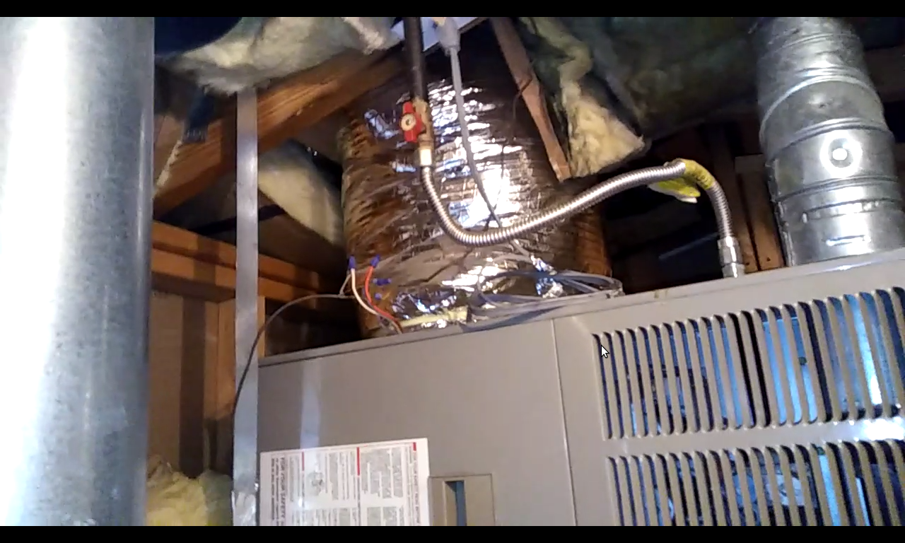

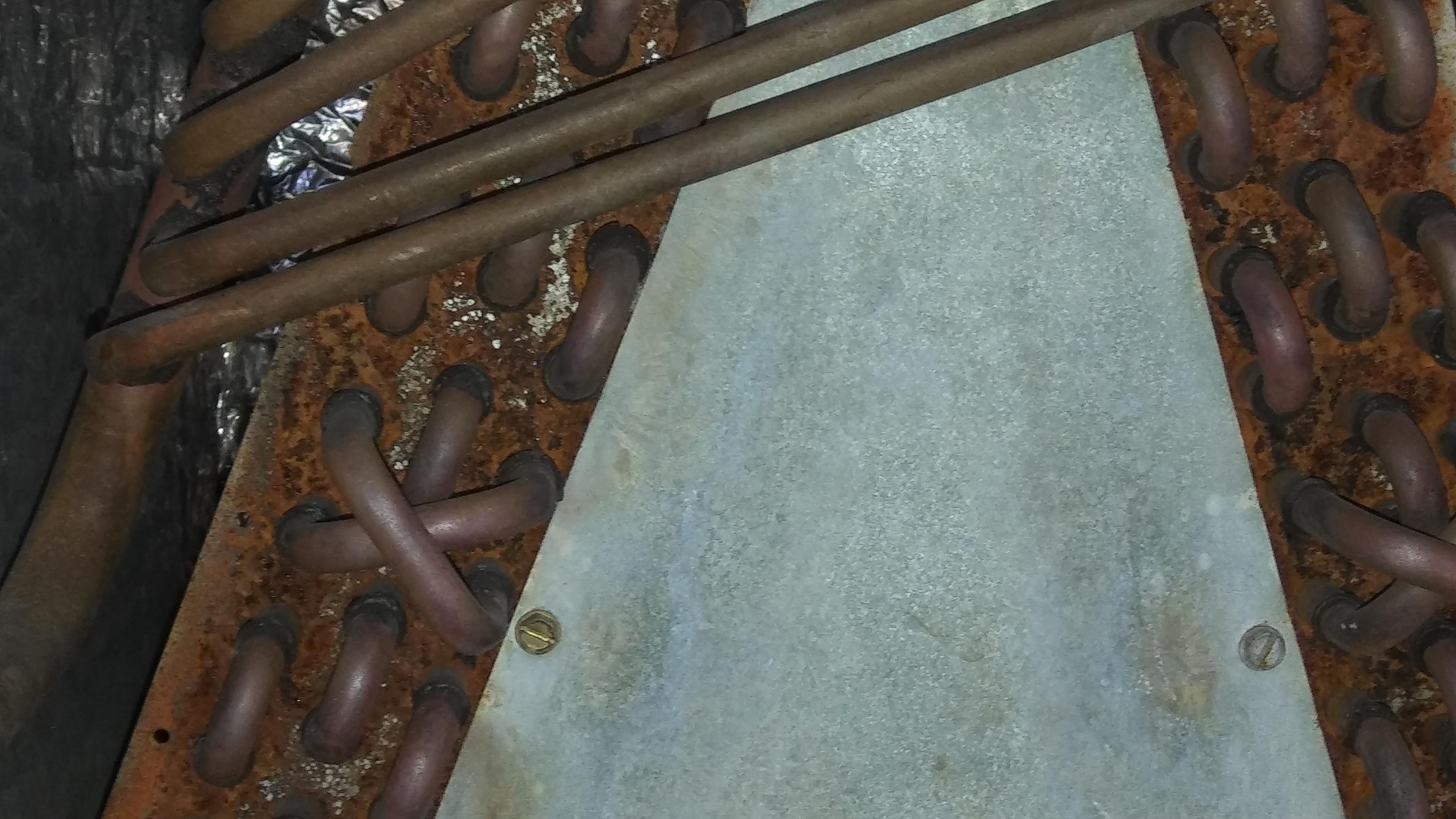

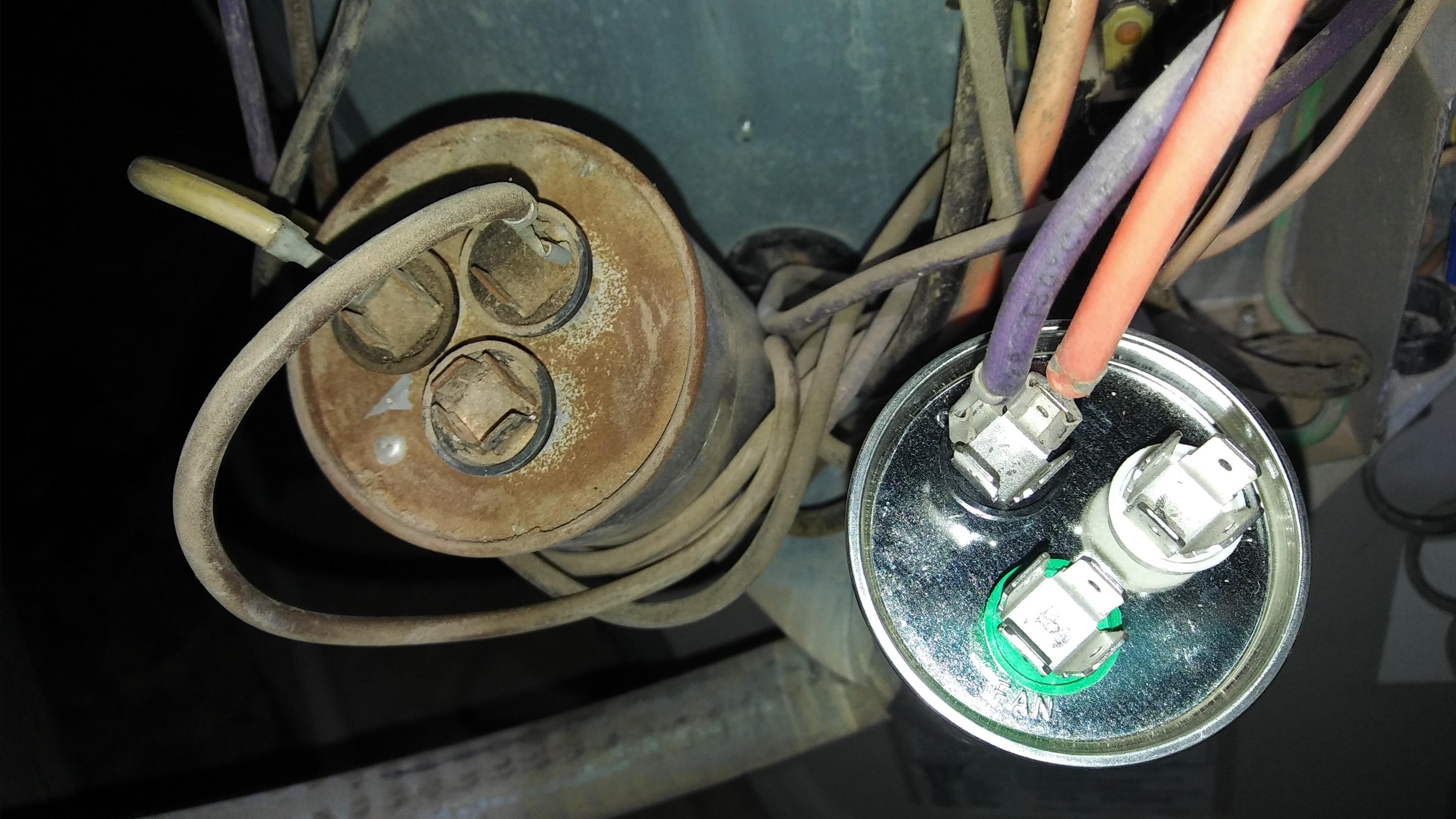

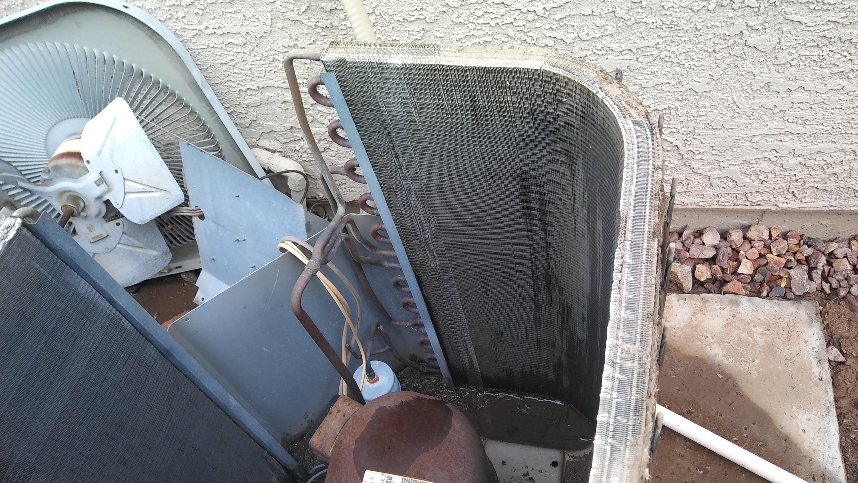

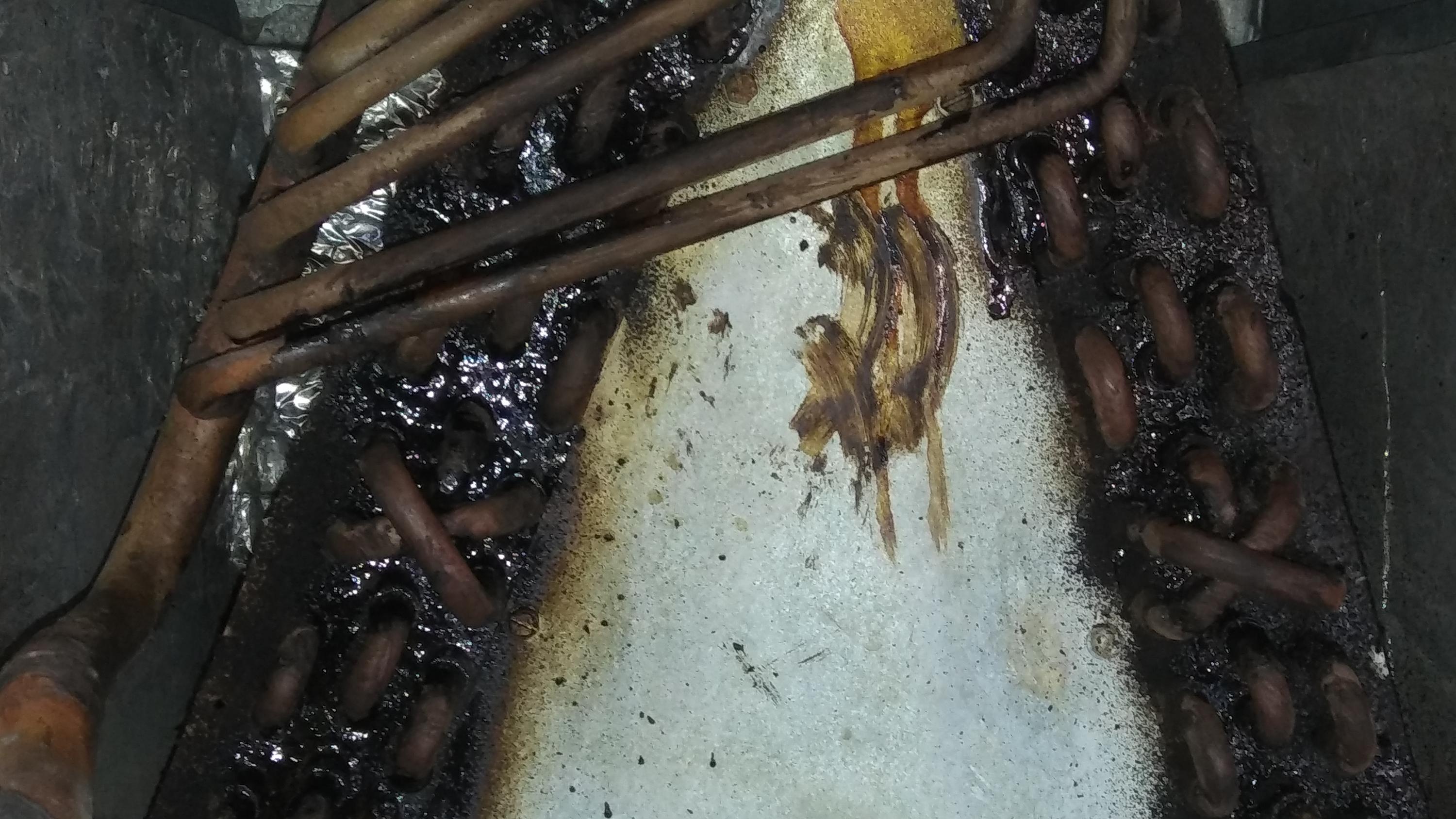

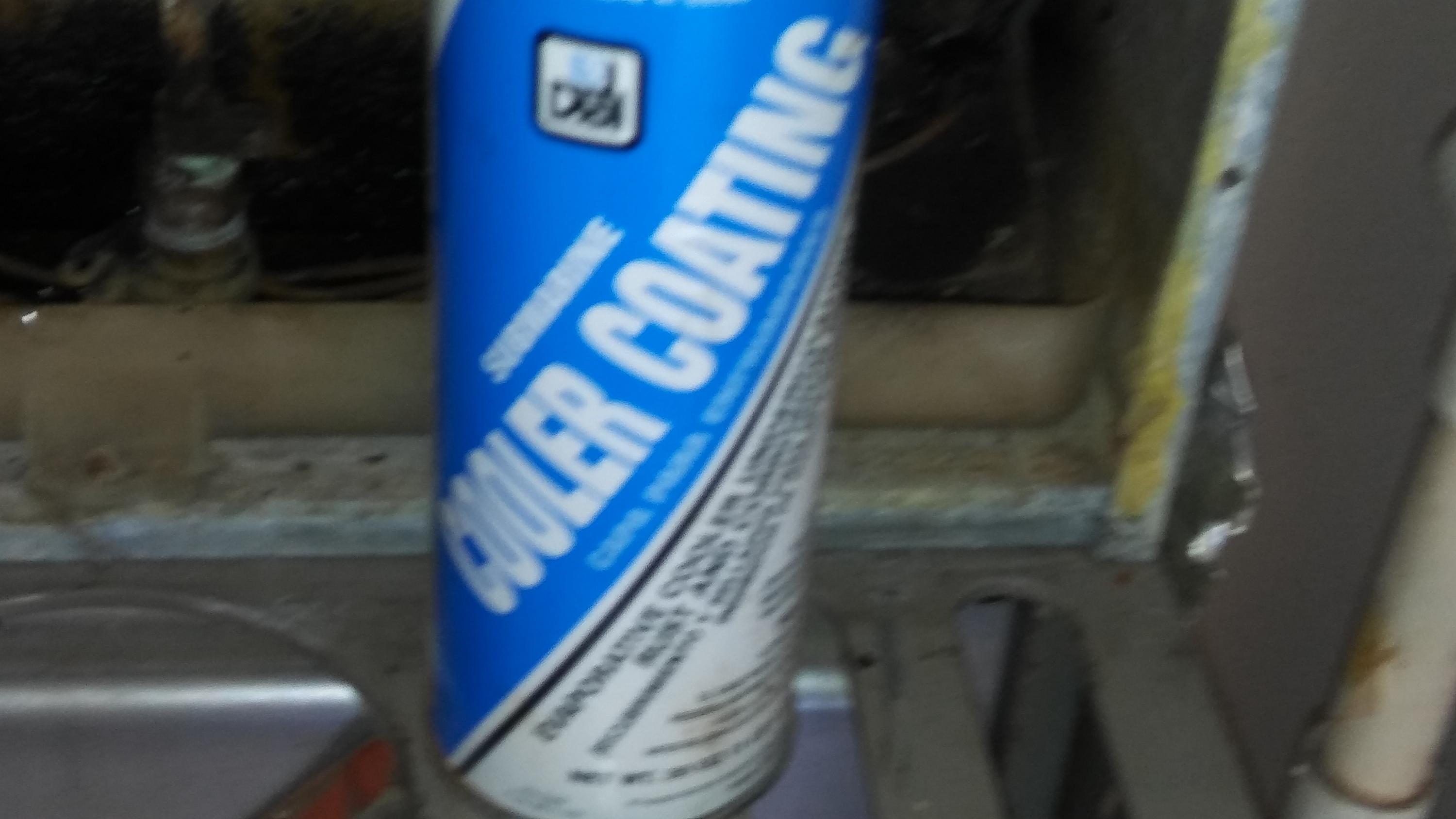

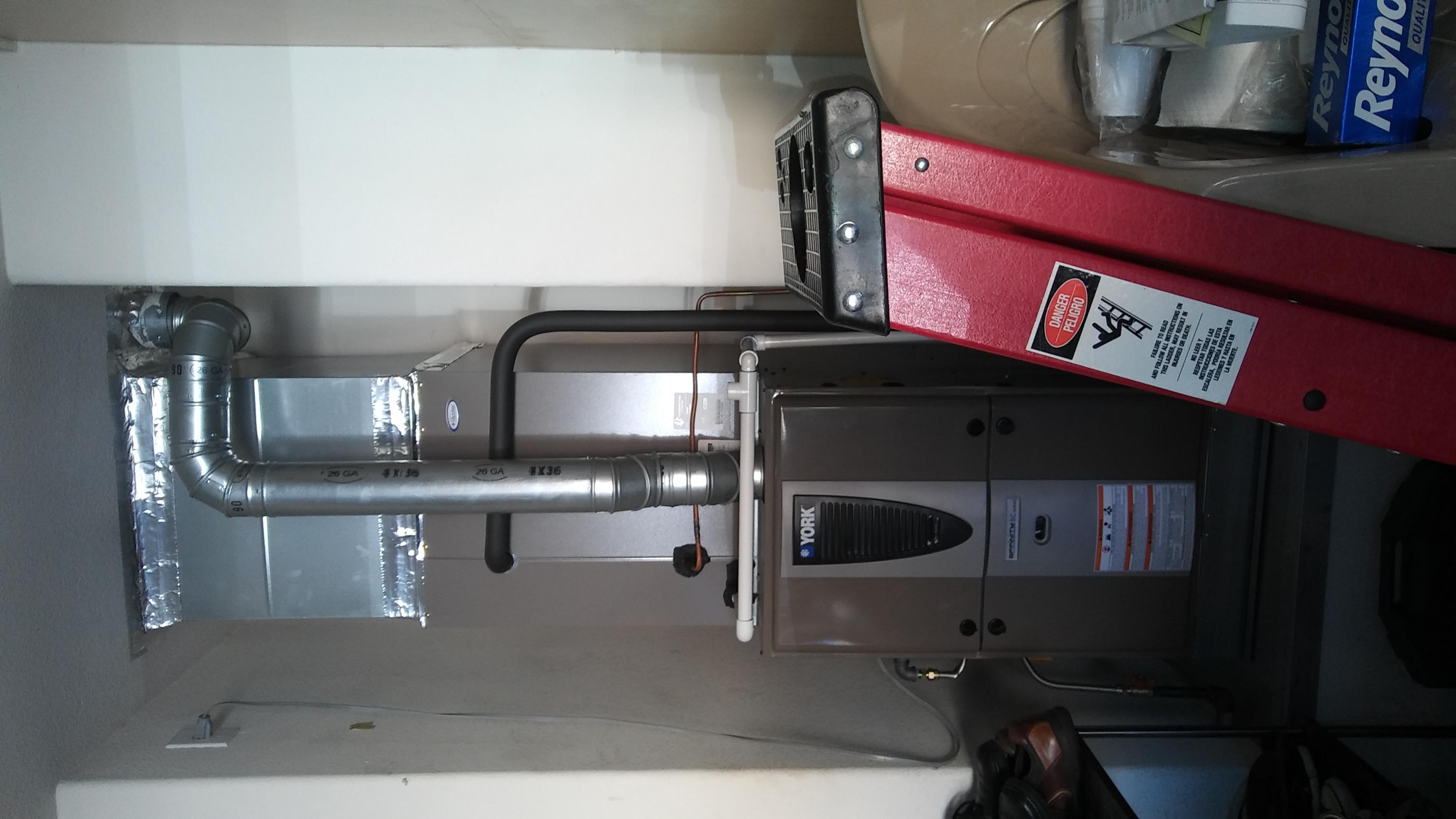

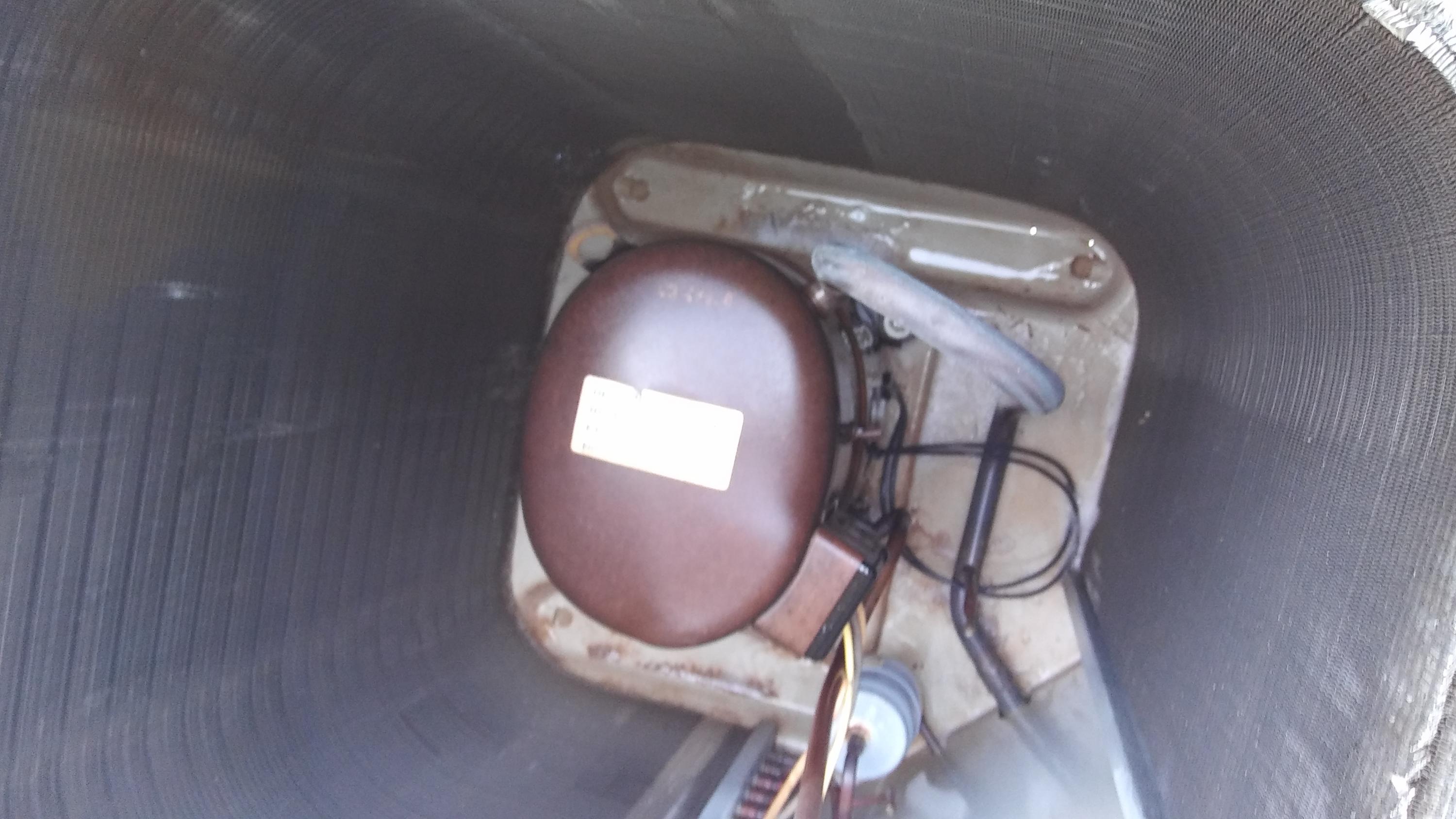

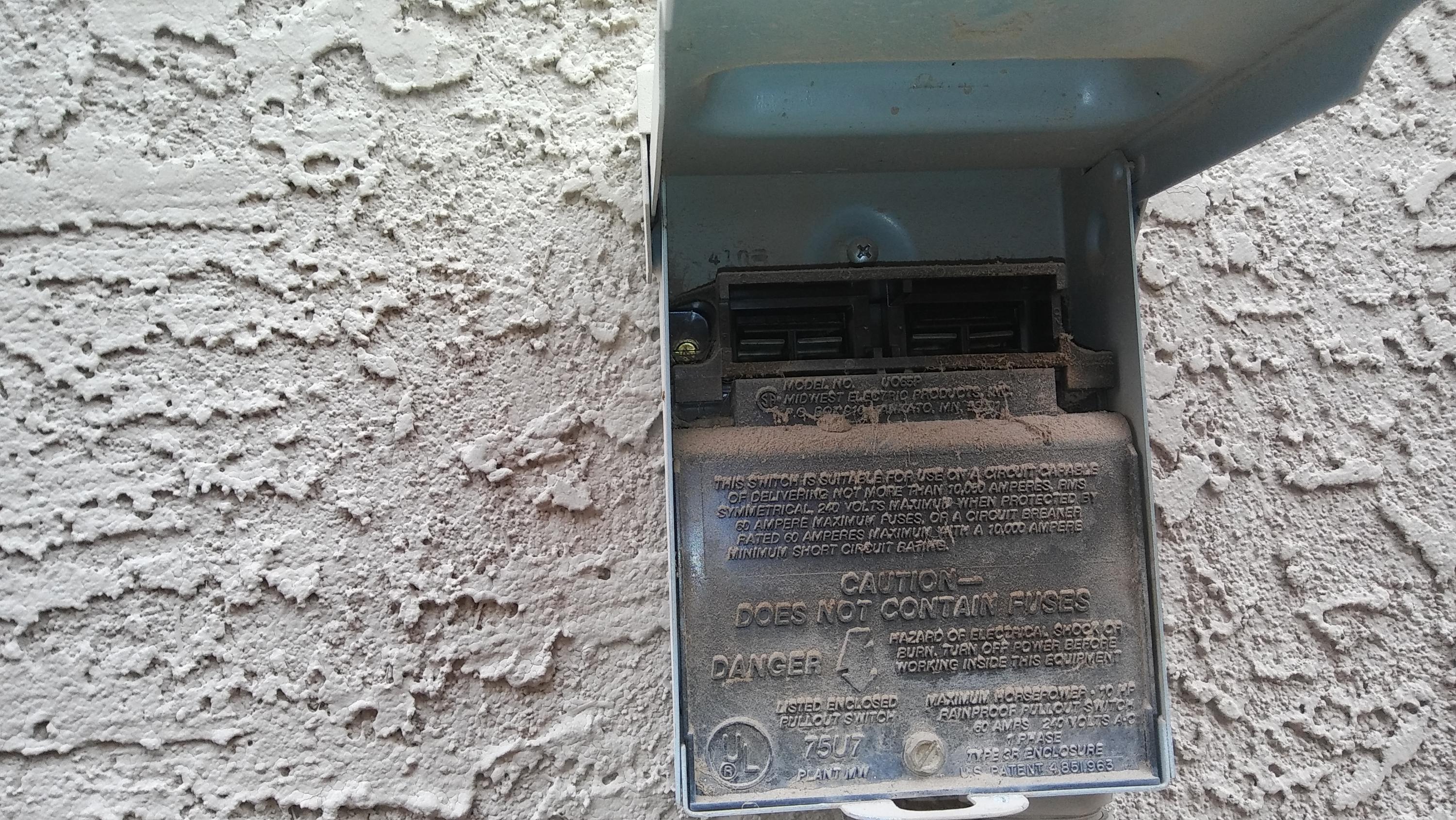

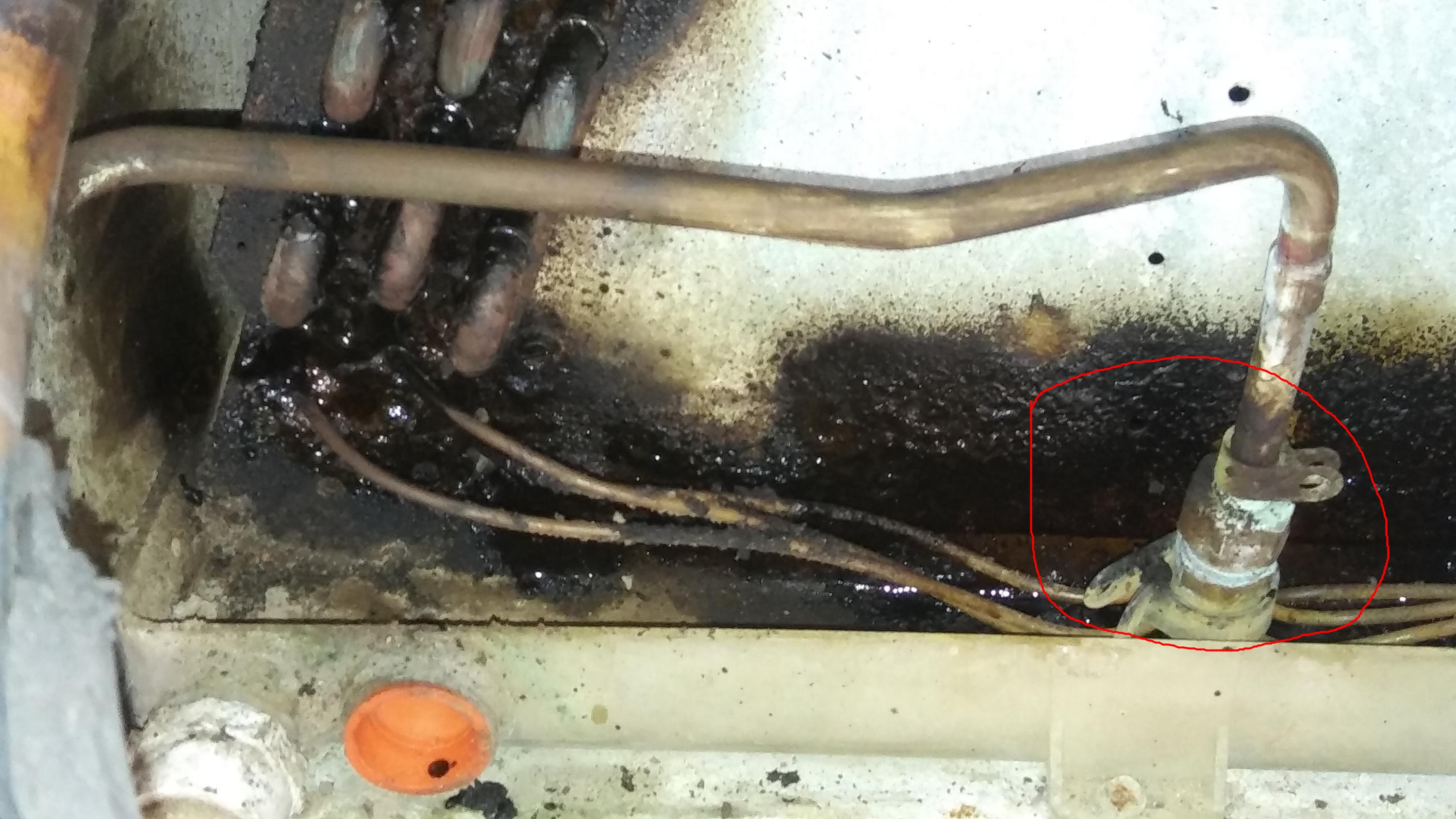

    Opened the exhaust fan from furnace and condenser of the cooler HAVC which on top of the furnace.
    PS: This Goodman system, Id changed 10uf capacitor for blower fan, control PCB, flame roll out switch and sprayed rust prevention.
    PS: I found out the water leak is from fireplace chimney thought the furnace's exhaust fan, not from AS- I- Thought-condenser of the cooler ! (pic15)

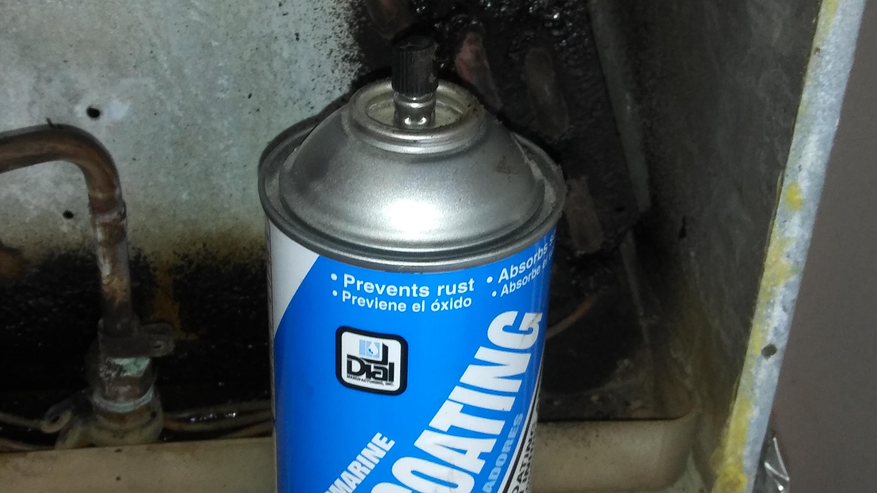

    PS: the Cooler Coating spray (Homedepot) is a nasty stuff like TAR.

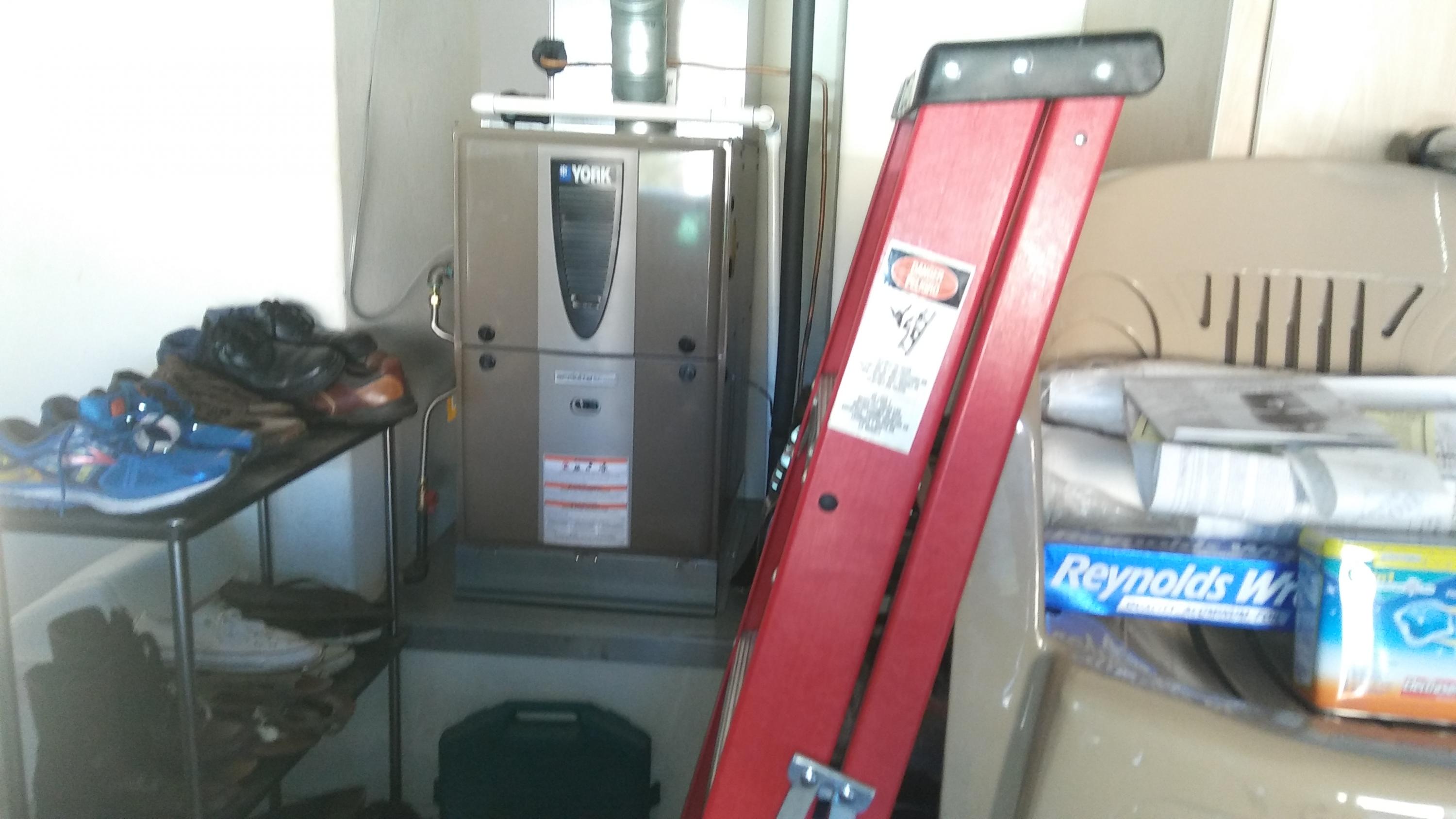

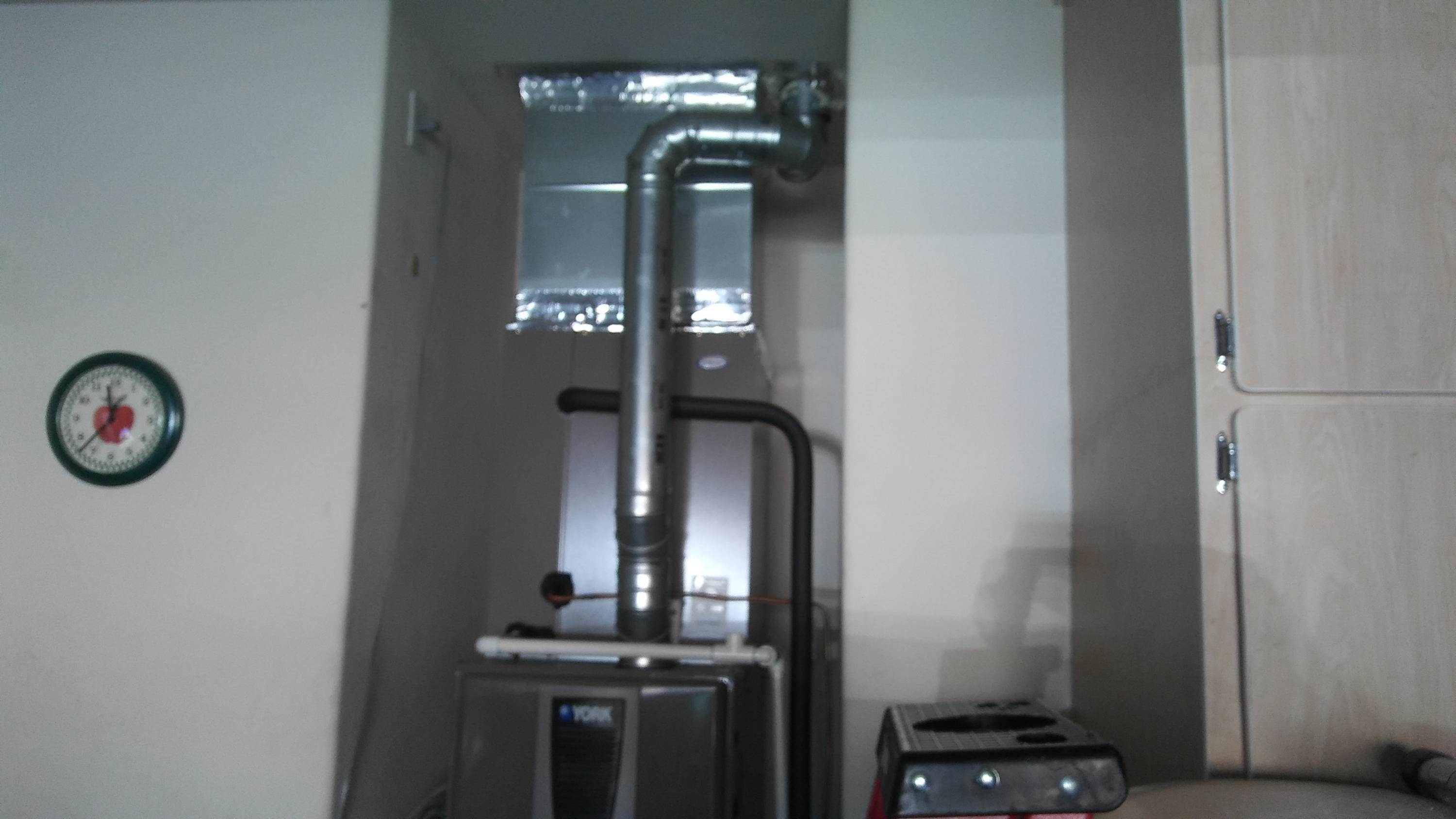

      i am showing off to the neighbors, now they all want me be their Handyman!!!......
      She said " Id changed the system to YORK two years ago for $12,000 they installed in just one day, and the most of neighbors did.", and how well her kids doing in the school gonna be a MD Doctor.........bohr....bohr ....bohr........"
      PS: OK, I will keep my ANTIQUE Goodman runs as long as I can!!!!

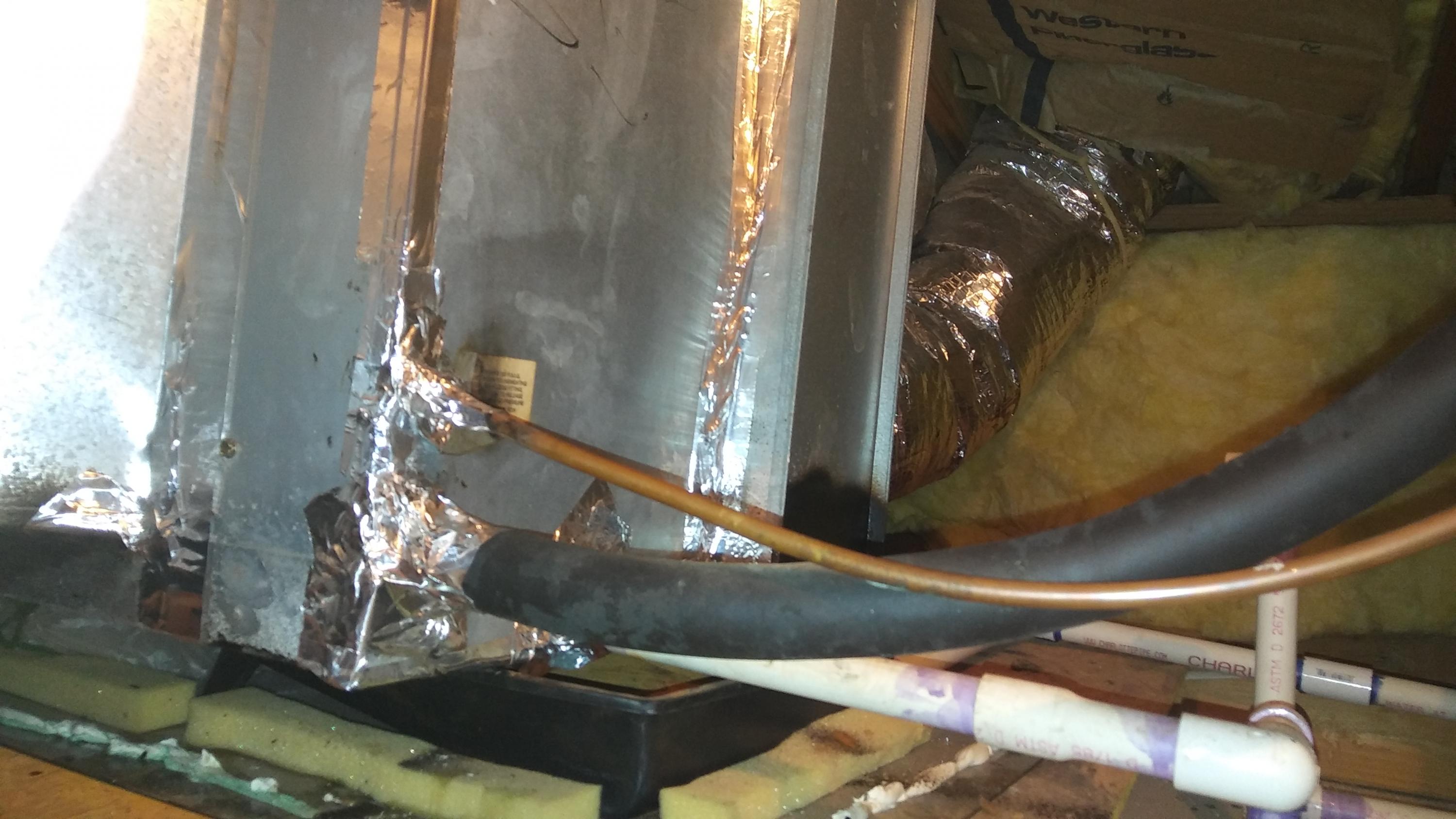

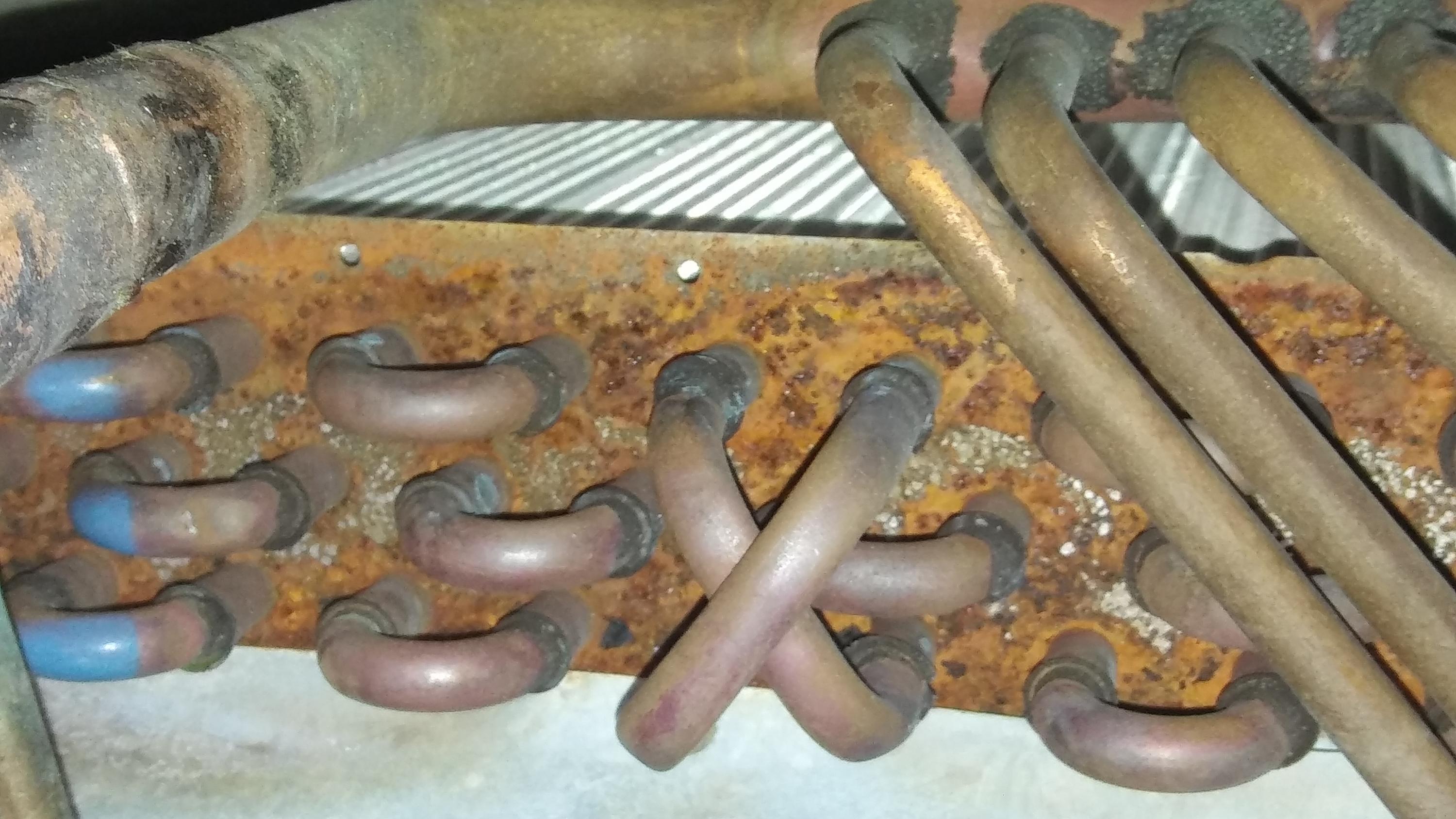

              i'm an amateur.........This is my preconceived opinions , Hope, someone might give me better ideas. let us save money together.

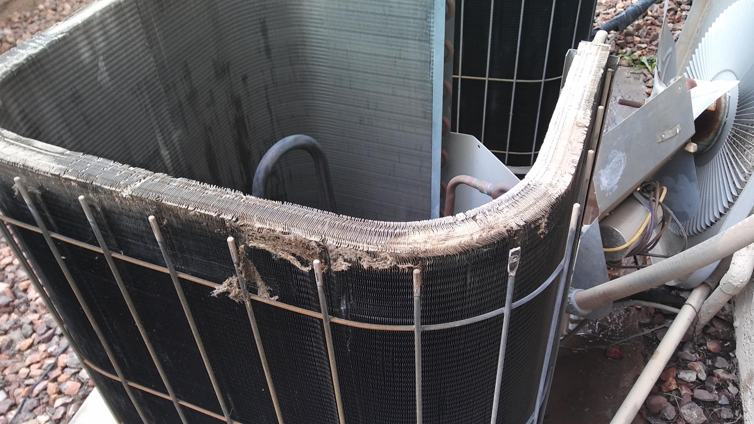

              How to clean the copper fittings and connectors: brush with WD40 then heavy grease. (prevent freon leakage)
              PS: Why I said "brush with WD40" ......I [canopener] the non-air-WD40 can, correct the oil, put in the cosmetic spray bottle, reuse it.
              How to clean the fins of the condenser: First DustOff + spray vinegar + brush with baking soda powder + water off the bubbles.

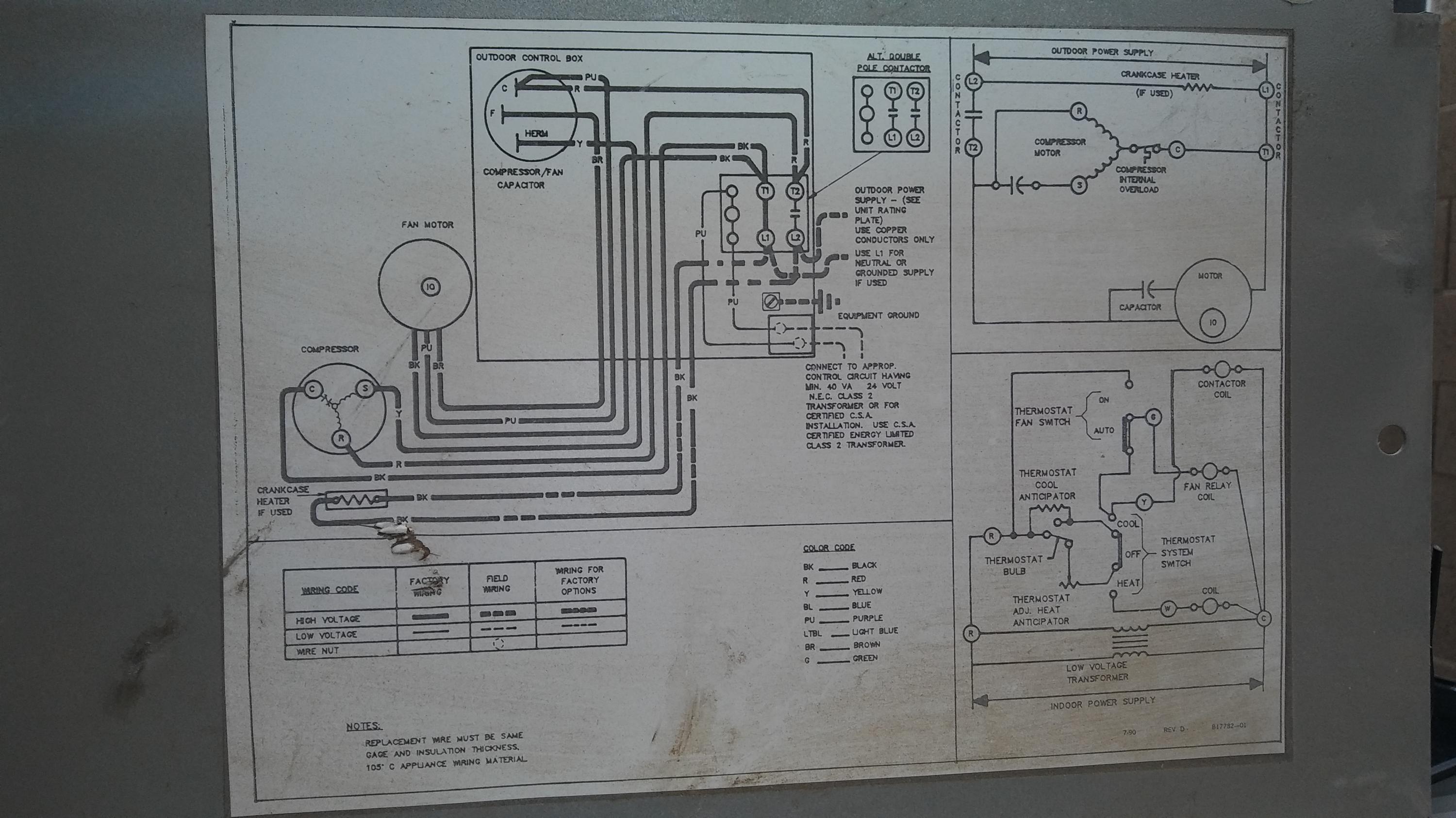

              pic3 Printable checklist
              http://www.hvacsticker.com/images/pr...ecklist-lg.jpg
              pic4 Printable checklist
              http://www.sawyoo.com/postpic/2013/1...pdf_617493.png

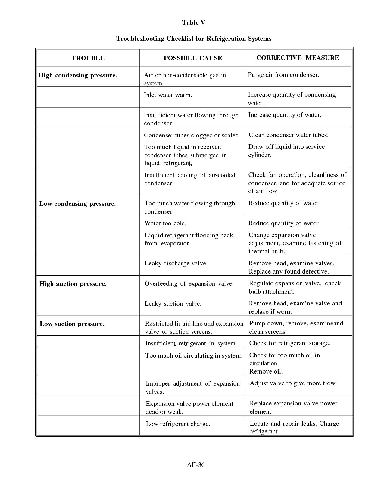

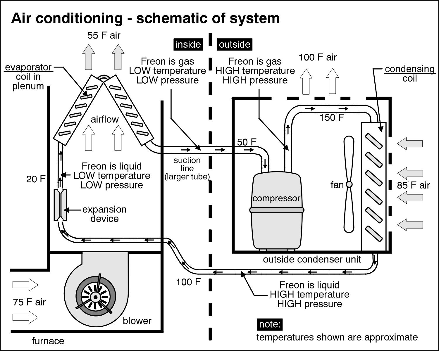

                I believe the temperatures in your picture are wrong. After the expansion valve it needs to be above 32 F so condensation does not freeze on evaporator. I also believe after compressor it will be much higher than 150 F.

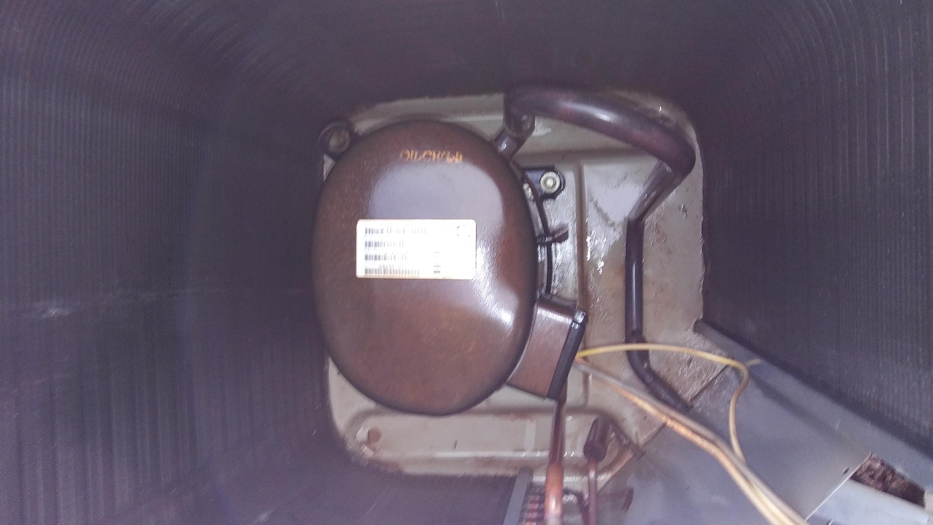

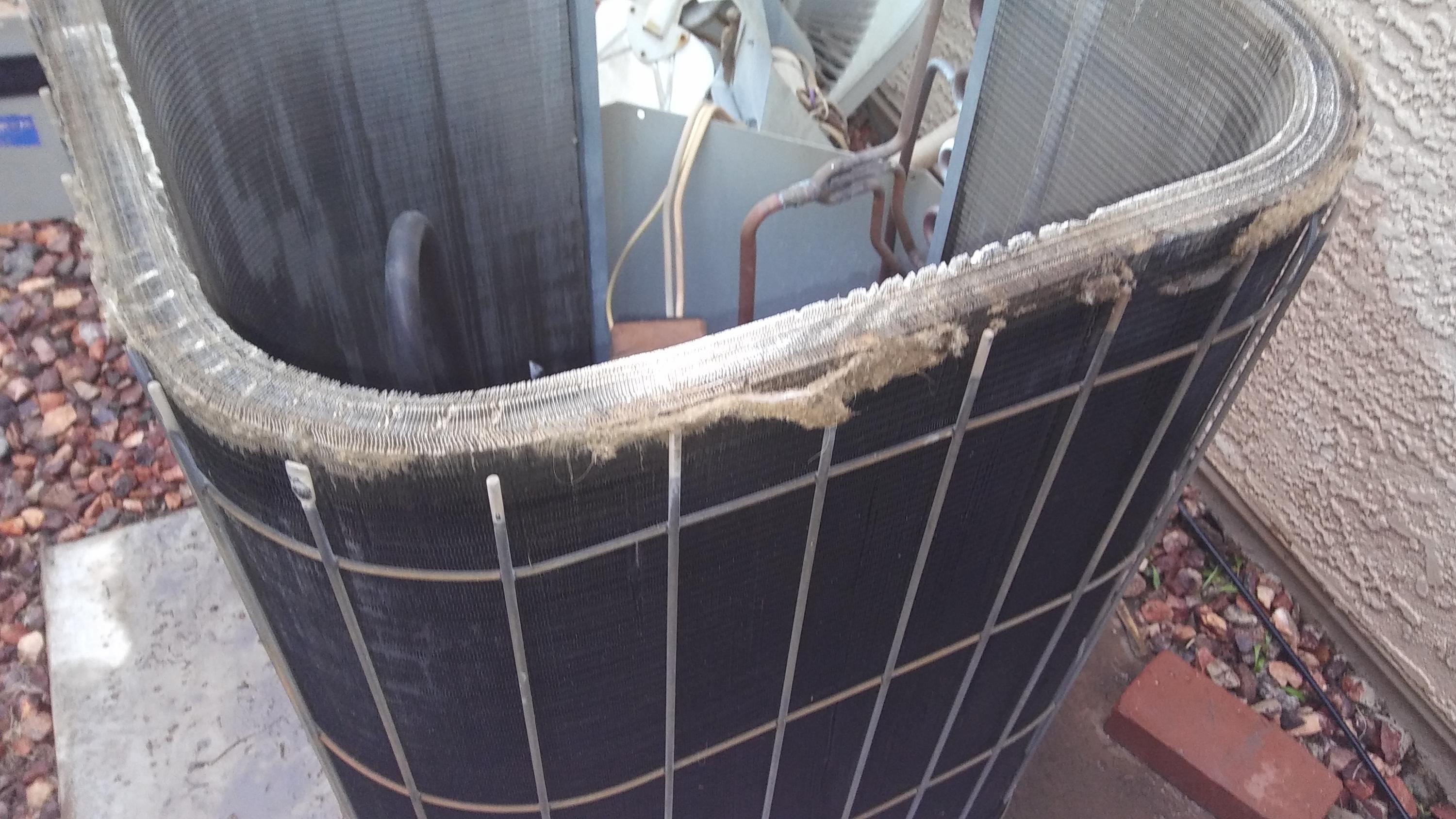

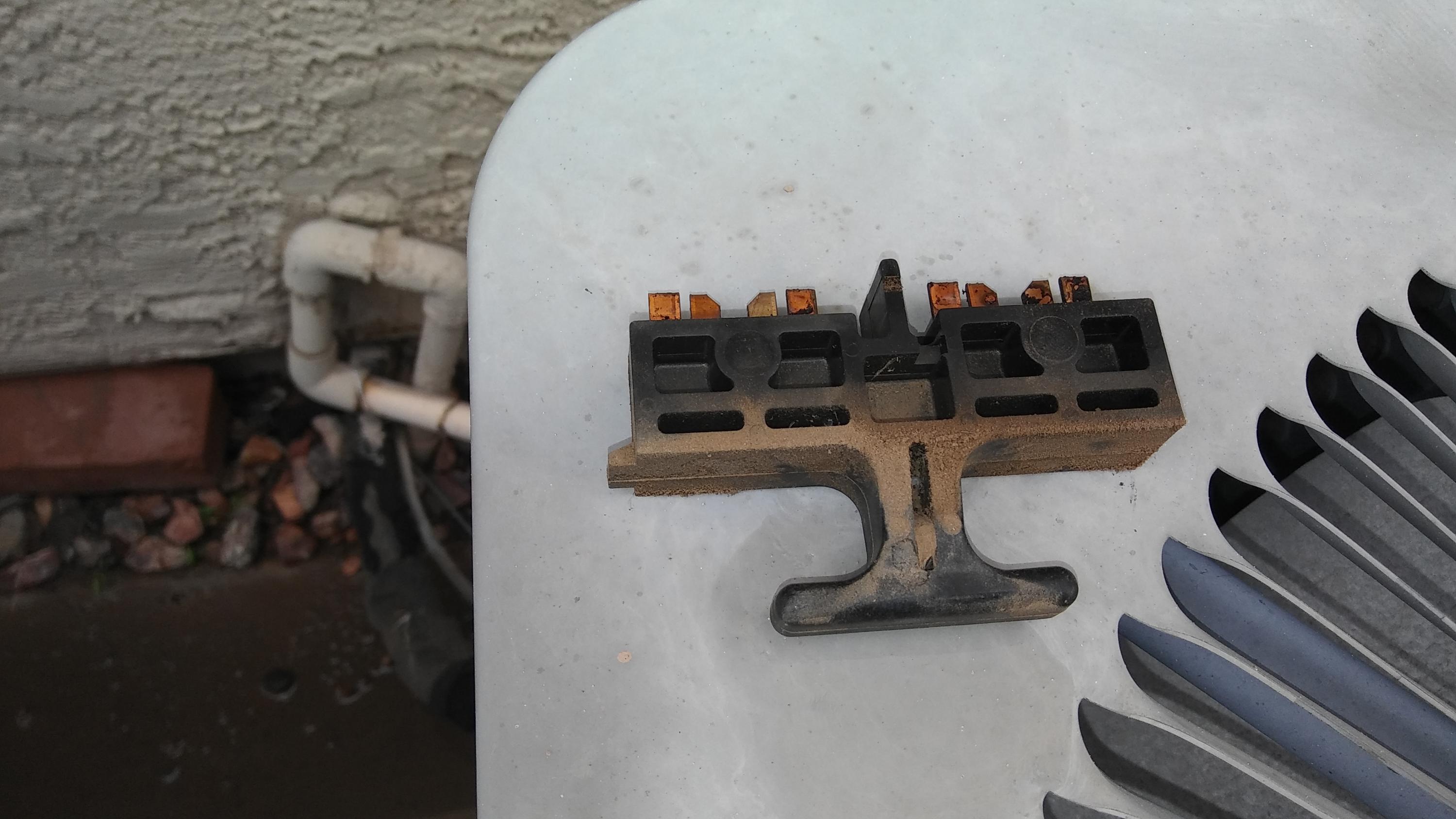

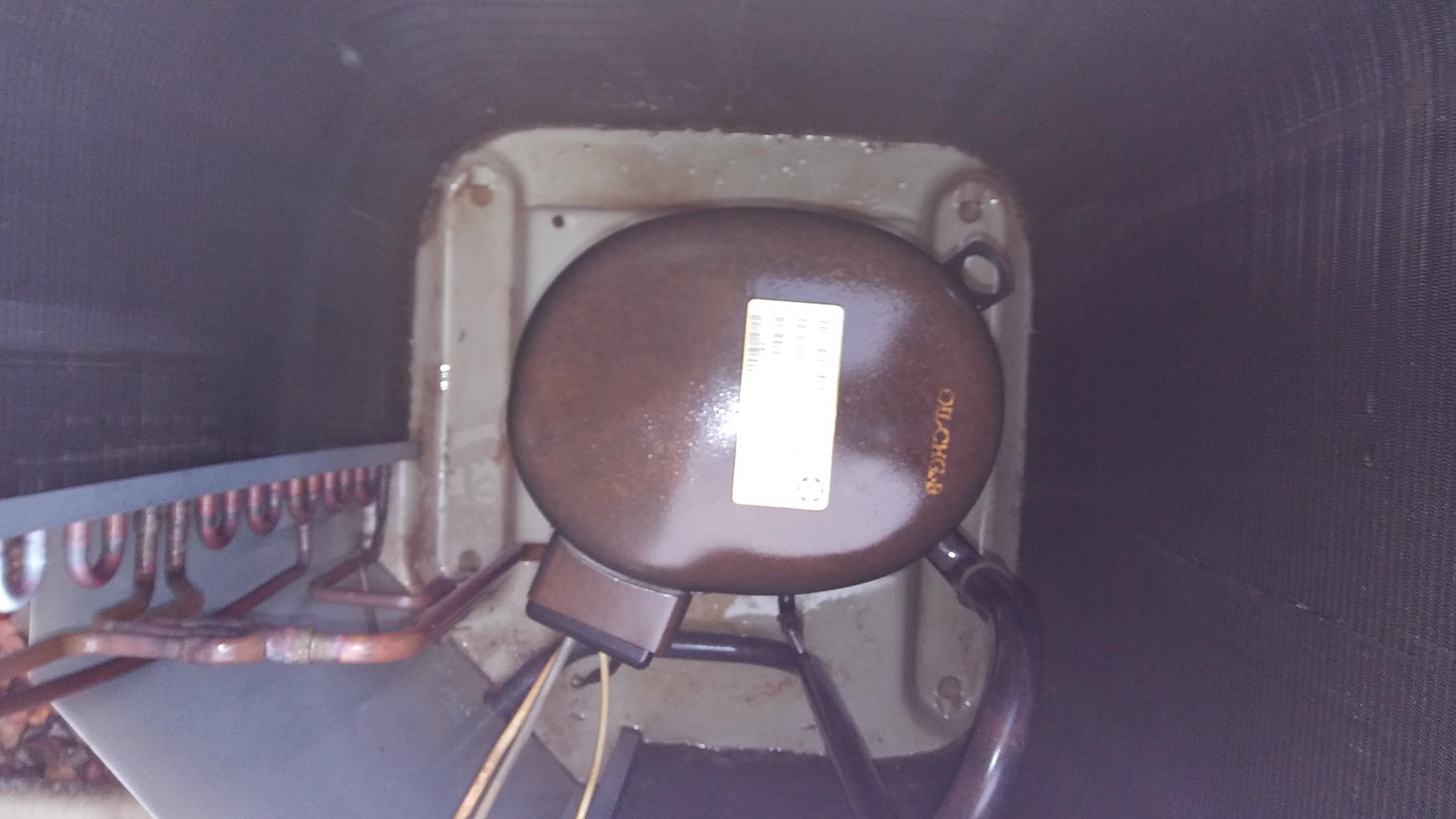

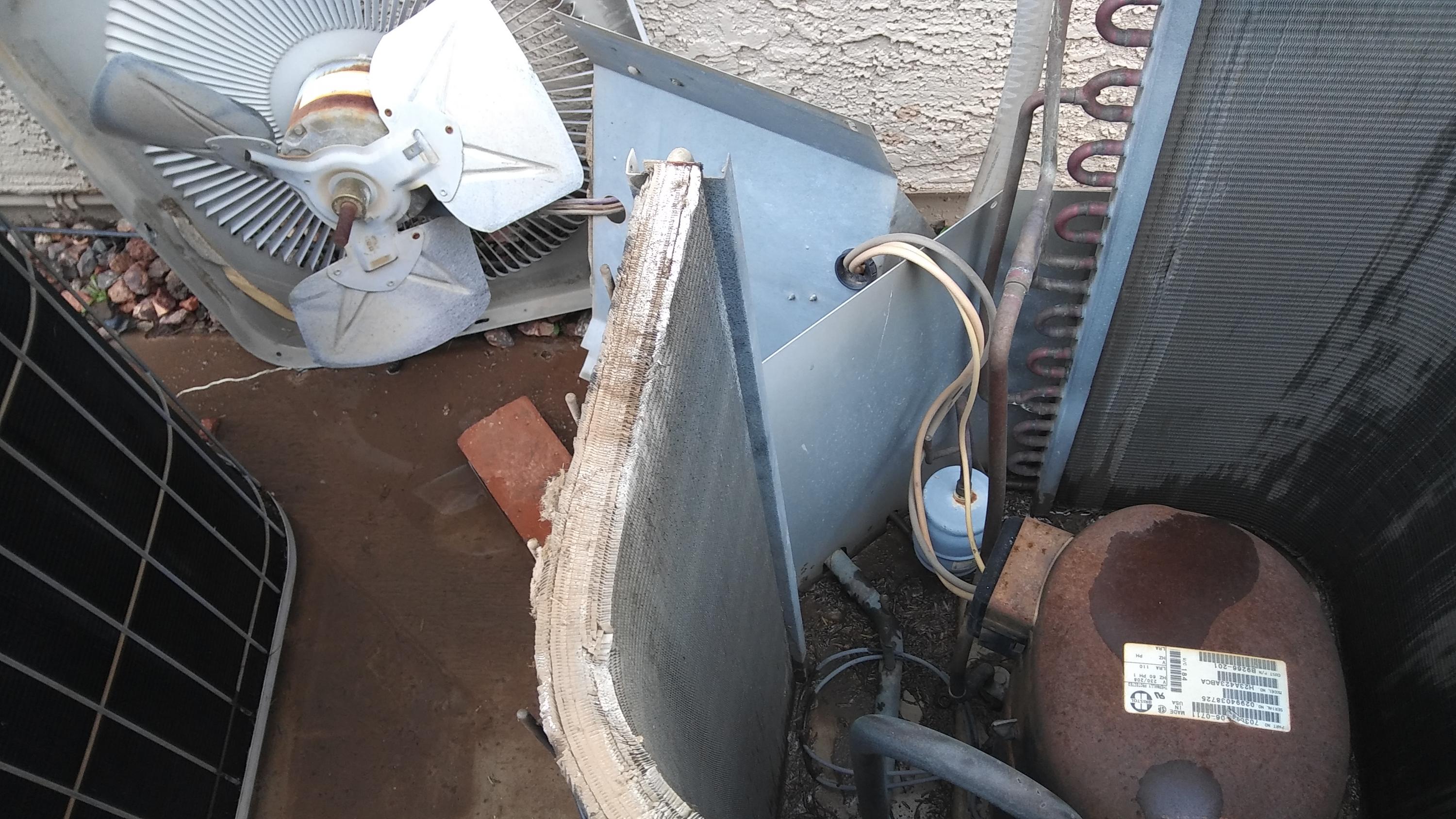

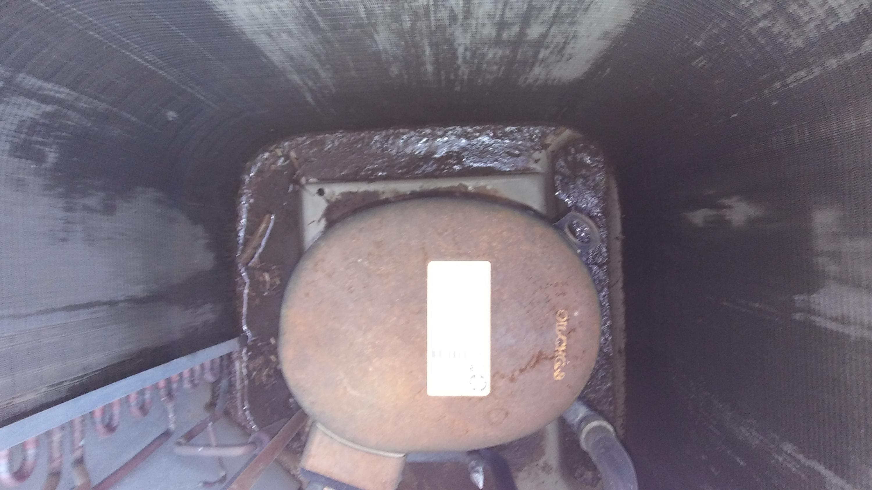

                      Beware of HVAC Scams!! My neighbors should watch this before they spended $12,000.

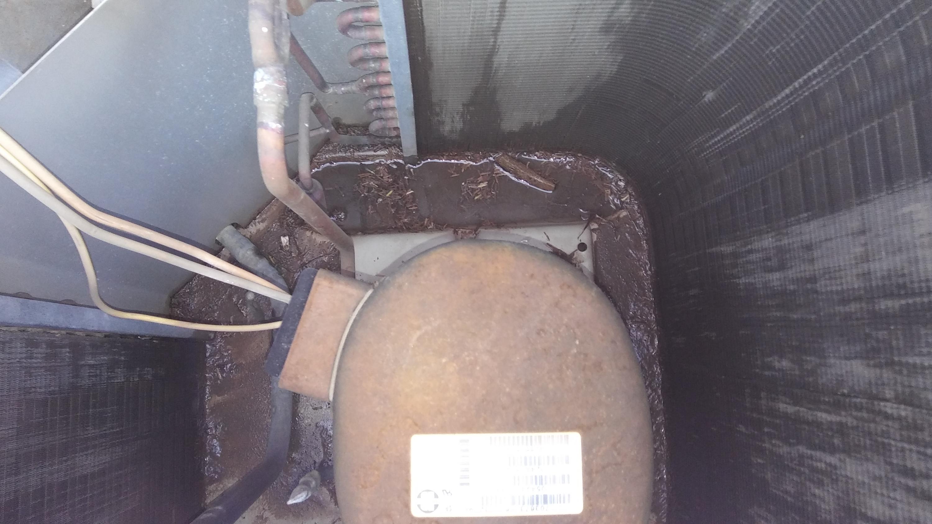

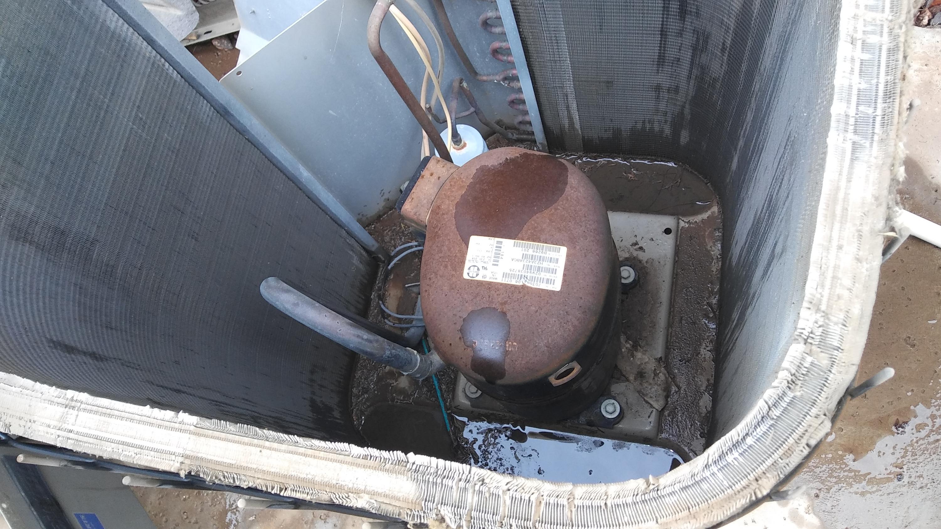

                      I cleaned two outdoor Condenser and Compressor units, Kinda like this one. Look at this one! What does yours look like?
                      I will check the Capacitors next time.
                        Your right the evaporator coil temp would need to be more than 32*F other wise it would freeze
                        40 to 50 *F Evaporator coil temp but ---> one way to really check this is take a reading on ether side of the evaporator coil you need at least 15* F difference between the two reading
                        The condenser coil would any where from 120* to 180* air discharge temp depending on how old the unit is but---> one way to check this is the liquid line temp should only some what warm to the touch not hot
                          The evaporator coil temp does need to be above freezing but the actual liquid temp will be below freezing before the evap. Reduced airflow across the coils will cause frost/ice to form because not enough heat is removed from the air to keep the coils above 32. A clogged air filter and incorrect blower speed, too low, are 2 simple things to look for. Another cause is an under charge of the system, the reduced pressure in the lines will allow the phase change from liquid to gas to occur at a lower temperature.
                          A 15 degree temp drop is a little low in my experience. Once the environment has stabilized it should probably be closer to 18-20. The best thing is to refer to the manufacturers charts to see what it really should be. High indoor humidity along with high outside air temp will reduce the temp drop.

                            What you have there is very true
                            I was basing this on older units that did not have high efficiency and that was the hard fast rule back then
                            Now if one of newer units that has a VFD fan motor then yes the temp difference will be 18* to 20* F
                            It could even be a little more more than that if has a temp sensor on the evaporator coil

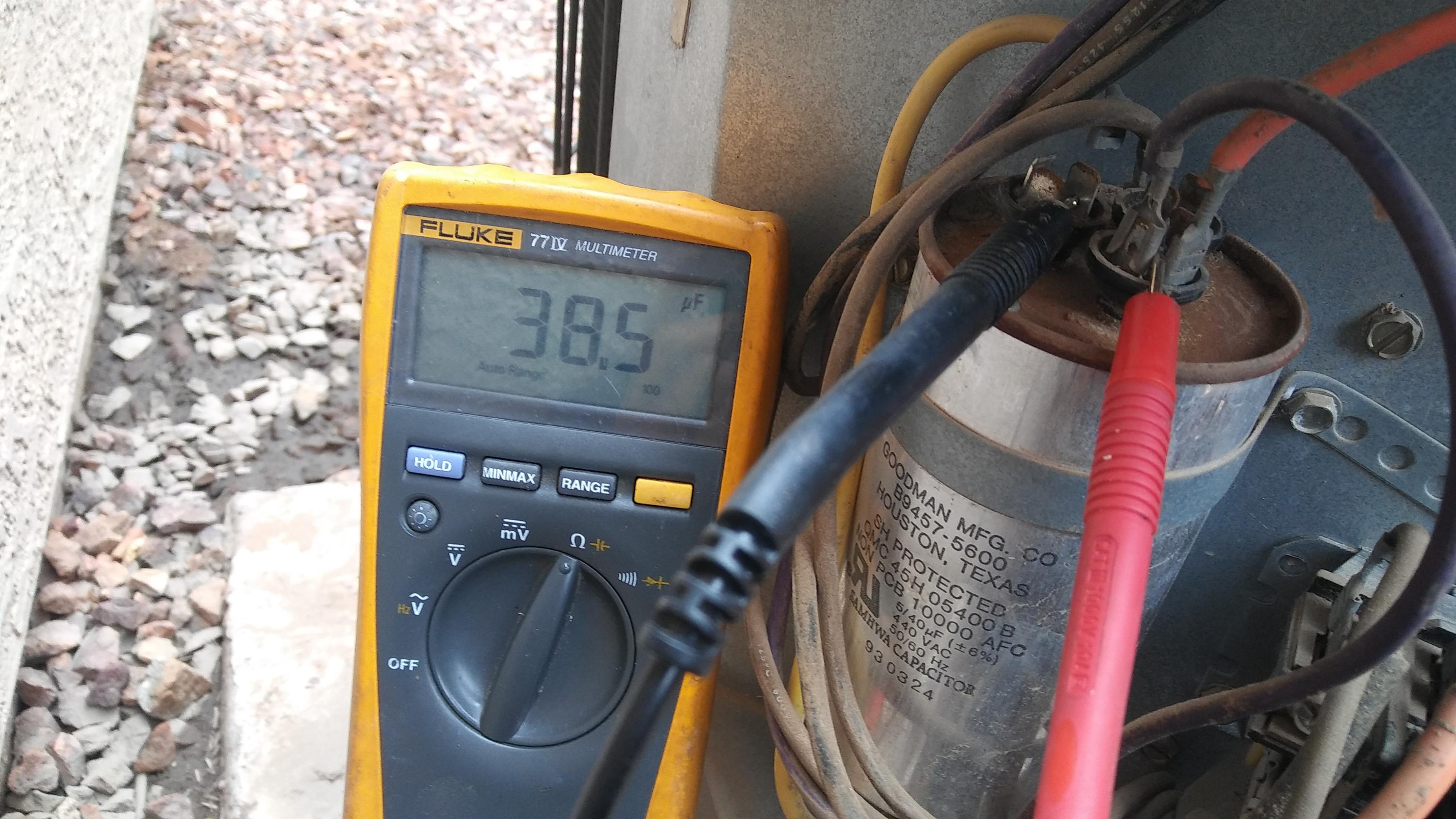

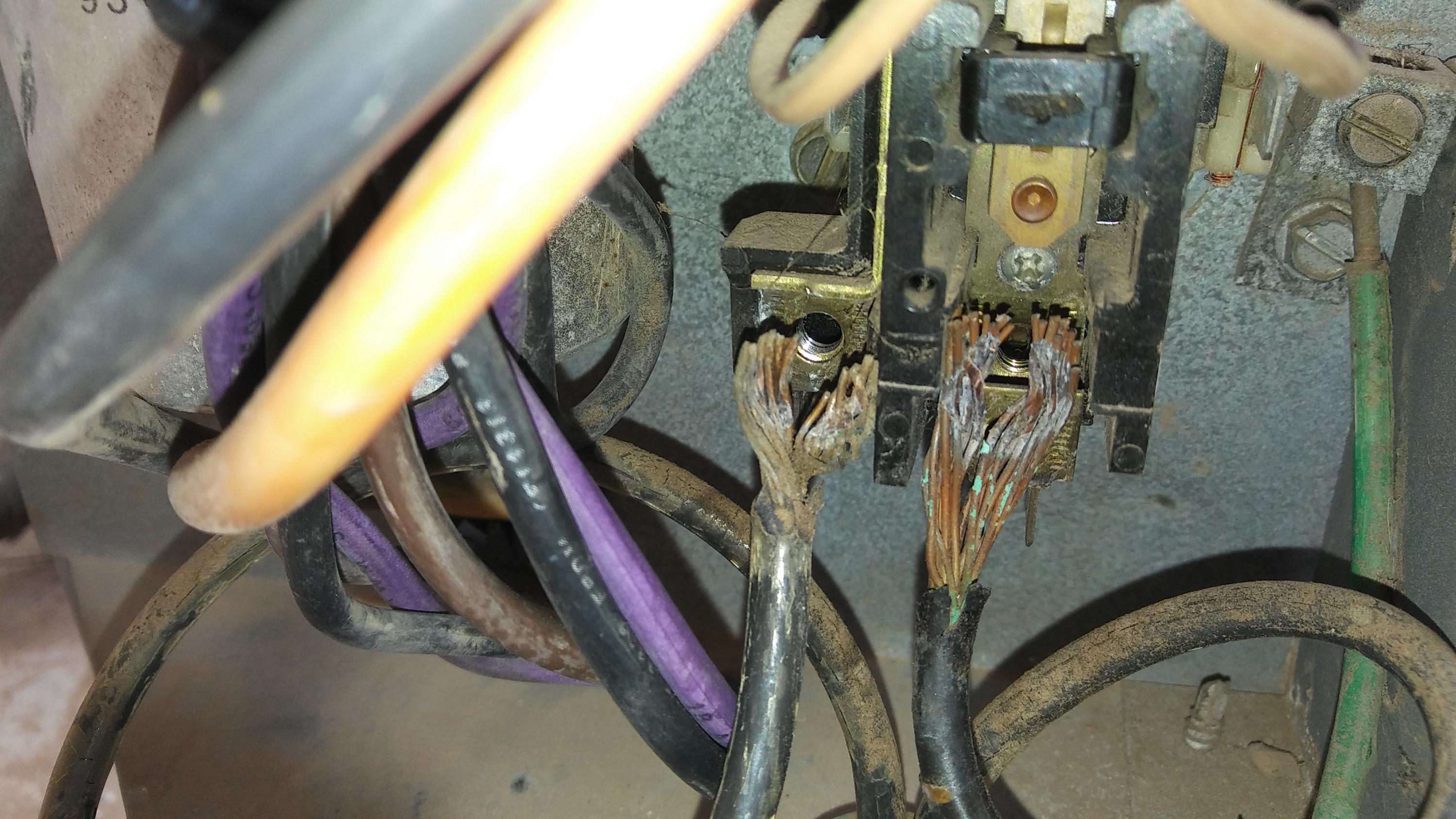

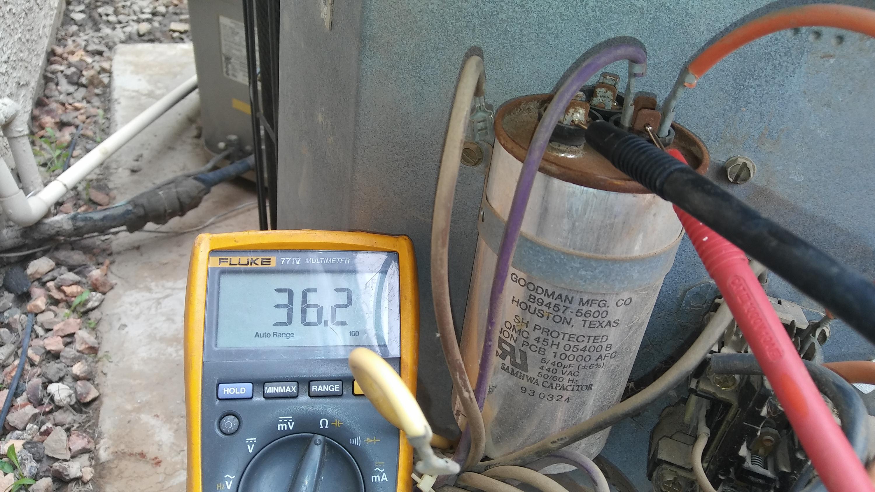

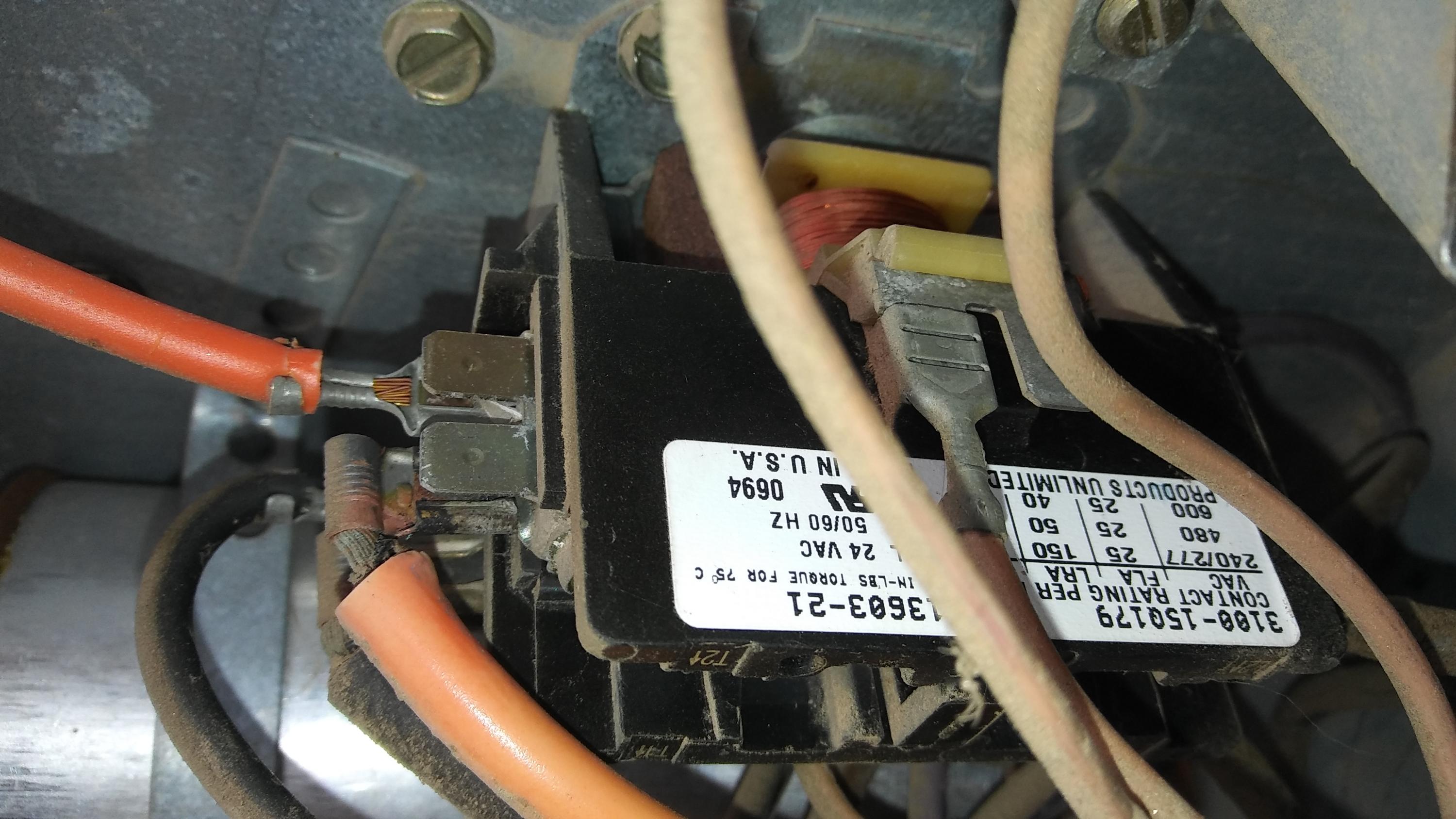

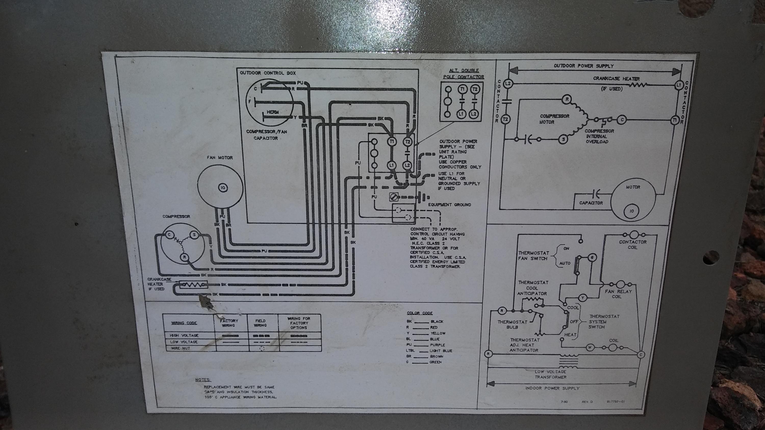

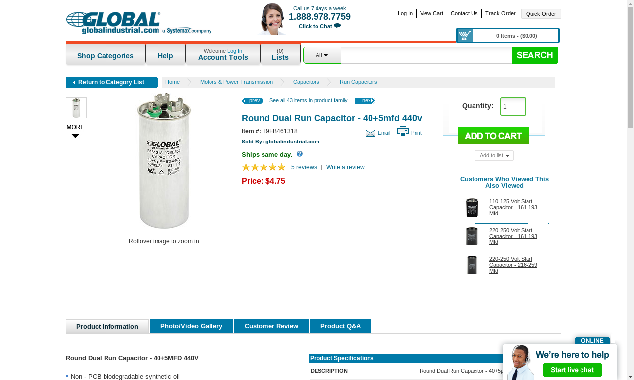

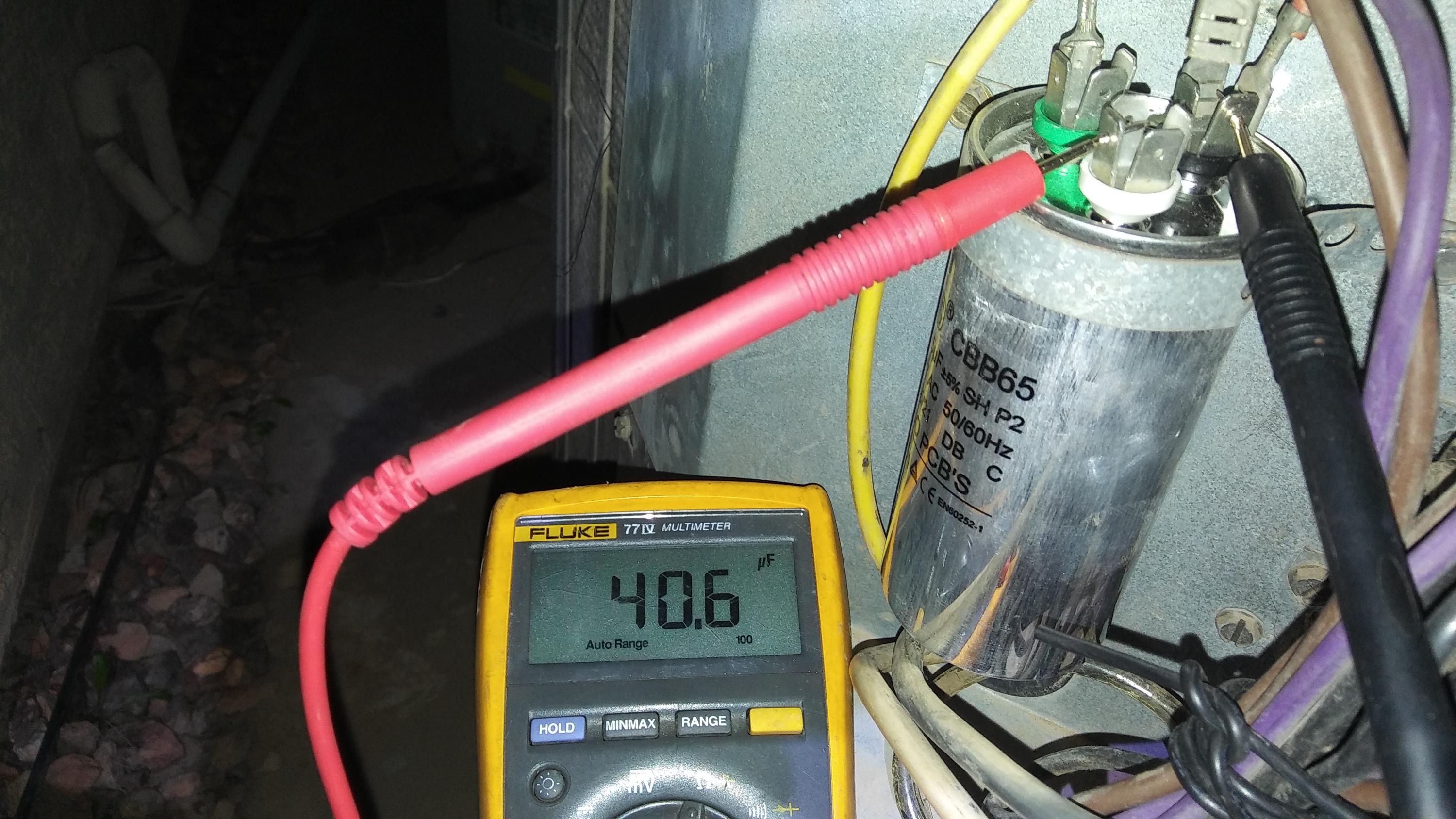

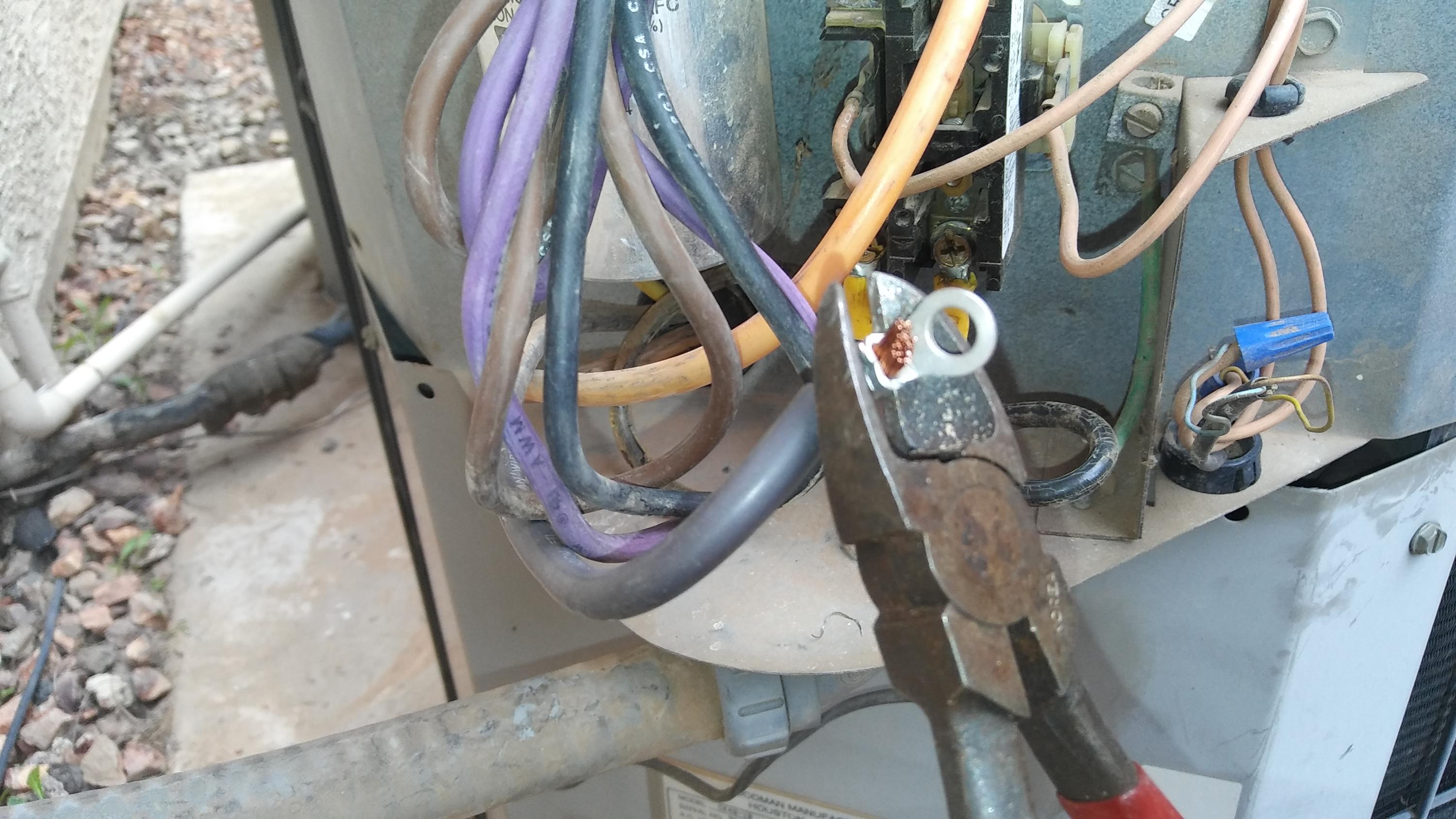

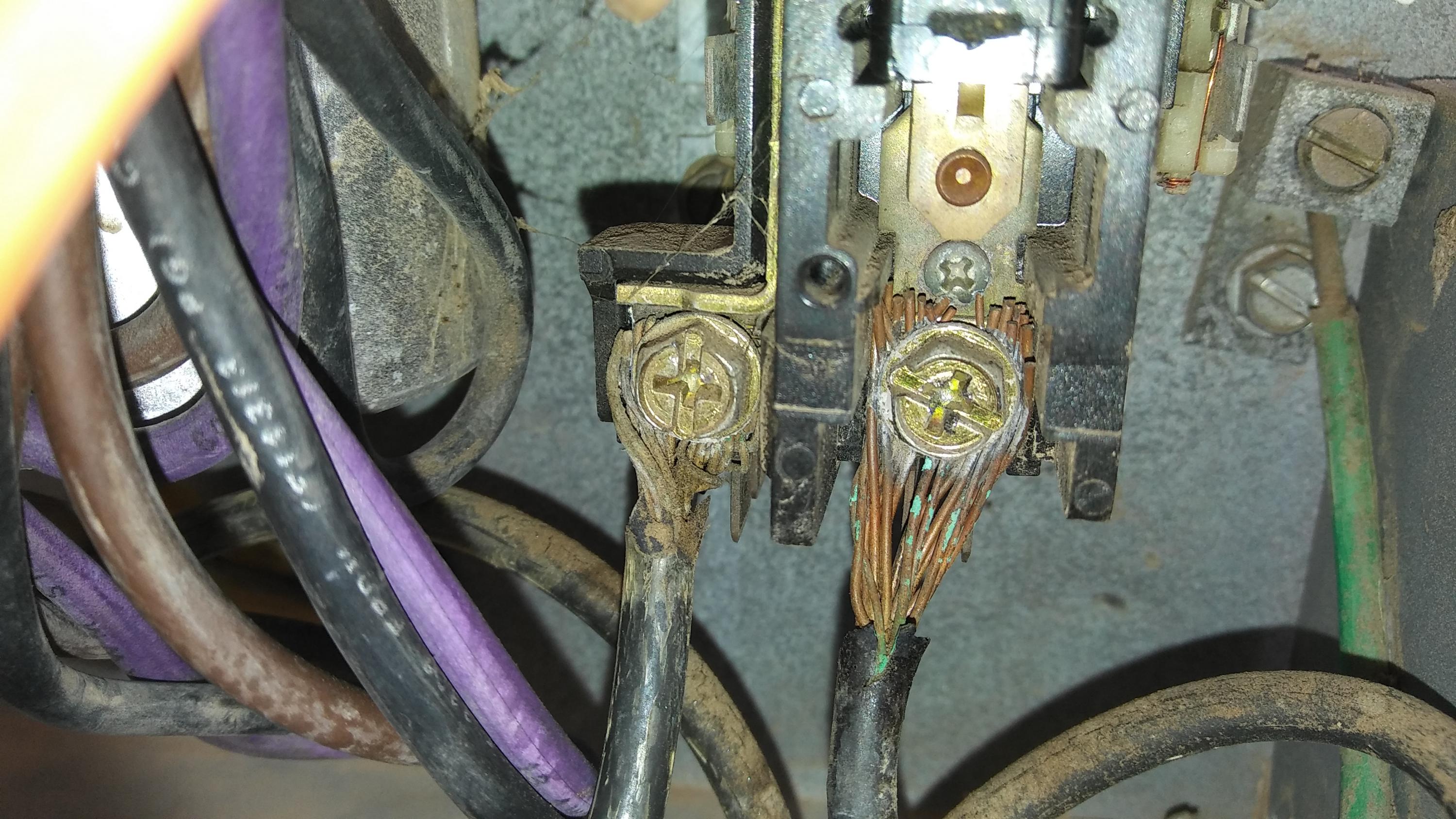

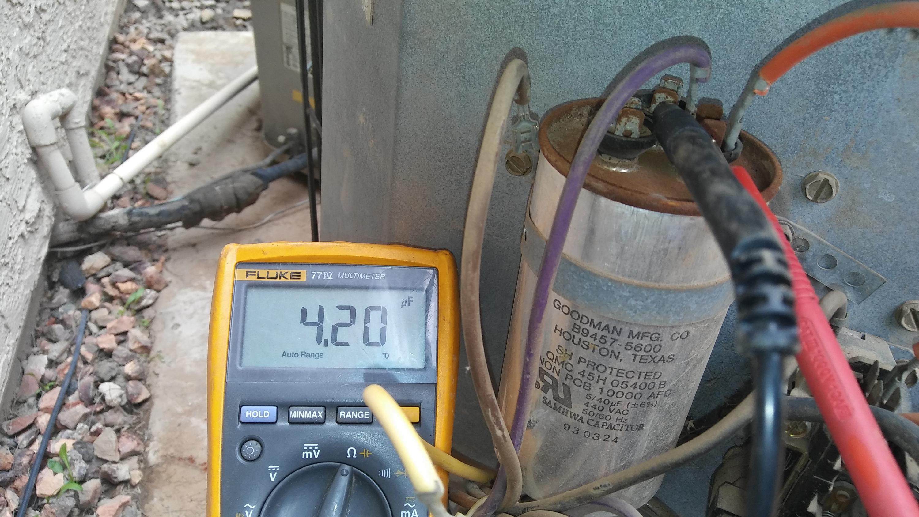

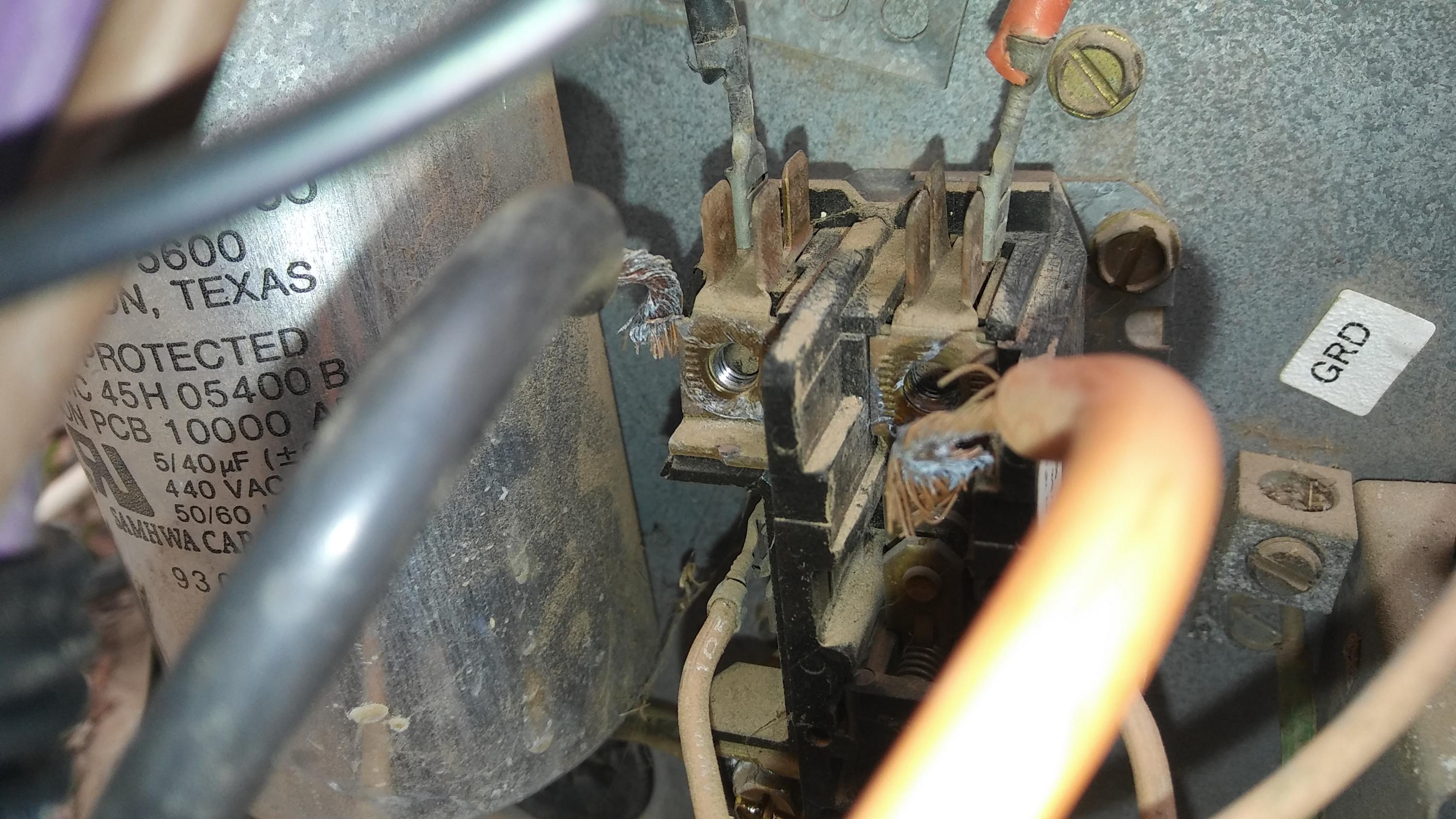

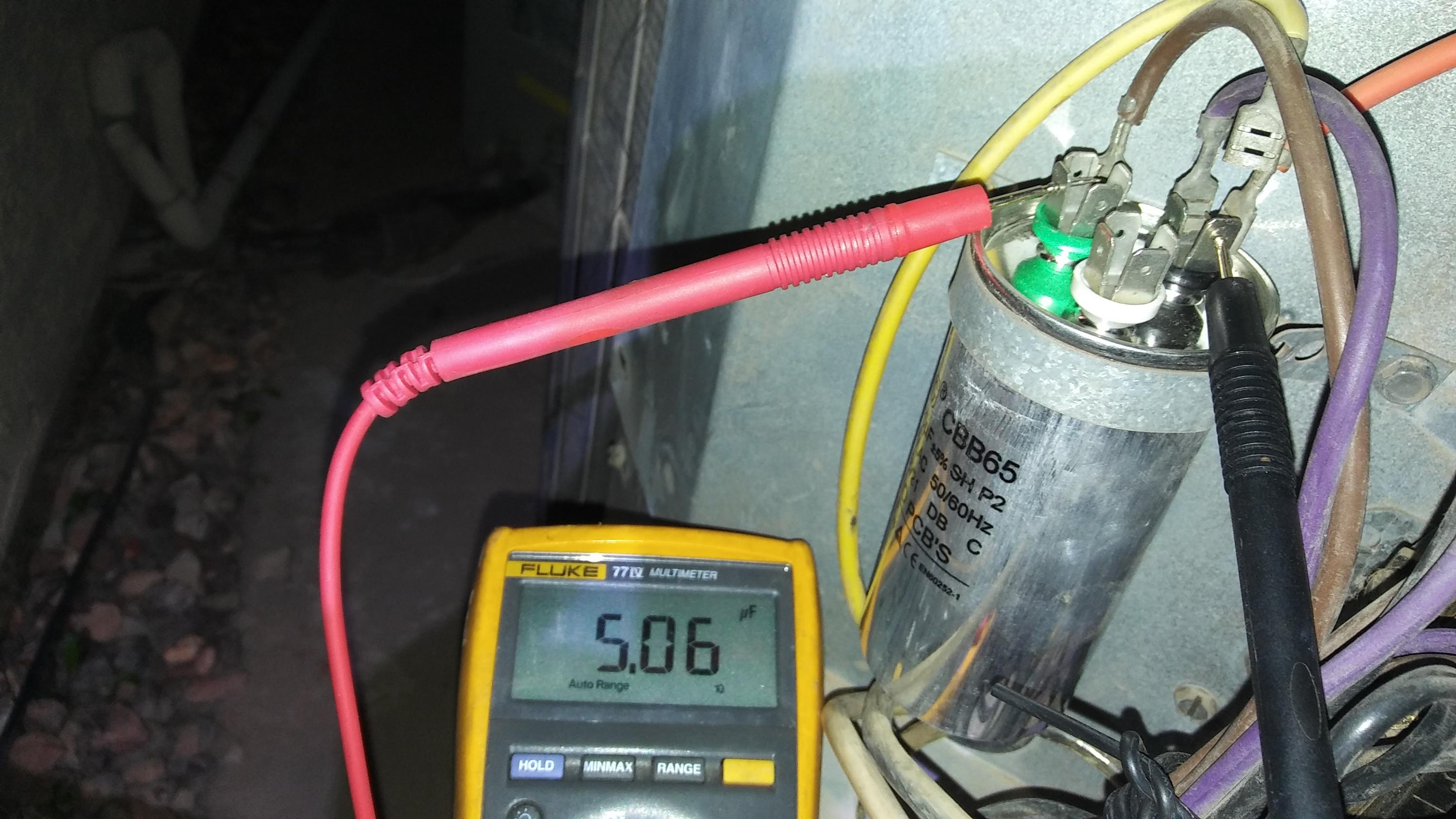

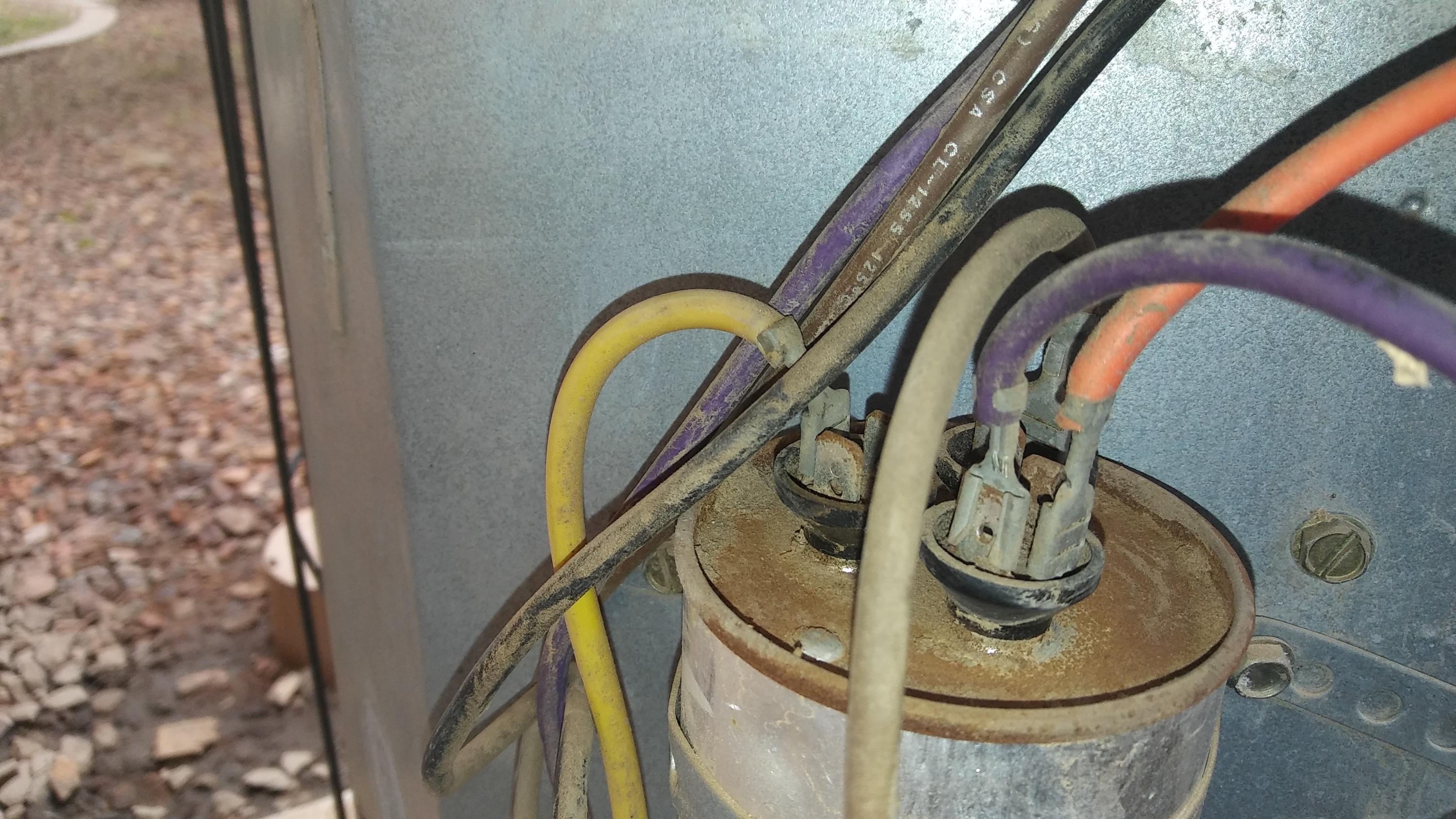

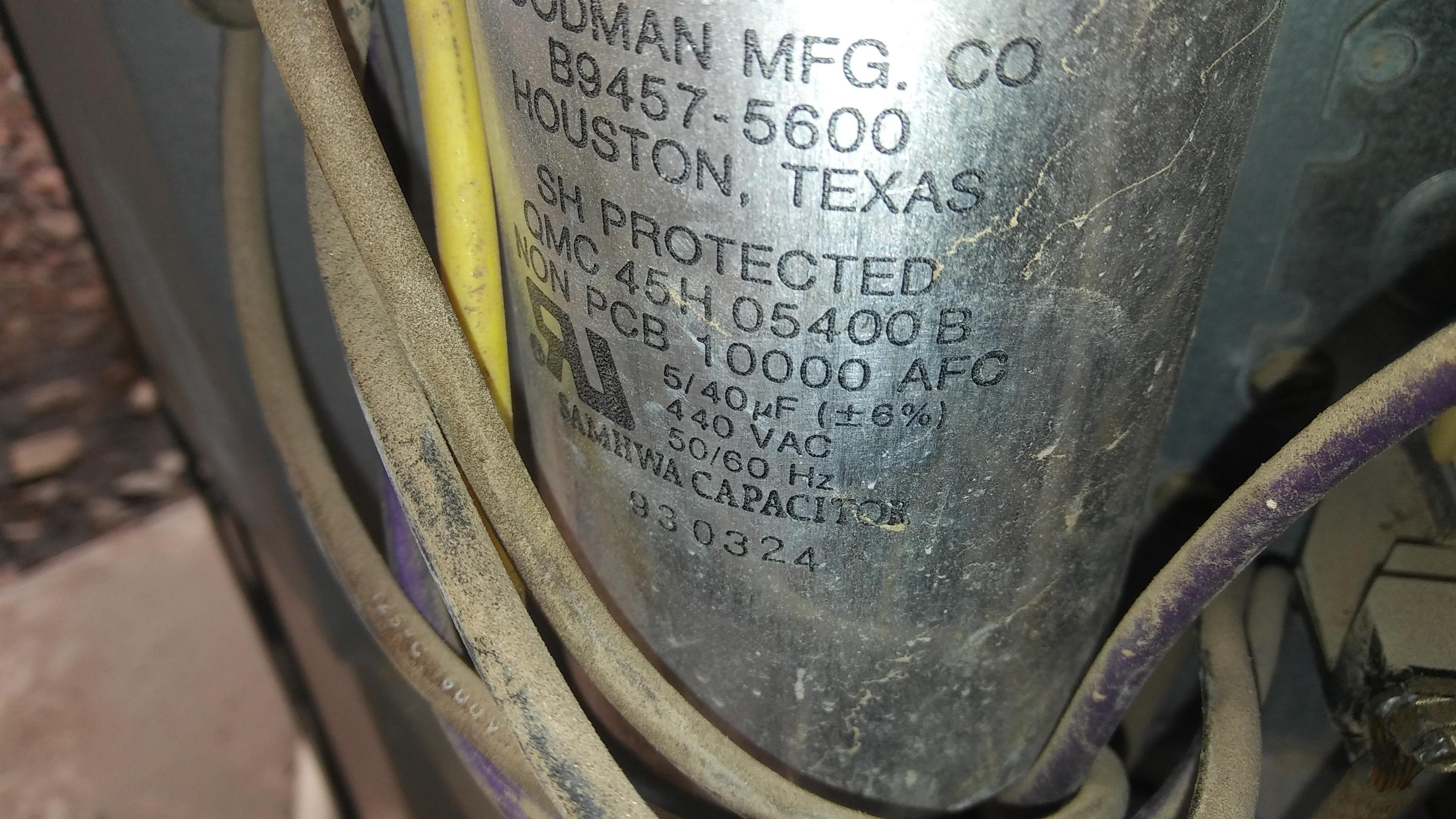

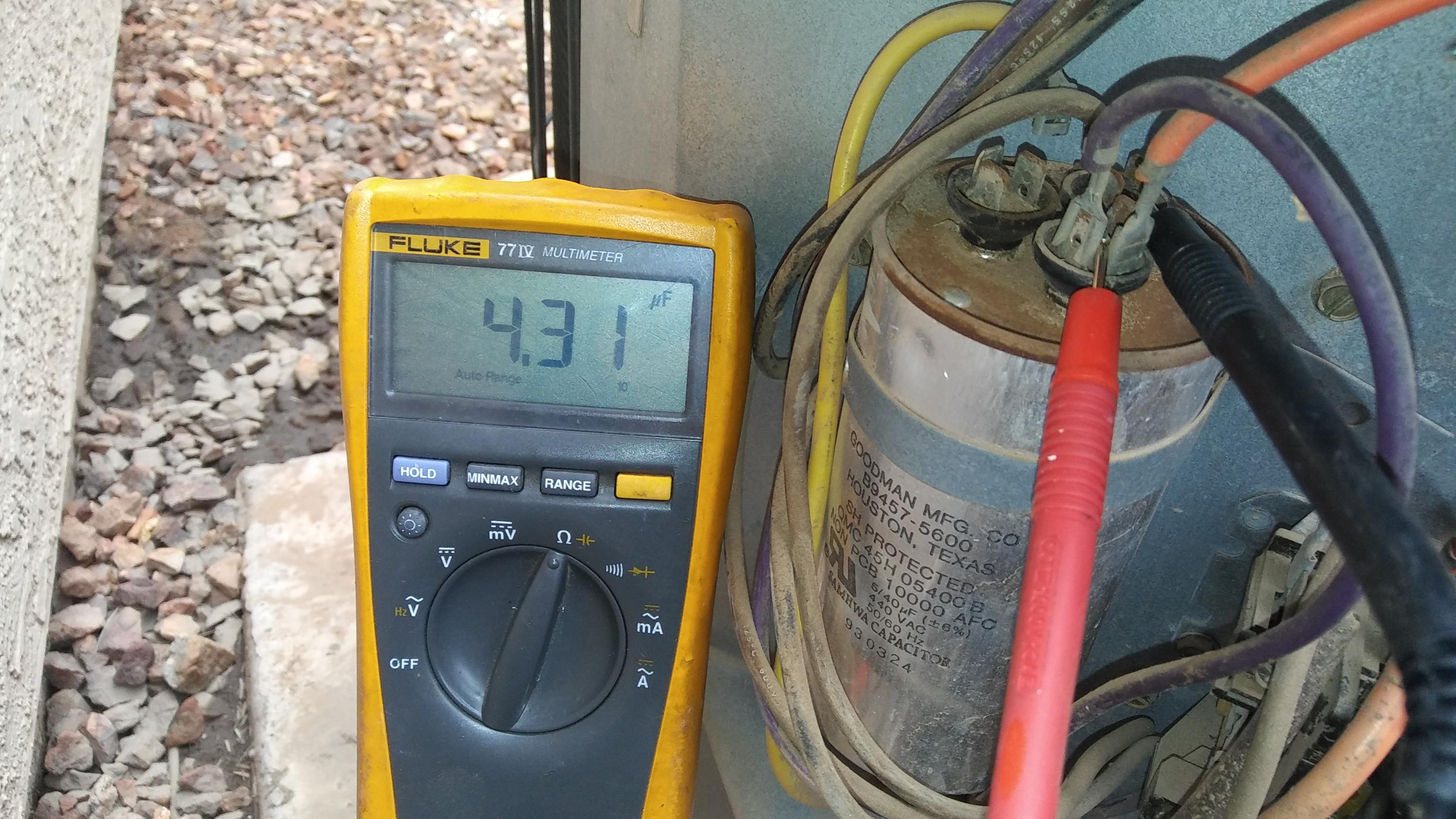

                              Test Run Capacitors and change compressor electric connectors.
                              A unit 5/40uf tested are 4.31/38.5 uf
                              B unit 5/40uf tested are 4.2/36.2 uf
                              It seems to be OK , I Ordered two of Run Capacitors gonna change them anyway.

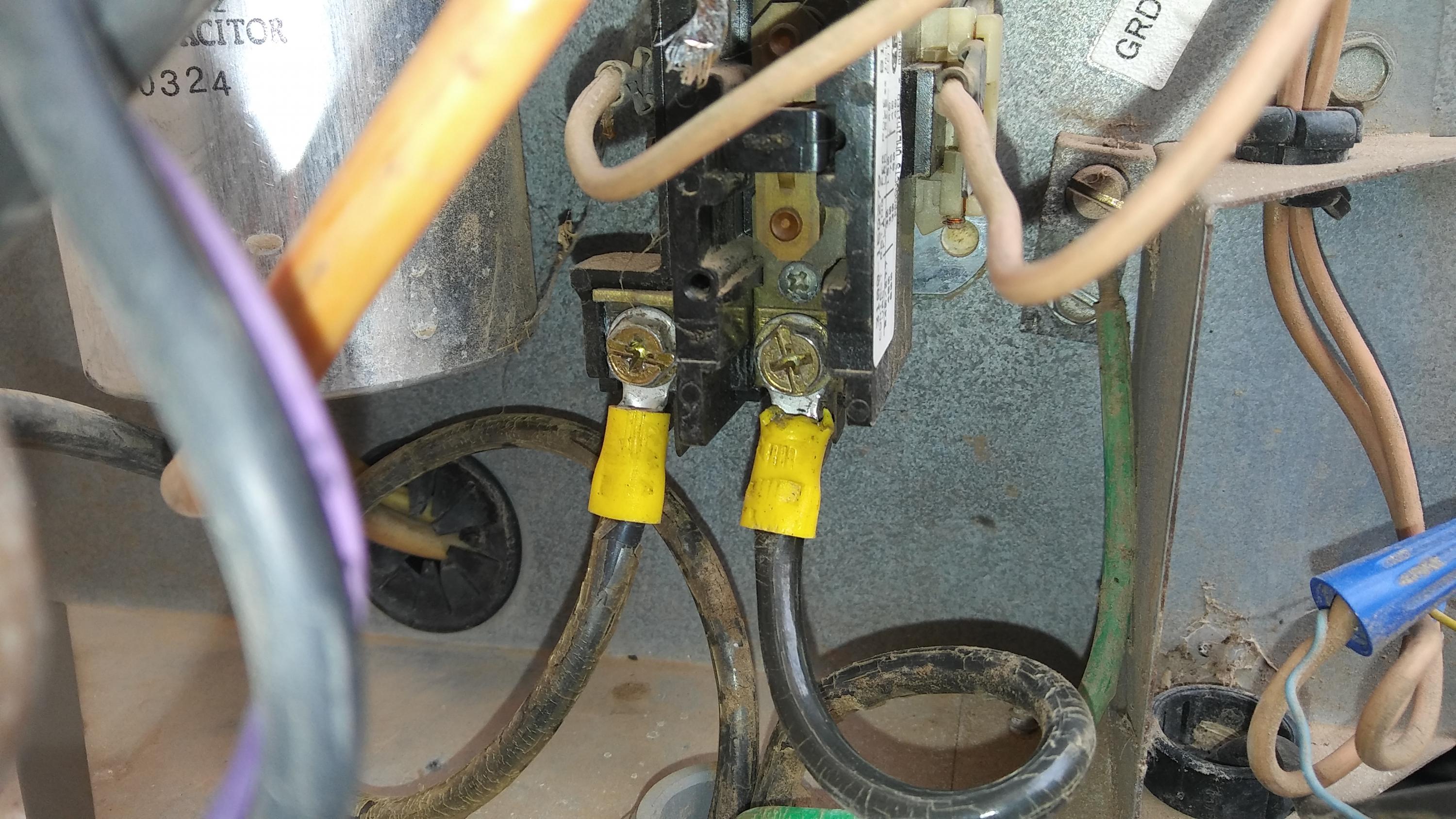

                              PS: The Electric wire 220v terminals look really bad. I changed them. Will put some solder next time.

                                Ordered two new 5/40uf and changed them for Preventive maintenance.
                                PS: 5 uf is for Fan, 40 uf is for Compressor.

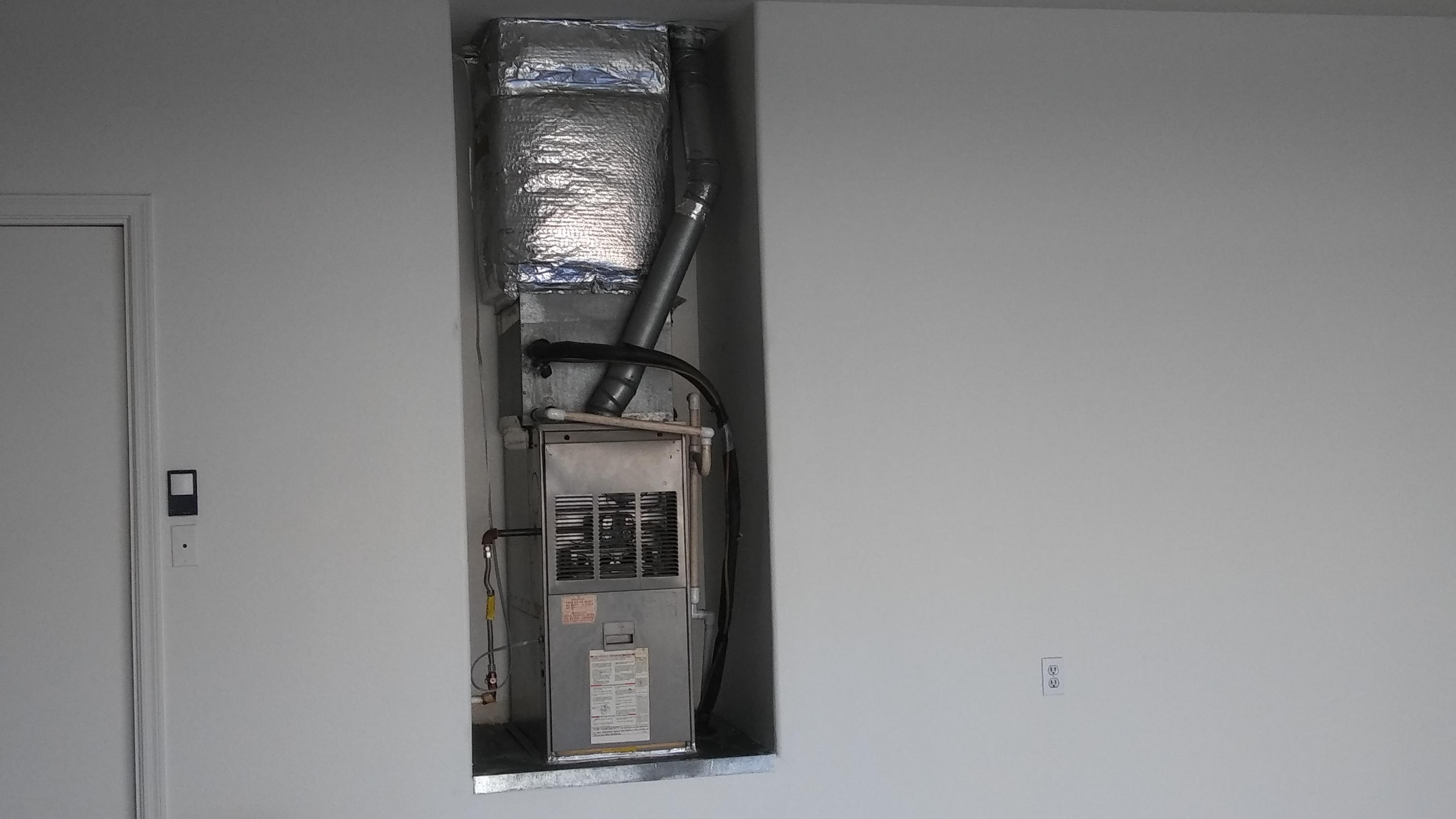

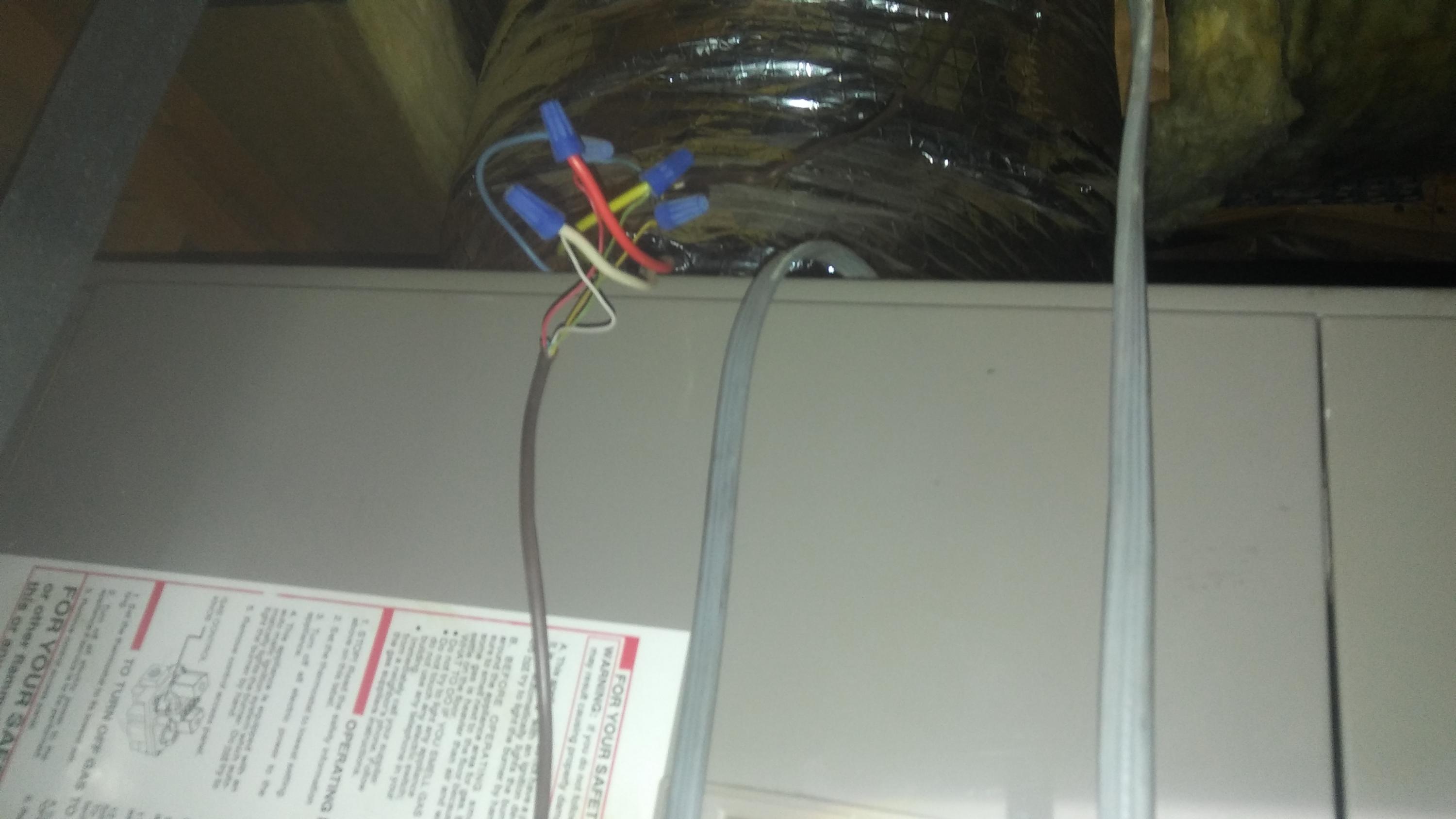

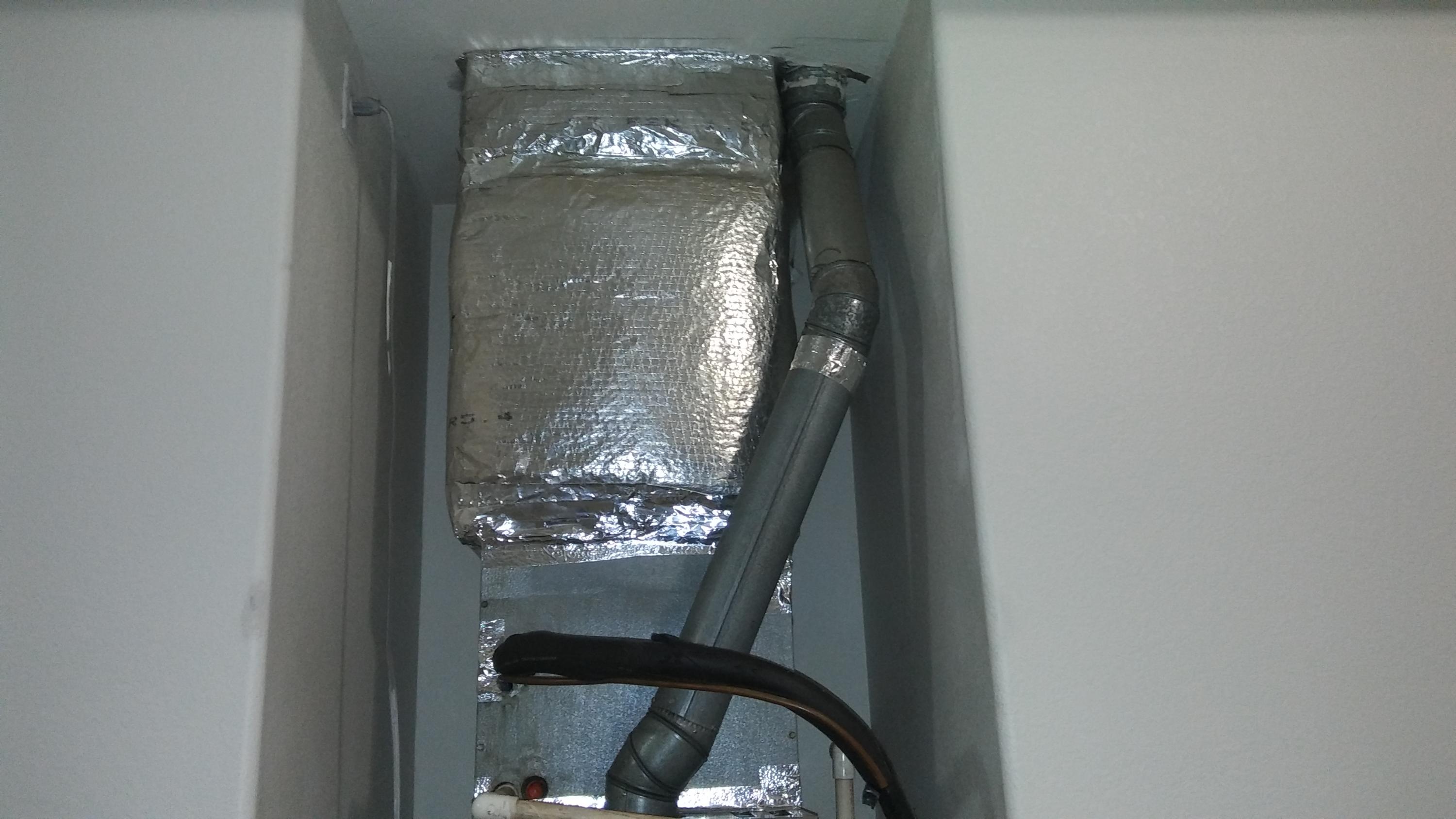

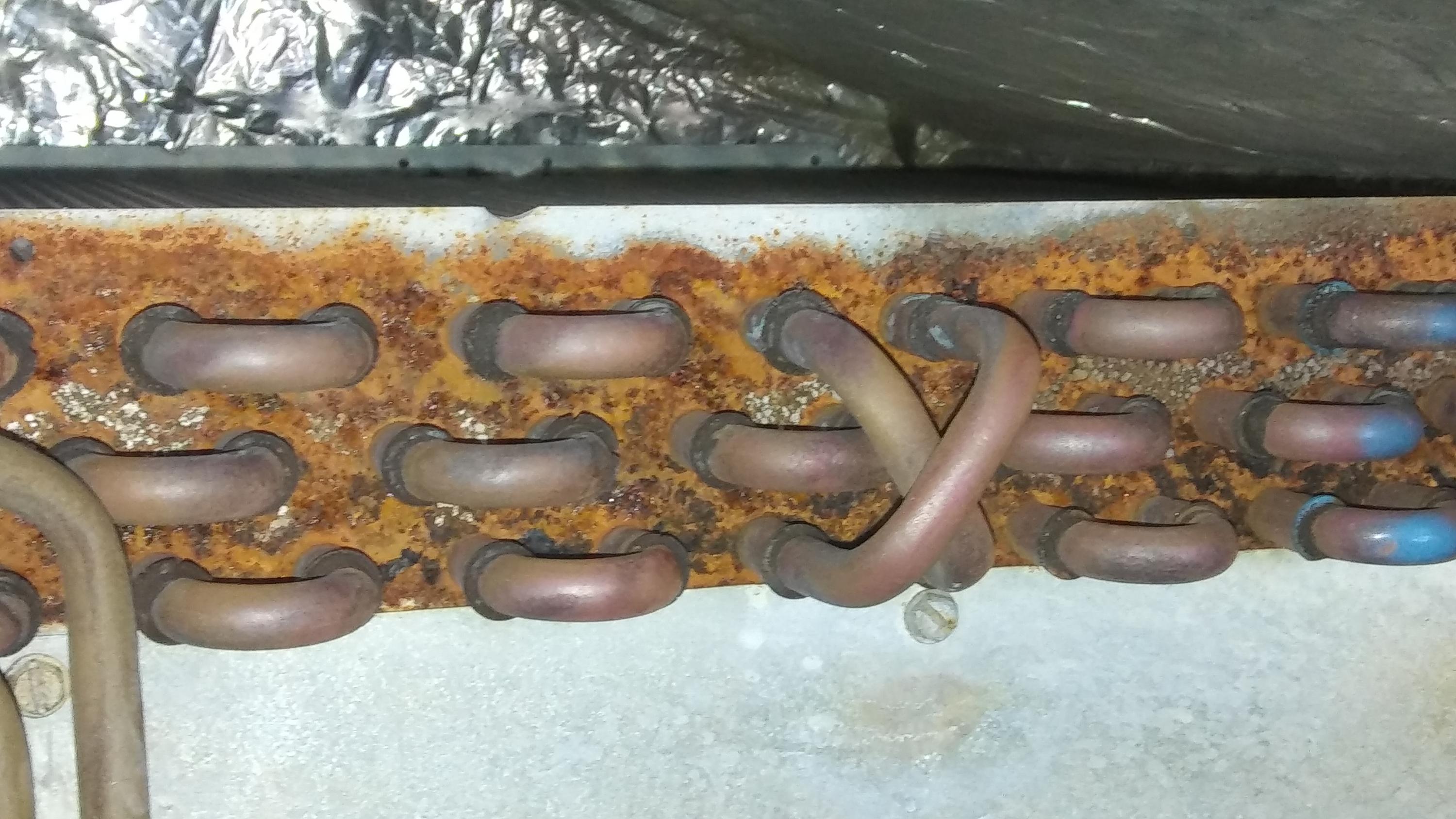

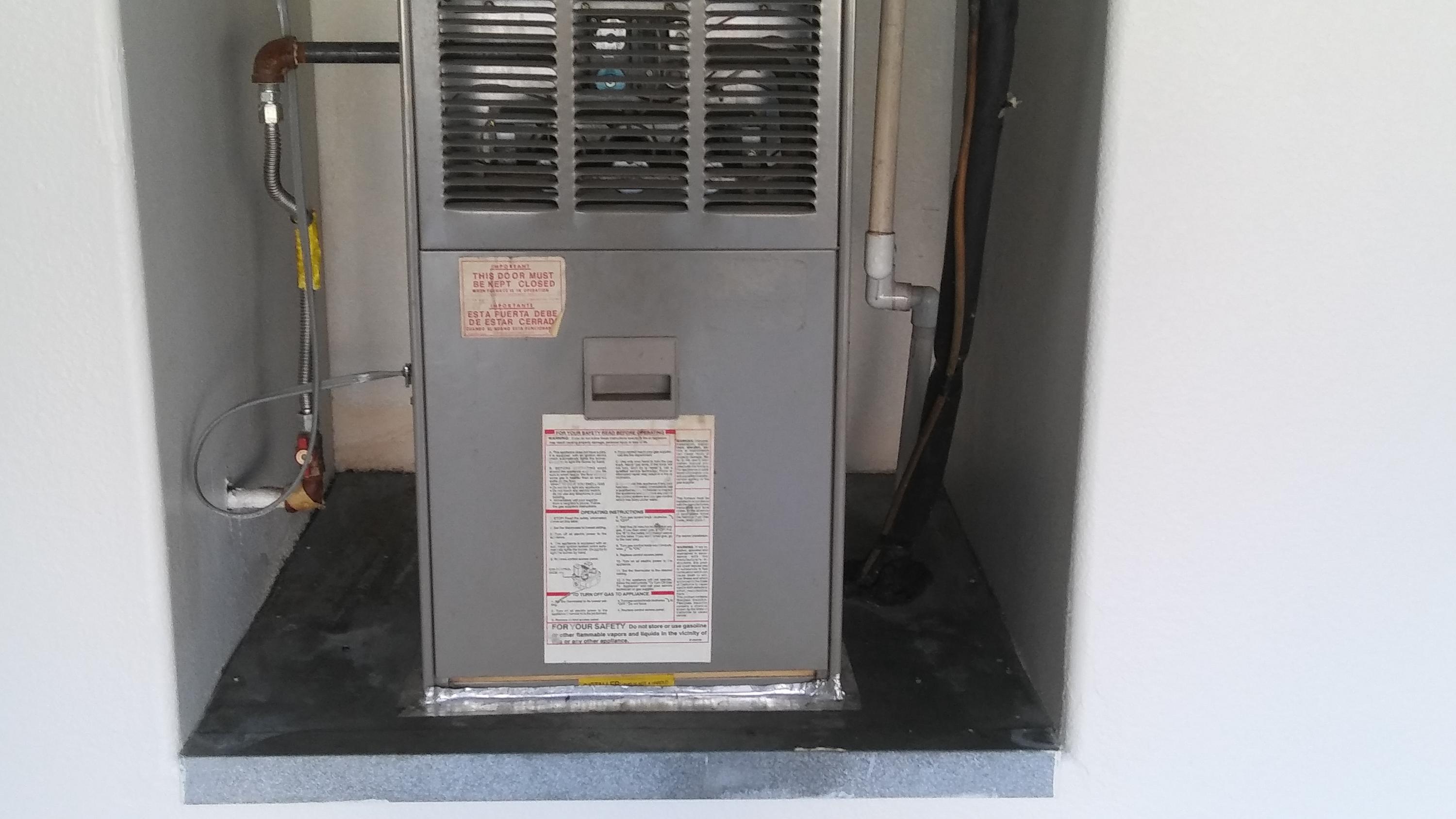

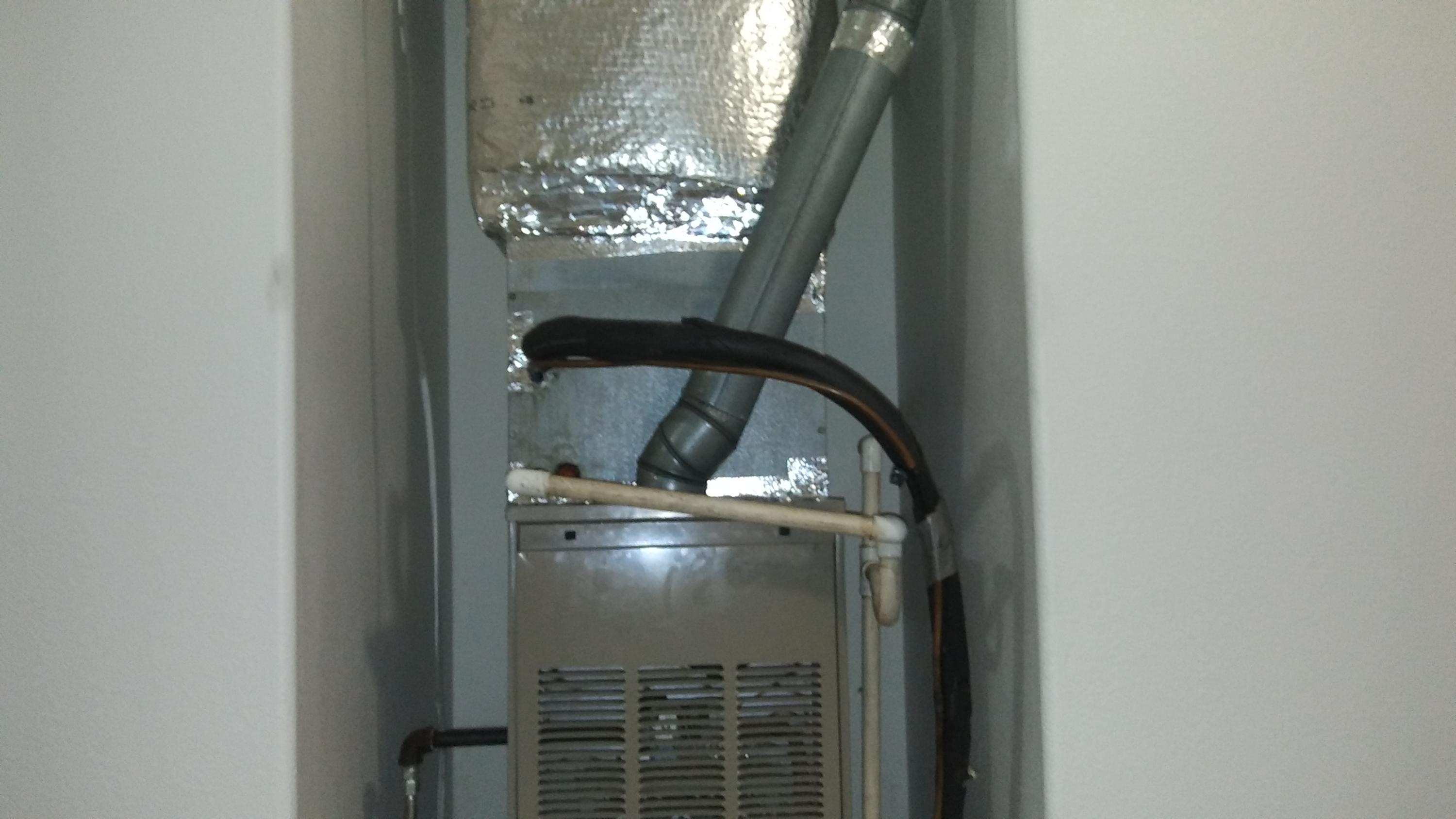

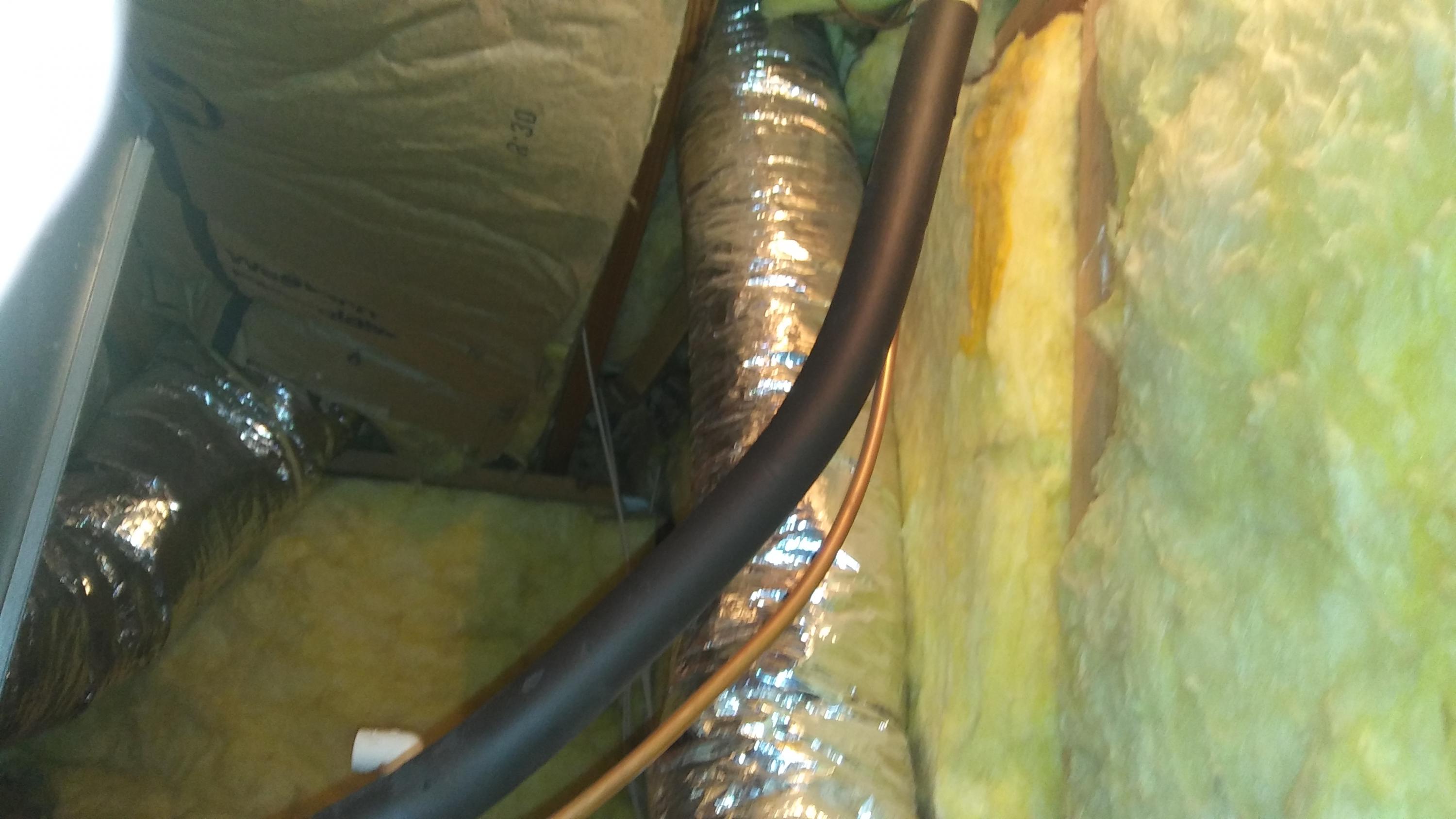

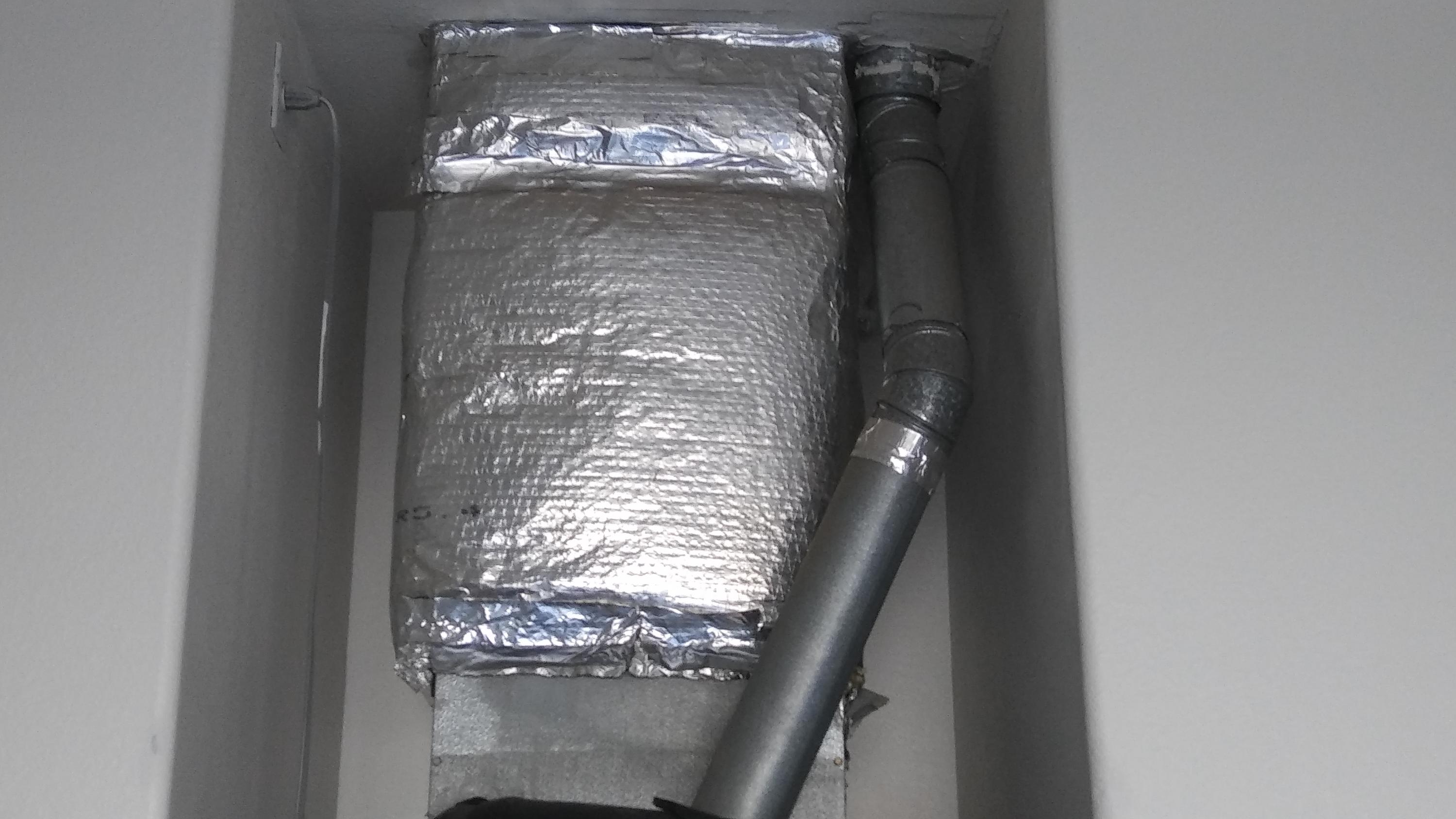

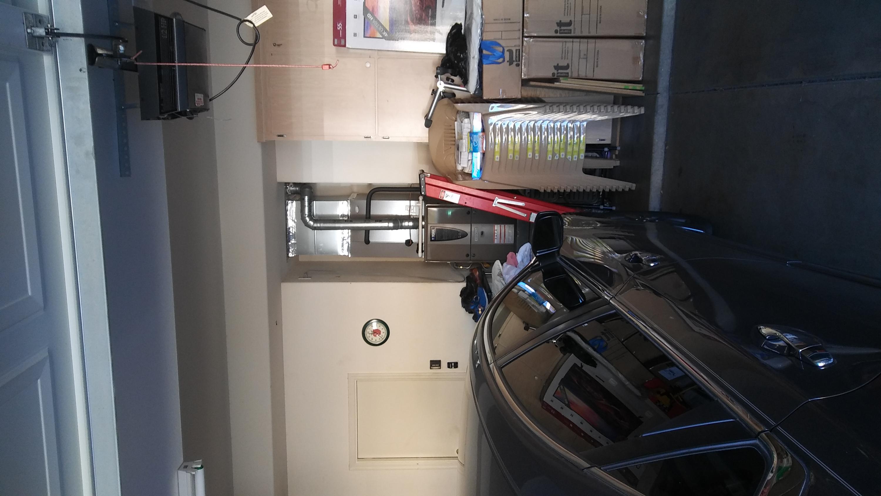

                                  In this 5 bedroom 2 story house I found another gas furnace lay horizontally over the attic. So each floor has their own HVAC system.
                                  PS: Totally I changed 4 capacitors and one PCB....................

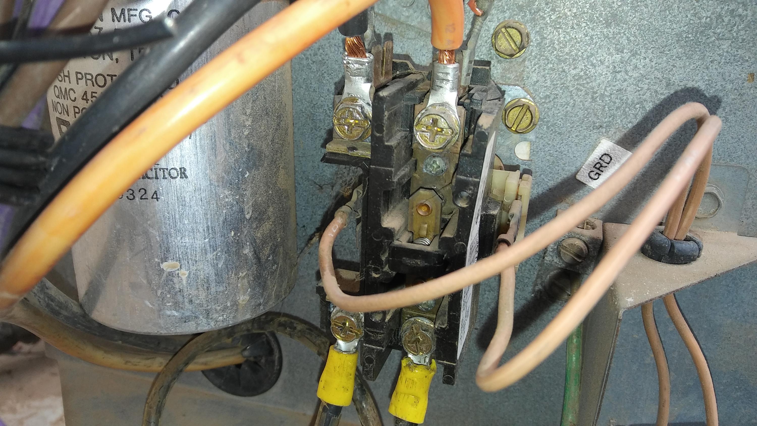

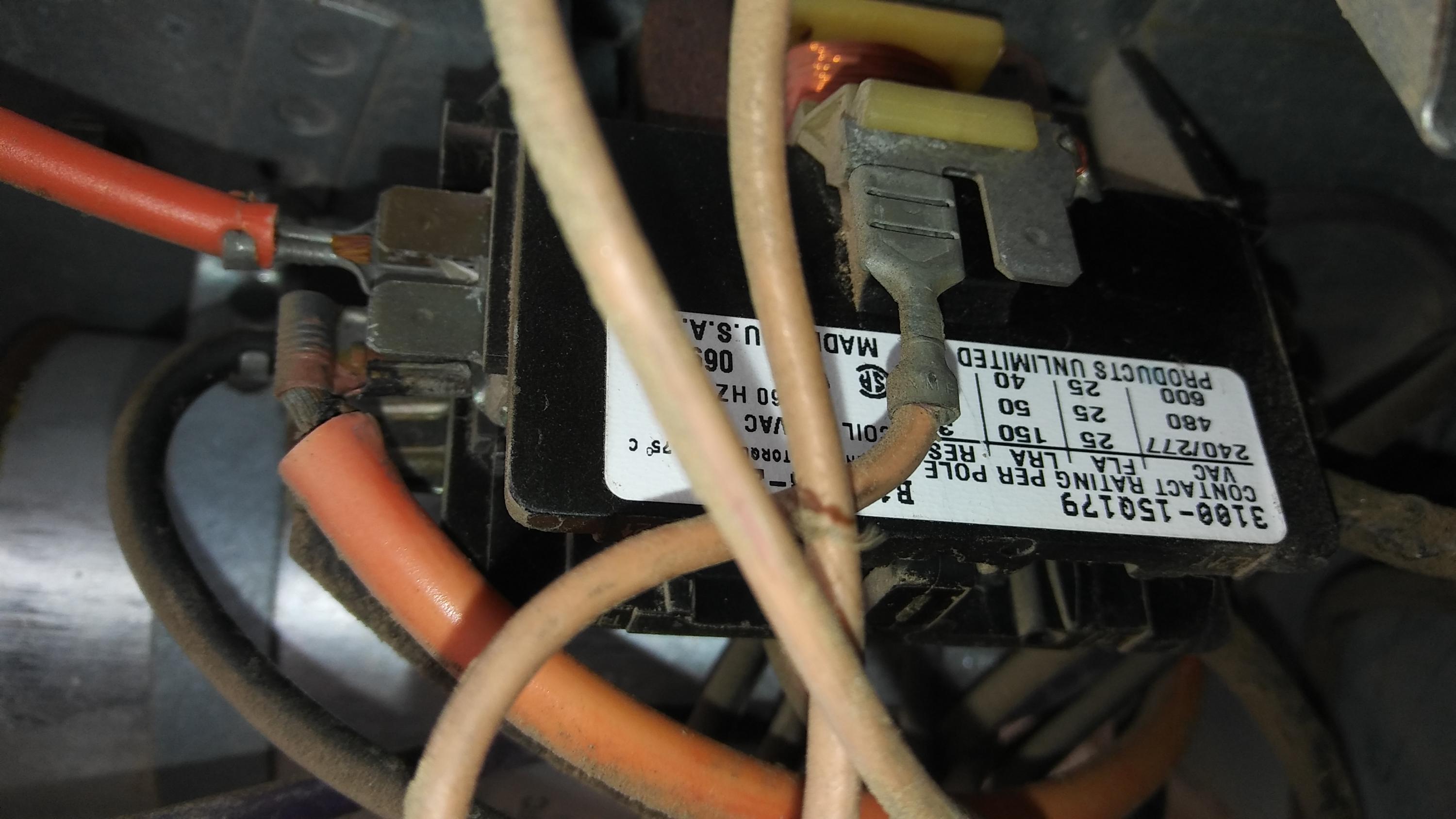

                                    This is just me BUT when I one pole contacter I change them on site
                                    Here is why I do this with one pole contacter only break one side of 220 so that means that you still have 120 volts going to the compressor and fan not problem unless you have a short in either the fan or compressor to me this is not a good thing I always use two pole contacter for this reason
                                    • capwizard
                                      • Jun 2016
                                      • 1991
                                      Yes, 2 pole compressor contactor is better......
                                      1 vs. 2 pole contactors
                                      I have always replaced the contactor with the same thing that was already in the unit. If it was a single pole, put a single pole back. But the other day I was told that I could just use a double pole for for all replacements.
                                      Goodman puts single poles on all their builders units doesn't seem to make a difference in the long run I think they're just cheaper.
                                      What is a Single Double & Tripple Pole Contactor -and Can / Should you change yours?
                                      https://www.youtube.com/watch?v=o-bjYucLXBk
                                      how to replace a contactor
                                      https://www.youtube.com/watch?v=3oz5HLk6ZDk

                                      • ljintexas
                                        LJinTexas
                                        • Jan 2015
                                        • 669
                                        The reason they use a single pole contactor is two fold, first, and foremost, it is cheaper. However, in theory, it saves them from having to furnish a crankcase heater for the compressor by applying 120 volts across the motor windings of the compressor, keeping the oil warm that is in the crankcase.
                                        Now you know.....the REST of the story!
