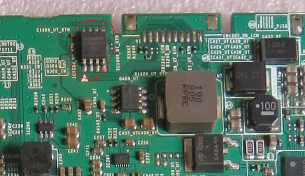

      Move IC 1603 (W25Q80) from board A (where the image is good) to board B (where the image is bad), as I understand it, board B is not original, from another TV (donor) and with a different panel diagonal.

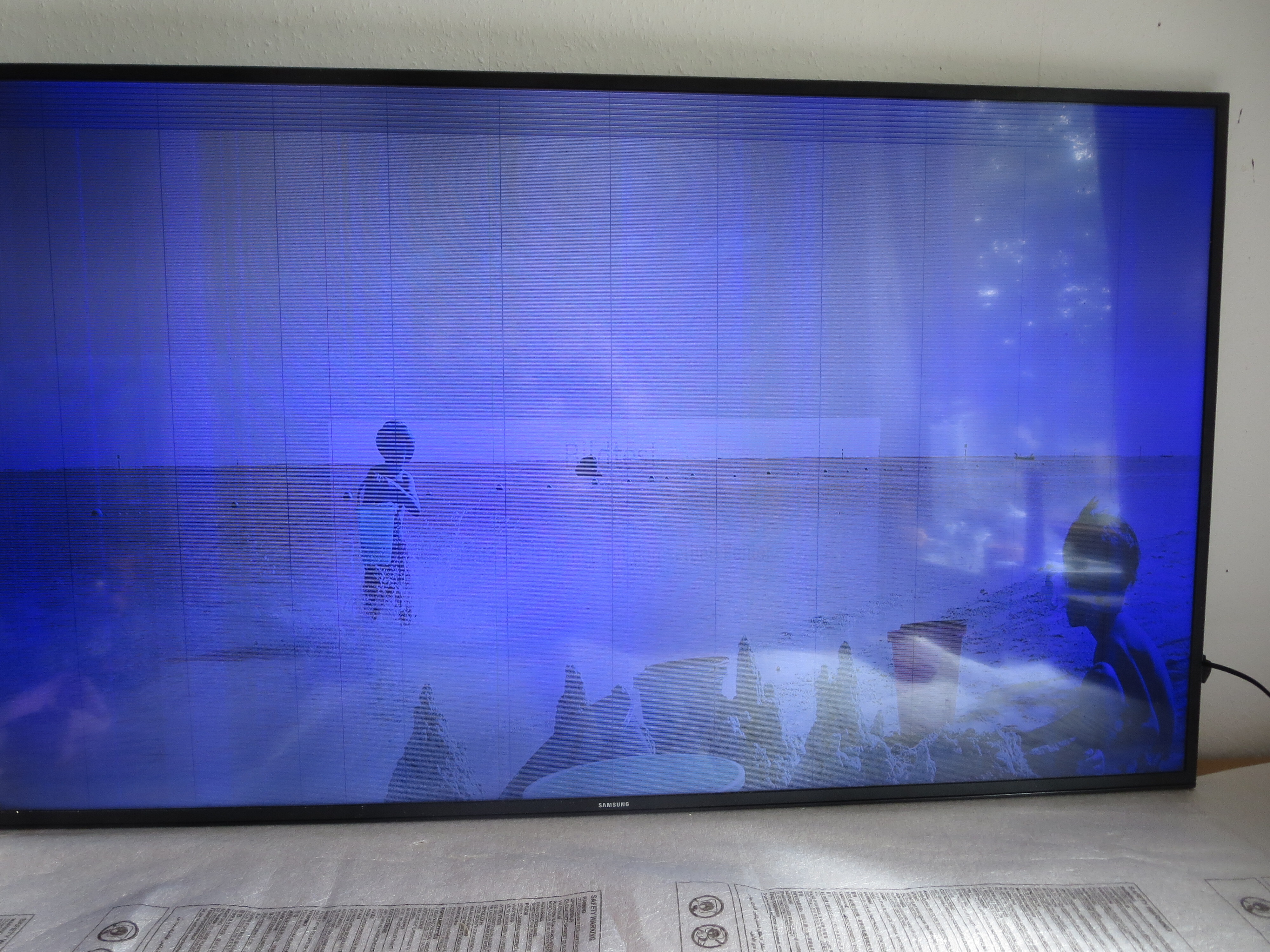

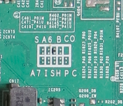

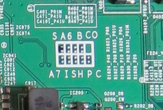

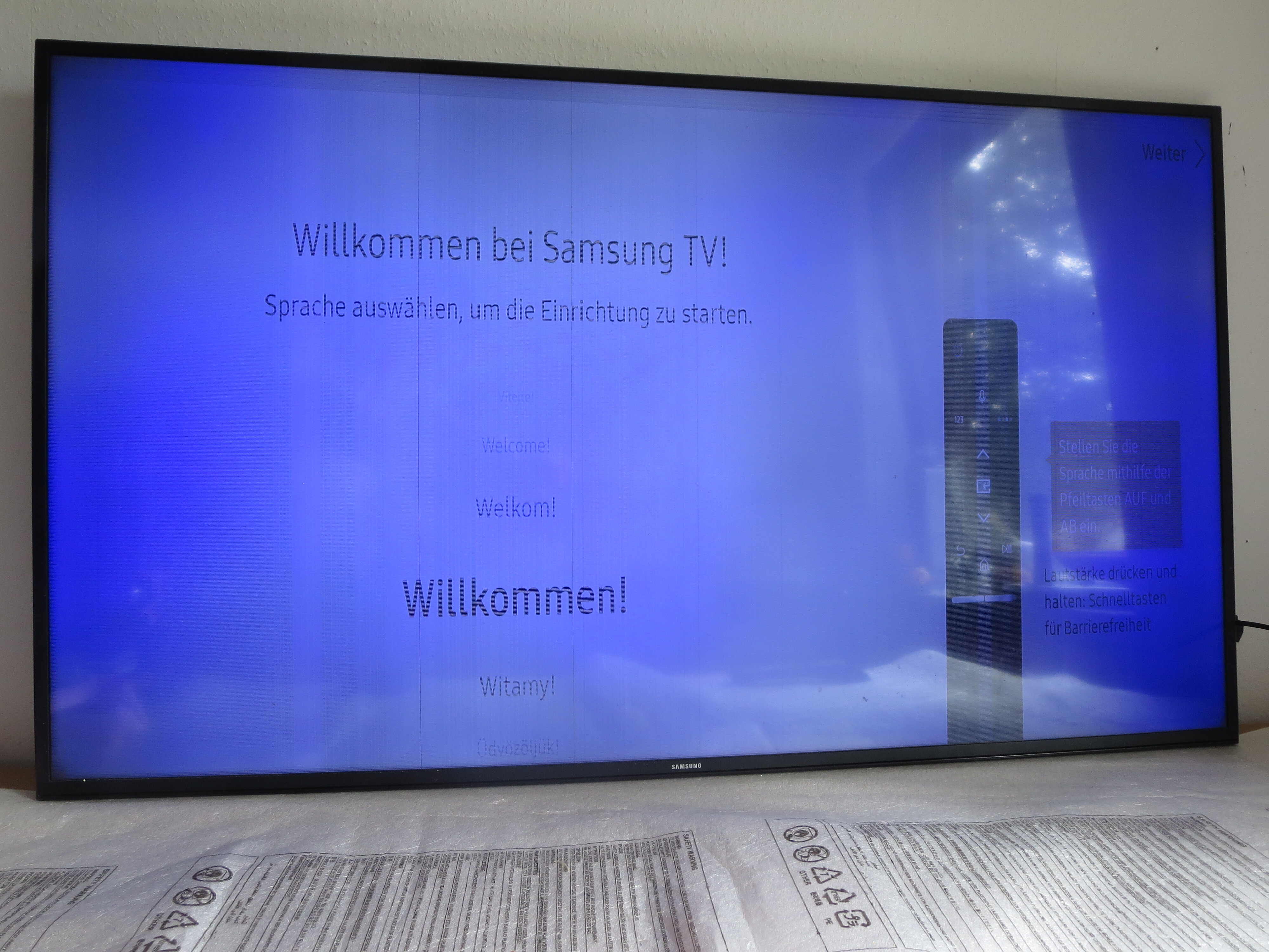

                        @lotas: thank you for pointing out the differences of the boards which may explain why the image on board B is distorted. I have added a picture of board B (distorted). Please notice the panel itself shows three vertical lines which is a fault of the panel.
                        The distorted picture (board B) has an offset to the bottom and displays many more vertical lines

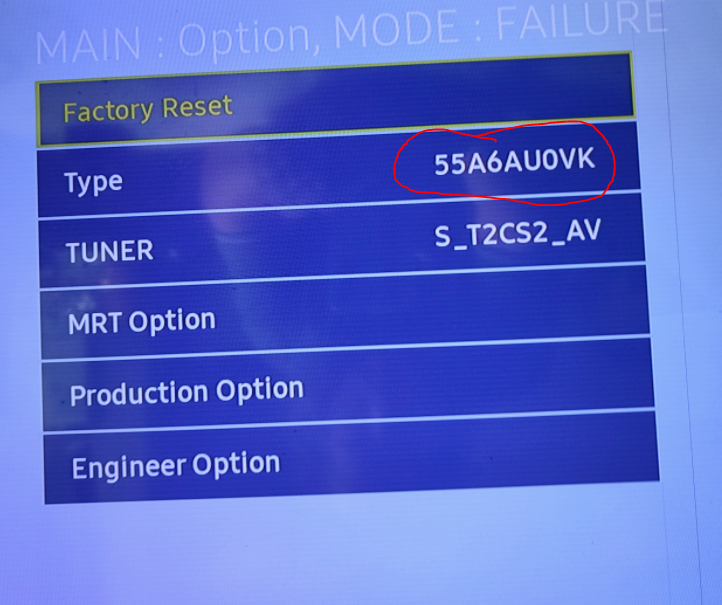

                        I did take over the service panel type from board A (which is the original board for that panel) and set it in board B without noticeable change.
                        I could try to move the resistor from position 3 (distorted) to position 1 - or would there be more differences between the two boards?
                        That would be easier than replacing an IC.
                        What I can tell: the working board from a curved mu6279 has its resistor at position 1 like board A.
                        @lotas: Could you explain why replacing the IC1603 in your post #3 would help getting rid of the distortion?

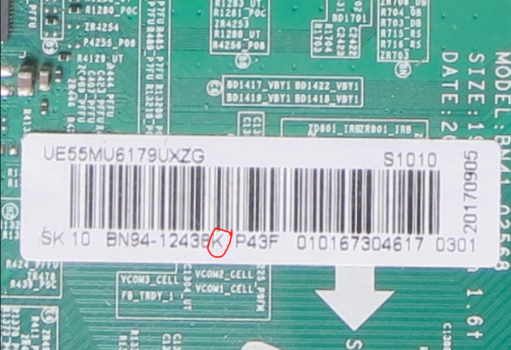

                          IC1603 (SPI Flash W25Q80) contains the T-CON firmware (all data and settings of your panel), rearranging that resistor will not give you anything.
                          Does this number match the number on your panel tag?

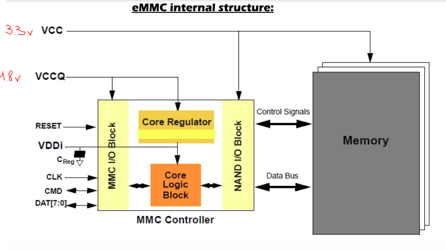

                              Originally posted by Davi.p
                              As for what i remeber many emmc needs dual voltage to be able to both read & write, 3,3v is the basic Vcc and 1,8v is for writing
                              Where did you get such knowledge, if you don't know, then don't mislead people.
                              eMMC has two power supplies, one for NAND memory (3.3v) and the second for the built-in controller (1.8 - 3.3v).
                              eMMC (embedded Multimedia Memory Card) is essentially a device where the interface controller is combined with flash memory (NAND design). In addition to the function of providing the interface, the controller independently corrects errors and manages bad blocks in NAND memory. Below, for understanding, is the internal simplified structure of eMMC.
