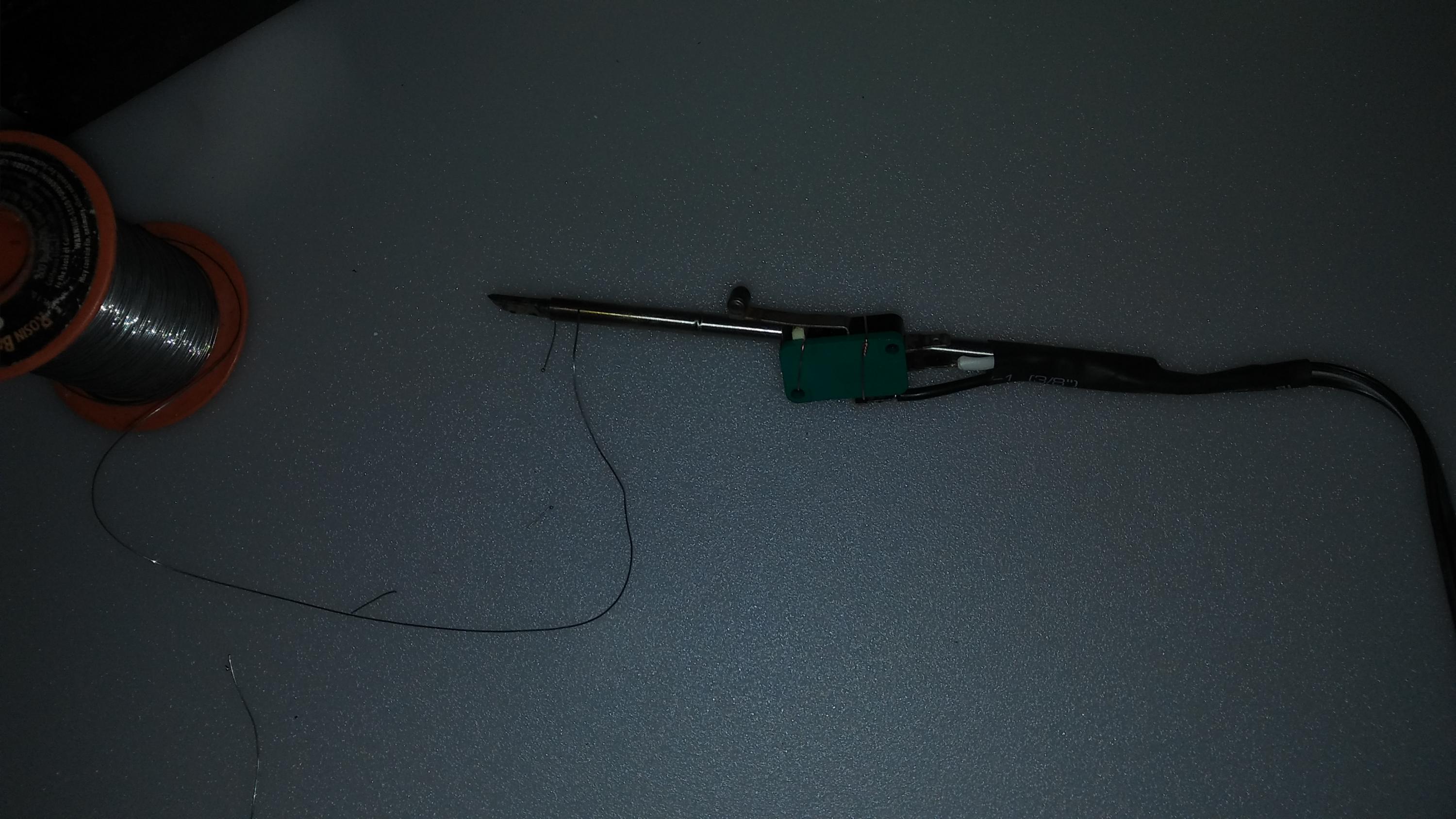

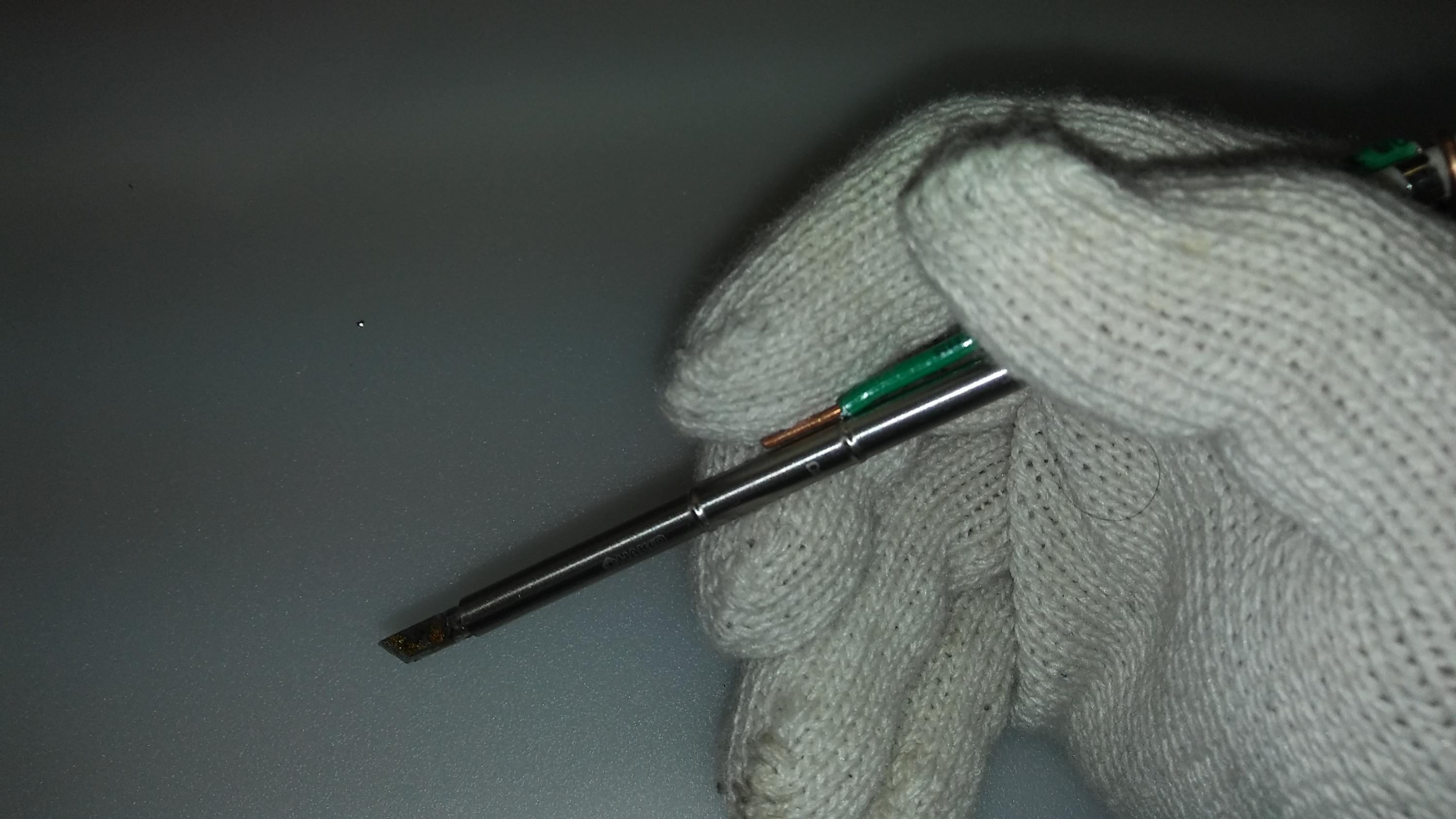

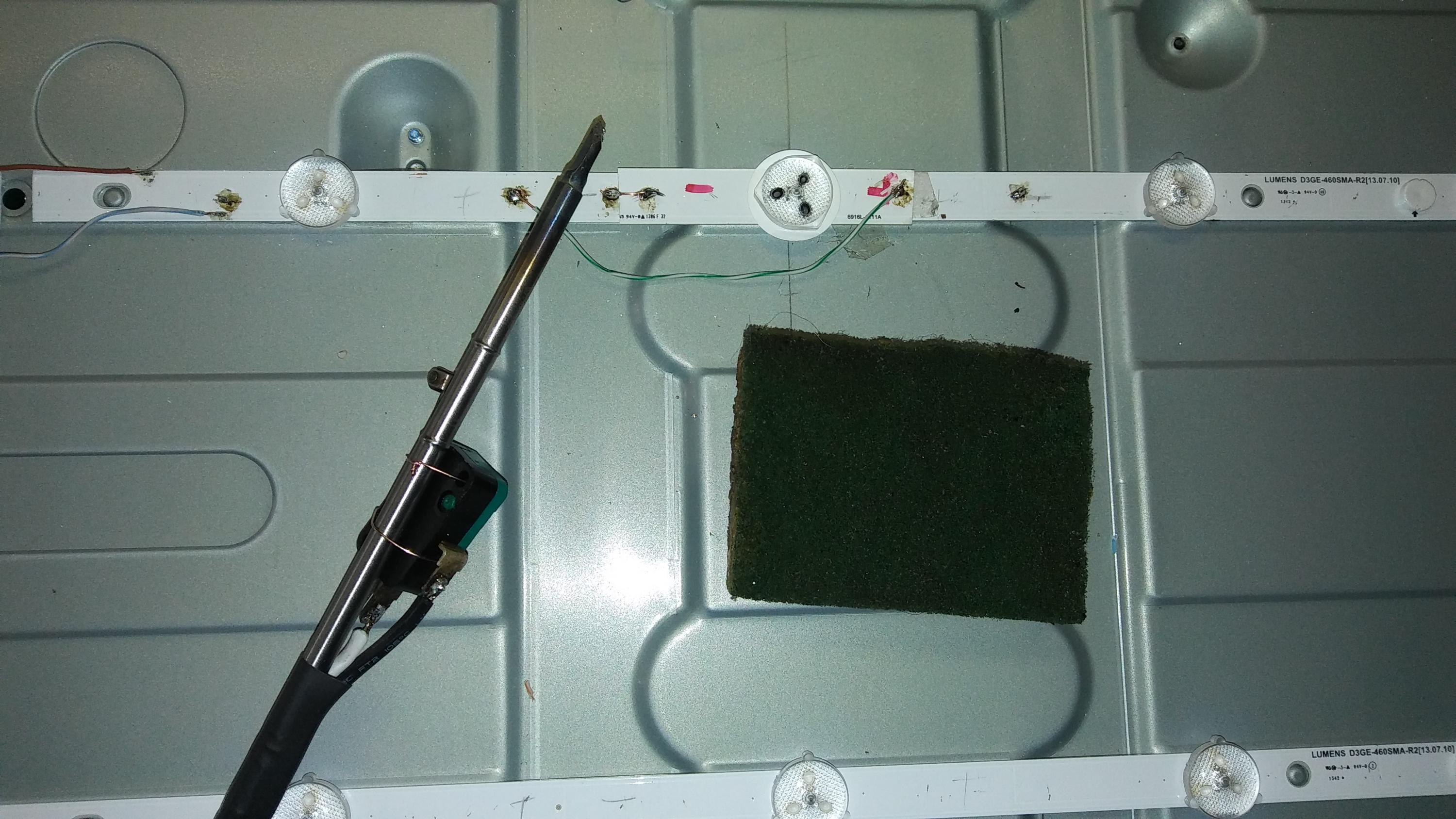

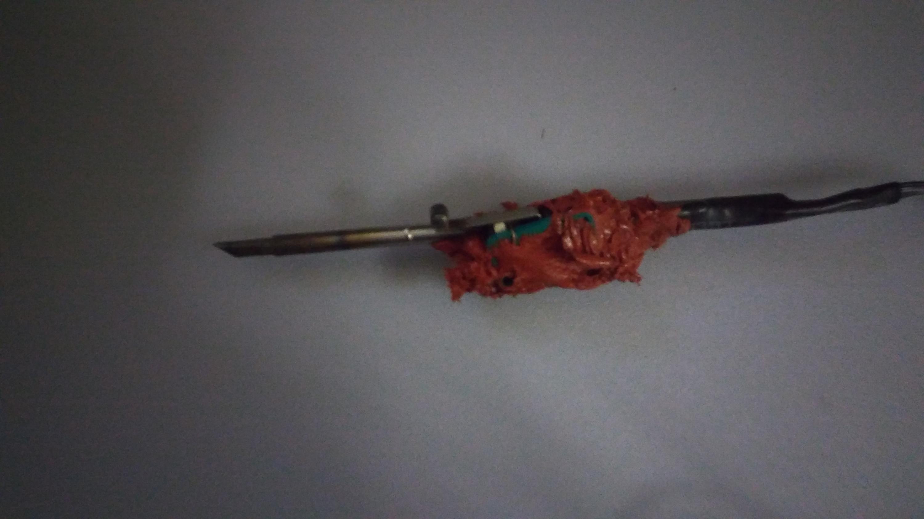

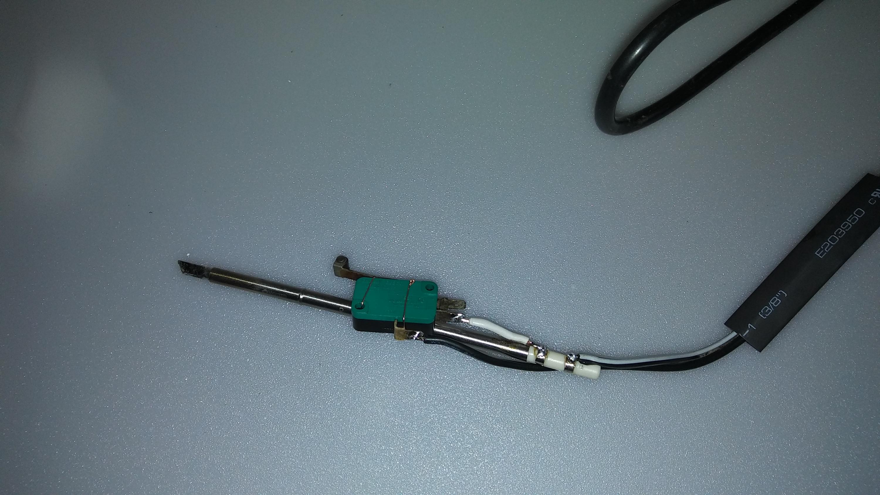

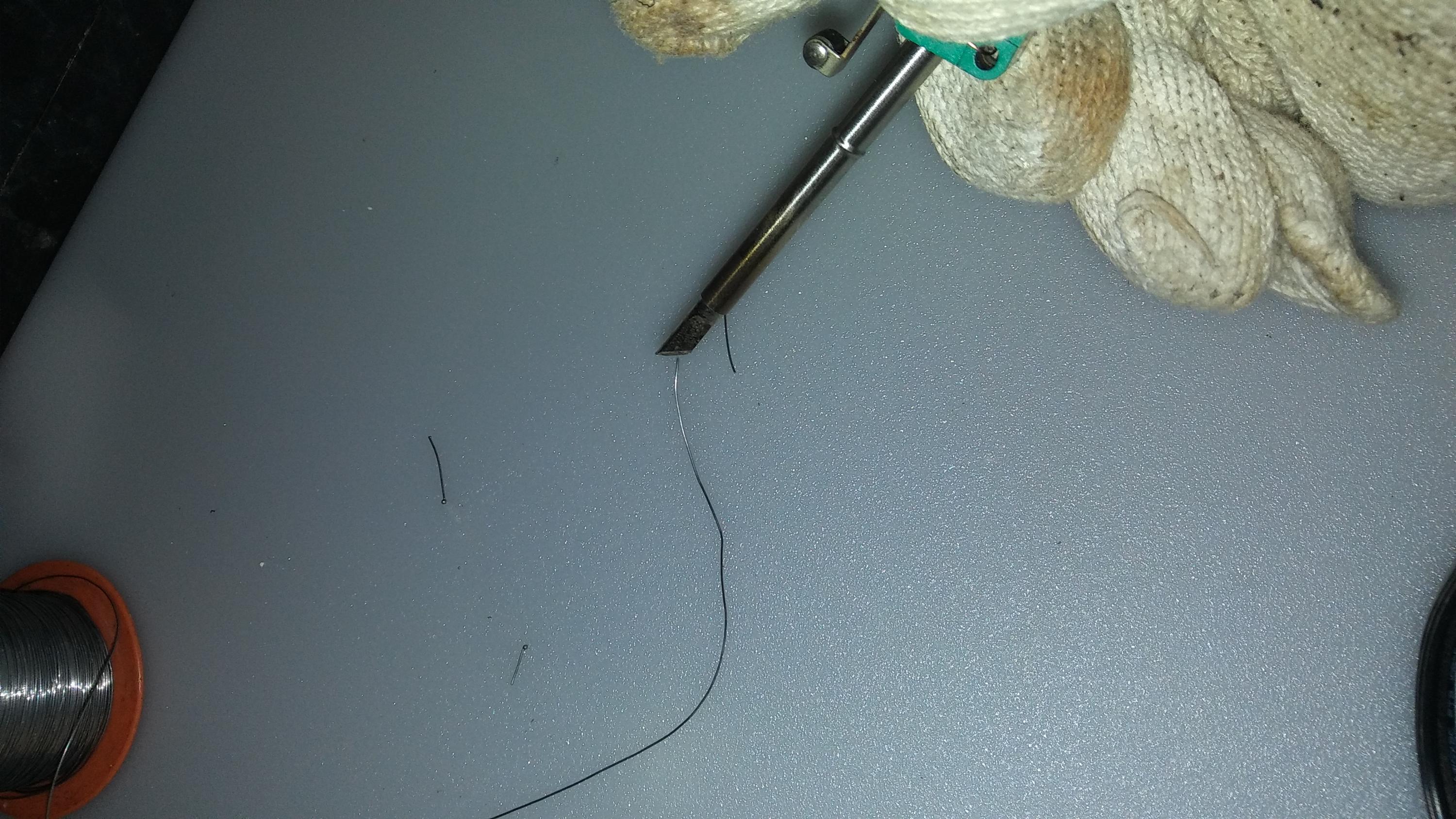

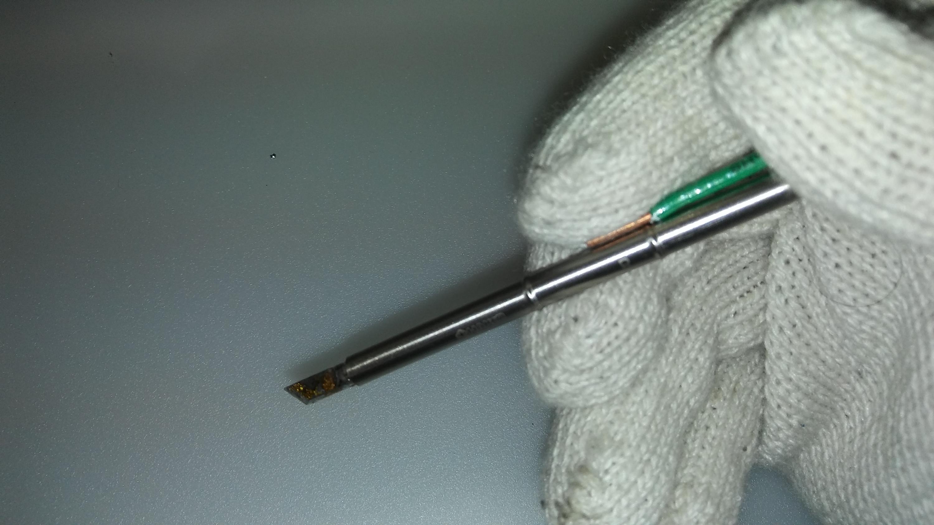

    Poorman's T12
    Dirt cheap T12 soldering iron more power than TS 100!!!
    If TS100 needs 10 sec. to heat-up to 300c, this one only needs 8 sec. depend on what kind power supply you use.

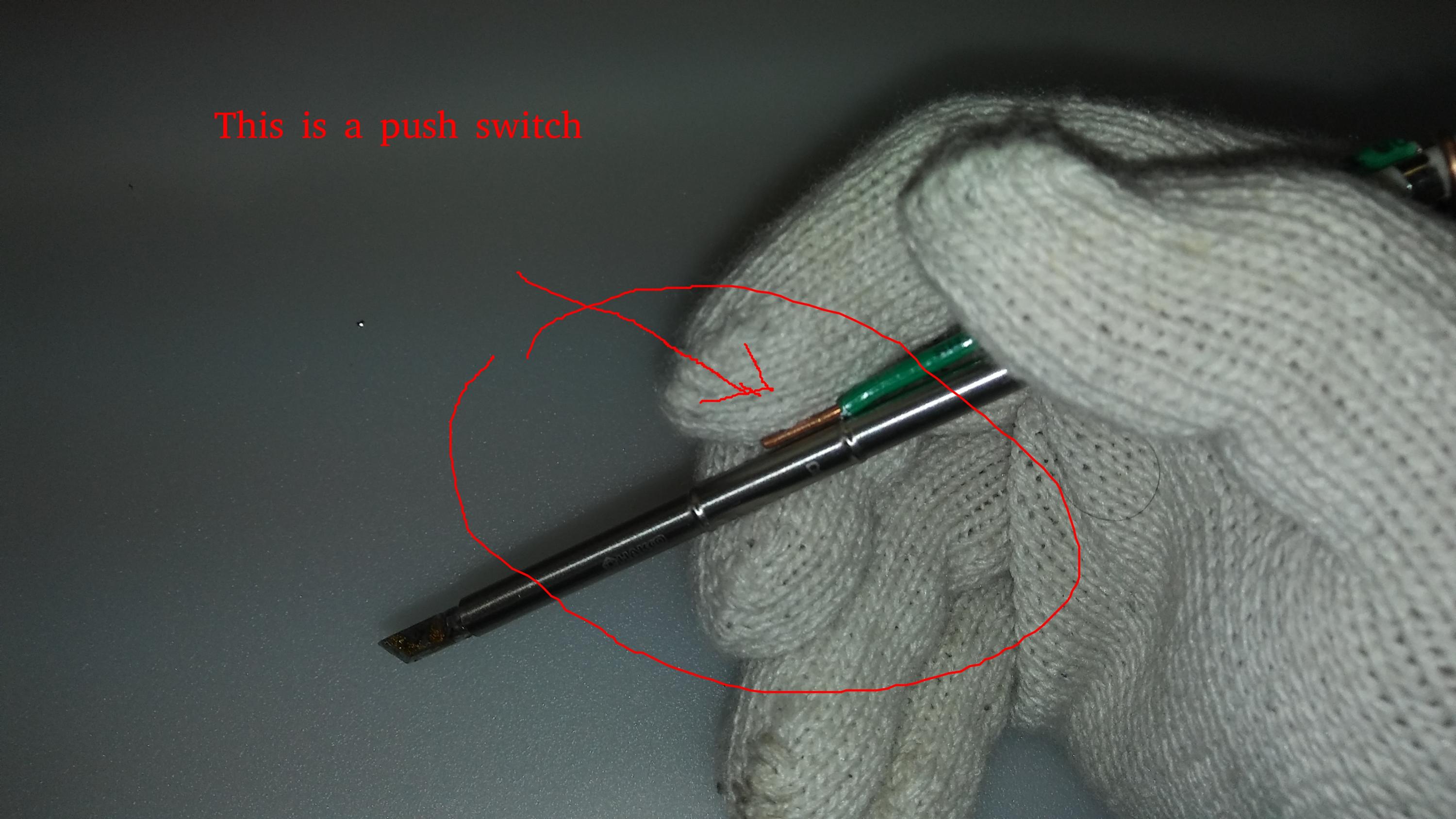

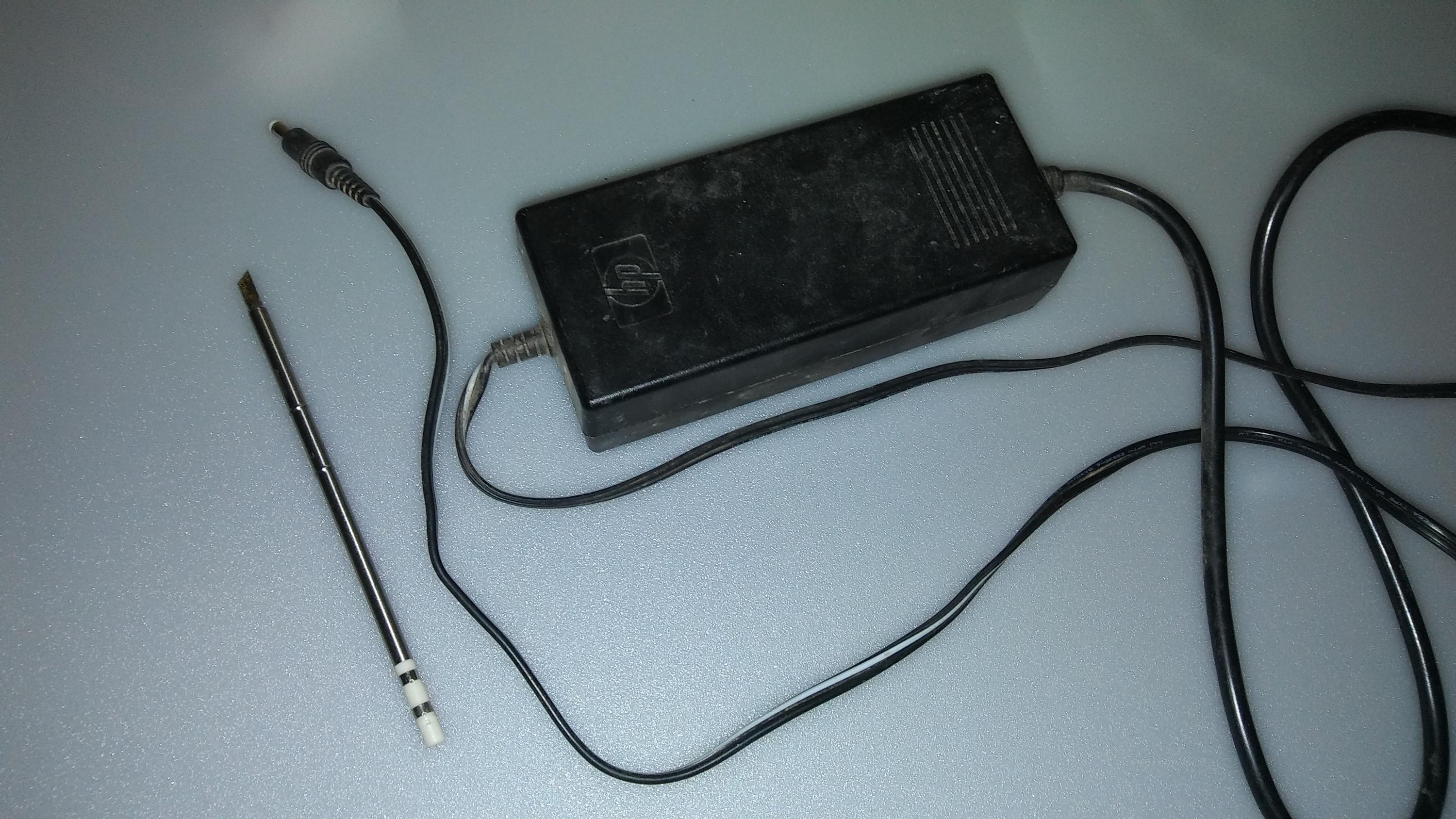

    Ac adapter use 31v HP old printer AC adapter, more power than 24v, power cable solder right on the top of tips bit, switch use copper wire, simple and easy , long time usage please wear glove.
    PS: this is a prototype, more T12 tips are on the way, will built real one, very good for Pulse user, you use a while then set for long time...

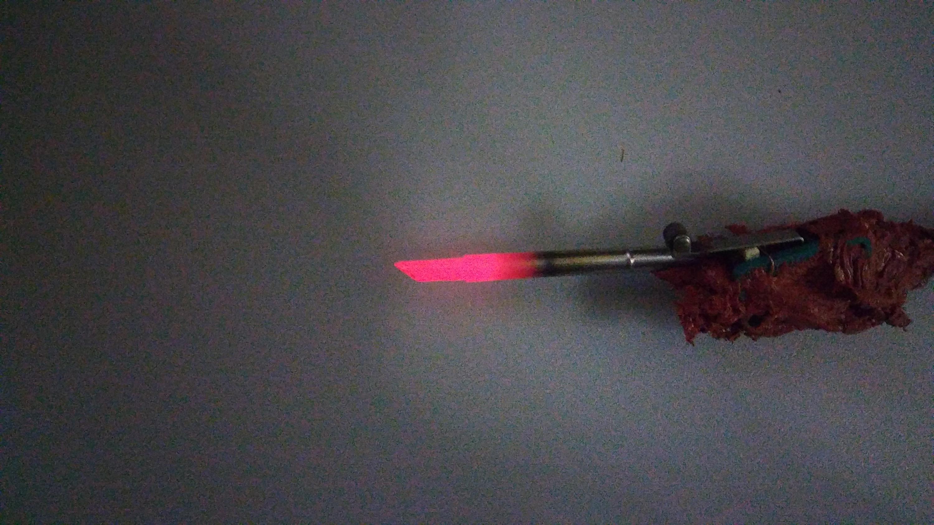

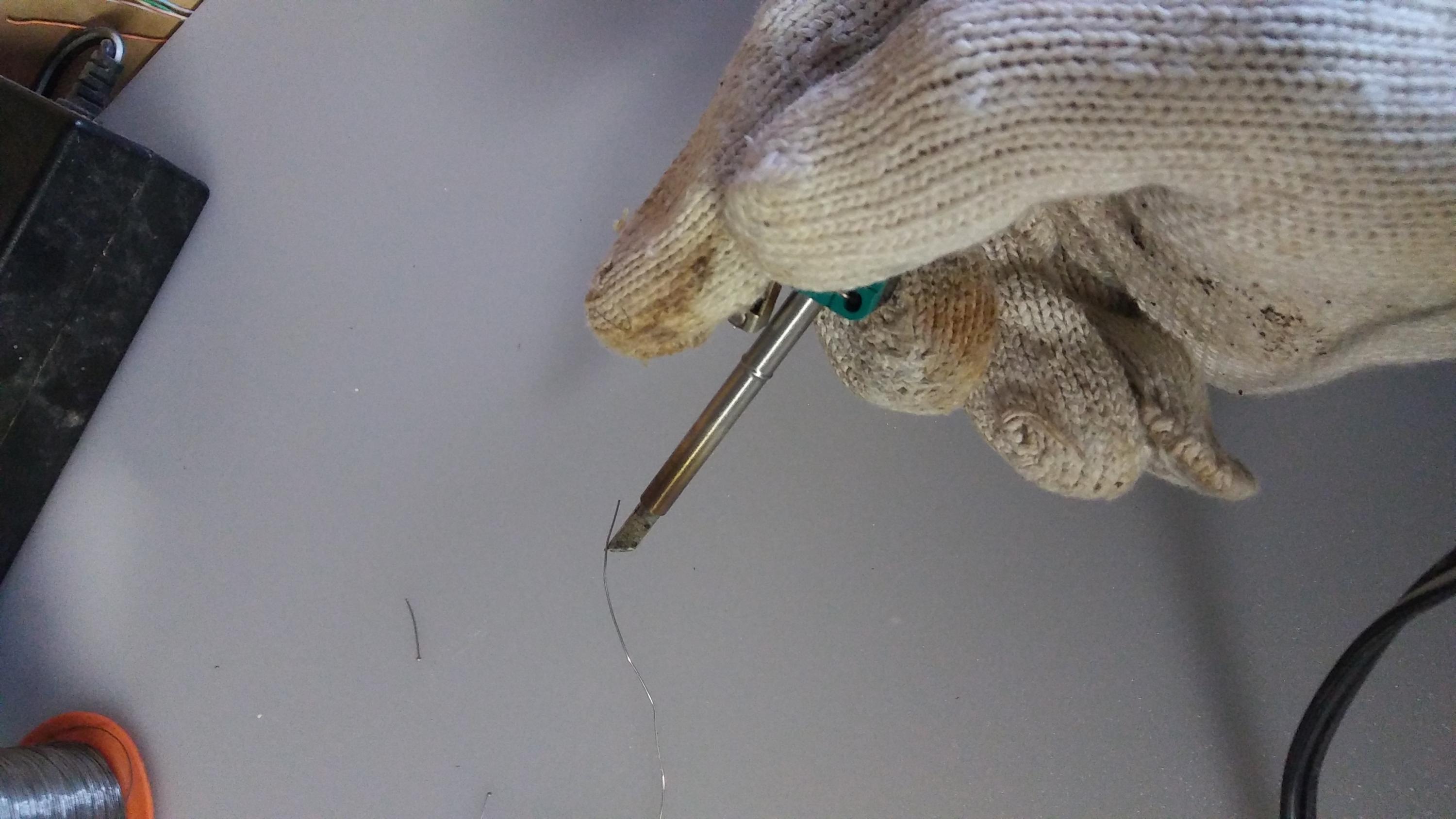

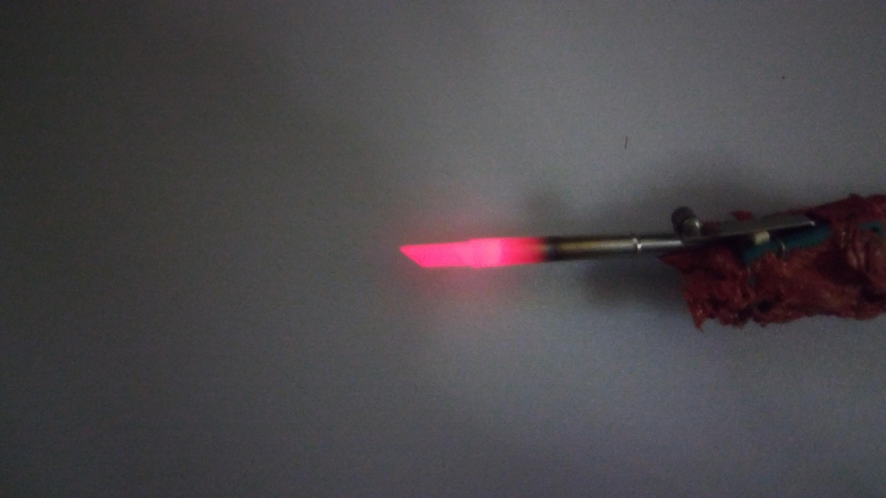

      Re: Poorman's T12

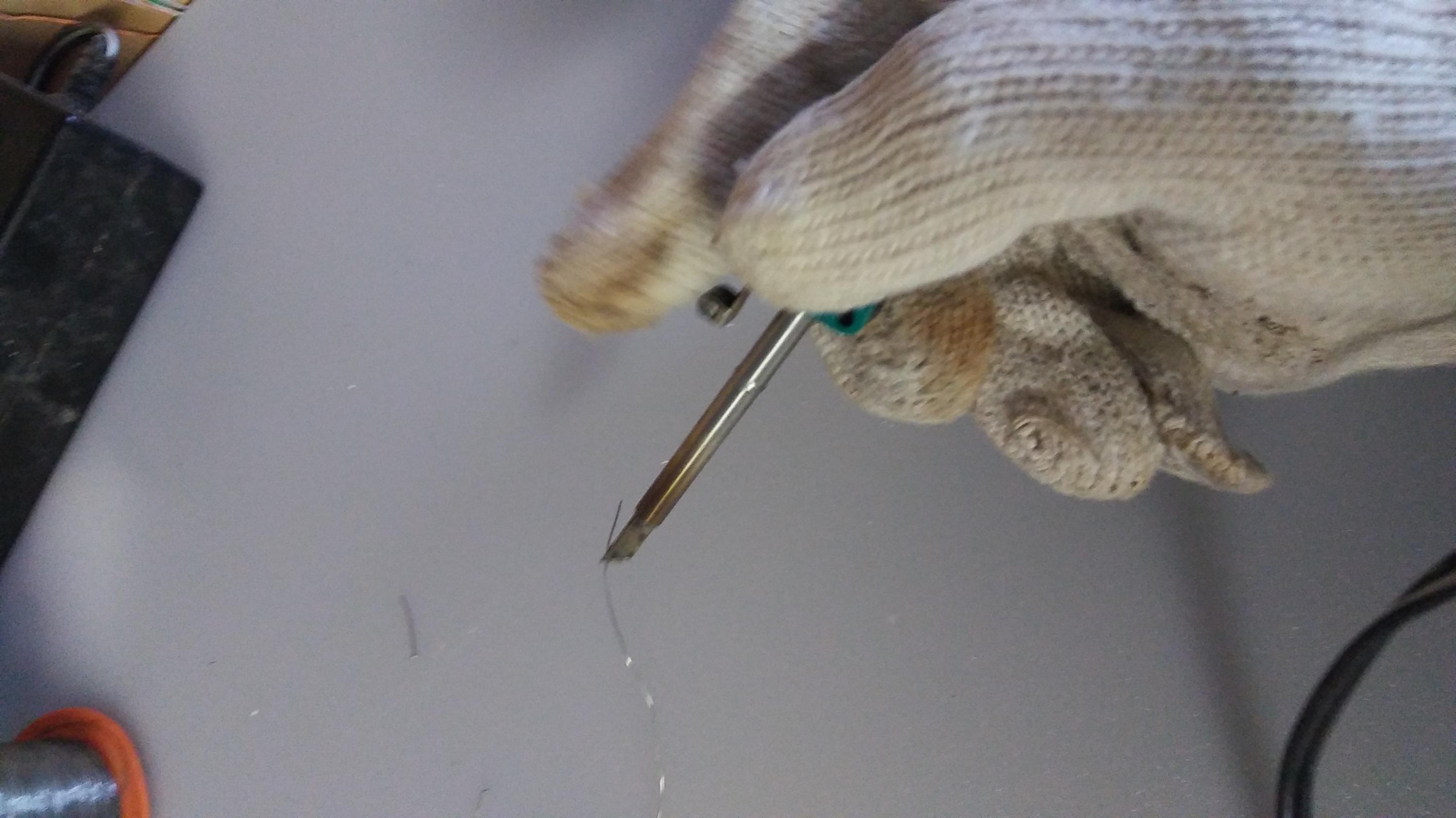

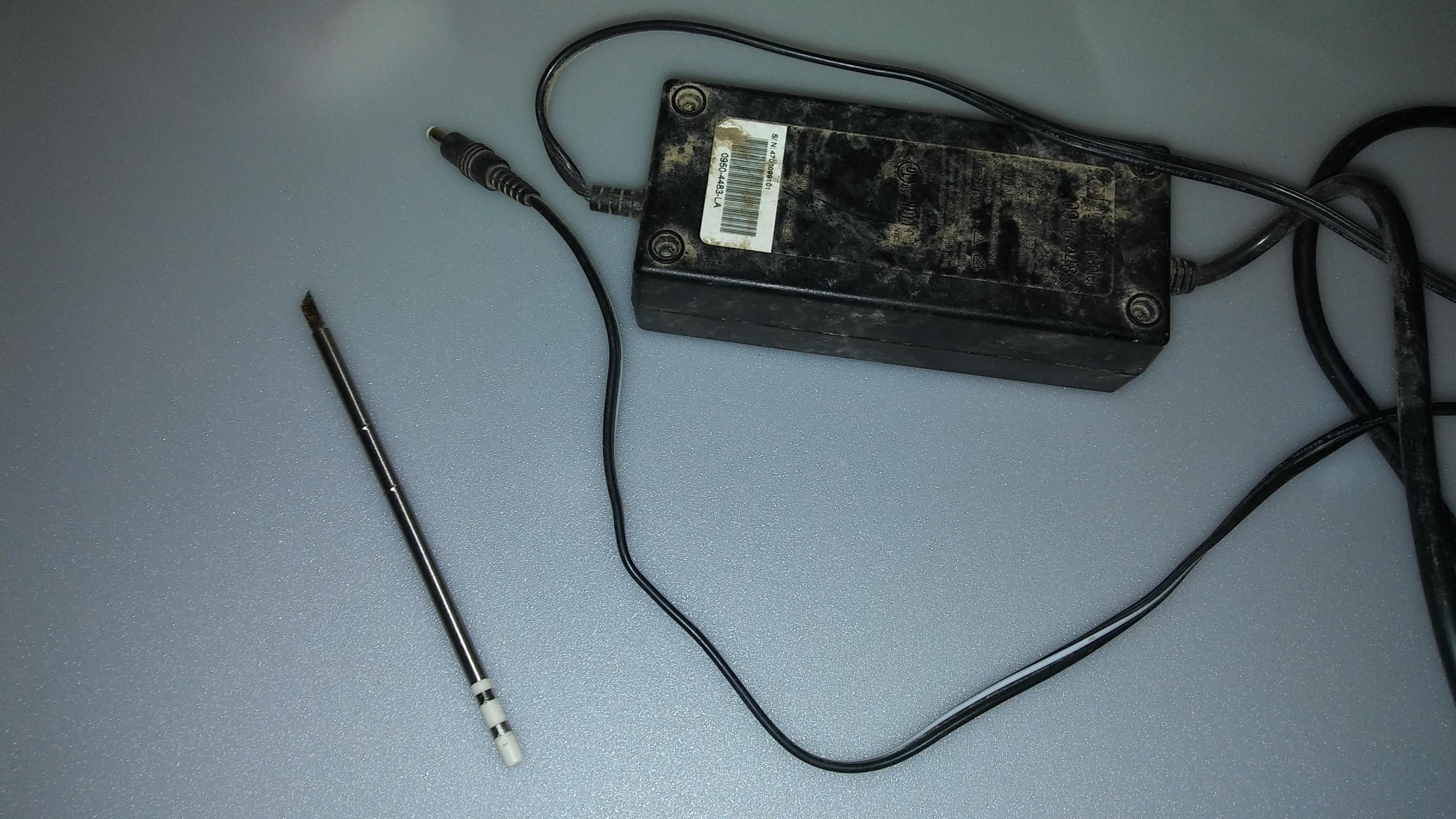

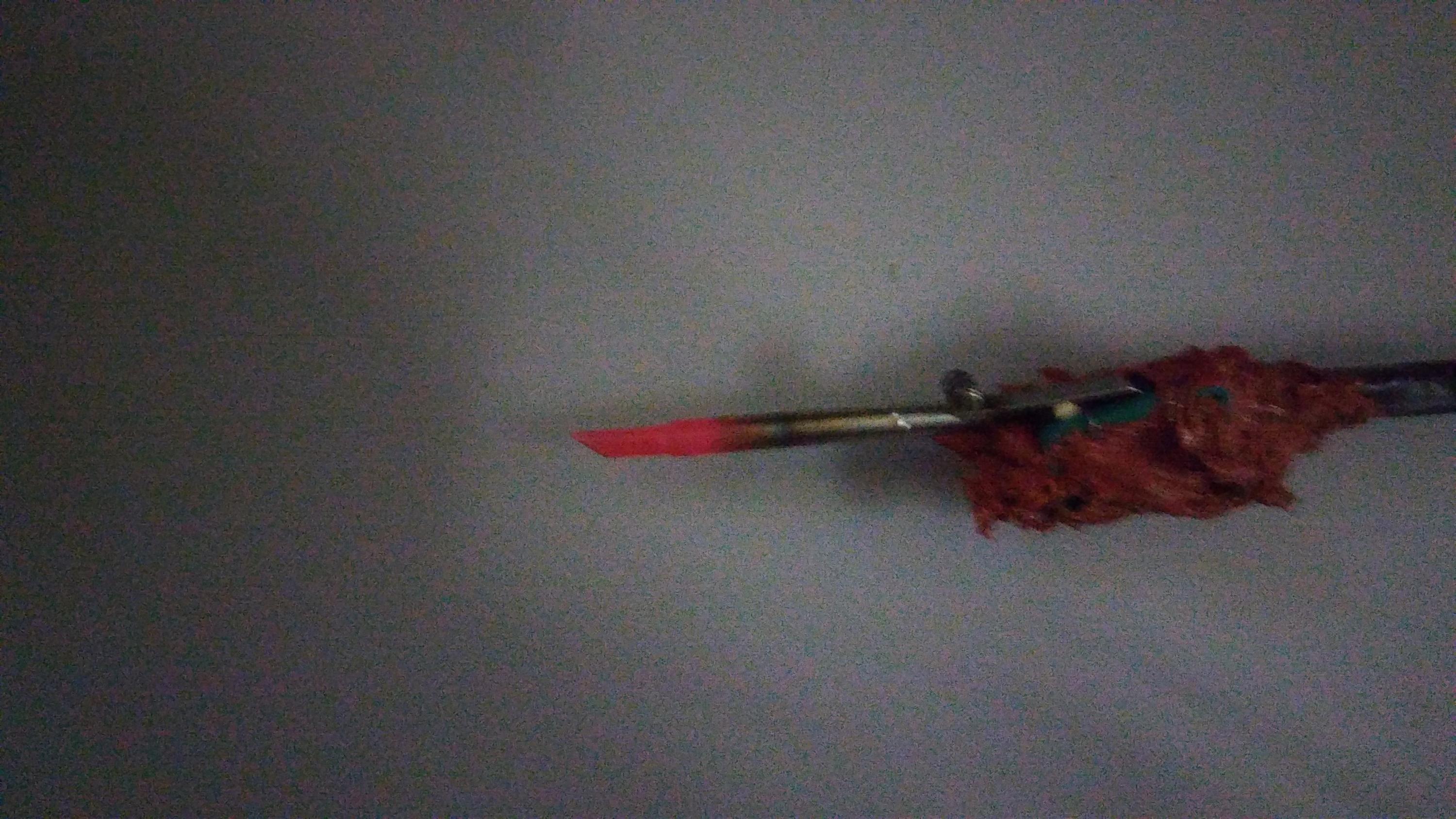

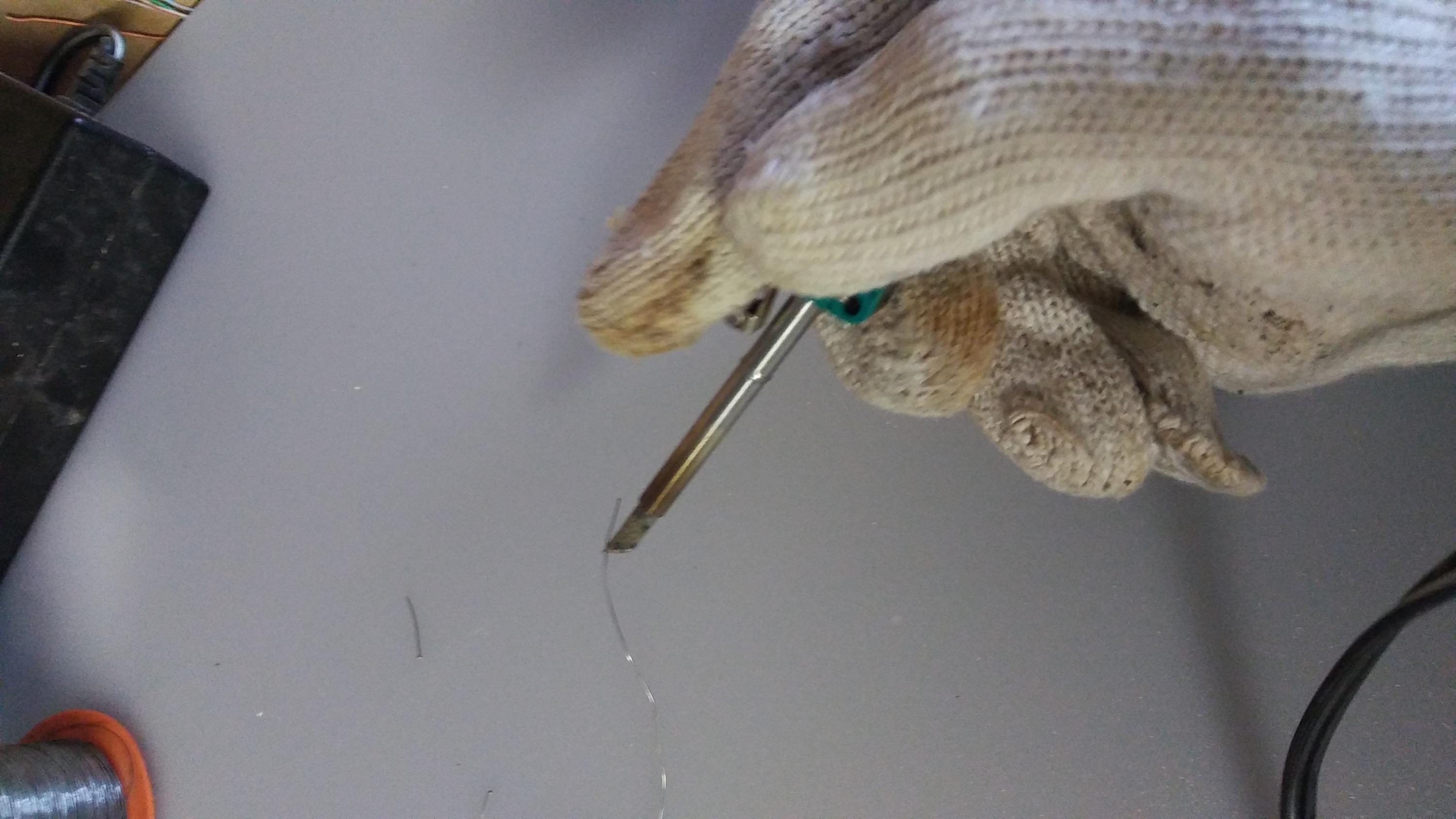

      Work wounderful....
      only took 3 sec. to melt the solder!!! This is the best Christmas gift for myself
      31v 2.420A old HP printer ac adapter was used.

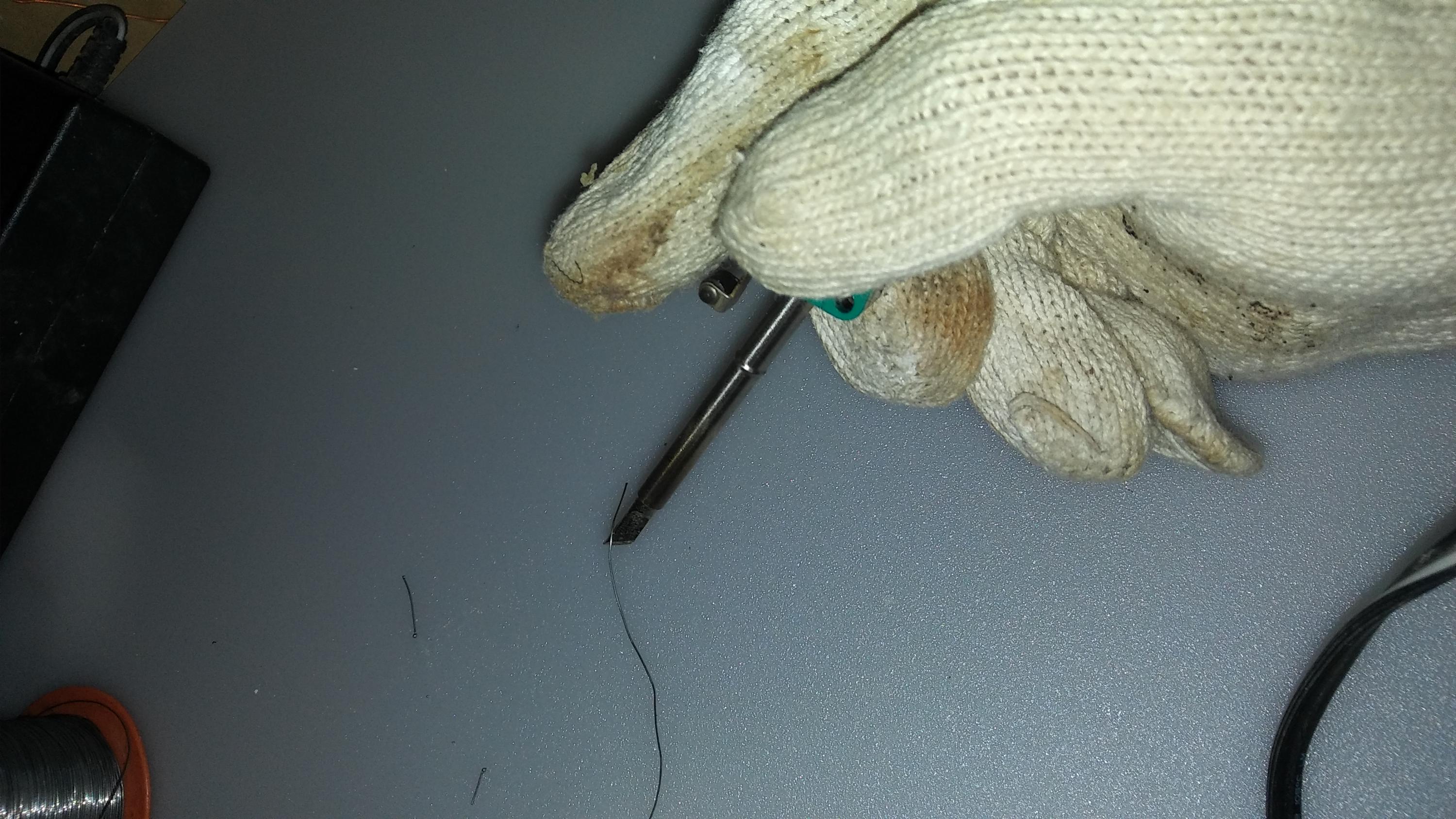

        Re: Poorman's T12
        Its fun, I need some practice to use this solder iron. kinda simulate PWM or relay, your fingertip push on and off, you will get used to it in no time. For me is better than TS100.... T12 tips I feel is not very good quality, instead of using cheap clone T12, we should support the original maker Hakko....at lease solder tips...

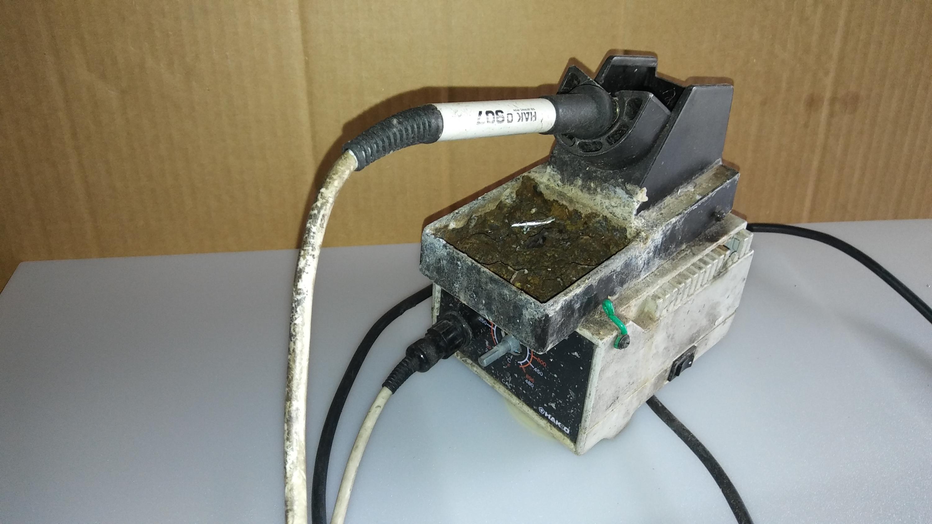

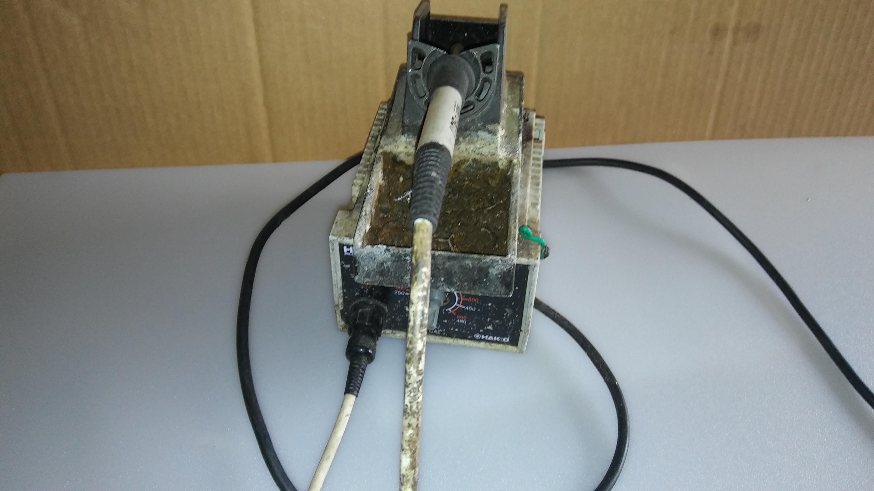

            Re: Poorman's T12
            Yes this is the Hakko, if not because I spread coca cola inside it will still working.

              Re: Poorman's T12
              it needs a new sponge!

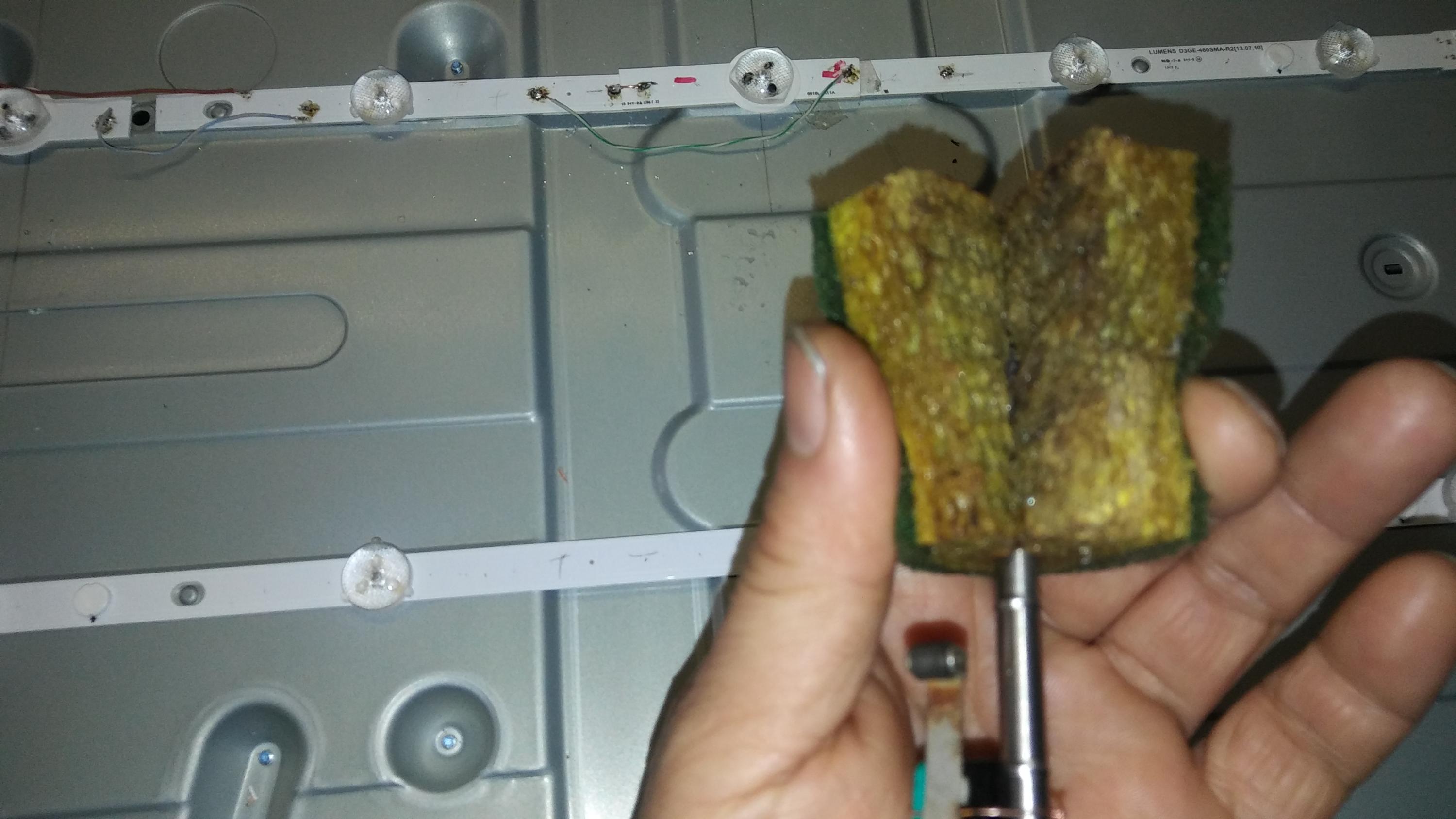

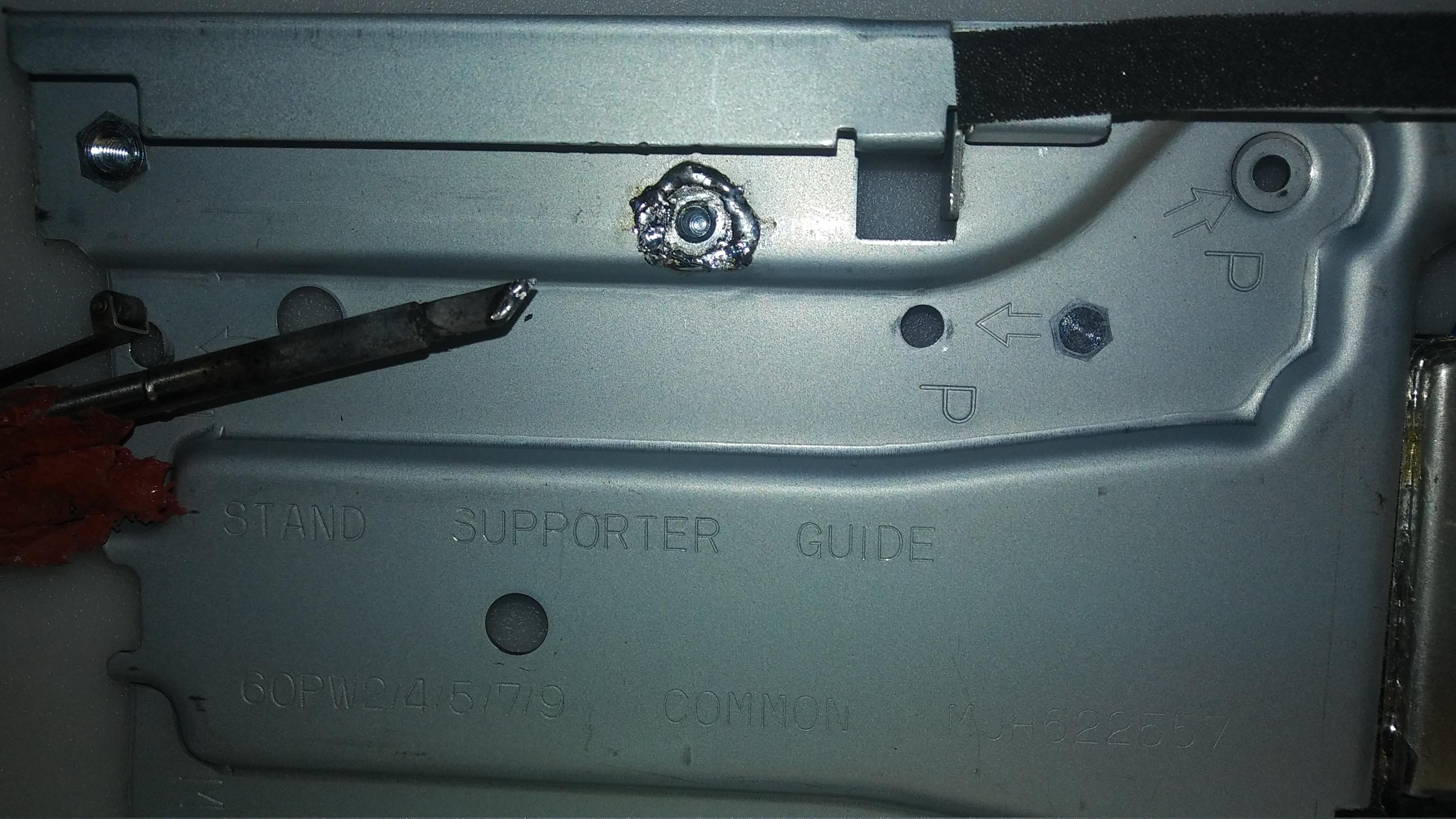

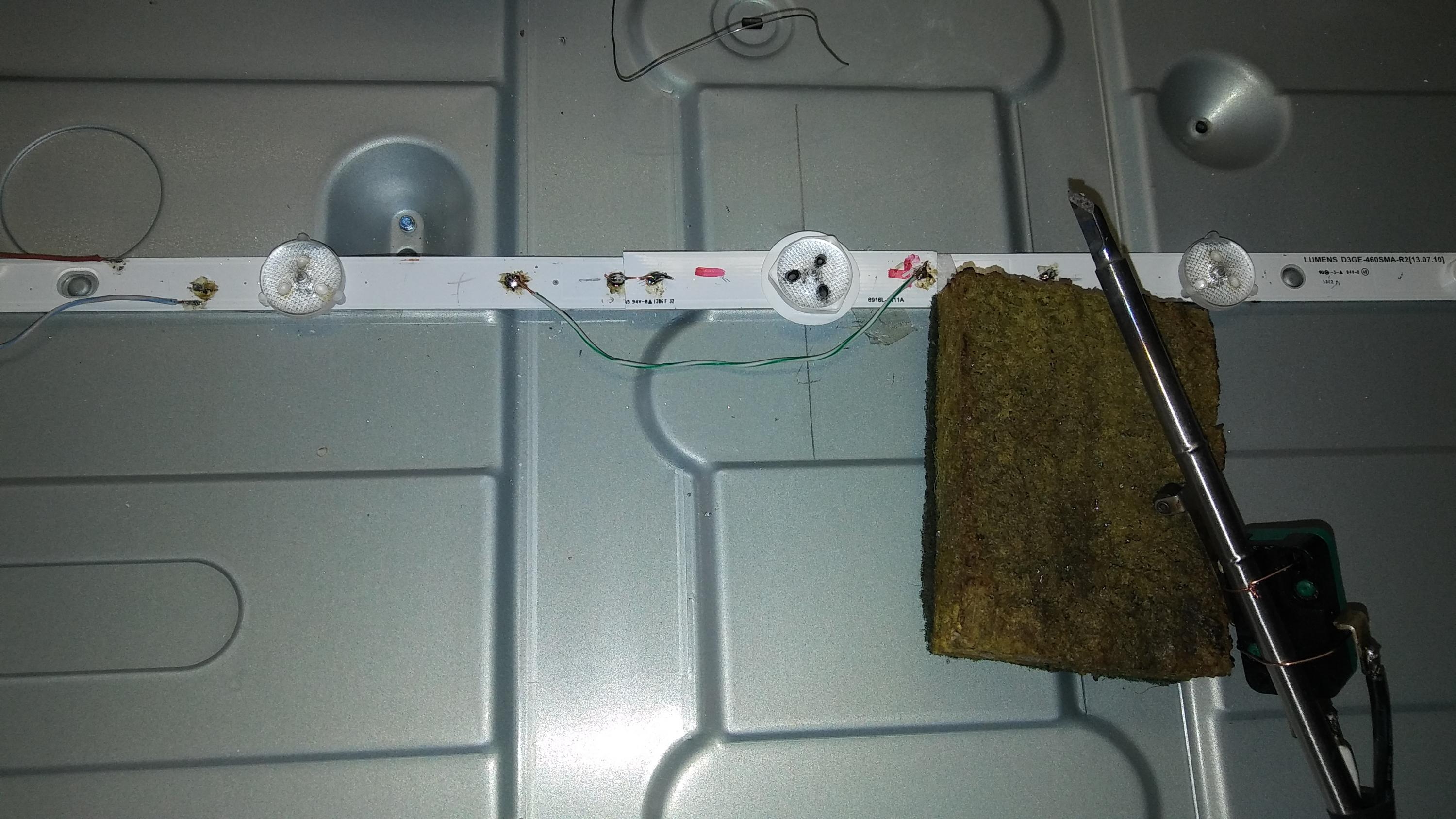

                Re: Poorman's T12

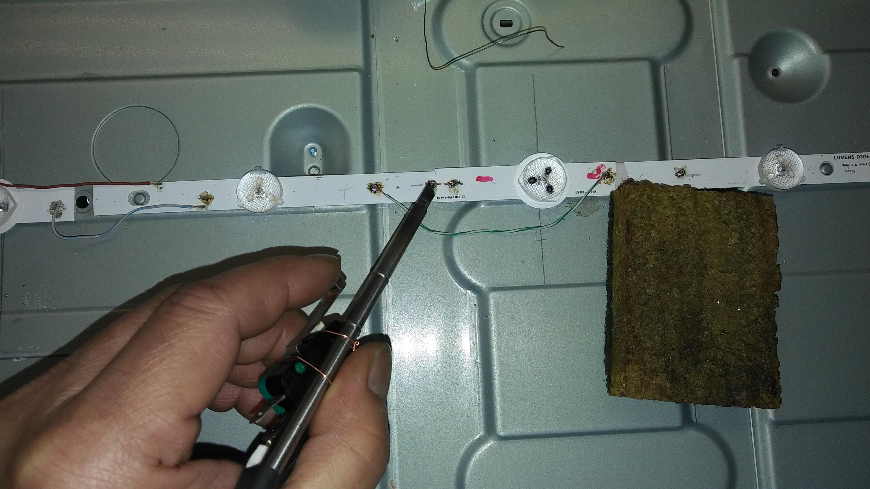

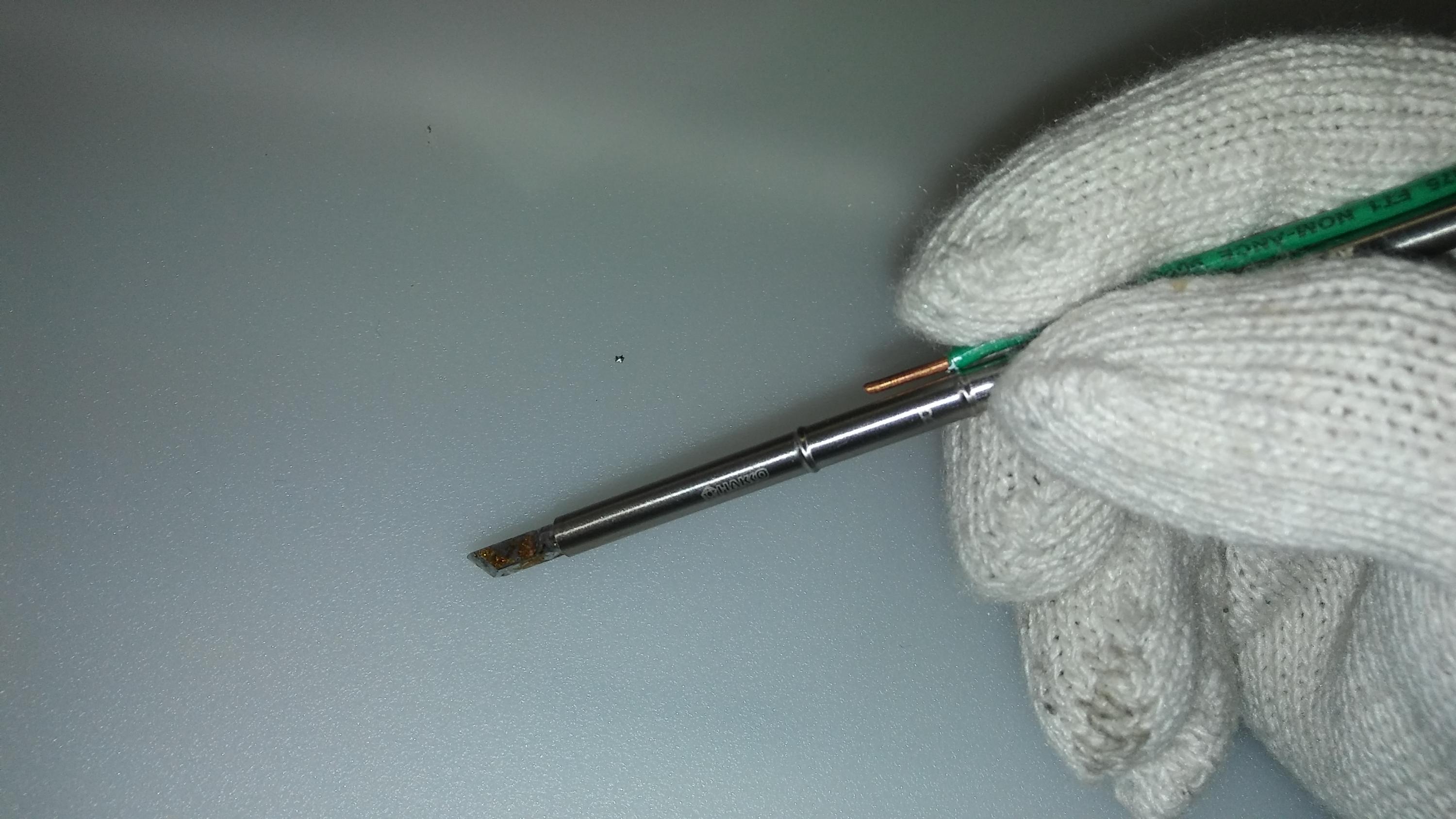

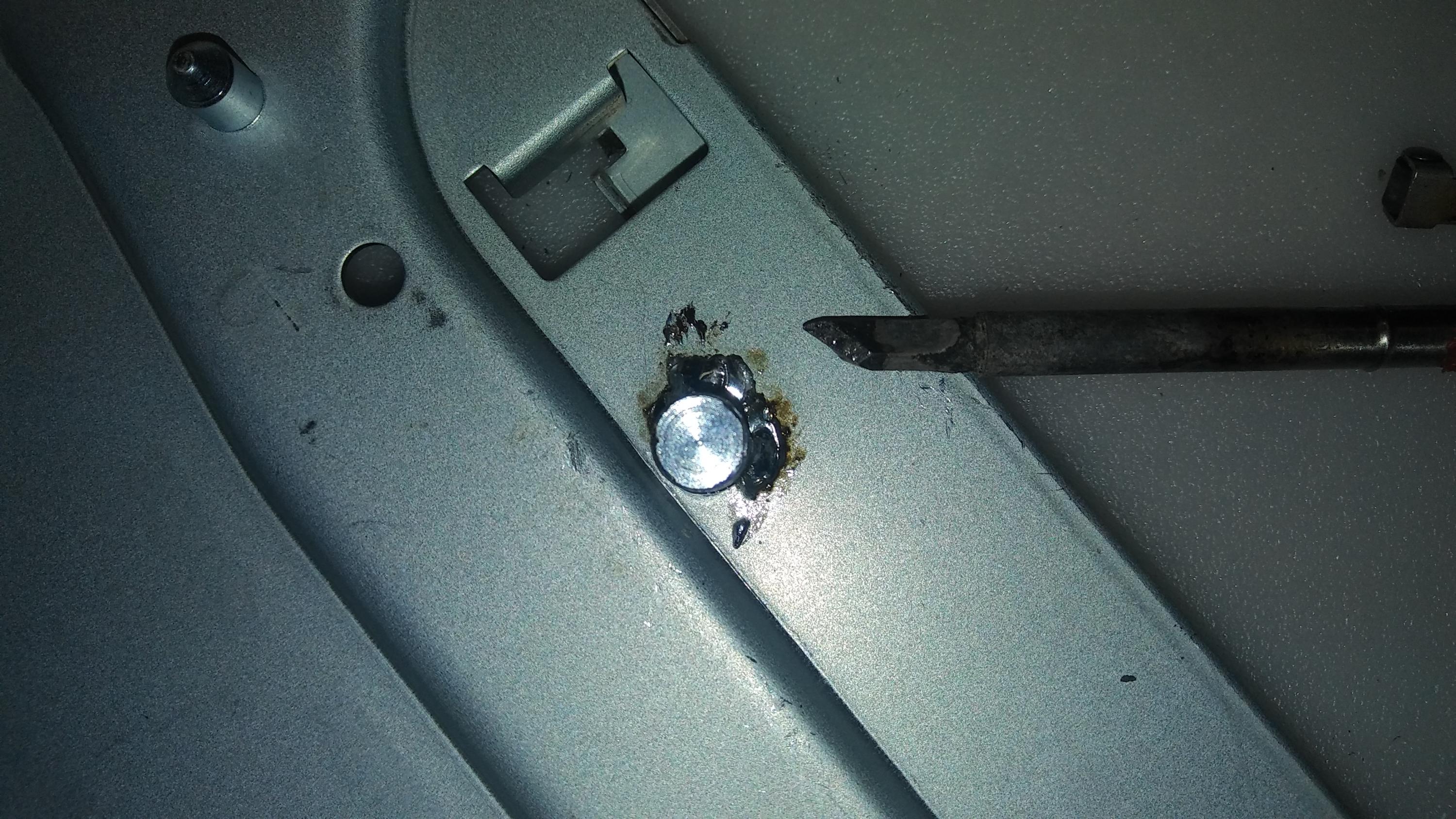

                Here you are! The 3m Scotch Brite sponge is the must to take away the heart especially on this DIY solder iron.
                with this solder iron about 10 pushes total, I finished change dLEDs job very quickly, and I dont need to worry about the iron is hot when I have to talk to customer.

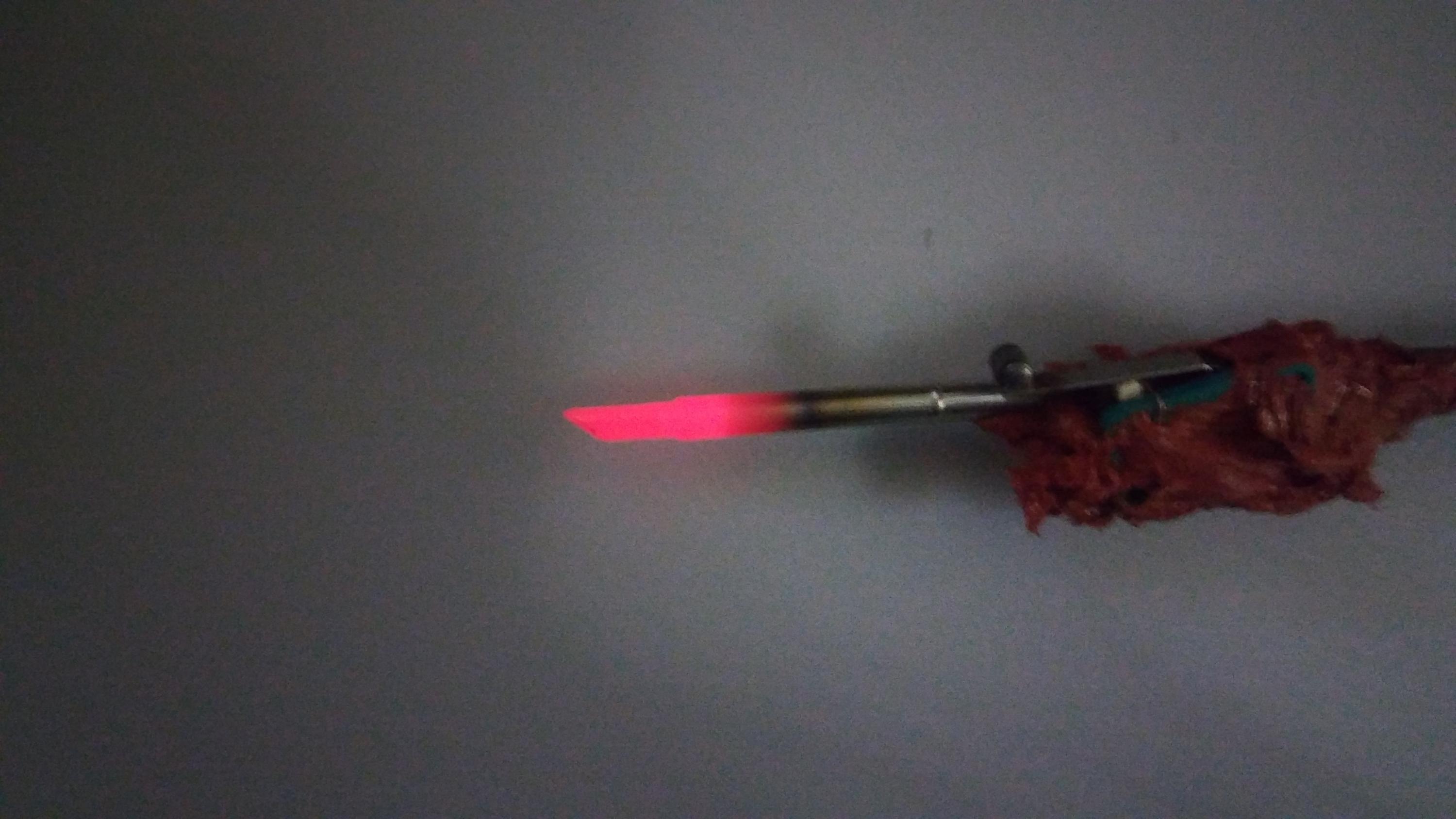

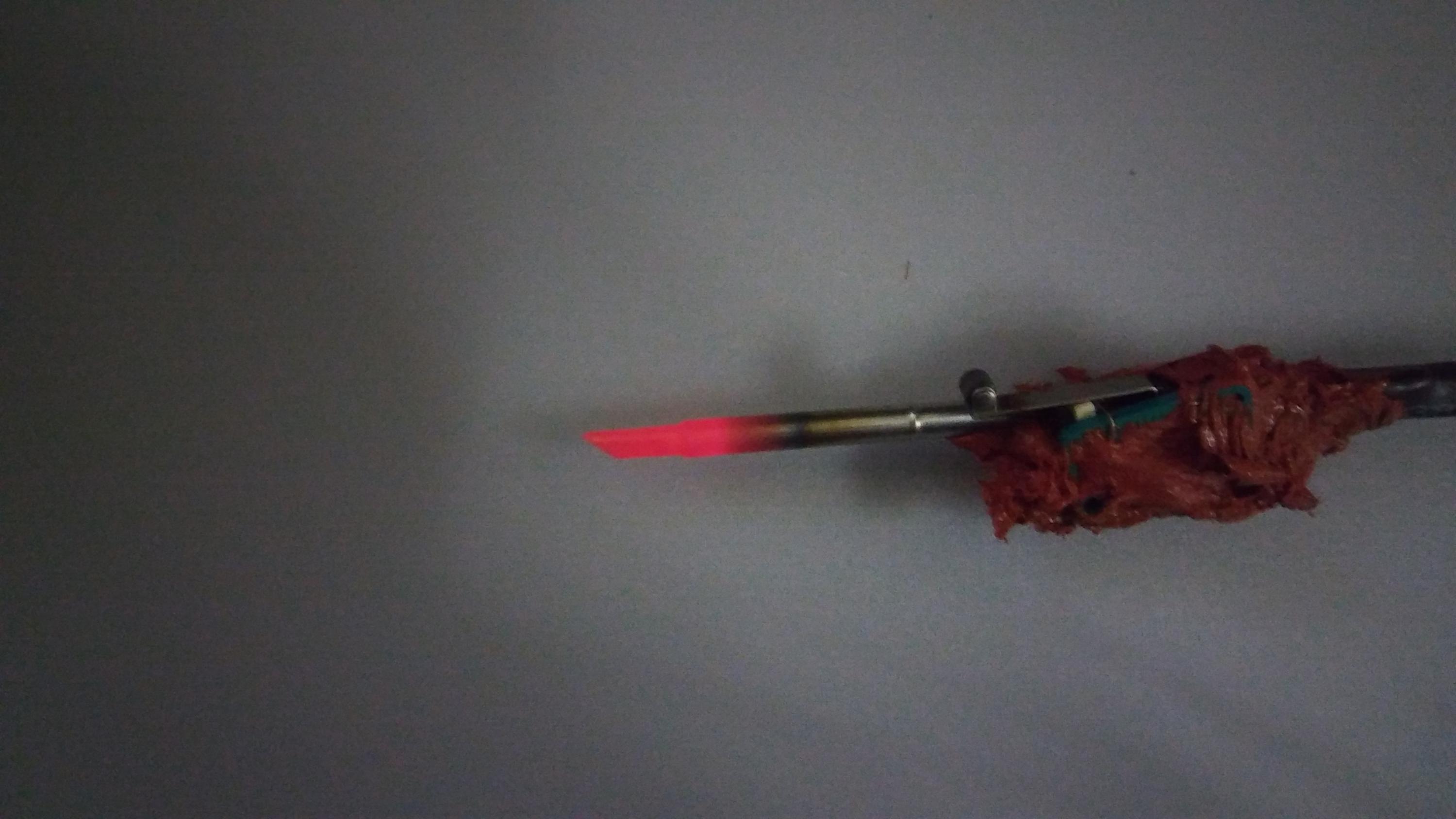

                  UPDATE:
                  This is the most powerful iron I ever use, 3 sec ready, don't need to over power this iron tip, so I'm gonna change back to common smaller easy to access laptop AC adapter 19v- 23v 2A , is enough for it, because sometime I forgot and keep push the button until the whole tip is red hot.
                  YES, still work OK, so far, so good, I think this can light up your gas BBQ.

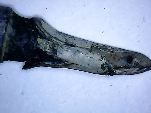

                    Re: Poorman's T12
                    I dont understand this T12 tip, the more red hot it get the more clean the tip is? most tips will get oxidized and can not use anymore?

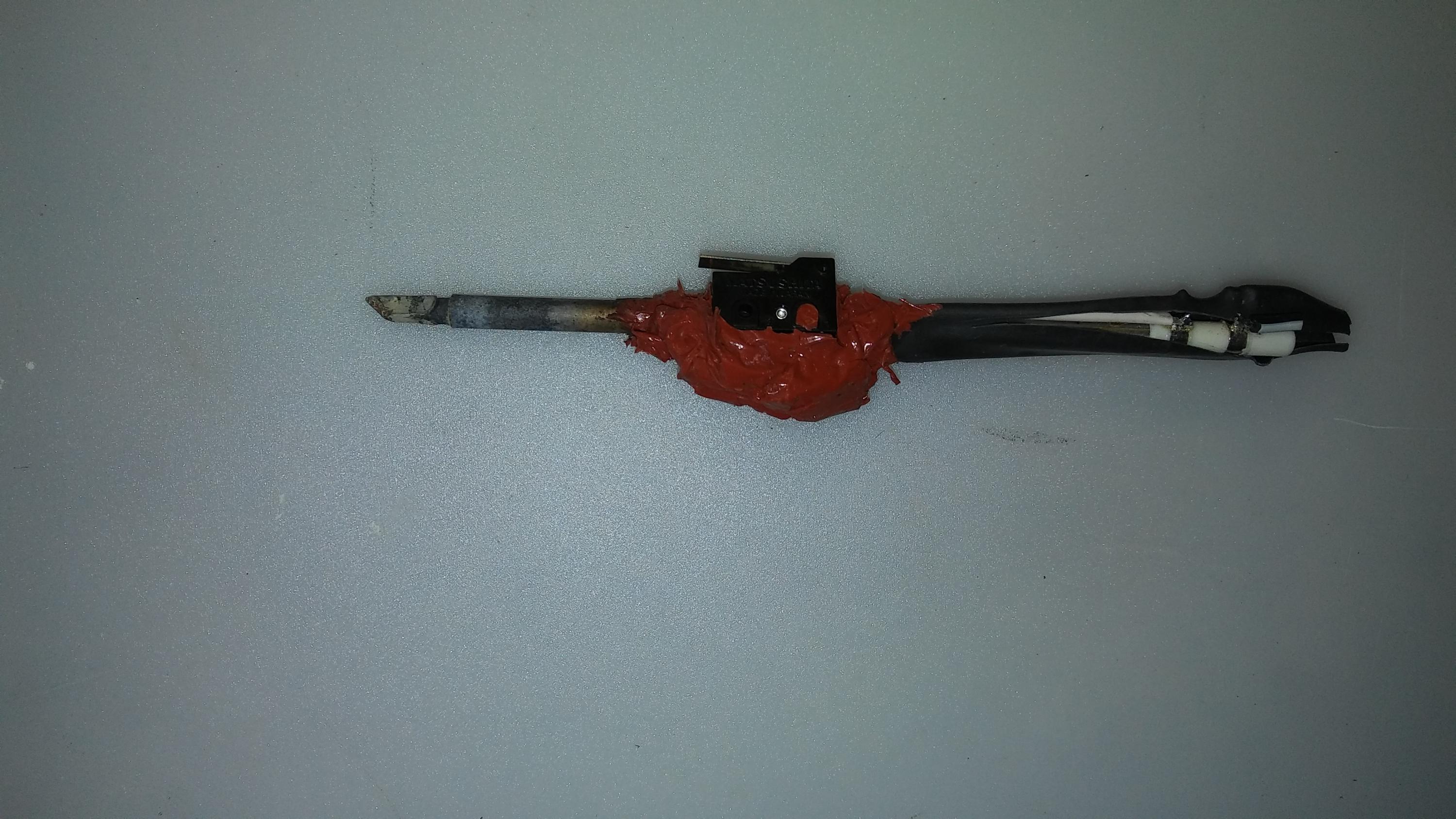

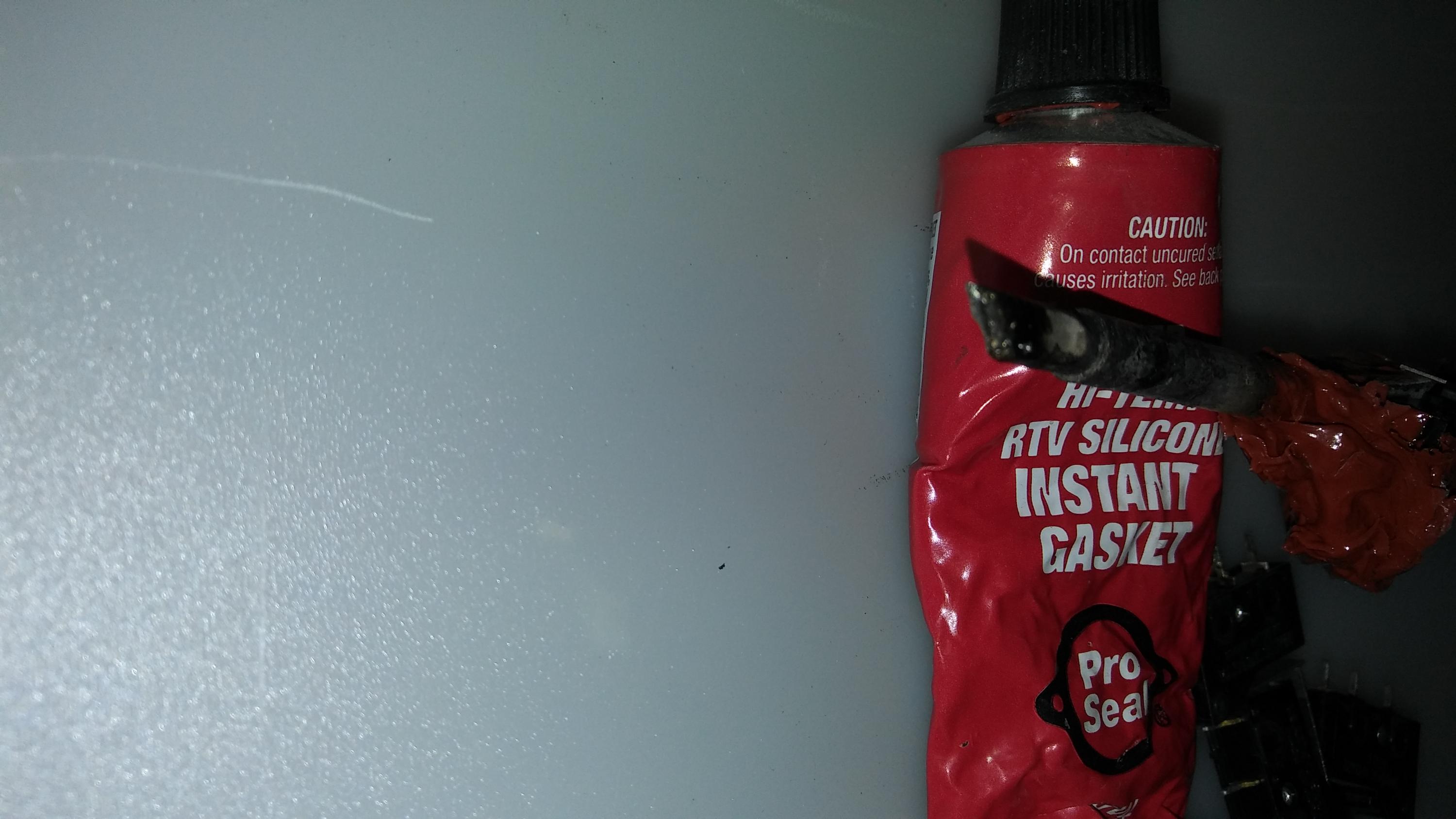

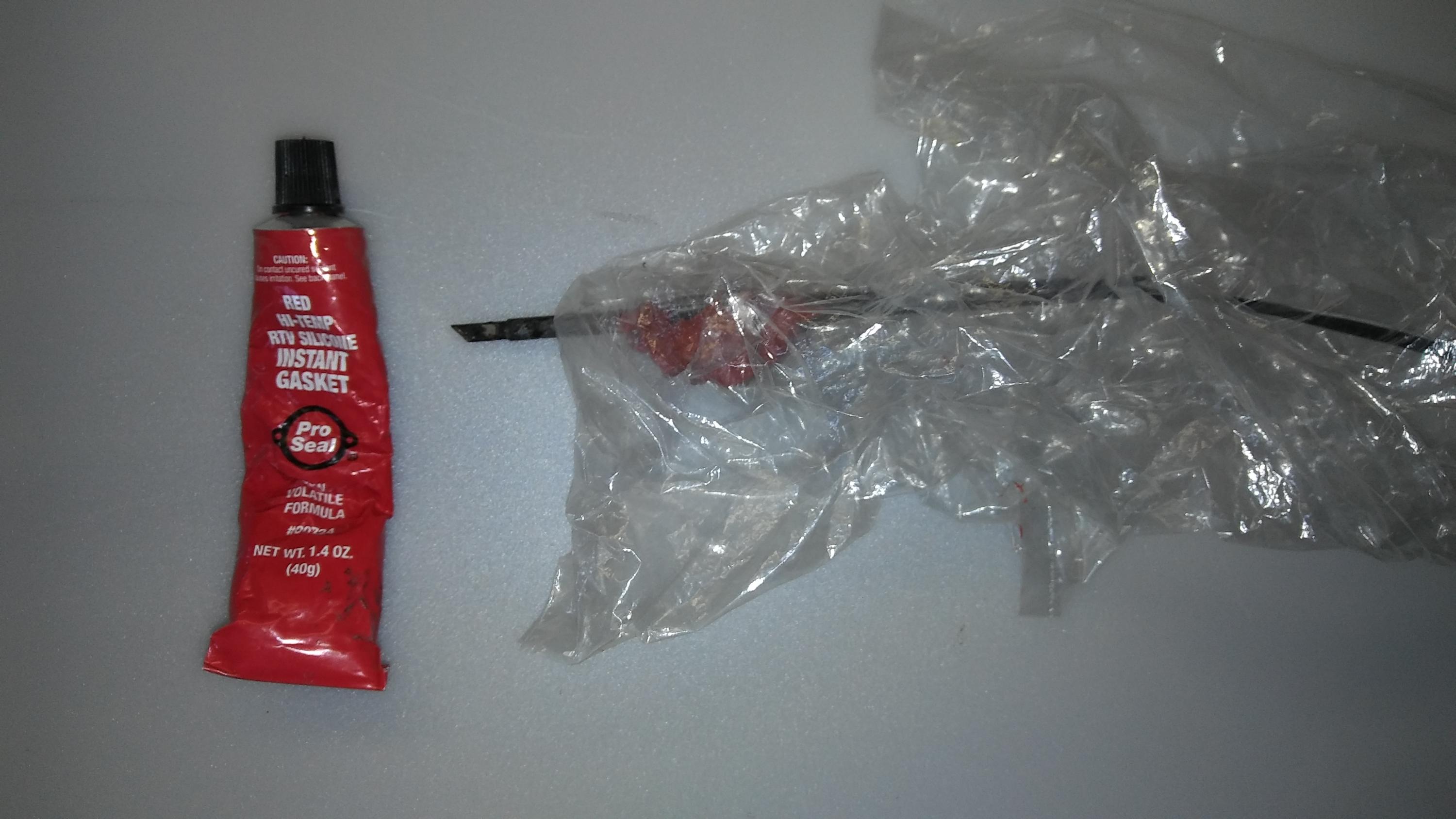

                        Re: Poorman's T12

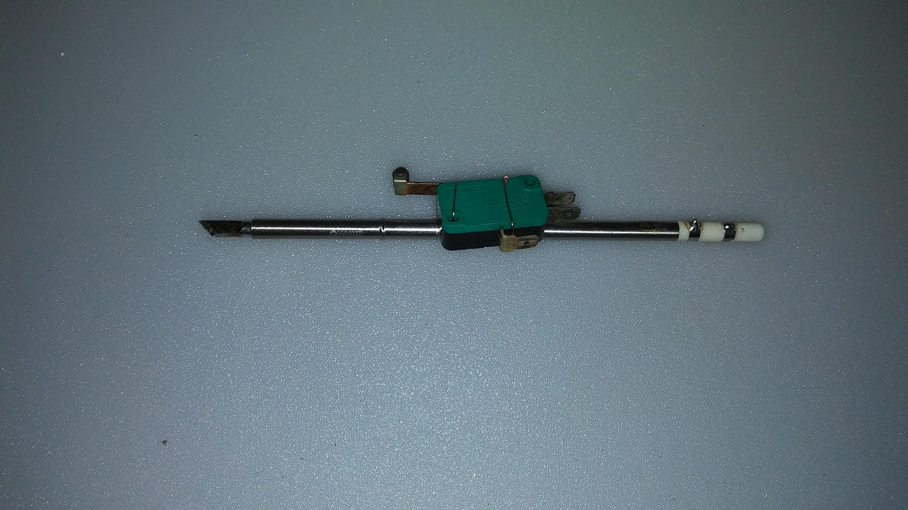

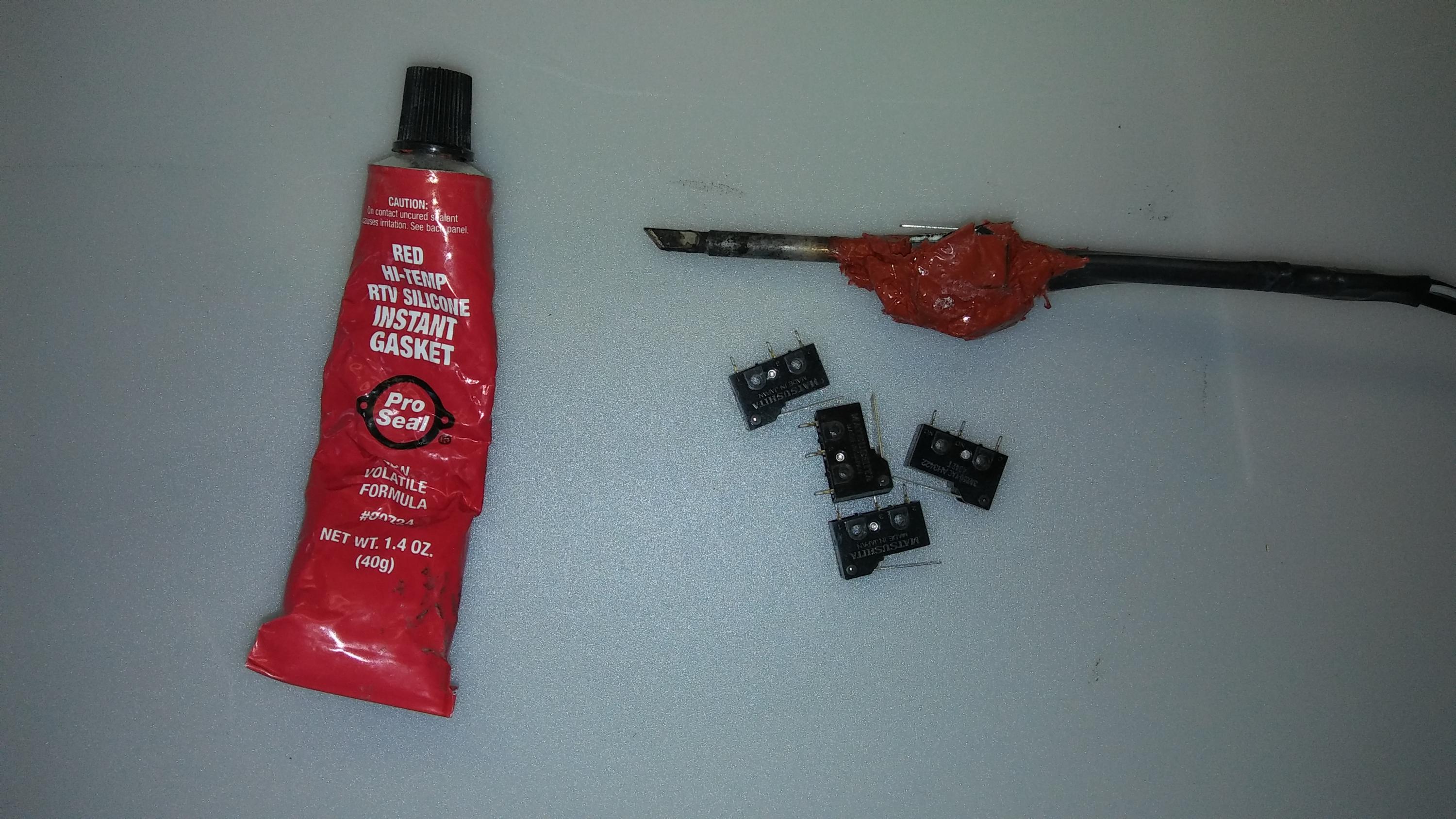

                        Update! I changed switch and redid the silicone handle, grab the iron with plastic bag fill with silicone. it is customer made right for your hand.
                        PS: After one month abuses the tips still shining...................

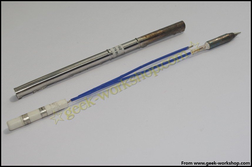

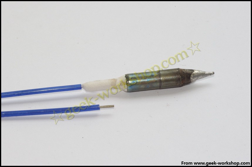

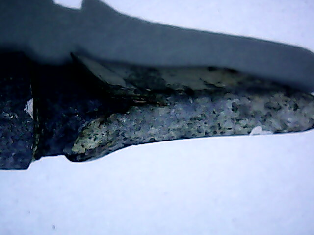

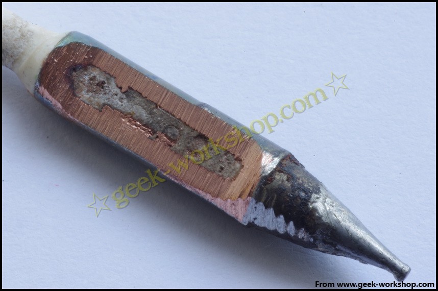

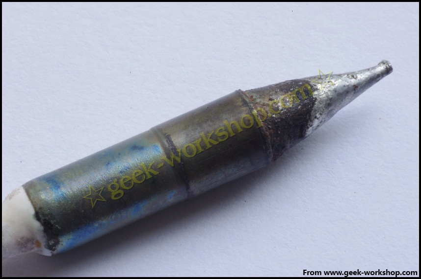

                          Re: Poorman's T12

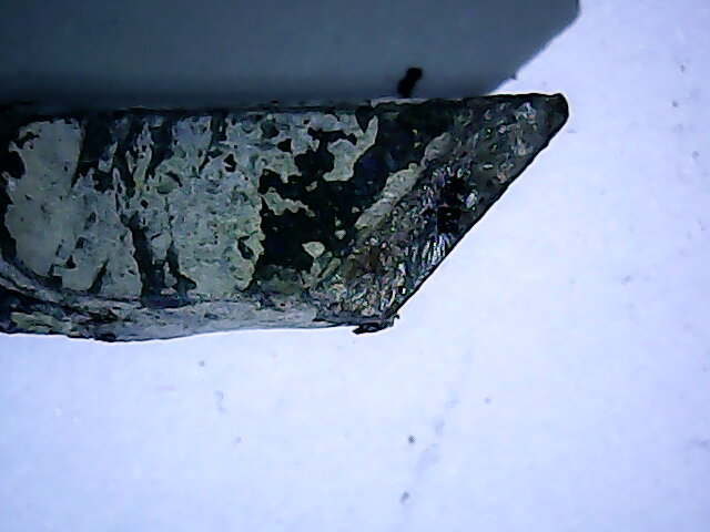

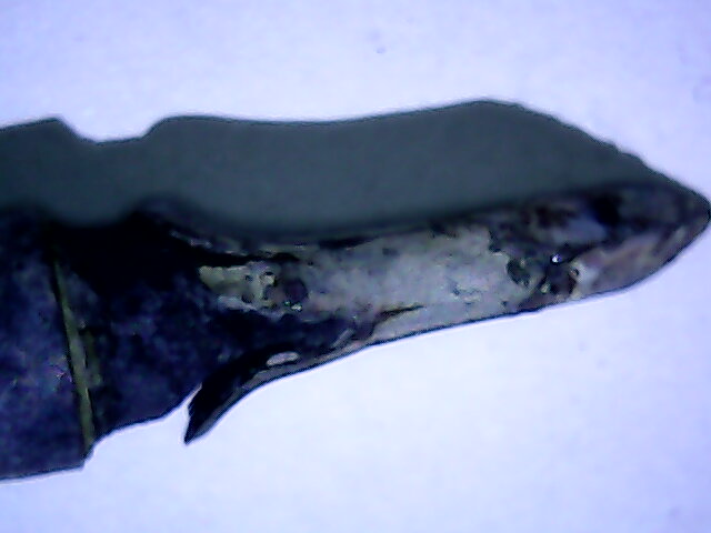

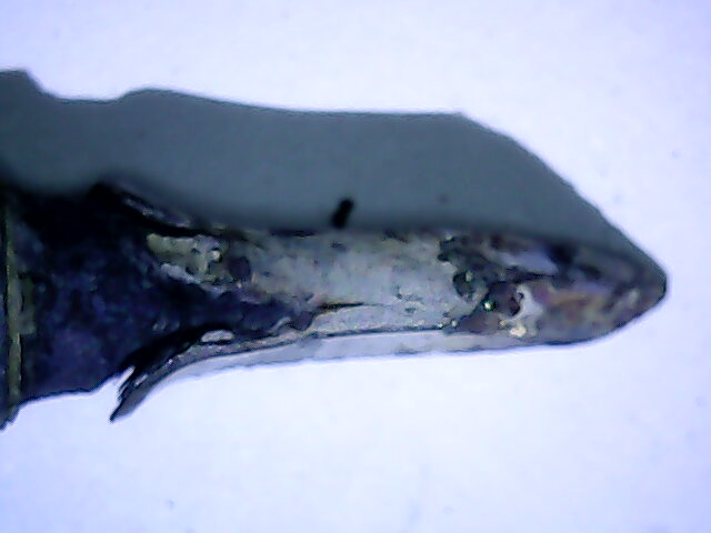

                          Finally T12 is no work, the iron tip heating element is open.
                          PS: The metal sheet was raised at base because I dipped it in the water occasionally.

                            Re: Poorman's T12
                            I can hear my t12 tips shaking with fear and crying as they look at those photos
