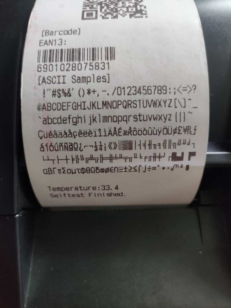

    a friend gave me this printer because it's no longer working.
    It powers on, but won't do a self-test print and when connected via USB to Windows, Device Manager says No Printer Attached under USB Hubs tree.
    The red light doesn't blink either with no paper inside.
    I think the firmware maybe corrupted. If someone has a similar printer and can provide a firmware dump, I really appreciate it.
    Printer model: Panda PRJ-58U

    Nevermind, turns out it's a faulty paper sensor. I covered it with a white paper tape, and it can now do a self-test print.
      • 31262
      thats a bit shit, it should still identify over usb.
      ideally and send a paper alarm!
        Hahaha. It works though and the print result is still great, it'll be very useful in printing receipts when doing business, and because I also got it for free, no complaint from me
