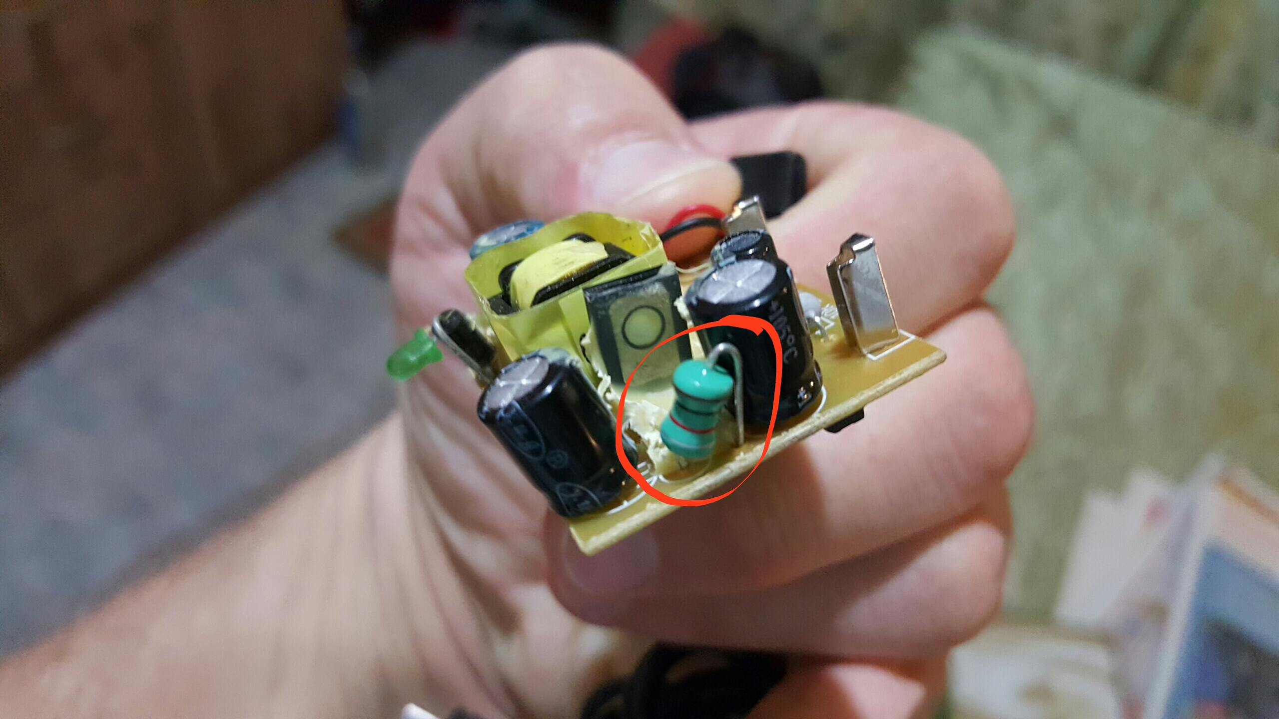

    What kind of resistor is that?
    In that picture there is some kind of component, it look like a resistor but it's a bit bigger and there is a coil inside.
    Who can tell me what that is exactly?
    Thanks in advance.
    Re: What kind of resistor is that?
    That is just a small axial lead inductor, looks to connected between two filter cap (+) legs to form Pi filter.
    Upload the pictures of the bottom side of the board to verify.

      Hmmm, the color bands suggest to me it could be a 1K resistor. An ohm meter should tell the difference - an inductor would probably be an ohm or two at most, while a 1K would be much higher (not necessarily 1K, since it's in-circuit).

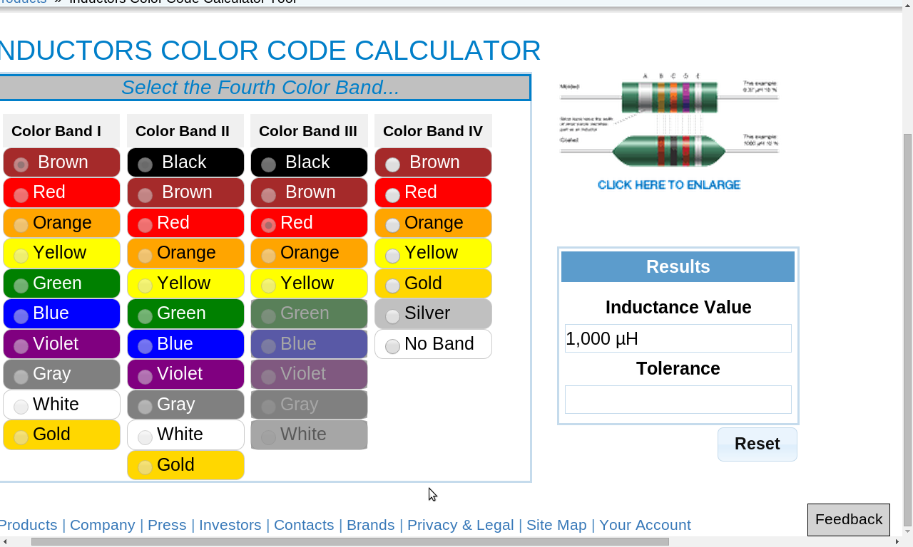

        I bet you,This is a 1uH 10% tolerance inductor . and circuit look like 9v battery step up power supply for high voltage usage. ex: for Lamp, electric fence.....
        http://www.vishay.com/inductors/color-code-calculator/

          I agree with budm, looks like an inductor. Maybe as the Pi filter.
          But the color code is odd brn/blk/red/silver gives 10mH +/10% when typically these parts are ~10uH. Putting an ohmmeter on it will sort it out.
          I usually find the power transistor/capacitors are shot in these small AC wall adapters.

            Could be either it would depend on how it is connected. Or you could measure it. It is either 1,000 ohms/1k ohms 10% tolerance or 1,000 uH/ 1mH 10% tolerance.

              This particular green-blue color is typically used for inductors.
              The color code could be either gray-red-black-brown (82 uH, 1%) or brown-black-red-silver (1 mH, 10%). I think it's the latter. Looks like it's used as a PI coil between the two caps.
              • capwizard
                • Jun 2016
                • 1991
                My BAD! my mistake ( , ) with ( . )!!!
                1.000uH=1uH 1,000uH = 1muH
                momaka you're right brown-black-red-silver (1 mH, 10%)
                  It's a wall cell phone charger. I took this resistor/inductor out of the board and measured for ohms, it indicates approximately 5-7 ohms.
                  How do I measure inductance?
                  What parameteres I need to know to buy one like this? I meen, what should I say in the store to the seller?

                    That means it is probably okay. Inductors typically show very low resistance when measured with a multimeter, especially ones that don't have many turns. For this small inductor to have 1 mH of inductance, it means the wire of the windings inside it must be very thin... hence the fairly high resistance you got.
                    Well, this might seem like a stupid answer, but... inductance meter!
                    Of course, those cheap eBay transistor testers will also work. The only problem they have is they they can't measure less than about 10-30 uH. So the inductors you see on motherboard and in power supply output stages will appear as a short-circuit and no inductance on those meters.
                    You need to know the inductance (1 mH... or 1000 uH if you prefer) and current rating. The current rating will depend on what your charger can output. If it's 500 mA, then you need to get an inductor capable of 500 mA or more. 2x the current rating output of the stated current on the charger is typically preferred. So for a 500 mA charger, use an inductor capable of handling 1 Amp.
