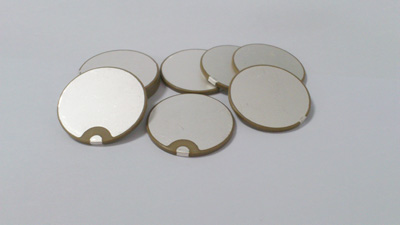

            Its a good idea to check the transducers, are those the piezo ceramic type? check them for cracks, if they are not cracked they should be ok, many times people drop parts into the tank and that can fracture the transducers.
