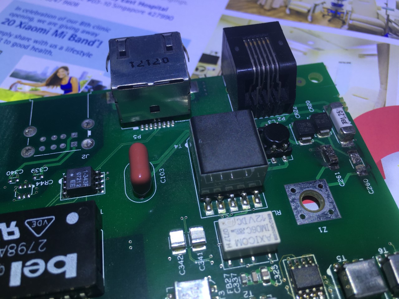

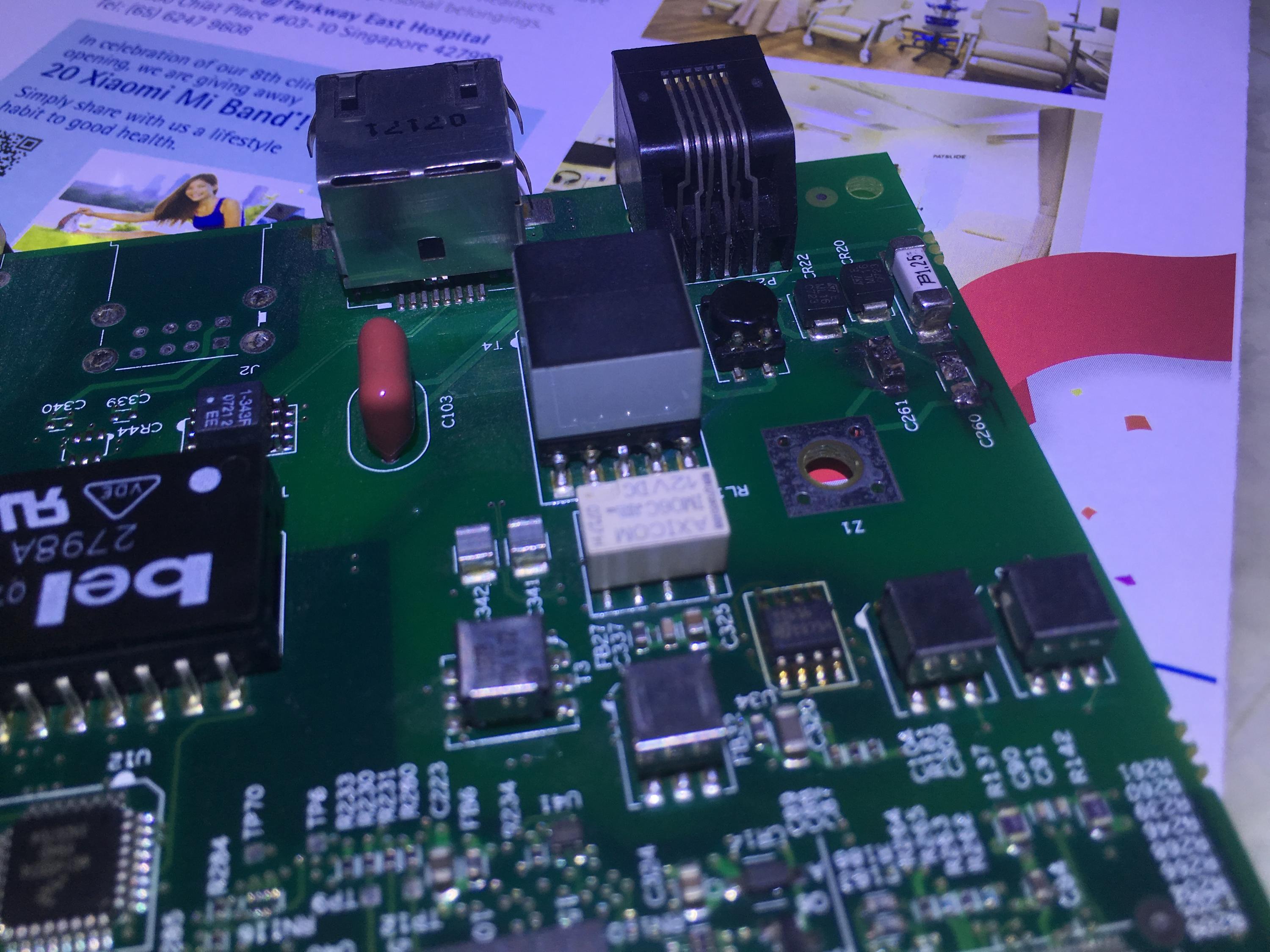

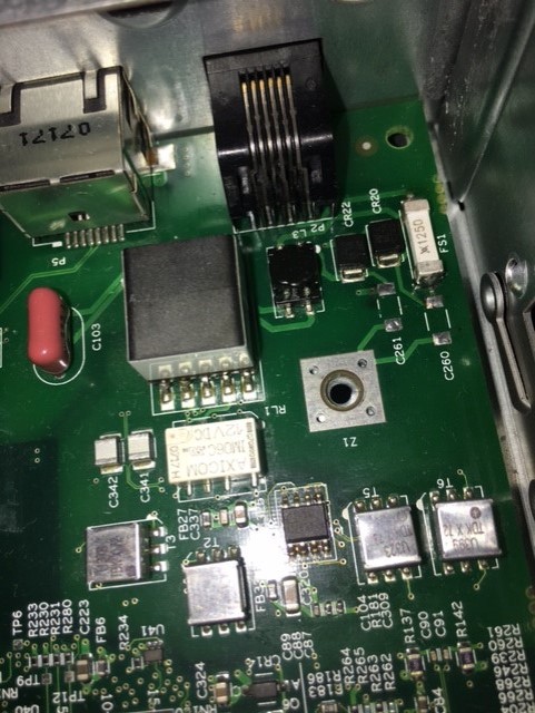

    Hi All
    I need some help.
    I had one unit of Cisco 1802 which was damaged by lightning.
    As attached you can see that the capacitor has been charred / burnt out.
    The Fuse has been tested with a DMM and it was found to be open.
    I know that getting cisco schematics are difficult.
    Looking for values for C260 and C261
    and curious on what is CR20 and CR22, which I believe is a protection diode.
    Just wanna check how it is tested, made by ST ML16 C723
    Thanks in advance.

    I noticed that cr usually do not refer to a diode . You can affirm that if there isn't an anode bar on it .. I think they are some capacitance resistance like their abbreviation say .
      • 30917
      Re: Cisco 1802 Router Damaged by Lightning
      cr look like some type of diode - maybe a zener surge protector.
      i would meter them, and the windings on that coil

        Somehow yes .. Looking at older routers reveal that this piece is a surge protector , but it's not a diode , or at least in testing purposes .
          • 30917
          no, but it shouldnt look shorted
            • 30917
            found it.
            smp100mc-160 Trisil
                update....
                the bad smd had been removed...
                does anyone has a clue on those two values?
                many thanks
                  • 30917
                  connected to ground from a data line - very low - probably in the pF's but high voltage to survive spikes.
                  you find stuff like that in modems and old set-top boxes with a fone connection.
