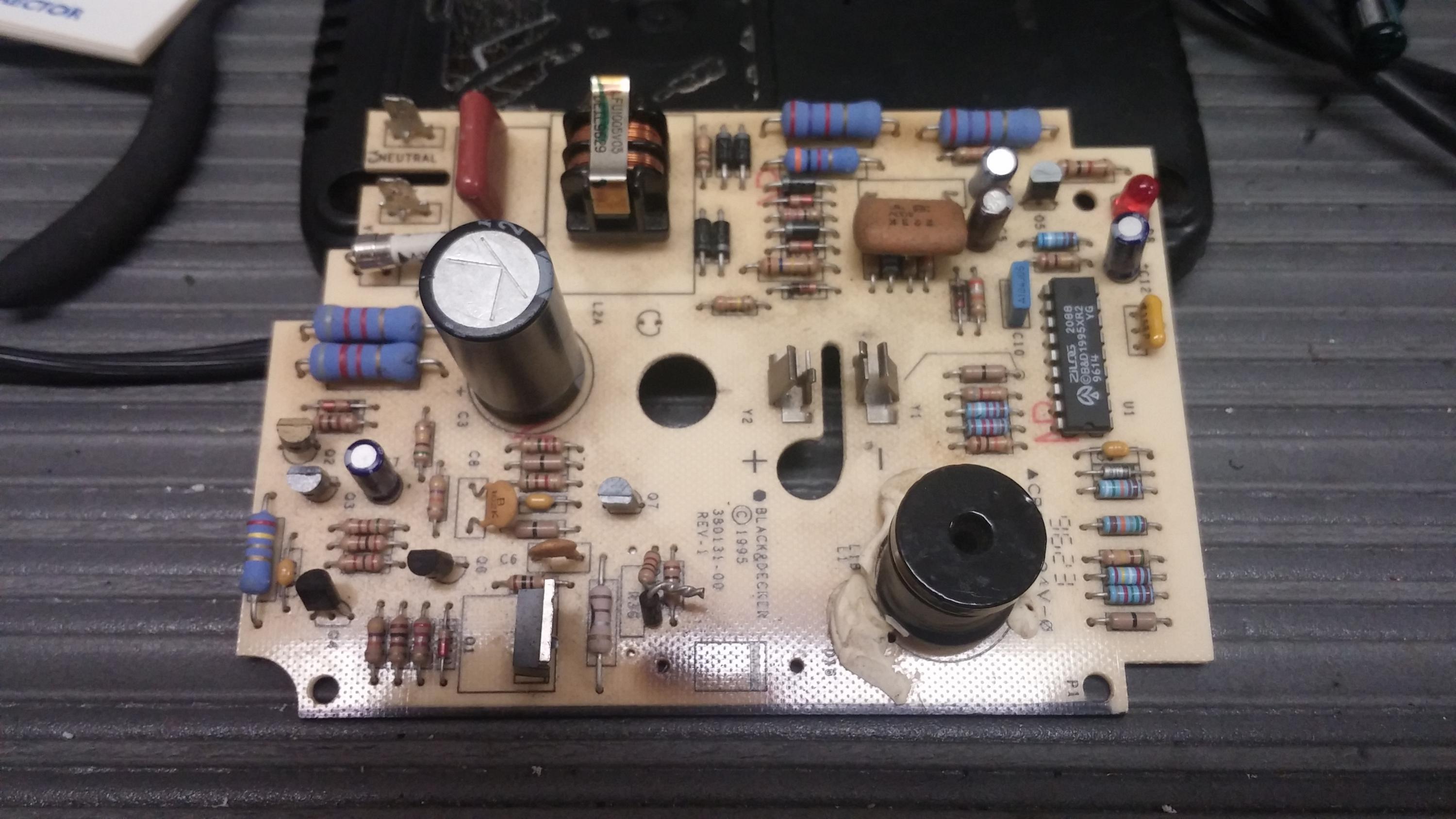

            Pics of Charger Board. You can see the burnt area of the board where the diode was located. The large black component with the hole in the top only had one leg soldered to the board. I replaced the fuse which was shorted, it is just visable behind the large cap.

              • 31250
              Re: NiCad Battery Charger
              fuses are supposed to be shorted!
              check if Q1 is shorted.
                How about a good clear pictures of the bottom side of the board?
                That black component with a hole in the middle is an inductor or transformer.
                BTW, your picture is mirrored that makes it hard to read the designators.

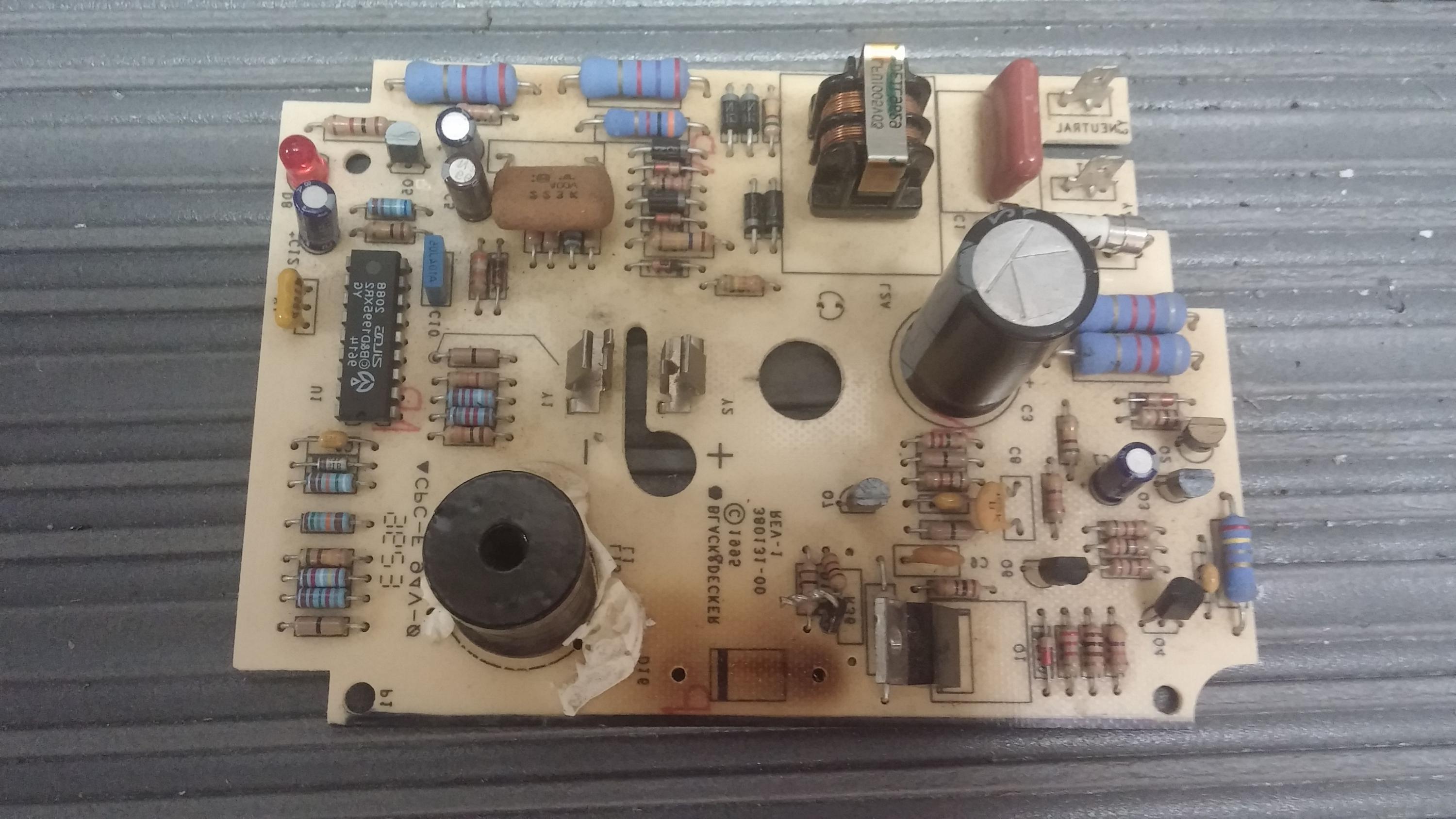

                    Also please up load the picture of the top side that is not mirrored.

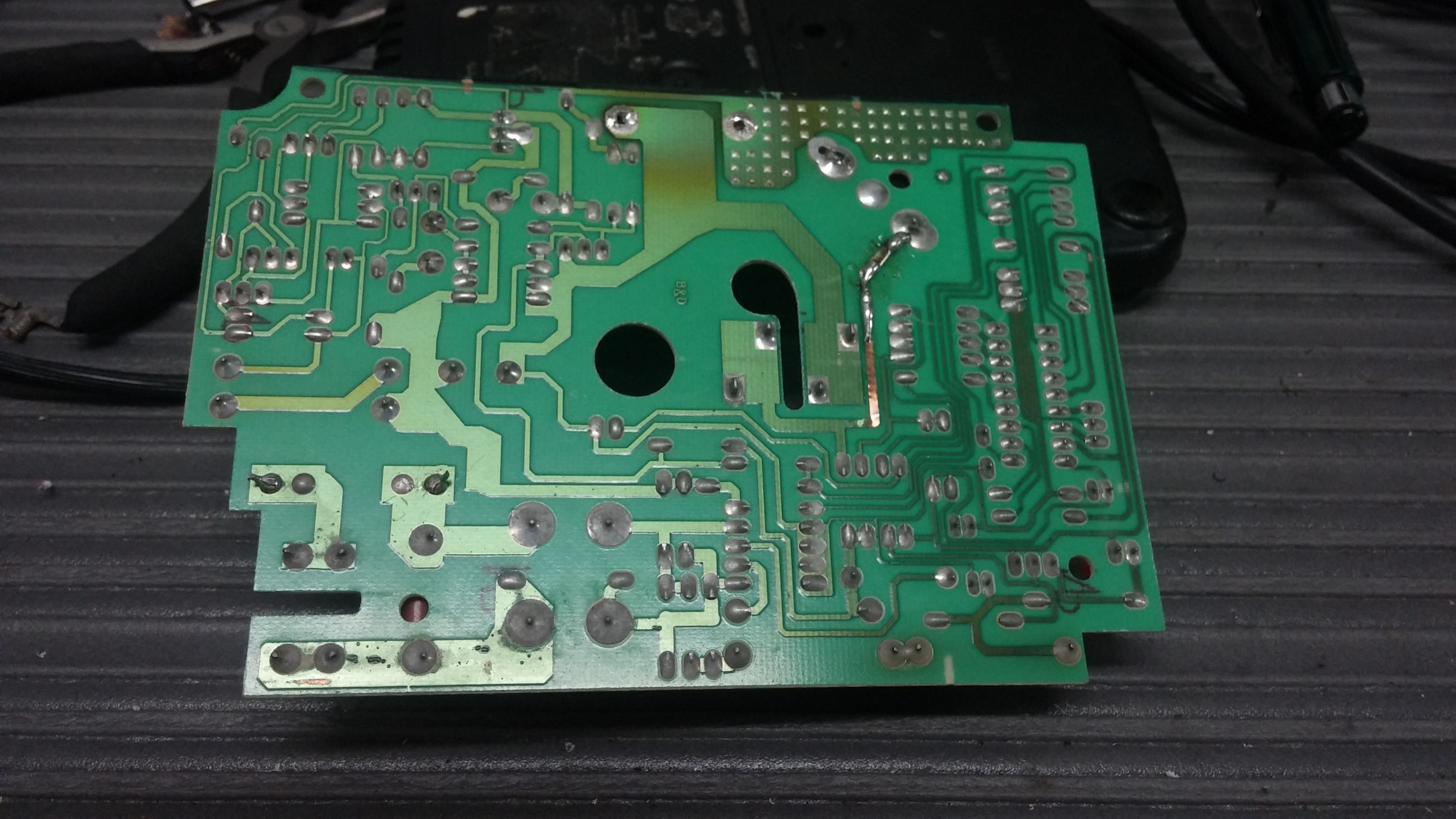

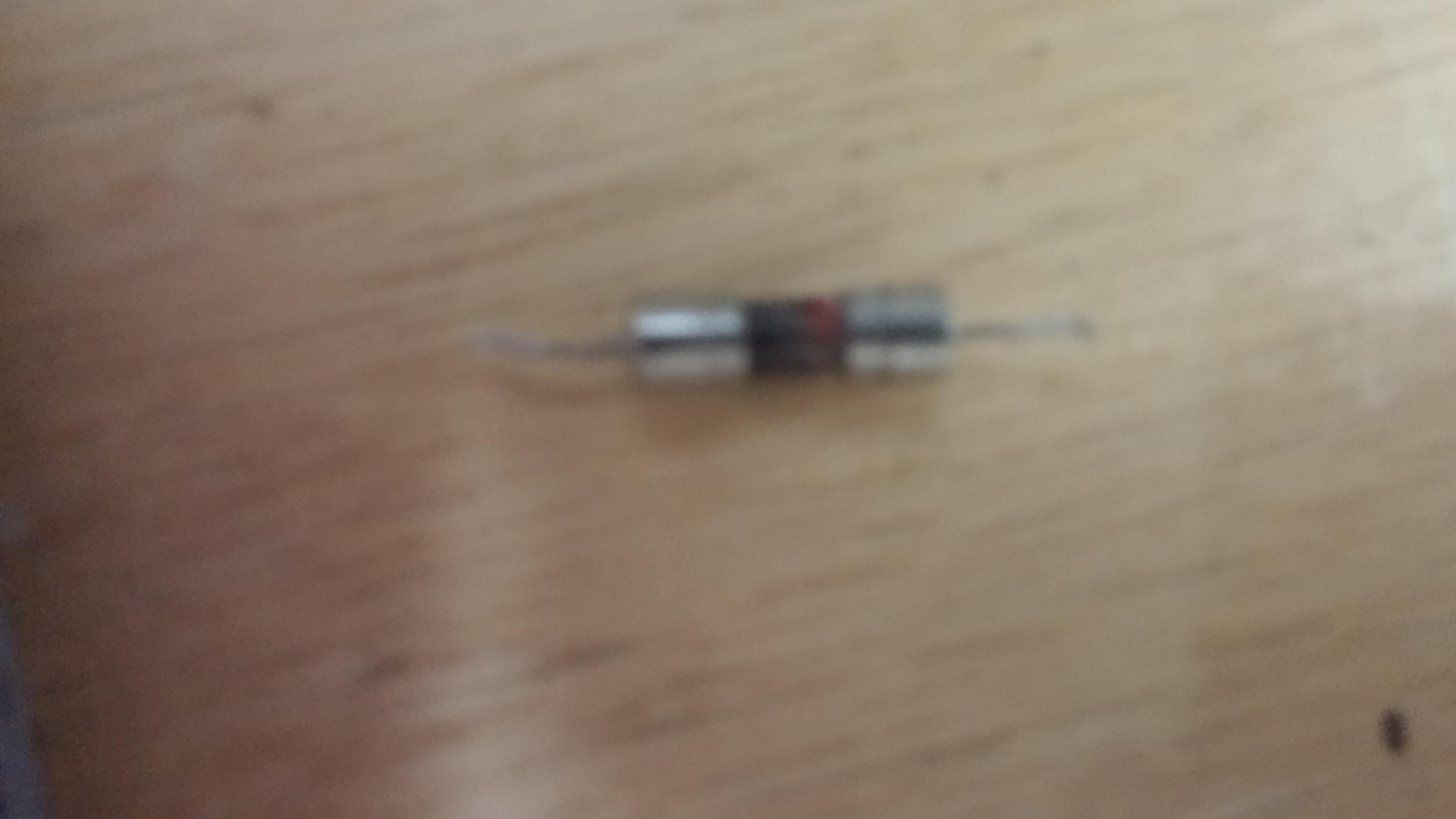

                      I retook the front picture and included the back of the board and the original fuse.
                        OK, you use ceramic body fuse instead of the glass body fuse that is why I could not figure out why you said it burnt to crisp. For the fuse to be blackened like that you have very bad shorts circuit on the board.
                        You already verify that the rectifier diodes on the board are all good? Q1 is good?
                        BTW, the trace that goes to the battery terminal got hot and cooked away the green solder mask, seems to me that the battery is shorted and the power supply is try to force the current to the battery.
                        Also that big resistor (low value) next to Q1 looks burnt.
                        Do you also get the continuity between the two legs of that black round inductor? It should show low Ohms.
                            The two legs of the inductor should be there and should show continuity, that trace got hot. The inductor may have gone bad because it is part of the pulse charging circuit.

                                    the mosfet is bad too.
                                    along with your batteries.all the cells short.
                                      You may have an open resistor there also adjacent to R36.. It looks burnt on one side?
                                        I reckon so too.. and it's in series with the diode which also blew so that makes sense... and which powers the MOSFET.
                                        It could well be that's what shorted to begin with, blowing the resistor, diode and fuse.
