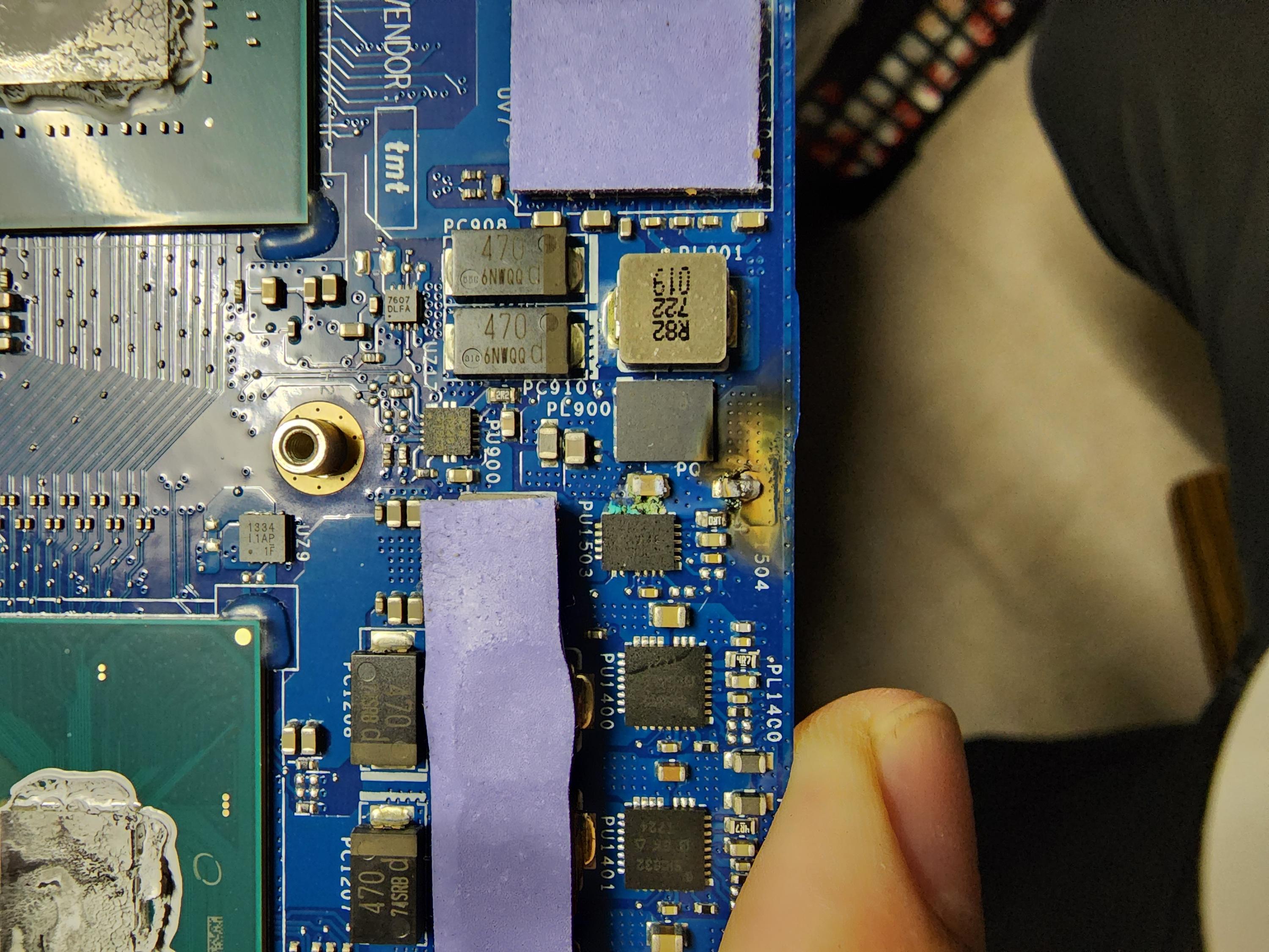

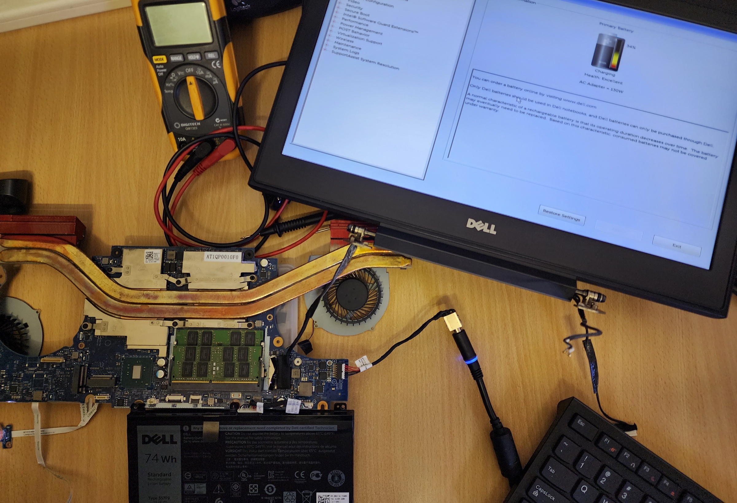

    Hi, I have a Dell Inspiron 7567 LA-D993P that I've just got running.
    There was corrosion around PU1503 which shorted PC1518 & blew PL1504. (Reference pictures attached)
    I've replaced PC1518 & PL1504 & the laptop is now running however I now have another issue.
    Here are the tested scenarios:
    1. With the laptop running on battery, I plug in the 150W charger & the charger shuts off (no LED, protection mode) but the laptop remains running on battery.
    2. With the laptop off, plug in charger (LED says on) & the front charging LED says it's charging. Turn laptop on & open bios battery settings, charger is detected & says charging (but it's not charging).
    Unplug charger, switches to battery, plug charger in, charger LED goes out (protection mode).
    3. Same test but with a 240W charger, laptop turned on, plug in 240W charger, laptop says charging but percentage does not move over time, the 240W does not trip out.
    4. Any charger can run the laptop without the battery connected.
    It seems as though the charging circuit has a partial short drawing too much Amps or something & tripping the lower wattage chargers?
    Any ideas what could be happening?

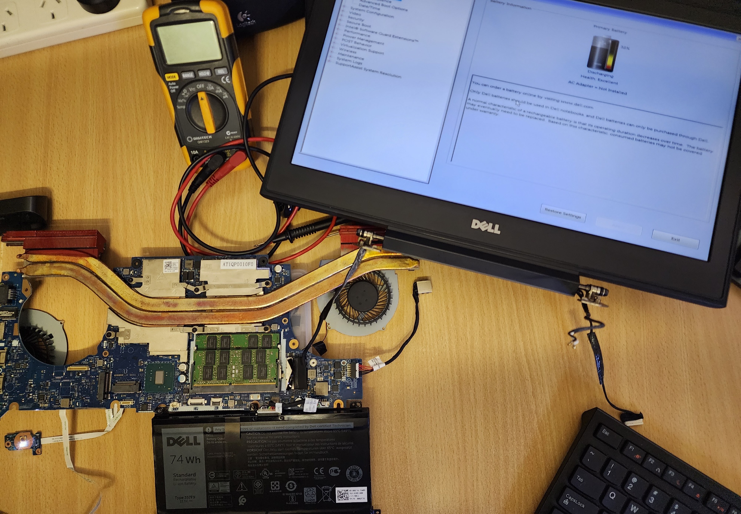

                                  Thanks, PQ301 is replaced with the donor & PQ306 re-installed. All mosfet mesurements are in the Mega ohms. Good to test? :-)
                                  • mon2
                                    • Dec 2019
                                    • 14713
                                    Re: Dell Inspiron 7567 LA-D993P odd charger issue
                                    Confirm the clr resistance to ground is not super low. This is the main power rail that powers the logic board.
                                    After this test, yes, power up to test again.
                                    • Johndill
                                      • Aug 2015
                                      • 314
                                      PR302 is around 15M ohms. :-)

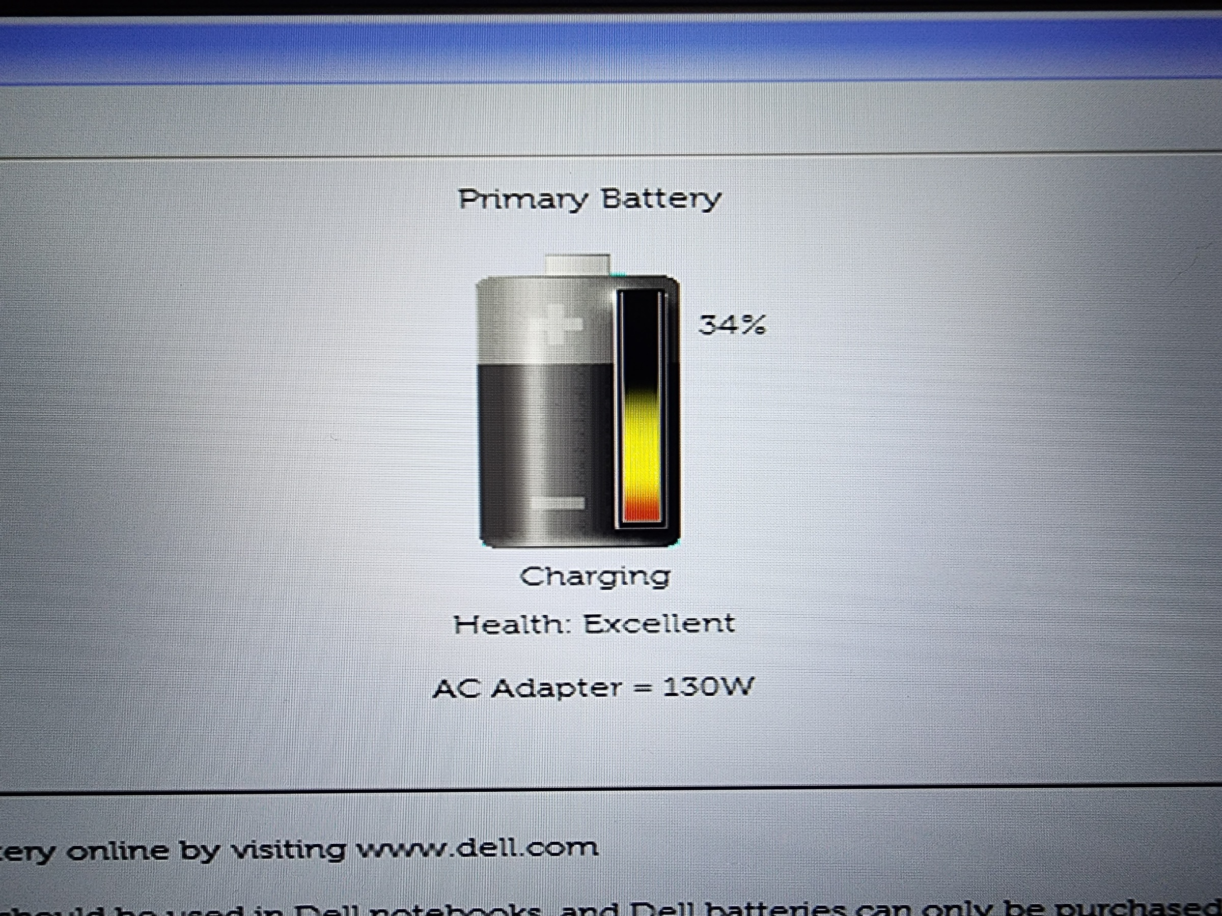

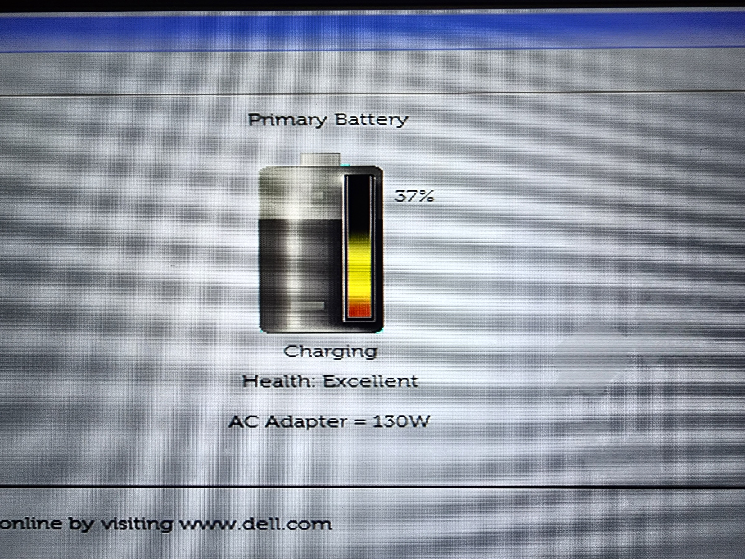

                                      • Johndill
                                        • Aug 2015
                                        • 314
                                        Yes! It is charging & the percentage is going up! :-D
                                        We did it! Thank you so much for your assistance. Another laptop saved. :-D
                                        It currently at 42% now.
