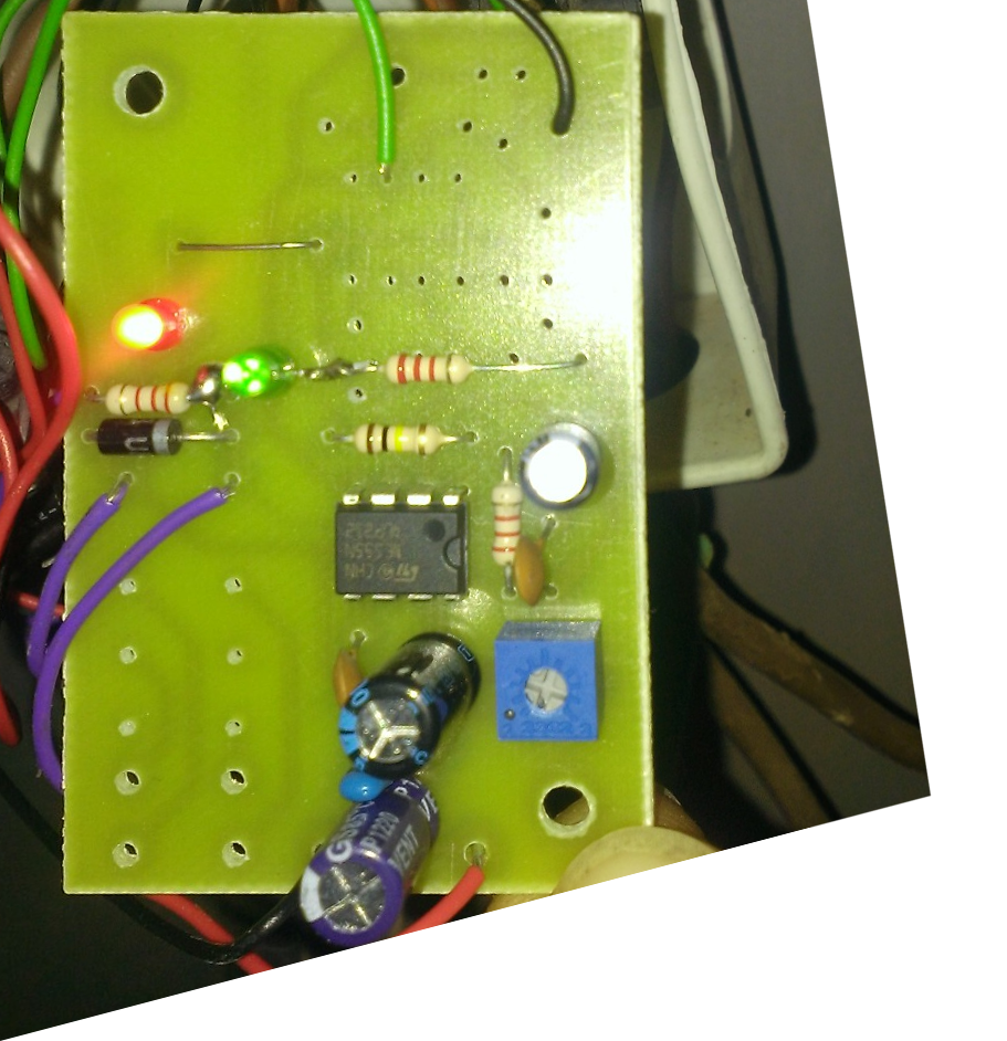

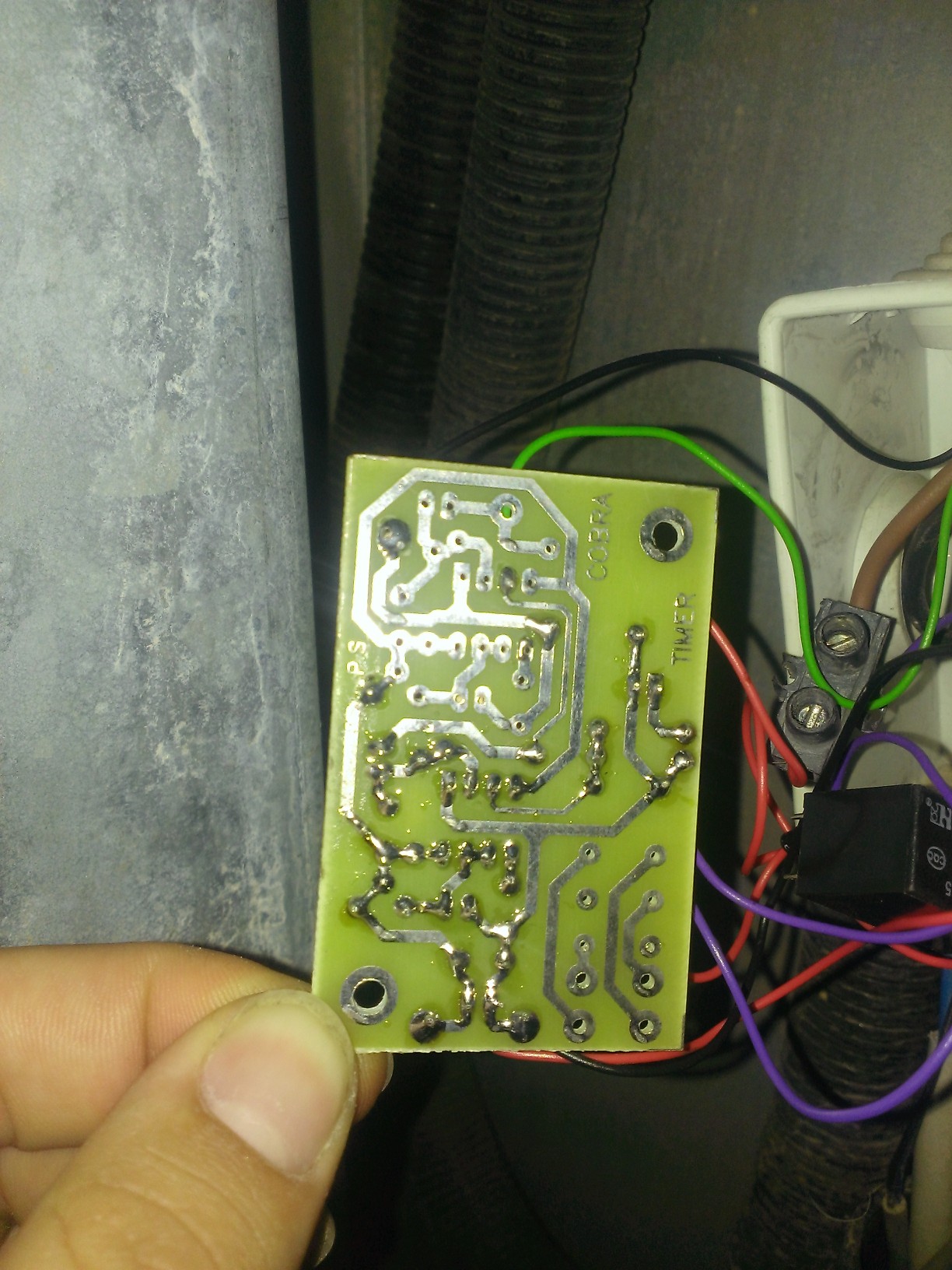

    Hi all.
    I need your help from all the experts around here, i have a that i need to copy and i need some help please to make Schema of it, so if u can help i will be extremely happy.
    The electrolytic capacitor are:
    C1+C2- 100uF 35V
    C3-2.2uF 63V
    there is there like tiny blue thing that i didnt really know i think its 0.1uF 100nF 50V 104 (104 what printed on it) Multilayer Monolithic Ceramic Capacitor and there is round thing that i think its Ceramic Disc Capacitor 50V 103 0.01uF (103 what printed on it).
    there is a blue Square thing that i dont know how its called.

    the chip is 555

      I want copying it on a DIY Prototype PCB

          Re: help copying a Circuit
          You must be patient. People will help if they can, just got to give them time. What is the purpose of the circuit?
          The blue object is a trimmer pot. Can't tell what value. The circuit appears to be a 555 timer circuit. The trimmer adjusts the timing.
            Its for big billboard on the roads. and its controls the timing of the board that have 3 Advertising's.
            like the one on the pics.
            and on the trim pot i think printed 2046B cuz the "4" looks like U

              Like Steve said if you tell us what the purpose of the circuit is we can help you better.
              Look here for basic 555 configs: http://en.wikipedia.org/wiki/555_timer_IC
              If you take two pictures exactly from the top and bottom (not taking the photo at an angle like you did) one can easily overlay the two pictures and draw the schematic.
              The circuit is very simple...
                So what do you expect from us?

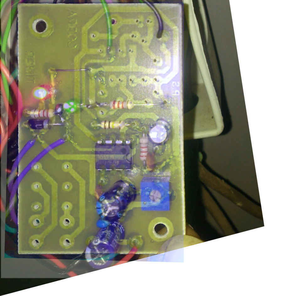

                Use a flashlight or some bright light, put the pcb over the light and you should see the traces through the board.
                Take a sheet of paper and draw the traces.
                The 555 chip is ancient and very well documented and easy to understand, if you'd bother to open the datasheet for it and read it, and if you'd search for tutorials/lesson about it , just type 555 in Google.
                Even the datasheets have example circuits which may even be similar to the one you have.
                Basically, the chip outputs a series of ON and OFF signals, some voltage and no voltage, the blue thing (a potentiometer) simply adjusts how much time the output stays on and how little it stays off.

                  Originally posted by predator0357
                  Help some1 pls
                  I listed the top of the board schematic the best I could. Coloring on resistor was hard to tell. Best to take picture of boards with no flash and in natural light. If you had a way of printing this picture on some transparent paper then print out the bottom of the board on solid paper one could trace out the rest of the circuit. Anyway it is best I could do with the paint program.

                    i expect from someone to help me copying that, cuz i am a beginner with building Schema from a circuit.
                    and the circuit isn't near me so i cant just put some light under it, i wish i had one that why i am asking from any one here that can help me and experience .
                    And by the way about the tiny capacitors am i right?
                    and again thanks for the help and understanding.

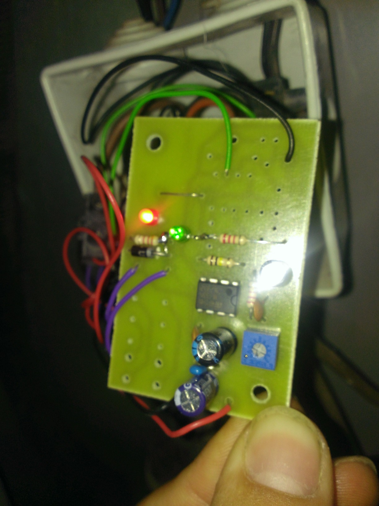

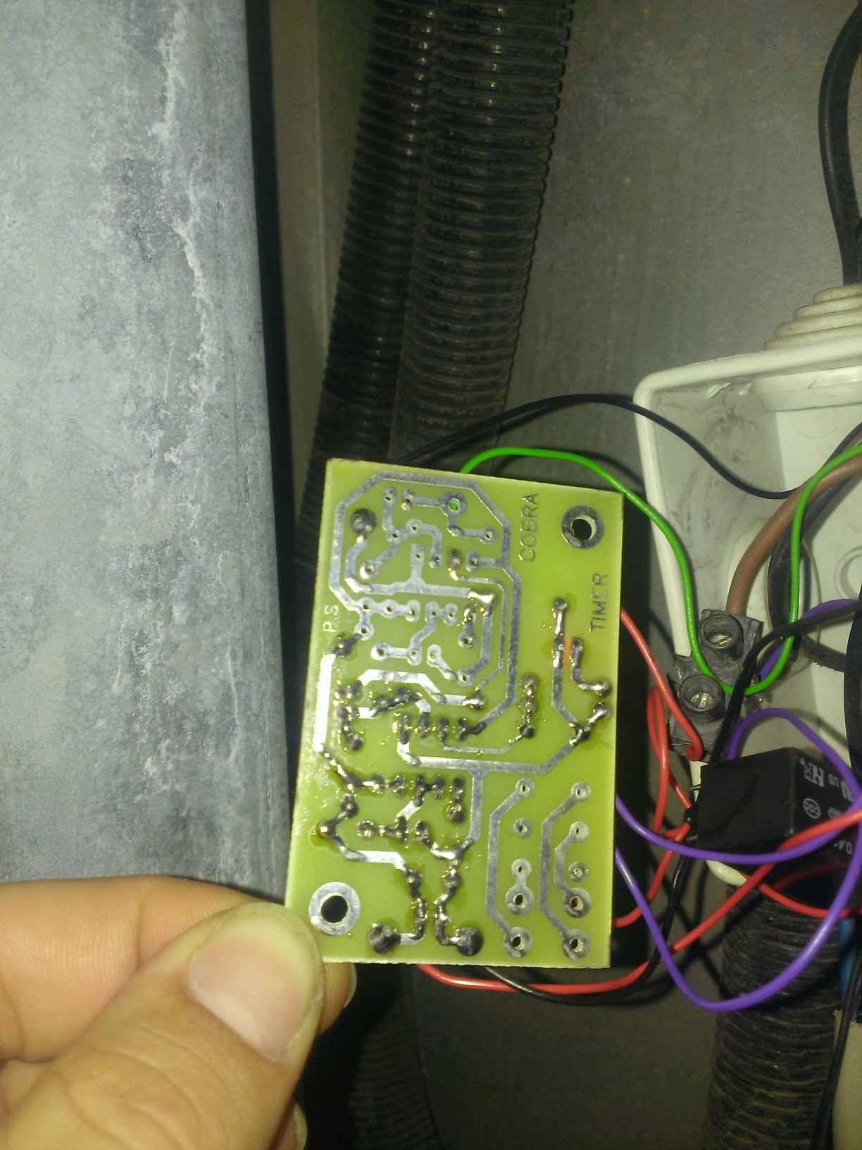

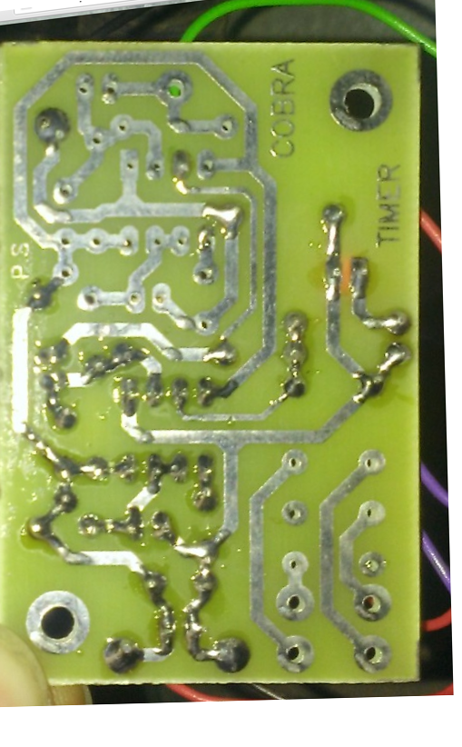

                        I need STRAIGHT SHOT pictures of the board, top and side and bottom side so I can make virtual PCB to trace out the circuit.
                        Isn't this the same circuit you were asking for help but did not follow through and abandon the thread?

                            Well, then give me the good clear straight shot pictures as I requested then.

                              I don't know if they'll do it, there is too much glare on them... better he takes other pics maybe...

                                Last one is a transparency it is just a matter of following the lines and putting in the symbols.

                                  predatoro357 I think if you focus straight down on the electrolytic caps making sure they are perpendicular to the board and turn camera so it goes in landscape direction instead of portrait. Try an do it with flash off without power on board so that LEDs are off. If using a flash make sure bright spot is in area where circuits are not.
                                    BTW, what is the board dimension?

                                      6.4cm x 4.2cm
