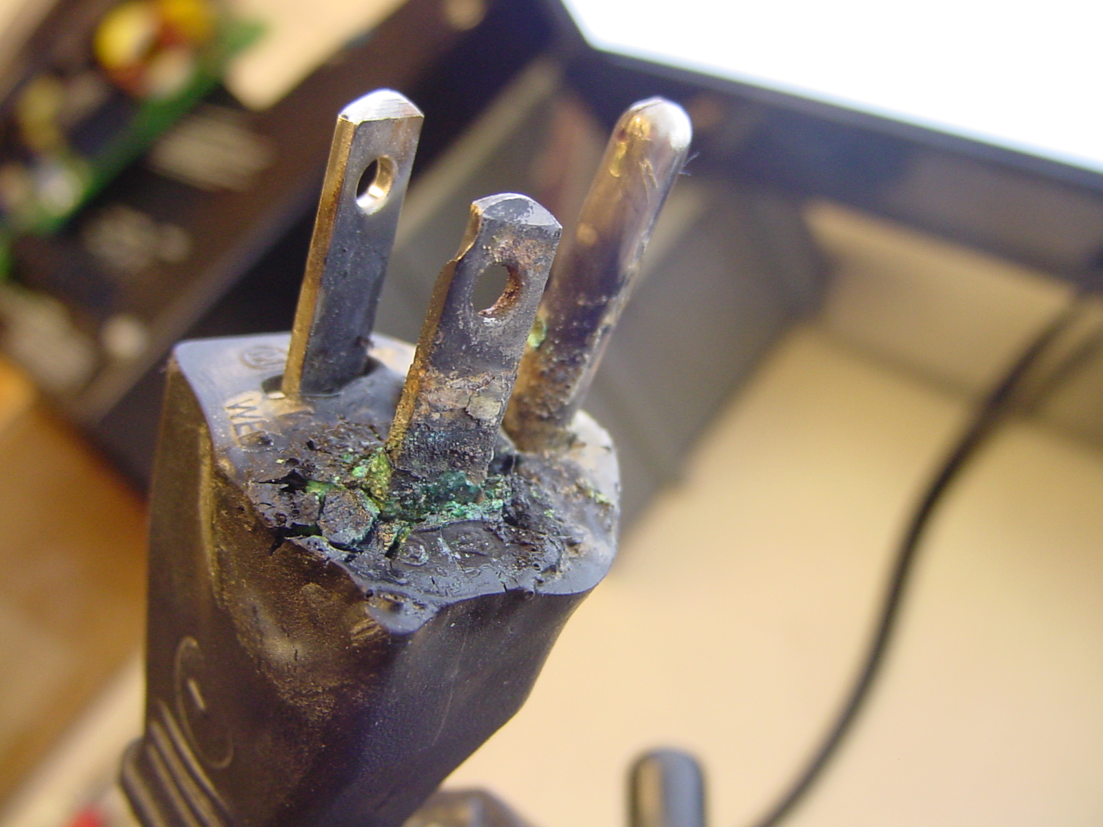

          It would be contacts resistance, I see it happens to both Line and Neutral, the connection will heat up when you have high contact resistance. See attached picture.
          You can check the voltage drops on the connection, just measure it, when you have the Voltage and known current then you can find out how much power will be dissipating on that bad connection.
          If it is arcing you can use AM transistor radio to hear the static on the blank band on the radio.

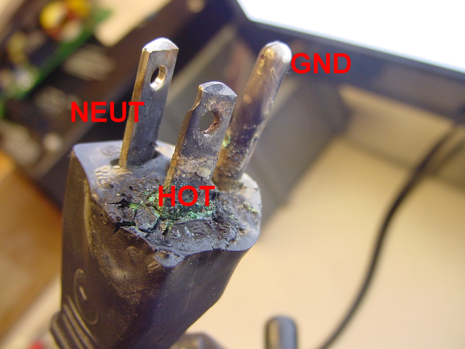

            Budm - if you look at the 2 blades on that plug, the neutral side has the most damage. 95% of bad outlets (and splices) I have seen over the past 10 years have had a neutral-side failure.
            I don't have a good explanation as to why neutral connections fail more than the live side, maybe harmonics.

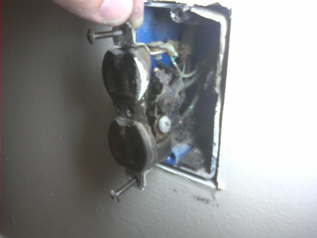

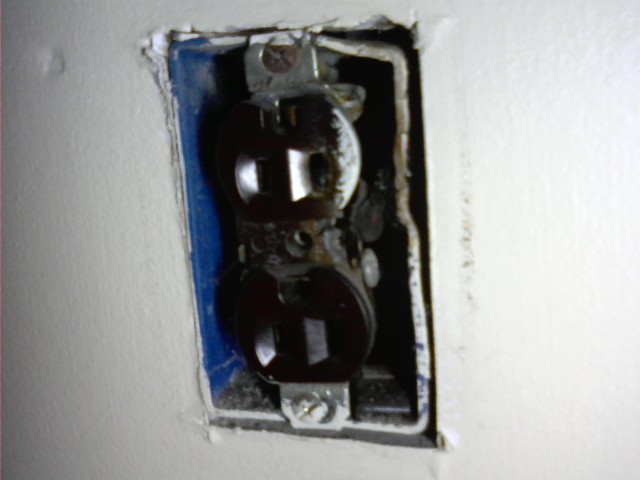

            The 2 pics I am posting were taken in a rental house I moved into in July '09. Neutral side failure, screw terminals used, burned all the neutrals to the back of the outlet box. Called landlord, told her she almost lost this house from the previous tenants. Cause: 1500 watt space heater with matching burned plug I found in a closet. I fixed the mess for $$$ off the rent
            To the OP - we usually don't see terminal or outlet damage on water heaters in the US. They're usually hard-wired with 240 volts. Our 'normal' outlet circuits are only 120 volts.

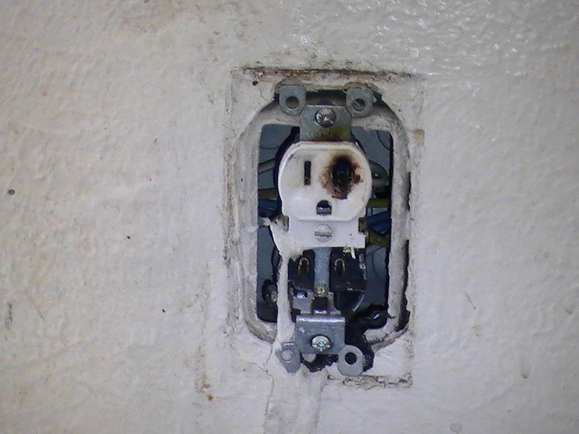

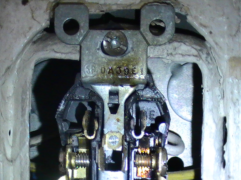

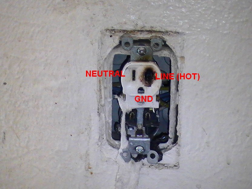

              OP, showers? here we take it outta the water heater. found some pics from my old apartment (now a hole in the ground) this was my fault.
              Follow the white rabbit.

                  "Budm - if you look at the 2 blades on that plug, the neutral side has the most damage." The blade on the right is the Line (Hot) which is badly damage.
                  Here is the pin out of NEMA5-15P: http://www.leadsdirect.co.uk/technic...american-plug/
                  goontron's pictures on post 7 also show LINE side socket is burnt.
                  @ST, please read this: as you can see how the current in the neutral wire flows int he branch circuit 1 and circuit 2, the unbalance of the loads on #1 and #2 will not have any affect in the neutral branch circuit.

                      The hot side of that plug carried the largest load. Could also be that someone wired the outlet reversed, hot wire to nuetral spade and nuetral wire to hot spade.

                        no. my socket was wired proper. my hunch was wear. top sockets where all worn more than the bottom ones, and with the bottom missing the cover material i wasn't going to try and plug anything into it. a line to earth short is not fun. especially when you have a zinsco panel...

                          I am talking about Budm photo not yours. Outlets in US should be wired so that the wide slot is connected to Neutral and the narrow slot is connected to Hot. The round hole should be Ground.
                            you see the chunk missing out of the top of the line pin? that says arcage. whether that was caused by the heating, or caused the heating is another story.

                              Re: Neutral terminals cooking up
                              "The hot side of that plug carried the largest load. Could also be that someone wired the outlet reversed, hot wire to nuetral spade and nuetral wire to hot spade." The current flows from the power source to the outlet into the load in one of the terminal and the same amount of current will flow back through another terminal, the current flow reverse direction at 60 time per seconds, so how can you have more current one one terminal. If the load draw 10A of current, the 10A will flow back to source. Just put the clamp on amp meter on the hot wire and then on the neutral wire then you will see.
                              The plug is properly wired, the real cause of that burn plug was due to poorly crimping of the wire to the HOT blade inside the plug, we no longer use that supplier for our products. I design and build products from 10A up to 120A.
                              BTW, you can easily check the voltage drops on the connection, I also have to check the temperature of the blades for the UL compliance testing.

                                Look, all i am saying is that the Spade on the plug that you show in the photo that is the most burnt would normally be the end that is connected to the HOT SIDE of the outlet not the NEUTRAL SIDE.
                                  Well, it is connected to the hot side and plugged into properly wire outlets, I also investigate why it burnt up. Should see what it looks like inside once we removed the molding.
                                  The bottom line is that you can have cooked hot or neutral line on your outlets or at the plug,, The same amount of current will flow in and out of the outlets Hot and Neutral.
