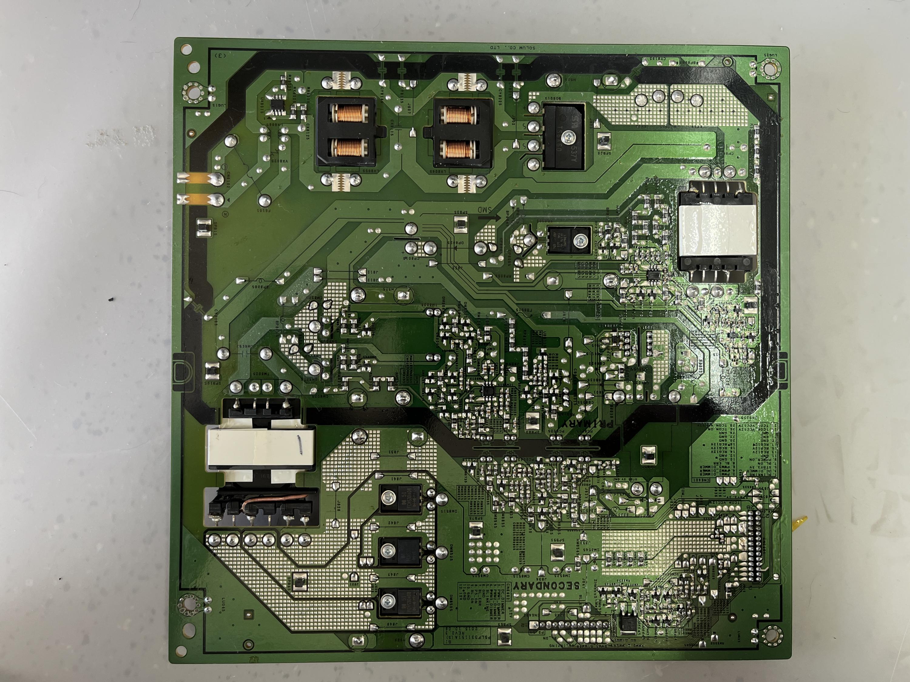

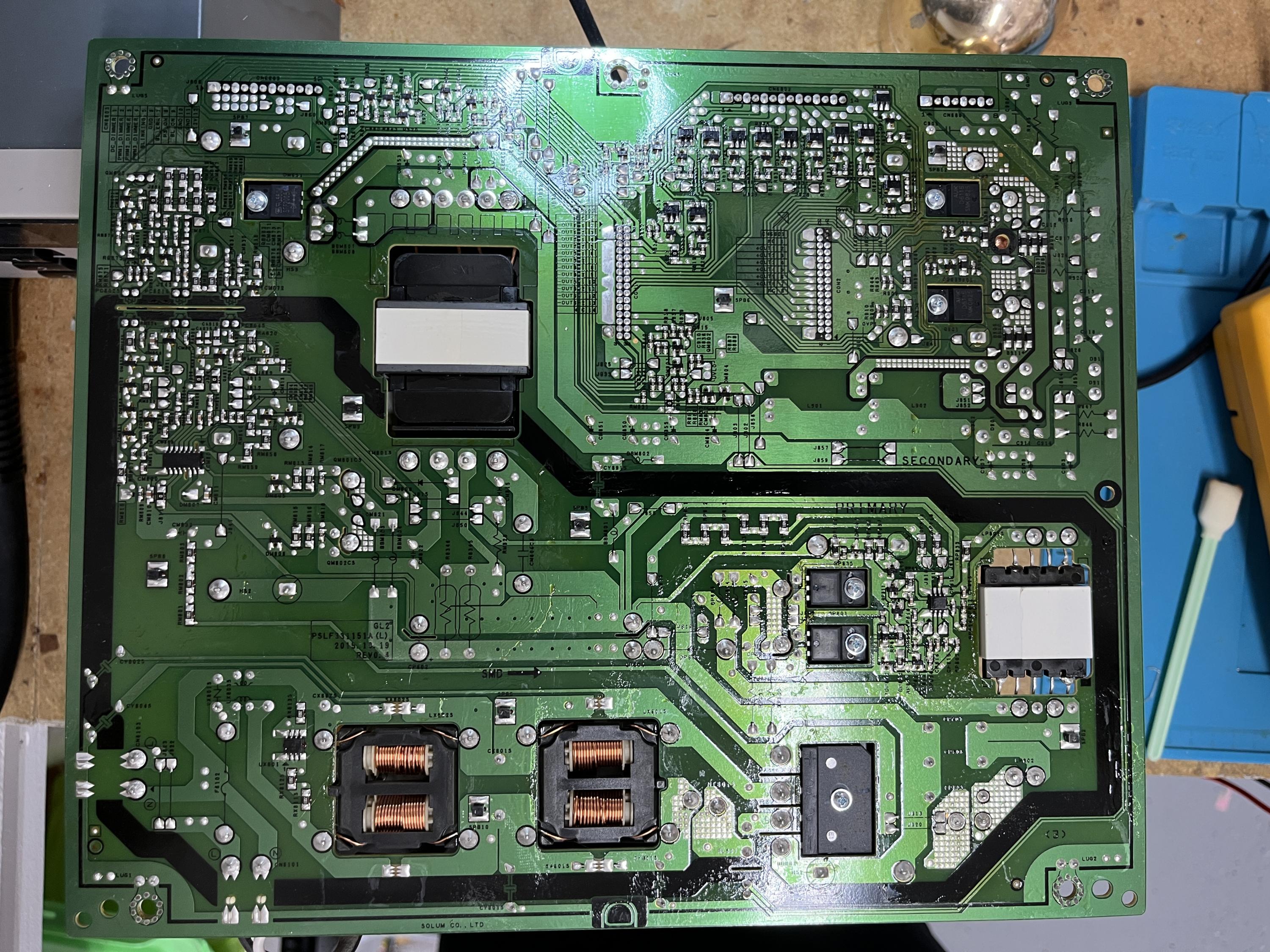

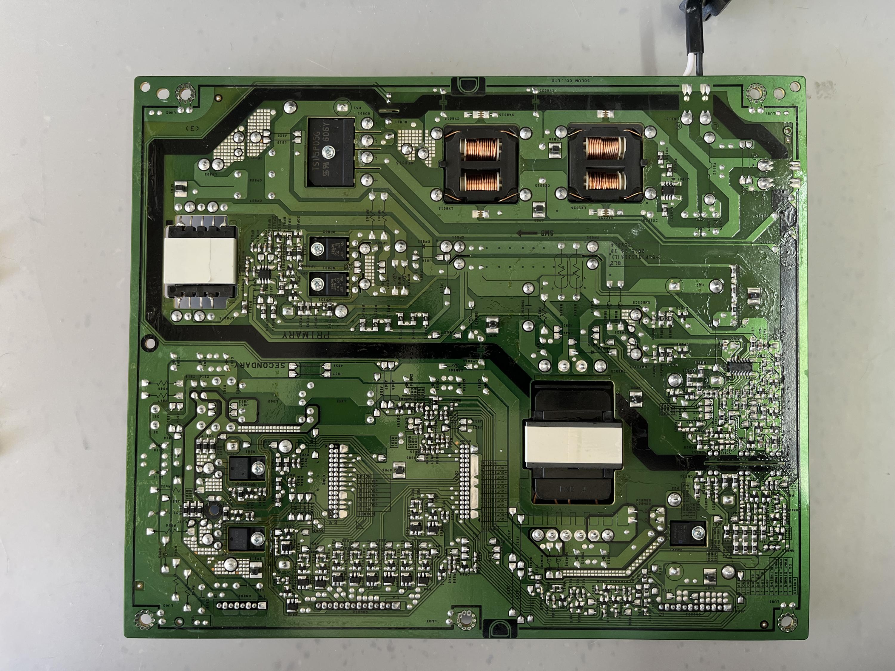

    This TV does not power on. No standby or power light
    The left side power board seems to be the issue. The large primary caps have .9v on them. The rectifier has 2.5V across the AC terminals.
    On the first board (left most board), If I measure from Neutral to the rectifier bottom AC pin I get 2.3V, top pin 150mV, Live to bottom pin 120V, live to upper 122V.
    If I compare it to the second board I get Neutral to bottom 1.1V, upper 121V, Live to bottom 121V, upper 1.1V.

    Re: Sony Bravia XBR-75X850D
    The rectifier wont work until RL801 is turned on, correct? Im actually reading 12.7Vdc on both sides on the relay. Shoudlnt I see 12.7 across it, or 12.7v on one side and 0 on the other, when its on? I did remove it from the board and it turns on when 12V is applied and the switch side has about .5 ohms.
      what you describe is looking like whatever drives the relay isnt doing its job for some reason .

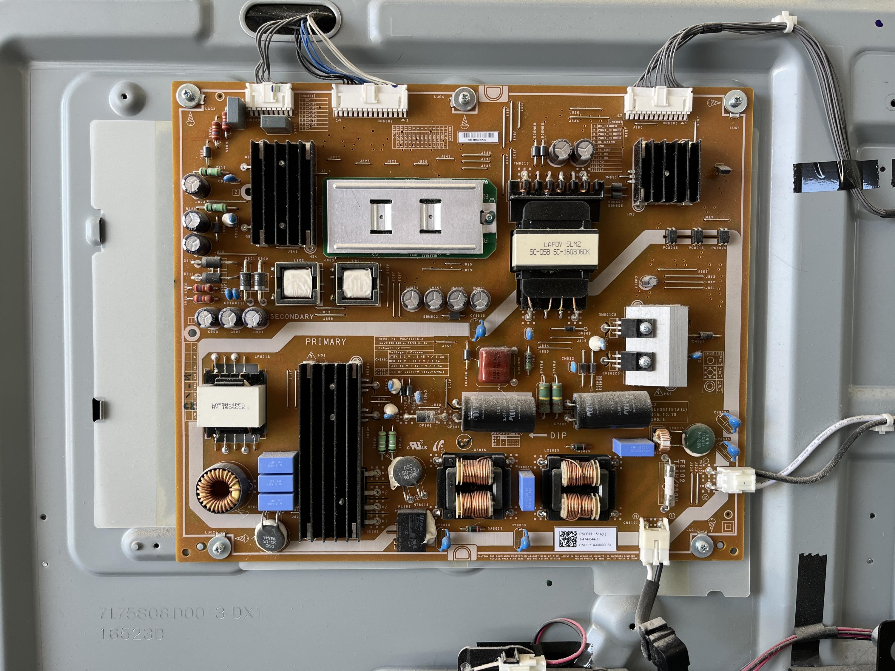

        I thought the left one was the main power board but it isnt.
        I will go through the flow chart checks tomorrow and see if that narrows it down

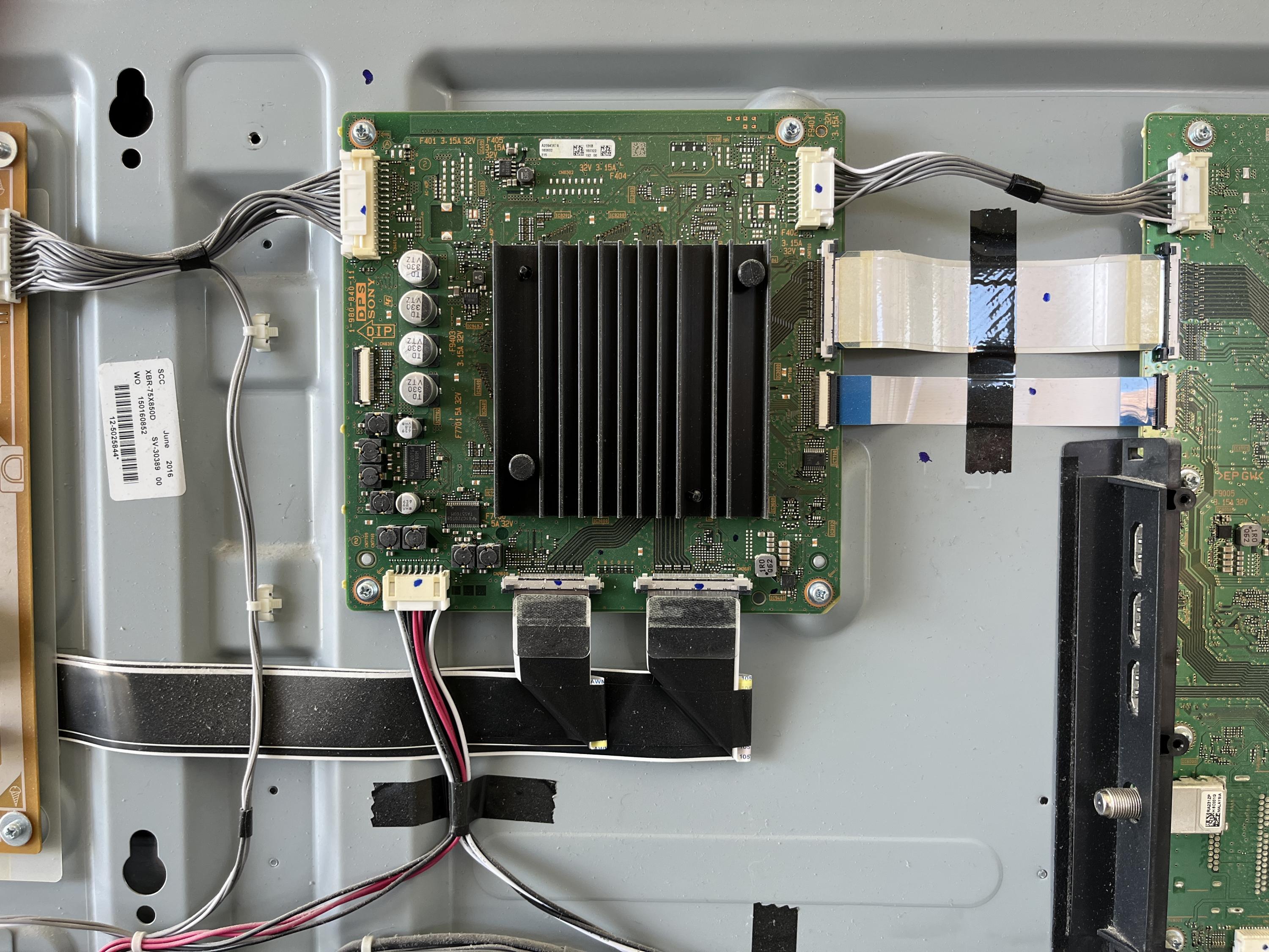

          How bout a picture of the whole back as to see how everything is connected.
            Added backside picks of power supplies

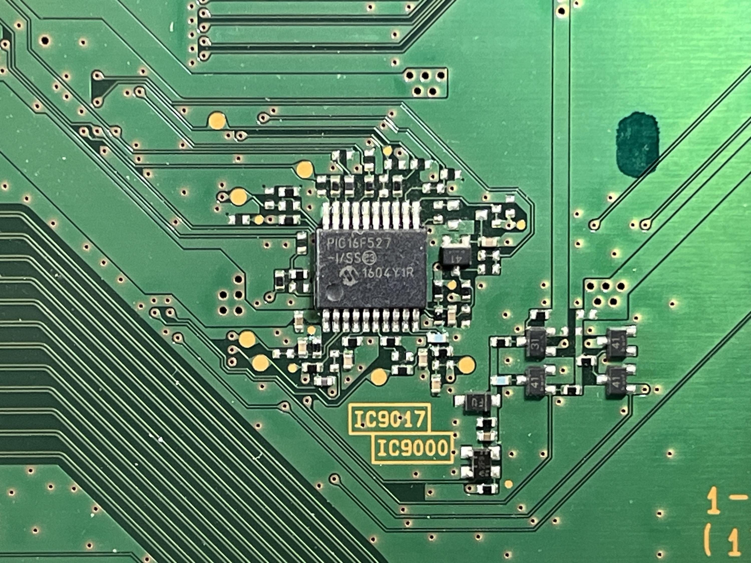

            I went through the flow chart test and im stuck on the last part of the U-COM failure test
            If BL_MUTE (R9090) is 0V, Check BL_ON IC9017 pin 18. Is voltage greater then 3V
            R9090 is 3.4V and pin 18 is 0v. Not sure what im supposed to do. Should i continue to the DDCON tests?
            I added the pic of the IC. R9090 is connected to the 3 pin IC to the right of the 20 pin IC9017
                IC9017 is a programmed microcontroller from MICROCHIP and it contains its own firmware.

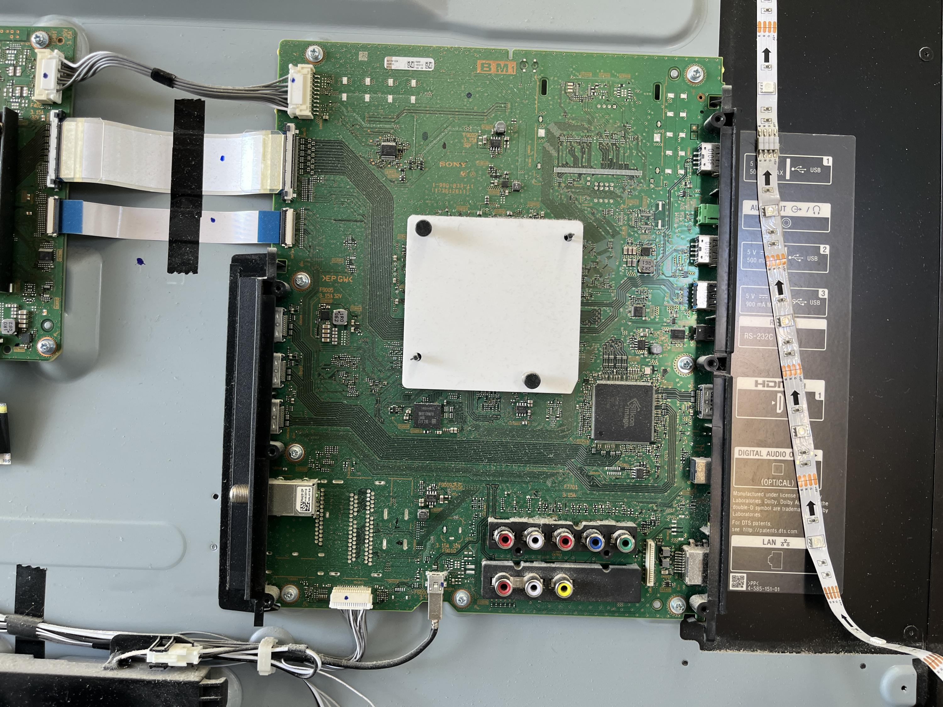

                        Sorry about the delay in responding. I tried uploading the service manual but it kept failing.
                        Try this https://file.io/aLjSiwodasQ7
                        If TCON VCC is not present will that cause any of this? I do not have BL_ON, PWR_ON TCON_ON when pressing the power button. If I jump power from standby 3.3 to BL_ON, PWR_ON I can hear the relay in the secondary PSU turn on and I have voltages present on the backlight pins.
                        I swapped the BM1 board and DSP board from units with cracked panels and still no change
                          Added flow chart I was following
                          Is there anything else that could cause a dead set? The flow chart for the G boards is 2 steps.
                          Standby on DPS - check
                          Standby on BM1 - check
                          Means B board issue
                          Is the BM1 board I bought bad?
                          The BM1 board power_on line is at 3.38V and stays there when the power button is pressed. Should it go to 0?
                          BL_ON, PWR_ON, TCON_ON all missing. Power button has 3.3V and drops to 0 when power button pressed.

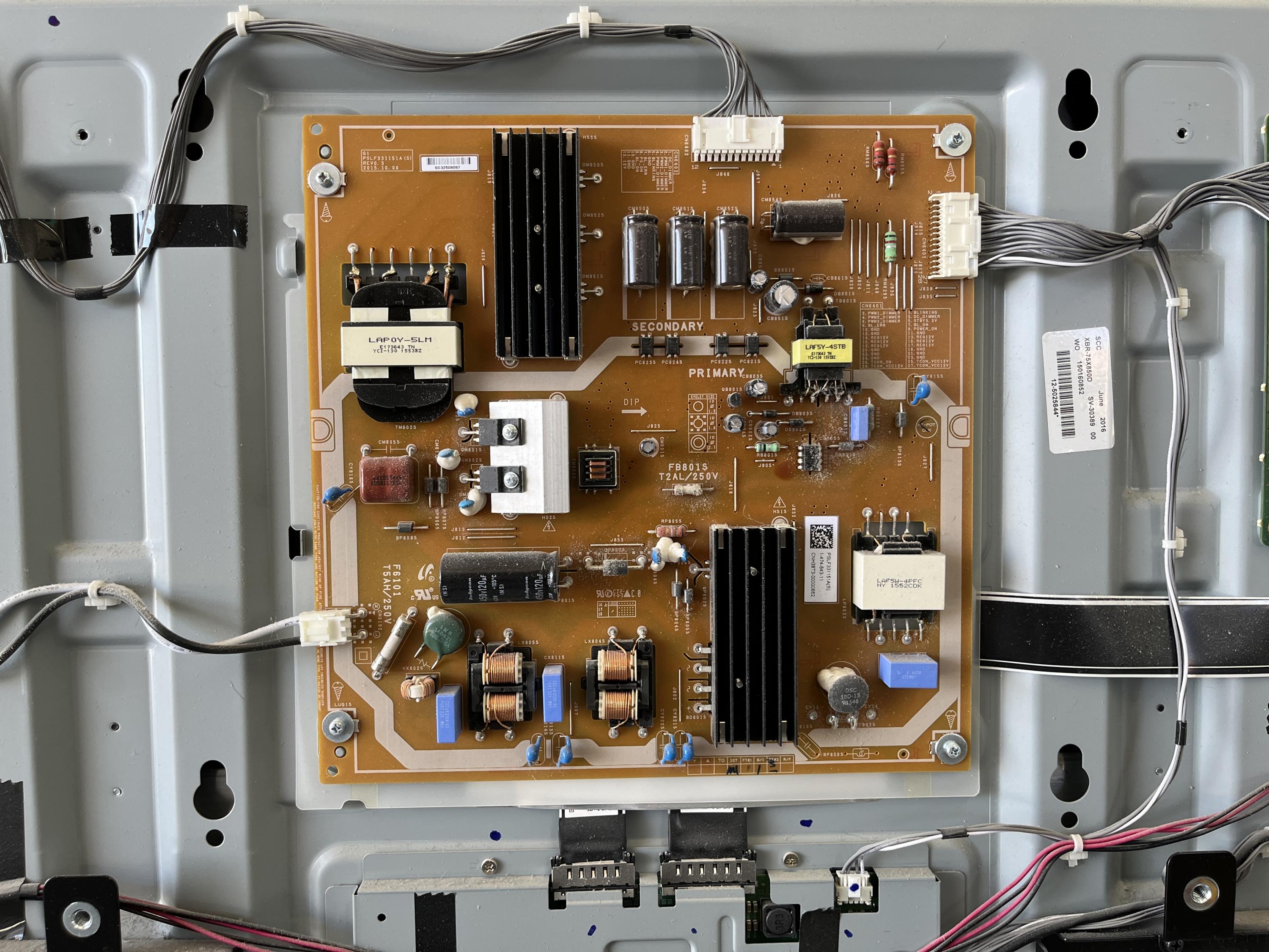

                                      The main board only connects to the G1 power board. I thought you meant to remove the BL connectors from the GL2 power board (backlight board). I just removed the connector from the main board and jumpered the wires while both power boards were connected to each other.
                                      I see nothing visibly wrong with anything on either power board. The TCON does get 12V and its present on both sides of the fuse.

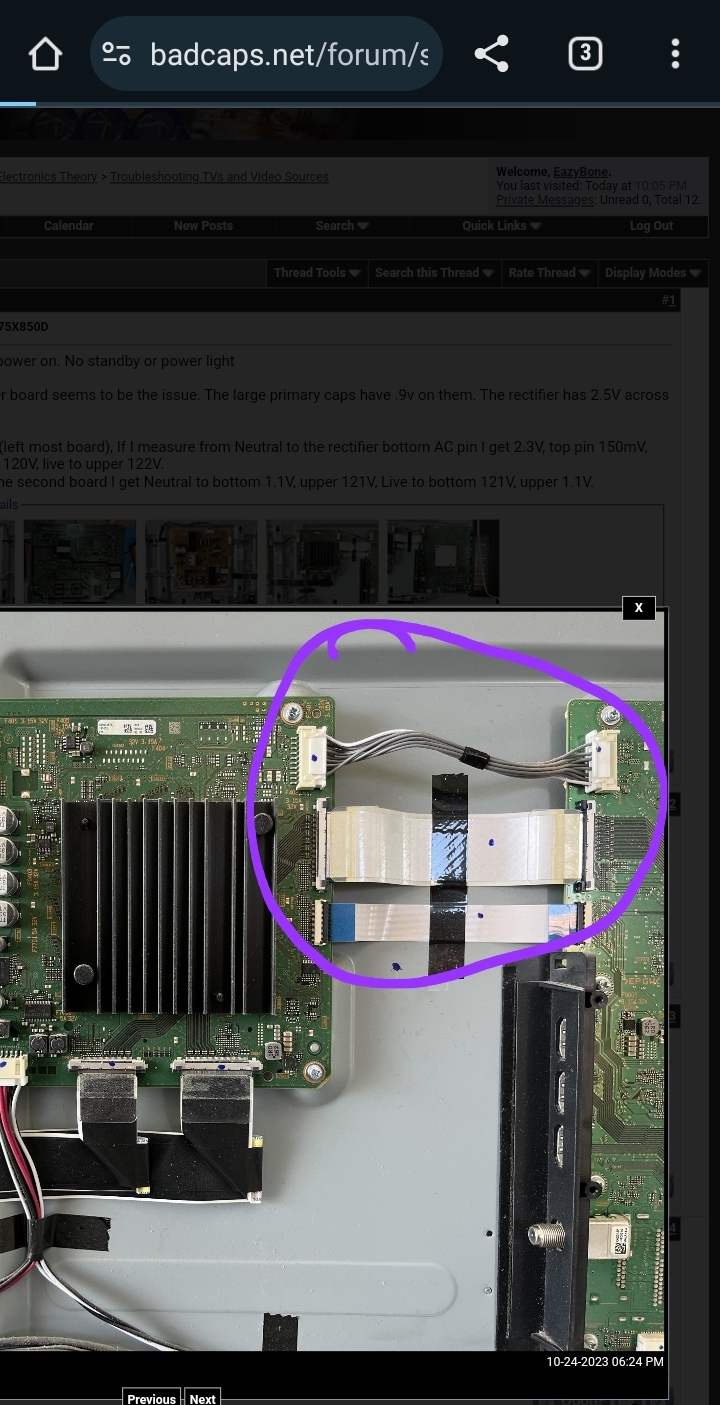

                                        Give us a picture of the whole back to show all boards
                                        The pic 4 in original posts clearly shows 2 ribbons and 1 wire harness connected to LED driver.
                                        Disconnect any combination of ribbons/harness and do the same jump and try and get those bl to turn on. Disc from LED driver side and make sure PSU and main are never connected so a ribbon doesn't accidentally short while disconnected.
