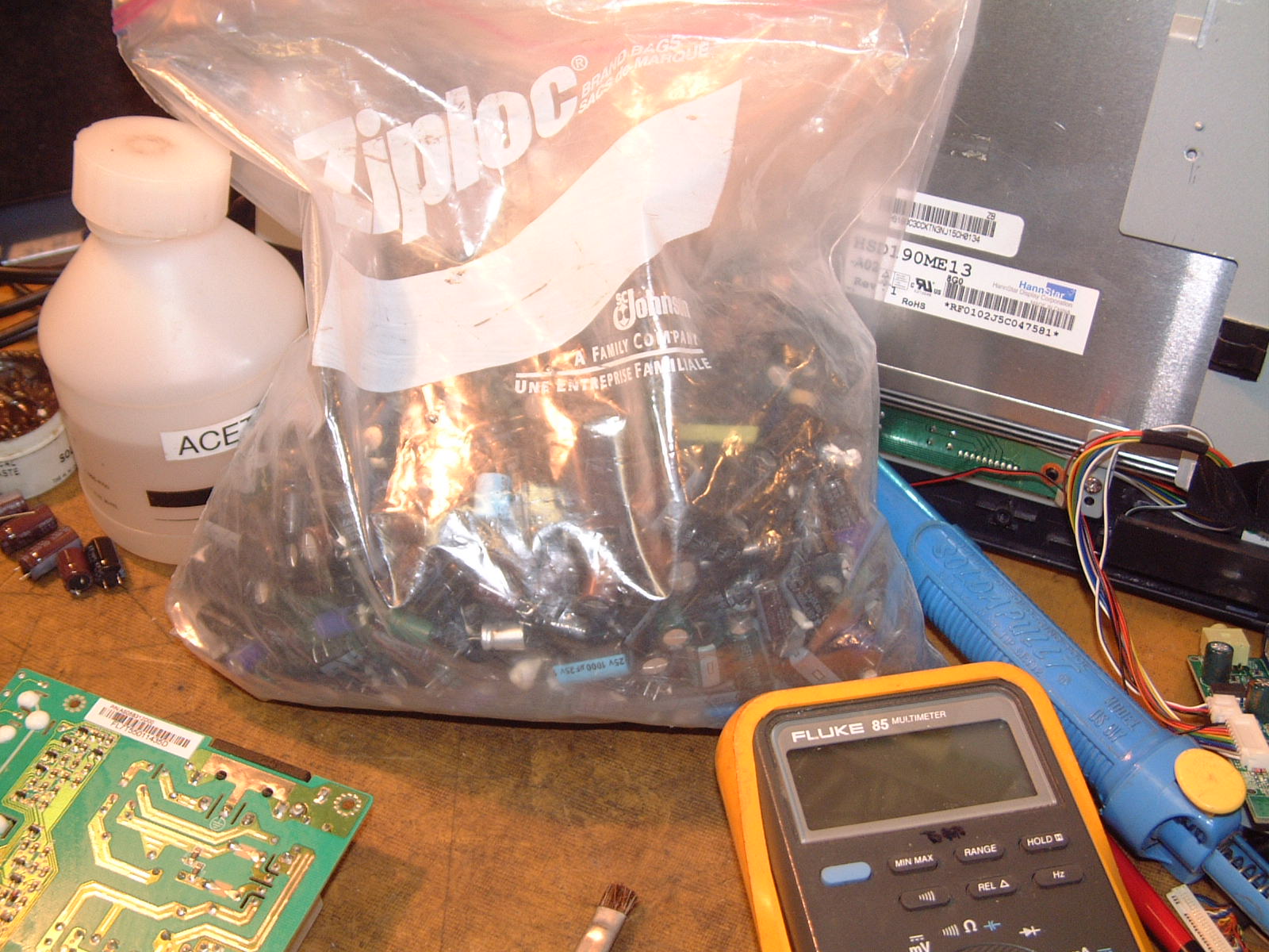

                          To me for most people that works on mother board, monitor, TV: the bottom line is to find out the cap that you pull off the board has high ESR compare to what we use as the replacement caps (PANASONIC FM./FR/FC series, you can use FR ESR # as the ref. point), you will find out that most failed cap will show more than 1 Ohms (the bad one will usually shows >3 Ohms and up. Then you will already know you have bad caps, no need to test for leakage, or capacitance since it already has one bad parameter already.
                          The regulator IC 1117 series used in the main board can accept the cap with ESR as high as 0.50 Ohms.
                          ""APPLICATIONS INFORMATION
                          Figure 1 shows the basic hookup diagram for fixed-voltage
                          models. All models require an output capacitor for proper
                          operation, and for improving high-frequency load
                          regulation; a 10μF tantalum capacitor is recommended.
                          Aluminum electrolytic types of 50μF or greater can also be
                          used. A high-quality capacitor should be used to assure
                          that the ESR (Effective Series Resistance) is less than
                          0.5Ī©."
                          So if you are not the incoming QC guy that need to verify the cap parameter (you will need meter that can do more than ESR checking, how many people here works as the QC guy? or even check any replacement components when you receive them from suppliers, or verify that they are not faked parts?) then the $50 range ESR meter will be more than enough for you to verify what you suspecting to be bad. I use SENCORE LC75, my home made ESR, hair dryer to locate bad caps, even Frequency function to locate bad caps. When you work in real world on so many equipment, you will know how to tell what is good what is bad.
                          I do not know how many people in bad caps repair as many pieces of equipment and replace as many bad caps as I do in 2 years.
                          See the pictures of the bag of bad caps. and how I use DMM, ESR meter to locate bad caps.
                          ESR meter, DMM, Hair dryer are part of my tools.
                          https://www.badcaps.net/forum/showthread.php?t=31410
                          https://www.badcaps.net/forum/showth...ghlight=al2416
                          These pictures are from what I work on every Saturday as the volunteer at the electronics recycle place (CRC.ORG), they are from about 3 years worth of works (I started taking pictures so other people can see what are inside the sets). How many people here repair that much one day a week every week. I have been doing volunteer work since 1995?
                          http://s807.photobucket.com/user/bud...?sort=2&page=1
                          So you pull out that cap, it shows 5 Ohms ESR, what else do you need to know? Put in that PANASONIC cap and you are good to go knowing you even putting in better quality cap than the one that the factory puts in in the first place, so far I no return repair units back from customer/donation receiver due to fail caps I replace, is a good real world test on these PANASONIC caps.
                          Here is a guy from Oman that does not have lots of expensive equipment but able to save another electronics from land fill. When the meter tells you you have 47 Ohms ESR, what do you do? Do you care if the meter show 47.00 Ohms instead of 47.000 Ohms? Will some one tell you that 47.00 Ohms reading is not accurate enough? Will you care when you check your car batteries with your DMM and it shows 9.00V not 9.000V? Are you going to say, oh I cannot trust that reading of 9.00V?
