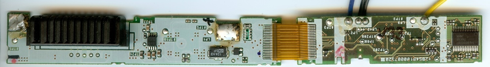

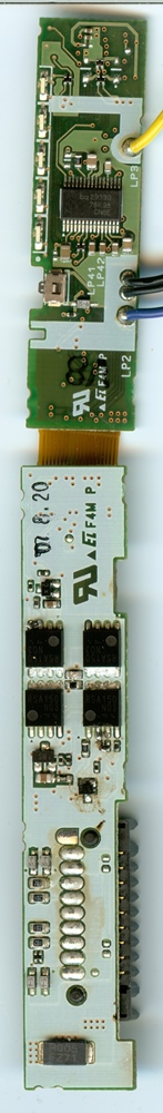

    Hi, i have burned the shit out of my battery controller by keeping it open and touching one of mosfet control transistors (small 3 pin p-channel sucker) with positive battery terminal. Led indicators just dim constantly on 30% of light power, battery not detected, and so on.
    Apart from the fact that controller is blocked i need to repair the circuit. I have tested most passives in-circuit. I assume that the resistors between source and gate of soic-8 mosfets were toasted as they were open. I assumed them to be 10kOhms. They were extremely small so i have made a ghetto fix. The problem persisted.

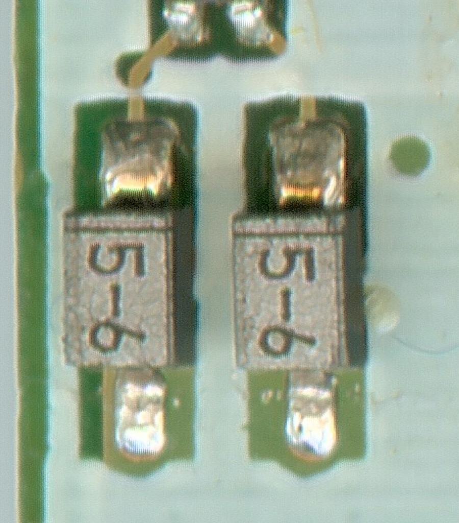

    I am not sure WTF are those white-blueish-gray "5-6" components, you can see some of them in the back of the connector terminal.
    And yes, i did actually scan the board With the goal of identifying those tiny resistors. didn't help
    And i did actually upload 2 insane high resolution files of 40mb each.
    http://domas.hard.lt/gd761-controller/scan0004.jpg
    http://domas.hard.lt/gd761-controller/scan0005.jpg
    computer dell inspiron 6400 / e1505, battery GD761

    Are they measured out as shorts, or like Diode?

      well, as i have tested them in circuit, they are neither.
      they have some different resistance in different directions, but that might was well be because of other components on-board.

        I would remove one off the board and do some measurement in Diode mode, capacitor mode, etc.

          the line on one end says diodes.
            Re: Help identifying SMD component 5-6 on battery controller
            That is what I thought too but it can also be Tantalum cap, not 100% sure.
              i will take some time and measure it and post some results here.
              <sarcasm>i just love desoldering smd stuff< / sarcasm>, so i will just measure them in circuit. I will aso try to check if they are going from connector i/o lines to the circuitry (as a component in series if it can be called so) or they go from lines to to GND.
              I have 4 of those and iirc they are connected to sba scl and tho other outputs, system_present and one dell related output to MB.
              there is also one of them next to the push button, it seems like it is in between button's terminals.
                  If it's connected to SDA and SCL then likely they are protection diodes, possibly zeners?
