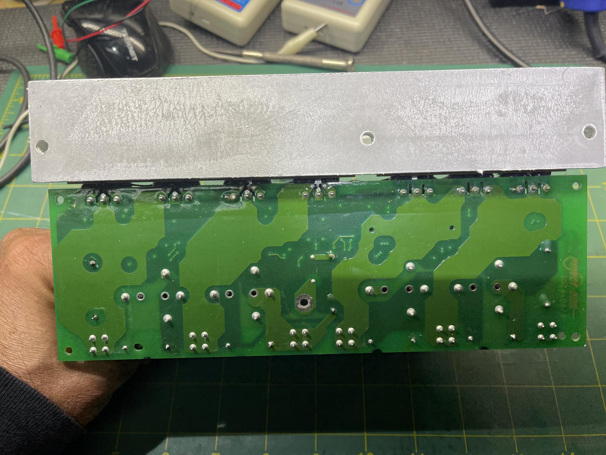

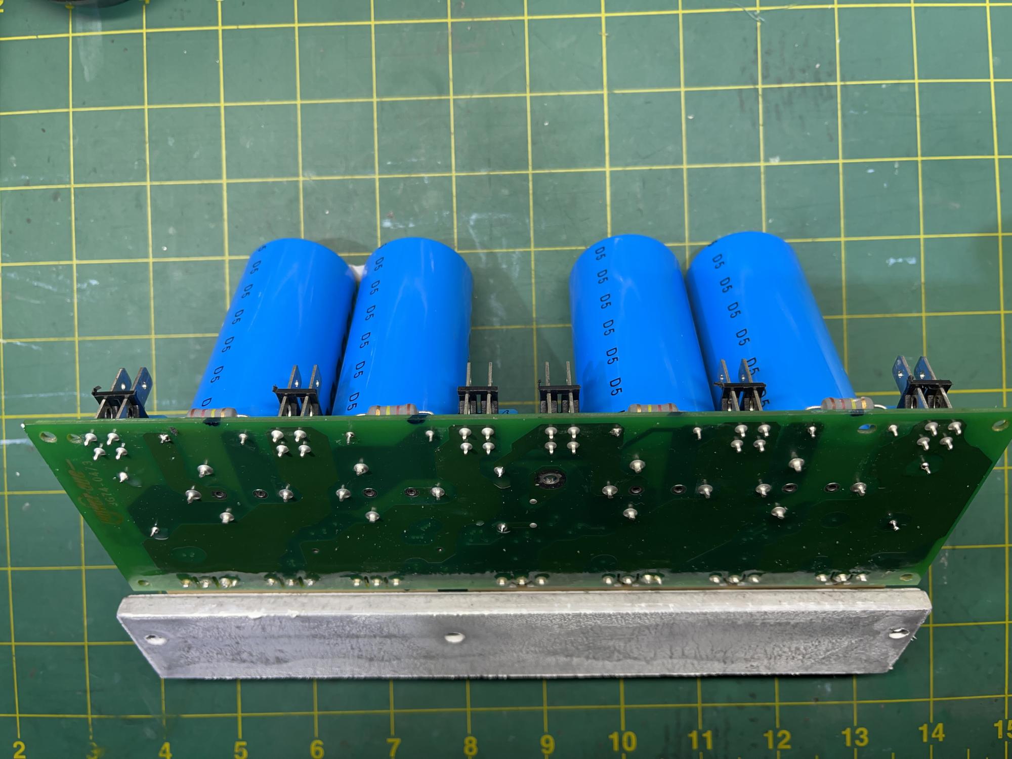

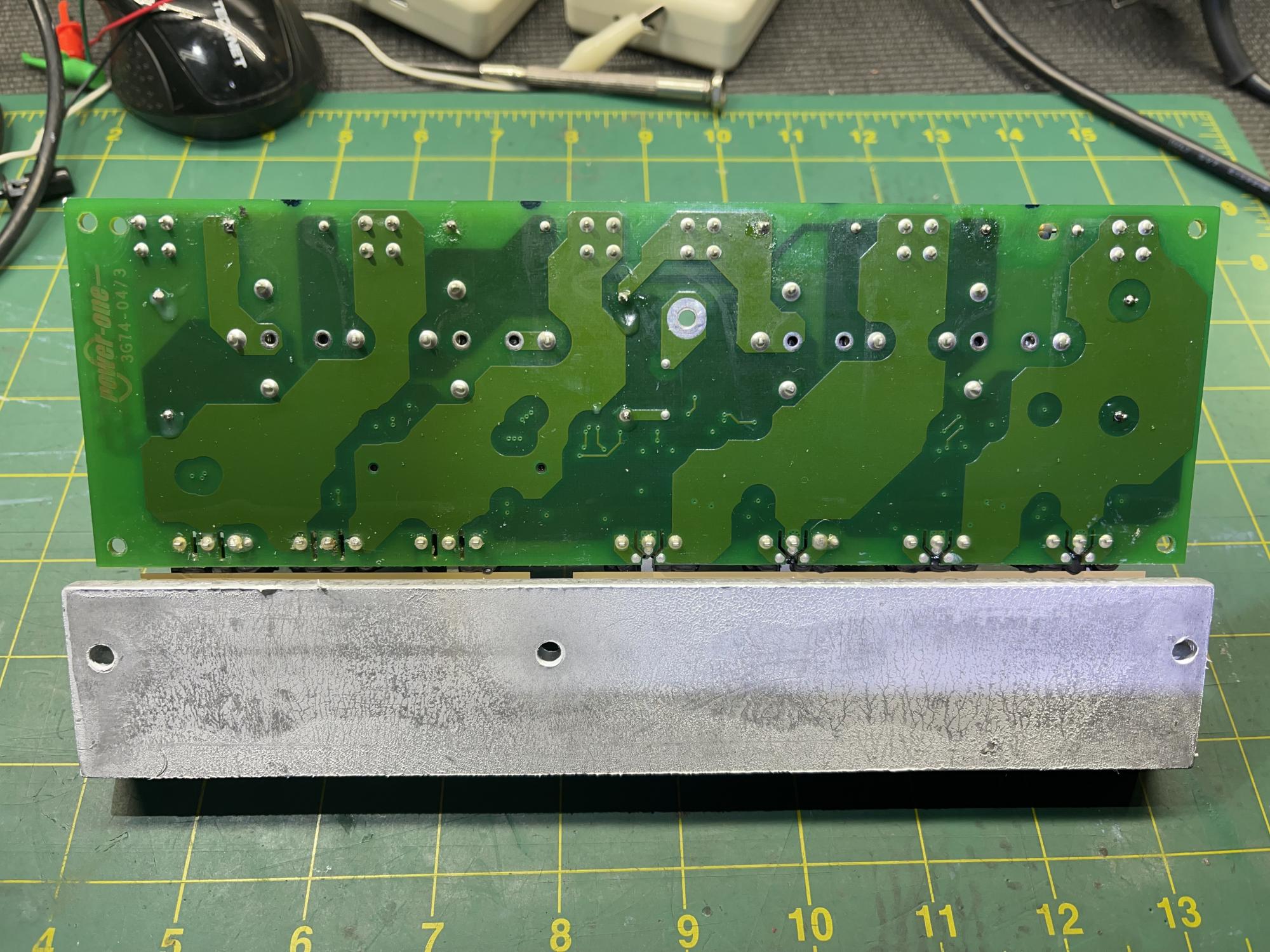

          Can we have a picture of the second board the bottom? Haven't seen that yet. Thx.
          BTW, I wanna figure out what the deal is between the GRP plug and the GND, there shouldn't be continuity there. Something is a miss somewhere that involves the GRP plug, the HVDC positive and negative and earth gnd.
          Some numbered GP screw holes don't look good in the pictures.

            I am such an idiot. I put the second board back in without taking pics of the bottom. I will remove it again and get those pics uploaded. Sorry for my oversight. I am getting worn out.

              Re: Power-One solar Inverter driving me NUTS!!!
              I took several pictures at different angles of the bottom of that second board.

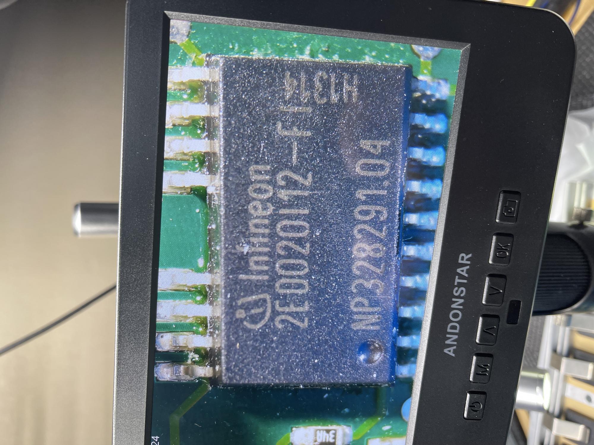

                    Is there any part numbers on the IGBT module if there is can you please post it thanks
                    Because depending on the model number sometimes there is a test procedure for that particular one

                        Originally posted by sam_sam_sam
                        Is there any part numbers on the IGT module if there is can you please post it thanks
                        I'm sorry, what is the IGT module? I can take a pic
                          The first board all I can see is a double layer board. The second board is at least 3 layers. No problem for writing that post again. It's very interesting how this inverter works. MPPT is complicated, but more efficient. Anyway… would be too nice to find a service manual with schematics for this thing.
                          Schematics would be great but I have not been able to find any and the company has sold several times. And yes you are correct. This is one complicated sucker

                              I’m sorry, what is the IGT module? I can take a pic
                              Most of the time they are module that many pins on it but the only way to be sure that it is a IGBT module is to google it
                              I forgot the “B” sorry about that

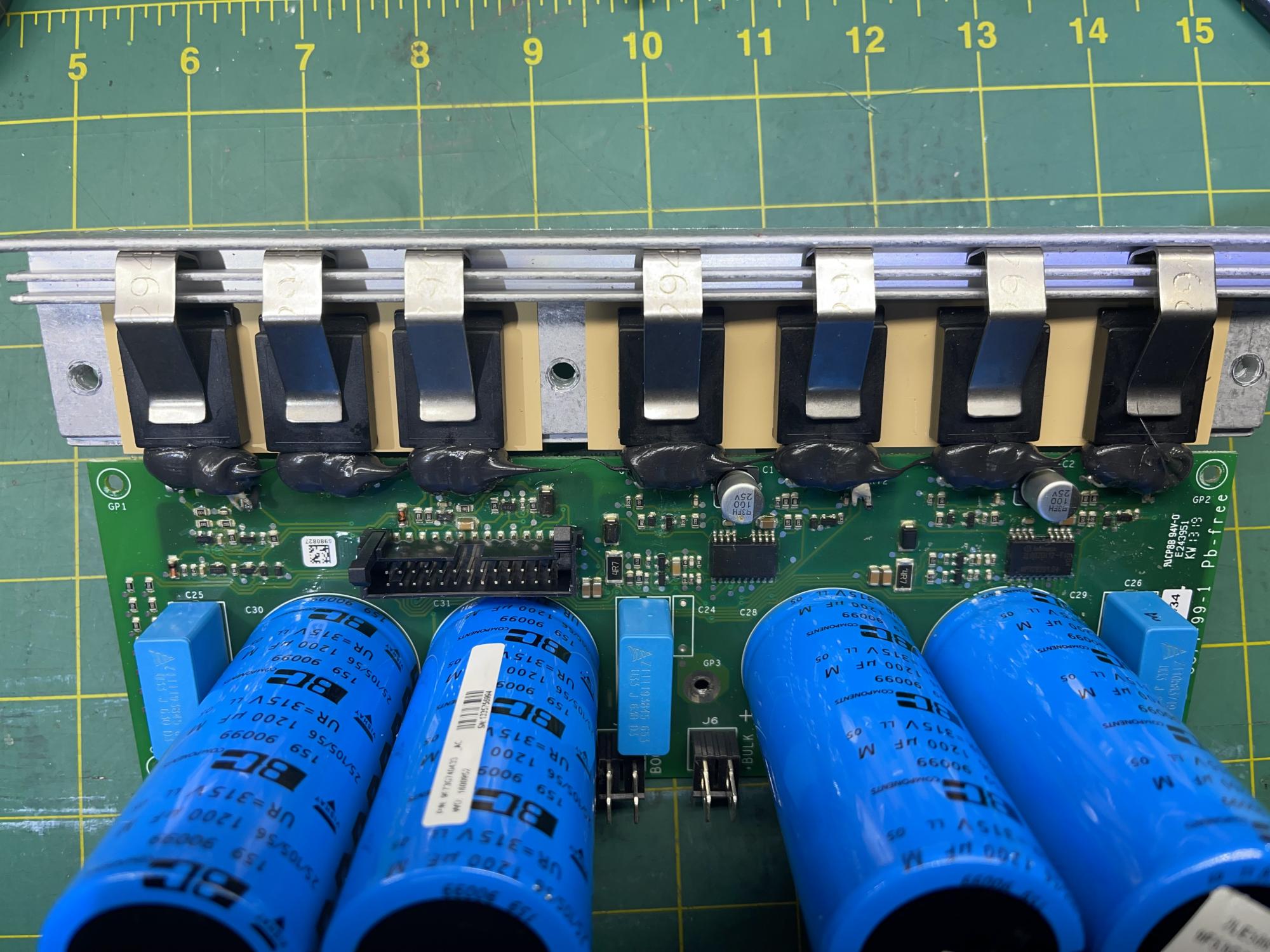

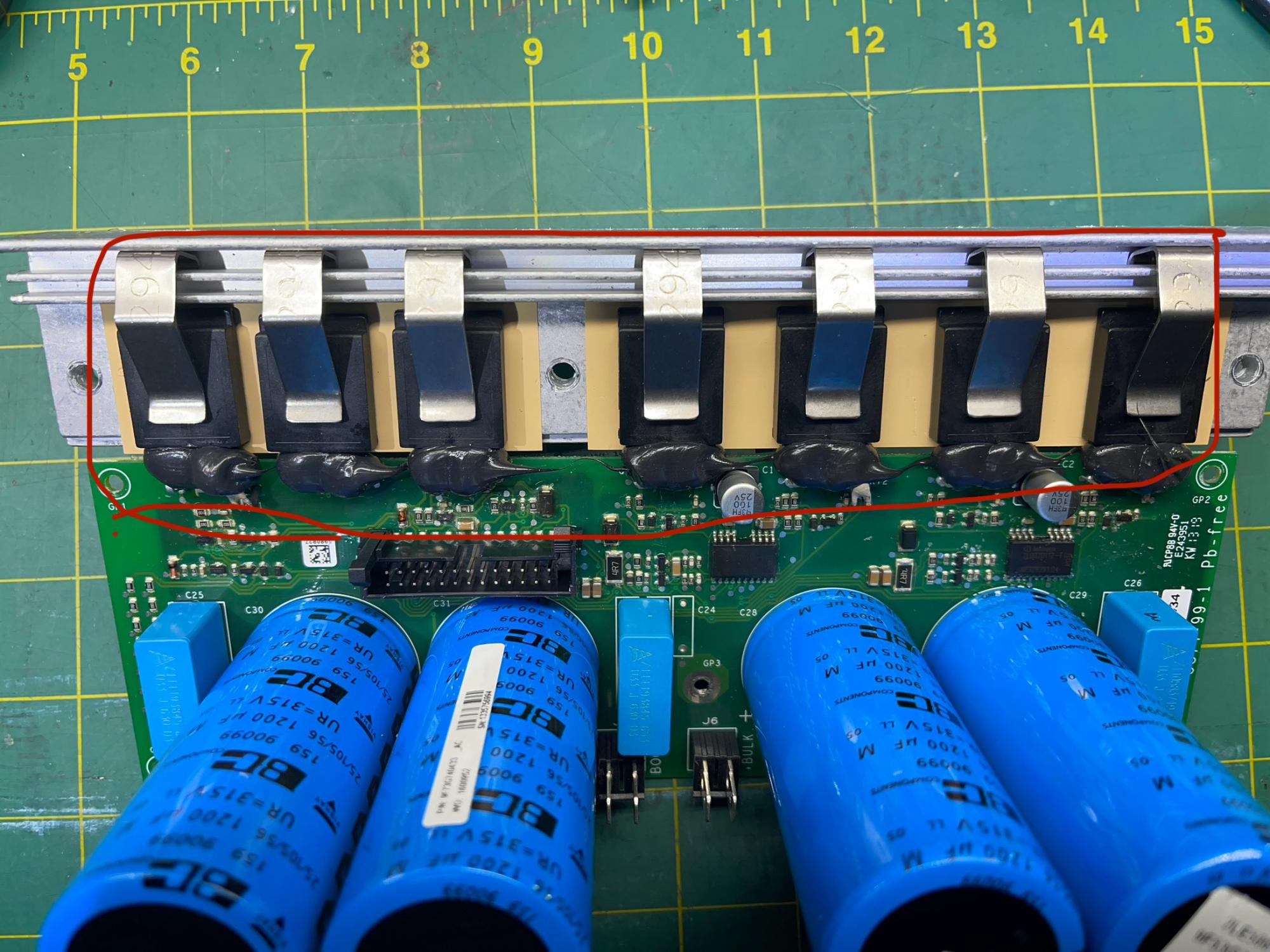

                                There are two of these on the board with the 4 large capacitors.
                                https://cdn.badcaps-static.com/pdfs/...f9e4568a9c.pdf
                                Also these 7 guys circled in the other pic have no part number on top
