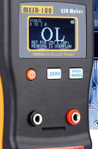

Finally built the Bob Parker "Blue" ESR Meter

      huge probes!
      i have several of these - i get a pair for every meter!
      https://www.aliexpress.com/item/32848907433.html
      Originally posted by bcstedt
      Those look pretty neat especially for the price. Do you use this seller specifically?
      Originally posted by jayjr1105
      Not a ton of options when you need modular ones that will accept 4mm banana plugs.
      Agree with @stj.
      Plus those banana plugs are completely useless. Cut the probe wires if needed, and replace.

        Re: Finally built the Bob Parker "Blue" ESR Meter
        I'm still tossing the idea around in my head to convert it to banana jacks like the MESR-100 meter. They give you an extra top plate, just need to find jacks like these somewhere.
          you would be better using the shielded type like on multimeters.
          you can still use 4mm banana jacks, but you can also then use comercial probes and cables.
            Incidentally, where does one get shrouded banana jacks?
            Ah, looks like ponoma makes some and distributed by the usual newark, mouser, digikey, etc...
                Question if it's easier to replace the old DMMs' connectors, or is it time to get the probes circumcised...
                  • 31315
                  that depends on the meter.
                  i have drilled out the molded crap on a couple and fitted ones with locking rings, but it depends on clearance.
                    Well the answer is quite obvious:
                    1. Once circumcised... you are stuck (in fact, not you but the probes... )
                    2. Change the sockets and you're free to swap probes (see @stj remark about clearance)
                      Even free to attach alligator clips when handy

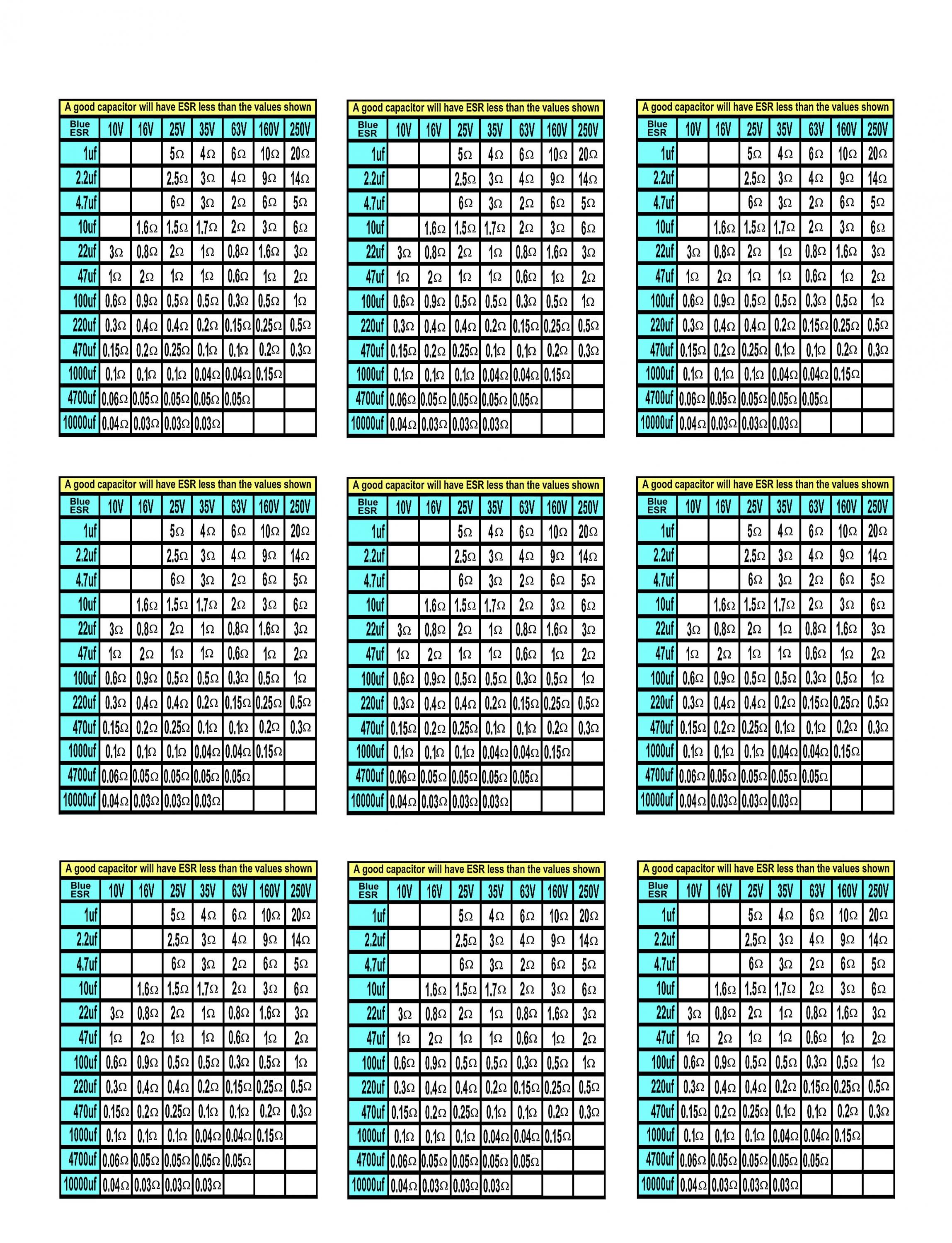

                      I built the Bob Parker Blue ESR meter kit a few years back and i still love it today.
                      All except the graph on the face,... I had to make a chart to replace it with!
                        What ESR chart did you go with?

                          #32
                          I kinda made one from the old Bob Parker meter.

                            #33
                            Printed it to sticker paper and after applied I put clear laminate over it!
                            I made a bunch in case i messed up. lol
                            Worked fine on the first one.
                              Did the included sticker give you trouble removing it? I agree it's a bit too vague. Need a simple chart. Plus I put mine on a little too high so you can't quite see the decimal positions if it's slanted too much.
                                I can`t recall but i bet there was some hot air involved.
                                          Did a few more minor upgrades. New thicker and longer cables, better banana plugs, cut off the massive finger guards on the probes, and 3d printed a case that holds the meter upright.
