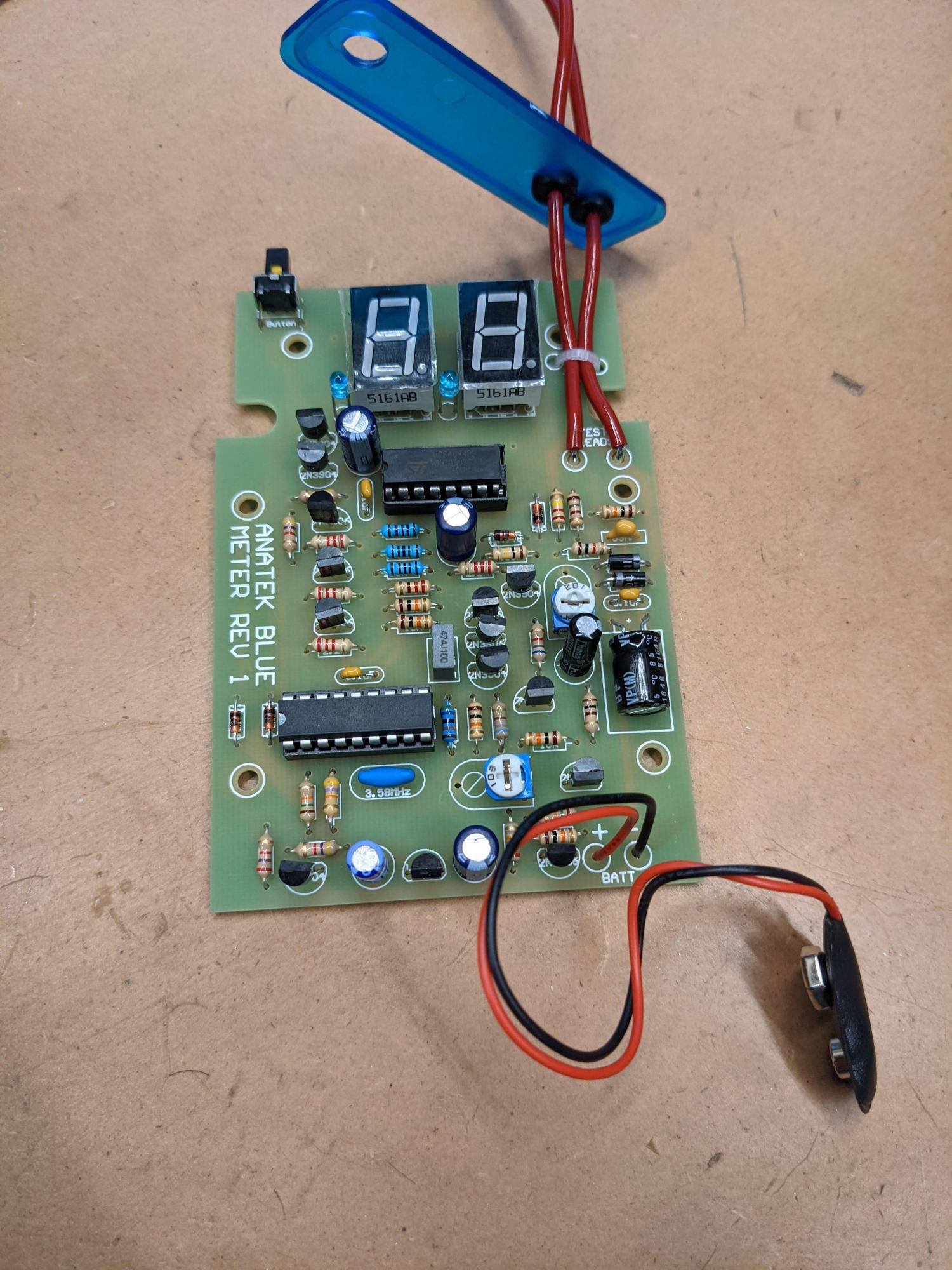

Finally built the Bob Parker "Blue" ESR Meter
  • jayjr1105
    • 281
    Have wanted to build this for a long time ever since I saw Dave Jones use the old black and red one. It was fun to build and works great. What ESR meters do you guys use?

    Re: Finally built the Bop Parker "Blue" ESR Meter
    There have been a few threads about this meter in the past if you want some history.
    I still have mine, and I used it today at work!
    Sure I have a couple of the Atmega based "transistor testers" that are all over eBay.
    But this original Bob Parker design is special to me, I really like it!
    https://www.badcaps.net/forum/showthread.php?t=1287
    https://www.badcaps.net/forum/showthread.php?t=6535

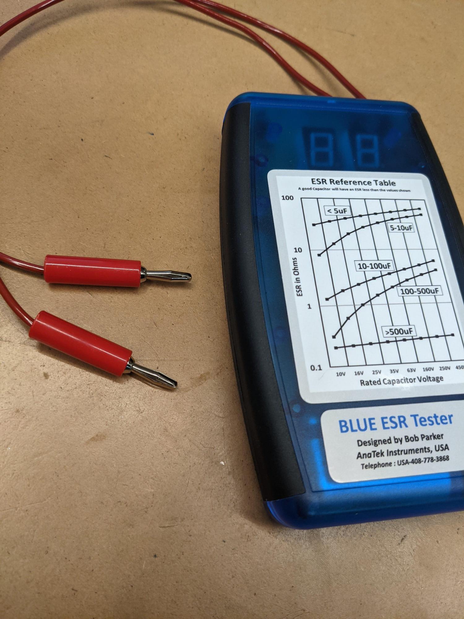

        Re: Finally built the Bob Parker "Blue" ESR Meter
        Oh wow, the Bob Parker lurked on these forums, cool!
        I love it. Just waiting on better probes. Wish the blue meter had the banana jacks like the old Dick Smith model had. Otherwise It's great and was fun to assemble.

          • 31314
          you could re-drill the endplate and fit a couple of 4mm shielded sockets.
          • jayjr1105
            • 281
            They actually give you an extra endplate without any holes, I guess in case you want to do something like this. You'd have to re drill the hole for the power button but that's not difficult.

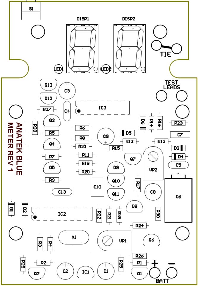

                  • bcstedt
                    • Jun 2011
                    • 59
                    Thanks for the update and the pics!
                    I mostly use the Blue ESR (rev 1) and the DE-5000 (ver 8). I just got looking over the Blue ESR docs and found the self test section (it's been a long while) but have now found my meter is giving an FA error code. Can anyone else confirm their self test is working okay (.8.8 display)?
                    I've never noticed anything really 'strange' about the behaviour of my Blue ESR but now I'm curious. :/
                    From the manual:
                    Switch the meter on by pressing and continuing to hold the button down, regardless of what the displays are showing. After five seconds, they will go blank for a moment and then show a test result for two seconds. The meter will then switch off by itself after you release the button.
                    If everything is more or less OK, you’ll see “.8.8” on the displays (this shows that all the display segments and decimal point LEDs are working). However, if the microcontroller has detected a problem it will flash a fault code
                    consisting of an “F” on the left hand display and a character from 0-9 or an “A” on the right hand one.
                    FA: Q6 not switching on. Check around Q6 (2N3904), R24 (10kΩ) and pin 1 of IC2.
                    The microcontroller cannot perform detailed tests on every component, so it’s possible that your meter is malfunctioning even though the self-testing hasn’t shown up a problem. For example, if the meter is behaving strangely, “freezing” up or giving absurd readings on some values of test resistors, the most likely cause is a mix-up in the values of R6 (10kΩ), R8 (1kΩ) and R10 (100Ω). On the other hand, if the meter produces readings but there’s something wrong with the displayed characters, this is almost certainly due to one or more solder bridges between the pins of the displays or around IC3.
                    • Per Hansson
                      • Jul 2005
                      • 5895
                      • Sweden
                      Mine (an original Dick Smith Electronics K-7214 MK2) shows 8.8 for the self-test.
                      It could be that Q6 has been damaged from a charged capacitor.
                      You can check the area around it and ultimately try to replace Q6.
                        I've inspeced the board, checked the battery and voltage while running, reseated the Zilog (IC2) but no change. A damaged Q6 seems like a reasonable explanation I'm just surprised. :|
                        • redwire
                          • Dec 2010
                          • 3912
                          The Blue ESR meter firmware does show fault codes for many problems:
                          F0- Q11 not discharging Q10.
                          F1- C10 charging too fast.
                          F2- C10 charging too slow or not at all.
                          F3- Pulse amplifier bias Q8-C <0.44V
                          F4- Pulse amplifier bias Q8-C >1V
                          F5- Test current source is always on.
                          F6- Pulse amplifier has no output.
                          F7- Q3 not sourcing current.
                          F8- Q4 not sourcing current.
                          F9- Q5 not sourcing current.
                          FA- Q6 not switching on.
                          FA might be the input protection diodes D3 or D4 shorted. Those fail if you connect the unit to a big charged cap. Less likely the 22uF BP cap C6 has gone open.

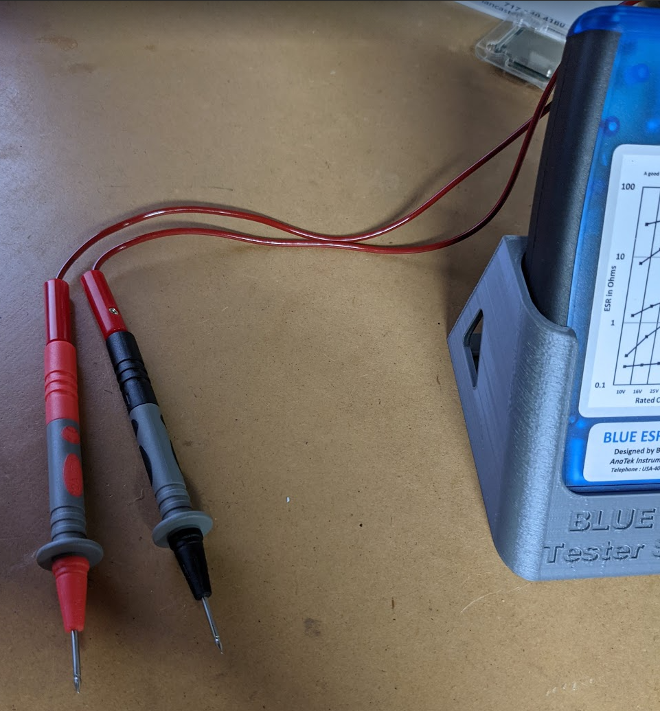

                          • jayjr1105
                            • 281
                            Bought some cheap modular probes for mine. Thinking about soldering in some thicker/longer wires into it, the ones that came with this probe kit to be exact. Probably don't want them too long right?

                              • 31314
                              huge probes!
                              i have several of these - i get a pair for every meter!
                              https://www.aliexpress.com/item/32848907433.html
                                Q6, D3 and D4 are not shorted and seem to test ok in circuit.
                                C6 measures 22uF in both directions, also in circuit.
                                Prefer not to remove components until I have a better idea what's going on. Maybe I'll see if I can contact Bob.
                                  Those look pretty neat especially for the price. Do you use this seller specifically?
                                    Component locations for those playing along.
                                    • jayjr1105
                                      • 281
                                      Probemasters are some of the best probes you can buy and they are like $15 shipped. Highly recommend them.

                                      • jayjr1105
                                        • 281
                                        huge probes!
                                        Not a ton of options when you need modular ones that will accept 4mm banana plugs.
