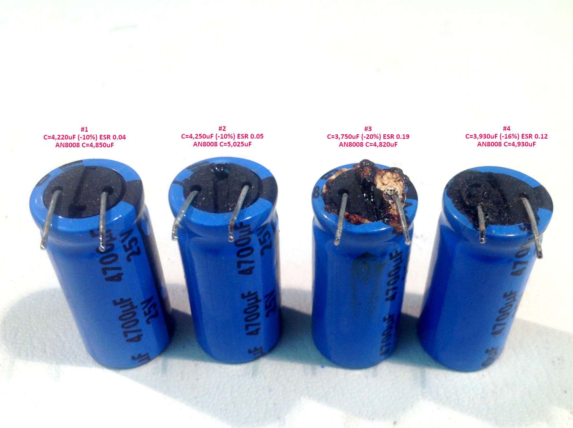

    I measure around 10mA idling, 25mA when testing, and under 0.1uA when off. It's a 5V device with LP2950 LDO (max. 30V in) and extra BJT power switch.
    Most important is the test current can be a decent 50mA narrow pulse (low average though) so it's not easily fooled.
    Here's some 4,700uF caps I tested with it and AN8008 readings for the laugh.

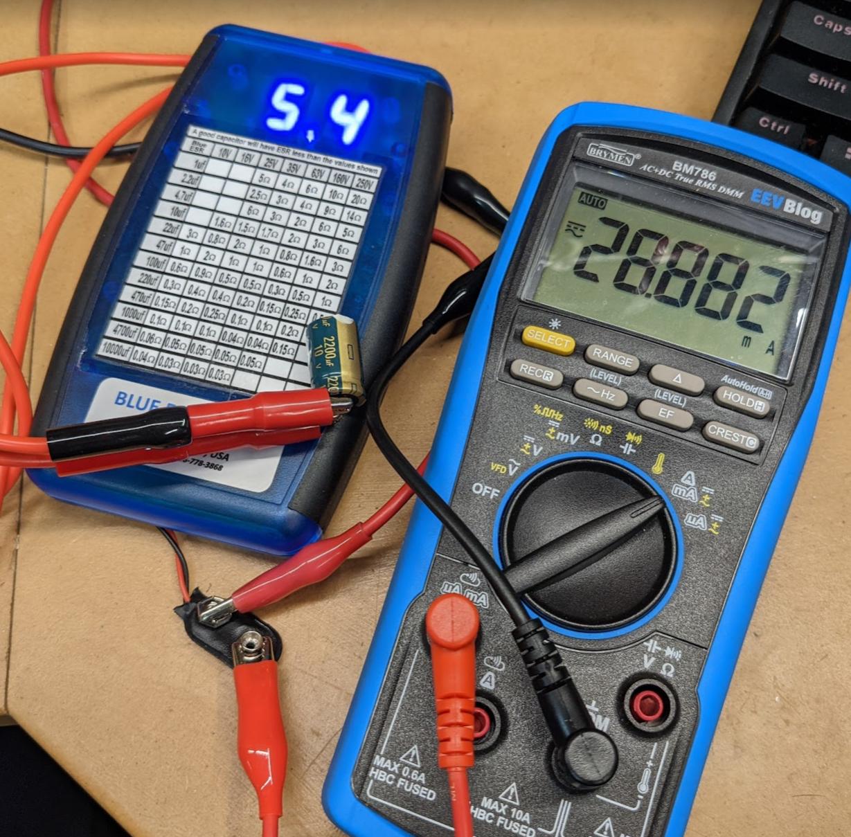

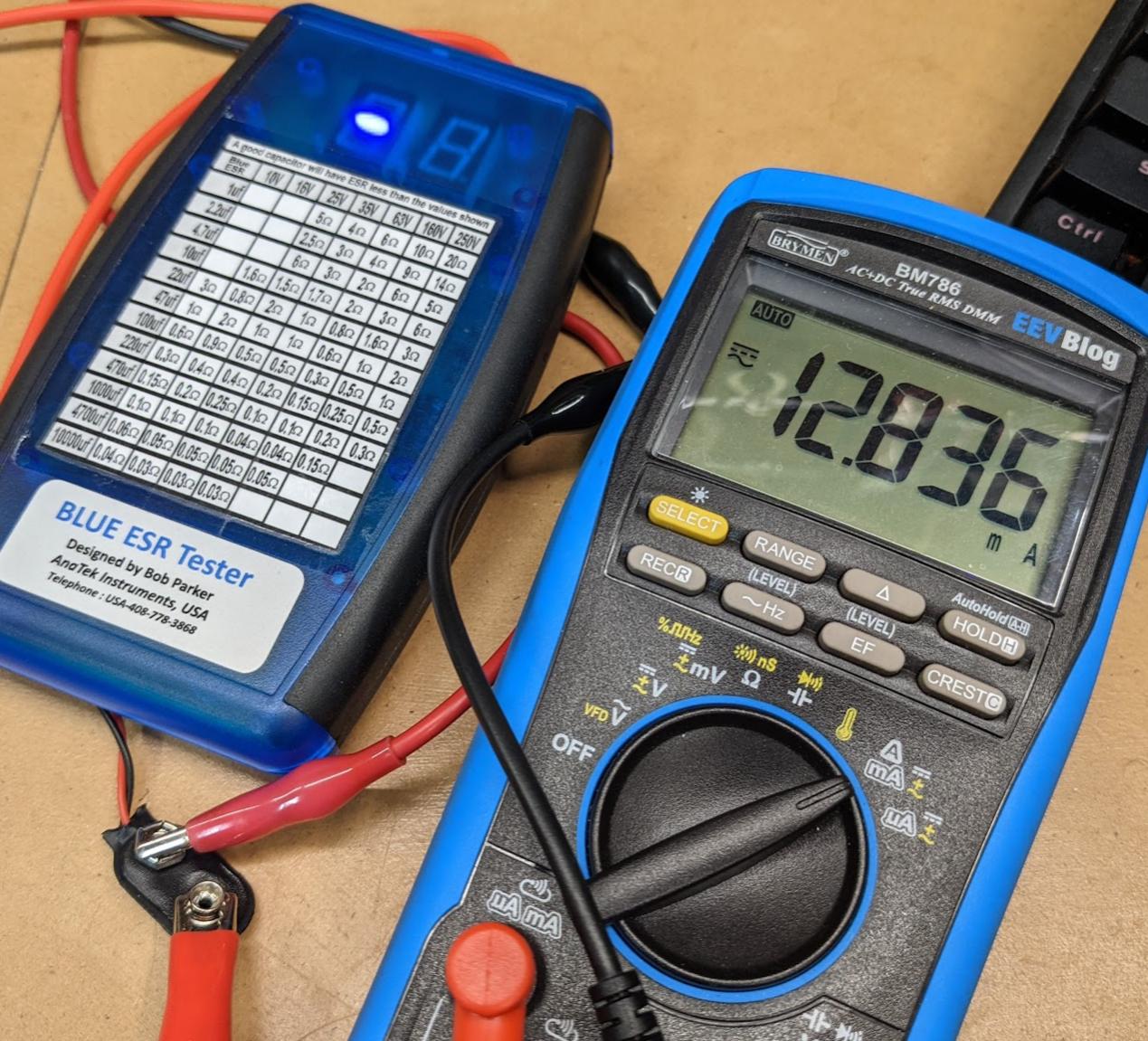

        Re: Finally built the Bob Parker "Blue" ESR Meter
        I saw spikes of around 35mA but about 12mA idle and 25-28 with the leads shorted or while testing a capacitor.
            Thanks for the measurements. I don't actually have a Blue meter with me, and I was quoting the figures for the original Dick Smith ESR meter. I kinda forgot that the blue LEDs with their higher voltage drop reduce the meter's current consumption.
