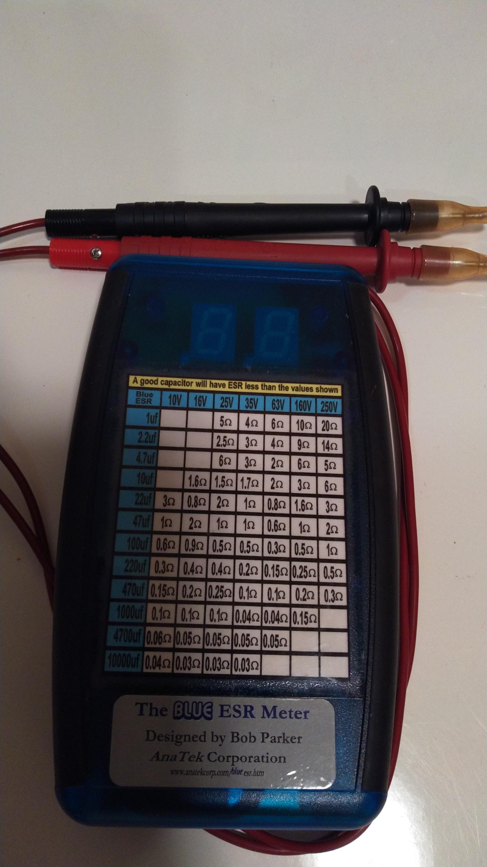

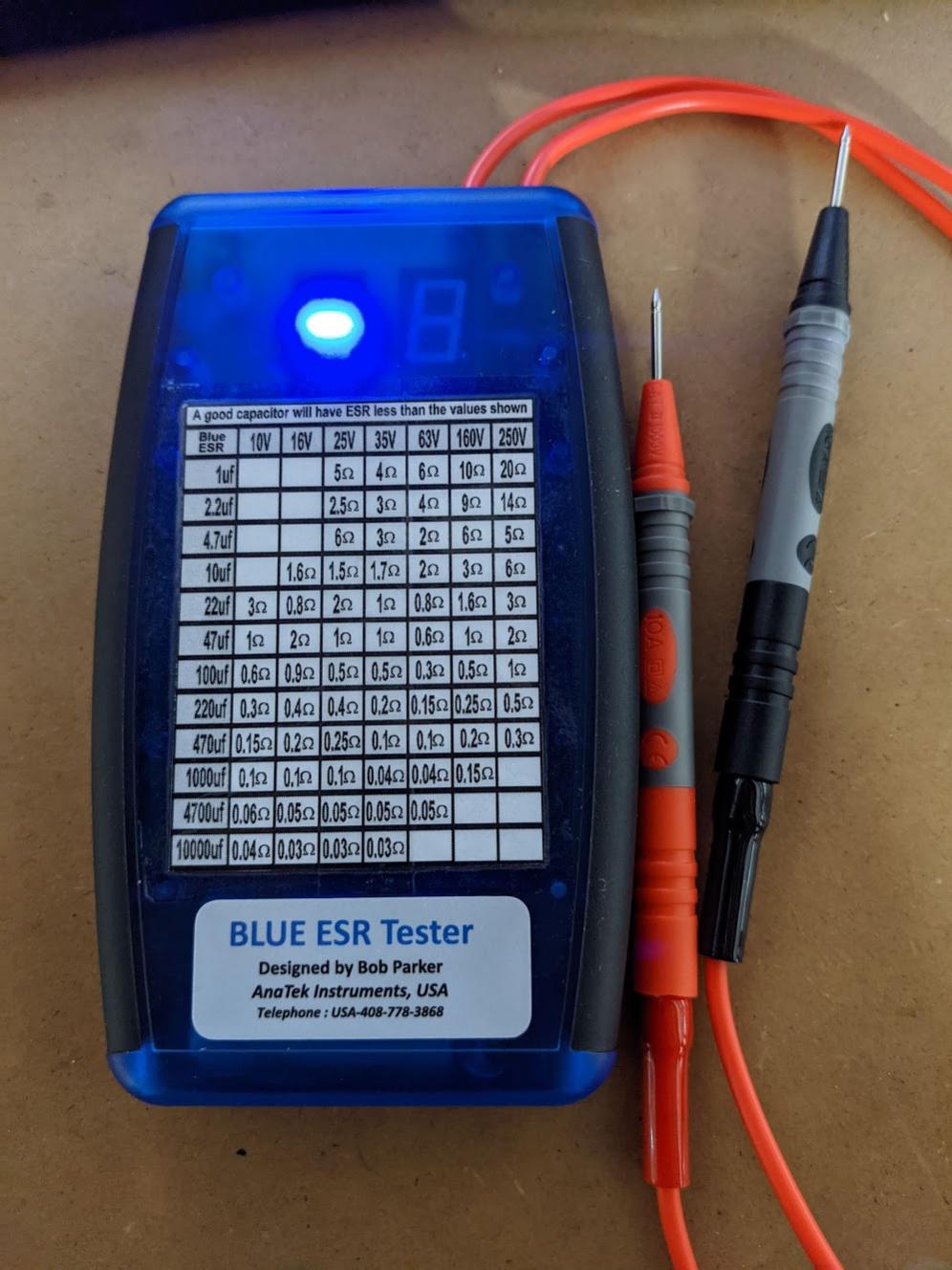

          I kinda made one from the old Bob Parker meter.
          Thanks for the printout. Doesn't look as "professional" as the original but 10 times more useful.

            Re: Finally built the Bob Parker "Blue" ESR Meter
            Glad to help... looks more professional in color. lol
            I know i love mine now!
              I should have printed it out at work on our $3000 copier instead of my monochrome $80 home laser printer. It looks good enough and I didn't use sticker paper either. I was just really careful with packing tape and used a razor to trim the excess.

                Interesting the "old" table seems to include some compensation to limited testing frequency, but the "new" graphs do not...
                  Looks Good Enough to do the job jayjr !
                  Everybody can use it if you want. Its not to fancy but it works!
                  I remember typing the omega / ohm symbol was a pain for me!
                  The colors just looked kinda cool. I saw similar on the net and they got added at the end.
