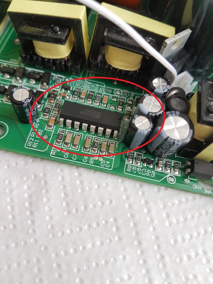

    Hi!
    I tried to desolder through I had IC that I wanted to replace but failed. And now I came here to learn what's the correct way for doing this. I tried to use soldering wick but the capillary force kept solder in the hole. With soldering wick I only managed to remove the part of solder that was outside the hole. But the solder that was inside the hole never got out. And of course when I moved on to next pin the solder in previous hole hardened again so no matter how many times I did all the pins there was still solder in holes.
    Question 1: what would have been correct way of desoldering this IC?
    Question 2: I tried to pull the IC with pliers while heating the pins from the other side but it did not help either. And as a result, I now have some pins stuck in hole together with solder that came off from IC when I pulled it. what would be correct way to remove these?
    Also attached here the image of IC (taken before desoldering attempt)

    Re: How to correctly desolder through hole IC?
    Ok
    It depends on if you want to spend some money or not
    If want to spend some money then buy a Desoldering Gun with a vacuum pump style
    If you do not want to spend very much money at all use a good quality solder wick with some flux
    Either one will work but you if you choose the second option you should have a temperature controlled soldering iron at a minimum 60 watt would be preferred but could get by with a 40 watt iron but you will have to be some what patient with this but you can stay on a one soldering joint for a real long time because you could have have the pads lift off the board
      most wick is pretty crap unless you add flux to it first.
      if you dont want the chip, cut each leg and then pull them out with tweezers while melting the solder.
              you should get a solder sucker .. it should almost fall out after using one .
              sometimes you need to add new solder to get the old solder to melt to remove it .

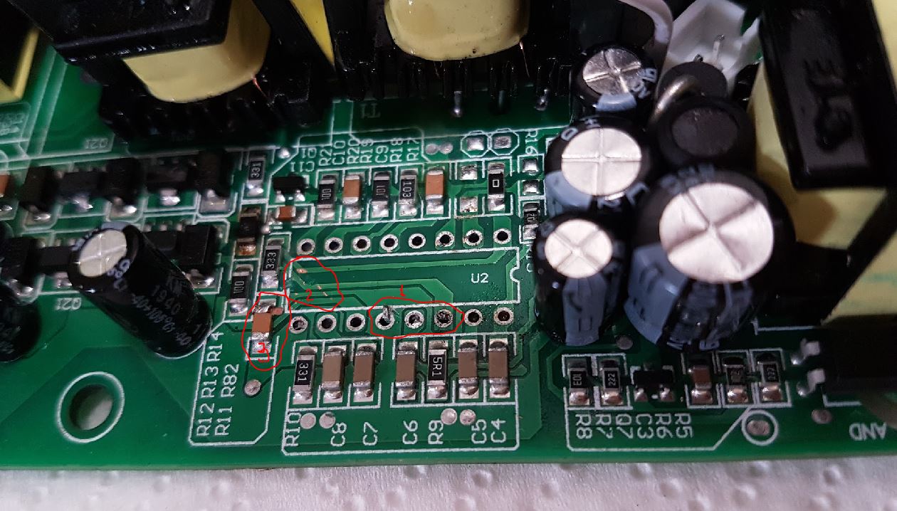

              • LearningToRepair
                • Jul 2020
                • 35
                Thanks,
                I will try out solder sucker. Meanwhile I have few more questions:
                1) Will solder sucker also getrid of broken legs in holes or is it only useful for future desolderings?
                2) Do scratched traces (see attached image) need some sort of treatment?
                3) If I managed to break one piece off of smd ceramic capacitor would I have to replace it and if yes then what would be the voltage rating (see attached image), I read from the internet that it is ok to replace it with capacitor with larger voltage rating, but is there any limit how much higher voltage rating capacitor can I use, for example if original capacitor were rated for 5V and and new one were rated for 500V, would it become a problem or would it be fine as long as capacitance is close enough?

                  you could heat those broke pins and pull out whilst iron still on it .
                    Since you got the IC remove, you should check that you still have connection between the top side and the bottom side of the board of each hole, just need to make sure the through-hole plating are not damaged.
                    500V rating cap will be so much Bigger size than 5V cap, you also need to use the same type of cap. Are you talking about MLC Capacitor?
                    BTW, you should use good IC socket so If you have to replace the IC again, it will be easier to replace the IC.

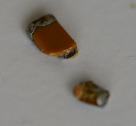

                      The capacitor I am talking about is the yellow one on the picture I attached to my previous post. Not exactly sure if it is MLC.
                        Yup, it's MLC.
                        What's the part number on the IC?
                        Looks like KA3525A from the picture, if I'm not mistaken.
                        Knowing what the IC is and finding its datasheet are the first two things to help determine the cap value. A lot of times, the circuit on the PCB may closely resemble an application circuit in the datasheet. This can help you find the value of that capacitor... or at least a ball park.
                        That aside, any reason for changing out this IC? If this is for troubleshooting a PSU, a lot of time, the IC is not the issue - at least not if it's just a PWM driver or voltage monitor. If it is one of those offline PWM-FETs/ICs, then those do actually go bad somewhat more often.
                        *EDIT II*
                        Looks like the cracked MLC is connected to pin 9 (and maybe ground - please check.) That's a signal IC pin, so probably a 16V-rated or higher MLC will do. As for the capacitance, I think that will depend on the circuit design, since it's connected to the inverting input of the PWM comparator. The test circuit in the datasheet suggests 10 nF. But again, that may not be the value that's in your circuit. It does give you an idea for a ball park, though (i.e. it's probably not over 1 uF and probably not lower than 1 nF... but that's still a huge range to guess.)
                        If you have a cap meter or capacitance measure setting on your multimeter, you can test that MLC (out of circuit.) If it reads open or infinite capacitance, it's probably bad. If it does show a good standard capacitance value, it's probably OK and you can leave it back in.
                                    Originally posted by momaka
                                    *EDIT II*
                                    Yes, It goes to pin nr 9. When I took it out of circuit I was unable to get any reading. I think it was because the other side was broken off. Just asking to be sure: can I be confident that this is capacitor or are there also other components that are yellow like that?
                                    I would also like to know where you got 10 nF? Did you use this datasheet?
                                    page 5? It doesnt have any units. Is it default to assume that numbers are in uF and therefore 0.01 uF = 10 nF?
                                    Local hardware store sells 10nF*50V X7R 10% SMD 0805 is it good enough? Sadly they dont have any other info than just product name. Also what does MLC exactly mean? If my local store lists this as SMD capacitor, are they same thing or different?
                                    Here is also macro photo of after removing it from the board in case it helps.
                                      MLCC = Multi Layer Ceramic Capacitor.
                                      Take caution when handling them, check the resistance after you install the cap to make sure it is not damaged and shorted out due to mis-handling.
                                      Read the PDF attached.
