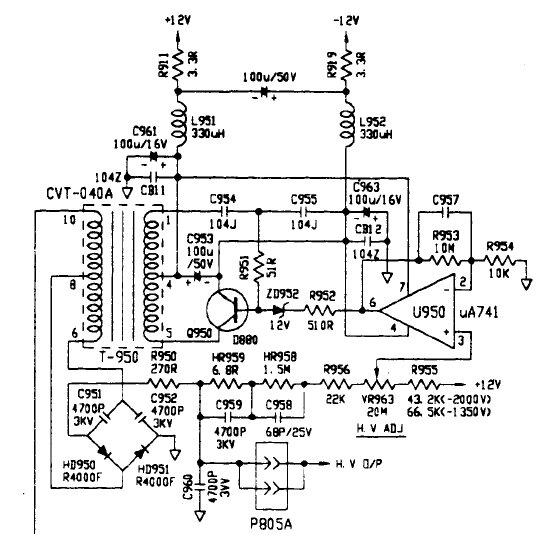

                      Hi All
                      I'm new to the forum and wonder if you could please help.
                      I have the same oscilloscope although re-branded as "Toptronic" that is dead, with very similar faults. (mine is the 20mhz version)
                      I had used the scope quite a bit, it then went on the blink and I managed to get it working by replacing U950 (741) and the D880 for the HV transformer. it worked for a while before dying again. This time after replace the same components it hasn't helped. I've also noticed that it started to arc on the board near the output from the HV transformer, I cleaned it up and sealed the board.
                      After changing all the components I find that the D880 (HV transformer driver) gets extremely hot, to a point where it actually melts the insulating washer. I assume that the D880 is not oscillolating?
                      The CRT has a very slight orange glow in a dark room, but I think this could be the heater? as it even glows with the D880 (for the HV transformer) removed off the board.
                      Any Help would be greatly appreciated! as I don't have money for another scope.
                      I've also tried to download the schematic from the previous posts, but comes up with an error. I've managed to find the user manual, but it only has a block diagram at the end.
                      Thanks in advance!
                      Justin

                            Ok, so it appear the transformer is toast!
                            So now to try have have it re-wound.

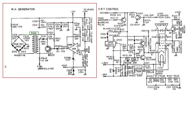

                            • monpirri
                              • 8
                              #74
                              Re: Oscilloscope CRT problem
                              Well i had the same problem with a 2120 ,now is a door stopper.
                              The HV output transformer (CVT T502 :063-016-9-001) got shorted and then it lost its 2kv volts.
                              Re-wound didn't work as secondary has a very special isolated wire very hard to find .
                              I sent an email to B&K and they don't give a supplier nor replacement.
                              Guess the best choice is to find a non working one as a source of parts .

                                  #76
                                  The SCH that MONPIRRI shows is a simple Self Oscillating with the OP Amp driving it to regulate the 2kvdc output, the rectifier section is the Voltage Doubler circuits, so the output voltage from the secondary may be about 700VAC, once it goes through the Voltage doubler circuits and charge up the filter cap to the peak voltage, you will get around 2KVDC output, I estimate the output current may be up to 5ma. You can use the flyback transfromer but you need to regulate the output using the circuits to do that.

                                      #78
                                      here is the schematic of the exact power unit. I would imagine the same would apply for the "voltage doubler"?
                                      So if I turned a new transformer I would need to calculate its output to be about 700V, perhaps 800V for safety, as the voltage reg system should drop it if required?
                                      Is a TV flyback not an option?

                                        #79
                                        A TV Flyback would be far too high voltage wouldn't it? That's even if you got an old one without the tripler inbuilt.
                                        -David VanHorn
                                          #80
                                          You just have to drop the driving voltage on the primary winding.
