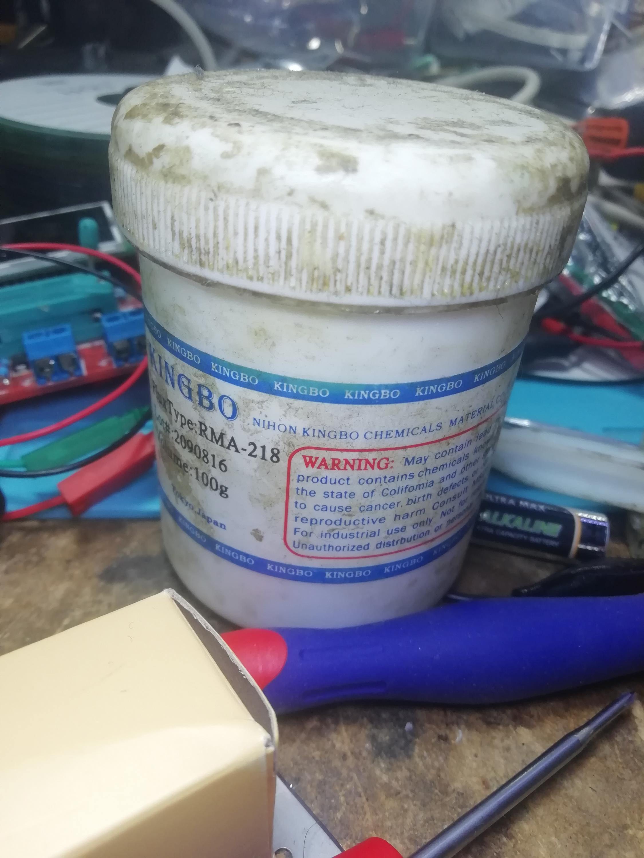

To me, and this is just my own personal opinion, a good way to gauge the quality of flux is to see how long it remains liquid under the hot air nozzle. As I explained in my original post, I always find the flux burning out before my part is properly soldered and it gets stuck because it's got nothing left to flow in.Wattevah...Comment

So now I have three bits of organic-compound flux...
one is as above, orange sherbet (estimate 35 grams) (sort of smells like rosin)
another looks like brown sugar paste, but seems like it has fats in it (estimate 10 grams) (kind of smells like rosin)
third looks like dried but not crystallized coffee (estimate 10 grams) (nasty smelling)
The fourth tub I have is clearly inorganic acid flux and is white ZnCl for pipes. Doesn't have any strong odor though it does have a glycerin like carrier so that it's a paste instead of solid.
I need to get some honey flux to try out... and whether or not I can use up all this flux.Last edited by eccerr0r; 05-24-2019, 11:31 AM.Comment

If possible, I hit the chip in question with my iron and lead-free solder....if it's a QFN and you can't get under it, that's a whole different story and I get around that by cranking up the tempWattevah...Comment

You can use a brush or implement to apply it but I prefer the cleanliness of a syringe and large needle.
Supposed to be no clean but as it's generic tacky flux from who knows where I always clean as best i can using a 50/50 mix of IPA and acetone.Comment

Sure is. Mine is about 3 years old and has the same Lot# as half of those sold today. It's like a copy of a copy of a copy. A bit pot luck how good it is, some stays thick longer than others.Comment
