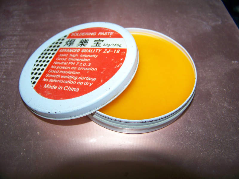

      Originally posted by stj
      flux absorbs moisture, so lifespan depends on how you store it.
      btw, i like this - try it.
      https://www.aliexpress.com/item/UANM...864986454.html
      I have this, and don't think it works that well. Comparing it to the flux that's inside Kester 44 solder, it doesn't help solders stick as well. I still use some anyway in hopes it helps a little, at the very least it does prevent additional oxidation as it coats the surface.
      Is this fake cheap chinese clone flux?
        • 30977
        Re: Does flux expire ?? Flux discussion.
        that's strange, not only is it not translucent from what i can see, the inside of the tin is painted too.
        my original stuff the inside of the tin is not painted.
        also, your tin has 2 sizes printed on it????????
        • eccerr0r
          Solder Sloth
          • Nov 2012
          • 8694
          Yeah they painted the inside of the tin as well, an extra cost. And yes it's waxy and not translucent. It's very soft, softer than wax. And yes two sizes, I suspect that it depends on how much was put into the tin.
          Very weird that they have the same typos, minus "made in china" and that one japanese character instead of the chinese character...
          Sigh... more knock offs...
                Maybe they use the same lid for a shallow and a deep tin?
                  True, could be the same label used for more than one container too...
