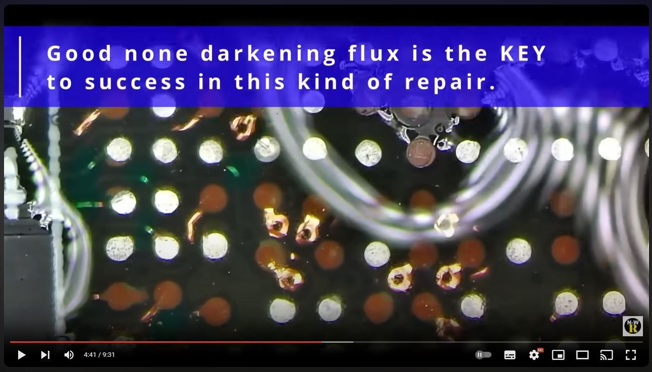

Non darkening Flux?
  • tony359
    • Oct 2018
    • 266
    • United Kingdom
    Non darkening Flux?
    I was watching a video from NorthWest Repair (The guy there is just doing such incredible repairs) and while he was fixing a bunch of pads on a GPU PCB, I saw this
    I've been trying to fix some broken traces on a PS3 CPU for a while but one major issue I'm seeing with my AMTECH flux is that it gets tacky and dark very quickly and then it's a pain to remove and replace.
    In the video Tony (I think it's his name) seems to suggest that I am just using the wrong flux?
    Any thoughts or ideas?
    Full video is here: https://www.youtube.com/watch?v=XYHeetEZcSg
    Thank you!
    • 31304
    hmmm....
    flux gets dark either because your burning it or because it's picking up crap off the board.
    maybe tell us your temps?
    also different fluxes have different content.
    oldschool fluxes have Rosin (pine sap) in them and look a bit brown to begin with.
    synthetics dont, and some are blends - like Stannol HS10 which is synthetic with added rosin.
    why did i mention that?
    because Rosin doesnt get along well with the elevated temperatures needed for working with lead-free solders
    • tony359
      • Oct 2018
      • 266
      • United Kingdom
      My iron is usually around 360. With tiny tips I might increase the temp as there is very little thermal mass at the tip.
        • 31304
        sounds o.k. - i solder at 350 and dont burn the flux
        • tony359
          • Oct 2018
          • 266
          • United Kingdom
          It doesn't burn, it gets a bit too thick and darkens a bit - the guy of the video is a sort of wizard, I don't know how he can do what he does so I take that suggestion seriously! From his (and others) videos I see that their flux stays much more fluid and clear than mine.

            Genuine Amtech flux ? Which one ?
            • tony359
              • Oct 2018
              • 266
              • United Kingdom
              Amtech 559
              • FZG
                • Sep 2022
                • 118
                I heard about fake Amtech 559 on several occasions. I have a syringe of 559 as well and I am not sure if it is actually genuine since it was rather cheap but it does what it is supposed to do and it does not get dark at 350°C soldering temperature.

                  • harp

                      I've noticed that Tony is mentioning the Stirri flux - I could try and give it a go but I also have the Amtech (original, not the chinese copycat) and that doesn't really work, at least as I'd expect.

                        That looks like you a burnt the flux by not having enough of on it, not the right soldering tip, low quality solder wick, too much heat and or a low wattage iron. And that is the exact result you get. Looks like you did all right to a certain point (cleanup). You may have forgotten to clean the old flux between the take off and the cleanup. Having the right tools and procedure = success. And some parts you just can’t cheap out.

                          Kingbo RMA-218,ChipQuik SMD291,NC191

                                I've used the Kingbo 218 for a while. At some point the product changed and became much worse with a horrible "chemical" smell.
                                I did some research and.. well, I cannot find a "Kingbo" manufacturer. So it looks like it's a random name and every seller is sticking whatever they want in those tubes! So "Kingbo-218" is like Aliexpress "Amtech 559" - it might be good but it depends on the seller and not the product.
                                About the Stirri, I cannot find that info on the datasheet - but Aliencomputres recommends the Kingbo which simply does not exist so...
                                https://cdn.shopify.com/s/files/1/06...f?v=1721712131
                                At the time of writing, the "Kingbo" sold by the seller "Riesba" on Aliexpress is not bad. It smells ok-ish and works much better than the average fake "Amtech". I do have genuine Amtech as well so I know how flux should work

                                    flux is stirri
                                    VS-UHF-TF

                                        What are the chances that I've just ordered some VS-UHF-TF!
                                        NWR has reviewed NRF's flux and Tony there also mentioned that his non-darkening flux of choice is indeed VS-UHF-TF. https://www.youtube.com/watch?v=q1KDWTSsEjo
                                        NF.Flux is apparently good but not magical. Alex is just very good at selling stuff!
