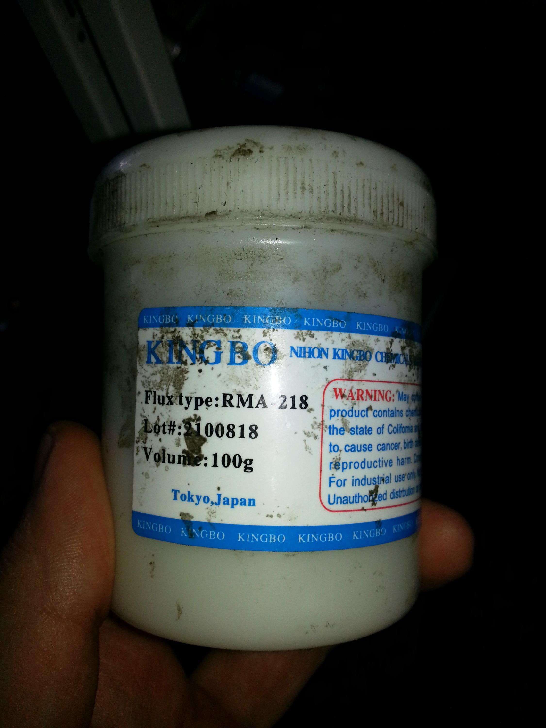

Does flux expire ?? Flux discussion.
  • eccerr0r
    replied
    Re: Does flux expire ?? Flux discussion.
    I would guess the animal fat based fluxes could expire when they go rancid (but even then...). Now how about fully hydrogenated shortening instead...?
    Leave a comment:
    replied
    Re: Does flux expire ?? Flux discussion.
    Originally posted by clearchris View Post
    Can confirm momaka's experience with kingbo. It has darkened, especially where I dip the tip in. When new, it was a light cream color. Still seems to work just fine. It does smoke a lot, I hold my breath when soldering anyway, helps to keep the hands steady. I used to seal it after using and it stayed the same color, but it has spent the past three years open on my bench.
    Well, I keep mine closed and have never dipped my iron's tip in it, but it still went dark. I'm thinking it has more to do reaction to UV light. Although I keep my flux away from direct sunlight for the most part, I do have a ton of natural light (big North-facing bay window) on my workbench area, which is where the flux is.
    And yes, I try to hold my breath too when using large amounts of Kingbo. Though, I usually apply very very little - about the size of a tiny beach sand grain (or two) per joint, which turns out to be just enough. Any less, and I get cold-looking joints. Any more, and I have to do more clean up. Speaking of which...
    Originally posted by clearchris View Post
    The only way the residue will come off is with brake cleaner in my experience.
    I use 99.9% IPA, and the Kingbo flux comes off fine. Only time I've had problems removing it is if I burned it onto the board to a crisp. But in that case, I just chip it off.
    Originally posted by Dannyx
    I too noticed the kingbo flux I pictured below smokes a LOT - Mr G. let me use some once when I quickly needed to desolder something at his table and I dipped the wick in it to make it more absorbent and it smoked so much that I couldn't see what I was doing and choked on the smoke.
    Oh man, I've seen a rookie tech do that before, and it was so funny! The smoke made him think the board must have caught fire or something, so he dropped the iron and the wick and jumped back. Made me laugh seeing it. Almost had a hard time convincing him this was actually normal... at least for the amount of flux he was using (which was too much!) If you have to flux wick, do it with a brush and apply little. Or use a tootpick and spread a rice grain -sized or smaller piece of flux.
    Leave a comment:
  • clearchris
    replied
    Re: Does flux expire ?? Flux discussion.
    Can confirm momaka's experience with kingbo. It has darkened, especially where I dip the tip in. When new, it was a light cream color. Still seems to work just fine. It does smoke a lot, I hold my breath when soldering anyway, helps to keep the hands steady. I used to seal it after using and it stayed the same color, but it has spent the past three years open on my bench.
    The only way the residue will come off is with brake cleaner in my experience. Must be careful about that stuff, the cleaner must be completely gone before soldering.
    Leave a comment:
  • diif
    replied
    Re: Does flux expire ?? Flux discussion.
    The air speed is too high if you're blowing away other parts.
    Leave a comment:
  • Dannyx
    replied
    Re: Does flux expire ?? Flux discussion.
    True, though I did turn it way down because of this reason. Not to mention, it also tends to blow away the part you're working on as well, plus other smaller ones around it, quickly turning a 5 minute repair job into a 1 hour nightmare....
    Leave a comment:
  • zhang
    replied
    Re: Does flux expire ?? Flux discussion.
    Could it be hot air settings?
    if the "air" is too high, when the fluxes melted it will go everywhere but the "place you want to melt"
    Leave a comment:
  • Dannyx
    replied
    Re: Does flux expire ?? Flux discussion.
    Originally posted by momaka View Post
    Now it's piss-yellow (the kind of yellow urine you get after not drinking enough water and eating salty shit all day.)
    ROFL ! I think I just spat my drink all over the laptop - liquid damage !
    Ok, so it wasn't the flux that was bad after all, it was just me who sucked on those QFNs back there
    I too noticed the kingbo flux I pictured below smokes a LOT - Mr G. let me use some once when I quickly needed to desolder something at his table and I dipped the wick in it to make it more absorbent and it smoked so much that I couldn't see what I was doing and choked on the smoke. Then again, he keeps his iron turned all the way up, so it was probably REALLY hot...
    Leave a comment:
    replied
    Re: Does flux expire ?? Flux discussion.
    Originally posted by diif View Post
    Sure is. Mine is about 3 years old and has the same Lot# as half of those sold today. It's like a copy of a copy of a copy. A bit pot luck how good it is, some stays thick longer than others.
    Yup.
    Apparently, Kingbo is just another generic Chinese RMA flux, so the quality will vary. But from what I've seen myself and heard from others so far, it's anywhere from acceptably working to very decent. So it's not junk / terrible, typically.
    My jar is about 7 years old now. It used to be light tan when it was new. Now it's piss-yellow (the kind of yellow urine you get after not drinking enough water and eating salty shit all day.) It still works, though. Just seems to smoke a lot more and definitely smells worse. Also doesn't seem to stay active for as long at high temperatures / gunks up faster. But like I said, it still works okay, more or less.
    So I wouldn't say flux expires - especially rosin fluxes. But in the case of my Kingbo, it did drop down a bit of its stability at high temperature, it seems. And in the case of rosin fluxes... well, those could dry up due to the alcohol evaporating from them - but that's usually fixable by adding more alcohol.
    Last edited by momaka; 06-15-2019, 08:39 PM.
    Leave a comment:
  • Dannyx
    replied
    Re: Does flux expire ?? Flux discussion.
    Originally posted by stj View Post
    i wouldnt go over 350 with flux of any type.
    it is pretty crap though, i only use mine for tinning old wires
    The temperature on the display is probably considerably off compared to the actual temperature at the tip, so I prefer to keep it a bit higher, knowing the tip is going to be colder anyway. Besides, I mostly go by feel rather than numbers and I sometimes found that not enough heat can lead to poor/frustrating results just as well as TOO MUCH heat....
    Leave a comment:
    replied
    Re: Does flux expire ?? Flux discussion.
    i wouldnt go over 350 with flux of any type.
    it is pretty crap though, i only use mine for tinning old wires
    Leave a comment:
  • Dannyx
    replied
    Re: Does flux expire ?? Flux discussion.
    Remember that can of polish flux ? The one I said I had no idea what it was called because the sticker was on the bottom ? Gave it a whirl today and it was....meh. I had to reflow some connections on a QFP and a USB mini-B connector. It went...mediocre at best: solder blobs everywhere and the flux seemed to dry rather quickly. The tip I used was the bevel one (slanted) and it seem to go worse than the T-IS (curved) one, so I ended up using that one instead and I kept adding flux and wicking around until I managed to get somewhat acceptable results, but it wasn't fast and not exactly professional....a pro tech would not be impressed with the time it took me to reflow those....
    The tips and temperature also seem to play a role. I ended up dialing down the temp from 420C to around 390C (on the display at least) on my Gordak because the tip was starting to get gray and looked burnt and charred, so solder wasn't sticking to it and was instead blobbing on my pins instead . Lowering the temperature allowed it to stay shiny a bit longer and I got somewhat more acceptable results, but STILL had to wick around more than I would like....or perhaps that's not a bad thing.
    Last edited by Dannyx; 06-14-2019, 07:18 AM.
    Leave a comment:
  • eccerr0r
    replied
    Re: Does flux expire ?? Flux discussion.
    Coliformia is the state made of colifony of course <BOOO! HISS!>
    Leave a comment:
  • diif
    replied
    Re: Does flux expire ?? Flux discussion.
    Originally posted by RJARRRPCGP View Post
    Is that a counterfeit flux?
    Sure is. Mine is about 3 years old and has the same Lot# as half of those sold today. It's like a copy of a copy of a copy. A bit pot luck how good it is, some stays thick longer than others.
    Leave a comment:
  • RJARRRPCGP
    replied
    Re: Does flux expire ?? Flux discussion.
    Originally posted by stj View Post
    coliformia
    Is that a counterfeit flux?
    Leave a comment:
  • diif
    replied
    Re: Does flux expire ?? Flux discussion.
    Originally posted by sam_sam_sam View Post
    What is the correct way use this flux
    Because I just bought some
    I use rosin core solder 60/40 for most everything
    I have tried the no lead solder before
    I have a spool of it and hate it because the soldering joints look like shit and very hard to use and it does not matter what temperature setting I use
    I can not remember whether or not it is the the no clean type of solder or not
    I have some Kingbo flux. I used it before I discovered Amtech 599.
    You can use a brush or implement to apply it but I prefer the cleanliness of a syringe and large needle.
    Supposed to be no clean but as it's generic tacky flux from who knows where I always clean as best i can using a 50/50 mix of IPA and acetone.
    Leave a comment:
  • eccerr0r
    replied
    Re: Does flux expire ?? Flux discussion.
    Originally posted by Dannyx View Post
    ANY form of soldering should be done with a fume extractor as far as I'm concerned
    What if you're using lard/bacon fat as flux?
    Leave a comment:
    replied
    Re: Does flux expire ?? Flux discussion.
    Originally posted by Dannyx View Post
    THIS is the flux Mr. G uses for reballing (and just about everything else, including tinning wires)....the state of the container is an accurate representation of this whole place
    What is the correct way use this flux
    Because I just bought some
    I use rosin core solder 60/40 for most everything
    I have tried the no lead solder before
    I have a spool of it and hate it because the soldering joints look like shit and very hard to use and it does not matter what temperature setting I use
    I can not remember whether or not it is the the no clean type of solder or not
    Last edited by sam_sam_sam; 06-09-2019, 07:24 AM.
    Leave a comment:
  • Dannyx
    replied
    Re: Does flux expire ?? Flux discussion.
    ANY form of soldering should be done with a fume extractor as far as I'm concerned ...and it could be implemented relatively easily here given the layout of the room and the workbenches, but if I showed you the state of ANY workbench here, ideas like that would immediately be confined to the "dreams" category...
    Leave a comment:
    replied
    Re: Does flux expire ?? Flux discussion.
    "known in the state of coliformia to cause cancer"??
    the thing that concerns me is kingbo is known to need a fume extractor or it will try to do a "white helmets" job on you!
    Leave a comment:
  • Dannyx
    replied
    Re: Does flux expire ?? Flux discussion.
    THIS is the flux Mr. G uses for reballing (and just about everything else, including tinning wires)....the state of the container is an accurate representation of this whole place
    Leave a comment:
