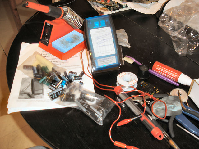

    I've finally bought my first ESR meter kit. Wish me luck.
    Parts
    Front
    Back reads "Bob... Dec '07" lol
    Please note PCB images are for my reference.
    Does an idiot make a sound if no one’s there to hear them talk?

    Luck has very little to do with it. This kit can be assembled by anyone willing to follow directions (assuming all parts are there).

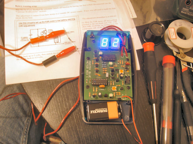

      I'm done building the meter, but I have 4 silver clips leftover. Any ideas what these are for?
      • PlainBill
        • Feb 2009
        • 7034
        Re: ANATEK Blue ESR Meter REV 1 PCB first build. Tips and component upgrade suggestions..
        The case is a marvel of multifunctionality. With those four clips the battery compartment becomes a battery holder for 2 AA cells.

          Thanks Bill for the update ((no extra parts) = (a good build))...
          Anyone know why I'm having to zero the meter out every time I power up?
          • Toasty
            • Jul 2007
            • 4171
            >>Anyone know why I'm having to zero the meter out every time I power up?<<
            'cuz that's the way it is.
            If you were to use longer or shorter leads, change tips, use probes instead of clips etc., the meter is so sensitive to low ohm changes that if not zeroed, you'd have false or bad readings. Simply moving along a trace on a PCB will register changes.
            Toast

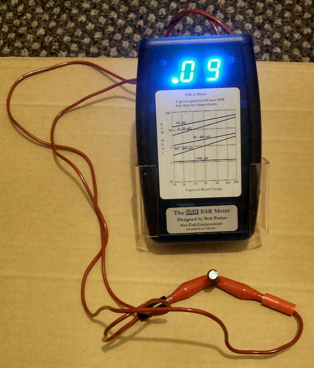

                I just got mine yesterday and put it together in a couple of hours. I was going to post pictures but it looks just like yours! Enjoy!
                Why throw it away? I might need it in the next 40 years. Duh!

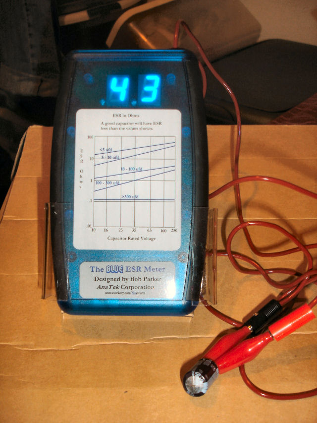

                  Here are a few pics of the completed Blue ESR meter and my work bench / kitchen table. =)

                    Well done! Looks nice. I hope it will give you years of faster electronic repairs.
