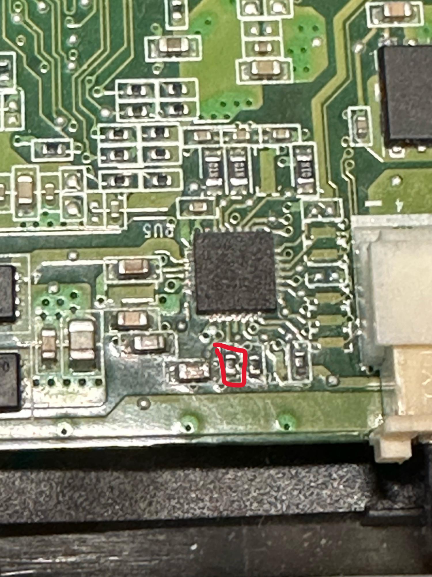

              Re: Acer Aspire E5-574G - Not Powering On
              After reading the Piernov's guide a hundredth time today, found a fault in one of my previous readings and would like to correct it. Re-did all my tests again. I think I have found a faulty resistor. In my comment 1, I said the following:
              "1) (CMSRC) PR166: Resistance = ~4K. Resistance value is correct. Voltage on Pin 1 = ~0V, Pin 2 = ~0V. Both voltages are incorrect and should be 19V."
              This statement is not true. PR166 and PR165 are so close to one another that I got the PR 166 reading wrong. My apologies for the mistake. Below is the correct reading.
              (CMSRC PR166: Resistance = ~ 0.5 ohms. This is incorrect. Correct Resistance should be 4K. And it beeps in continuity mode while PR165 doesn't.
              According to Peirnov's guide (2.1.7. Damaged passive component), "One possible issue would be the gate resistors for the DC-in MOSFET, as well as the resistor connected to CMSRC pin when it is present, so you can always check them if you're in doubt."
              This is exactly what is happening here. PR165 which is the gate resistors for the DC-in MOSFET with one side connected to ACDRV pin is showing the correct resistance of 4K. But PR166, the resistor connected to CMSRC pin is showing a wrong resistance of ~0.5 ohms. Looks like the main rail is shorted because of this resistor.
              I'm not saying this is the only problem there could be other issues as well. But to get to those issues, PR166 has to be fixed first.
              Before I ask further questions and check all inductors, should I replace PR166 first. If so from where can I buy a 4K resistor? Is this the same as "0402" resistor. I see some links on amazon. Please let me know and I will proceed accordingly.
                My friend, you're making wrong conclusion because of missing knowledge and missing experience.
                There is no way PR166 could cause a shorted main power rail since it has no natural connection to GND. Also a resistor almost never fails shorted. They fail open. So I have to strongly doubt about your measurement, maybe even about whether you're measured the correct resistor. Sometimes it is hard to differentiate between the various resistors on the same rail.

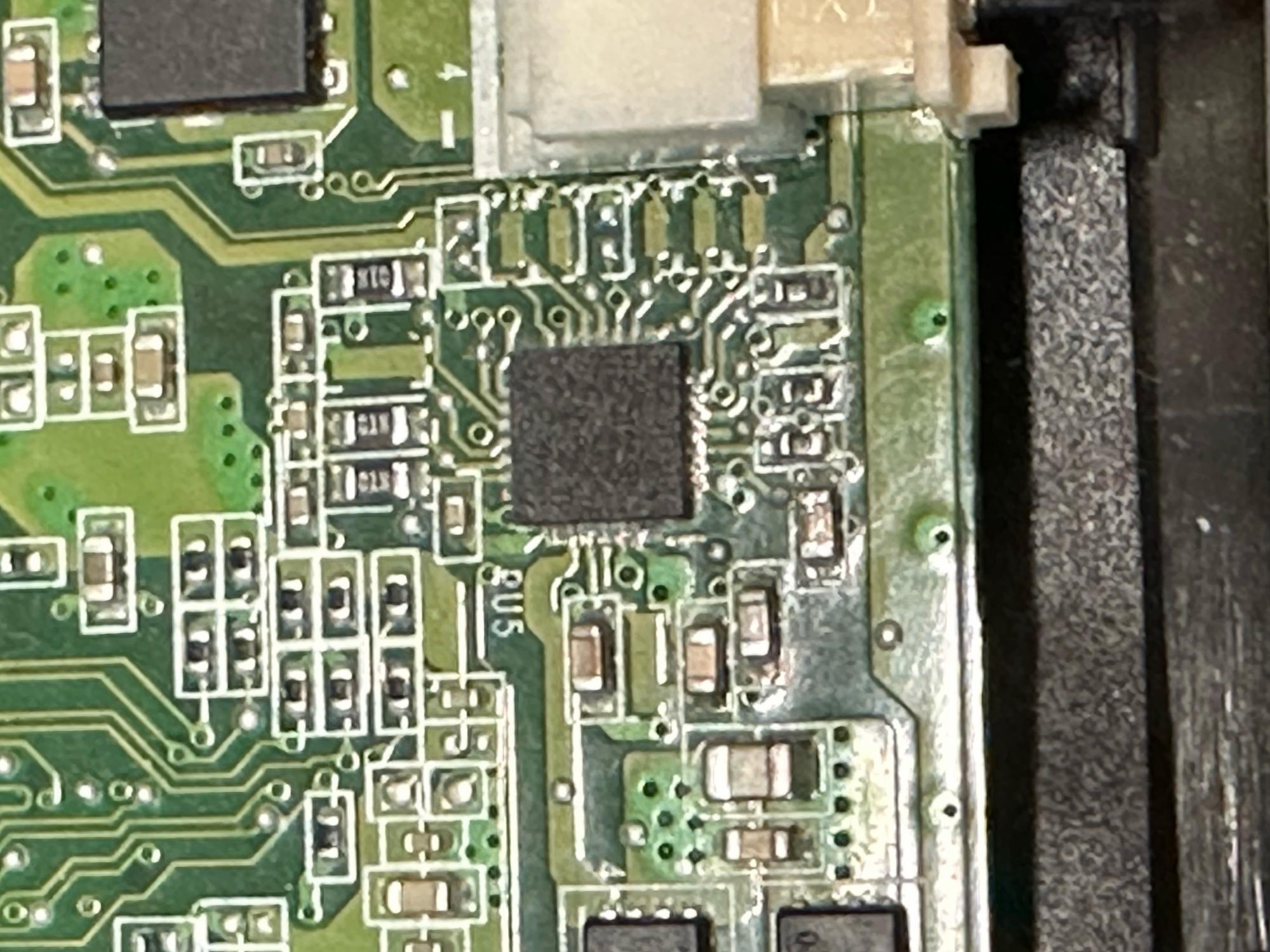

                  That is very true. I'm definitely not knowledgeable and missing experience. That’s why I came here, and am willing to learn and give it a shot. One of the reasons I bought the practice board, and spent time learning the schematic.
                  I understand your point and used the wrong technical terminology. Thanks for the correction. It might not be called a shorted main power rail but I'm positive that resistor PR166 is showing a wrong value. I wore much bigger lens and re-tested everything again before posting this comment. I can confirm two things:
                  1) With the multi meter in Resistance mode, PR166 still reads !0.5 ohms, and PR165 reads 4K ohms. All other readings (voltages and resistances) are also the same as in comment 1
                  2) With the multi meter in Continuity mode, PR166 beeps, and PR165 does not beep and says 0L.
                  To be precise, I performed the above tests by putting the black probe on end of the resistor and the red probe on the other end of the resistor. Maybe I'm doing something incorrect here.
                  I have attached 2 pictures. They both are the same pics and lighting is pretty good. But in Pic 1 I have pointed out PR166 with a box in red paint. You can see the below in Pic1.
                  On the left side of PR166 is PC115. Below PC115 is PC116, PC119, and PC122. All of them are horizontal.
                  On the right side of it is PR165. Next to PR165 is PR168. Both of them are vertical. You can see there is no PR167 between PR165 and PR168 like I pointed out in comment 1. Next to PR168 is PJ2 (Power Jack). You can see the slight white plastic in the picture.
                  I think Piernov’s guide point still holds true for this case that one of the possible issues is the resistor connected to CMSRC pin when it is present. It appears that in this case it is present and is PR166. I’m not sure what the technical name is for that. From your earlier comment it looks it that possibly some other part is bad and that is why PR166 is showing a wrong value.
                  If you think that resistor is called something else and if that’s not what is wrong, please let me know what I’m missing and I’m willing to test that and proceed accordingly. Thank you.
                  • Sephir0th
                    • Oct 2020
                    • 1289
                    Okay, confirmation necessary: Lift PR166 from at least on pad of the PCB and perform the same measurement again.
                    My bet is that the Resistor out of circuit won't read 0 Ohms anymore other than the CMSRC Pin at the charging controller itself.
                    General rule if a resistor is in question is to test it out of circuit like explained above.

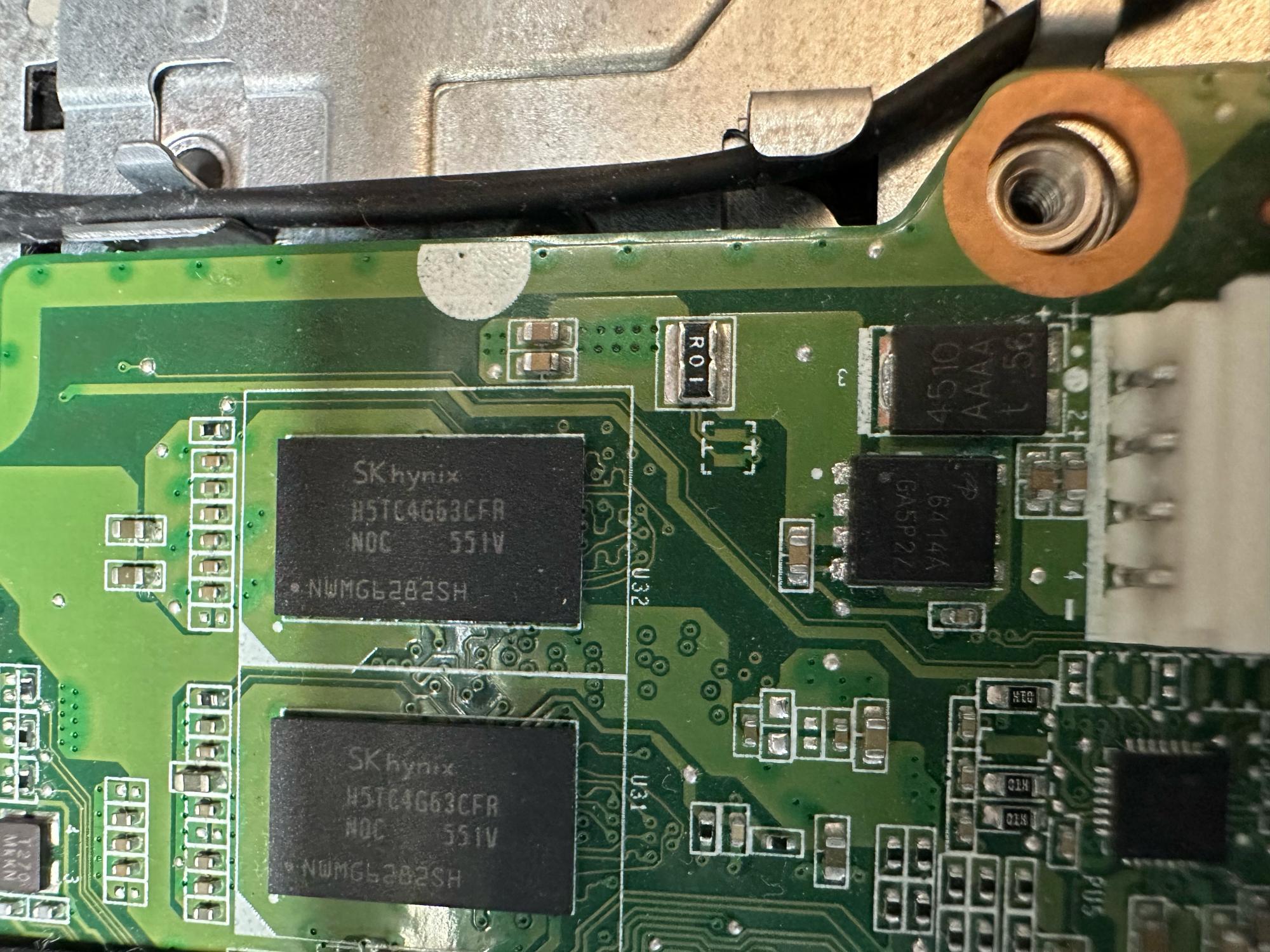

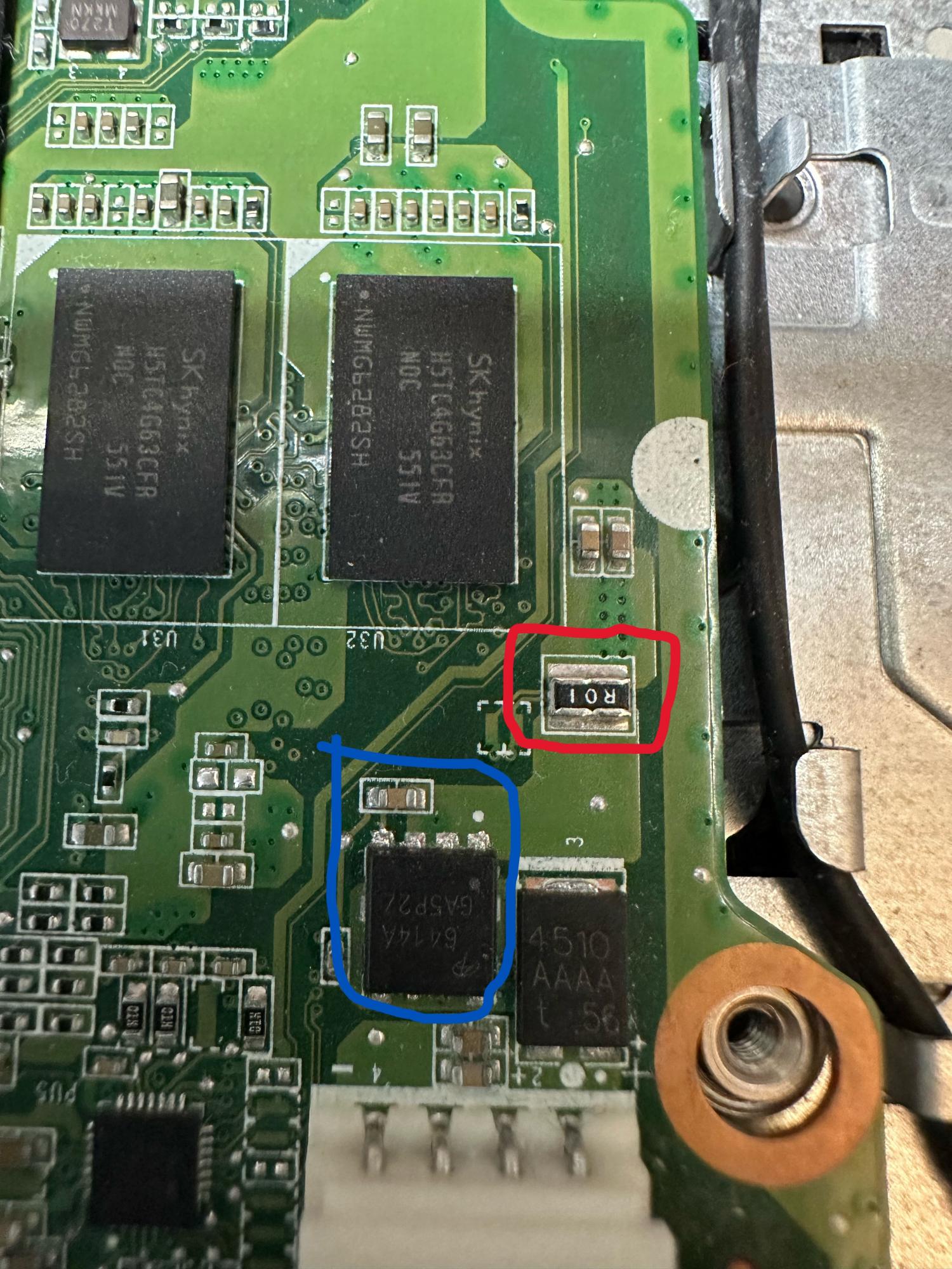

                        Thank you both for answering. Sephir0th I did not pull out PR166 yet because I agree with you that probably some other component is bad and probably there is short to ground on the main rail. I want to test more before I jump the gun.
                        So based on mcplslg123 advice I performed below tests on PR213, and some other components connected to the main power rail. I also attached a pic of PR213 for confirmation.
                        All of the below tests measure resistance to the ground on the main power rail. To be precise I did so with the multi meter in the resistance mode and touching the black probe to the ground, and touching the red probe one by one to the pins of below components. If I used the wrong terminology or performed the wrong tests please correct me, and I will redo all the tests again.
                        Touched the black probe to the ground and the red probe one by one to both ends of resistor PR213.
                        Resistance = ~0.5 ohms (Pin 1)
                        Resisatnce = ~0.5 ohms (Pin 2)
                        2) With the multi meter in Continuity mode, Pin 1 and Pin 2 both beep
                        I also performed the same tests on my spare practice board which also has PR213. In resistance mode, Resistance is in Mega Ohms (Fluctuates but stays in Mega ohms). Moreover in the continuity mode neither of the Pins 1 and 2 beep on the practice board.
                        Pic of PR213 is attached. Pic2 is the same but has the components I ran my tests on circled. I have circled all 3 components (PR213, PQ22, PC136) in Pic2. PR213 is in red square. PQ22 and PC136 are in blue square.
                        PR213 looks like a different kind of resistor and there are 3 letters on top of it "R01". Not sure if the last two are numbers zero and one or alphabets ‘O’ and ‘I’. Moreover from the Pic by looking at the left side of PR213, you can also see that PR209 and PR210 are not present on the board. You can also see MOSFET PQ22 on top of it with letters 6414A. Below PQ22 is a small capacitor called PC136.
                        It looks like I’m not getting any VA2. Another observation and I might be wrong here so you can correct me. This is the test to measure resistance and continuity on any Pin that gets VA2. From the schematic and board view below components get VA2.
                        1) MOSFET PQ22 on Pins 1, 2, 3
                        2) PC136 on Pin 1
                        3) PR213 on Pin 1
                        4) PR166 on Pin 1
                        With the multi meter in the resistance mode and touching the black probe to the ground, and touching the red probe to the pins of below components. Basically resistance to ground for these components.
                        1) PQ22:
                        Source Pins 1, 2, 3; Resistance = ~0.5 ohms to ~0.6 ohms.
                        Drain Pins 5, 6, 7, 8; Resistance is in Mega ohms (~0.85).
                        Gate Pin 4: Resistance = ~4 Kilo ohms.
                        2) PC136:
                        Pin 1, Resistance = ~0.6 ohms
                        Pin2, Resistance = ~4 Kilo ohms
                        With the multi meter in the continuity mode and touching the black probe to the ground, and touching the red probe to any Pin that is connected to VA2, the multi meter beeps. It does not beep on the other pins of those components.
                        MOSFET PQ22: Pins 1, 2, 3 beep but not others. Pins 1, 2, 3 are connected to VA2.
                        PC136: Pin 1 (VA2) beeps but Pin 2 doesn’t
                        PR166: Both Pins beep but Pin 1 is connected to VA2
                        As a note on the spare practice board, for components PQ22 and PC136 resistance on all Pins is in several Mega ohms, and on continuity mode all pins of PQ22 and PC136 don’t beep at all.
                        From Piernov’s guide point 2.1 (HPB Buck topology), I think in my case PQ22 is the “2nd DC-in MOSFET” and PR213 is the current sensing resistor. I’m not sure which one is correct, and what component is faulty as it could be any of the faults specified in 2.1.2 (Short to ground on main power rail), 2.1.3 (Shorted DC-in MOSFET), 2.1.4 or something else. Not sure which component is the problem PQ22, PC136, PR213 or something else. Does this tell you anything if the 19V rail I shorted or not.
                        If you think any of the above readings and explanation appear incorrect, I will redo all the tests. Please let me know how to proceed further. Thanks
                        • mcplslg123
                          • Jun 2015
                          • 7262
                          • india
                          Going by the resistance to GND reading on current sensing resistor PR213,you have +19V rail shorted to GND.
                          You need to de-solder PR213 and i'm sure pin2 of PR213 is shorted to GND. You need to inject 1V/5A on pin2 of PR213 with a dc supply and see what's getting hot. Ofcourse you need a dc supply/short killer to find the shorted component.
                          PS: No point troubleshooting any aspect unless you fix this +19V rail short.
