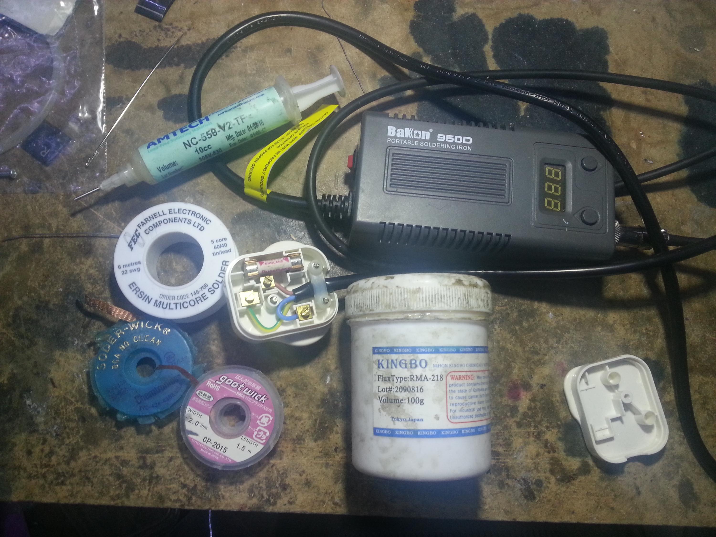

                                Re: Bakon BK950D
                                No adapter. As i said, cut off the non UK plug and stick a UK one on. It's three core that comes out of the Bakon.
                                Solder from RS, Chemtronics braid for BGA, Gootwick for smaller, Amtech 559 flux for important jobs, cheap Kingbo in a syringe for eveything else.
                                Photo of some of my bits including how to wire up a UK plug.

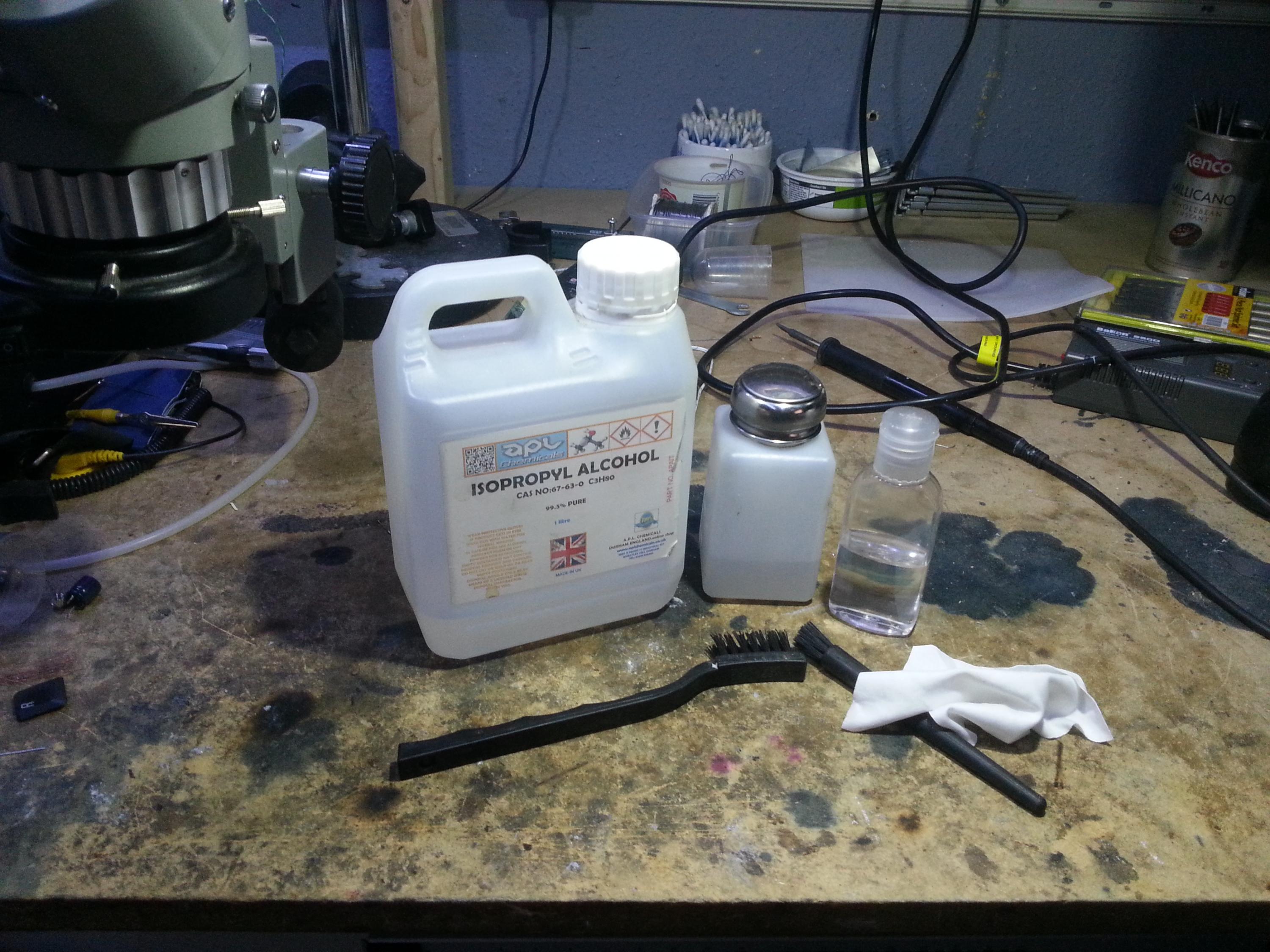

                                  How do you get rid of the flux on your items, how do you remove the flux off the motherboard.
                                  http://www.hse.gov.uk/pubns/indg305.pdf
                                  • diif
                                    • Feb 2014
                                    • 6978
                                    • England
                                    Re: Bakon BK950D
                                    IPA and a brush followed by a wipe with a clean room wipe.
