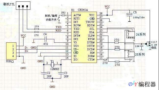

    First, I saw in a video that the pin numbers printed on the adapter board are incorrect (black model w/green adapter board). And pin 5 is supposed to be pin 1. Can anyone confirm this?
    Also, any documentation on what the jumper does? Comes default on pins 1-2.
      pcb marked "YFT246837" pin wiring is correct.
      the jumper switches between programming and usb2serial adapter.
      good for hooking up to serial pins in stuff like routers.

          pin1 on the adapter is printed and the pad is square.
          the socket on the programmer is used differently for 24series and 25series though.

              Hi Katfish, could you tell me anything about the right position of the adapter board onto the CH341A mini programmer? I've got the same model but in my case the card can read bios (MX25L1005) only with adapter rotated of 180 degrees, as you said... Could you help me? And I'd like to see the discussion video you referred to... Thanks in advance for answer.
              • diif
                • Feb 2014
                • 6978
                • England
                Re: CH341a - Questions
                You are correct. You need to rotate the adapter 180 degrees to the photo above.
