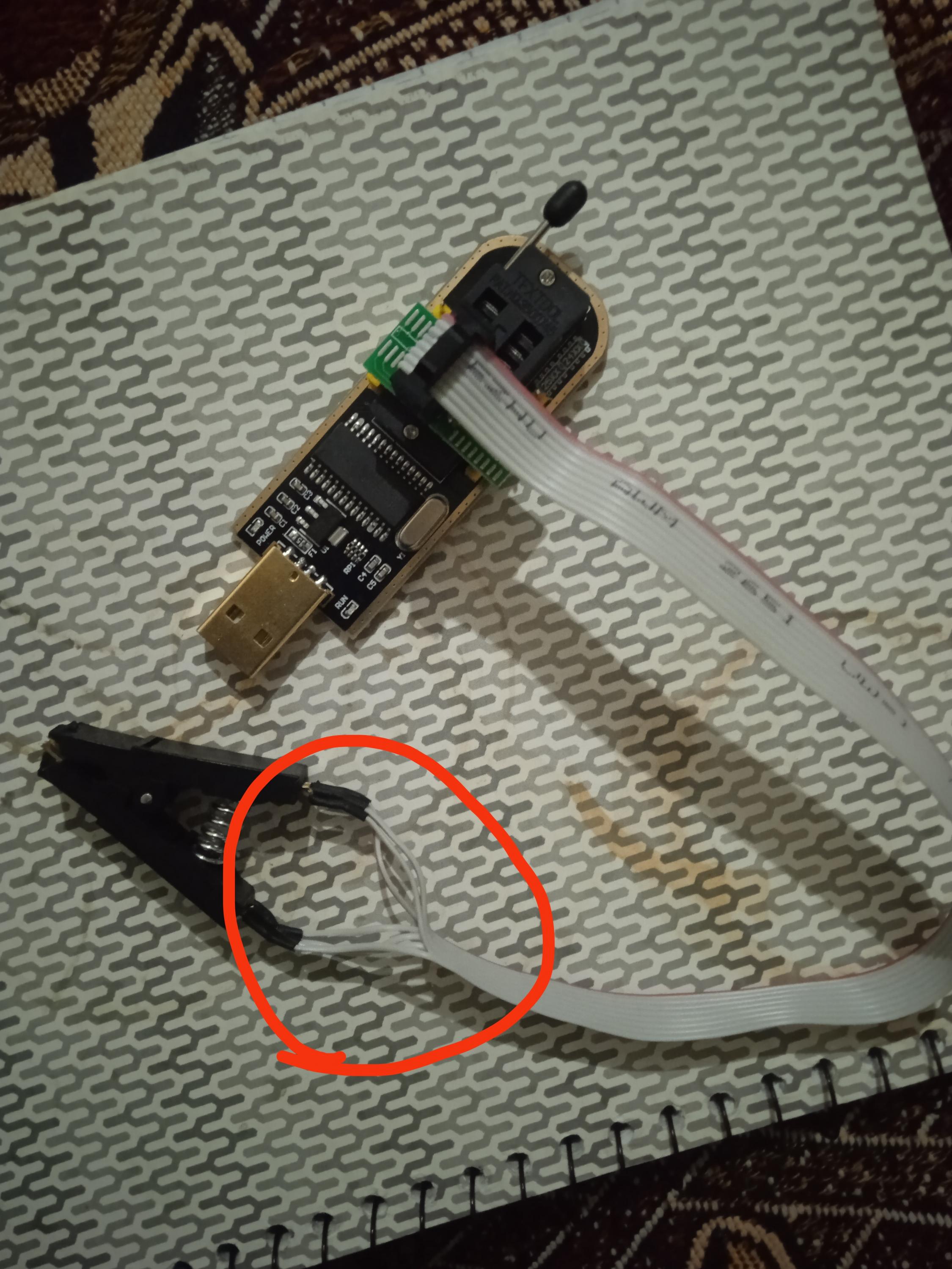

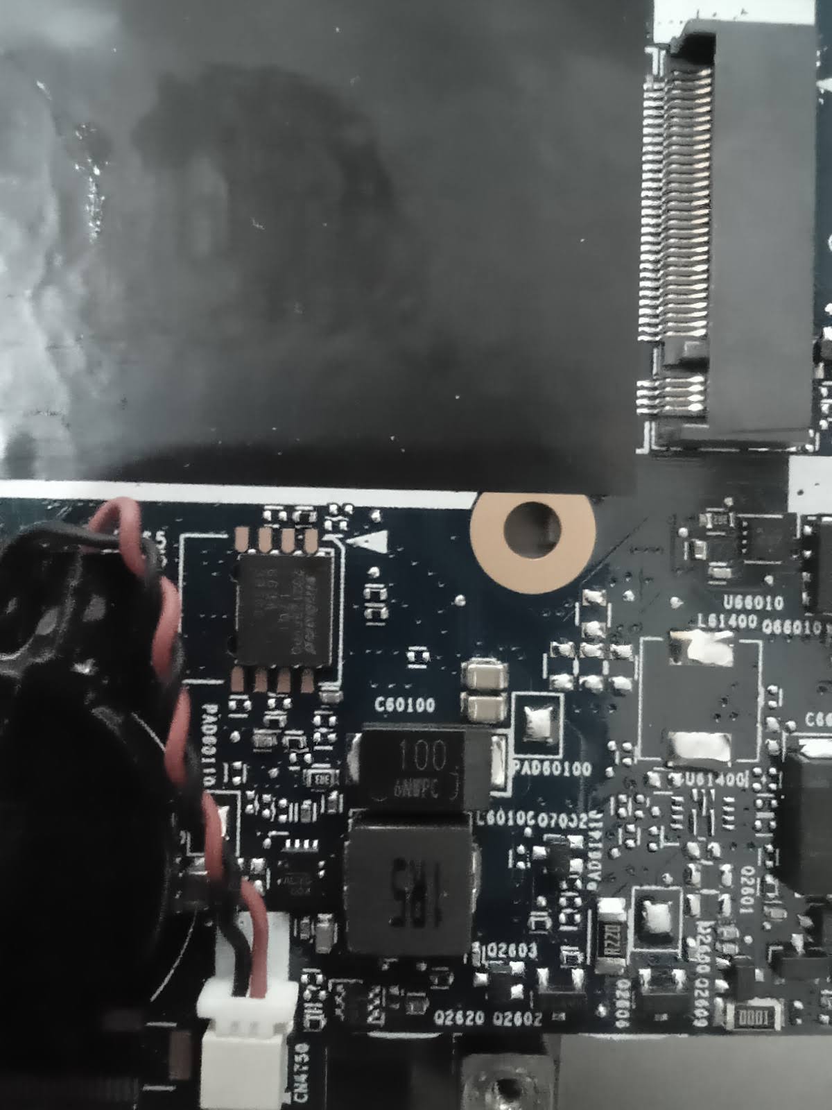

                          HI. can anyone help me i bought a CH341 and a test clip with it. my laptop HP 840 G3 has bios password which I wanted to remove. first of all the clip wasn't actually fitting on the chip because the clip was large. so i cut it a little and sometimes the clip fitted perfectly but there was no light in at power led. i tried running it through ASprogrammer but it shows an error like FFFFFF(Unkown) something like that. can anyone help me what should i do right? is the clip not fitting perfectly or there is another problem> Thanks

                            For the correct reading of the dump, you need to desolder the flash and read it separately into non-circuits.

                                The ic you are trying to read is not isolated from the rest of the circuit, when you are powering the memory chip with the clip from the programmer you are also powering (or trying to), everything else connected to the ic's vcc such as the microprocessor, any memory etc. The usb programmer can't supply the current and if it did the microprocessor would likely interfere with any reading

                                  Sorry for asking too many questions. so you are saying that my only option is to desolder the chip and then read the ic? btw thanks for helping

                                    Youve been using a SOP8 clip with a WSON8 chip, it is the wrong adapter to use .You can solder wires to the gold pads ,then to the programmer adapter, or cut the clip off and use those wires
                                      Thank you so much. man, I thought that maybe I was using the wrong clip because It wasn't fitting the chip lol.
                                      thanks for the help.
                                        So let me understand completely. Basically, you are saying that cut the wires from here and solder them onto the gold pads and then use the rest of the programmer as it is right?
                                        Really appreciate your help!
                                          yes
