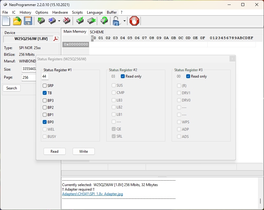

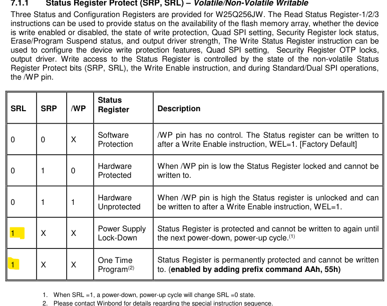

    You also have the "read-only" SRL bit set
    Attached W25Q256JW datasheet, check page 18, if SRL is set to 1 you can't modify the status register
    Click image for larger version  Name:	w25q256jw status register protect.png Views:	0 Size:	170.0 KB ID:	3697627
    As you have both TB and BP0 set, you can't program the first 64KB (0000h - FFFFh), the chip will ignore writes to that specific area

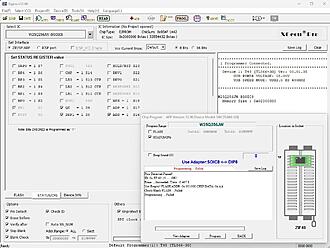

        Thanks guys for your hints.

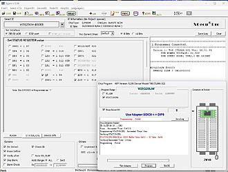

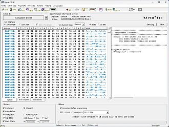

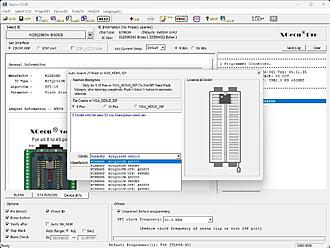

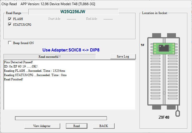

        I have now received a new commercial programmer, the chinese Xgecu T48.
        Tried to unprotect and reflash the chip with this commercial programmer, which also works in 4bit quad mode, but to no avail.
        Here some screenshots from the process:

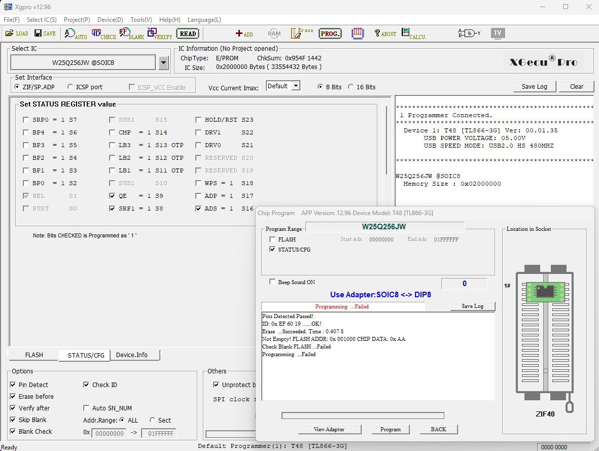

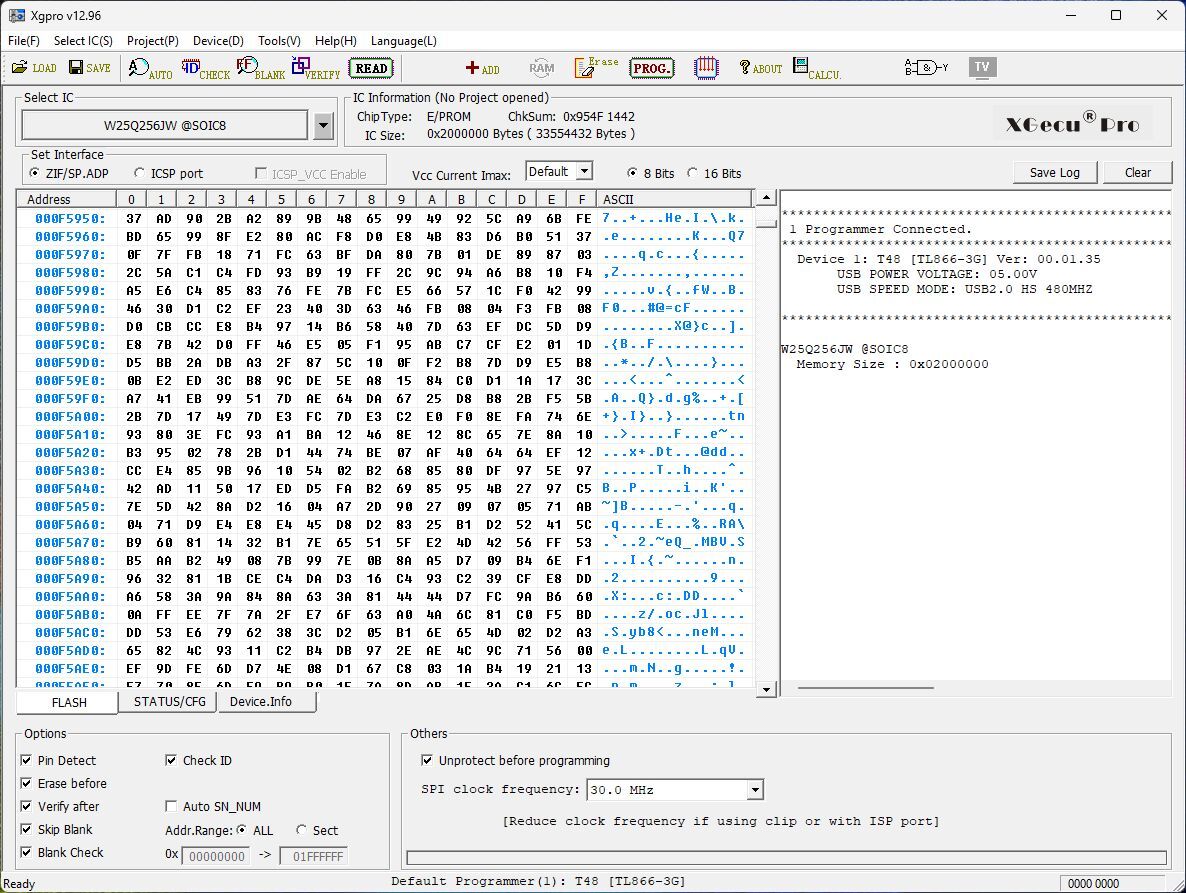

        Click image for larger version  Name:	Read.jpg Views:	0 Size:	41.2 KB ID:	3702853 Click image for larger version  Name:	Erease result.jpg Views:	0 Size:	36.4 KB ID:	3702854 Click image for larger version  Name:	About screen.jpg Views:	0 Size:	141.3 KB ID:	3702855 Click image for larger version  Name:	autodetect.jpg Views:	0 Size:	160.6 KB ID:	3702856 Click image for larger version  Name:	SPI not erased - content still inside after read.jpg Views:	0 Size:	246.3 KB ID:	3702857 Click image for larger version  Name:	Status CFG.jpg Views:	0 Size:	128.2 KB ID:	3702858 Click image for larger version  Name:	Writing status register does not work.jpg Views:	0 Size:	146.2 KB ID:	3702866

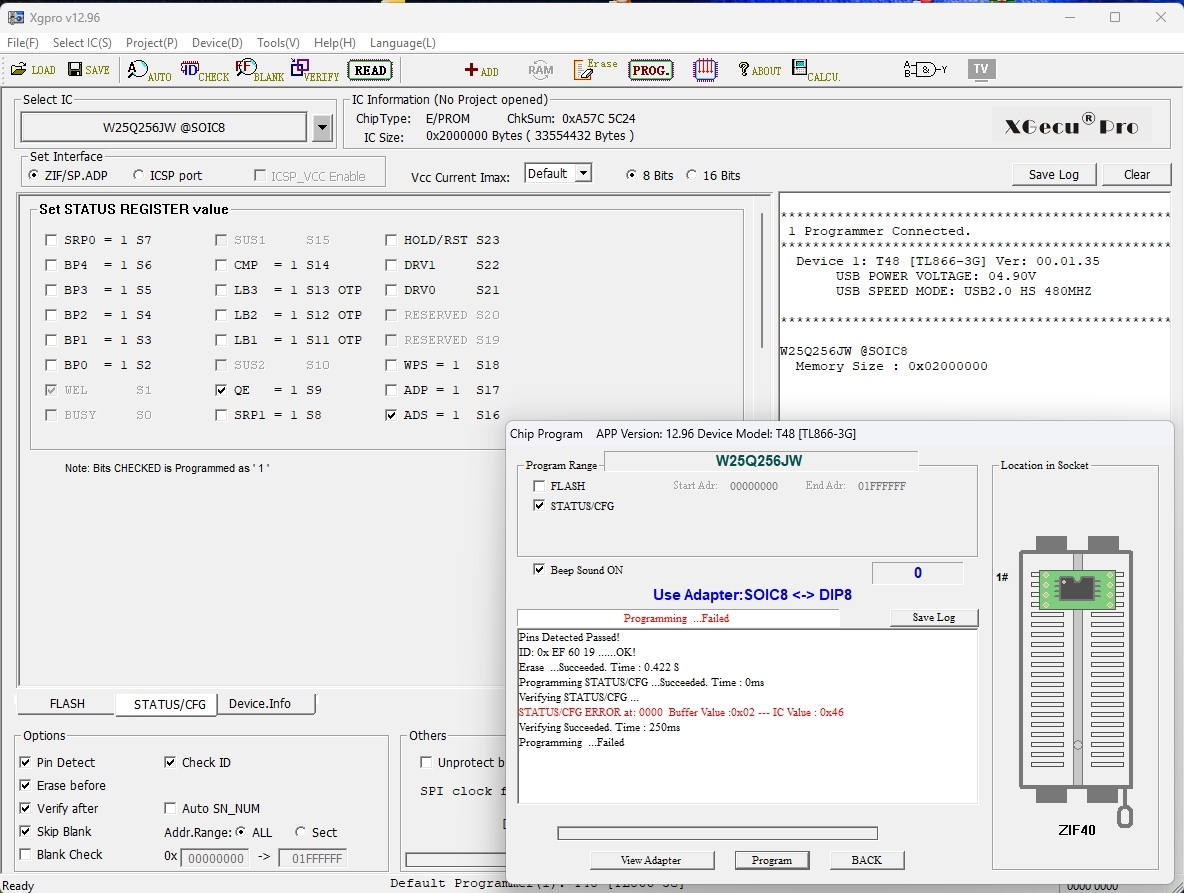

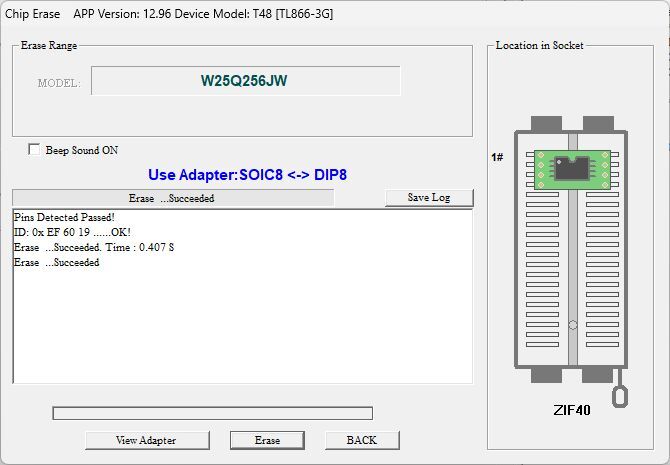

        The chips does not allow to chage the proctection registers.
        I tried to unlock also the SRL register, but it seems completely no register can be changed, whatever I do.
        Also measured pin 3 /WP during programming and it is correct level, i.e. high, so the HW protection is disbaled.

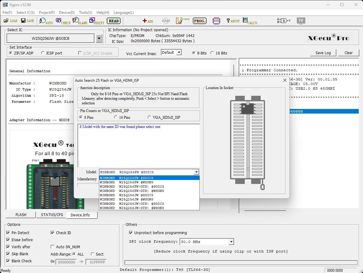

        Tried all autodetected spi chip models, as well as several *256* chips from other vendors, but no luck, no way to unlock the chip.
        The erasing process is much too short, only 0,4 sec. Normally it takes about a minut at least to erase such a chip - I tested it with a new chip. So the "Success" message of the programmer is wrong, as it even does not start to erase the chip.

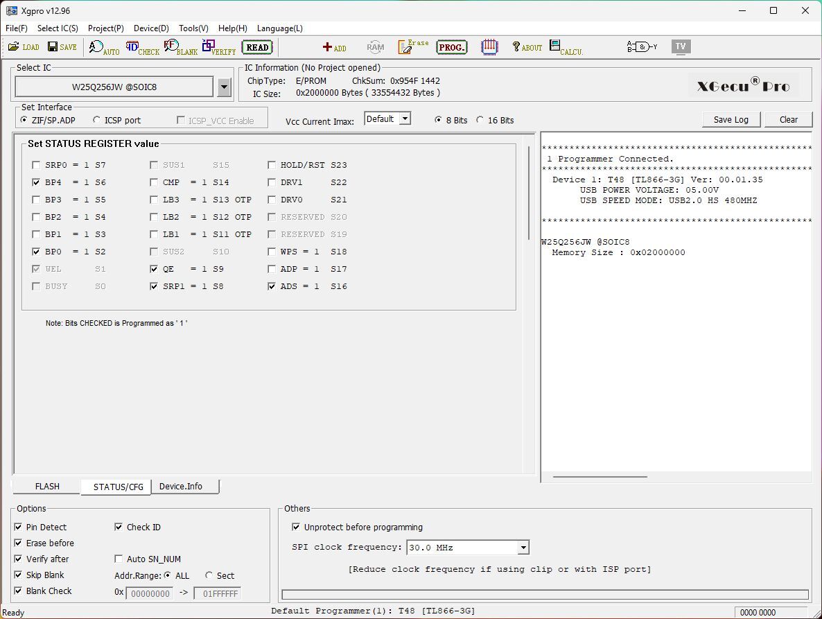

        The SRL register, equal to SRP1 (SR8) on the Xgpro programming software screenshots, can't be changed, also not by a Power Down/Up cycle of the chip.

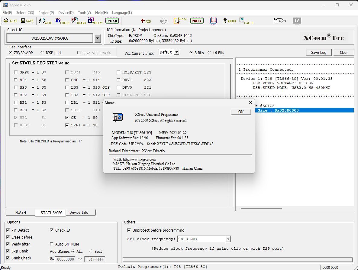

        Here what happens when I try to reset the status registers:
        Click image for larger version  Name:	Resetting the status registers fails.jpg Views:	0 Size:	333.0 KB ID:	3702867
        Still there must be some magic done with this chip by the BIOS of the motherboard, but what exactly I have no idea.
        Let me know if you have any new ideas.

          Looks like the second condition for SRL=1 is true i'm afraid
          One Time Program (2)
          Status Register is permanently protected and cannot be written to.
          2. Please contact Winbond for details regarding the special instruction sequence.

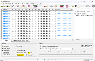

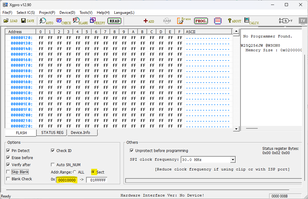

          That means you can't write/erase the first 0xFFFF of the flash, the rest you should be able to erase/program, uncheck "Blank check" and set Addr range from 0x10000 to 0x01FFFFFF
          That specific flash chip will only work on the same motherboard/another board of the same model

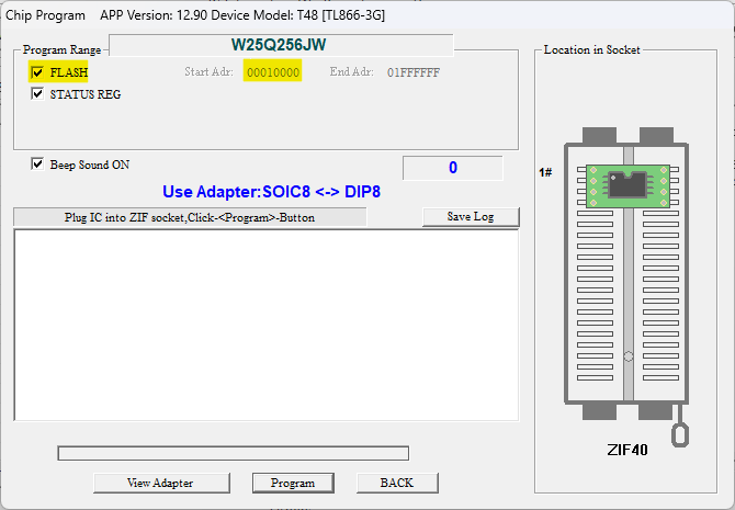

          Try this, clear buffer in the main Xgpro window, should be full of FF FF FF..., write that to the chip, settings as following picture:
          Uncheck "Blank check" and "Skip blank"
          select Addr range from 0x10000
          If it tails, also uncheck "Unprotect before programming"
          Click image for larger version  Name:	xgpro settings.png Views:	0 Size:	44.7 KB ID:	3703139
          Click image for larger version  Name:	t48 start range.png Views:	0 Size:	22.5 KB ID:	3703138
          Verify will fail, now read the chip, the first 0xFFFF should still be preserved, the rest should be full of FF FF FF
          Now flash the BIOS with the same settings
          Not ideal, but what can you do
