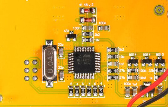

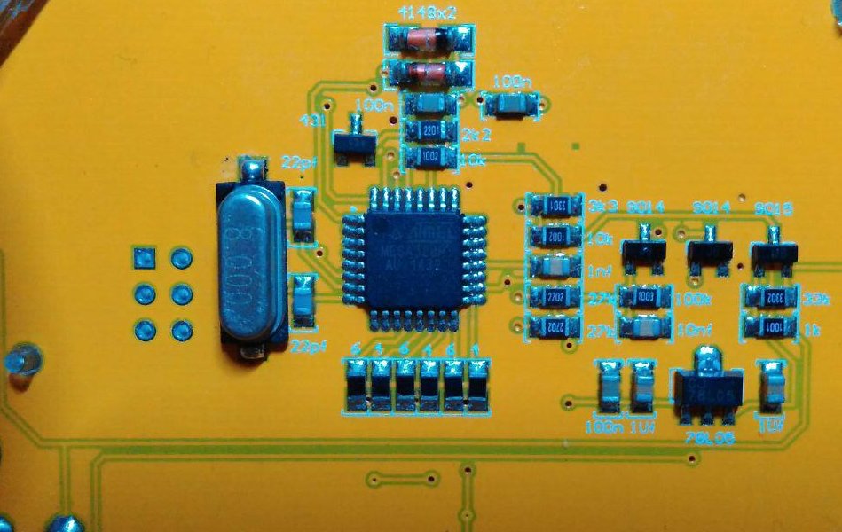

    Originally posted by stj
    can you double-check those pads, they use that to program them after assembly.
    Looking at the schematic and comparing to different high-res T3/T4 on google image is making me think my clone got the RESET connection wrong.
    I attach 2 better pics to show difference. The 2nd pic (mine) has a via that goes to pin 30 that other T3/T4 don't use.
    Thinking I should cut and reroute it to the correct pin 29.

      Re: ESR meter upgrades
      there are a few bad points on that board.
      i would replace the TL431 with an LM4040, and use a 3v3 regulator instead of the pair of diodes top-center.
