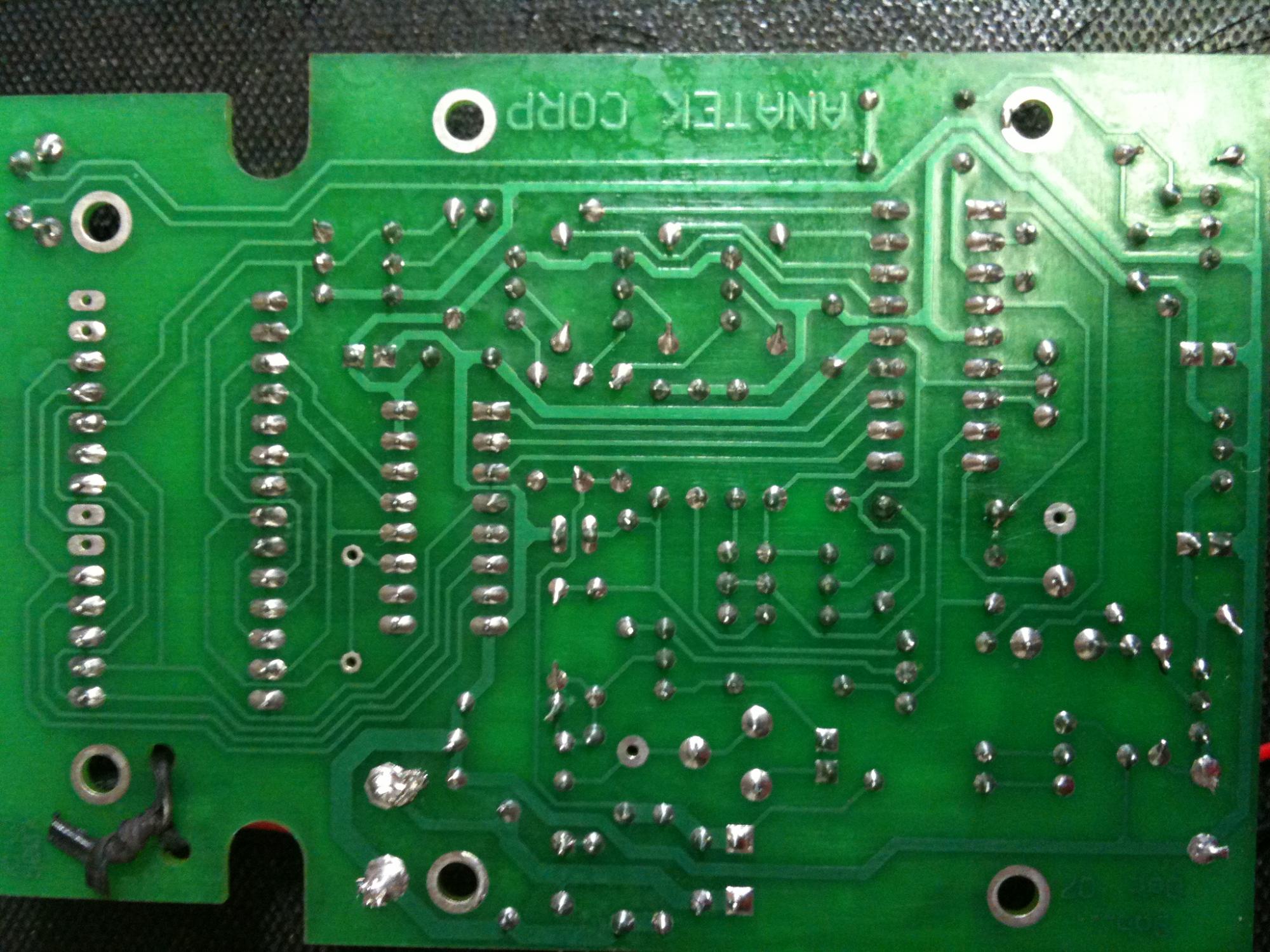

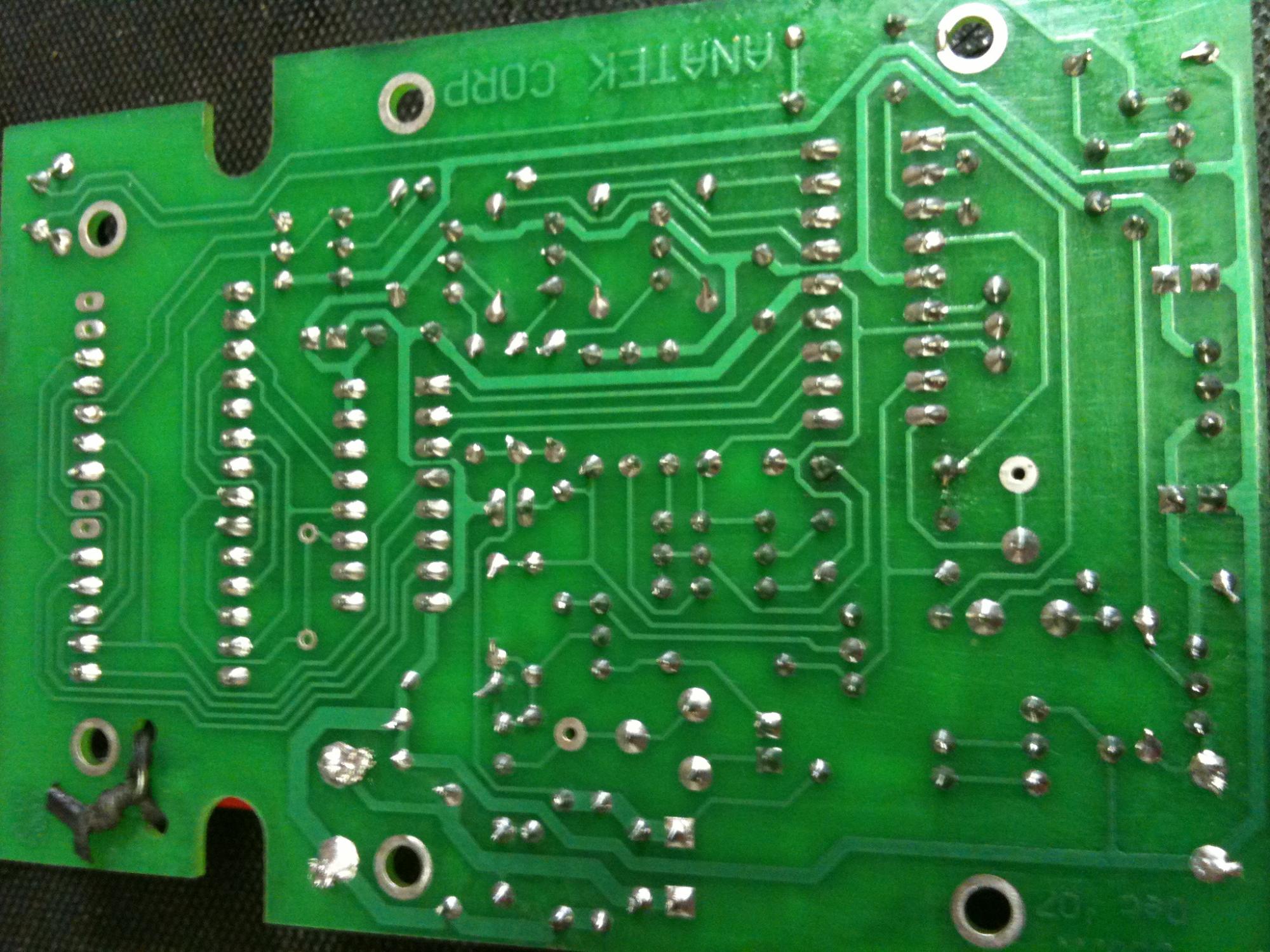

          I see some pretty nasty joints on both the probe wires and the battery clip where the solder didn't properly flow over the stranded wire so there could be some bad joints elsewhere. Unfortunately a piece of test equipment isn't the best place to hone your soldering skills.
          The transistors are oriented properly but still check to make sure they are all in the right places.

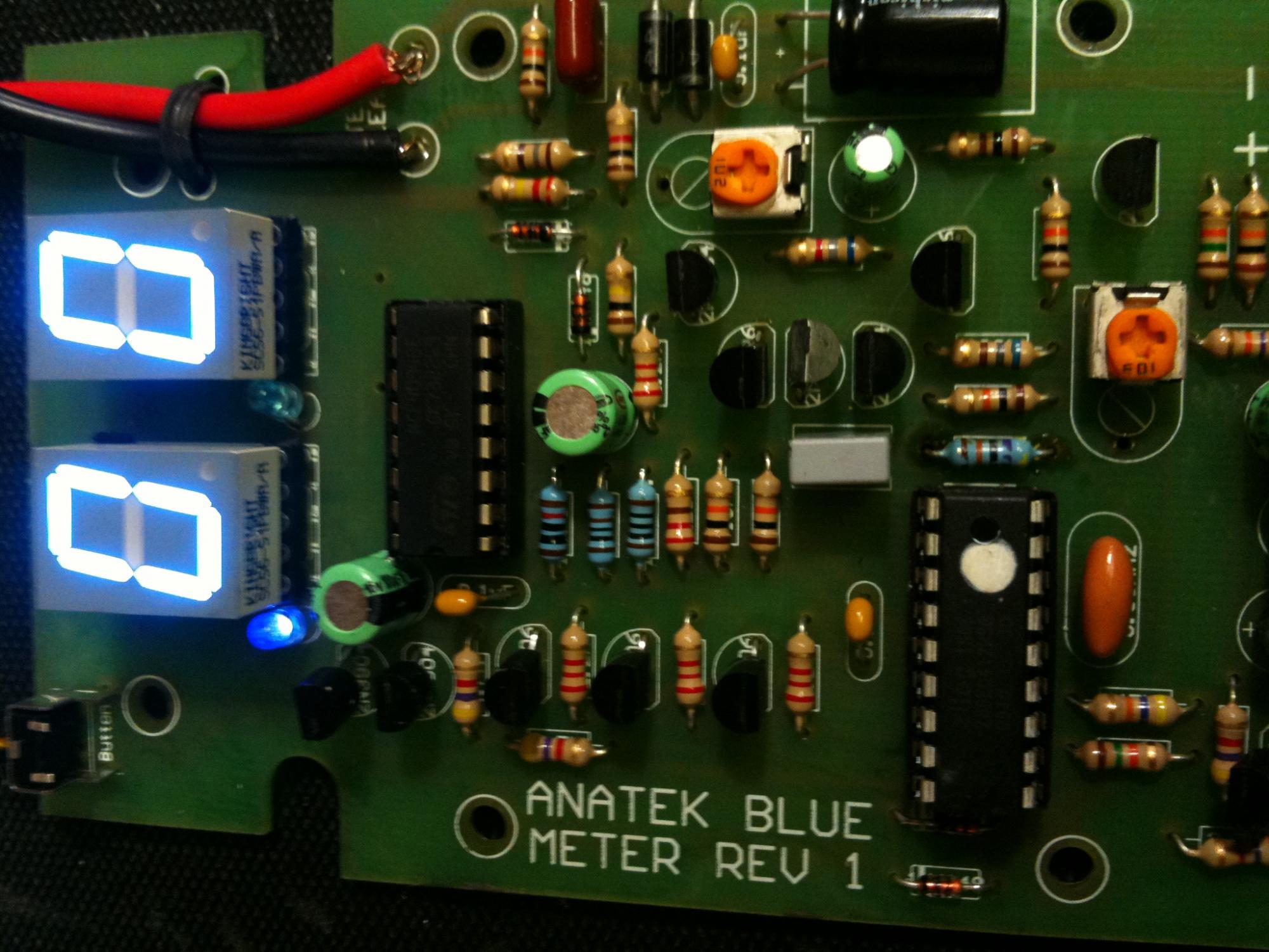

            update: here is the solder w flux added and new pictures attached.
            Good News first: both displays are now working! thanks a ton for all the information.
            I would like to thank everyone for all the input yaull provided, it helps me understand the way the meter functions and what component does what.
            1. The meter reads 10 when it is on and i have not seen "-" on the display. ALso the LED on the left has yet to light up.
            2. I get an F1 error code when i hold down the power button for the self test. (i went through the trouble shooting guide for this error and still have come up empty handed.)
            3. The meter will not power off once it is on unless you hold down the power button for the self test or remove the battery.
            I feel like i am allot closer to solving the issues i am having due to everyones input.
            Thanks again!

              If that white dot is indicating polarity then that Zilog IC is in backwards.
              Make sure before you go flipping it around.
              [That IC is basically the CPU and it IS static sensitive.]

                That's what I thought too when I first saw his photos, but the notch tells a different story.
                I think if it was in backwards he wouldn't get any kind of display at all, except maybe a (rather small) fireworks display?

                  IC2 is NOT around the wrong way. The fact that it's working proves it. If you reverse it, it will be destroyed and you'll make things a lot worse.

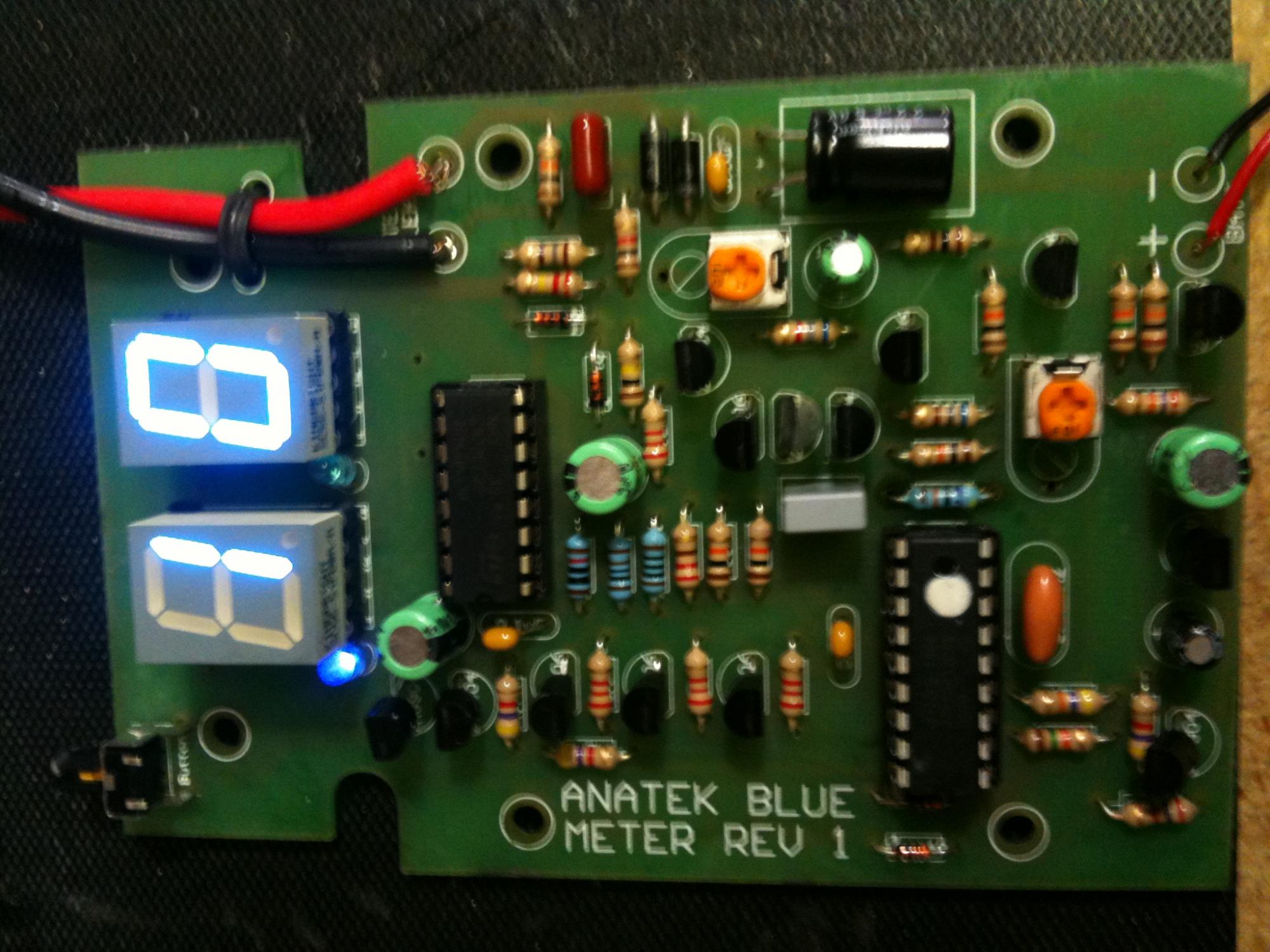

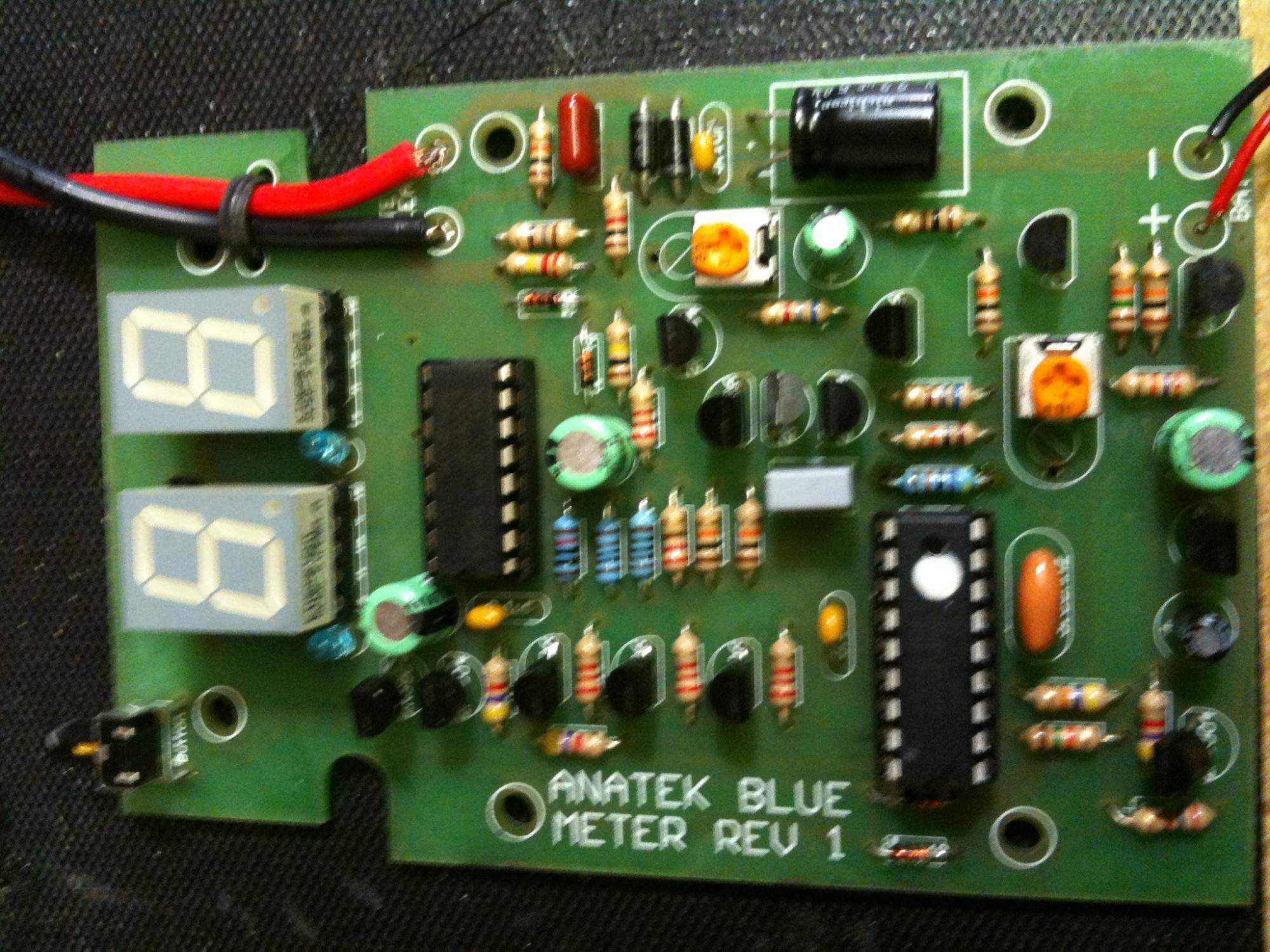

                      When I short the leads out I get ".00".
                      Not to sure why it is doing that. Thanks for the reply
                      To make sure we are clear.
                      When I power on the unit I get "-" on the disp1 then ".10". Then if I press the power button again I get ".00". If I touch or short the leads nothing happens. Stays at ".00".
                      The picture is without the leads touching.
                      Last edited by bedford_repairs; 09-17-2010, 02:43 AM. Reason: Answering the remainder of the question.

                          ".00" in the display, with the leads shorted, could be correct before calibration. Staying at .00 after the leads are un-shorted, is NOT correct.
                          Going through the "motions" with mine, I offer these observations of operation:
                          - press power button, DISP2 typically blinks (either a "0" or "-") and the center decimal point *may* flash and go off, then DISP1 will show "-"
                          - short leads together, unit will show ".0X" where X is any number and is actually indicating the resistance in the test leads.
                          - with the leads still together, pressing the power button will zero the unit and the display will show ".00"
                          - with the leads separated, the display shows "-" in DISP1
                          - "-" continues for several minutes if unused then auto-shutoff
                          With everything "appearing" to be in place correctly, some problems I can think of are:
                          1) You still have a bad joint/connection as Bob said in the beginning
                          2) Pull and re-seat those IC's and the displays in their sockets. Hopefully you pulled them out before resoldering the pins....?
                          3) Inspect every transistor and make sure you did not swap a 3904 and 3906 somewhere.
                          4) Verify the regulator is delivering 5v
                          5) Could the crystal be damaged/not working, killing the multiplexing?
                          Finally-
                          Have you performed the diagnostic procedure in the troubleshooting section found on Page 11 "It does not work, now what?"
                          You need to remove the battery and supply 6.2v to 6.8v instead. Also calls for shorting out R30 (100Ω - next to big cap). There are a number of diagnostic codes that you can refer to and post up here. Perhaps that will narrow this down.
                          Keep Fightin'!
                          Toast
