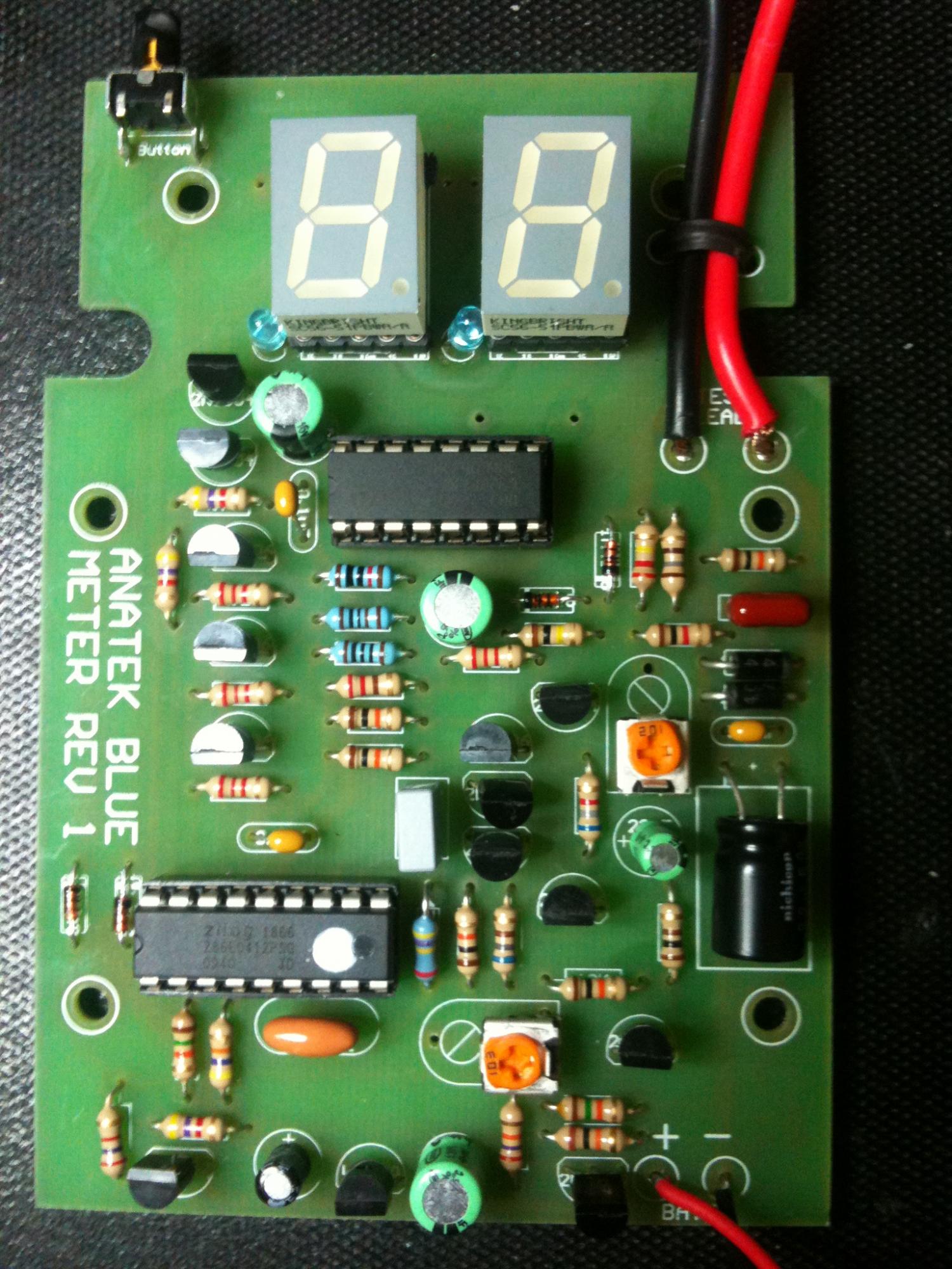

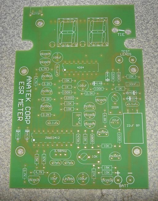

    Here is a picture of the unassembled PCB:
    See attached picture 2:

    The first thing that striked me as odd is on the silk screened PCB there were no component designation numbers like I'm used to (R25, C12, etc). There were only part values (220R, 27K, etc).
    While I'm sure that the intention of this was to make assembly easier it can also lead you astray. For example there are a couple of 1% resistors on the board with the same values as 5% resistors so in actuality you could place a 1% resistor where a 5% resistor was made to go and vice versa.
    The easy way to make sure you don't slip up is to look at a picture of the board with the component designation numbers on it in the manual. Then flip a page forward to see a picture of the board with the component values on it and make sure that the number of the component matches up with the component value.
    Personally I think it would have been alot easier with component designation numbers silk screened on the board.

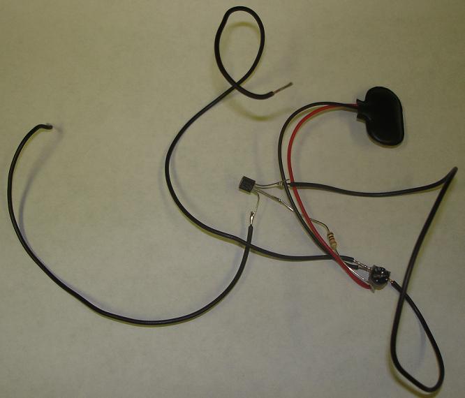

    So I build the little voltage regulator circuit pictured in the manual.
    Sadly the components for this circuit weren't included but can all be found at Ratshack. I happened to have the components in that huge mess which is my parts drawer.
    See attached picture 3:
    I used an NTE123AP that I had on hand which was a sub for a common NPN 2N3904.
    It is VERY IMPORTANT that you adjust this circuit while the meter is running if no load is being placed on the battery the input voltage will be off.
    I soldered the output leads from the regulator circuit to the PCB while leaving the included battery clip installed then I simply connected the battery to the little circuit.
    I then placed my probes on the other battery clip so that I could measure the regulators output with one hand and adjust the regulators pot for 5.5 volts with the other.

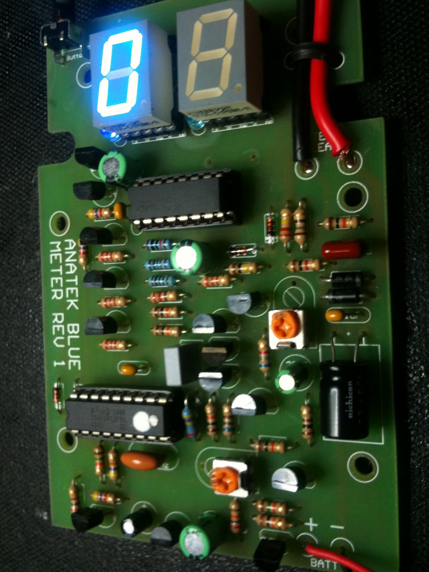

    Now onto the actual calibration I had my next issue when the meter was powered on the low battery indicator started flashing I then attempted to turn the adjusting POT clockwise and the indicator didn't go off. Turning the POT to both extremes didn't shut it off.
    Puzzled I turn the POT fully clockwise and turned the meter off then on and the indicator turned off. I then turned the POT counter clockwise and the b indicator came on I then turned the POT clockwise again.
    You would think that this will turn the indicator off.
    However this is untrue the manual neglected to mention that the low battery indicator is a latching circuit in other words once it comes on the only way to shut the indicator down is to power the meter off then on.
    This makes sense to design the circuit this way since it would prevent the indicator from flickering on and off if the battery was jumping back and fourth past the threshold voltage.
    While this was again a misinterpretation on my part and the manual clearly stated turn the pot fully clockwise then turn it counter clockwise until the indicator comes on it not fully explaining why lead to some confusion.

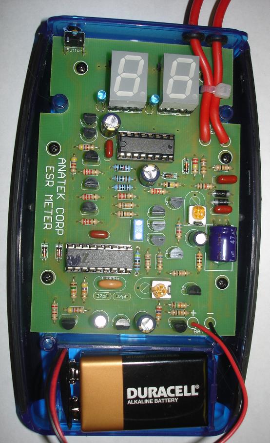

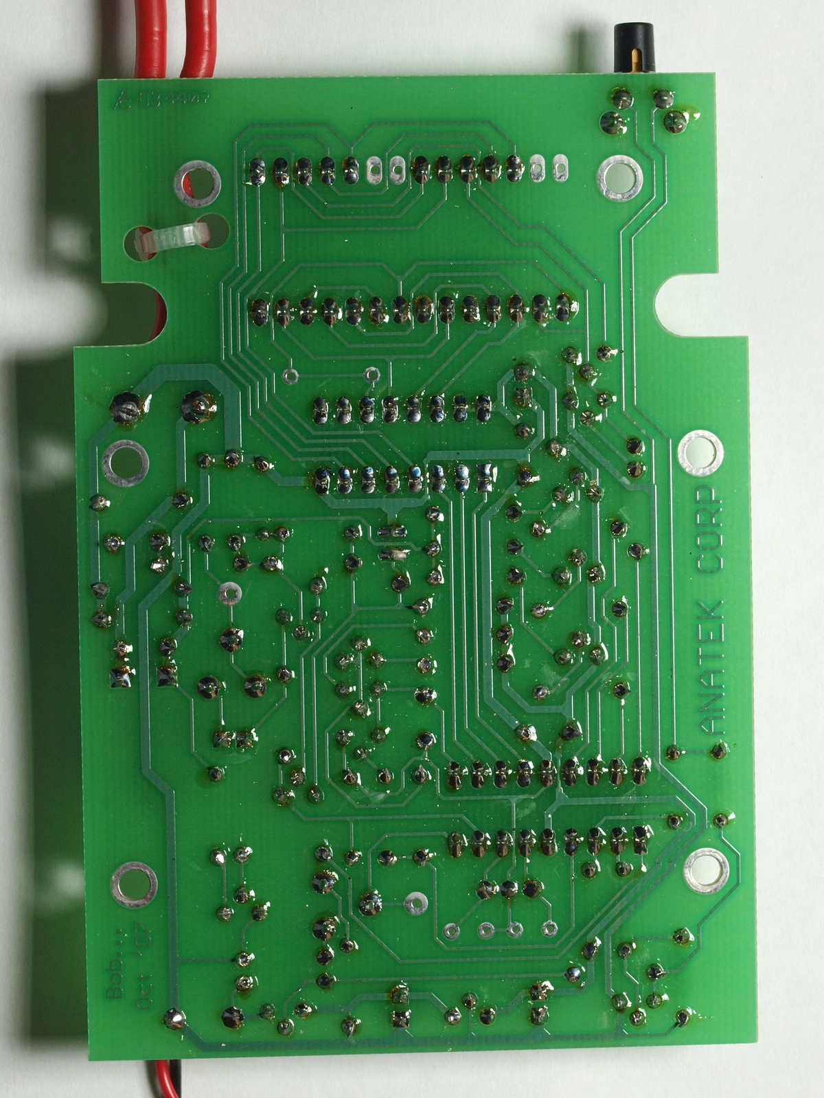

    The assembled kit board:
    See attached picture 4:

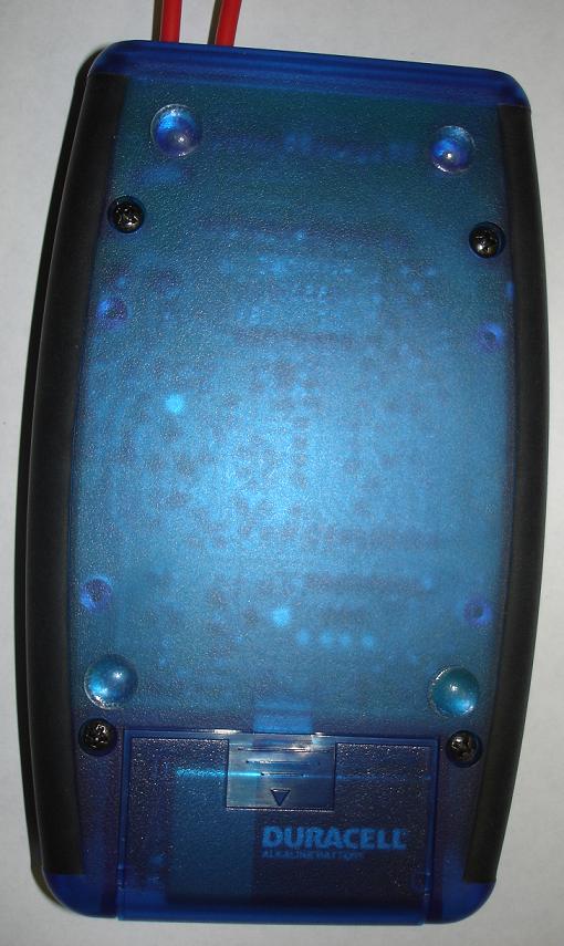

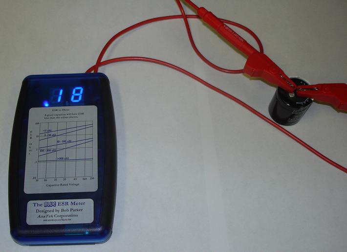

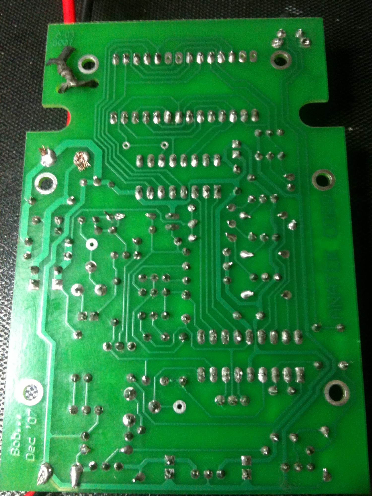

    The fully assembled kit:
    See attached picture 5:
    I also put on some clear feet so that it won't skid all over my bench and so I don't elbow it onto the cement floor .
    See attached picture 6:
    Overall after assembly this meter is every bit as good as the Dick Smith kits with some extras like the battery cover and the more efficient blue displays.
    I am very pleased with this meter and it's a great option for those of you who haven't been able to grab the quickly vanishing Dick Smith kit.

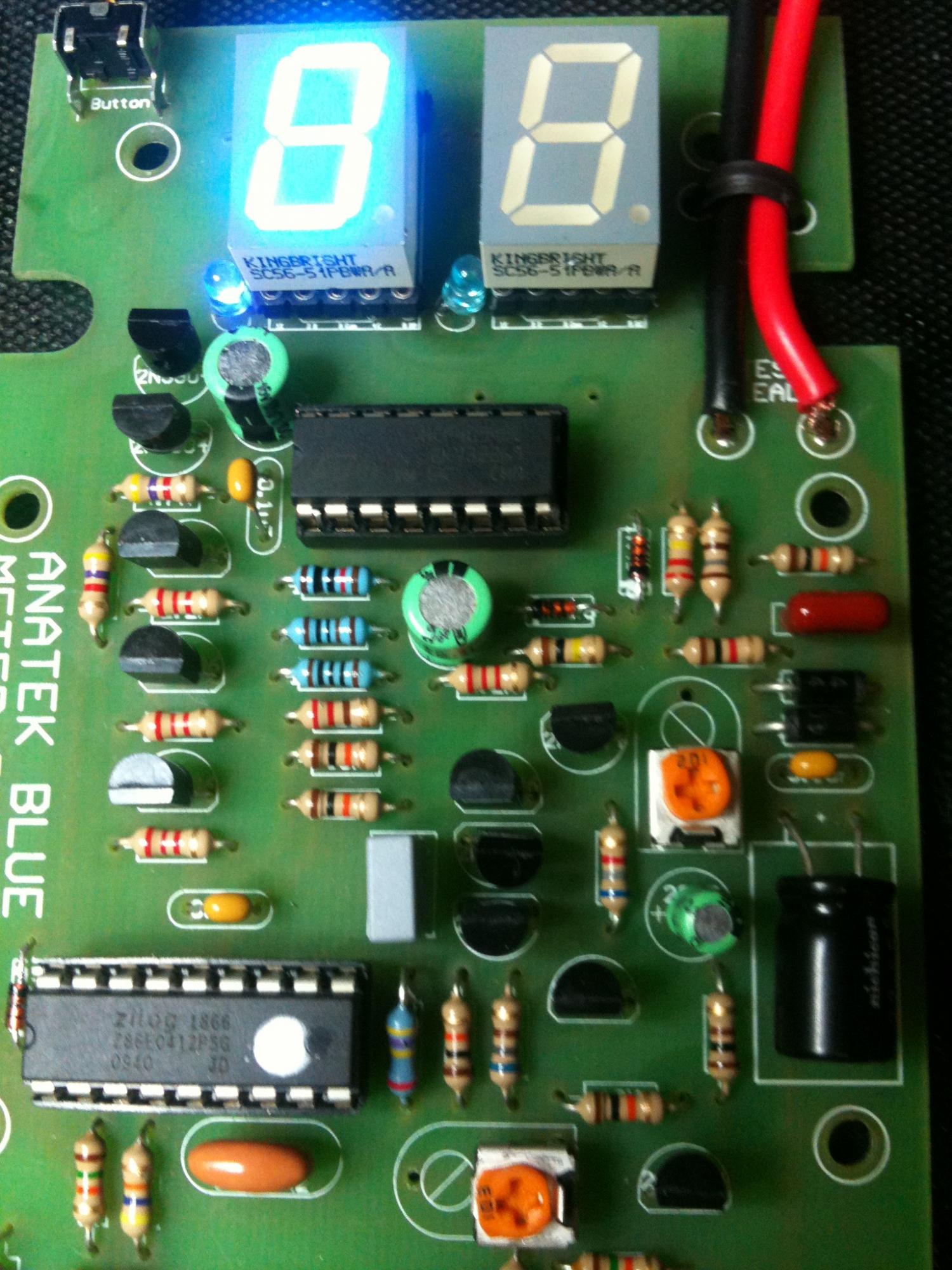

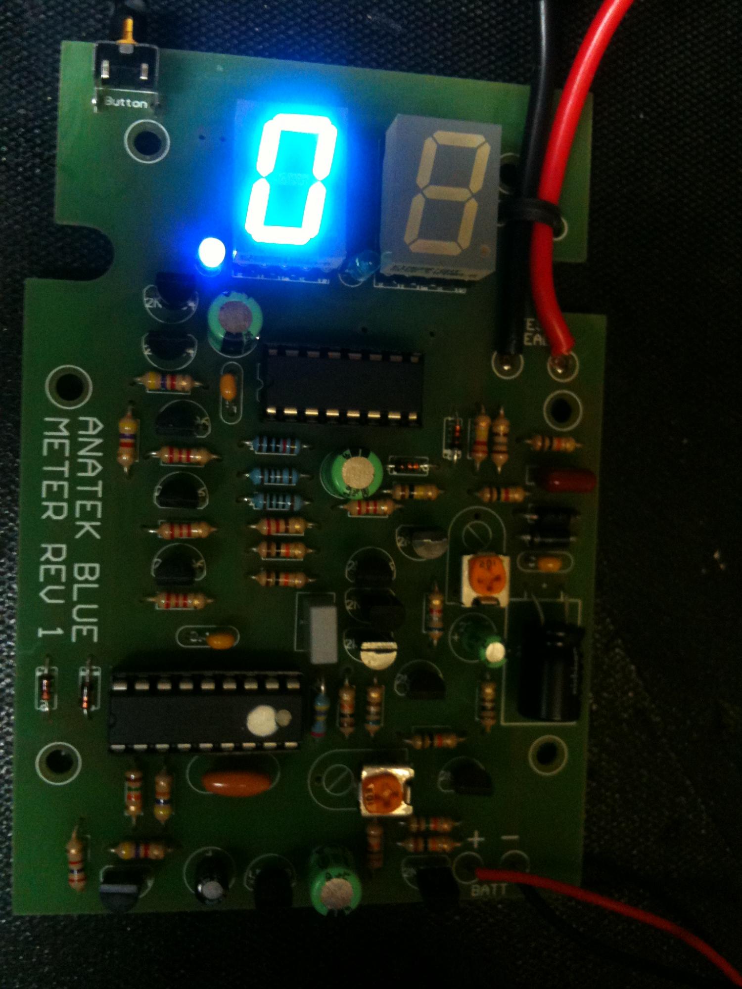

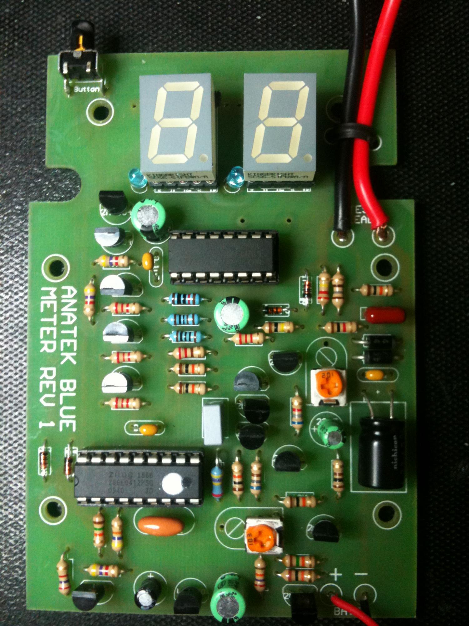

                      Ive purchased the meter and after i finished assembly and im having an issue with the right side LED and Display lighting up.
                      I looked over a few posts for trouble shooting and the only thing i could come up with is IC3 may have been bad but i since replaced the IC and i am getting the same results.
                      Any ideas?? Here are some pictures of the front, back and the display.
                      Any input would be greatly appreciated.

                        If the 4094 was OK, I would check transistor Q13 which switches DISP2 and LED2.

                          Thanks for the detailed photos. I'll have a careful look at them and see if I can see what's causing this problem, and get back to you.
                            Stupid message board. I wrote out a detailed description of what to check, and then it wouldn't let me make an edit so I've lost it all.
                            OK, to summarise.... please resolder Q12's (2N3904) leads and R27's (4.7K) leads. All the solder joints should be smooth and shiny, and those connections in particular don't look like that in the photo.
                            Good luck.

                              I appreciate the quick responses.
                              Agent 24:
                              Thank you for the information. I did first check continuity on the Q13 transistor and all checks out. I then removed it and checked the transistor to test it w my multimeter, guess this is where im a bit green. I know the transistor is a NPN and i looked up the data sheet and see pin 1 is the Collector, pin 2 is the Base and pin 3 the Emitter. So my question is what reading should i see on the meter as this is a switching transistor to verify if it is working properly?
                              Mr. Parker they came from my phone so i hope they show enough detail. If there is anything else you need information on or pictures of i will gladly post them ASAP.
                              Thank You both again for your time.

                                Thanks Bob i will do that and let you know how it goes! Sorry about the message board screwing up on you, now im curious to what you had to say! Always open to learning about this. Ill let you all know soon.

                                  Howdy again.
                                  I'm so buried in emails right now, that I don't exactly remember what I wrote in detail.
                                  For your info, it's exceptionally rare to encounter a defective transistor. You're about as likely to win the lottery as find one.
                                  The big killers of the ESR meter kits are (1) Soldering defects especially dry joints and to a lesser extent solder whiskers/bridges, and (2) Components in the wrong place. You would not believe how many people put the 220 ohm and 220K ohm resistors in the reversed places.
                                  Your phone photos are pretty good. Good enough to easily see all the component values and the general condition of the underside of the board. Thanks but for now I don't think I need photos any better than that.
                                  Also for your info, I've attached a photo of the back of a Blue meter board to show how the solder joints should look. I hope all this is of some kind of help.

                                    I'd say whiskers are more of a problem with lead free solder.
                                    Even manufacturers had a lot of problems with whiskers when the lead free ROHS craze started. Surface mount IC pin spacing doesn't leave much room for errors.
                                      Good luck.
                                      I thought that it would be Q13 that would be in question? Maybe I don't understand how the circuit works...
                                      Can you tell me why you would check Q12 in this case?
                                      -David VanHorn

                                        Re: Bob Parker's Blue ESR Meter Assembly & Comments
                                        Your pictures are of...
                                        Leads shorted together?
                                        Leads not shorted?
                                        Swap the displays, verify operation of other.
                                        Decimal point LED in correctly? Does it even flash when leads are shorted?
                                        Do you get the ( - ) sign in left display without leads shorted?
                                        Toast
