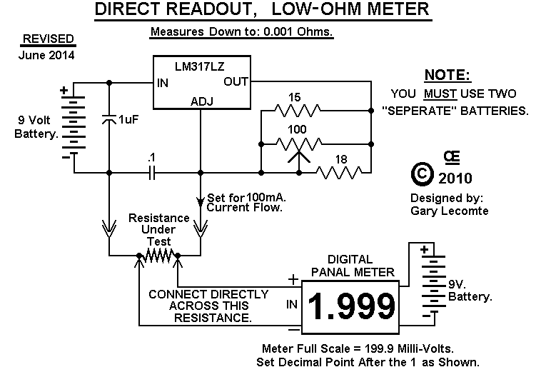

    Ok it is getting very tiring pulling tonnes of SMD components from boards in an attempt to find a short on the board... So..
    What is the best method of finding shorts?
    What equipment is needed?
    Suggestions of best make/models of equipment?
    Cheers guys

    a low ohms meter.

      Re: What equipment??
      How do you find a short with an ESR meter?
      This card I have had in today has a short somewhere down one of the 12v rails.... Of course on my meter it is showing 0 ohms across the pads of many components... Would this not also be the case with an ESR?
      I have read up about people using variable PSU's and pushing a small current through the circuit then using a sensitive meter to track the path of the current.
      Basically I am looking for the quickest way of finding them
        esr meters can often show resistance with a higher resolution.
        my meter for example can show xx.x ohms
        an esr meter can show xx.xx
        10 times more detail.
        the resistance of the solder and copper tracks is very small, but it's still there, so with a good enough meter the short will show a lower resistance as you get closer to it.
        there used to be circuits for this using a speaker that generated a tone that rose in pitch as you got close.
        maybe you can find one.

            as for finding shorts though, go look on schematics sites for a low-ohms tracer.
                    found this - it looks simple.
                      Simple as it may be I can't build circuits so I will need to buy one

                                  • australia
                                  I have been having good success at finding shorted Multi-layered Chip Capacitors using about 0.5A of bias current and using a multi-meter with at least 10uV resolution by measuring the voltage drop on the ground plane. The readings increase as I get closer to the shorted MLCC.

                                    How exactly does it work? And 10 uV is really too low…
                                      he is tracking the volt-drop.
                                        The meter is set to 10uV resolution to measure small changes in voltage, that's not the voltage he's applying to the ckt.
